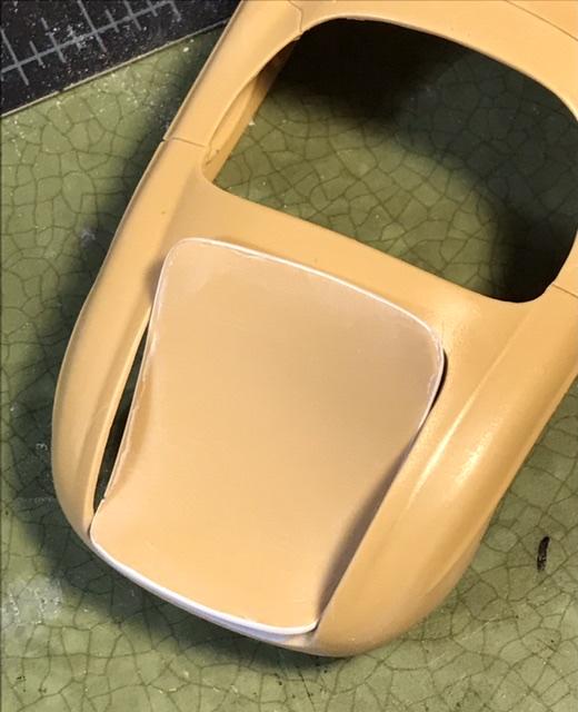

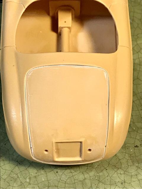

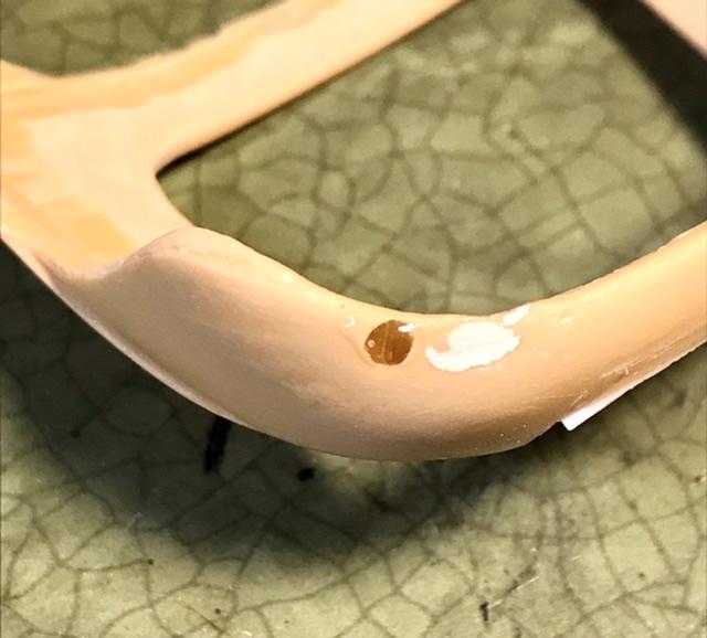

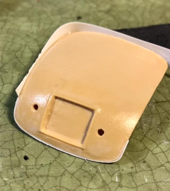

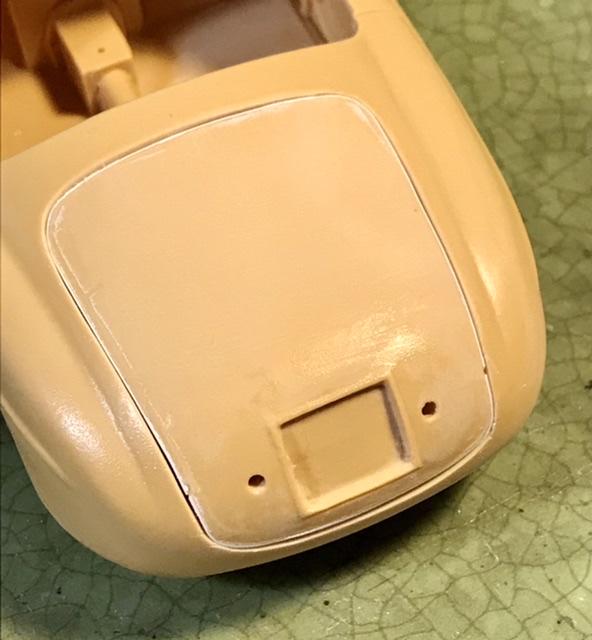

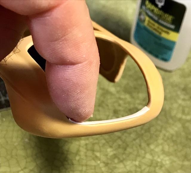

absmiami Posted October 12, 2021 Author Posted October 12, 2021 Gonna put all the …. Junk in the trunk …. But first I have to recover the shut lines on the trunk lid with a strip of Evergreen and lots of CA glue …. And filling the one casting cavity that I found along the lower edges of the body casting …

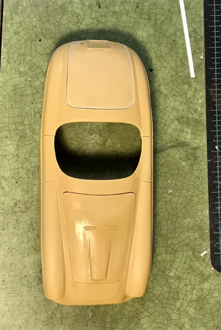

absmiami Posted October 12, 2021 Author Posted October 12, 2021 If you’re loading pix fr your I phone. - give them a “spin” on the editing app - which will give them correct orientation on the thread - which is what I forgot to do on the first trunk shot above …the fourth shot is the obligatory “glued the model to my fingeR tip shot”. That’s always fun … 1

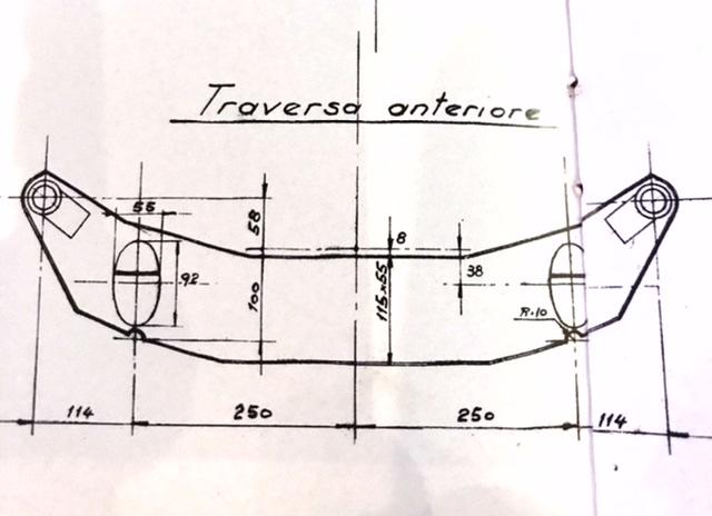

absmiami Posted October 15, 2021 Author Posted October 15, 2021 Here’s a neat discovery …. Years ago there was A Ferrari magazine publication called Ferrari Story - I don’t think it was published very long - I’ve got about a half dozen issues - they published a great series on the earliest Ferraris - including early chassis drawings from Gilco - they designed and made the early chassis - this drawing has the dimensions of the chassis tubes - don’t think I’ll use this for the UMI Barchetta - but it might come in handy in some Other early Ferrari projects that are percolating …

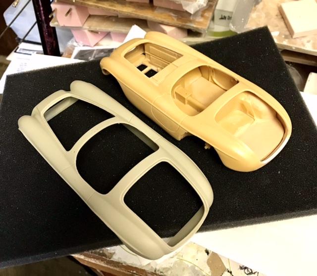

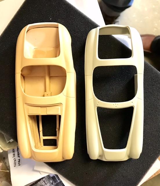

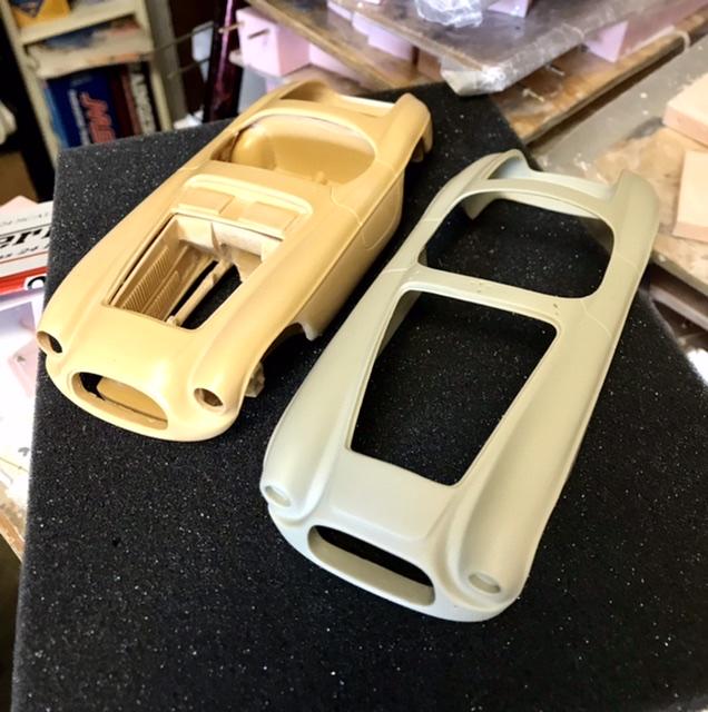

absmiami Posted December 2, 2021 Author Posted December 2, 2021 These photos offer a comparo of the Fisher / UMI Barchetta body casting and the MFH Barchetta - which of course is long out of production and basically umobtanium…. The MFH casting is in the collection of a friend that I had a chance to see during my wanderings up and down the east coast in the past two weeks … 1
absmiami Posted December 2, 2021 Author Posted December 2, 2021 You can see several differences in the shape of the driving compartment cowling and some subtle differences in the shape of the transition from front fender to the radiator cowling - in some respects I think that the Fisher casting is more accurate - there are factory drawings posted here and there for reference - which brings me to the news on the MFH website - they are posting parts photos for a 12th scale Barchetta - including what will be a bonkers engine - with all of the internals - you haven’t lived until you’ve seen a working 12th scale MFH Ferrari V12 - with those pistons humming away …
absmiami Posted December 2, 2021 Author Posted December 2, 2021 So I’m anxious to see how the 12th scale kit develops - I’m wondering whether MFH will correct any of the shape errors made in their now 10 yr old 24th scale kit …. We’ll all know soon - as the speed of their kit development is dizzying ..
afx Posted December 2, 2021 Posted December 2, 2021 The lines on the MFH kit look a bit harsh/stark. I prefer the look of the Fisher kit but not a Ferrari expert by any means.

absmiami Posted December 2, 2021 Author Posted December 2, 2021 i: I occasionally email w Paul F - unlikely that he will again produce kits - which of course is a shame - but understandable given advances in cad cam and 3D printing but this is a good chance to see if makers like MFH will pay close attention to SHAPE - which requires an artist's eye to interpret in scale !! Umm I feel a rant coming on .... incidentally - Paul and Susie Fisher lived in Paradise Ca - it was THAT fire ! Paradise is trying to re-build, according to Paul - maybe consider a town name change ???? no, not Phoenix !!
absmiami Posted December 2, 2021 Author Posted December 2, 2021 Paul got the sweep of the cowl correct - 24th sc MFH ? Miss …

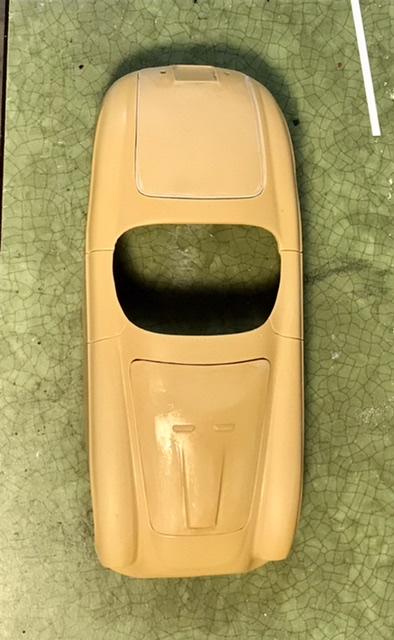

Ace-Garageguy Posted December 2, 2021 Posted December 2, 2021 Enjoying this, and your detail shots of the real cars are much appreciated. I have a Fernando Pinto version acquired a couple of years back. The body lines look very good on that one also. His Porsche 550 Spyder gets the lines right too, better than any other kit. I've had the opportunity to see a few 166 Barchettas together at one time, and the differences from car to car, with individually coachbuilt bodies, can be quite striking. I also appreciate the effort and skill you're putting into opening panels on these thick castings. It's not a job most modelers could get right.. 1
