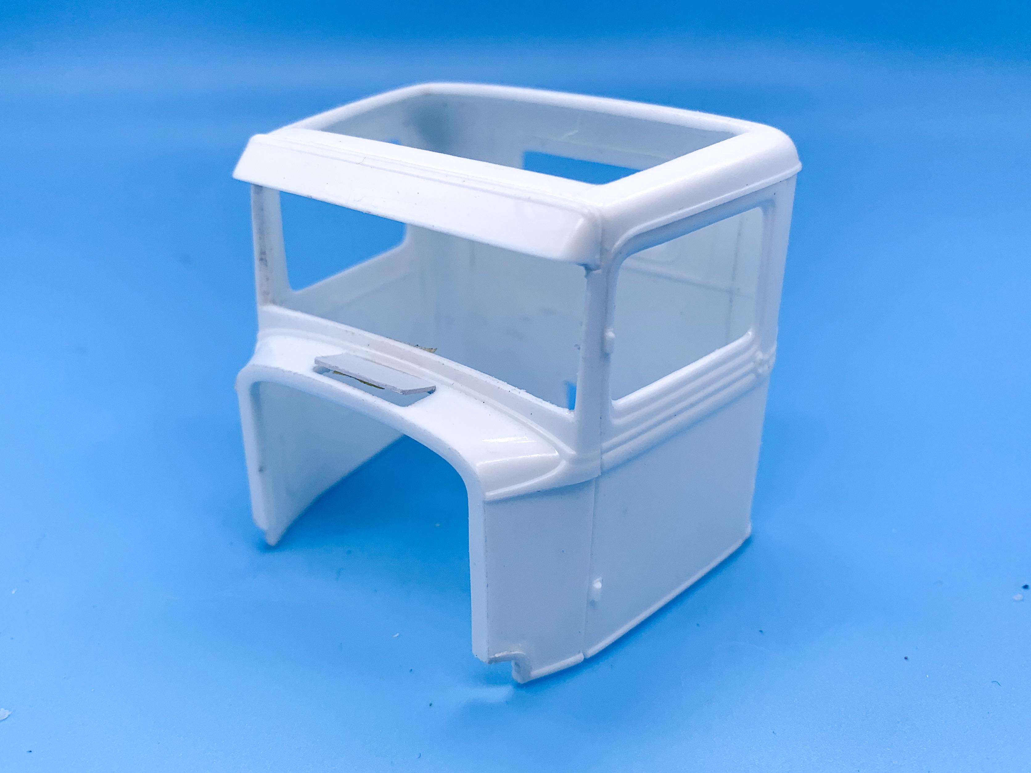

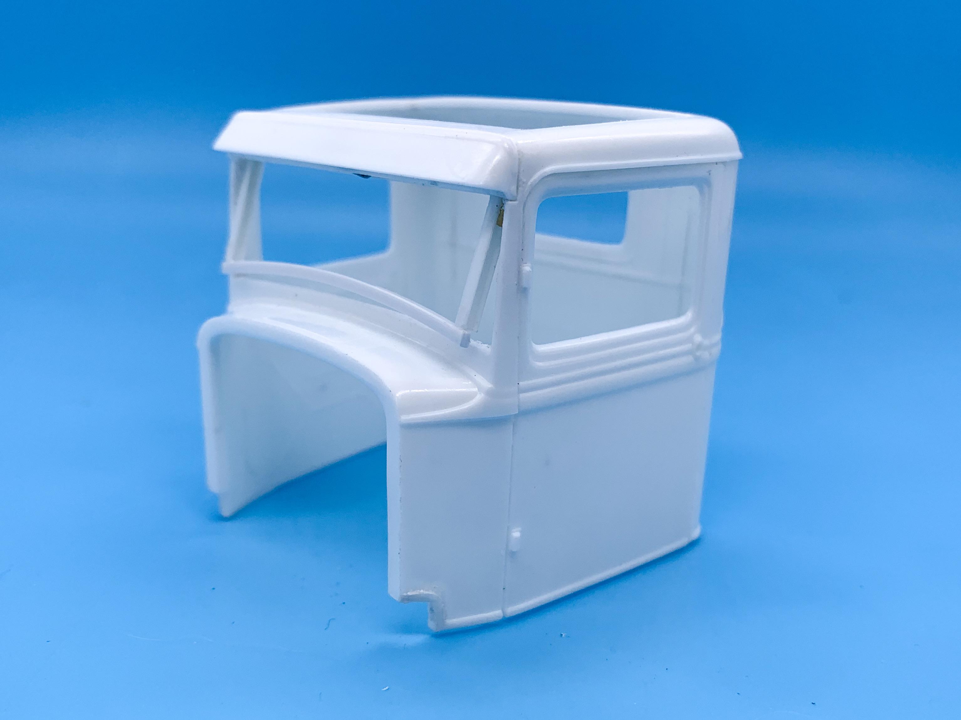

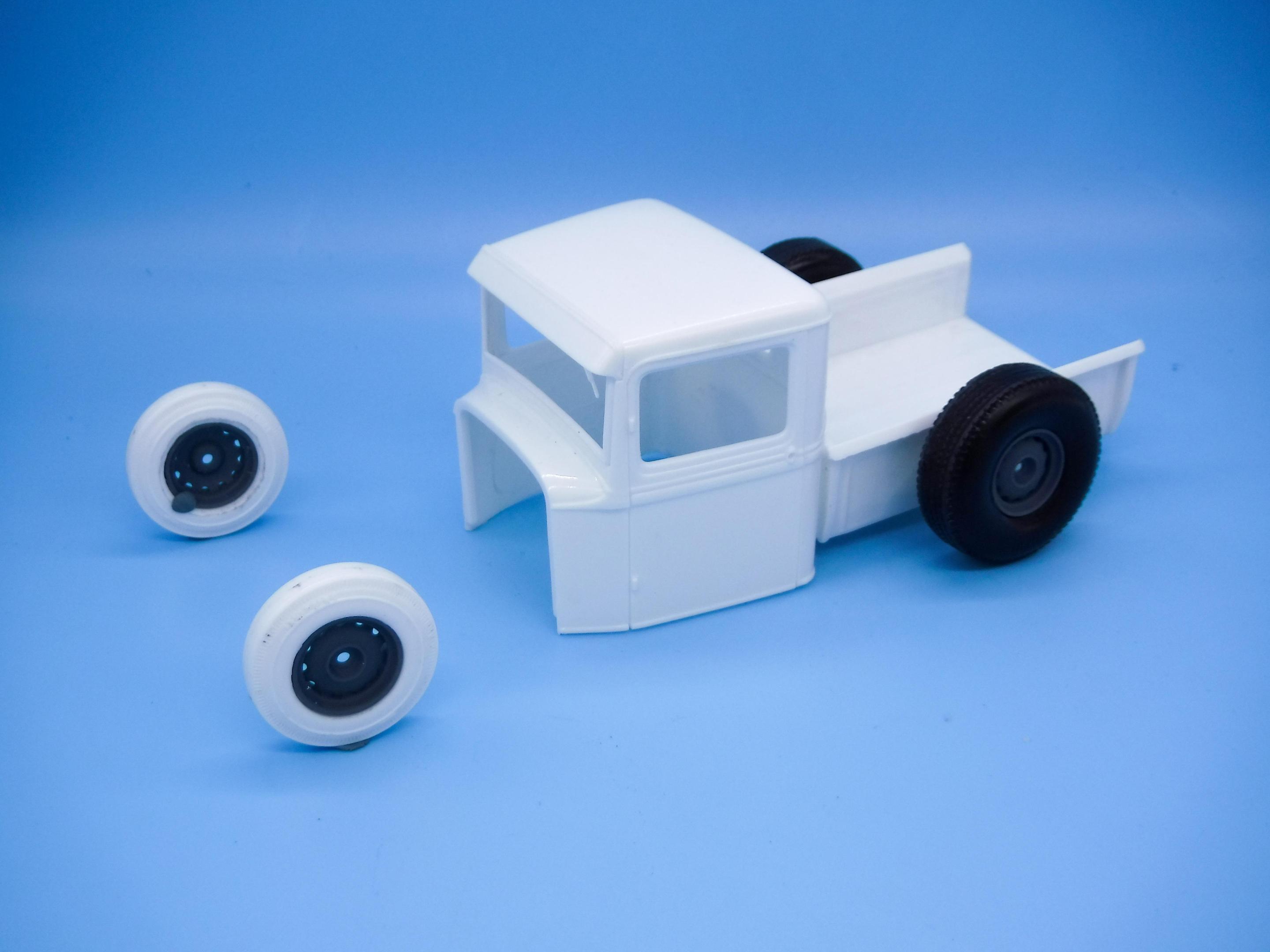

I’ve been building this thing in my head for almost a year now, and decided I oughta start ACTUALLY building it….I’ve been saving pics of 32-34 trucks for about a year now for reference  and I think I finally have enough ideas ?
Using the cab (and probably not a bunch else) from one of these:

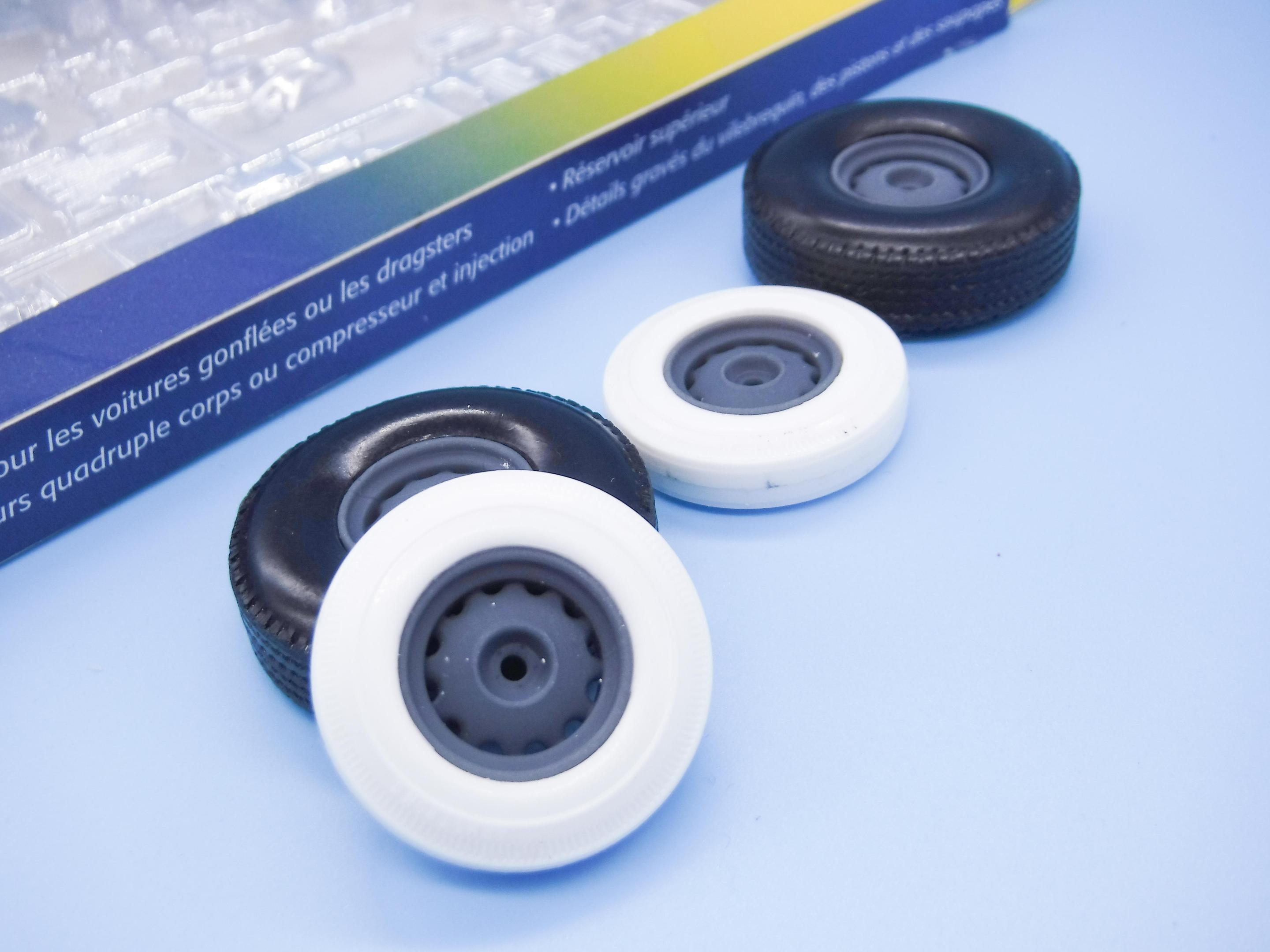

Scratchbuilding a frame around one of those nicely detailed old Revell Parts Pak engines, and I picked up some artillery wheels and some big meaty rear tires from (I think?) The Parts Box:
Those front tires are the plastic kit tires that come with these 34 trucks - seeing as I’m painting the rear ones anyway I figure these will work just fine - and they pair nicely with the resin rears to make some decent bigs ‘n’ littles.  Had to machine both sets of tires on my lathe to get them opened up enough to accept the wheels - seems like the wheels are about a scale 15” and the tires had a 14” or so ID.
I’m thinking of a nice low over-engined little hot rod, scratchbuilt frame, super low and mean looking with some unusual little touches that you don’t see every day.

No problem. really like those bobber style trucks. whats the plan for those front tires and the lack of tread?  A frame with all those holes will be super kool!!
  • Like 1

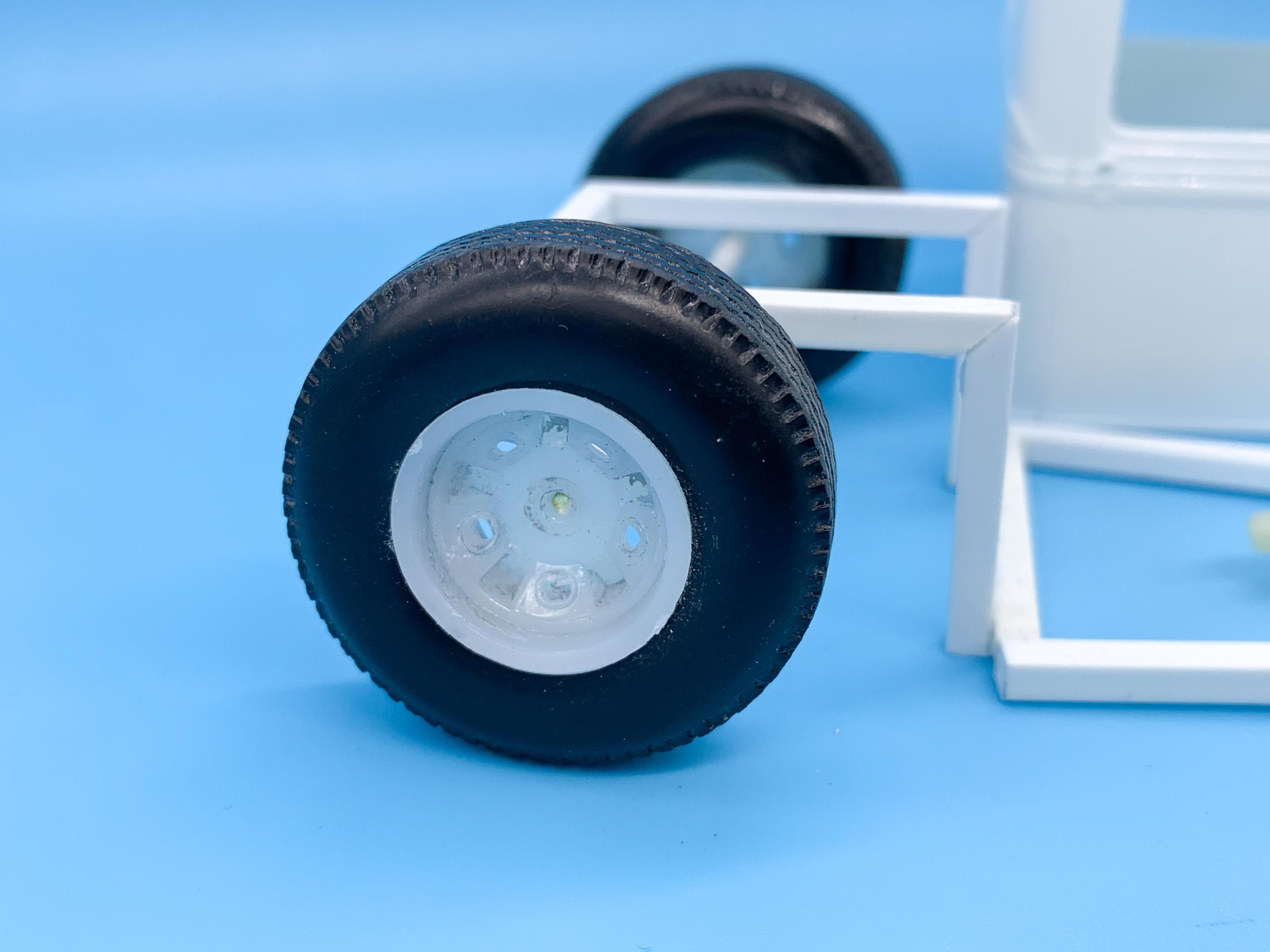

I’m thinking of cutting some treads into them with my lathe - haven’t totally figured out the best tool to achieve that yet…worst case it doesn’t work and I go with some others, but I’d like to make them work if I can!  Other option is cut thin strips of styrene with a zig-zag tread pattern and lay them around the tire- make my own treads on my scrapbook cutter!

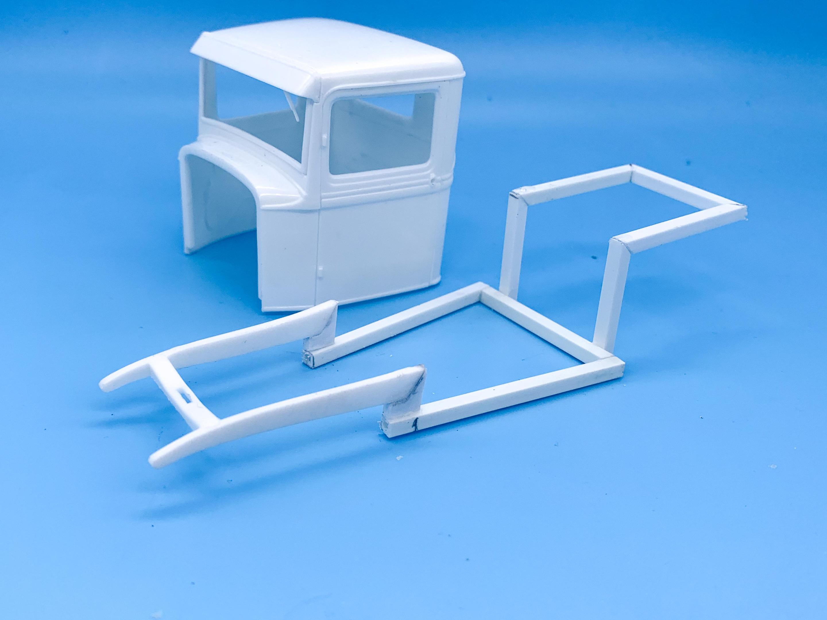

Speaking of the frame, seeing as I’m replying anyway, I’m kinda sketching in some styrene tube to see how this thing would lay out…got a lot of zee in the rear to get the stance how I want it with those big rear tires! ??
Something unusual I want to try with this build is to not have a traditional bed as such, but have the frame form part of the bed sides somehow but have the floor partially open so the axle and suspension setup are easily visible.  Maybe a little shelf just behind the cab with a gas tank and the battery.

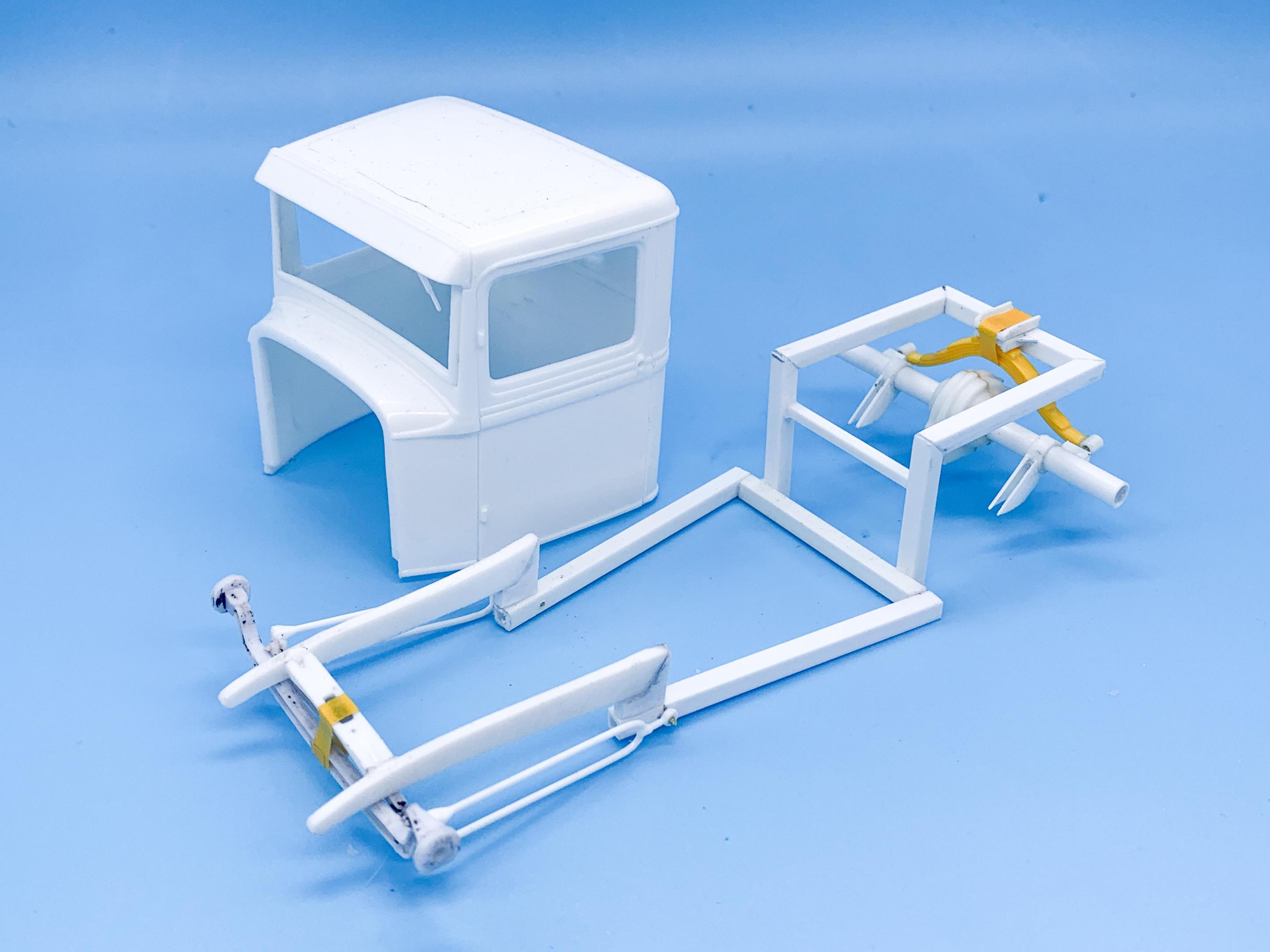

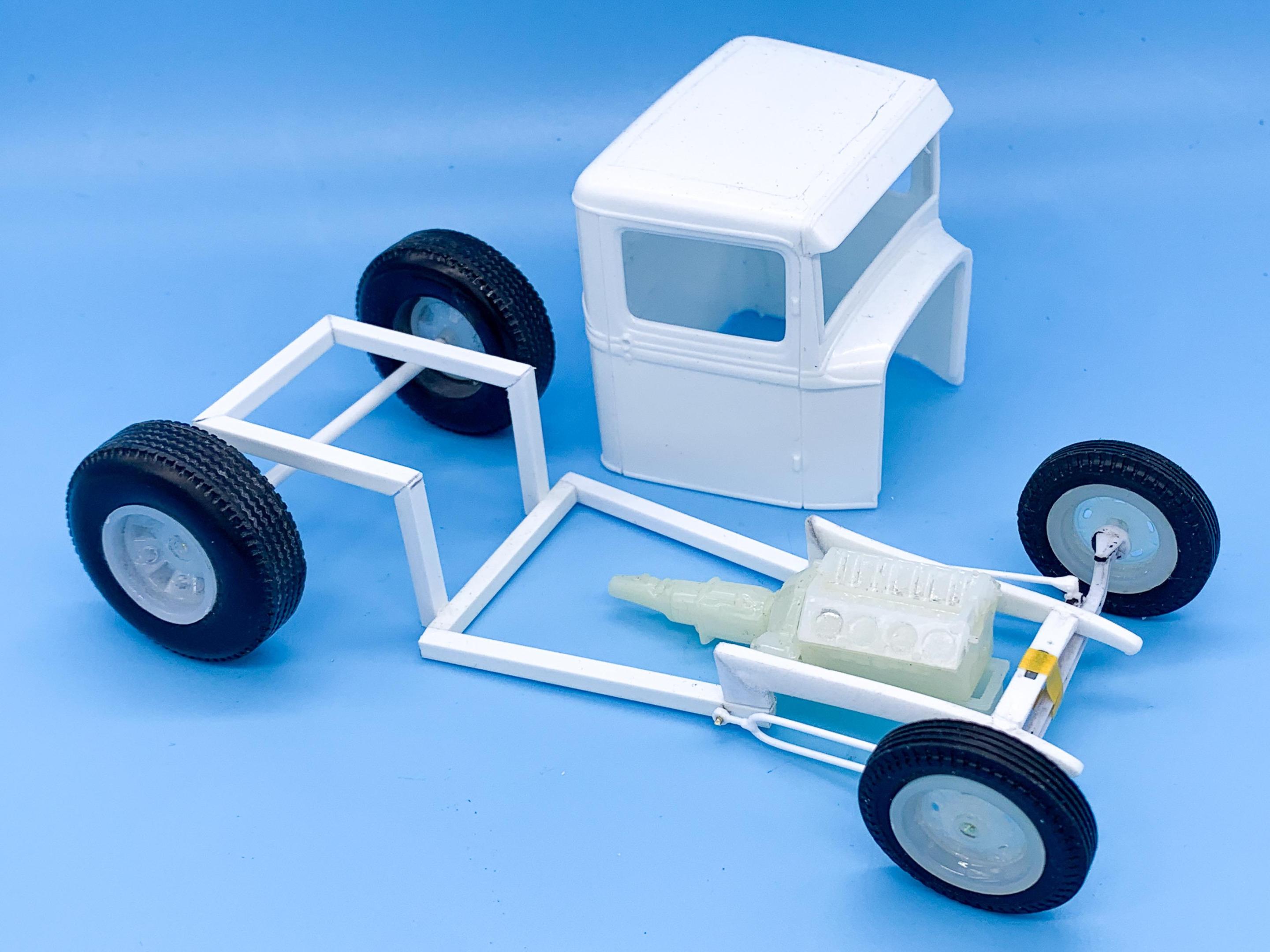

For a front axle, I went with the Revell unit from the 29/30 Ford kits - it drops right under the AMT truck frame like it was meant to go there, it seems like.  That said, I flipped the crossmember in the front to drop the ride height nice and low, separated the spring from the Revell axle and placed it behind the axle instead of above it like normal.  That really got this thing low…might even need a spacer to bring it up a touch ?
Those hairpins are from the Atlantis Mooneyes kit (actually, from the old Revell parts pack) and they didn’t need much modification to work with the 29/30 axle.

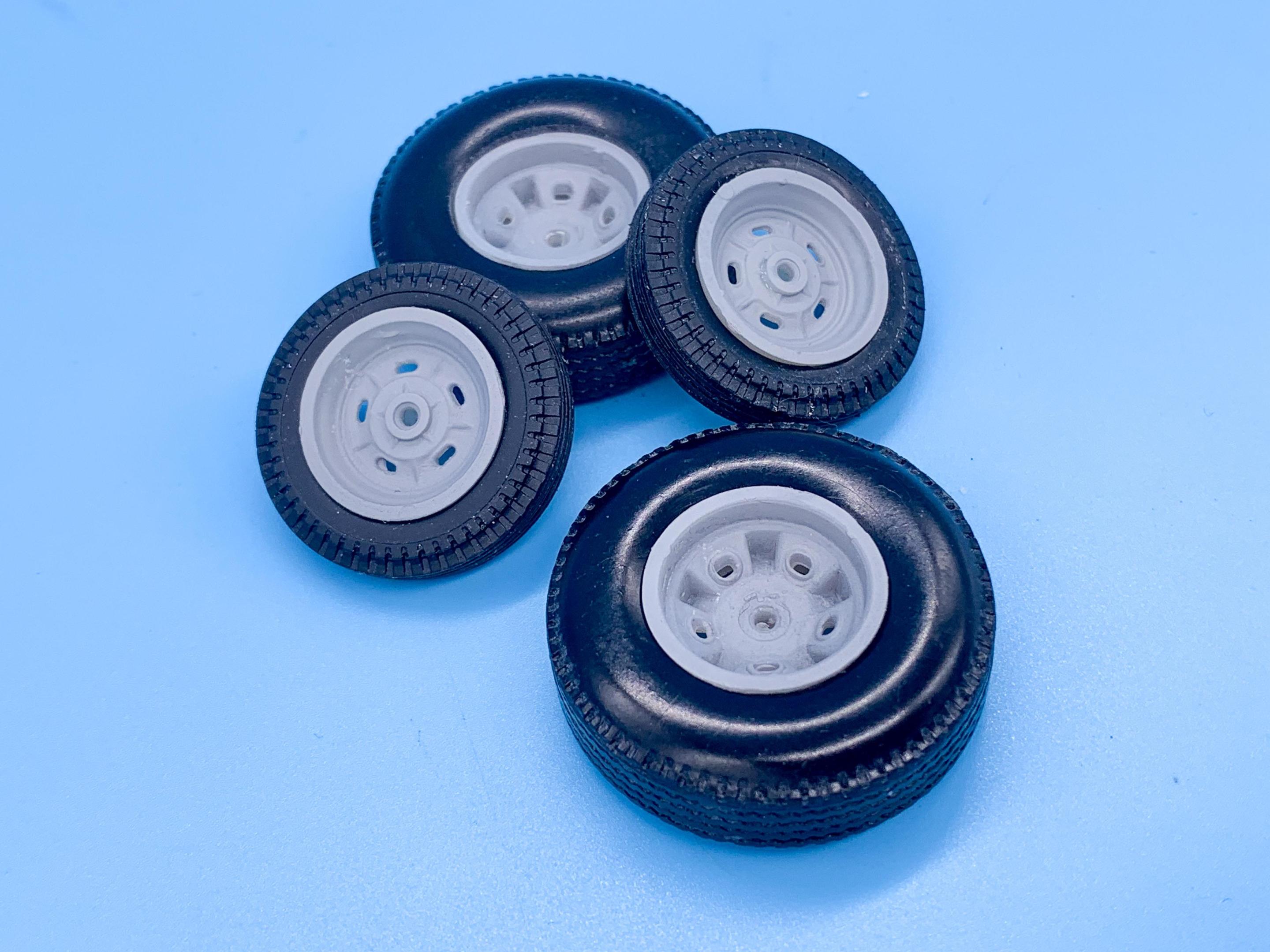

Also found in my fun new box of Atlantis goodies was these cool reverse Halibrand (I think?) wheels:
I had to machine out the centers of my rears to open them up some, and I curiously wondered if the front dirt-track tires from the Revell Model A kits would fit too…turns out they perfect for these wheels!  May end up running those…. The wheels will need a little cleanup and detailing before paint but as my one buddy on Instagram pointed out, these are a better match to that big 427 than the artillery wheels were anyway.

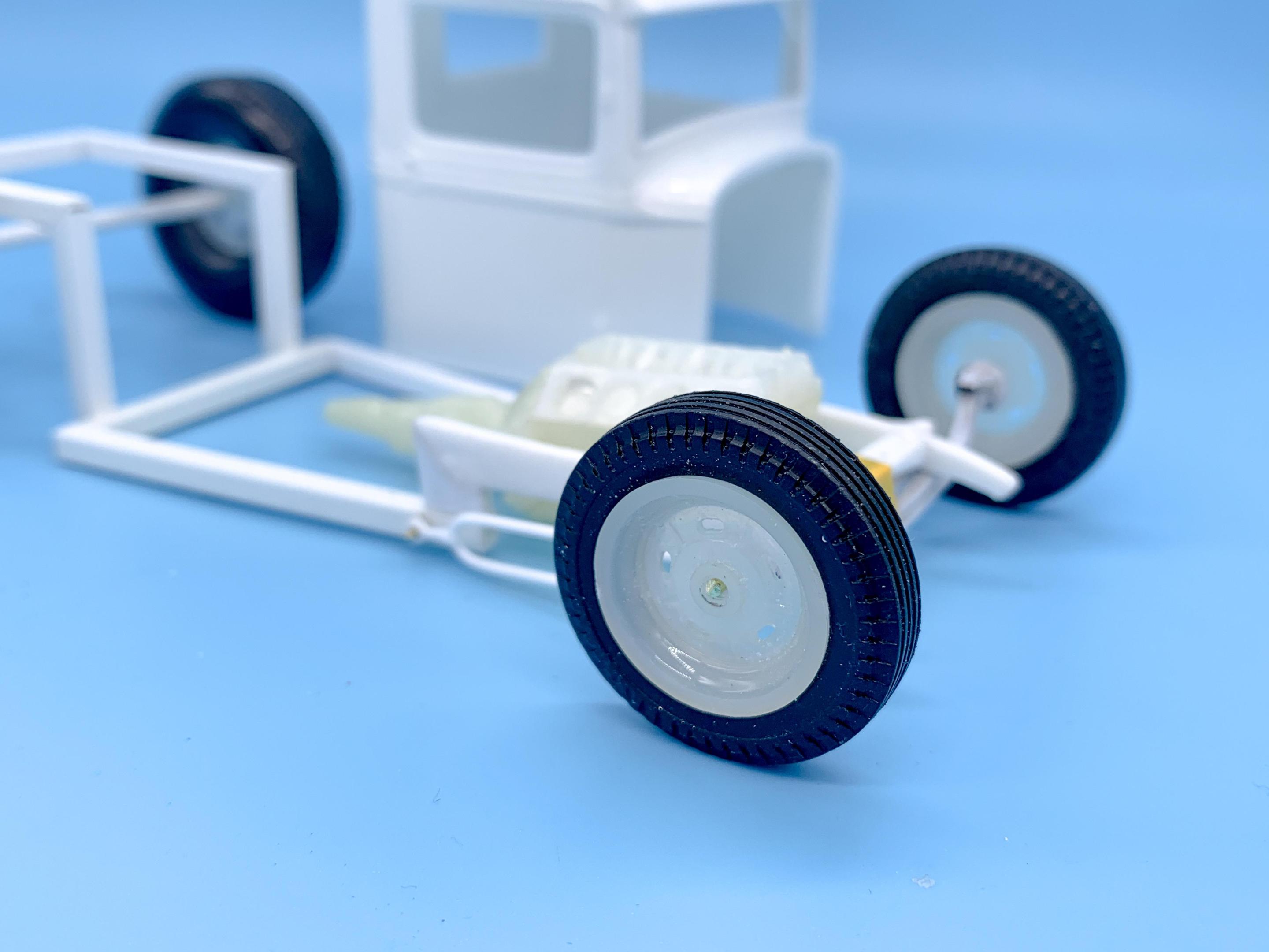

Everything is looking nice Jim.  Looks like its going to be nice and low.  How do you get those good looking 45 degree cuts on the frame?
  • Like 1
Just one of these cheapo mitre boxes, nothing fancy:

A little more progress today - starting to piece together a rear end so I can mock this thing up on it’s wheels and see if I’m getting the nice low stance I was going for…
I had a cool, but simplified, Quickchange center in my parts box and scratchbuilt an axle around that, suspended on a spare Boot Hill Express rear spring (which I think is meant to be a stock Model A spring maybe?)
Ill do some more work on the rear end, and I need to fabricate some linkages next, but it’s starting to look like a frame now!

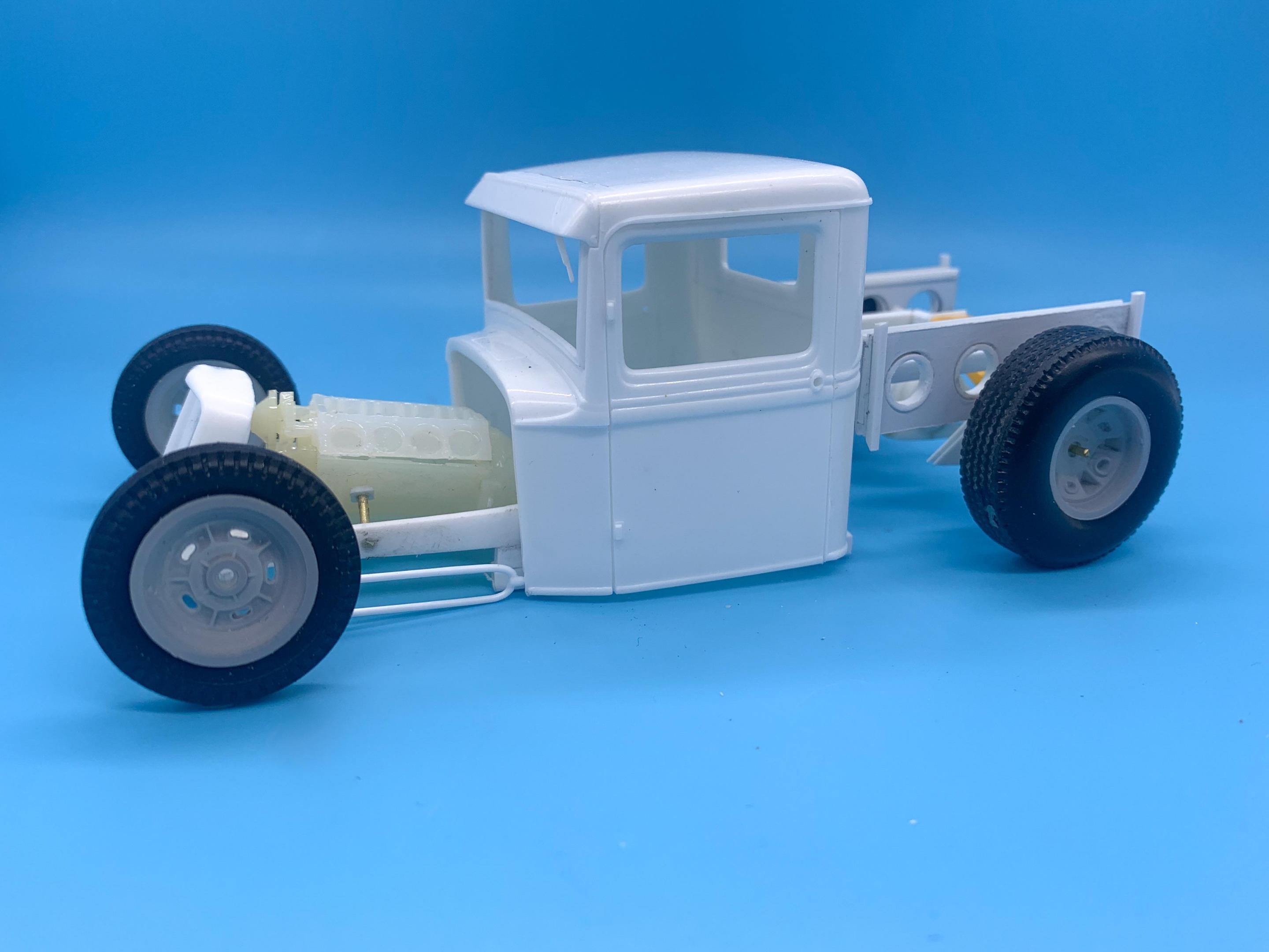

Quick mock-up on the bench to see if it’s about where I’d like it to be:
Plenty still to do, but now I know where the rear end needs to be I can figure out where the motor will live and make some motor mounts.

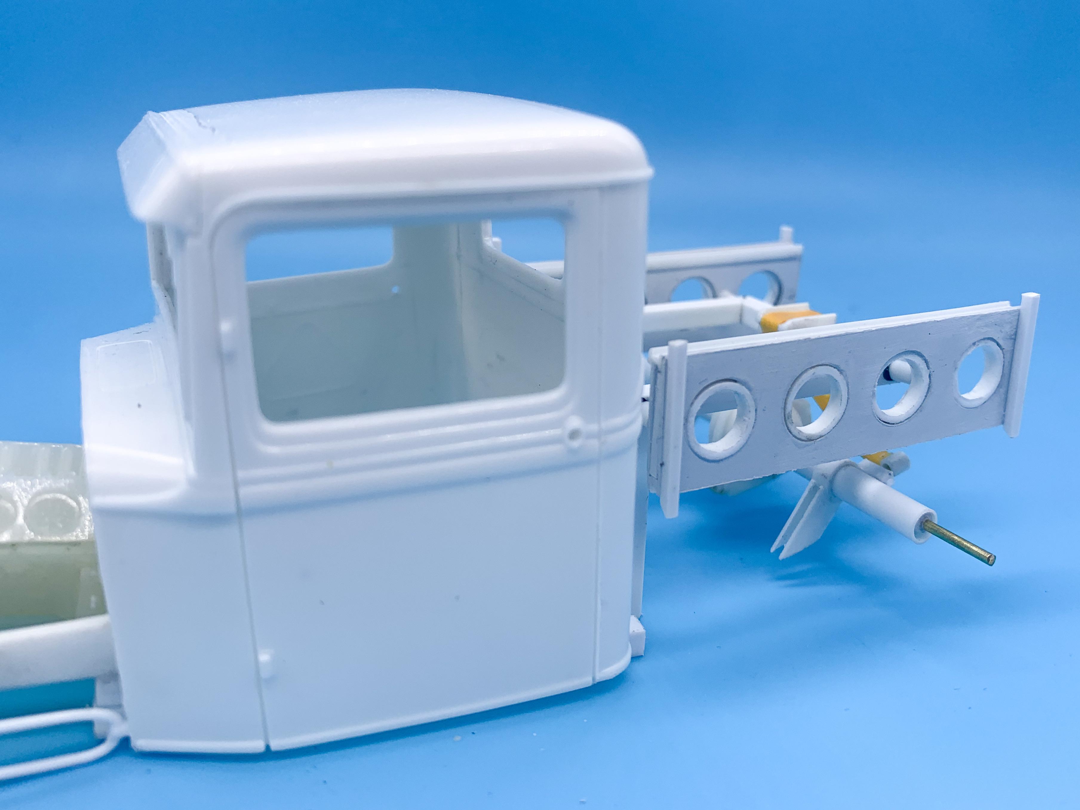

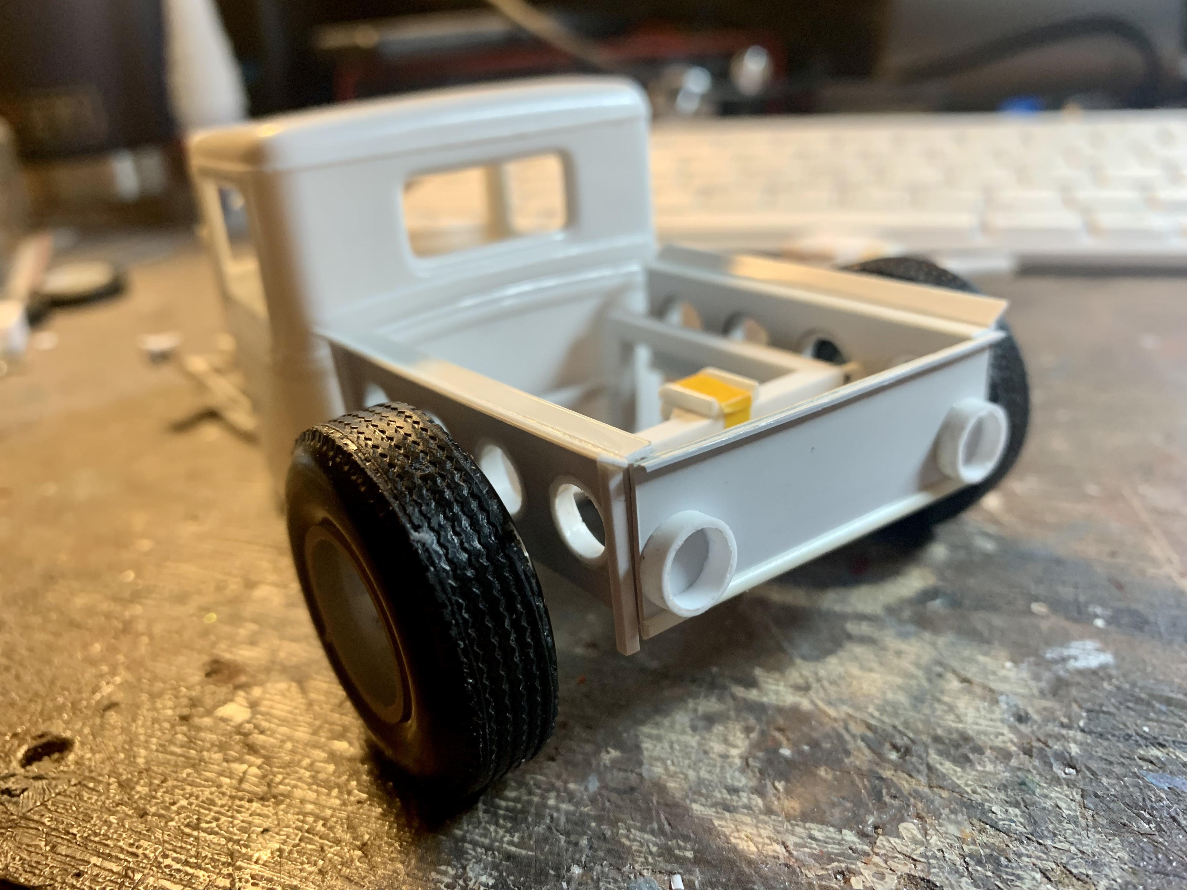

A little more progress on this one - been working on the ‘bed’ this week.  As I mentioned before, the bed won’t really be a bed - just a couple of sides and a tailgate.  Would’ve been simpler just to modify the kit bed and use that, but I wanted to do something that referenced the Roth Mysterion a little (no, I don’t know why either ?)
Made a styrene sandwich with sheet, and styrene tube ‘holes’ for strength to get the approximate look I was going for:
Quick mock-up to:
The bed sides attach to the frame with pins, nothing too complex - and tonight I started messing with the tailgate, with some big ol’ receivers for some nice Mysterion-inspired taillights:
Not sure if the bed will be chrome like the Roth frame that I’m taking as inspiration, but it’ll be bare metal at a minimum.
Plenty to do still in the mock-up stages, but it’s the weekend so I should get a bunch of bench time to keep playing here.  More soon!

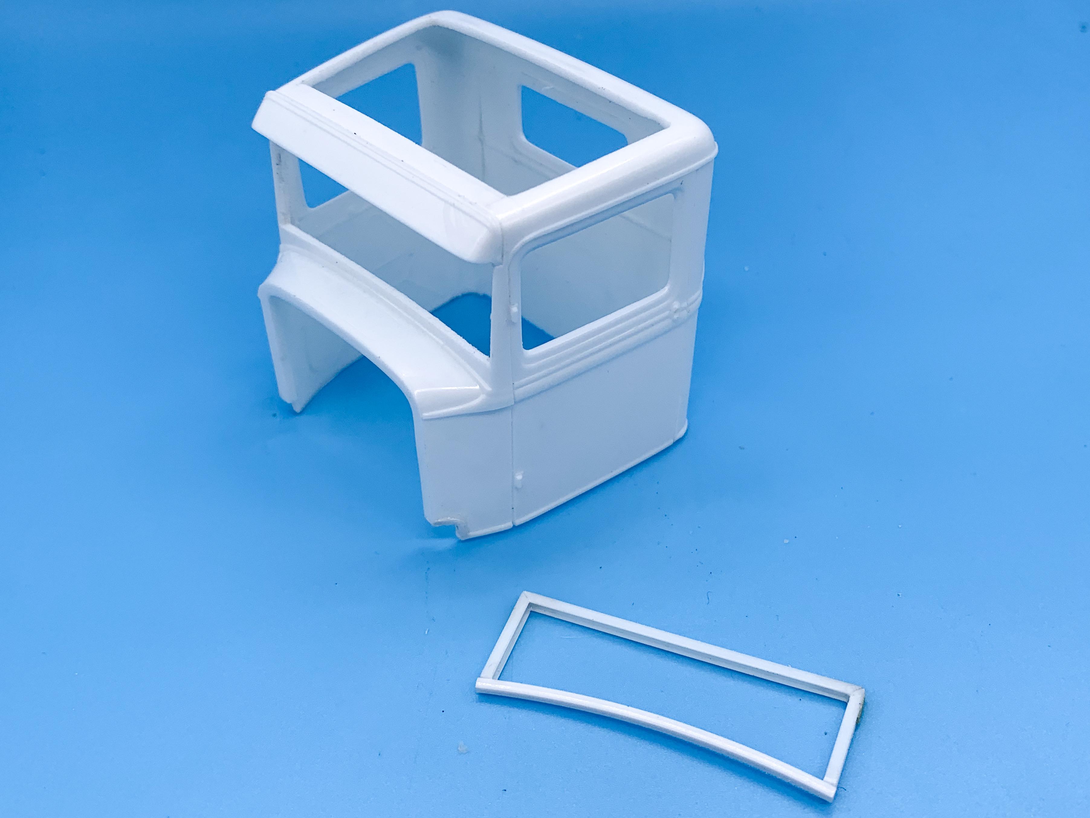

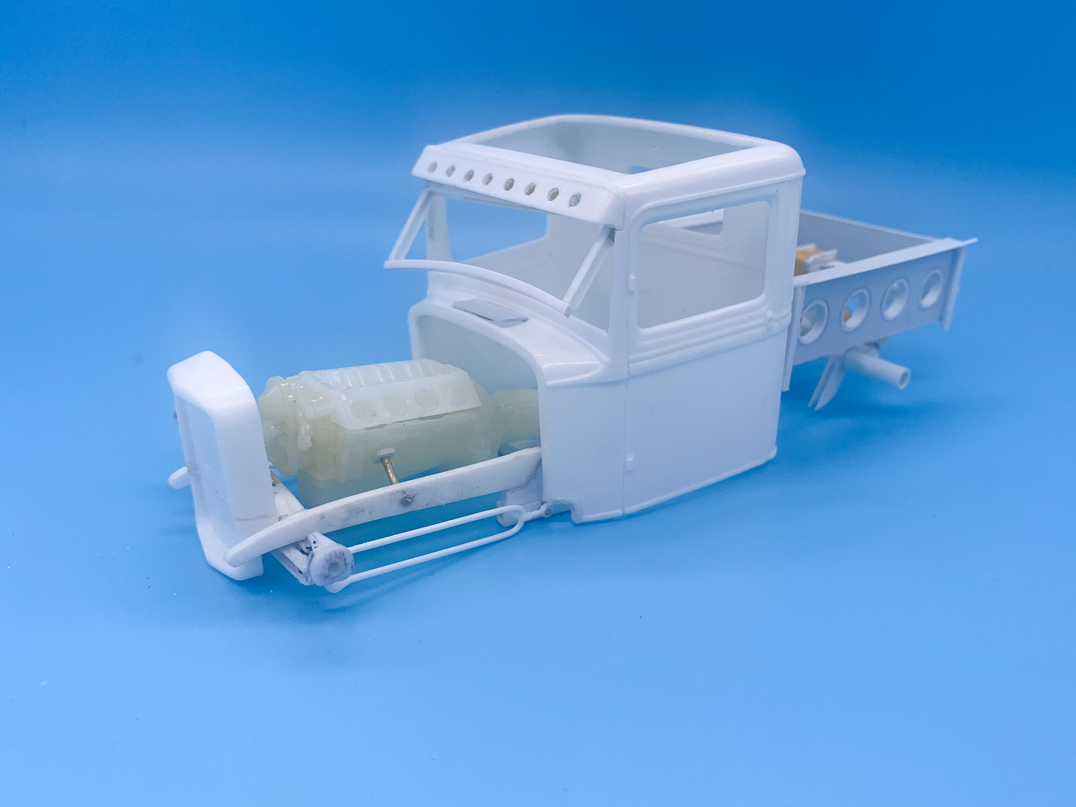

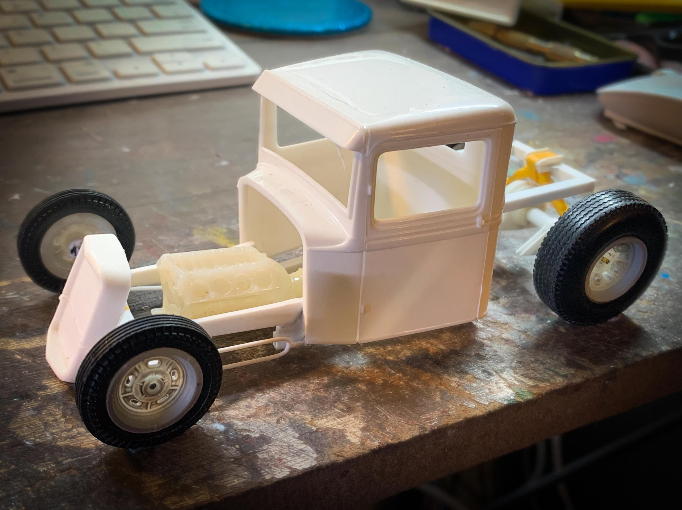

Started work on the cab today - had a few ideas I wanted to go with on this one…
First up, I wanted to open the roof up, and have an opening windshield…cutting a hole in the roof was easy enough but I had to scratchbuild the windshield frame.
That windshield frame is made with styrene channel, except for the curved piece, so that I can install ‘glass’ into it and hide the edges - it was pretty delicate so I cut some thin brass strips to help hold it together.
I also wanted to notch out the front of the cowl for those hairpins - I’ve seen that done on a few 1:1 builds and I figured it would be a fun little detail to add:
Used some styrene bar to rough-in a new trim line - I’ll clean that up when I get to the cleaning-up stage.
Next up, I wanted to open that cowl vent - like the windshield, this will be posed in a slightly-open position when finished:

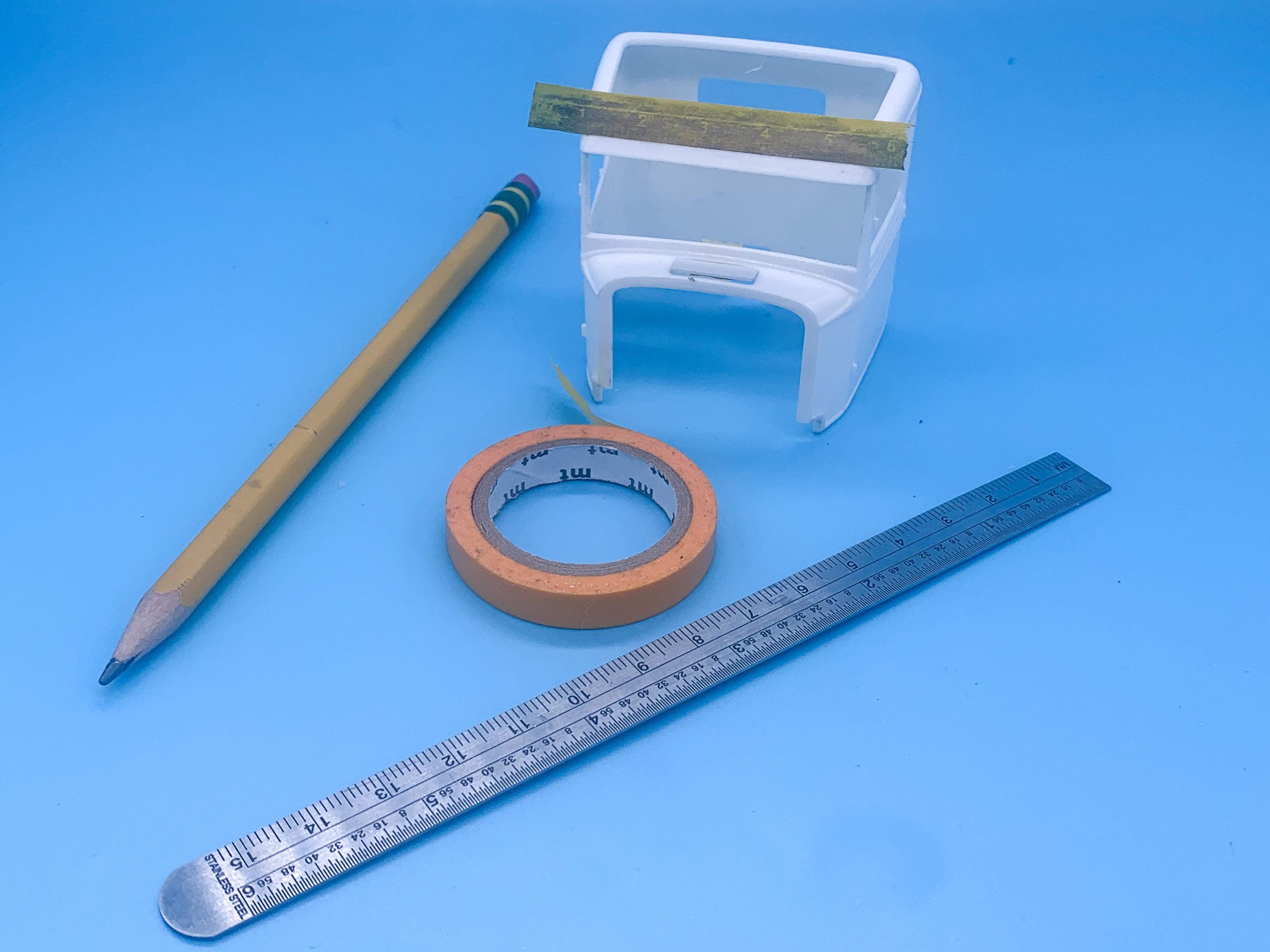

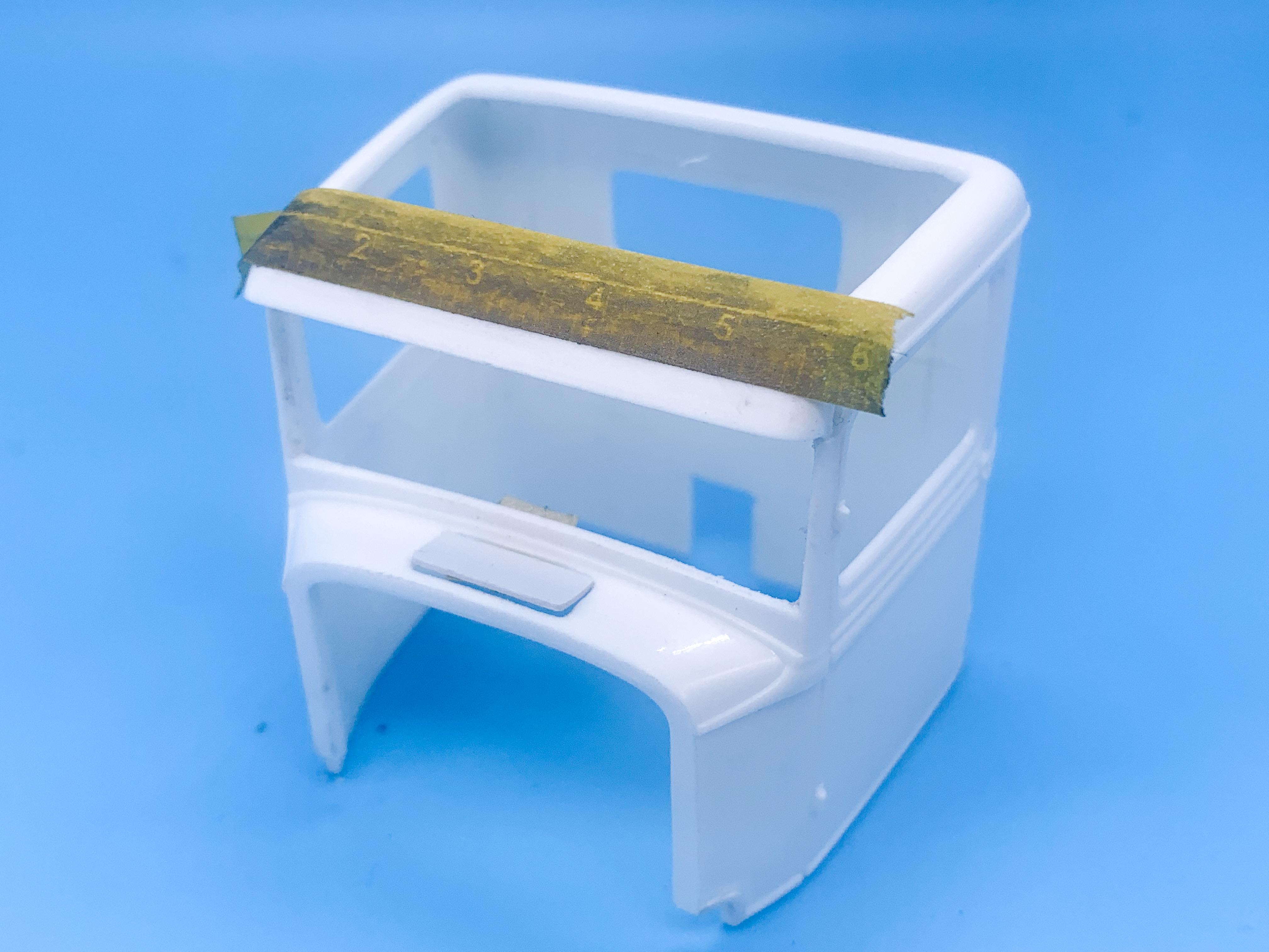

Then, final project for today was drilling out the sunvisor.  A trick I like to use when I’m trying to layout equally spaced holes is to lay some Washi tape down on a steel ruler and use a pencil to transfer the markings to the tape:
Then, you can lay the tape down and reposition it until you’re happy and use it as a guide for the holes…isn’t totally necessary for something flat like this, but it helps getting even measurements on curved surfaces for example:
And this is about how it’s looking now - plenty to do but I’m having fun on the journey!

Looking pretty slick there Jim.  progress it looking killer.  I like your little trick on transferring the steel rule markings to tape.
