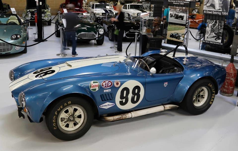

Here’s CSX2431 from the Boulder CO museum.  It’s a 289 but you can clearly see the influence it had on the design of the 427 body.
