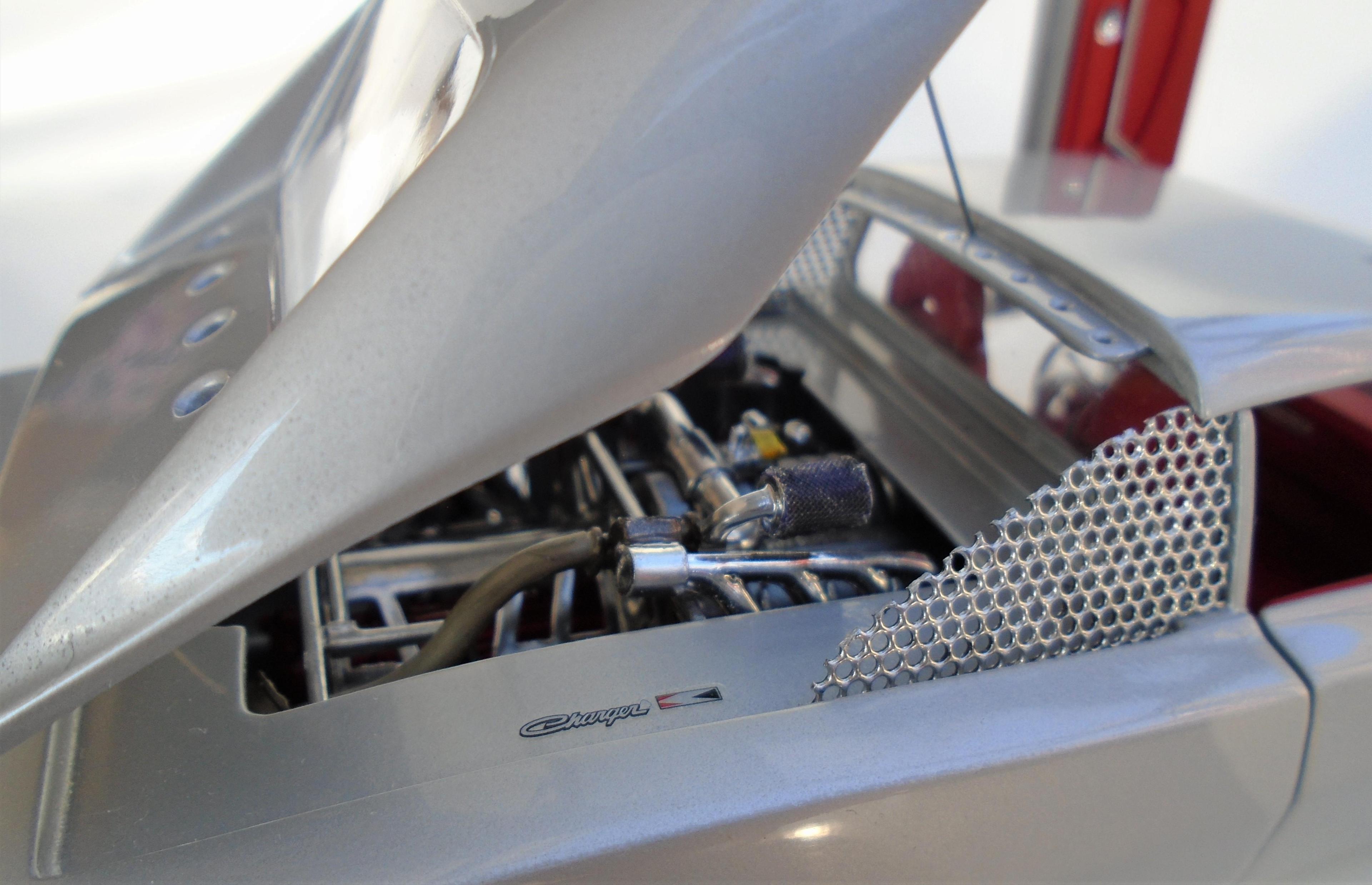

Claude Thibodeau Posted November 13, 2021 Share Posted November 13, 2021 HI! I use the refill of Molotow, shake it very well, pour 2 or 3 drops in a spoon, and apply qith a blunt fine brush. My experience is that you get best results when you really "soak" the part, just a the limit of having it to run, and most important, NEVER go back to do a second stroke on the surface you just applied the Molotow to. If you do, it creates a surface wrinkle, and the smooth even "chrome" look is marred. Let dry a full day, and THEN recoat if needed. The intake cross-tube in this pic is done this way. One coat only. For you to judge. Good luck! CT Quote Link to comment Share on other sites More sharing options...
