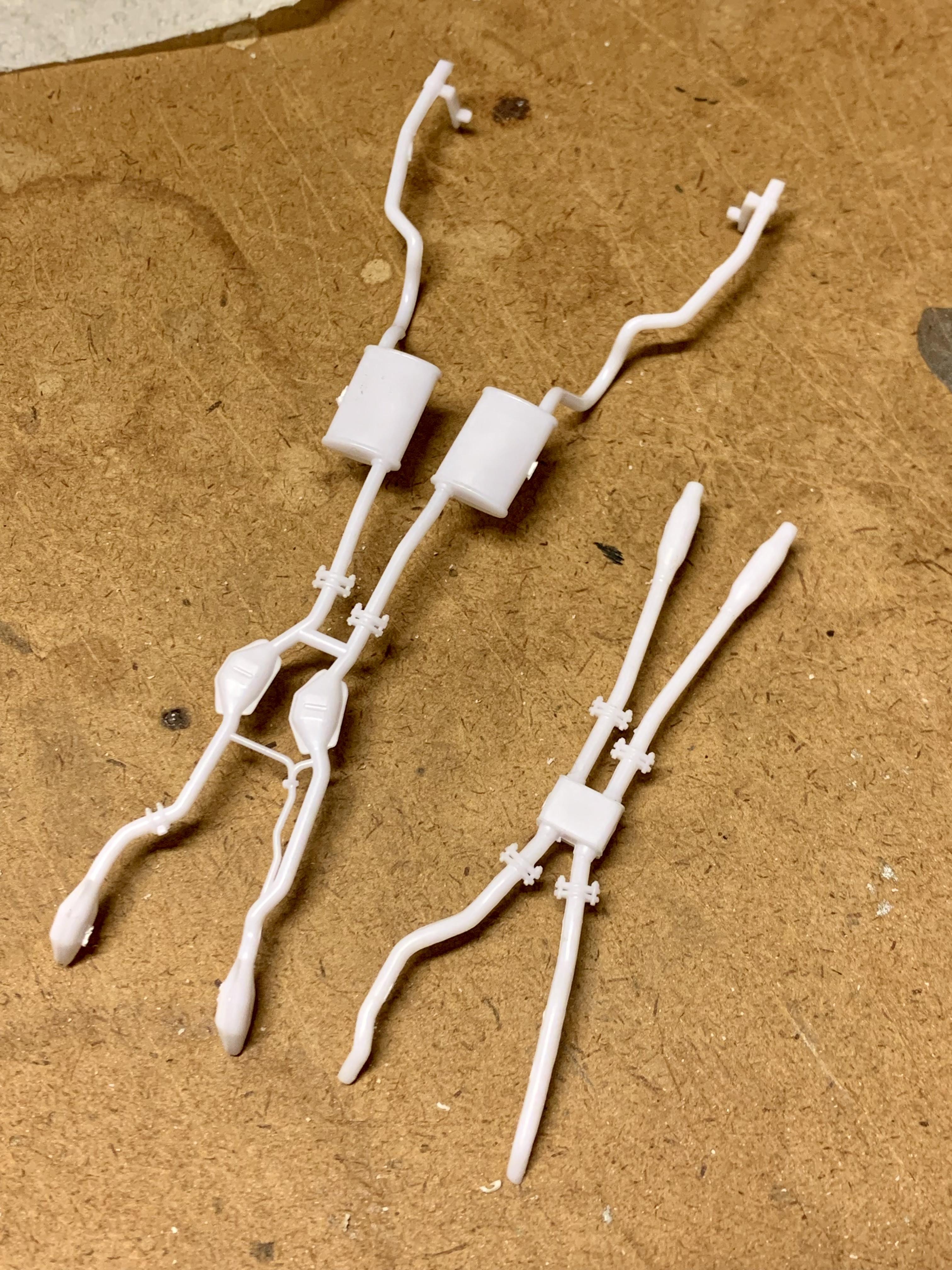

Below is what the kit gives you. On the left is stock system and on the right is the optional drag race system which consists of MAC Pro-Chamber mid section and some bullet style mufflers that are disappointingly simplified. Not even turn down tips behind the mufflers. Hokey! I don’t like the looks of either system, the pipe size looks a little small and wimpy and both would need modifications to mate up with the new SVT Cobra engine and long tube headers.

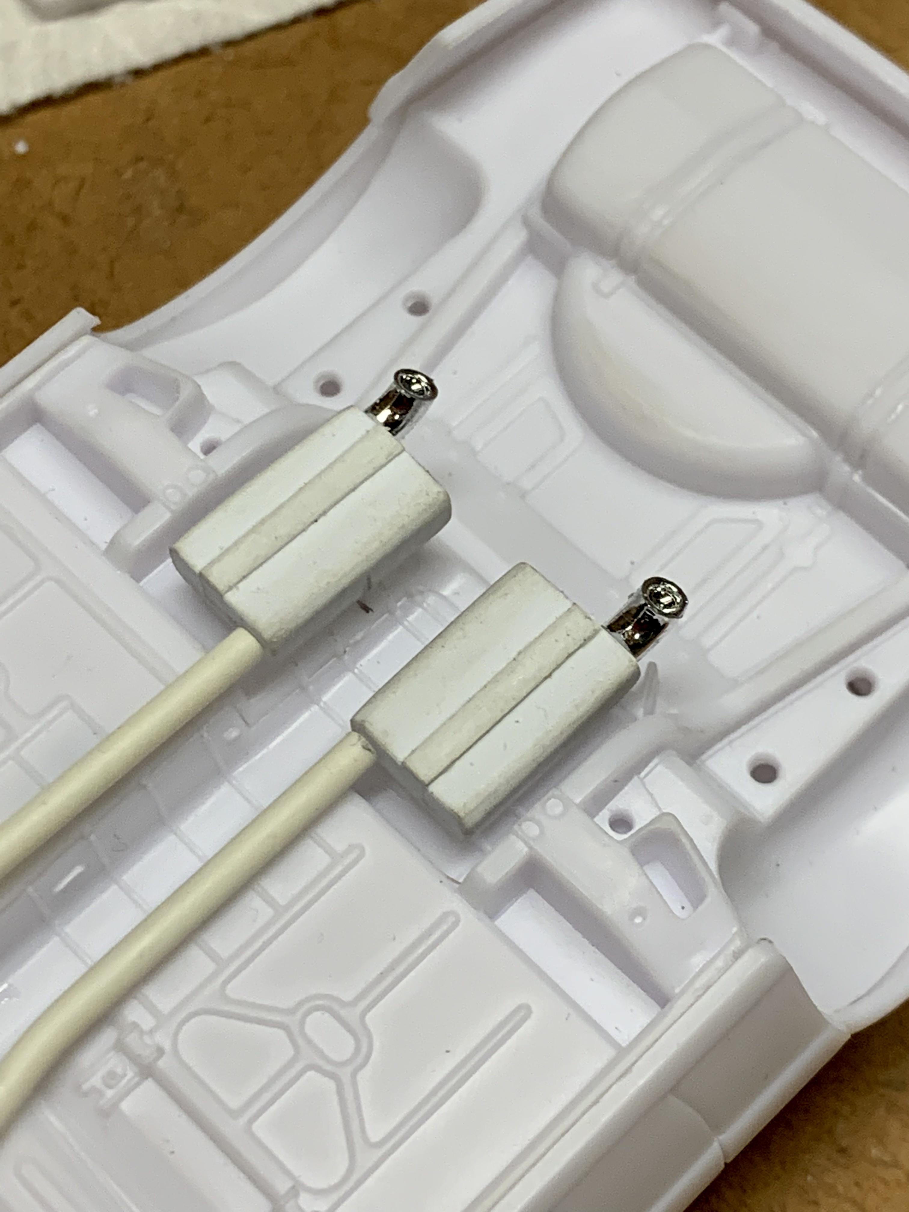

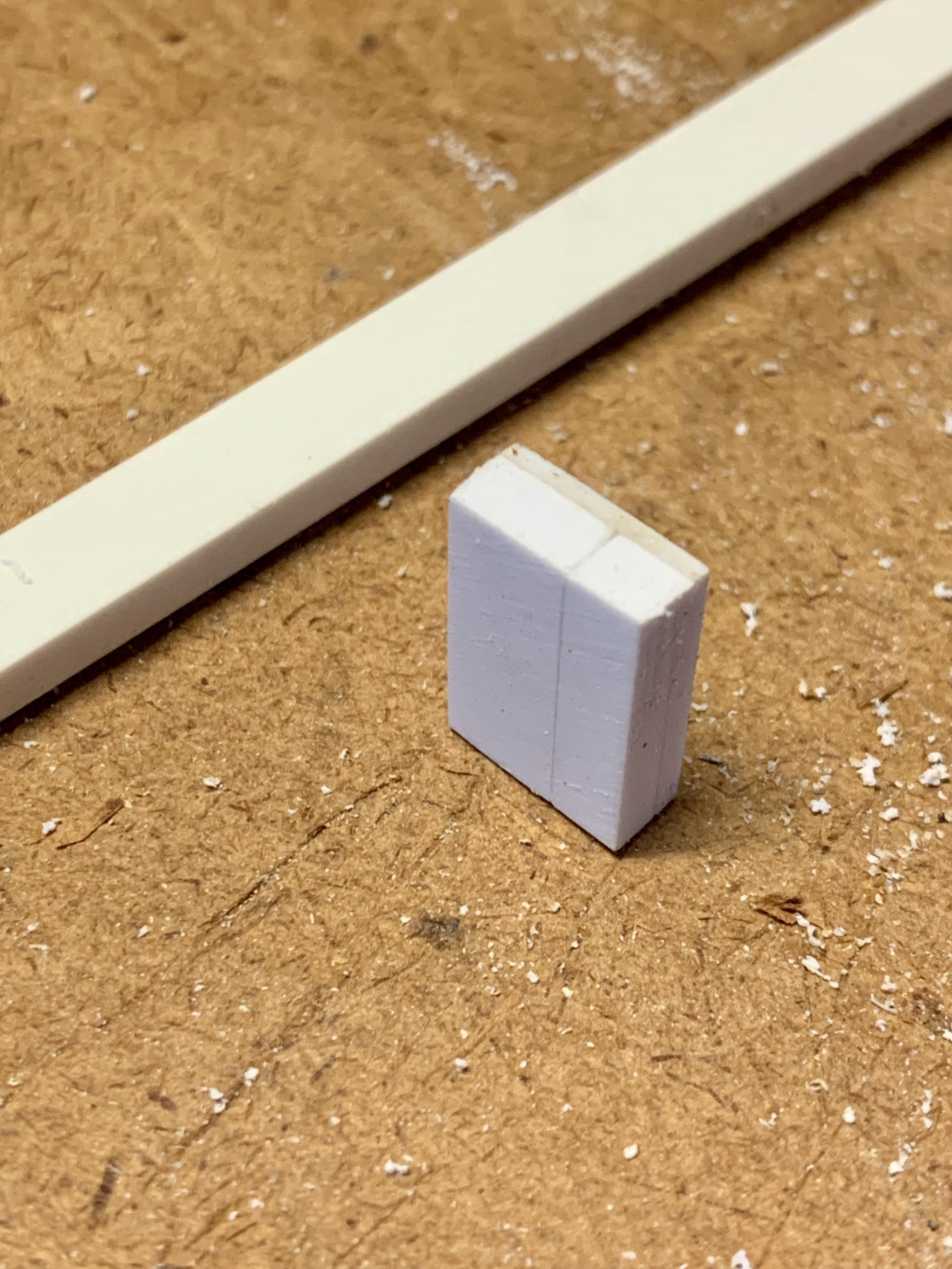

After giving it some serious thought I decided this car needed Flowmaster mufflers like every proper 90’s Mustang. Only catch is that I didn’t have any and I’m not even sure if there are any available in scale? No problem, I’ll make my own! I started with laminating some chunks of plastic together, cut them into the basic dimension, finished shaped them then added the seam strip. A couple of robust looking turn-down tips were made from the ends of the headers found in Revell’s recent reissued ‘29 Roadster or their original issue of the ‘30 Coupe.

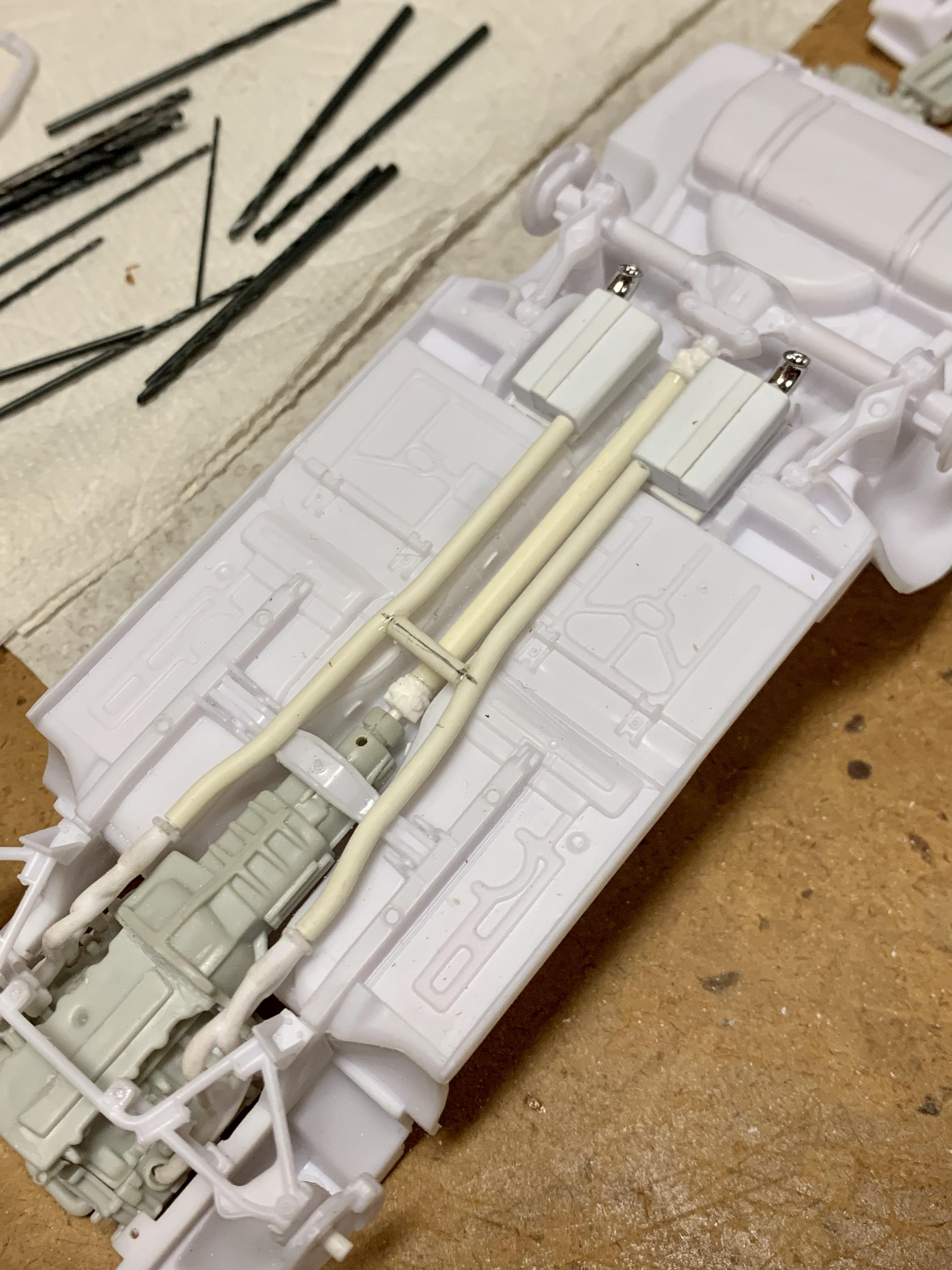

I then made new exhaust pipes from Evergreen 3/32” tubing which is a size bigger than the kit pipes which (IMO) give a much more aggressive appearance. It’s like the difference between stock the 2.25” pipes and proper aftermarket 2.50” pipes on the full scale cars. Once the pipes were fitted I then trimmed a crossover pipe to fit between creating a classic Fox Body Mustang “H-pipe” mid-section. The mufflers have alignment pins which fit into the pipes and the front ends of the pipes were drilled out bigger to fit over the little alignment nipples on the headers. I also made a new driveshaft since the kit piece was now too long. I used larger 1/8” Evergreen tube and heavier U-joints from Revell’s ‘32 Ford kits to replicate the bigger diameter aluminum HD driveshaft that was offered in the old Ford Motorsport SVO caltalogs (and is still available from the current version of the brand, Ford Performance.)
Now the exhaust system can get crossed off the to-do list. Always a big deal! Some people will probably call cop out for not doing full tailpipes but SO MANY of these cars ran dumped Flowmaster’s back in 90’s, one of mine included for a while!

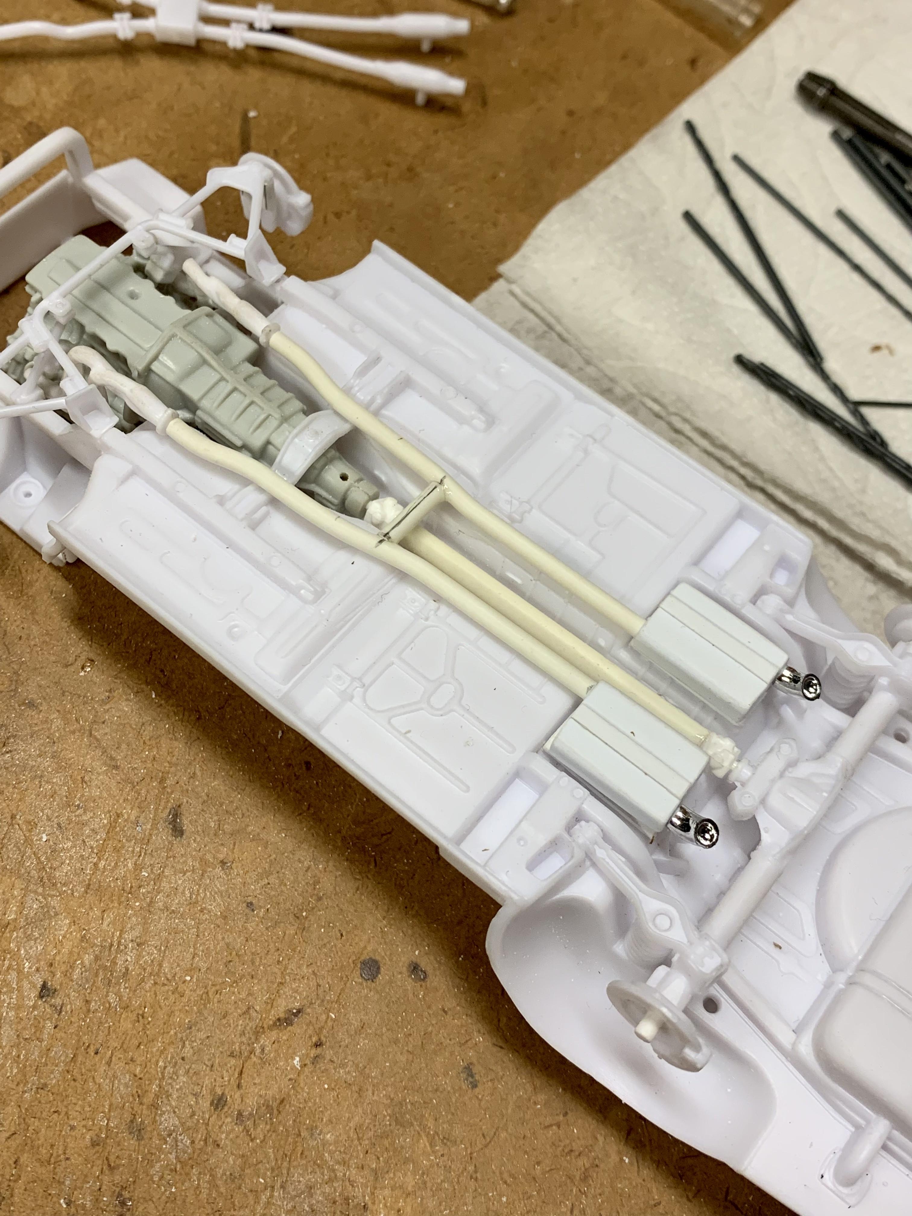

Today was a bit frustrating as I tried to get going back on the LX. As I last worked on it I felt like I had gotten the engine properly located fore & aft which allowed me to make a new driveshaft and exhaust system. As I started trying to work with the project today I decided that I would also like to add a locating pin to align the transmission with its cross member but I just couldn’t get the engine positioning to cooperate like before requiring the rework of the motor mounts that I had added to the pads on the tubular K-member so that they properly fit into the nooks in the sides of the engine block. Again, not prototypical but it works. The other thing is that it would be tremendously helpful if I could permanently attach the front K-member BUT if I do then the engine can’t be installed with the headers attached nor can the headers be snaked into place if the engine is installed without them. This makes it a challenge to get consistent mock ups and fit checks. Permanently attaching it would also make it a royal pain to paint as it needs to be a different color than the chassis.

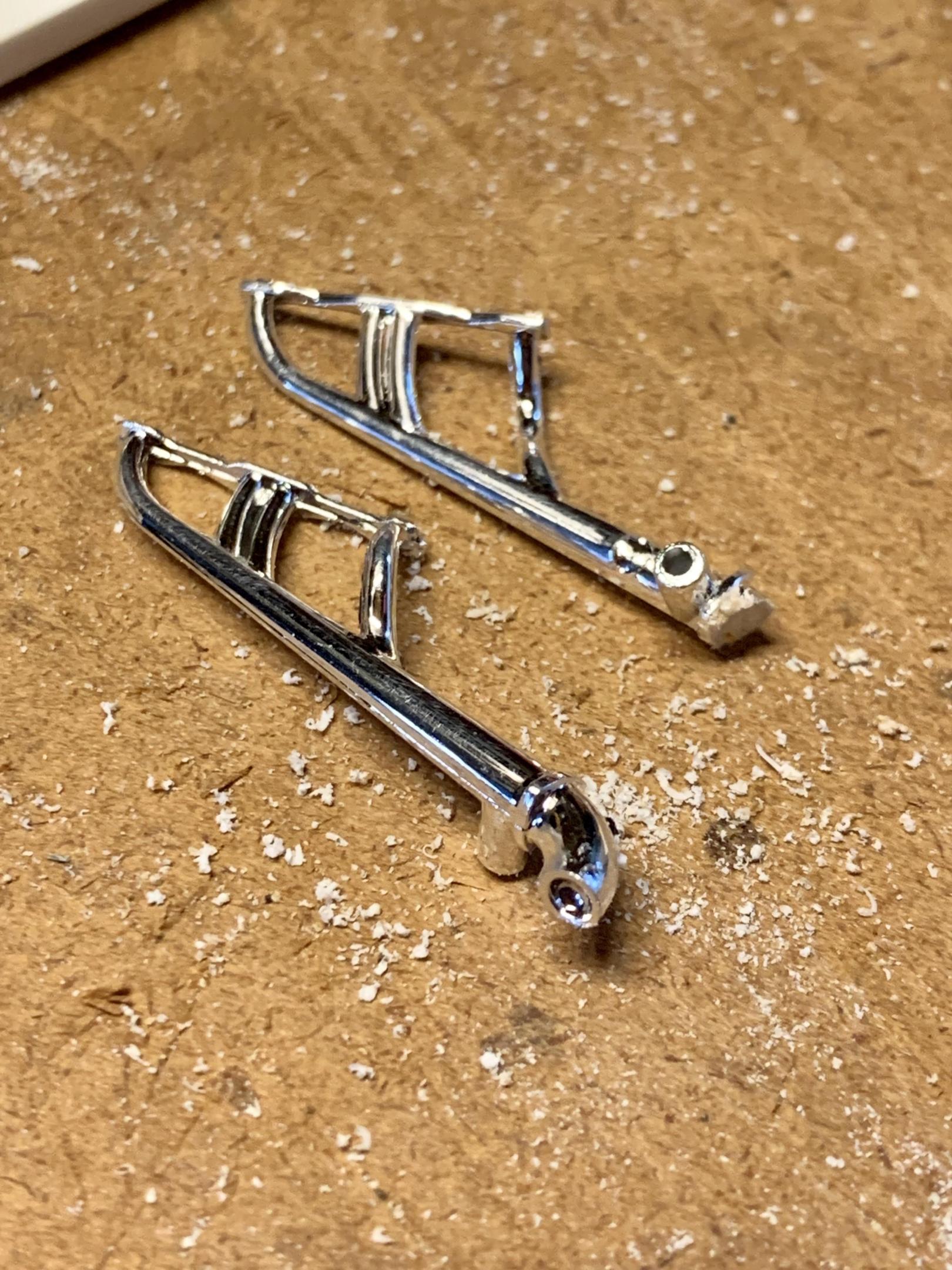

Anyhow, with the engine positioning finalized (for real this time) it’s now 3/32” forward of previous so that meant building a new, longer driveshaft and I added cone extensions to the headers so that the exhaust would hook up. No way I was making those pipes again!

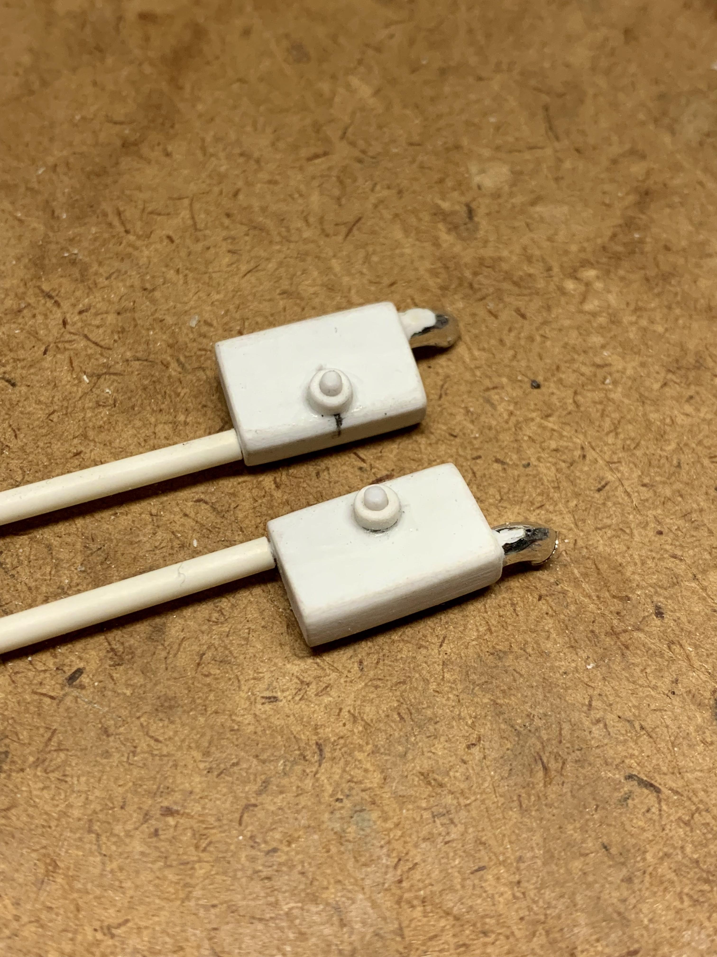

 I still needed to make supports for the mufflers. The kit mufflers have pins on the top sides which fit into holes in the floor. I figured out where to drill and added pins to the new mufflers and slipped sleeves over them to set the muffler off the floor the proper amount. I then filled the holes in the floor and drilled them back smaller to match the size of the muffler pins.

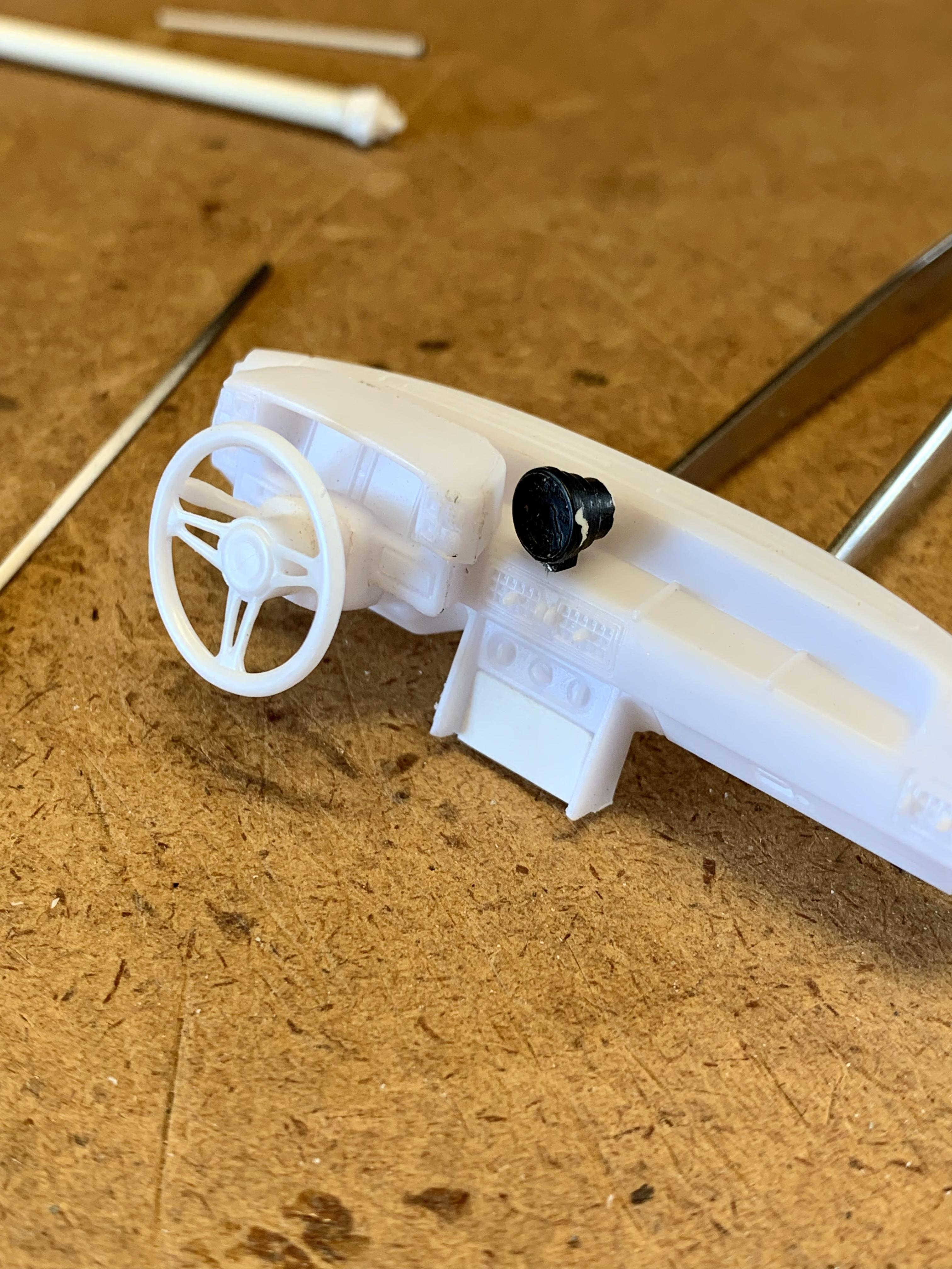

So that, unfortunately, was the big extent of today’s work. Admittedly a good portion of the time was spent in denial before ultimately sucking it up and reworking everything. On a couple of small notes, my pal @Rocking Rodney Rat sent me an Autometer monster tach which I fit to the dash with a pin. I would never put one in any car of mine but love ‘‘em or hate ‘em, thousands of people did in the 90’s. I also found that the electric fan from Revell’s 1948 Ford Convertible is a good fit for the radiator and looks like it would be robust enough to keep such a car cool.
