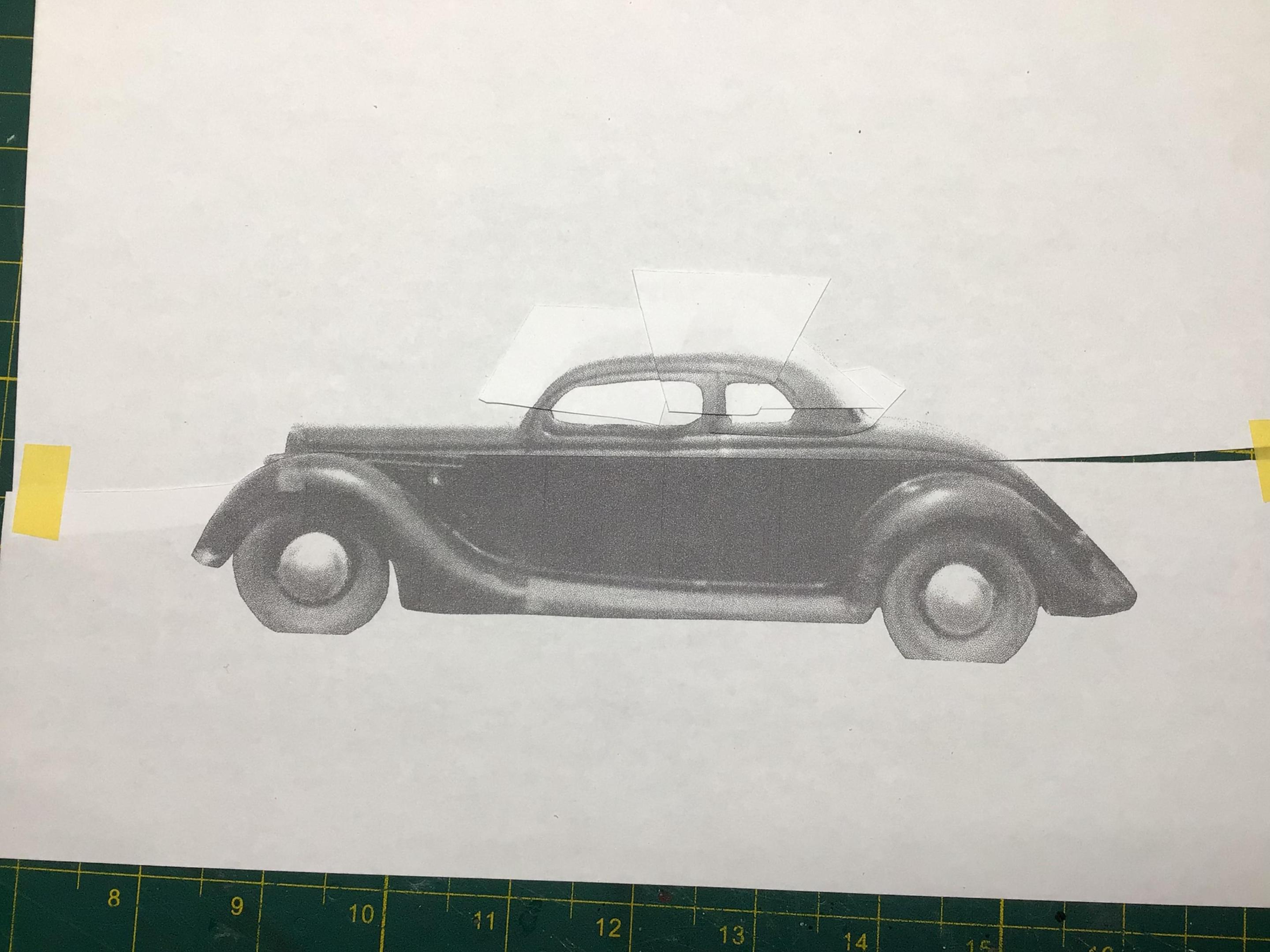

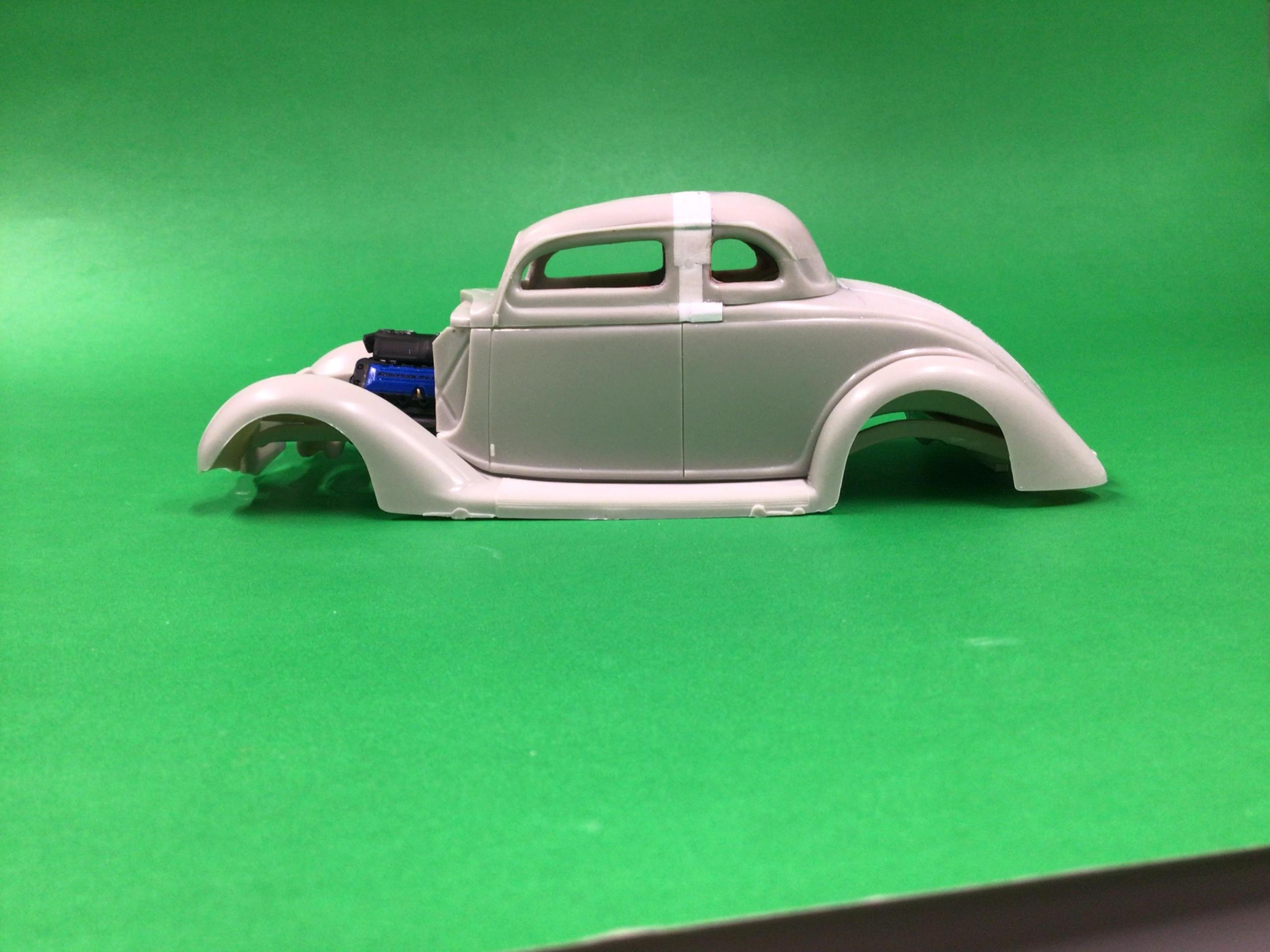

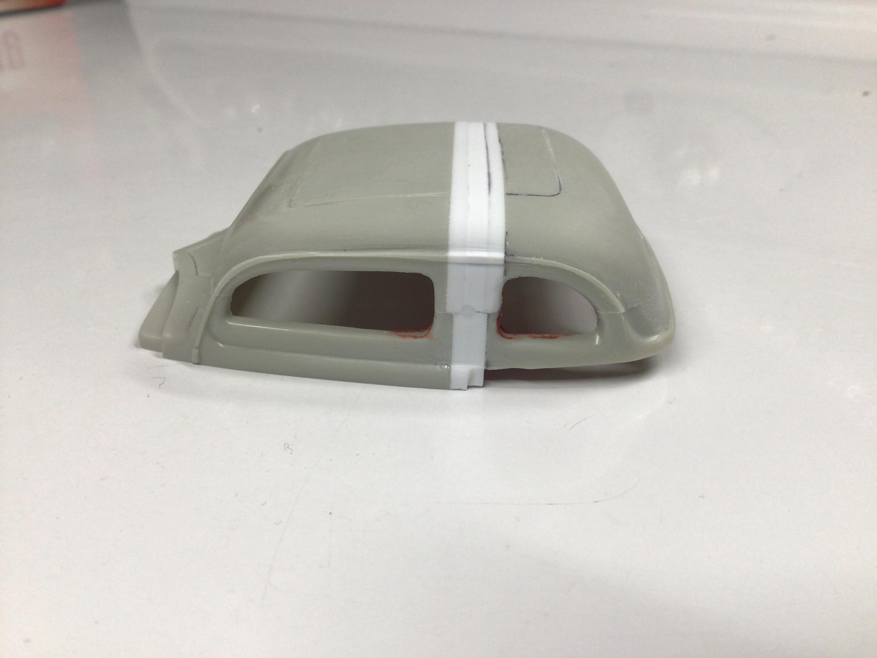

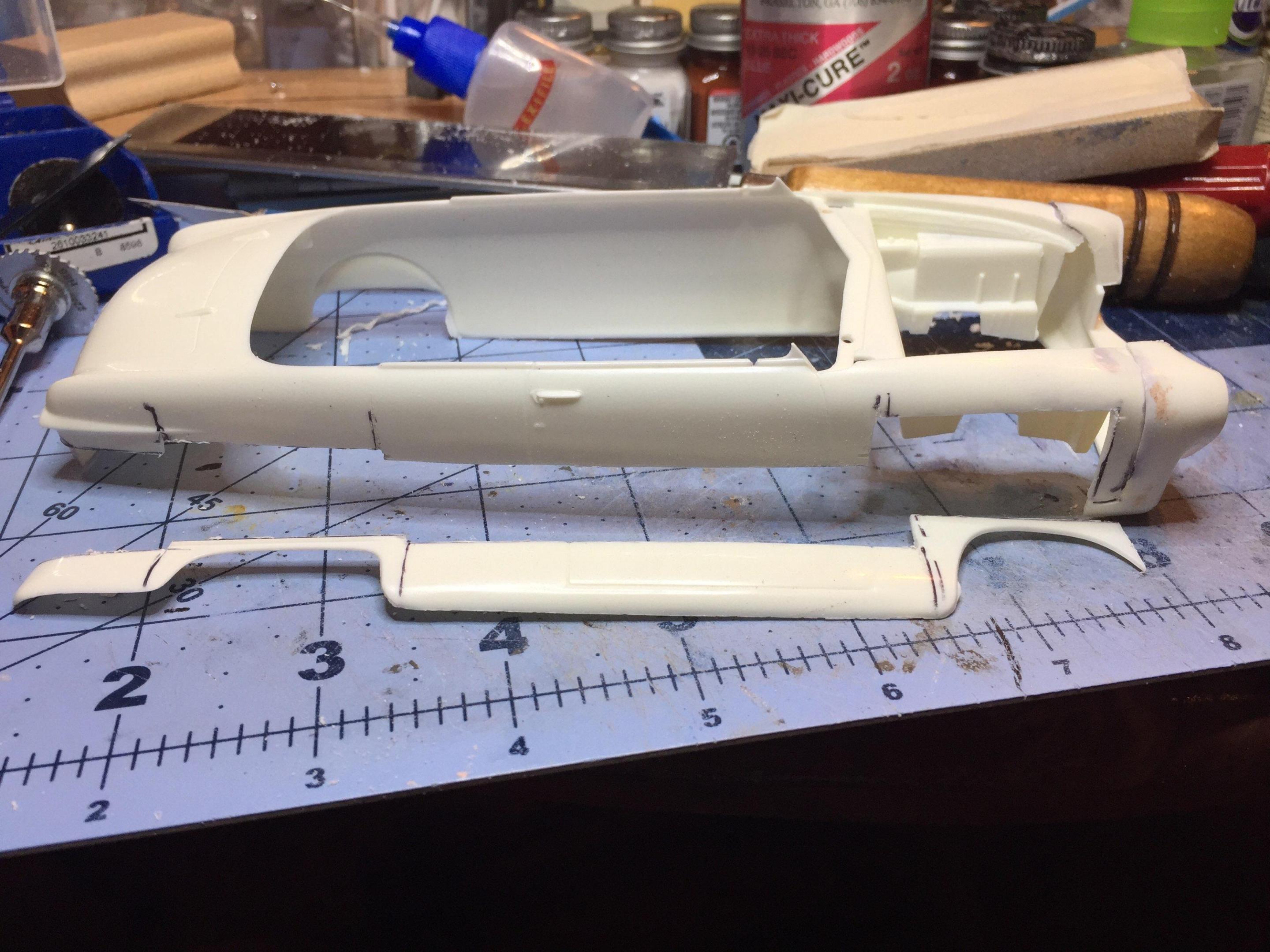

This will be only the second chop I have ever done, and I have a rough idea in my brain of what I want to do with this, but am pretty much making it up as I go along.? I found a pic on the net and did some old school photo-chop to get the approximate look. Any thoughts or input welcome!?BF5D6EB6-6178-41F6-8473-AAA2E80FAC18.thumb.jpeg.668e353f10c5f4d196353ee2654ce2dc.jpeg

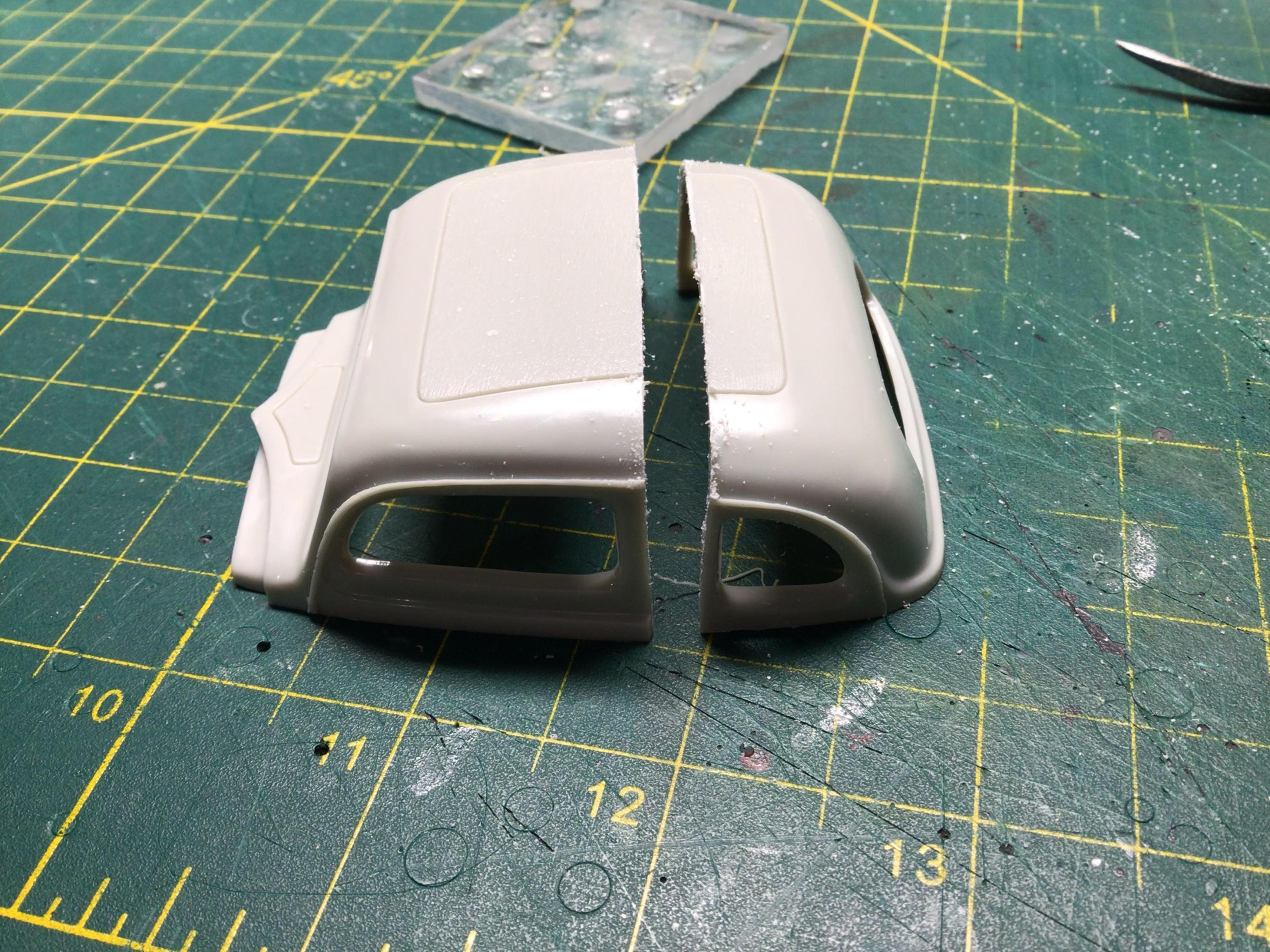

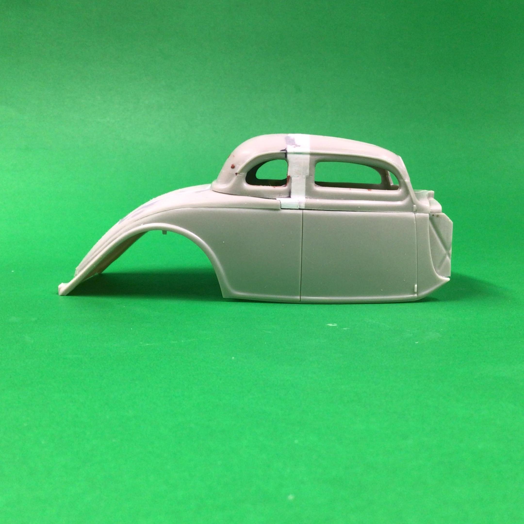

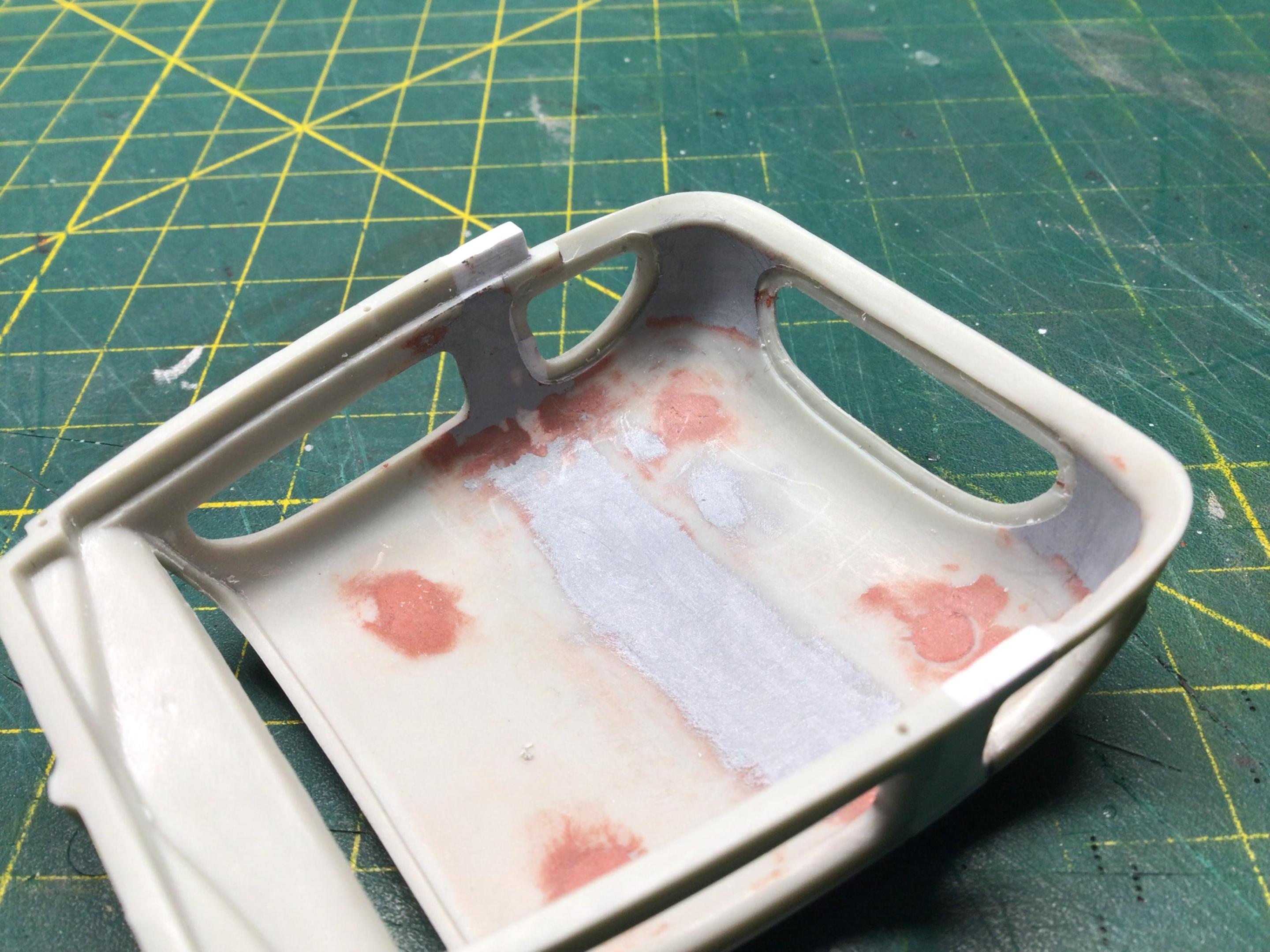

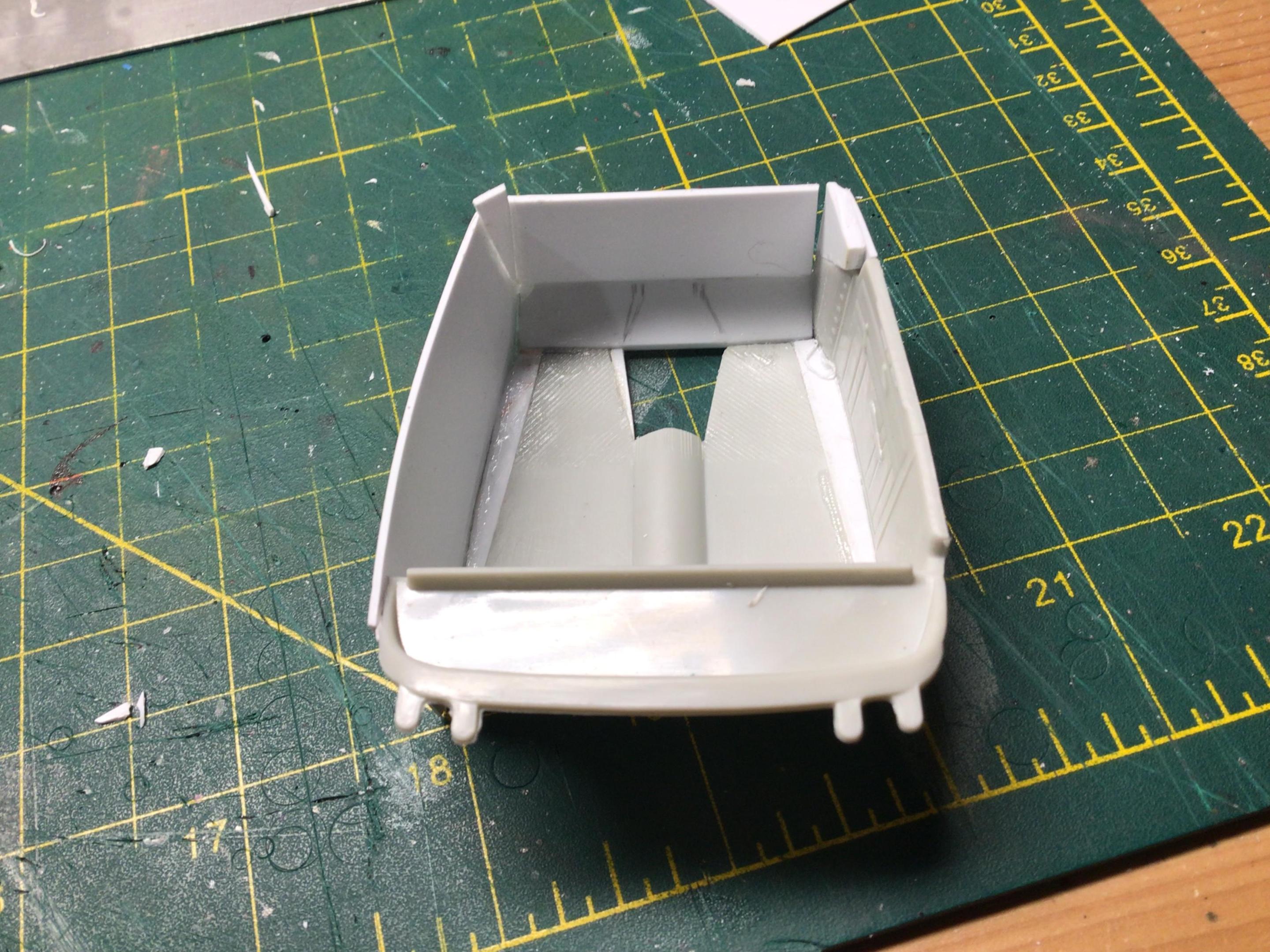

I cut the roof in half and added .080” (2” scale) of styrene to each half.

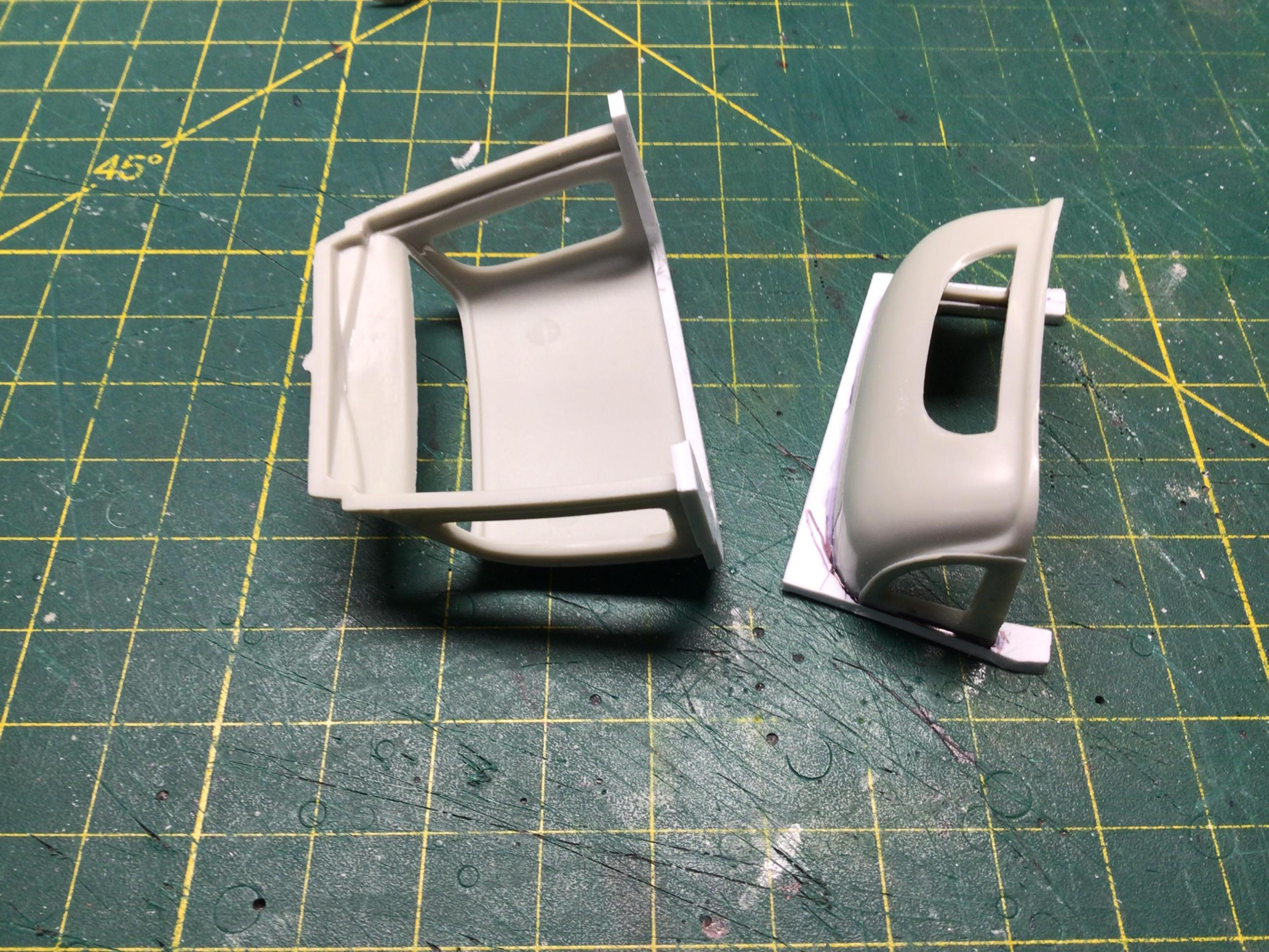

BABE93C5-F583-45DC-A8B8-28956E54C3EE.thumb.jpeg.90a470be5a8f8db1d3c0f24a8e5fcd20.jpeg1AF8629E-C198-46F9-B772-B7EB0D94CEB8.thumb.jpeg.c3c7660434b13e497ca5d07b1c30d712.jpeg

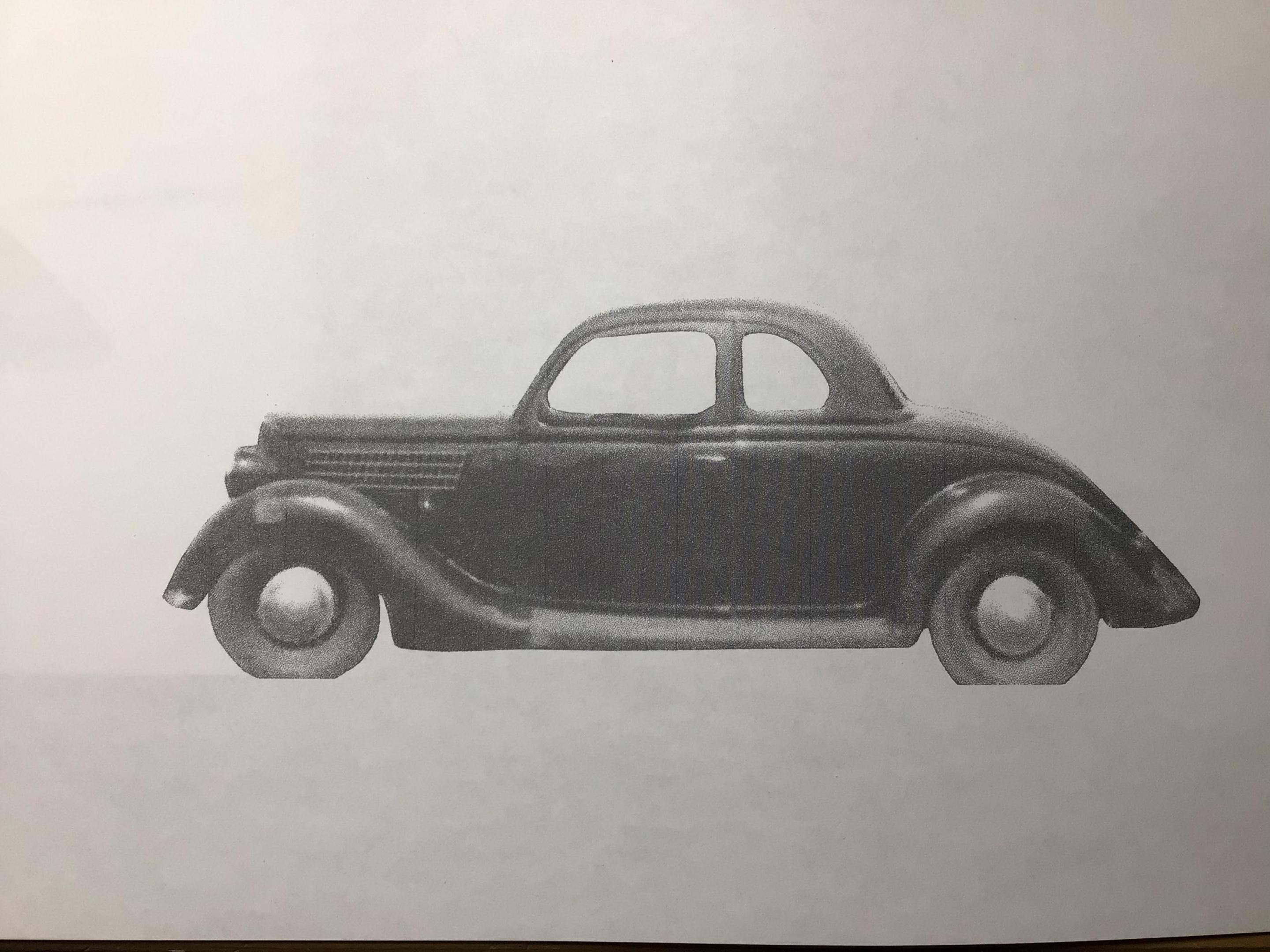

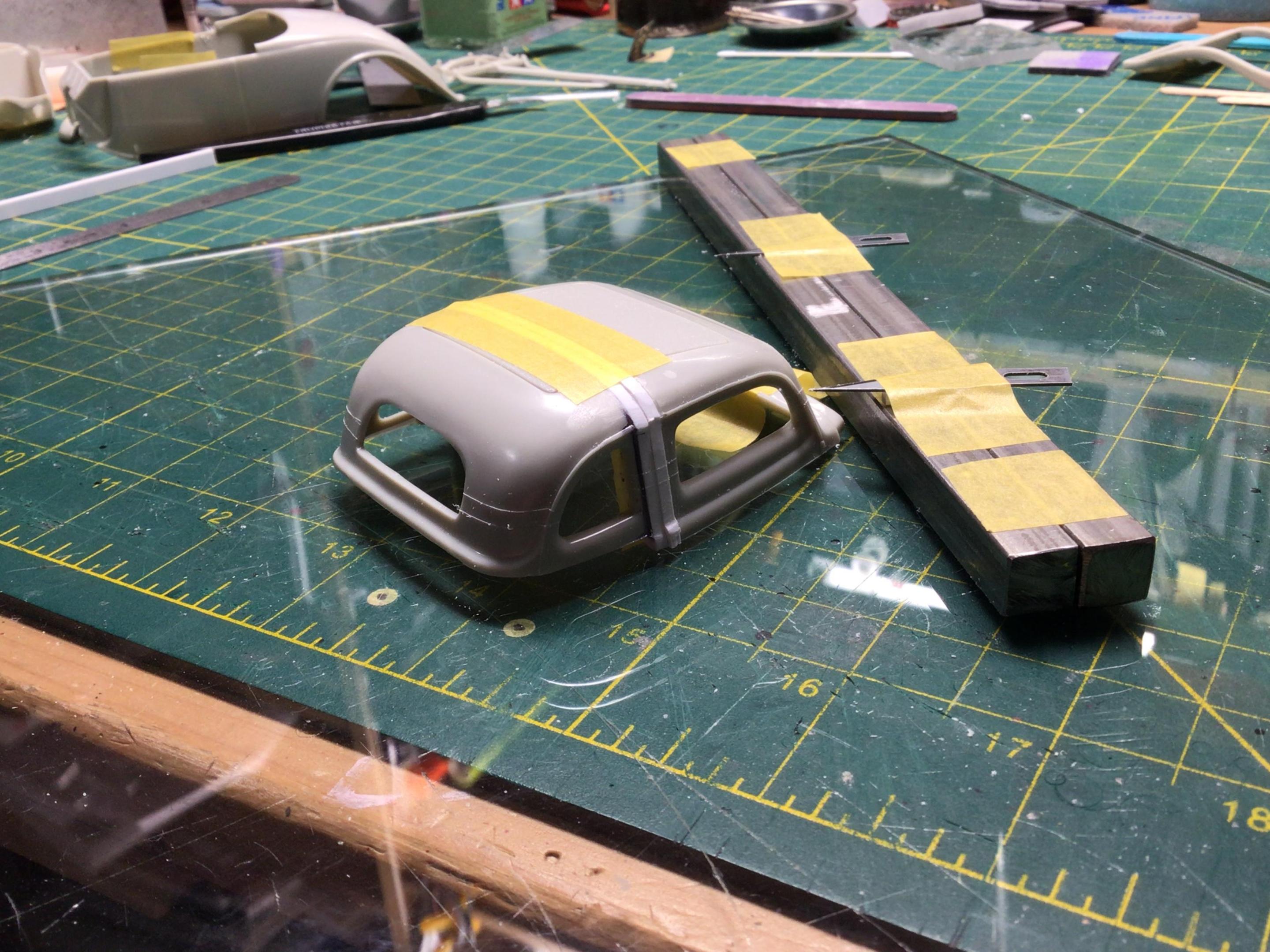

Once they were filed to shape, I chopped them 1/8” (3-1/8” scale)7895686E-68E8-4117-89DD-A973C17CE4B8.thumb.jpeg.dfe1dbcbc4078e9a3cc30cce23ce213a.jpeg

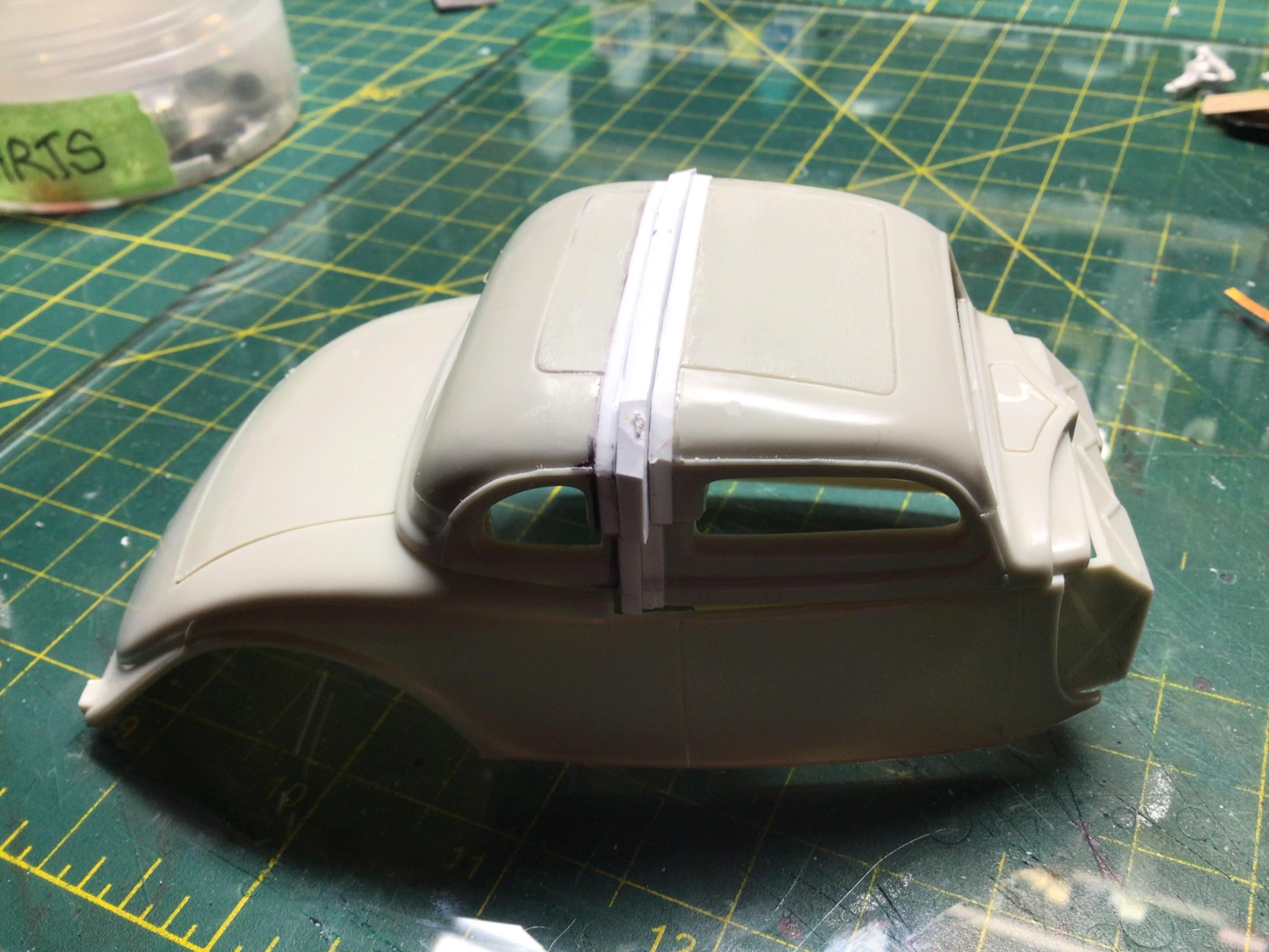

After re-aligning the A and C pillars, I needed another .100” of styrene to fill the gap. This makes a total of 6-1/2” of stretch on the roof.

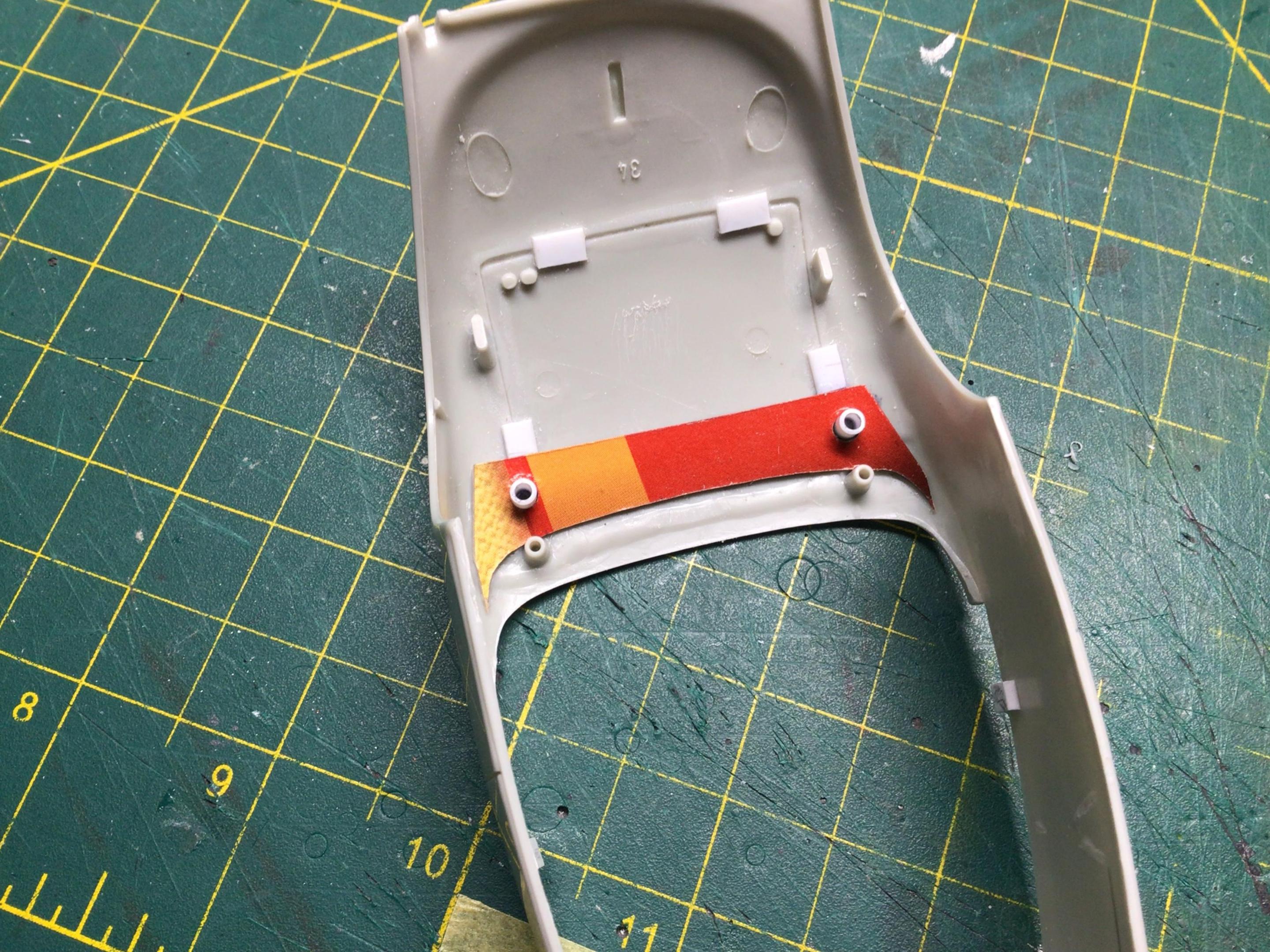

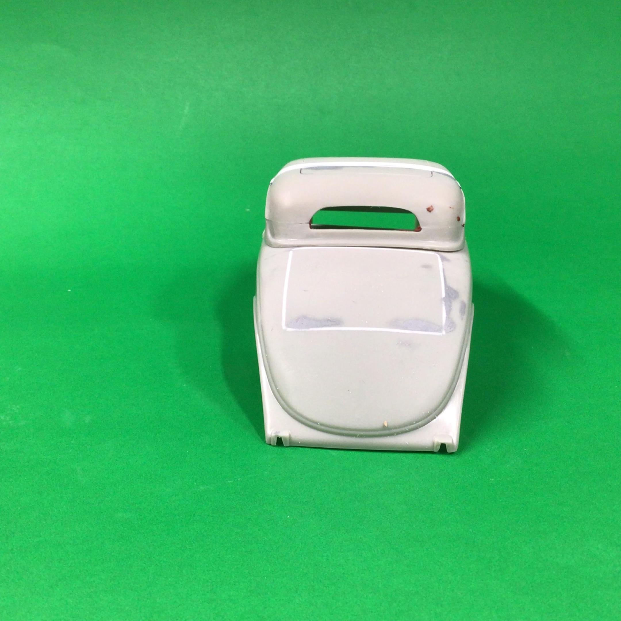

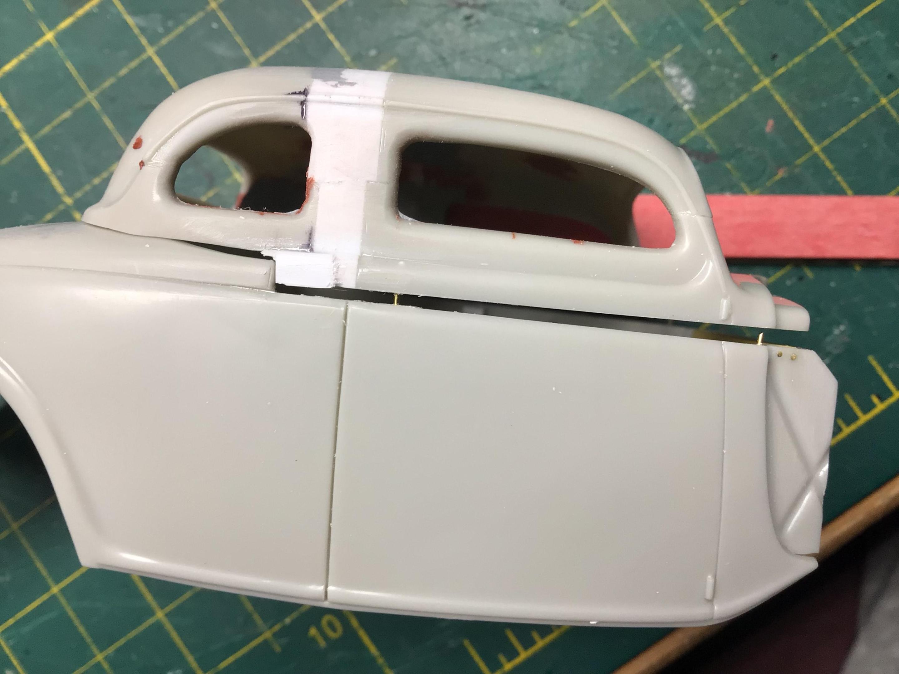

I added some pins to keep everything aligned while glueing the roof to the body. I think I have everything filled and sanded smooth enough to attach the two now.? I used sprue glue for strength to join the roof on the last ‘36 I did, but I think with the pins, I can just use Tamiya thin wherever the fit is tight. And a little medium or thick CA at any slight gaps. Then a bit of putty and more sanding.?

Looks very well planned out. My only thought would be that the B pillar looks a little wider and maybe enlarging the front side of the rear side window may help.
1 hour ago, dino246gt said:
Very cool!
Thanks Dennis!
Thanks David. Yes, I plan to thin out that B pillar, but I want to get the roof glued on and a coat of primer on it first. Then it will be easier to tell how much to enlarge the window. The white styrene filler fools the eyes right now.  Alternately, I could lengthen the door a bit, and enlarge one or both windows slightly?

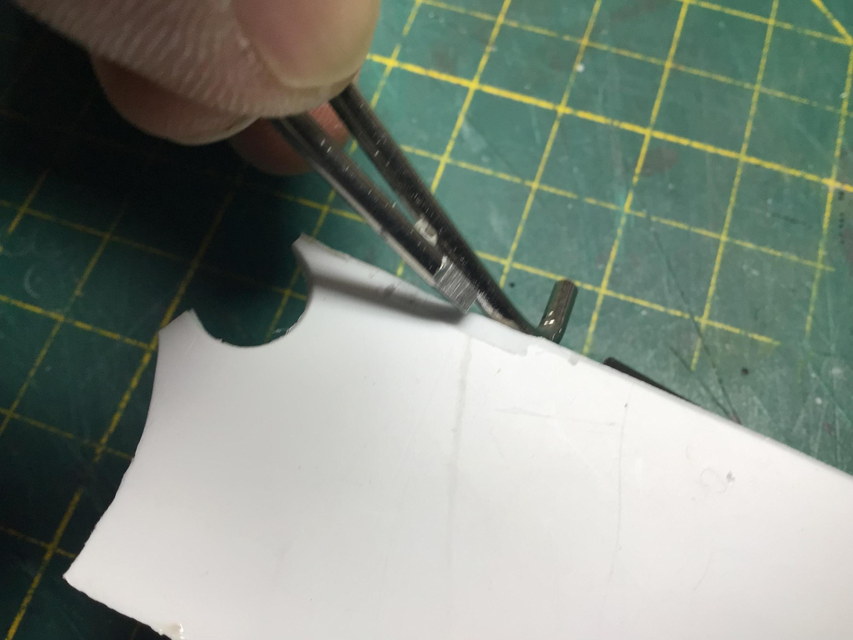

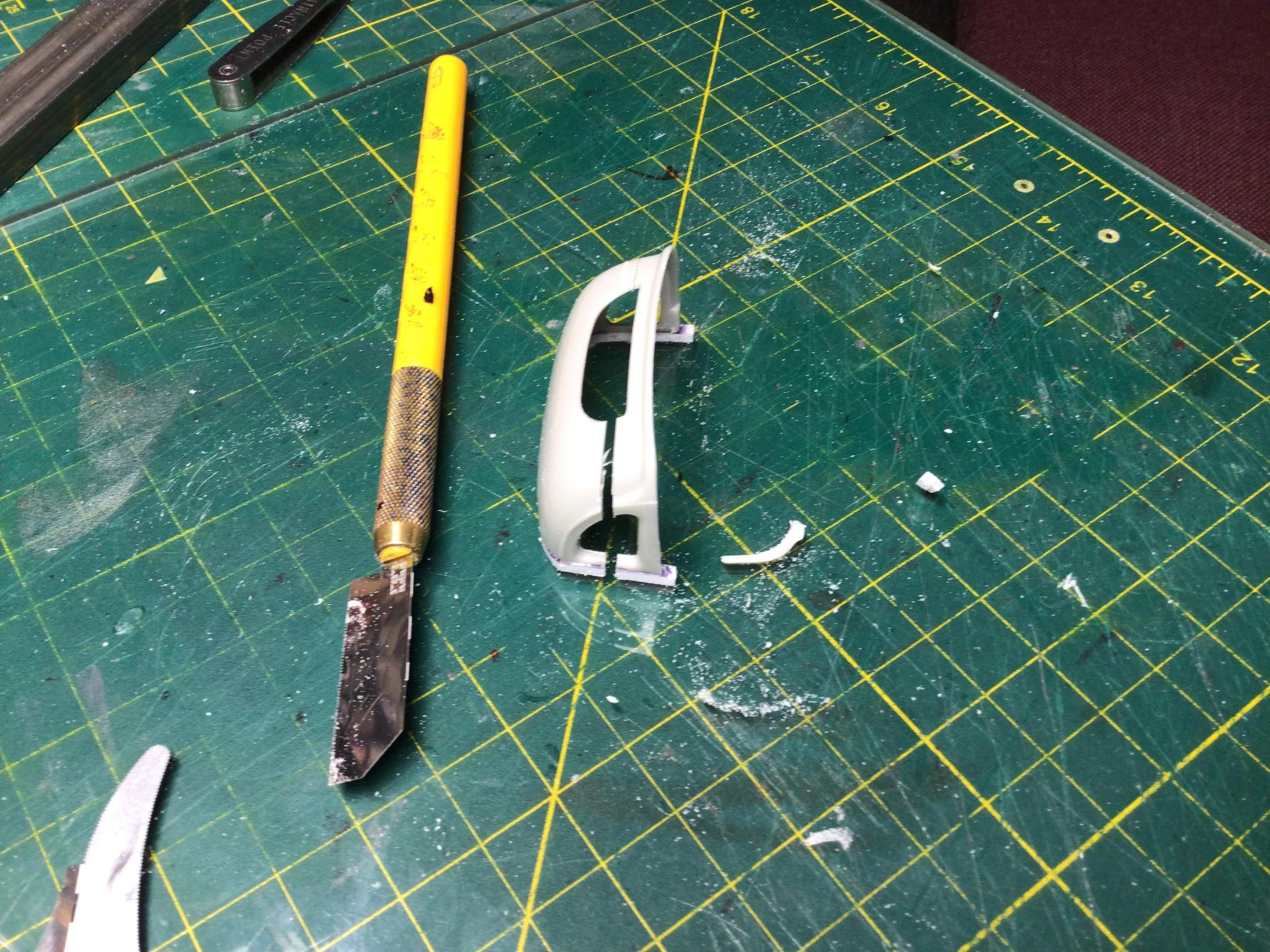

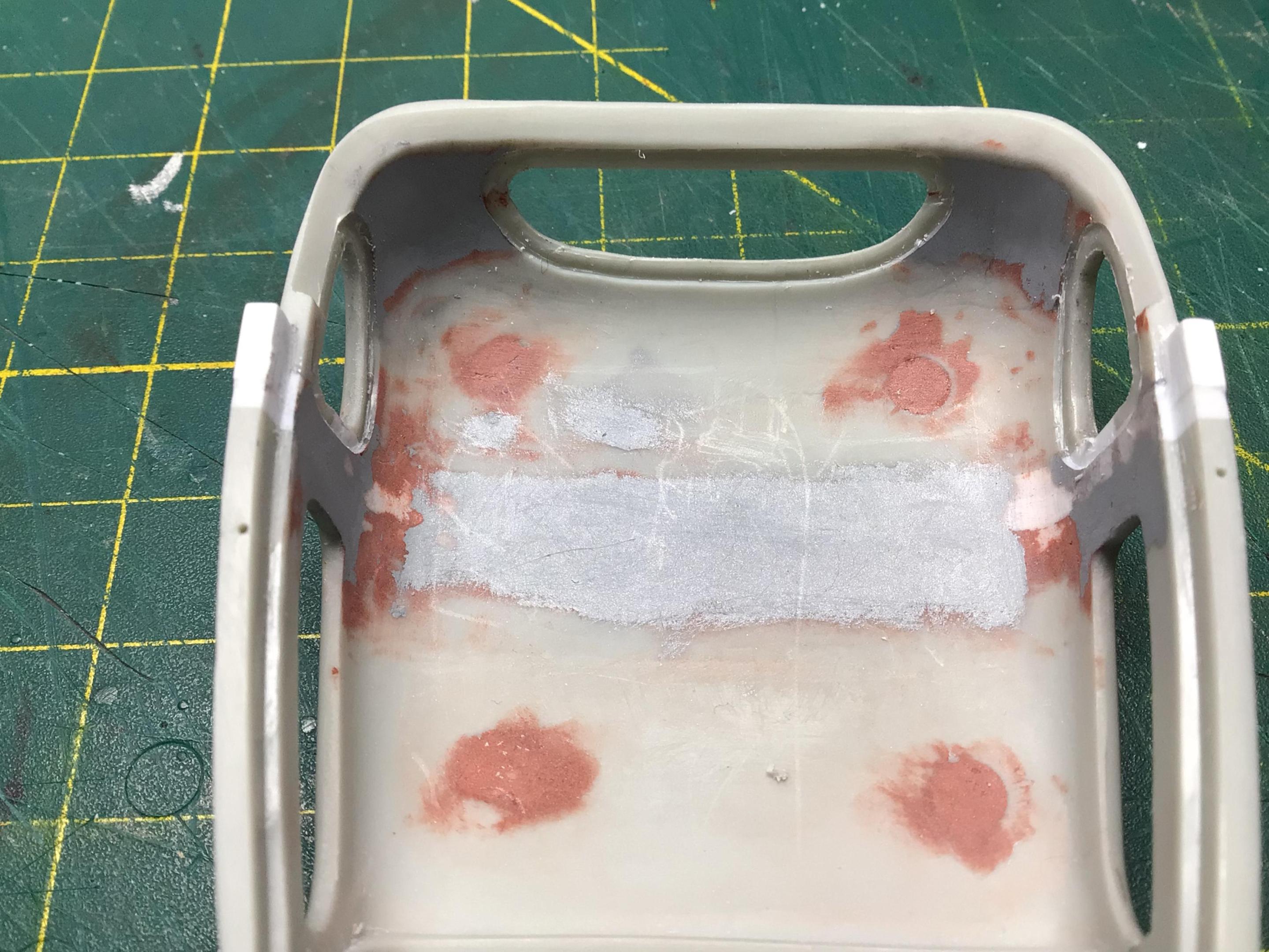

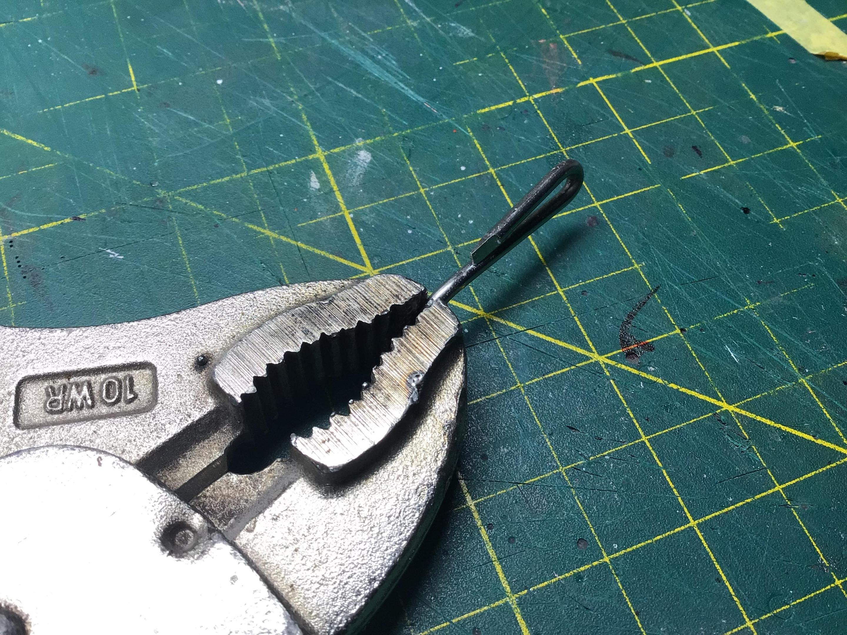

I want to do a bit more work on the A pillars and drip rails. Plus, I figured it might be a good idea to fab some windows before I go glueing the roof on.? I made a little scraper tool so that I could make a uniform recess for the glass to sit in. It worked like a charm I think.

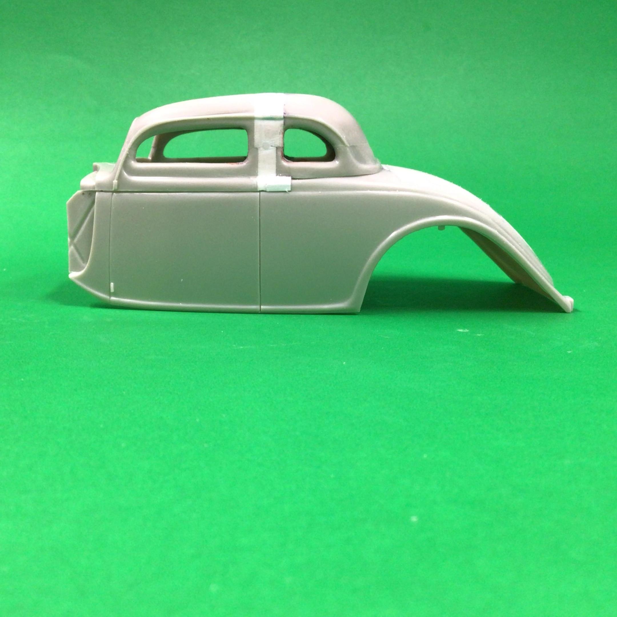

Next time you chop something like this, it's mucho easier if you stretch the roof like zo (this is a '34, but it's the same deal):

Count me in too, Greg, this thing looks like you gave it a lot of thought and planning. Stretching the roof like this can't be done on a body with integral roof unless you cut it off first. Every chop is different and you found a way to do this one that, I know, I wouldn't have thought of.

You'd still need to stretch it, the pillars are slanted. I suppose you could lean the A post's back like a lake car, a formidable task.?

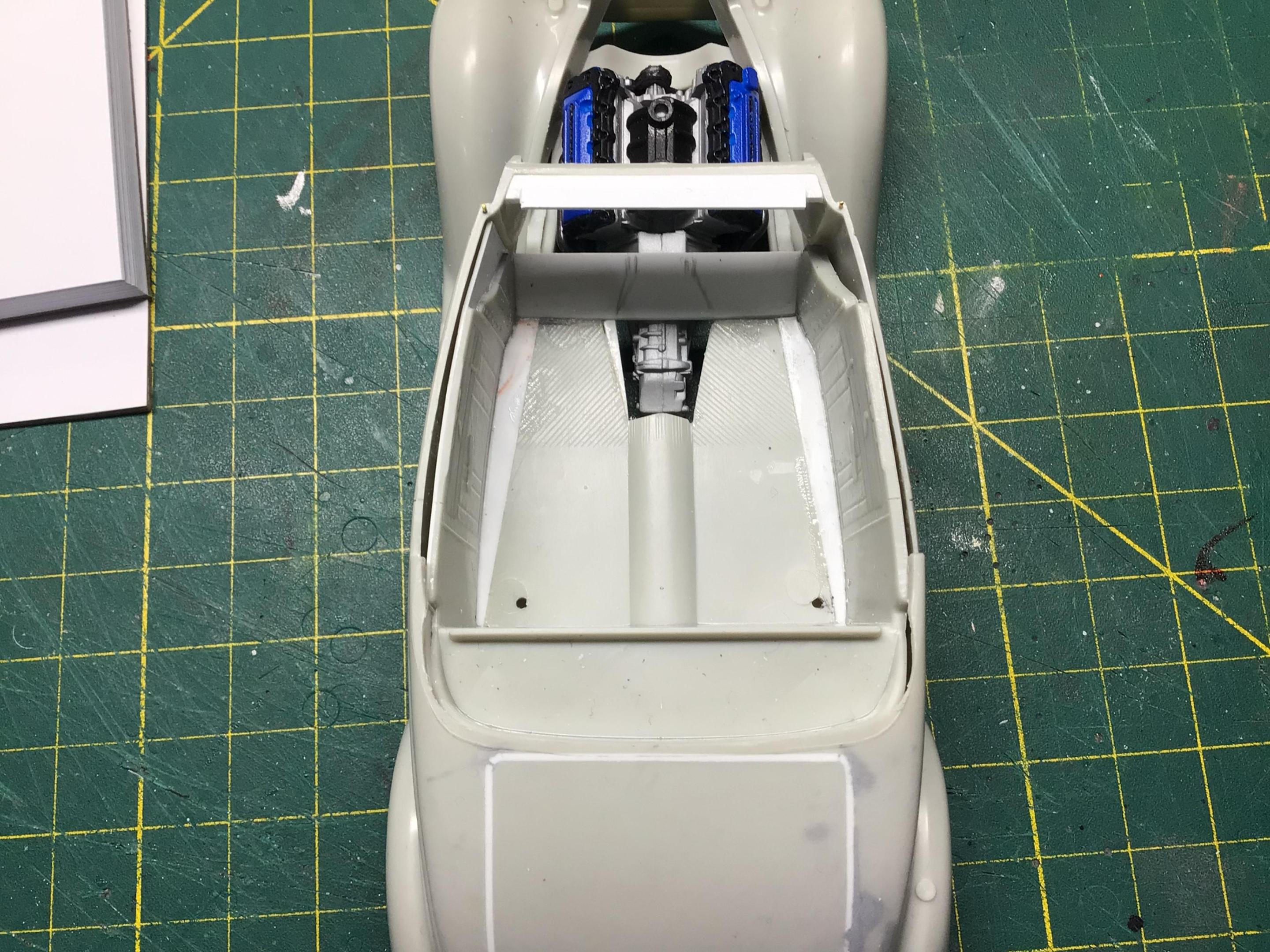

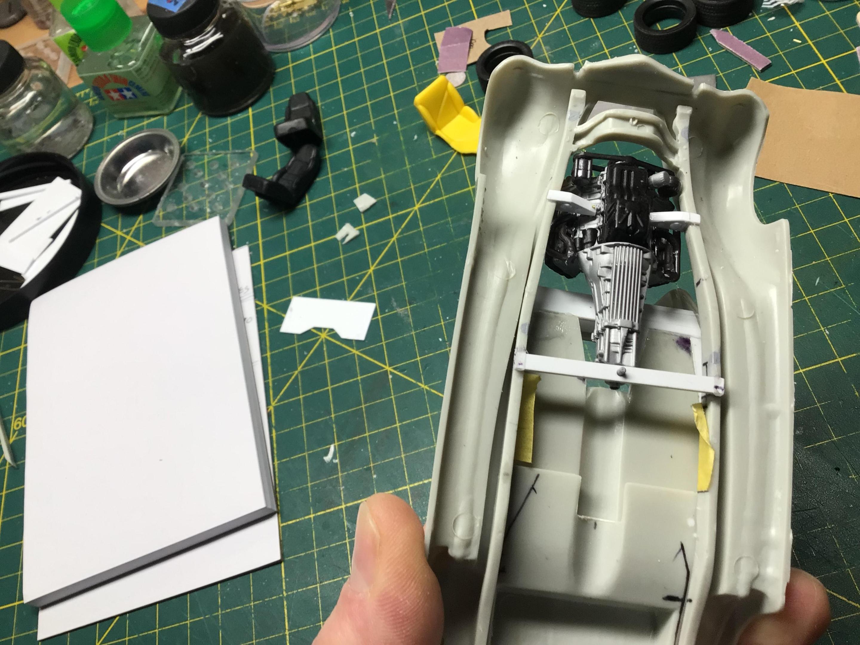

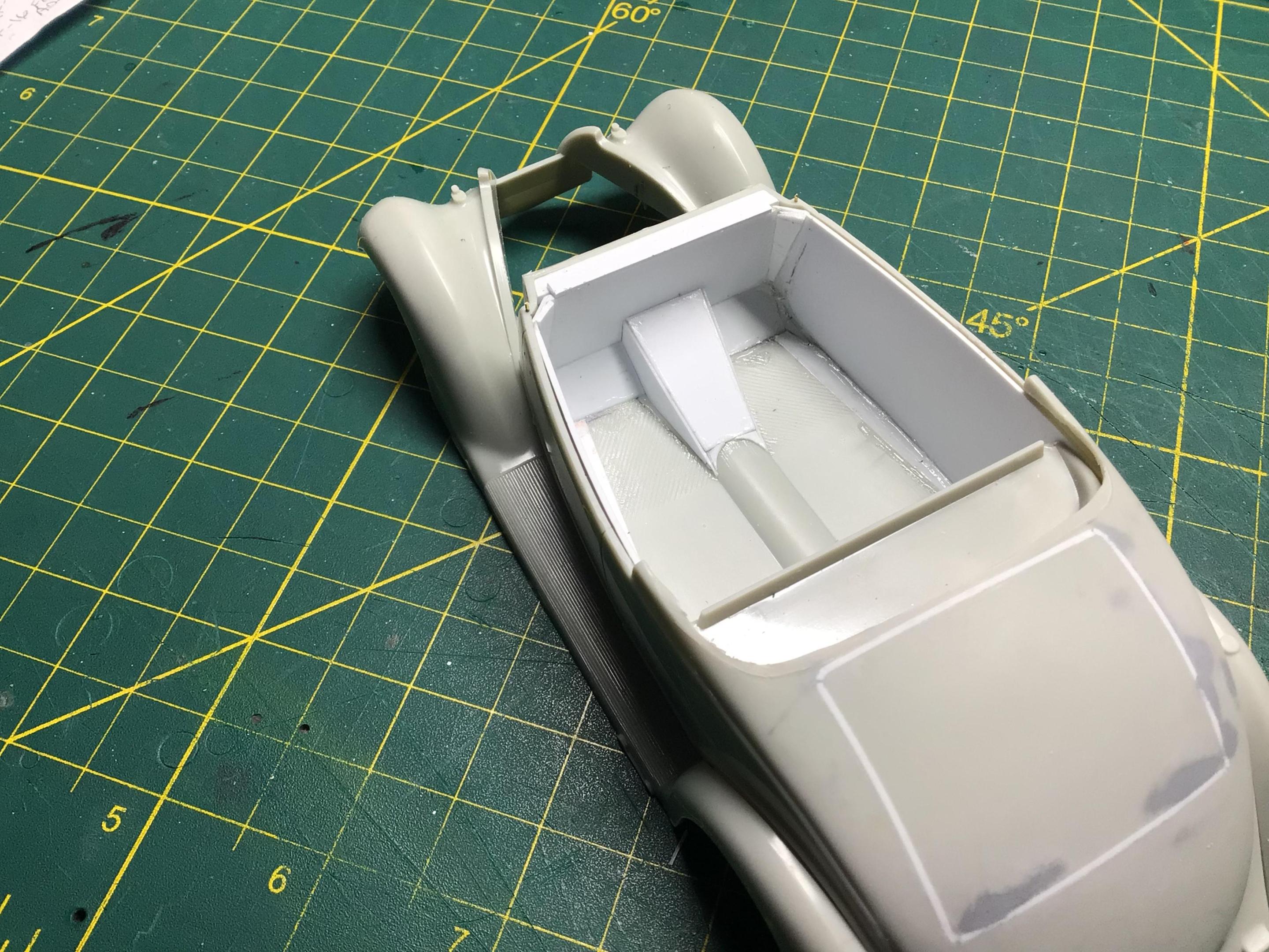

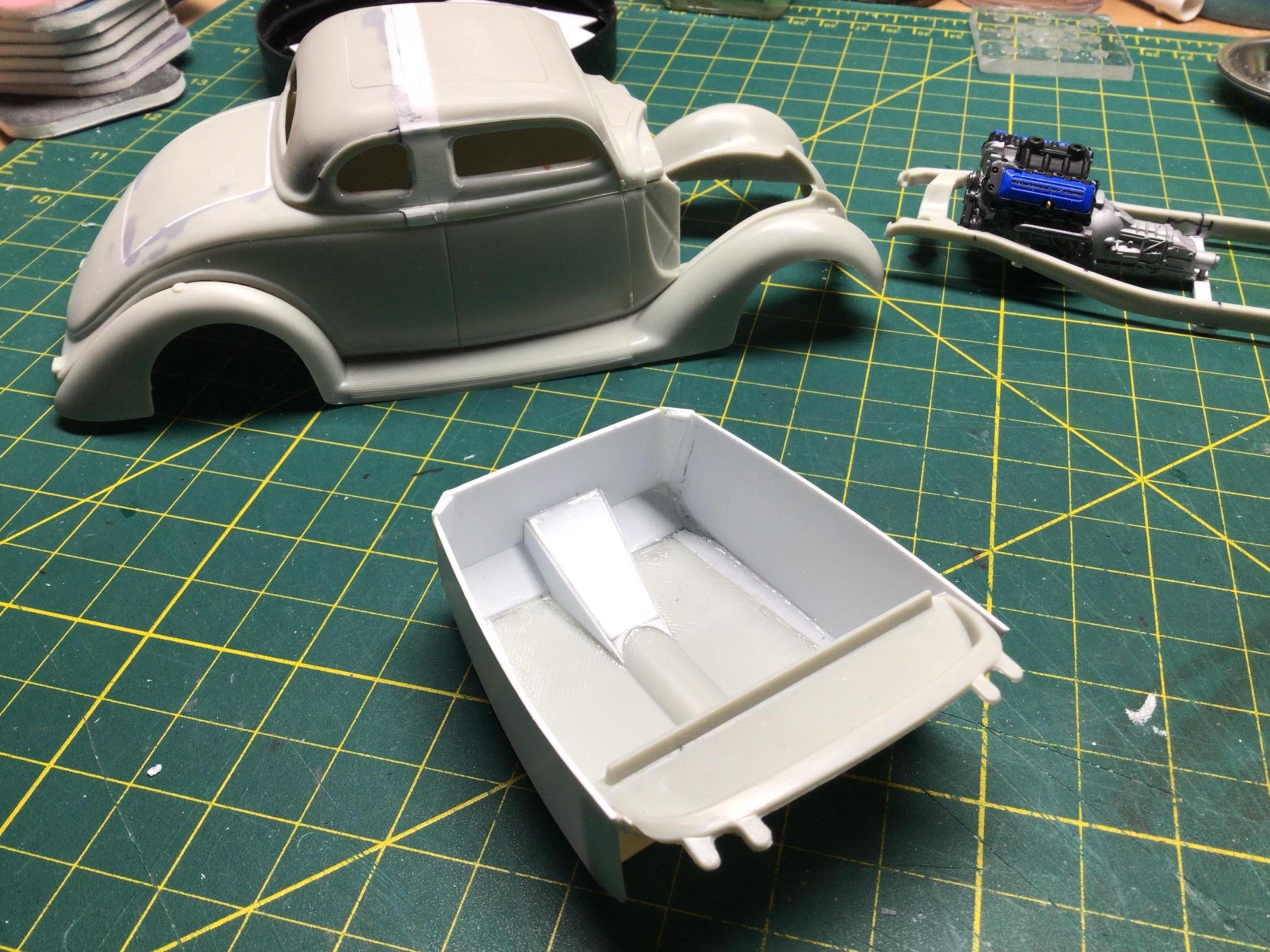

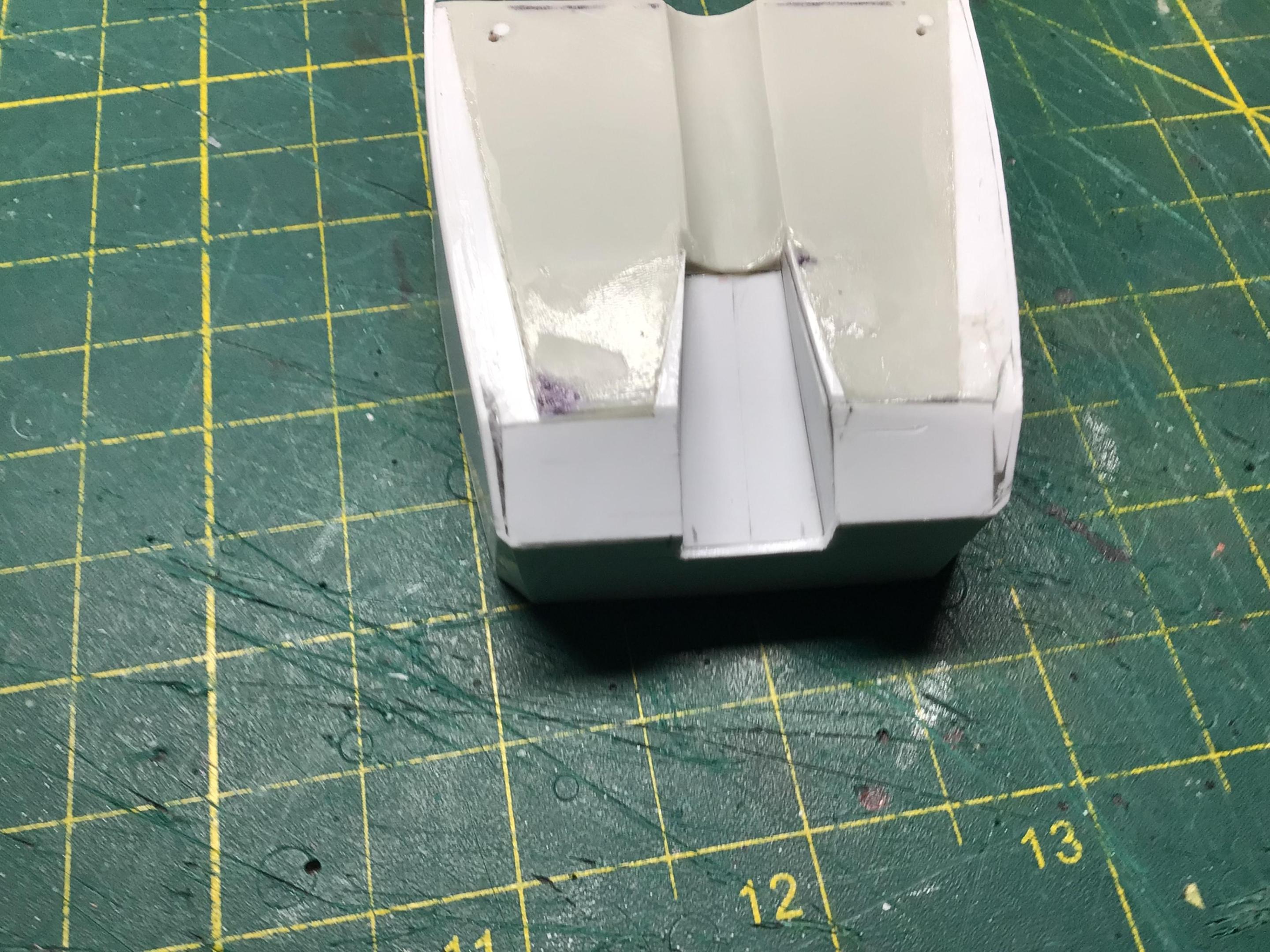

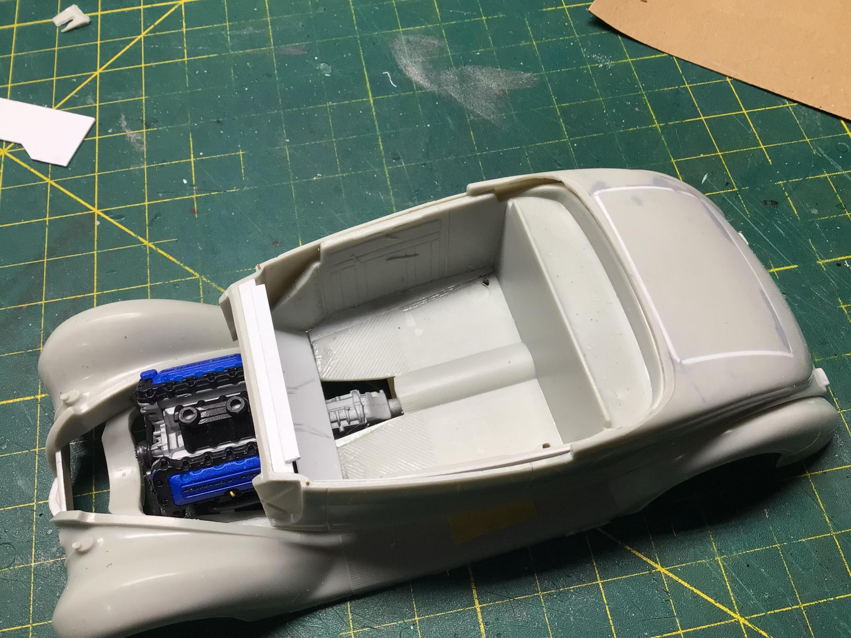

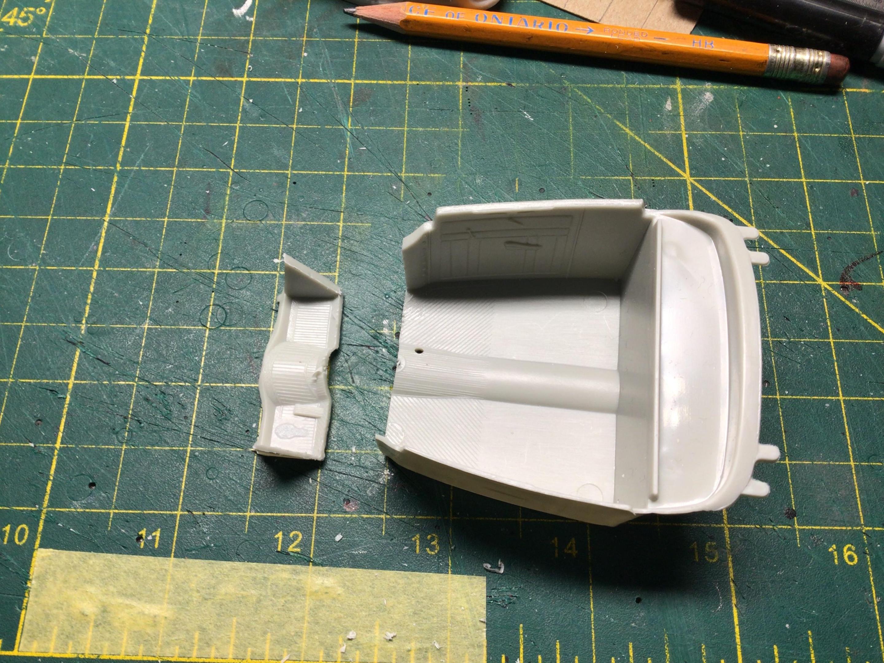

Well I may have bitten off more than I can chew I’m thinking as I fumble my way along. I want to use the engine from an ‘07 Shelby, which is pretty wide. So I cut out the firewall and moved the engine back to where it would fit under the hood. Now that left me with zero foot room.? Since I stretched the roof, I decided to move the whole interior back…then widen it…?. The stock kit interior door panels are over 6 scale inches narrower than the outer skins and the seams never were in alignment, so I may as well replace them entirely. One thing leads to another…wish me luck!?
Edit: At this point I don’t think I want to try the channeling mod that I envisioned.?
Edited by NOBLNG
  • Like 1

Thats a good looking chop, and your scraper tool for the window area is something I'll try to remember. Such a neat trick but well worth it when the glass is fitted, tahnks for sharing it
Thanks. The scraper I originally made with a pointed end to do drip rails and window moldings.

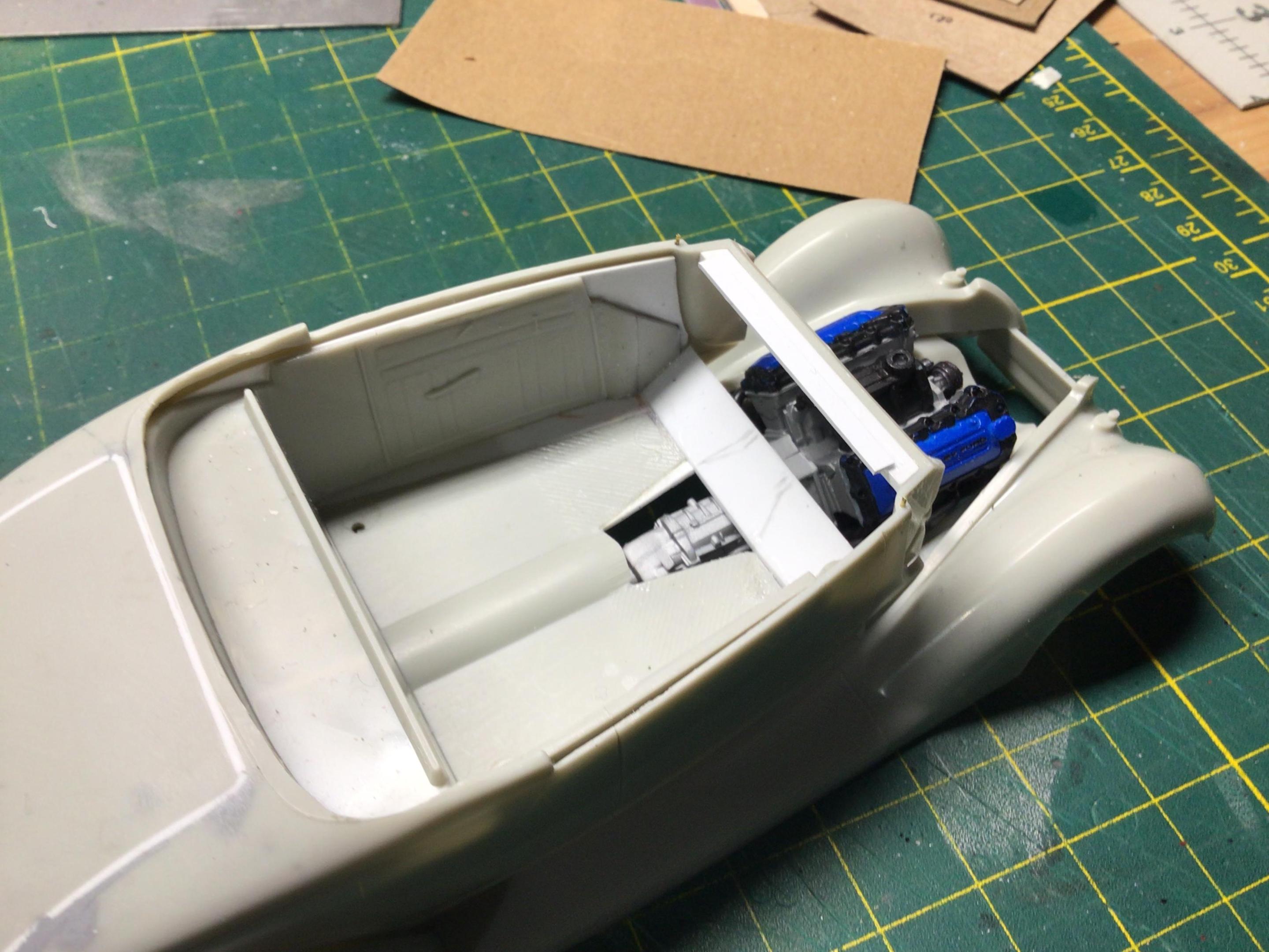

Well that wasn’t so hard. A bit of a hack job, but once I re-mount the dash, I should be back on track.?
I’m still not sure what I am doing with the suspension? Most likely stick close to stock, but I will update the rear end and brakes for sure.
