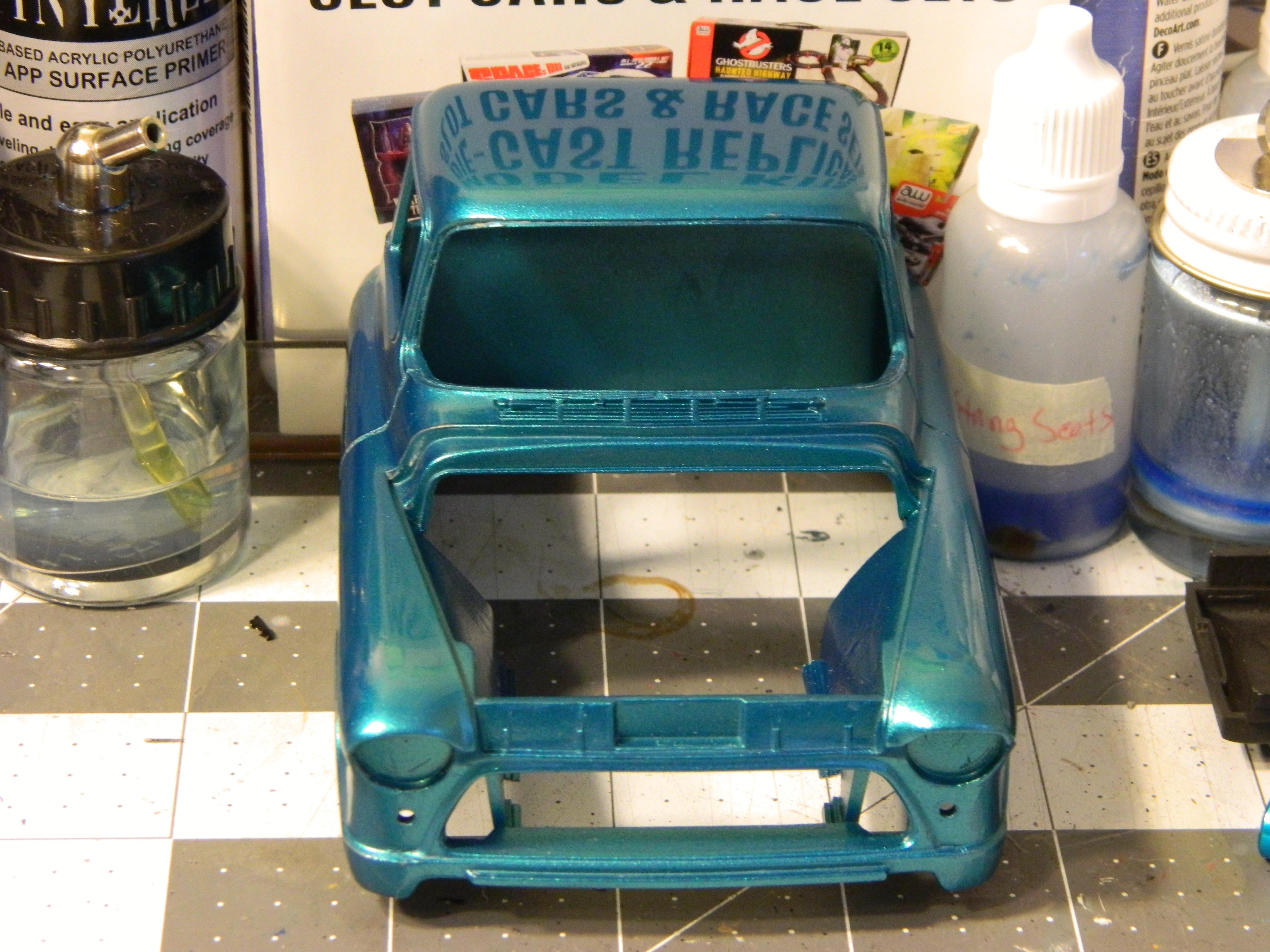

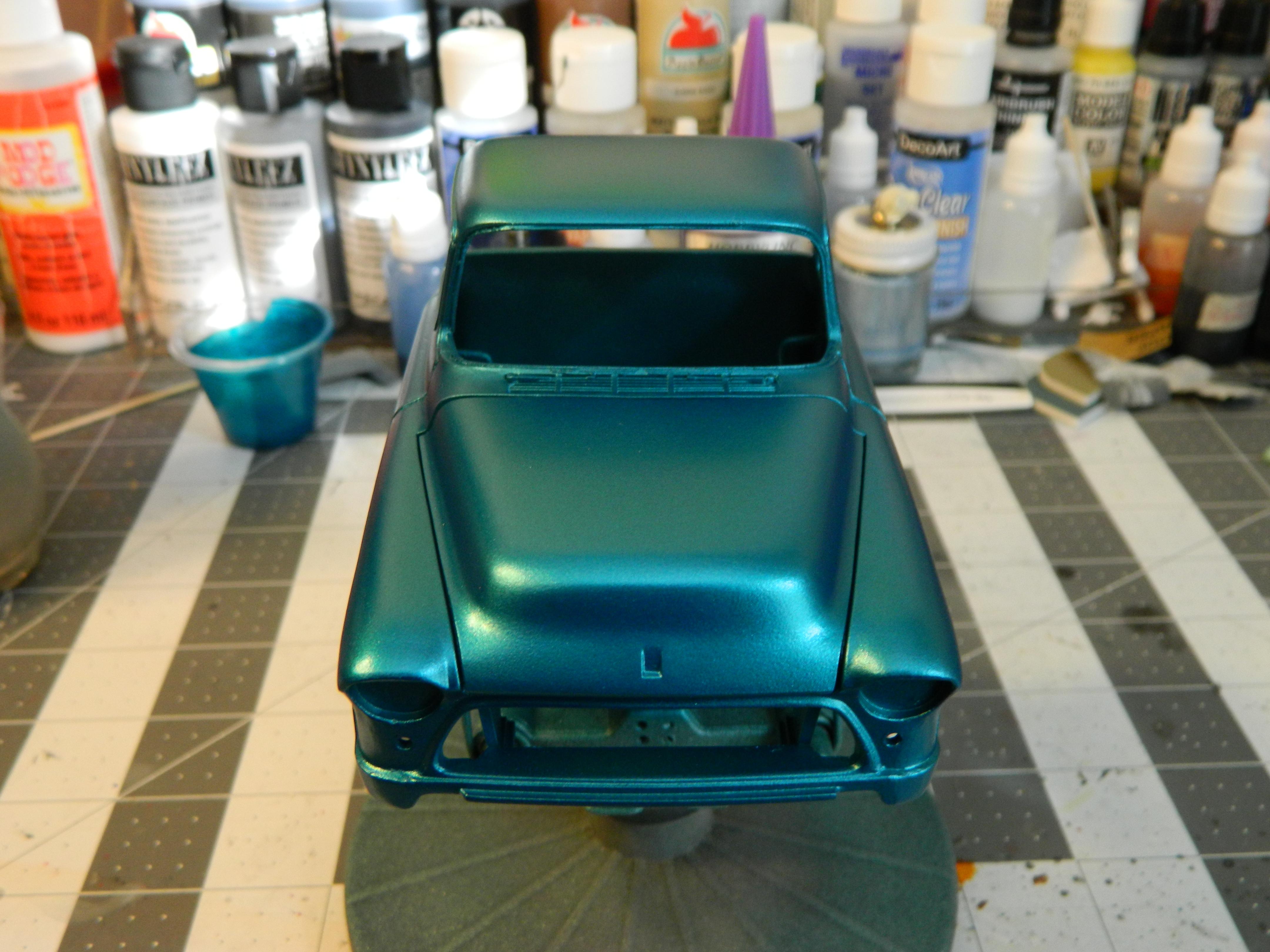

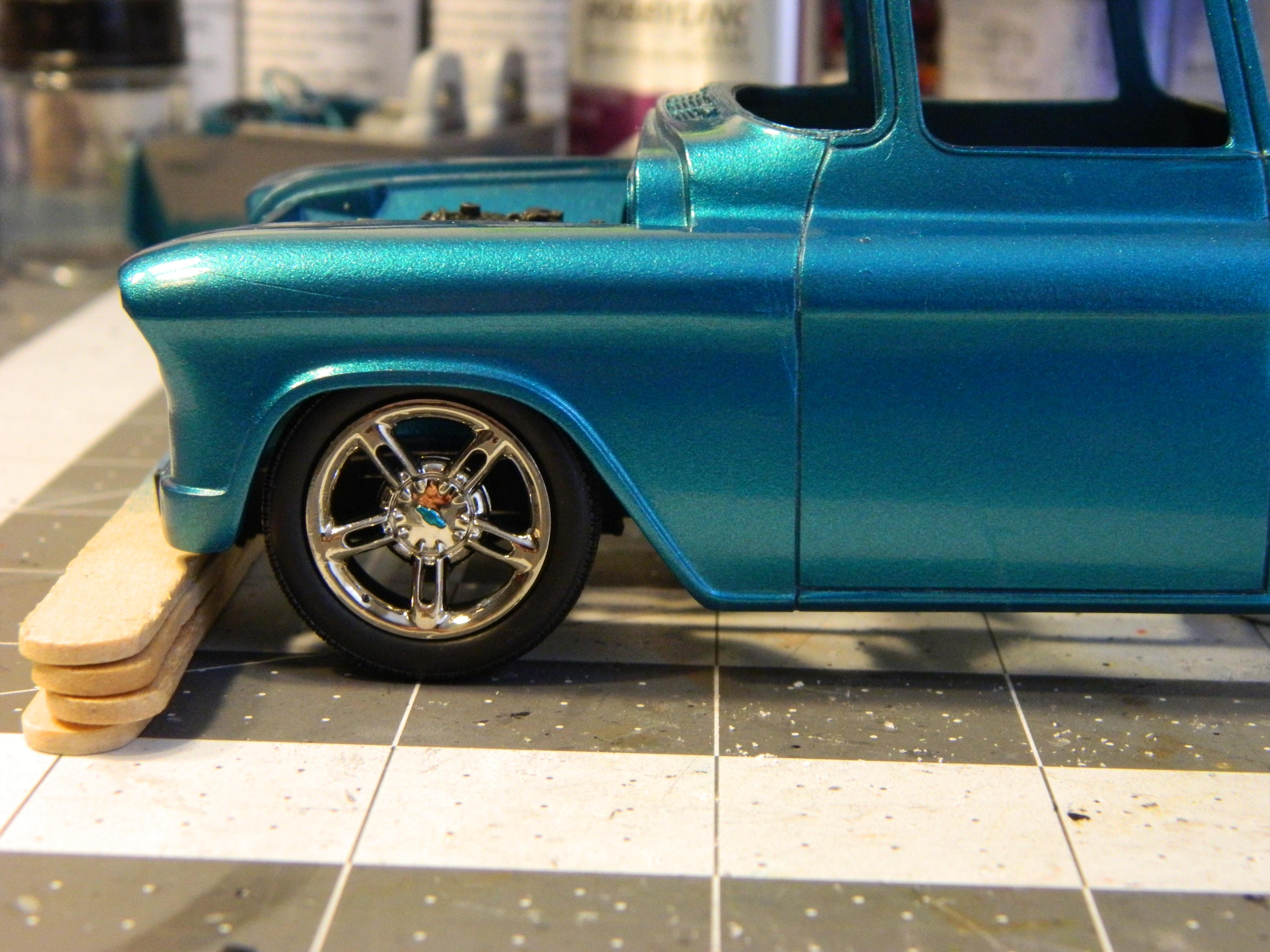

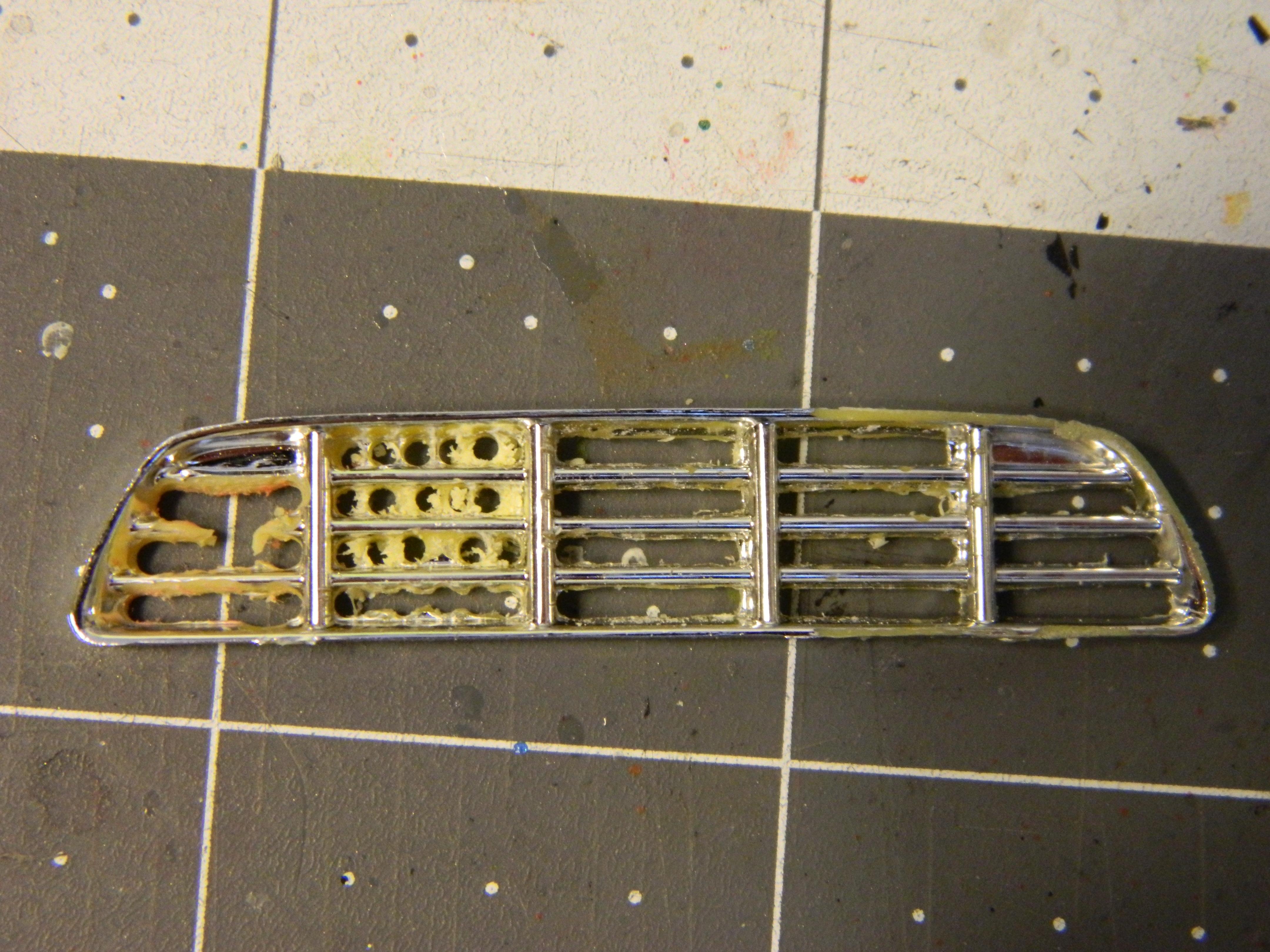

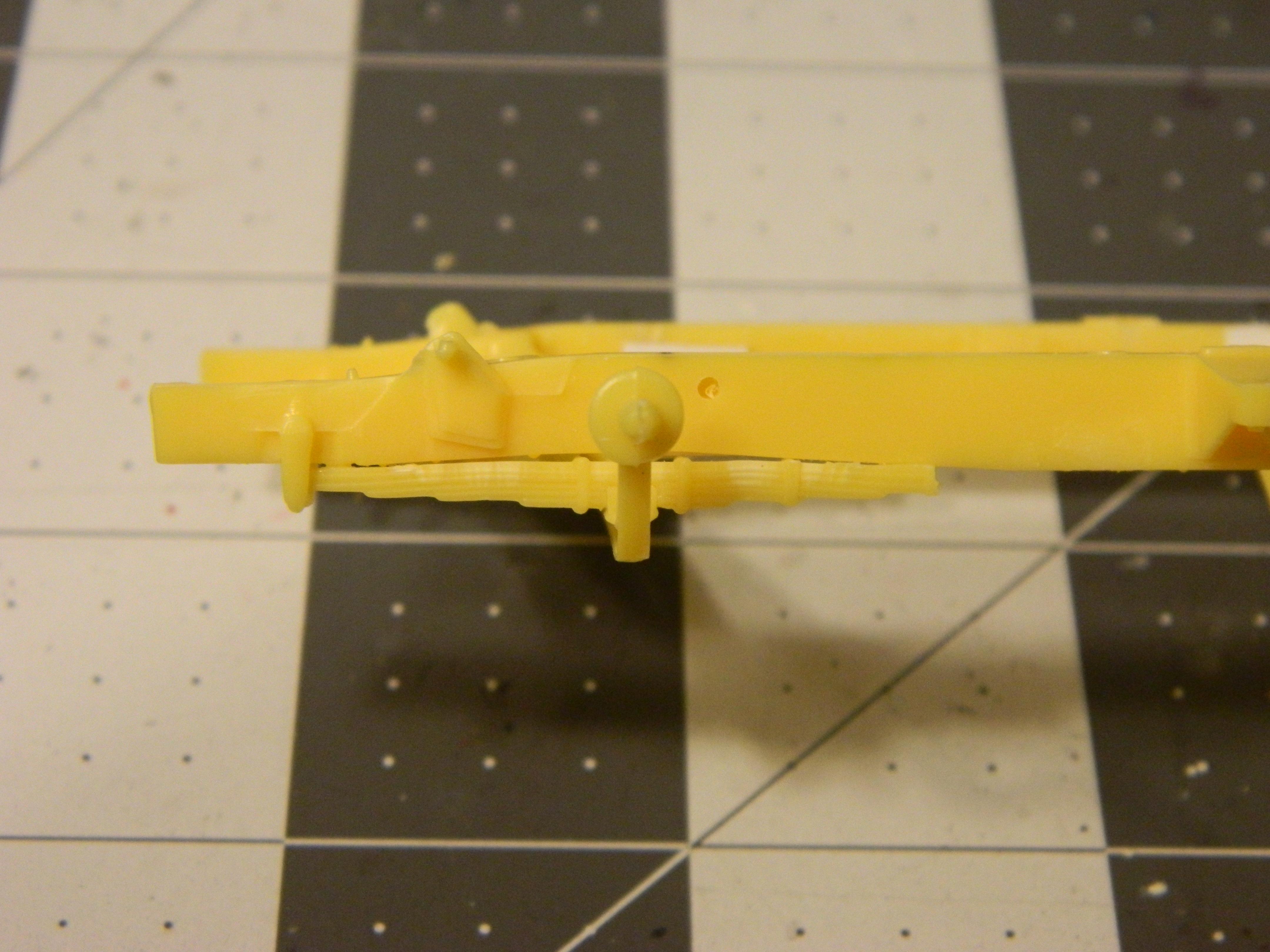

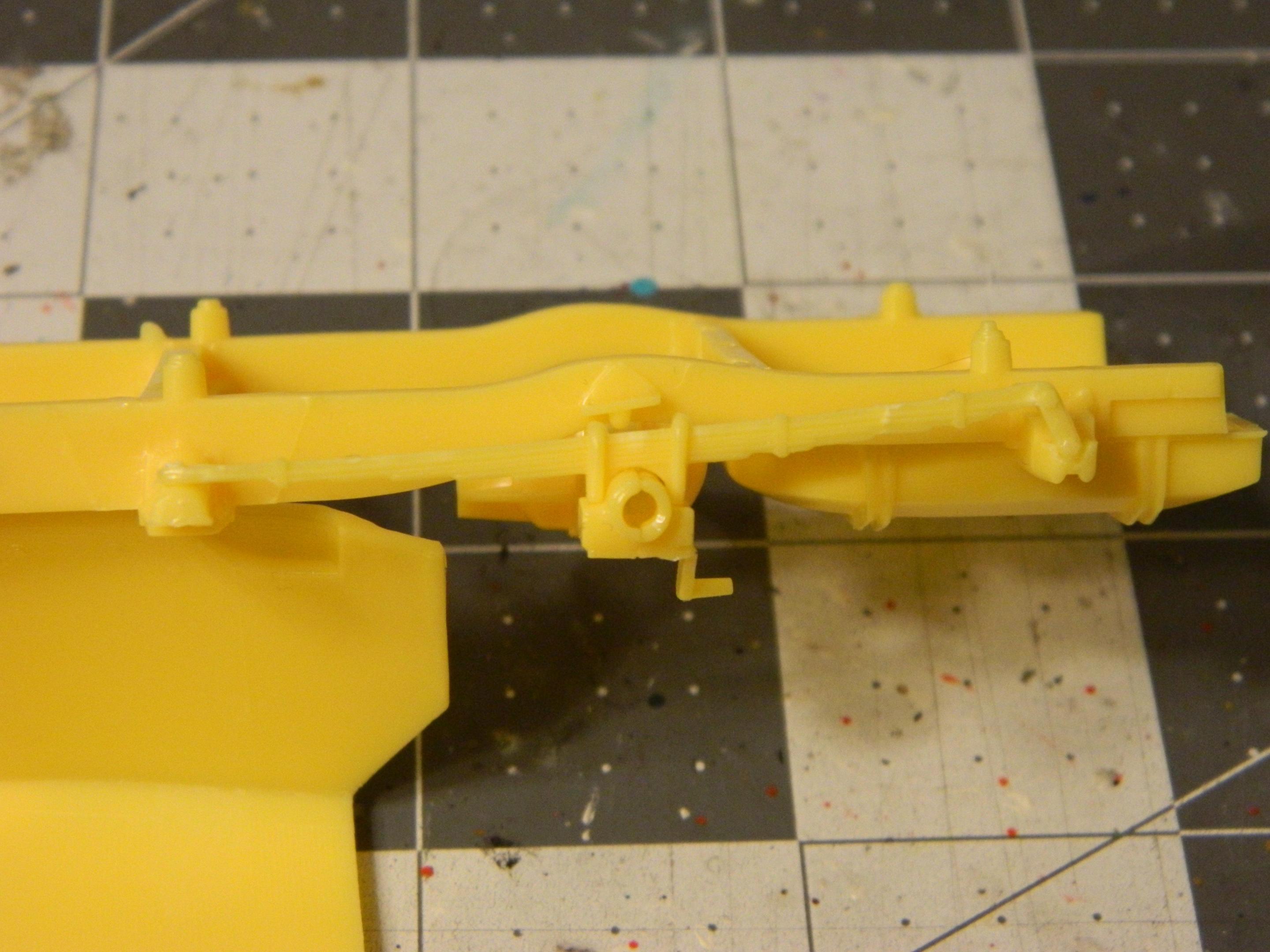

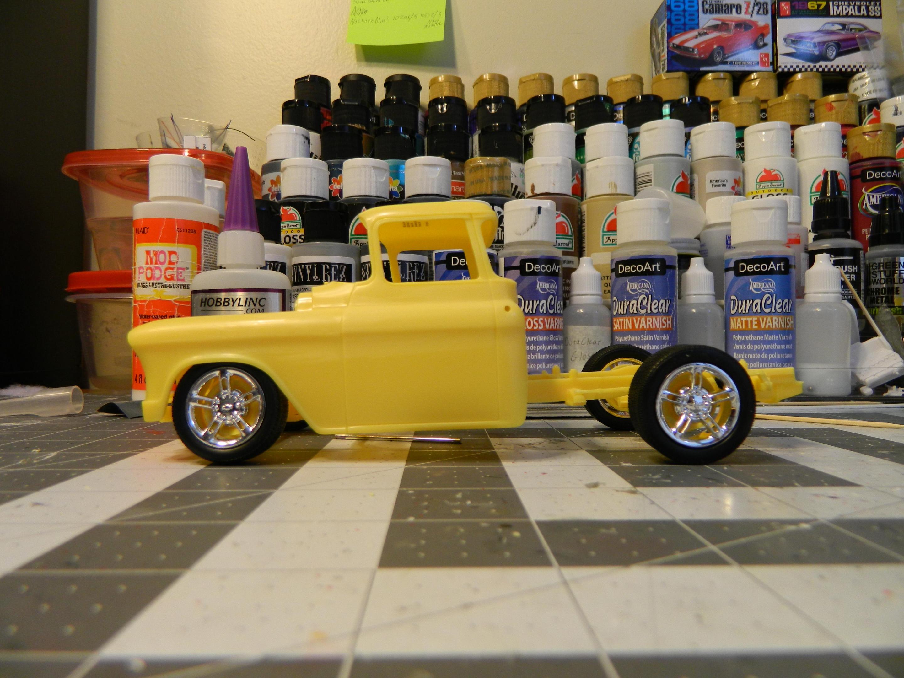

Dragonhawk1066 Posted February 23, 2022 Posted February 23, 2022 (edited) It's kind of far along in the process to start a WIP thread, but I thought I'd start one anyways, lol. I got the inspiration from Scott Inman, aka lghtngyello03 for this one. I'll be using the engine/transmission, seats, wheels/tires, and hopefully exhaust from the SSR. The color will be Createx Pearlized Turquoise. I opened up the grill, stripped the rest of the chrome and re-chromed it by airbrushing Molotow from the refill tube. I cut and flattened the front springs, and mounted the rear springs under the mounts to lower the suspensions. I'm not going for an ultra-low ride, so the height is pretty much where I want it. Edited February 23, 2022 by Dragonhawk1066 1

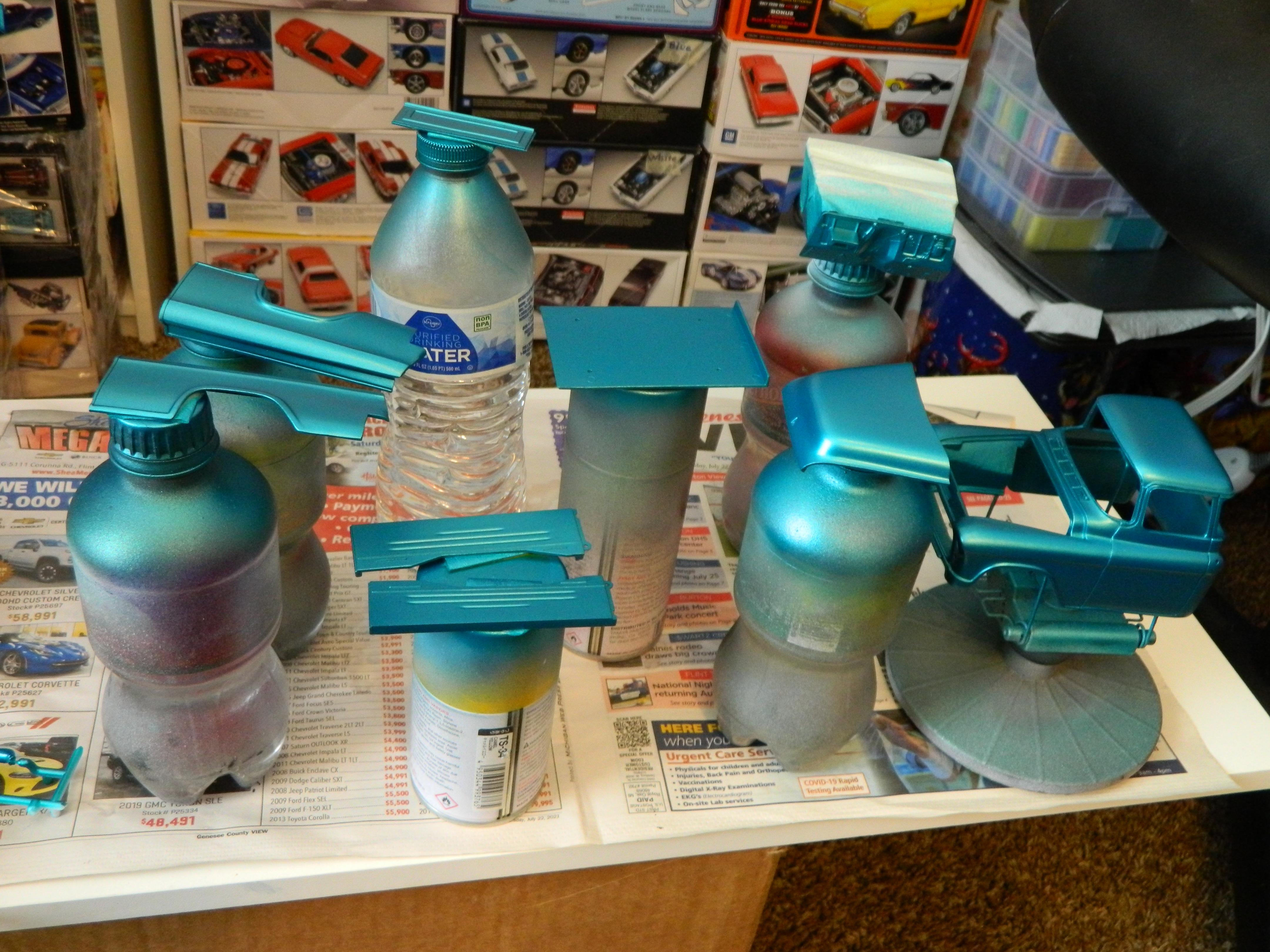

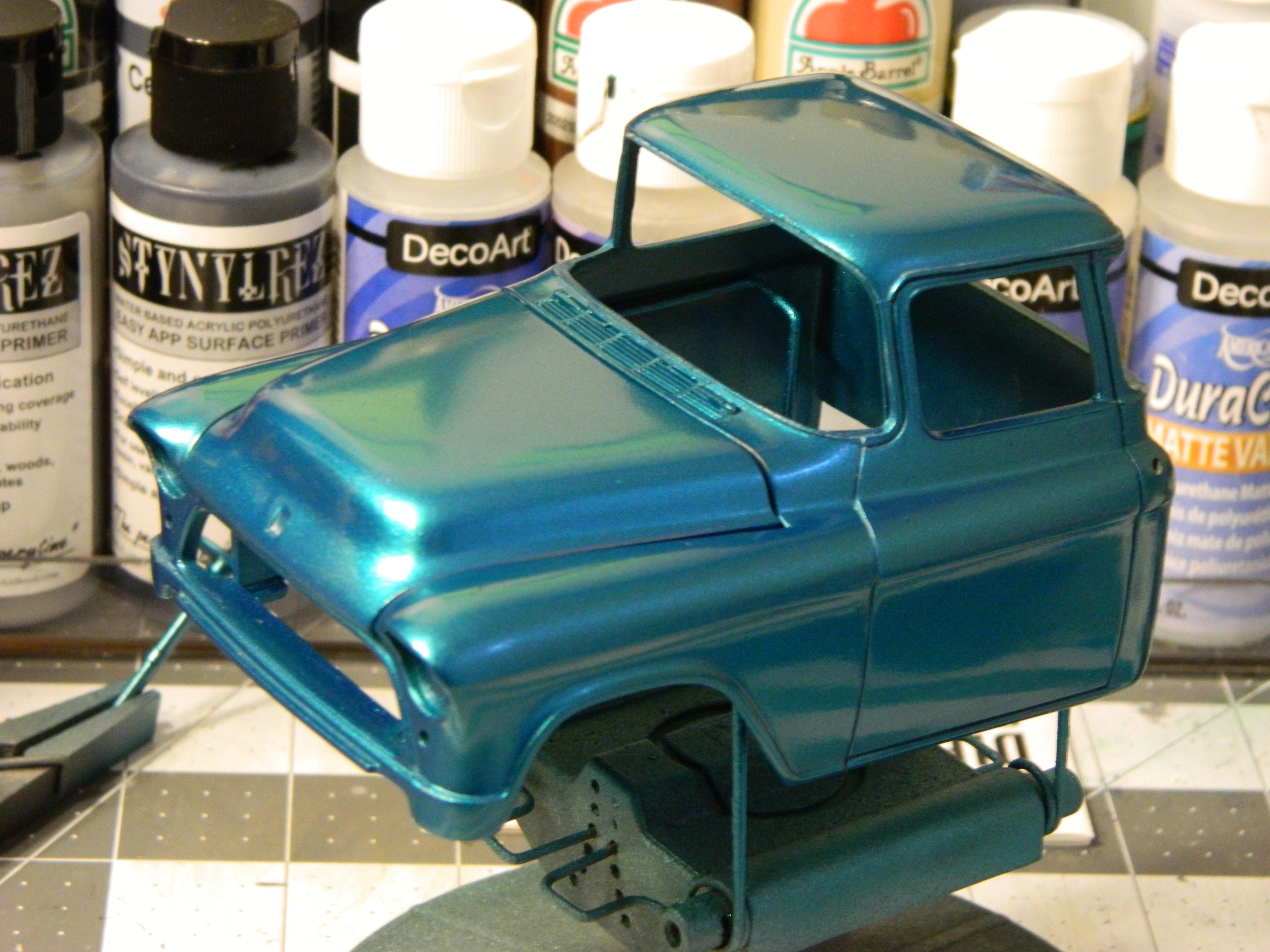

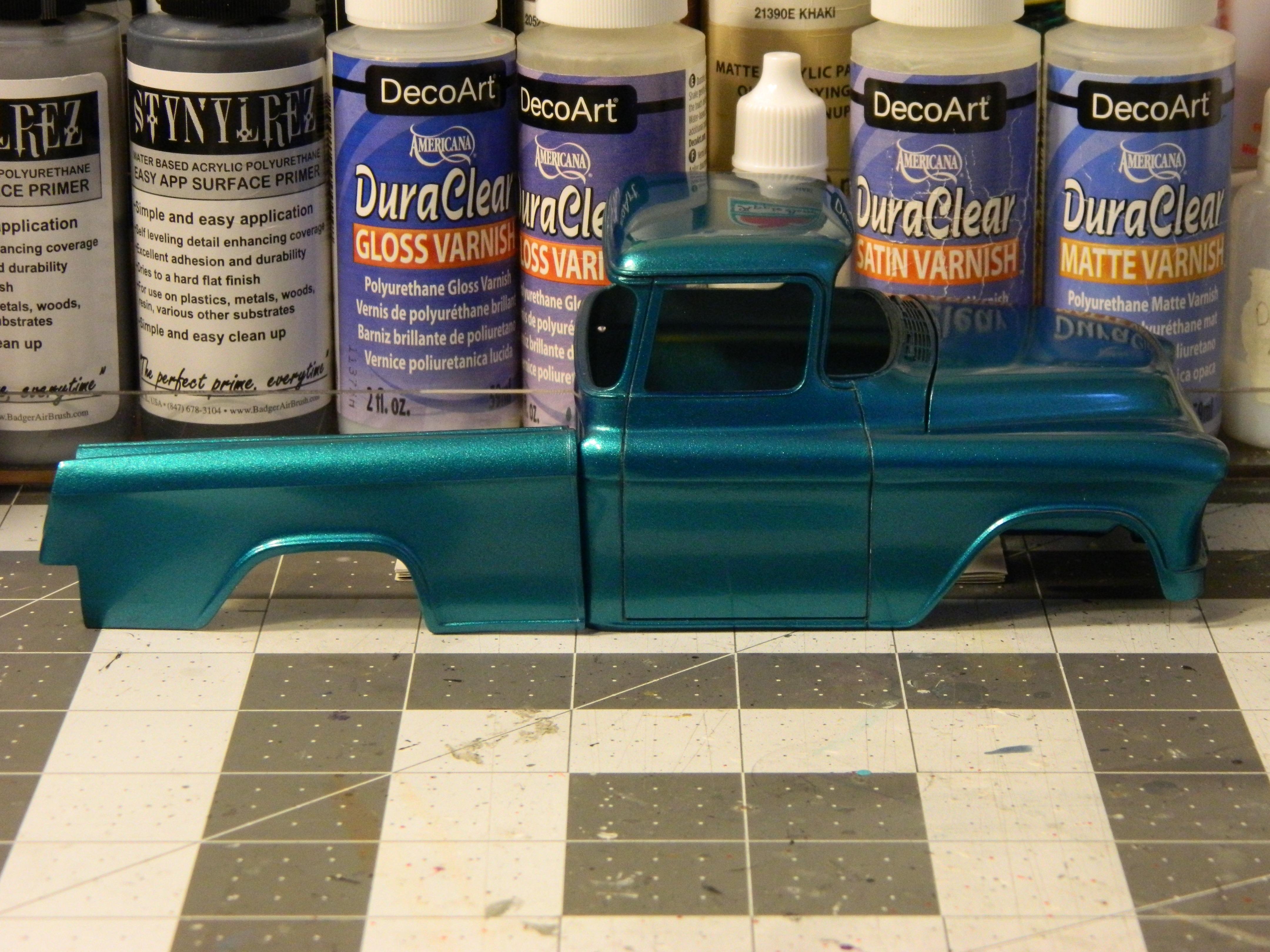

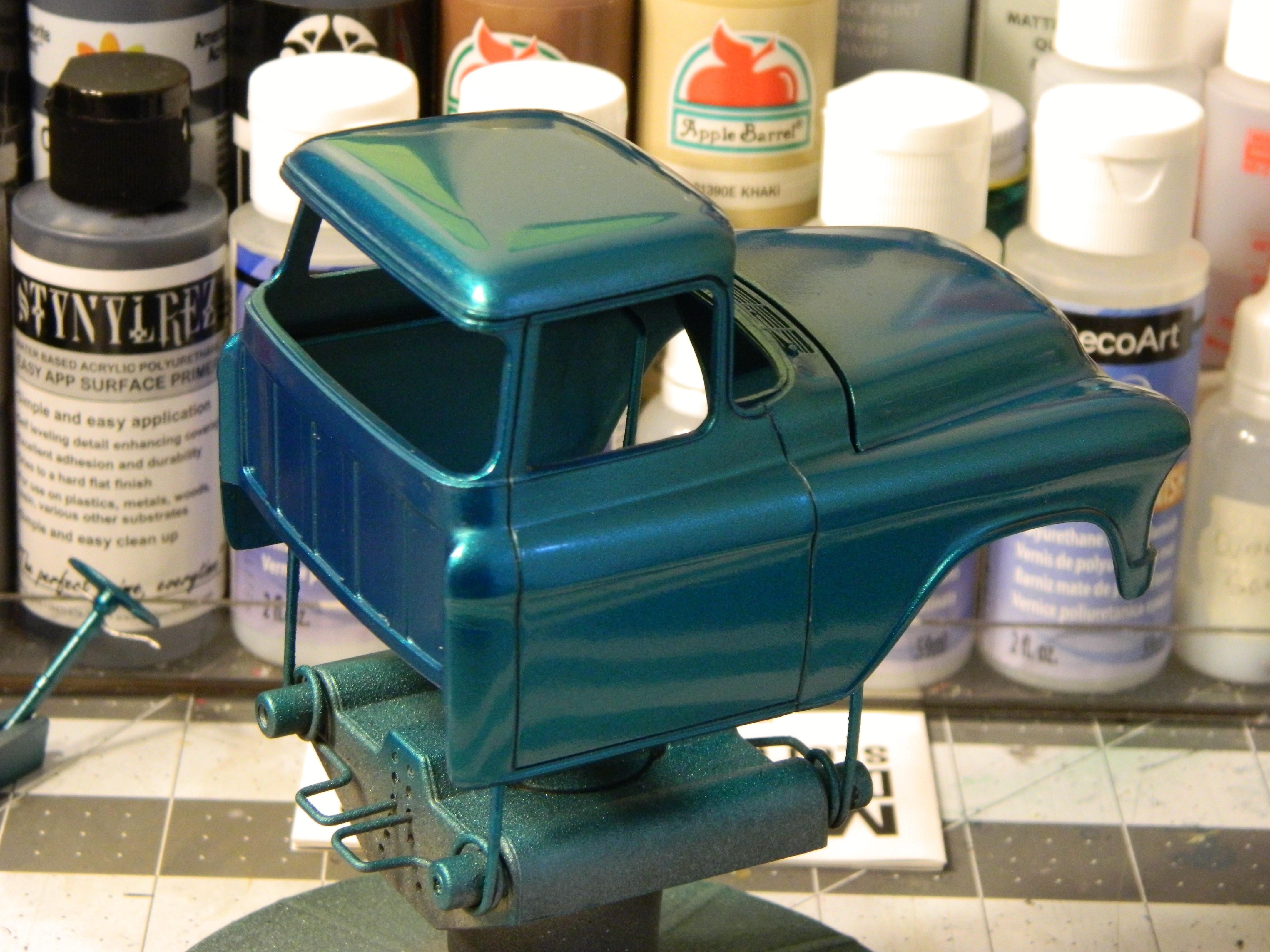

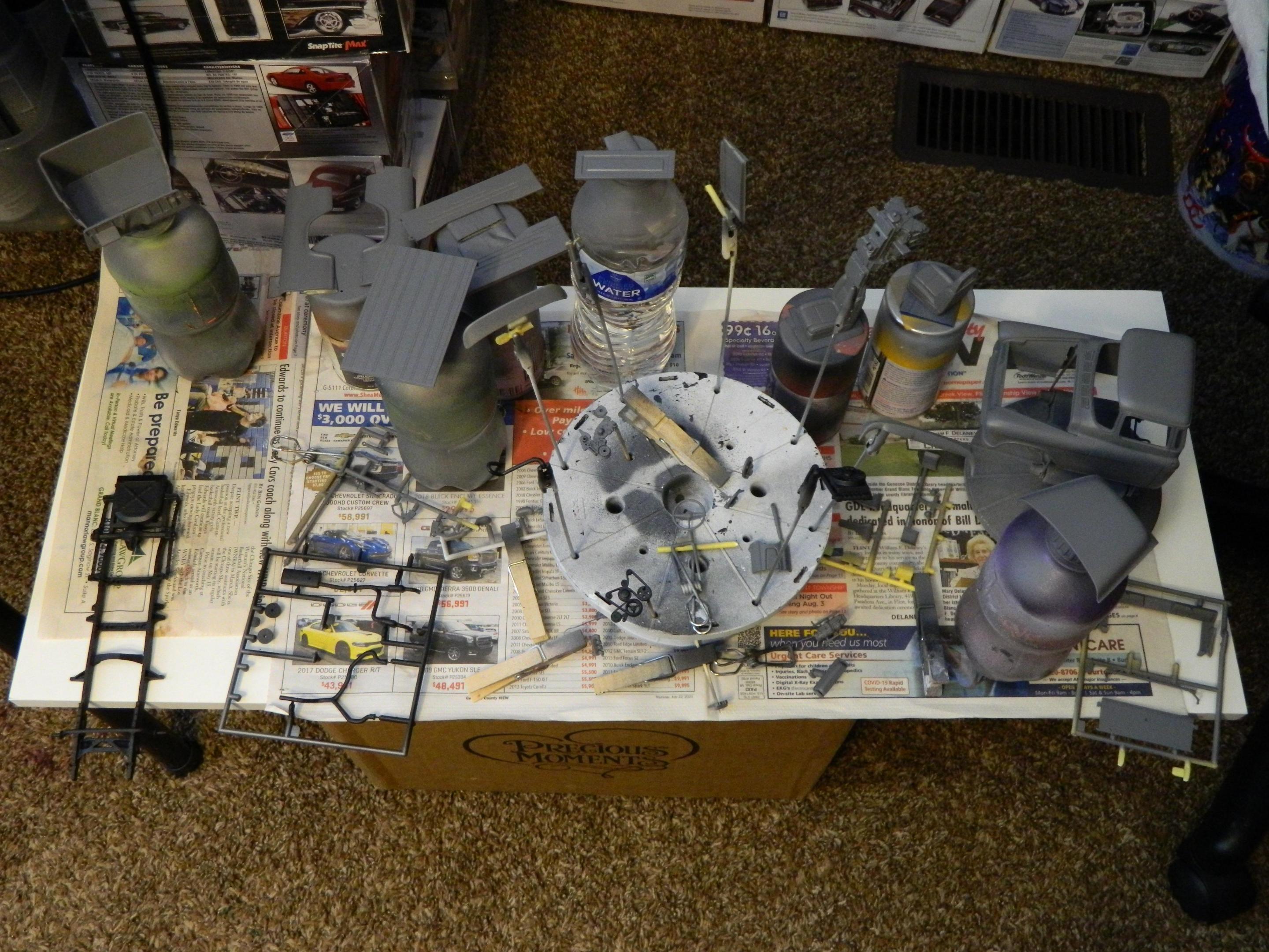

Dragonhawk1066 Posted February 23, 2022 Author Posted February 23, 2022 I did the prep work for the body, including sanding off the door handles. I primed it with Stynylrez Gray Primer, and then shot the Turquoise, using five coats. Two lighter coats, two medium coats, and a heavy coat. I really like the Createx paints so far and absolutely love this color.

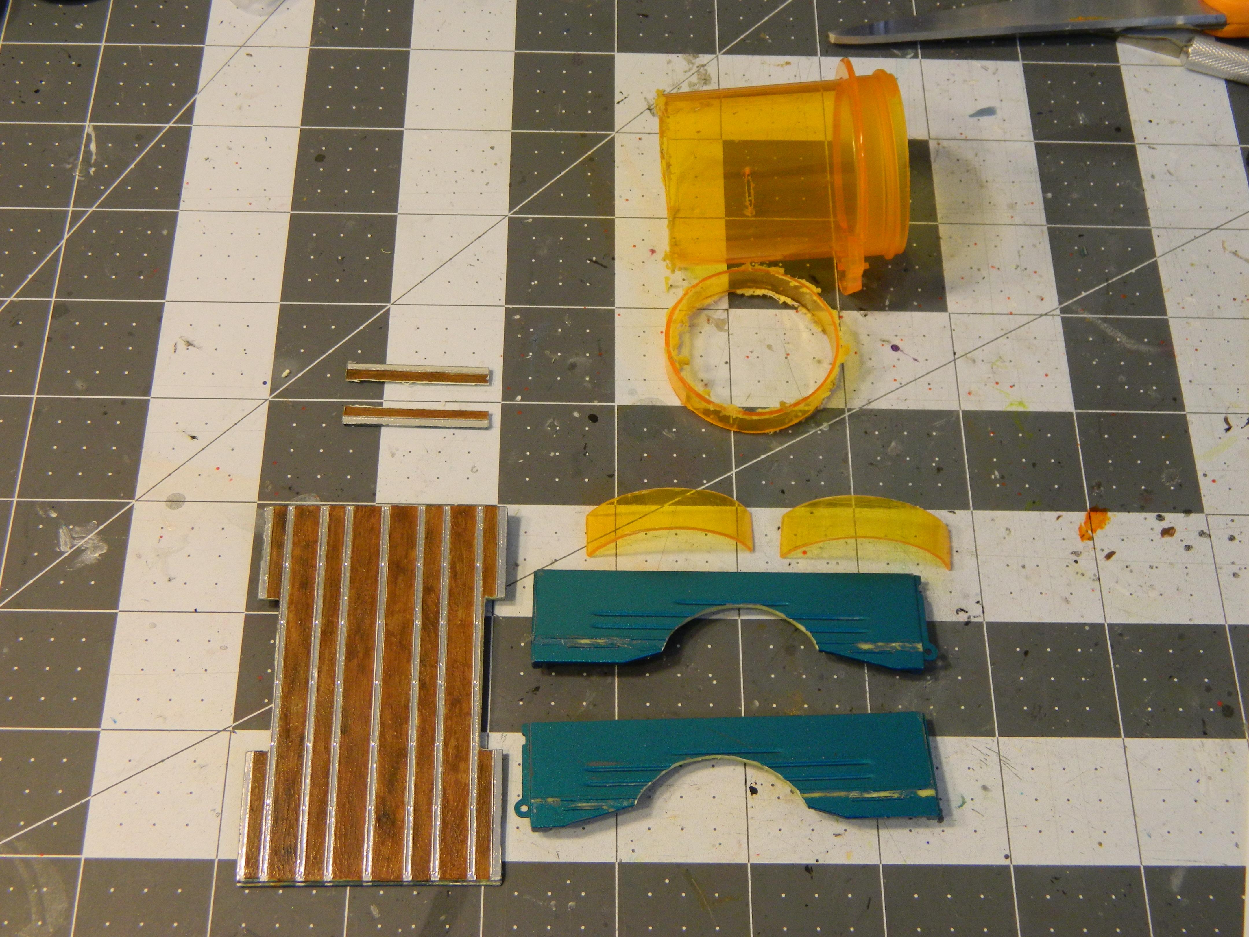

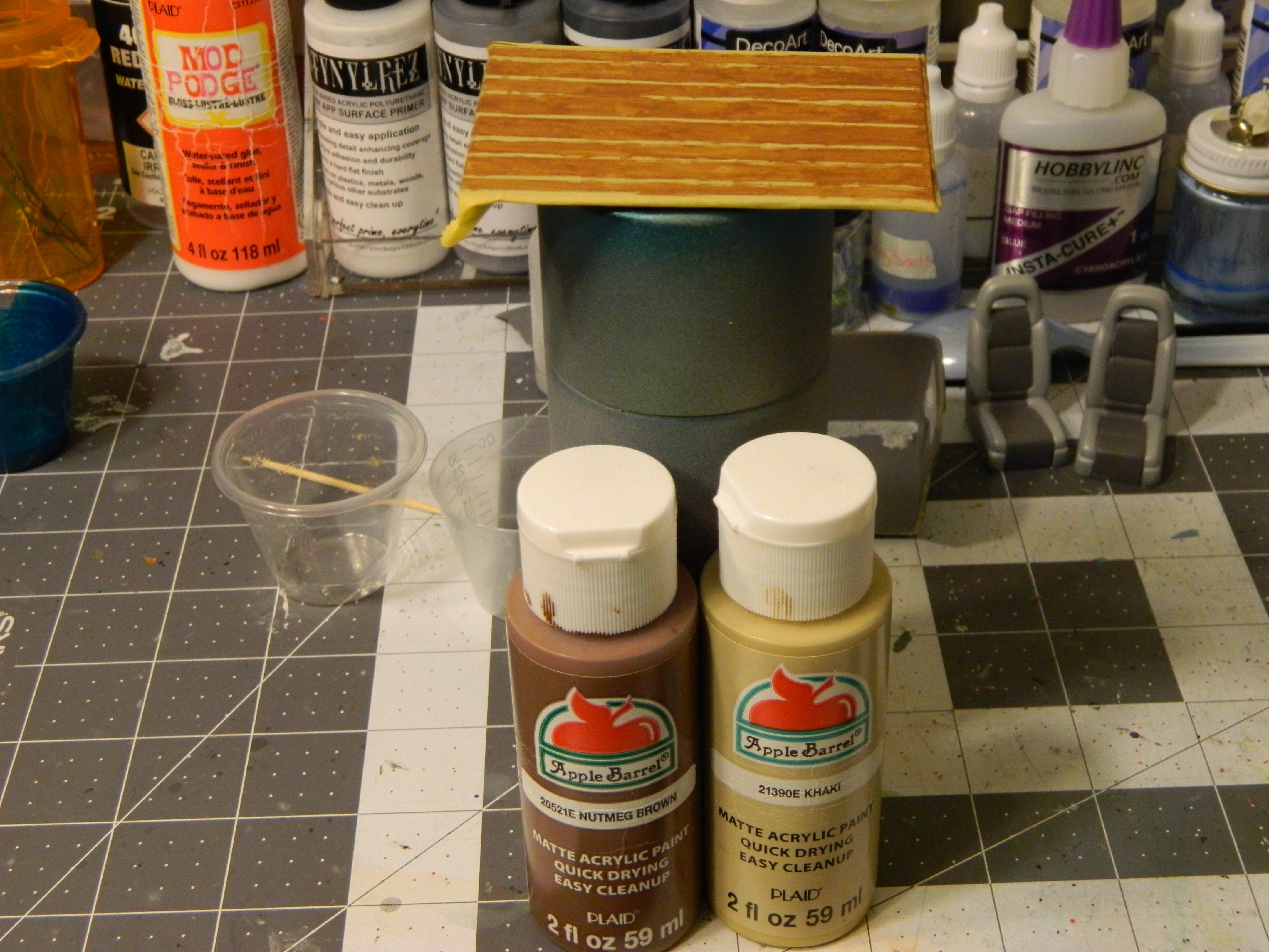

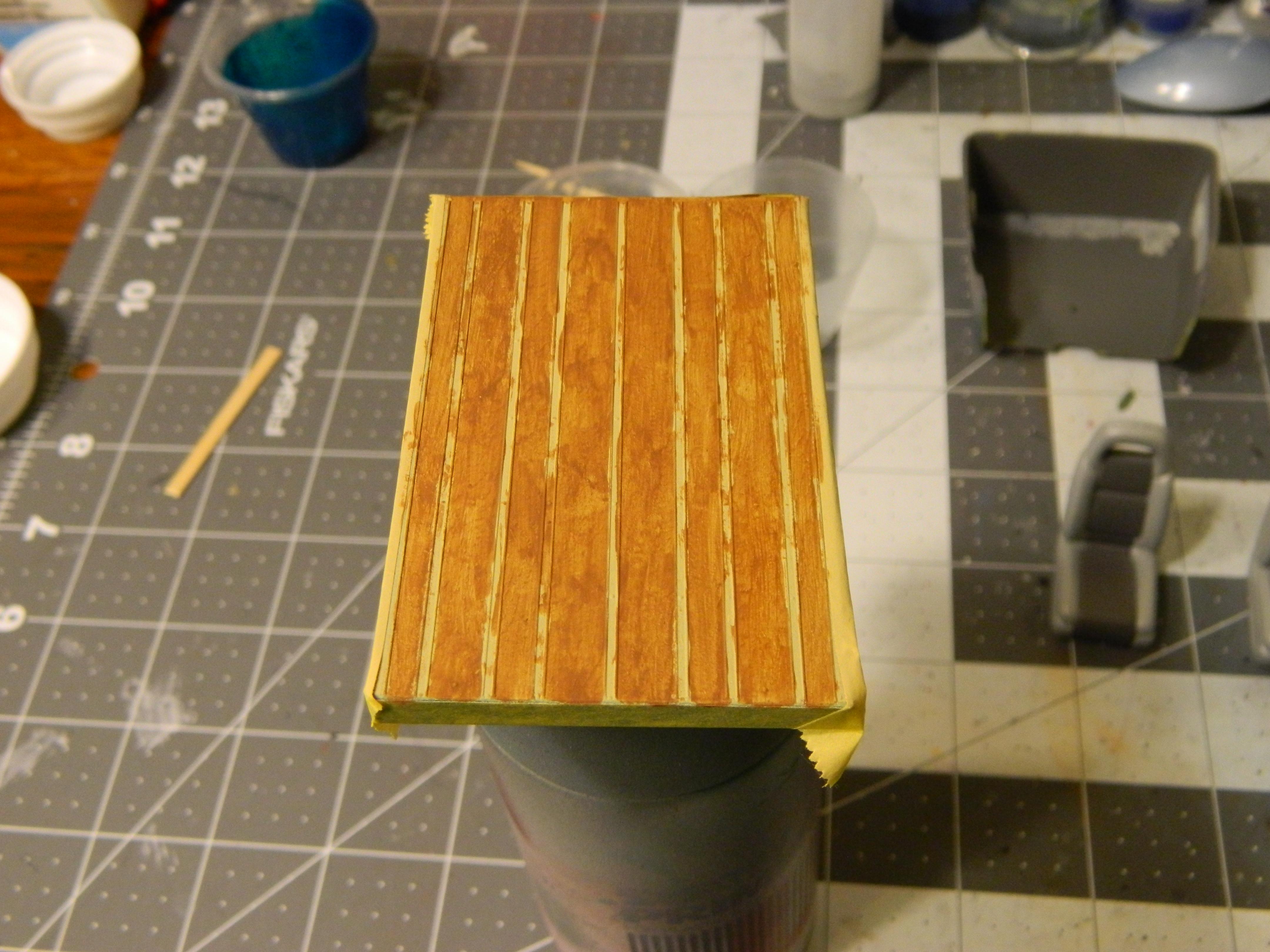

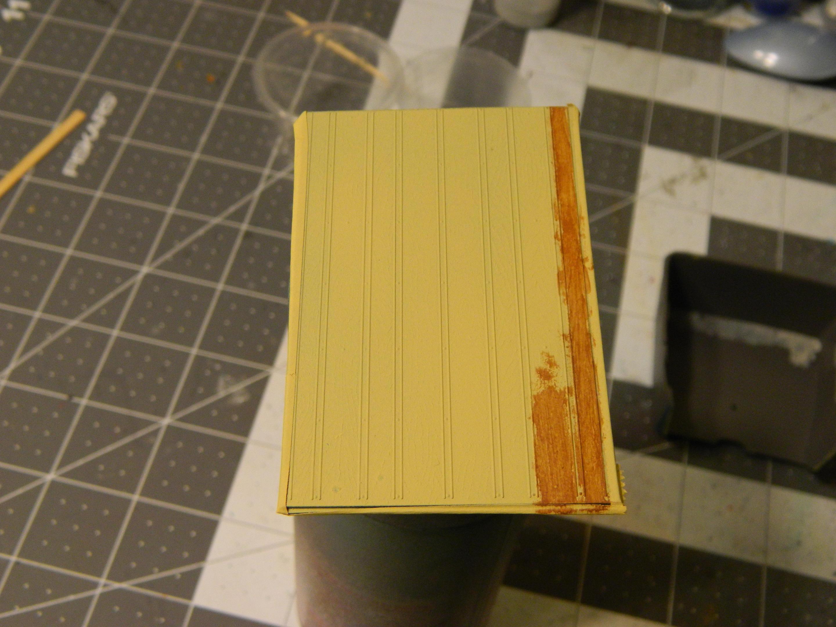

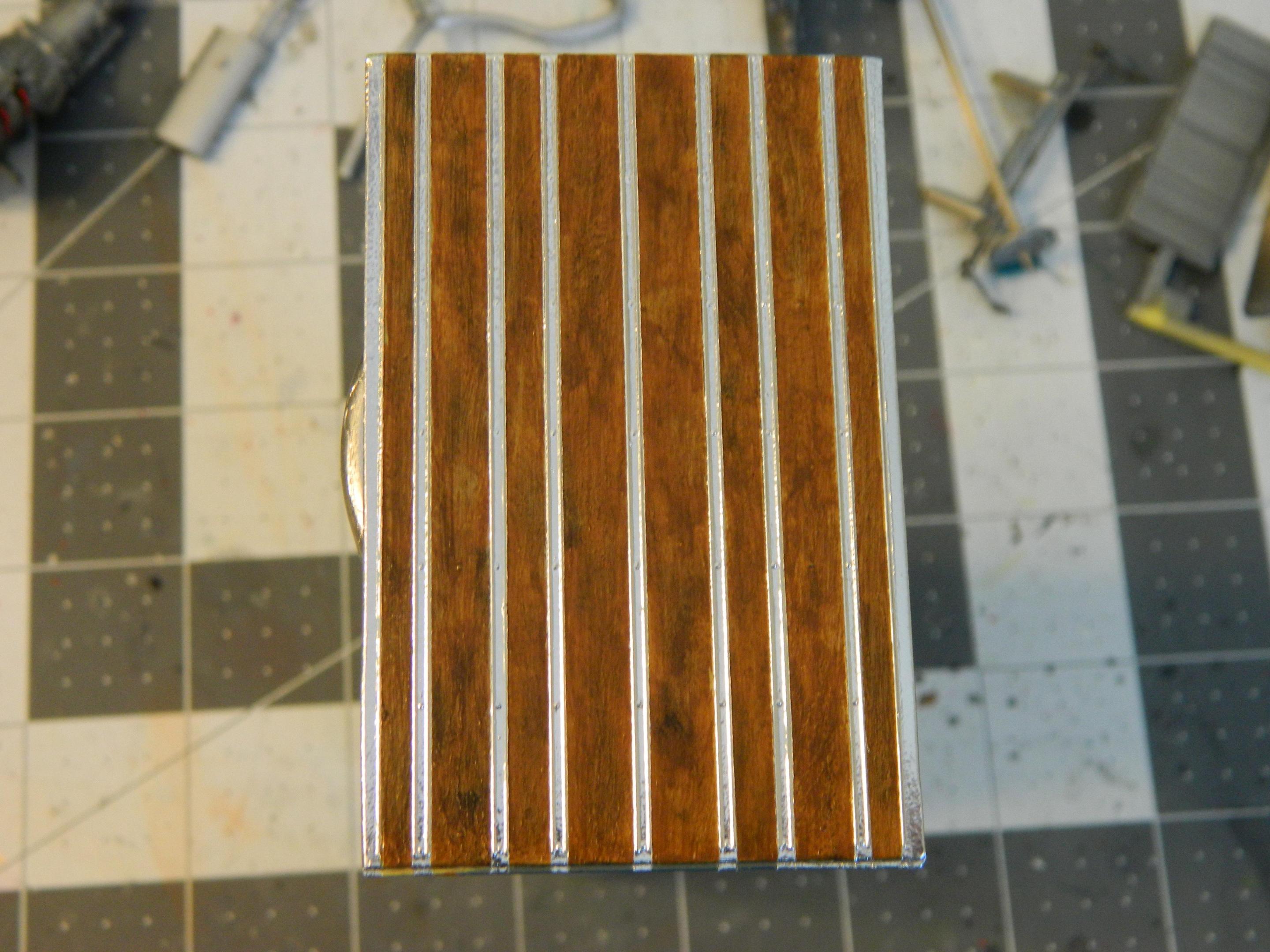

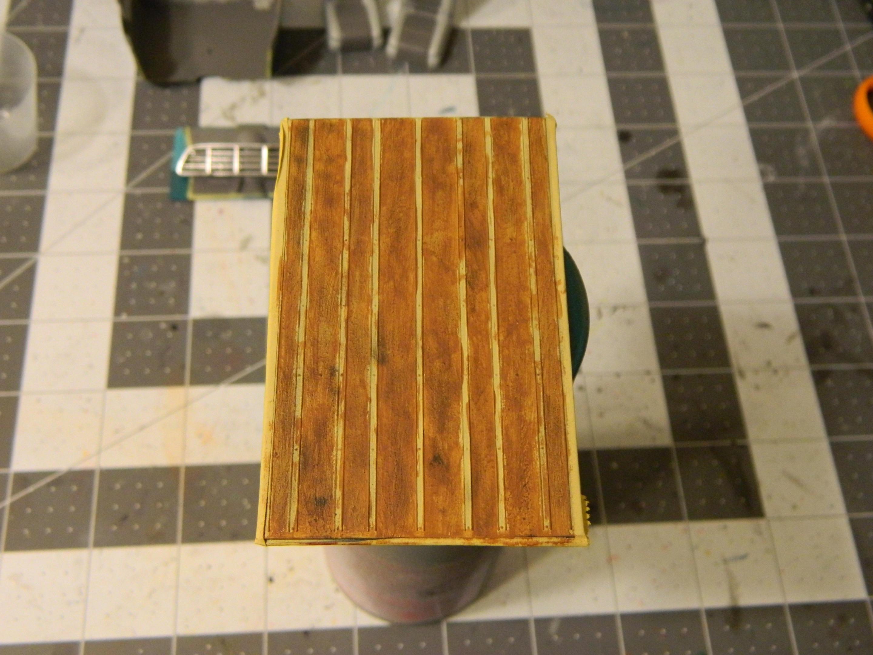

Dragonhawk1066 Posted February 23, 2022 Author Posted February 23, 2022 Then it was time to make something of the woodgrain bed floor. I airbrushed the piece with Apple Barrel Khaki craft paint. I then brush painted Apple Barrel Nutmeg Brown over the Khaki, making sure not to get any thick spots. After that I dry-brushed Delta Ceramcoat Black using both straight strokes and a swirling motion to try to give it a natural look. It turned out pretty good, so I brushed on a coat of Matte Varnish and let it dry overnight. In the morning, I taped off the the bed and trimmed out the slats to airbrush the Molotow Chrome. When that was done, I carefully pulled up the tape and surprised myself with what I think is a pretty nice looking woodgrain bed. 1

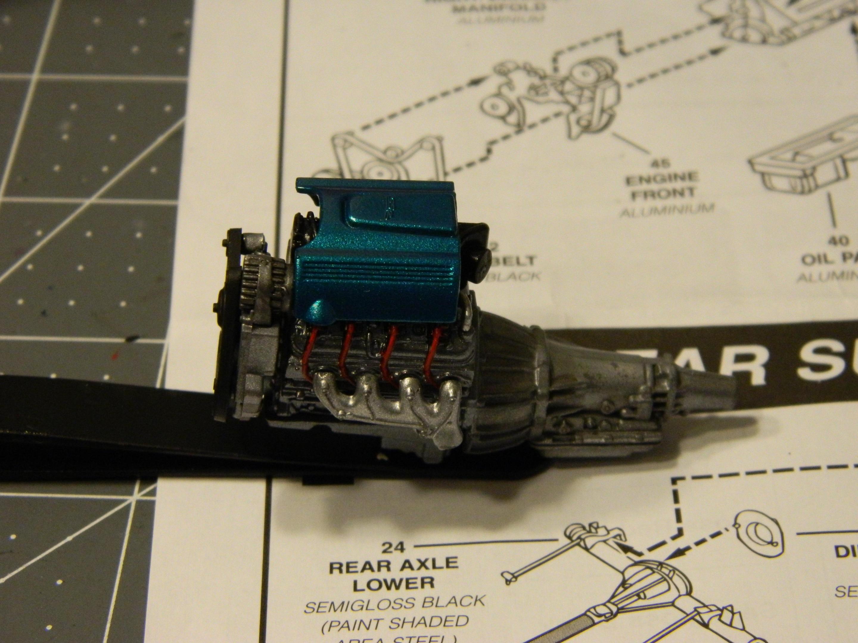

Dragonhawk1066 Posted February 23, 2022 Author Posted February 23, 2022 The engine was painted with Decoart Dazzling Metallics Zinc, the transmission in aluminum, and then detailed and assembled.

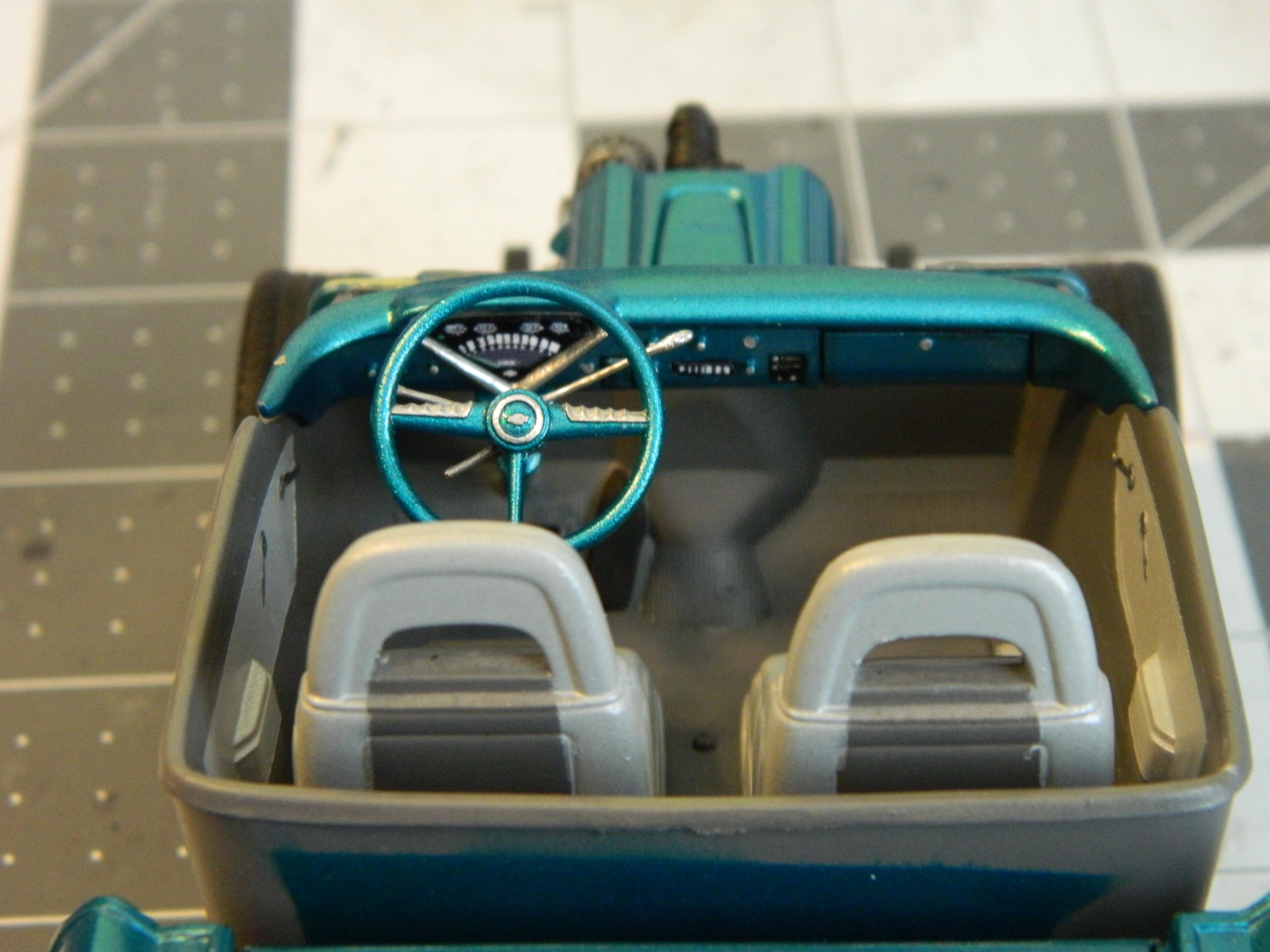

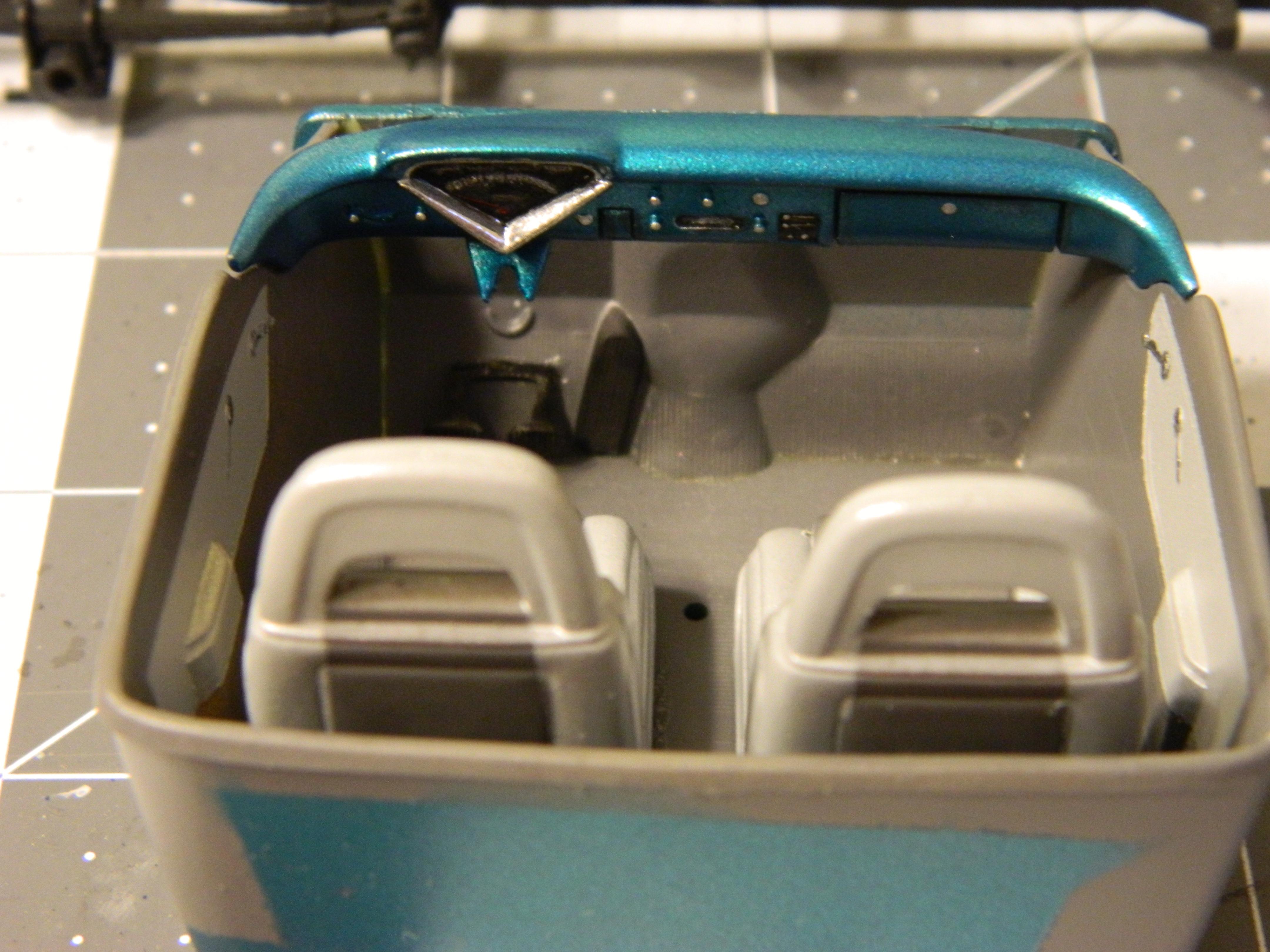

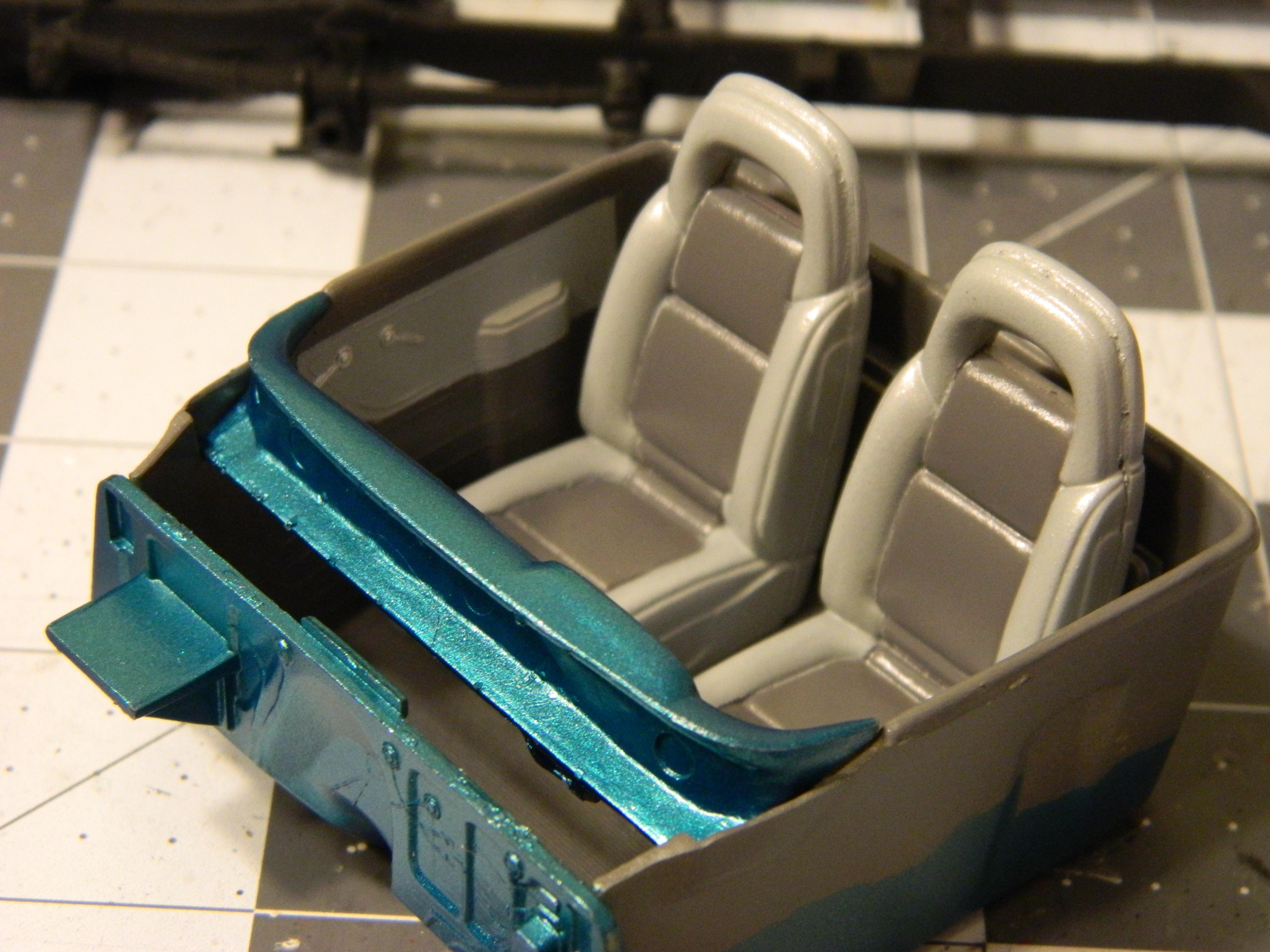

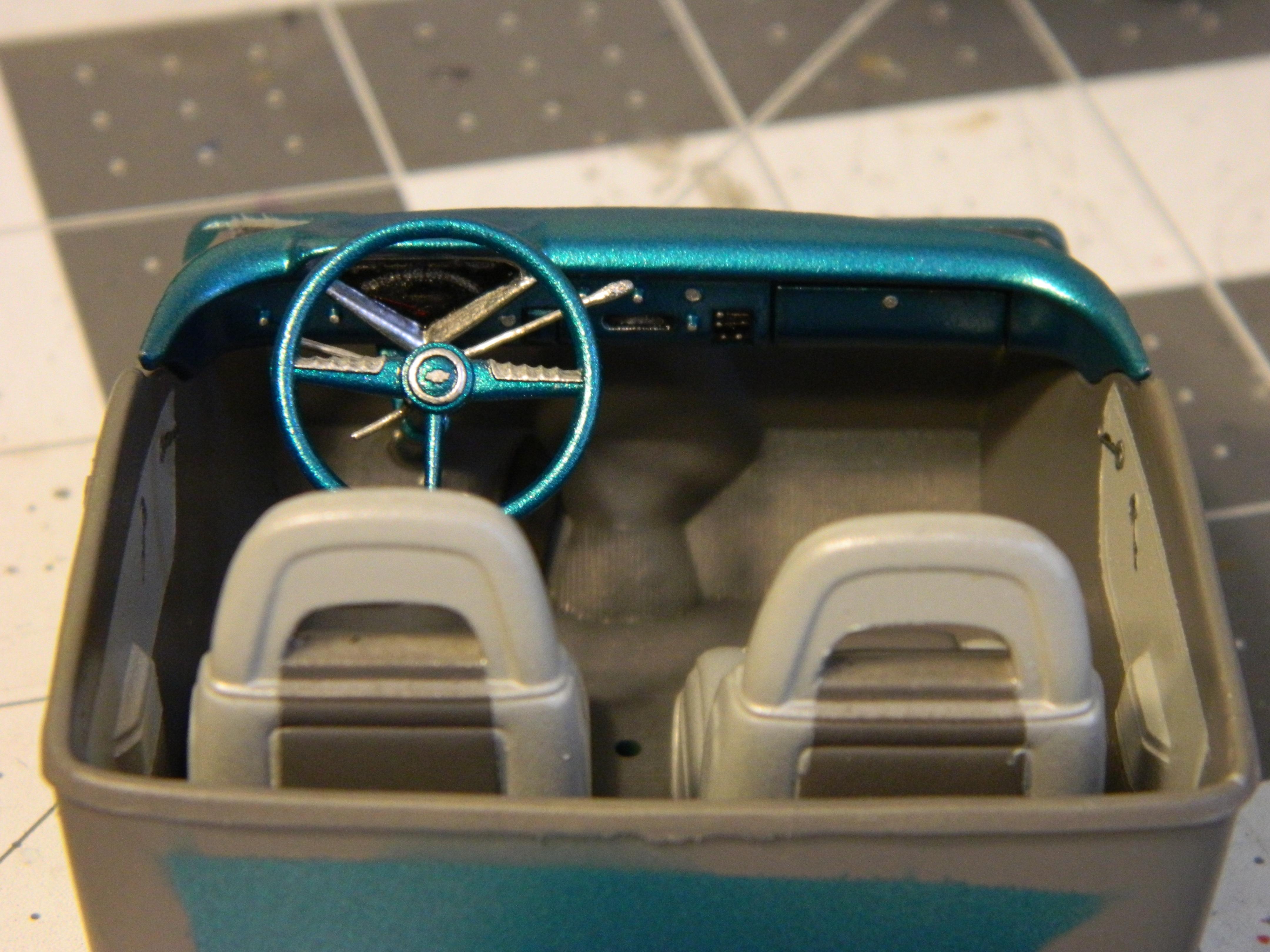

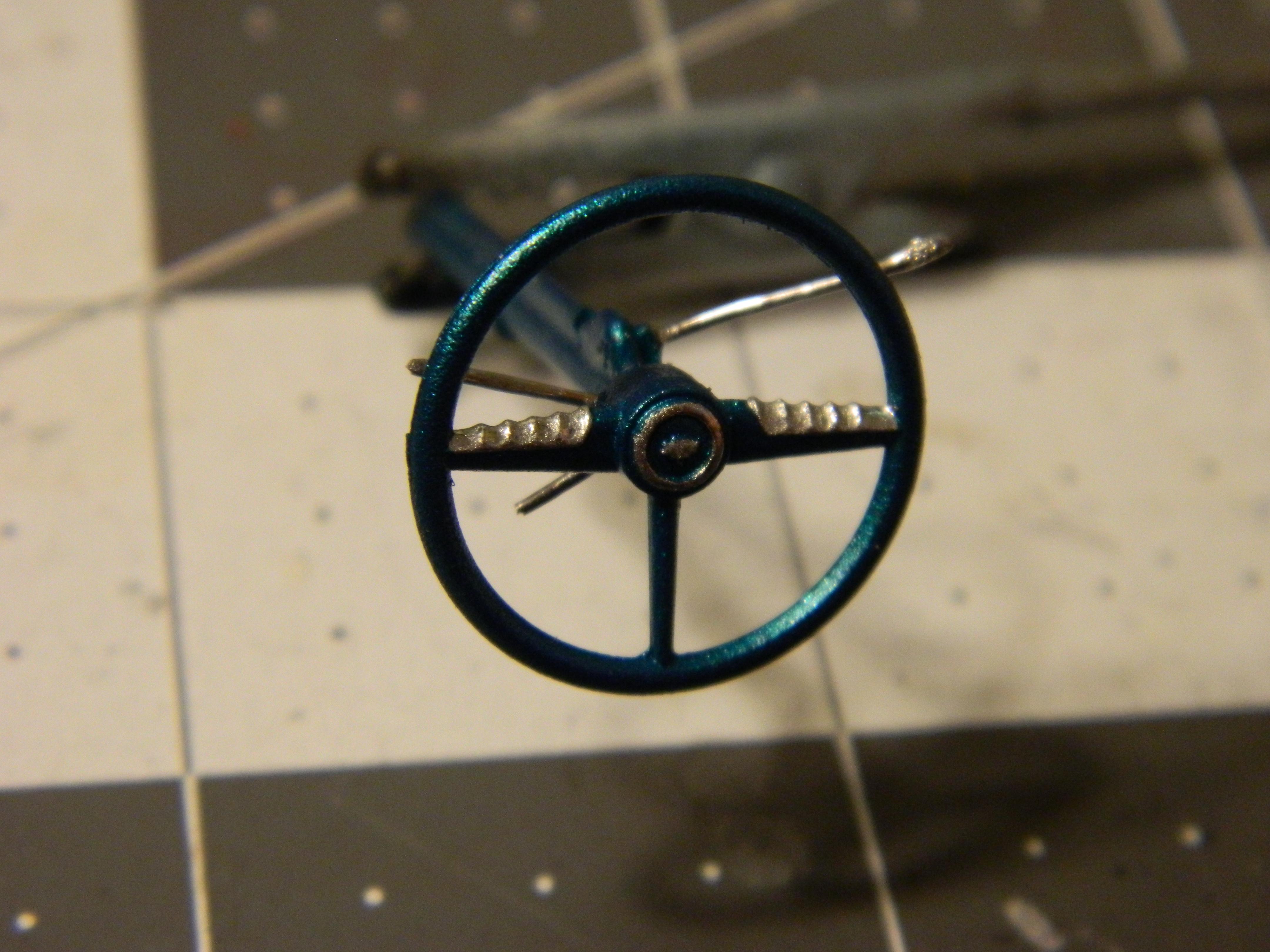

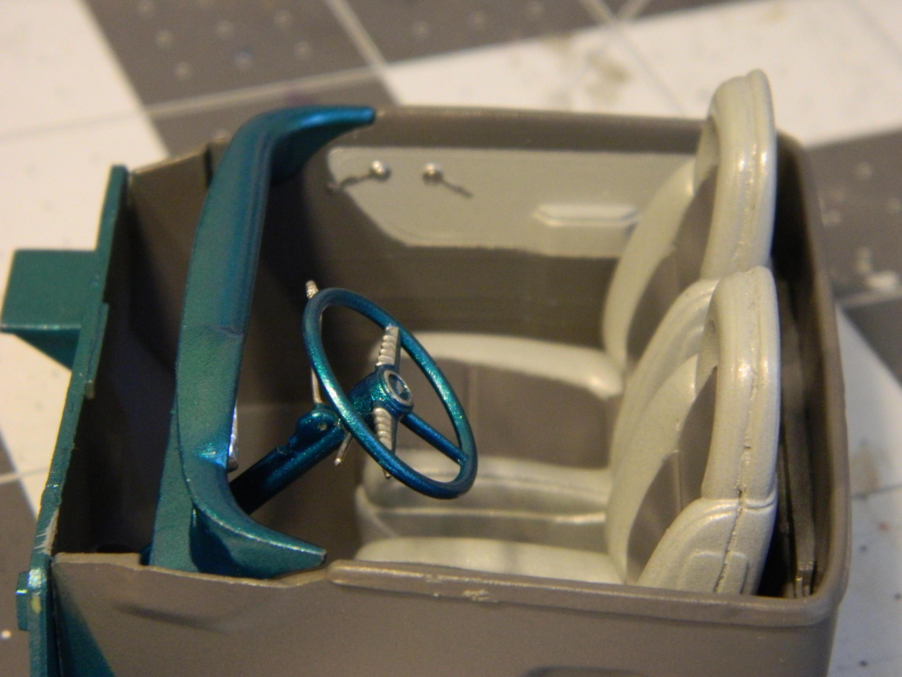

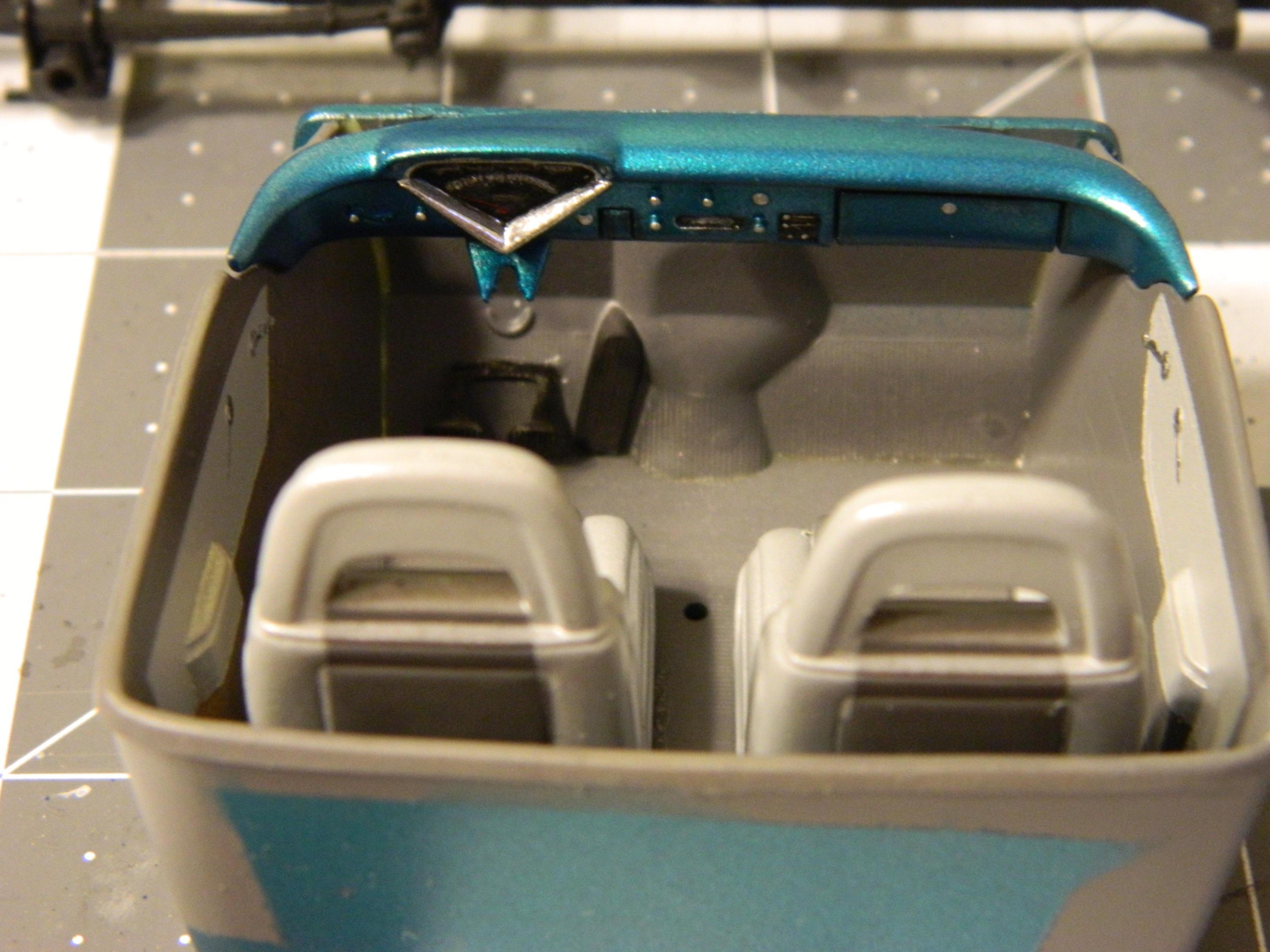

Dragonhawk1066 Posted February 23, 2022 Author Posted February 23, 2022 The interior tub was left in the gray primer, and the seats were given a two-tone using a custom mix of craft paints. I hand painted the door handles and window cranks with Molotow Chrome. The gauge cluster was painted and detailed and Molotow was also used for the bezel. I painted Molotow on the steering wheel, and drilled holes and used wire for the column shifter, turn signal, and tilt wheel lever.

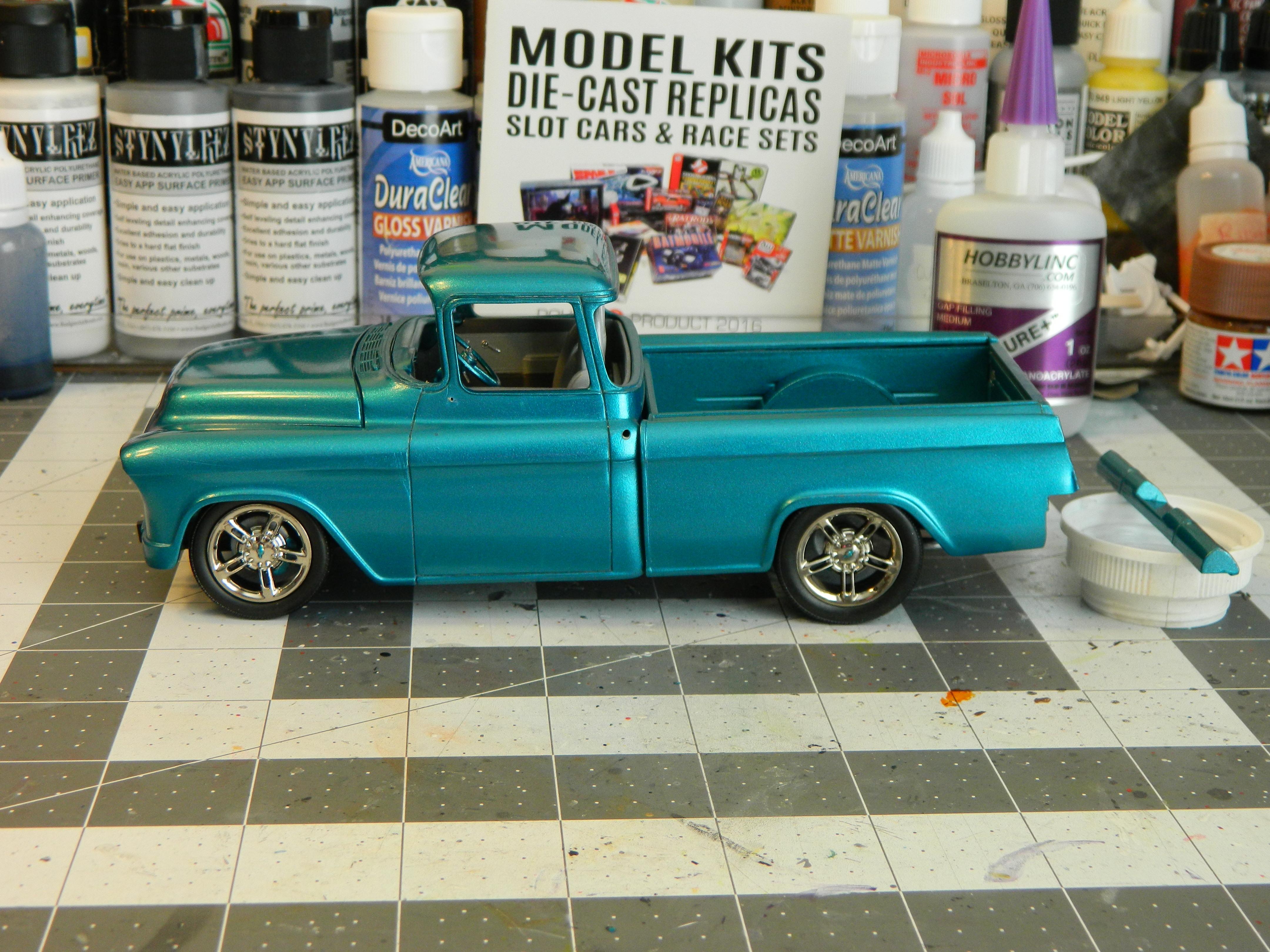

Dragonhawk1066 Posted February 23, 2022 Author Posted February 23, 2022 And finally to get things current, I spent the morning wet-sanding and polishing the body parts. I ended up using Micro Mesh Polishing Pads starting at 6000, then 8000, and 12000. After that was some Novus #2 polish and then Meguiar's Ceaner Wax. I tried starting wet-sanding with 4000 and then 6000 wet/dry sandpaper, but both were too abrasive for the Createx UVLS Clear, so the polishing pads ended up being the perfect starting point. I really like my experience with these Createx Paints so far.
espo Posted February 23, 2022 Posted February 23, 2022 Beautiful looking paint finish and color. Very realistic looking wood bed. 1
Mr. Metallic Posted February 23, 2022 Posted February 23, 2022 Great color for the body. And thanks for sharing your faux-wood technique. 1
bisc63 Posted February 25, 2022 Posted February 25, 2022 On 2/22/2022 at 6:34 PM, Dragonhawk1066 said: The engine was painted with Decoart Dazzling Metallics Zinc, the transmission in aluminum, and then detailed and assembled. Those have a nice appearance, are they sprayed or brushed on? Curious if they can be brushed ?
Dragonhawk1066 Posted February 25, 2022 Author Posted February 25, 2022 1 hour ago, bisc63 said: Those have a nice appearance, are they sprayed or brushed on? Curious if they can be brushed ? Thanks, I airbrushed them. I airbrush craft paints all the time, mostly for engines, chassis, and interiors. I have also airbrushed several bodies with the metallics. They definitely need to be thinned though. I started using just plain blue automotive windshield washer fluid, which works well. I now use a "homebrew" thinner that consists of 3 parts distilled water, 1 part isopropyl alcohol, and 5-6 drops of glycerin, as a flow improver, per 8 oz. batch and the results are great. 1 1

Dragonhawk1066 Posted February 27, 2022 Author Posted February 27, 2022 Thanks for the great comments everyone! I finished the interior and pinned the SSR side view mirrors. I also sprayed on two coats of Tamiya Smoke to tone down the wheels.

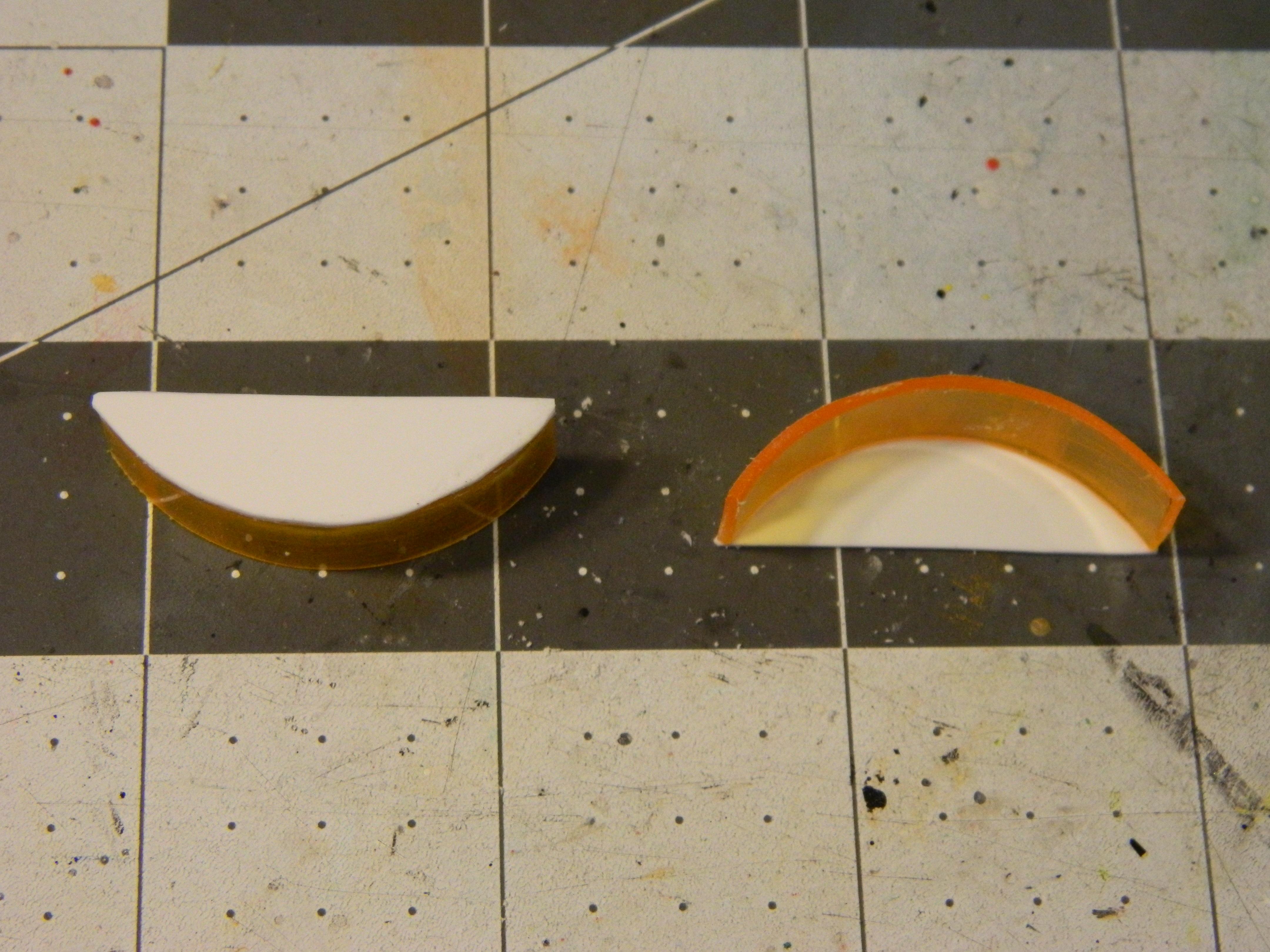

Dragonhawk1066 Posted February 27, 2022 Author Posted February 27, 2022 My initial mock-up showed I had clearance for the rear wheels, but while assembling the bed, I noticed that I was mistaken, and surgery was in order. I measured and cut out the inner bed wall, and then very carefully cut pieces out of the bed floor. I used a pill bottle to make the arches and .020 sheet styrene to fill in the arches. I thought I had everything measured correctly, so I primed, painted and cleared the fender tubs with Pledge yesterday. Upon re-assembling the bed this morning, it was apparent that the tubs were just a bit too small. So, back to the pill bottle and sheet styrene to make a couple more to be painted Monday.
Oldcarfan27 Posted February 27, 2022 Posted February 27, 2022 I like the pill bottle idea, I may use that. But I probably want to leave them clear. Sounds like it would be cool to show off the wheels and suspension detail. The woodgrain detail came out great!

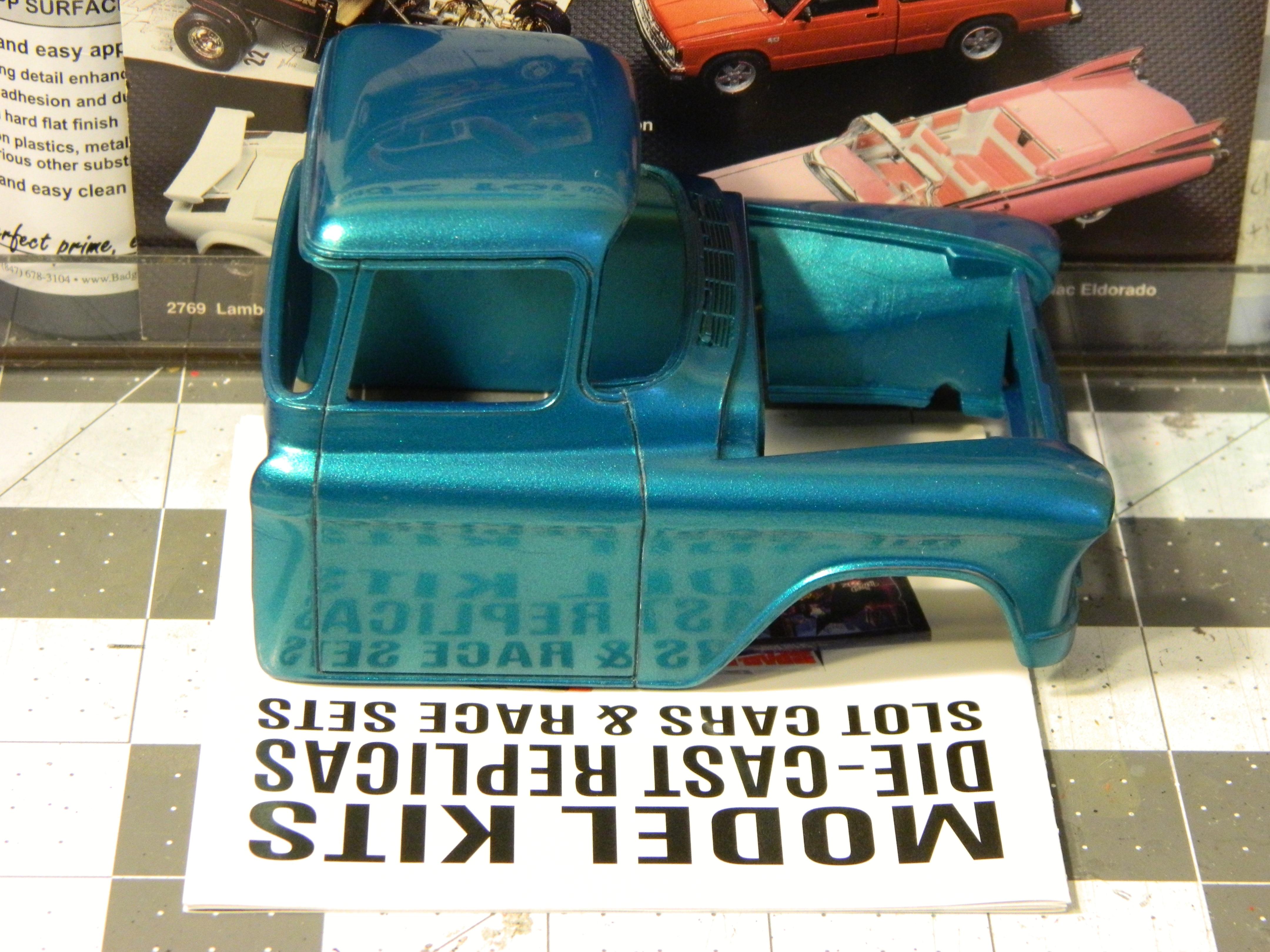

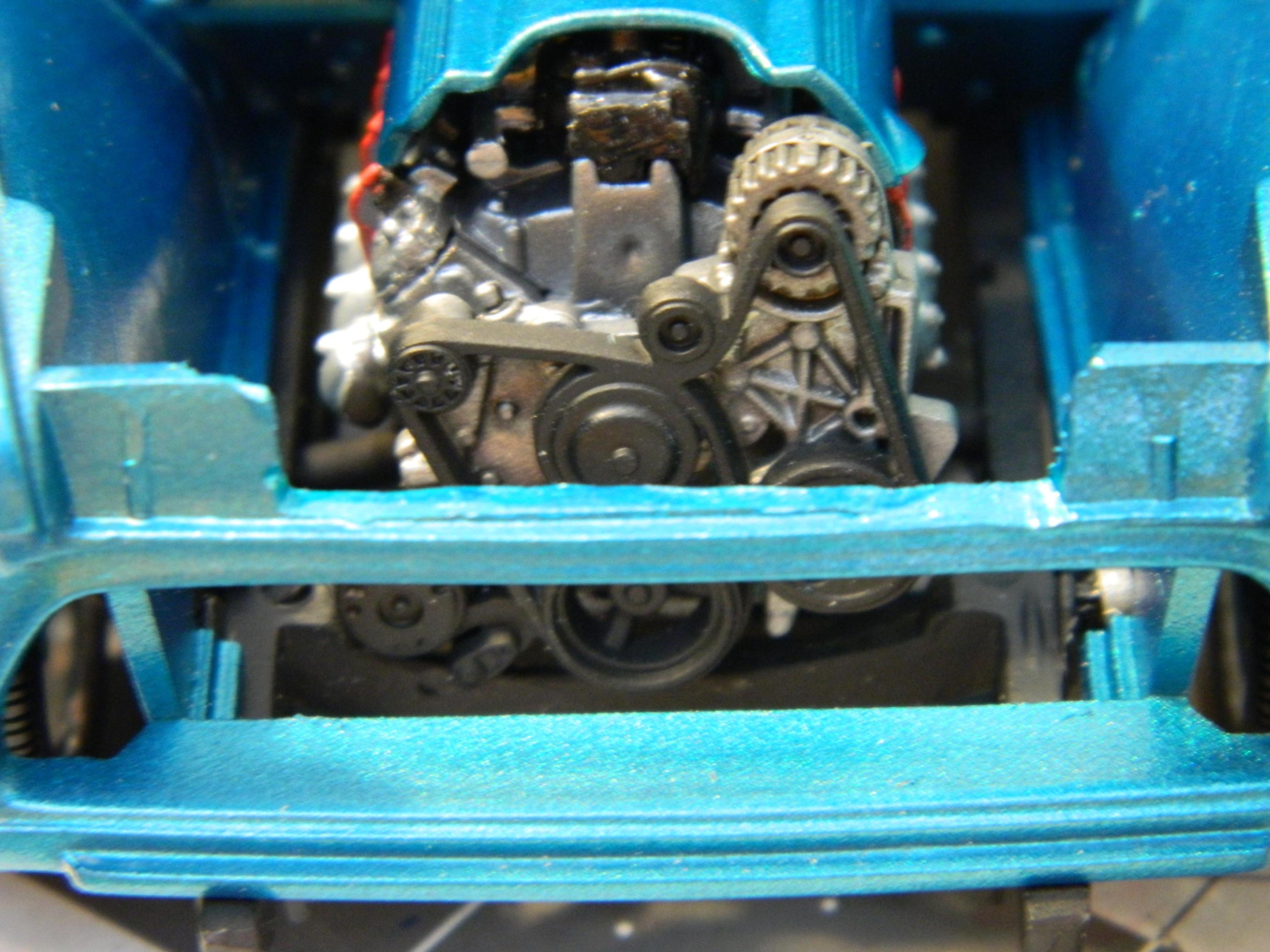

Dragonhawk1066 Posted March 9, 2022 Author Posted March 9, 2022 I finally got back to the Cameo after my gauge decals came in. Here's a little before and after. I also had to perform some surgery to get the radiator and electric fan from the SSR to fit. Before I put it away last week, I also had to tweak the cab/bed assemblies for a more precise fit. It's getting real close now!
