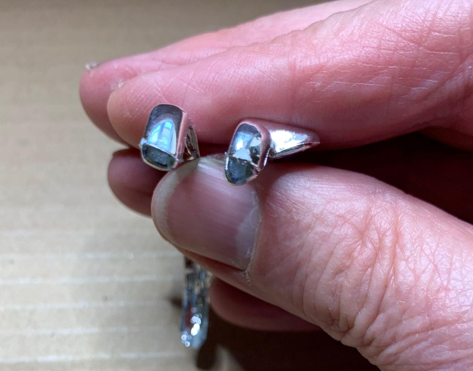

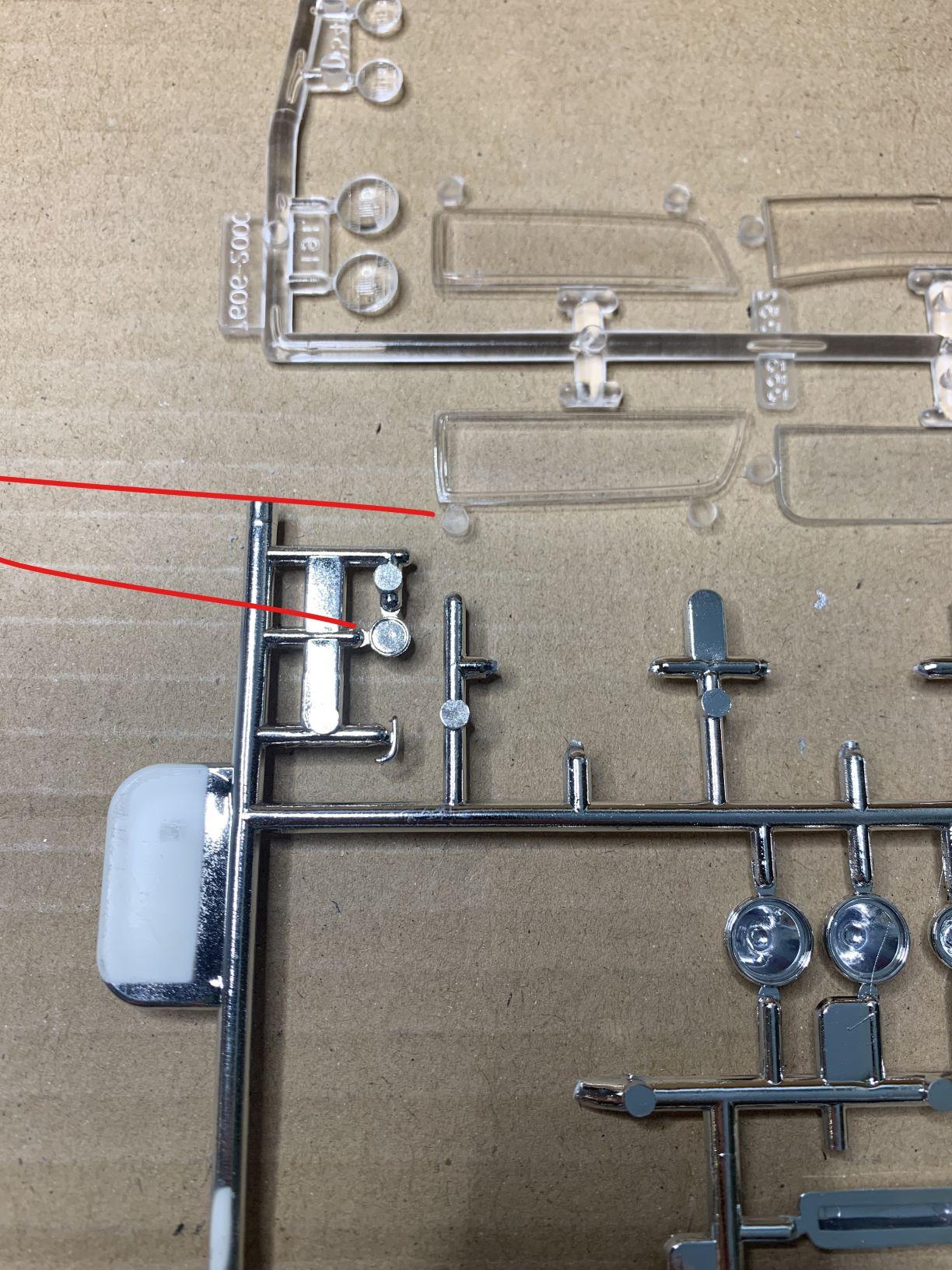

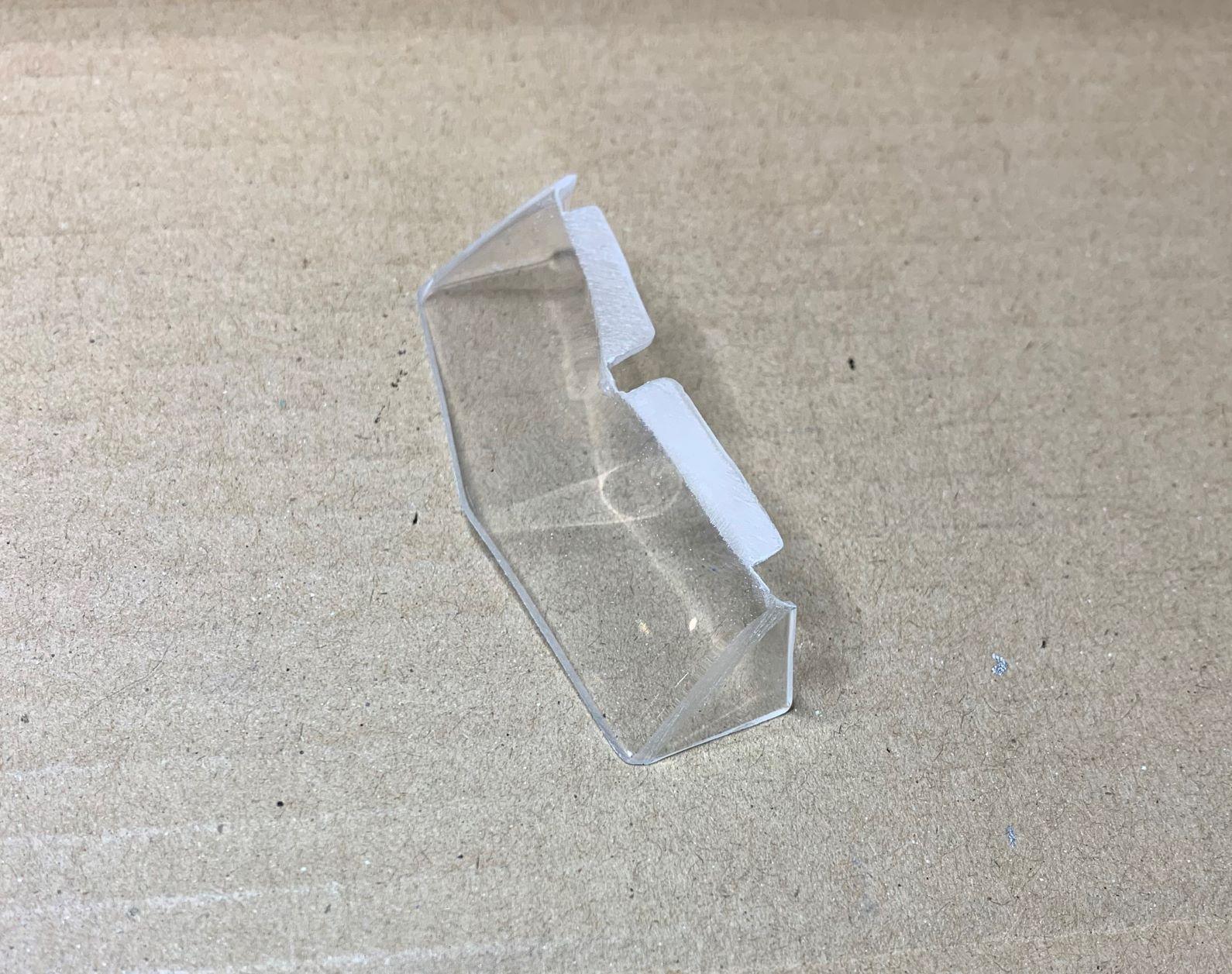

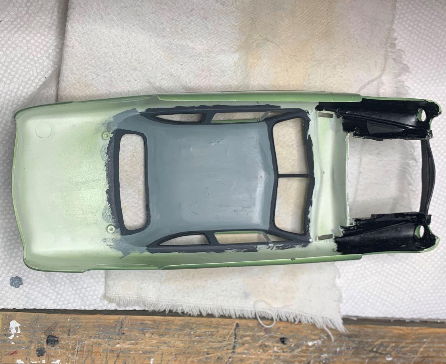

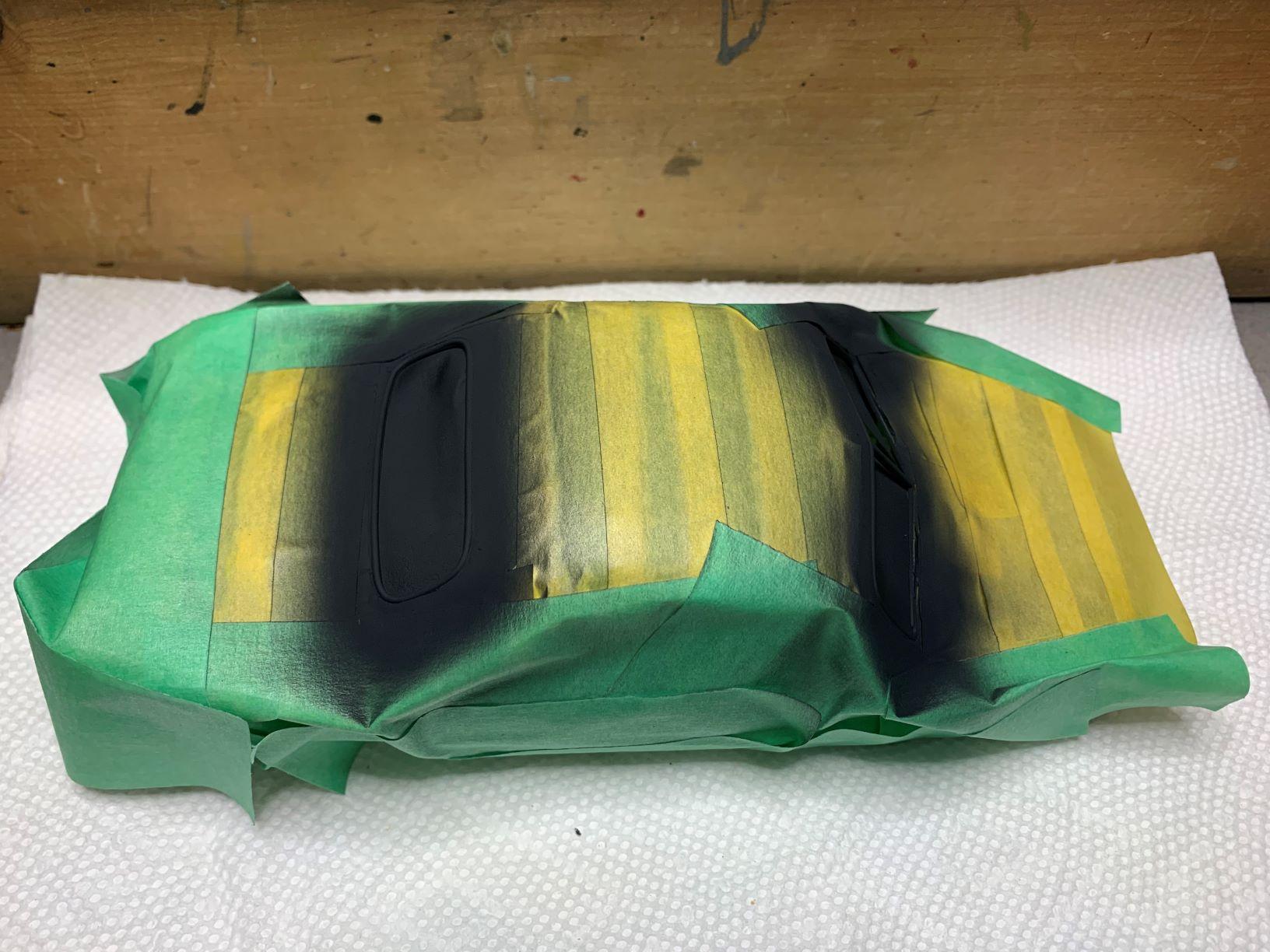

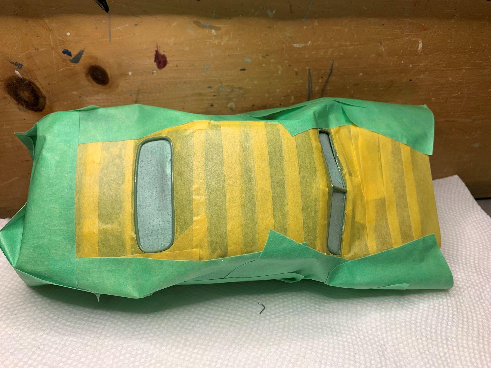

dino246gt Posted April 18, 2022 Author Posted April 18, 2022 I wanted rubber, not chrome around the windows, so I masked, AND airbrushed Tamiya acrylic rubber thinned 50/50. Then I brushed acrylics to the headliner and around the windows inside. (this is the car upside down looking in) I made a dome light with a '32 Ford kit's chrome mirror and a piece of the clear throw-away things. I reshaped the windshield for somewhat of a sunvisor look inside. (actually turned out pretty good once painted.

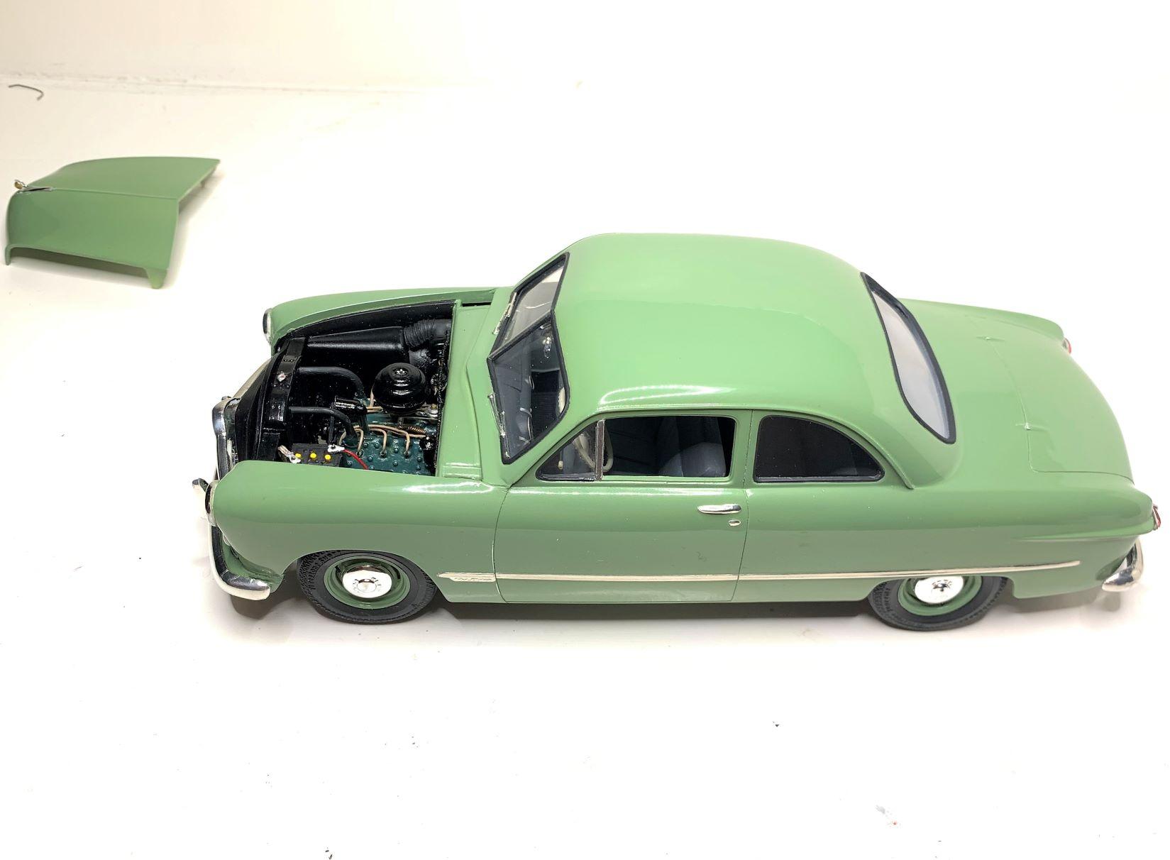

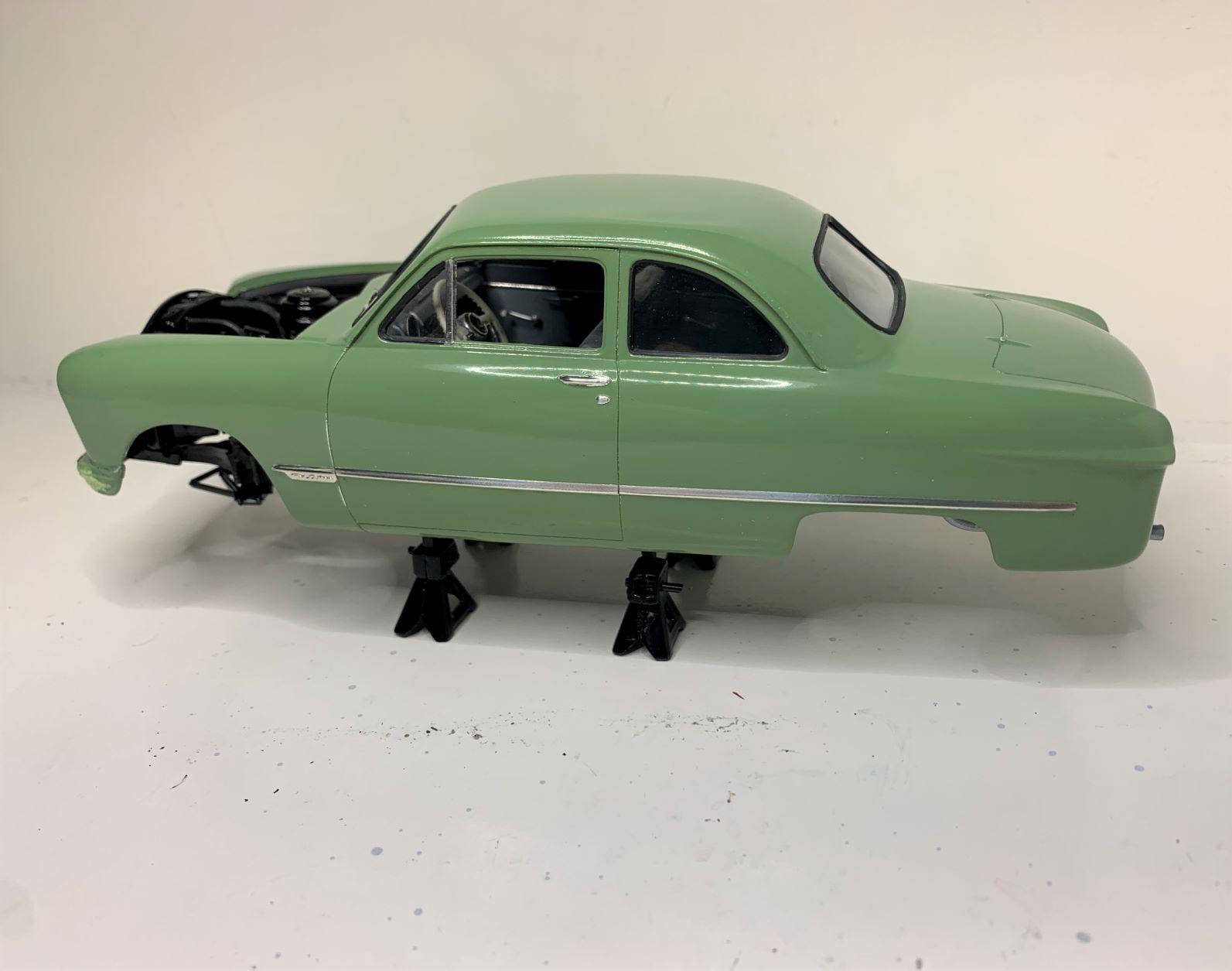

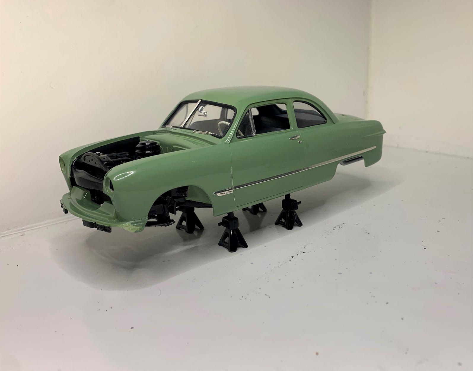

dino246gt Posted April 19, 2022 Author Posted April 19, 2022 I got the glass, interior and chassis all glued together! I believe that's called the marriage. Now just the "honeymoon" left!!! I want to have this finished by the weekend.

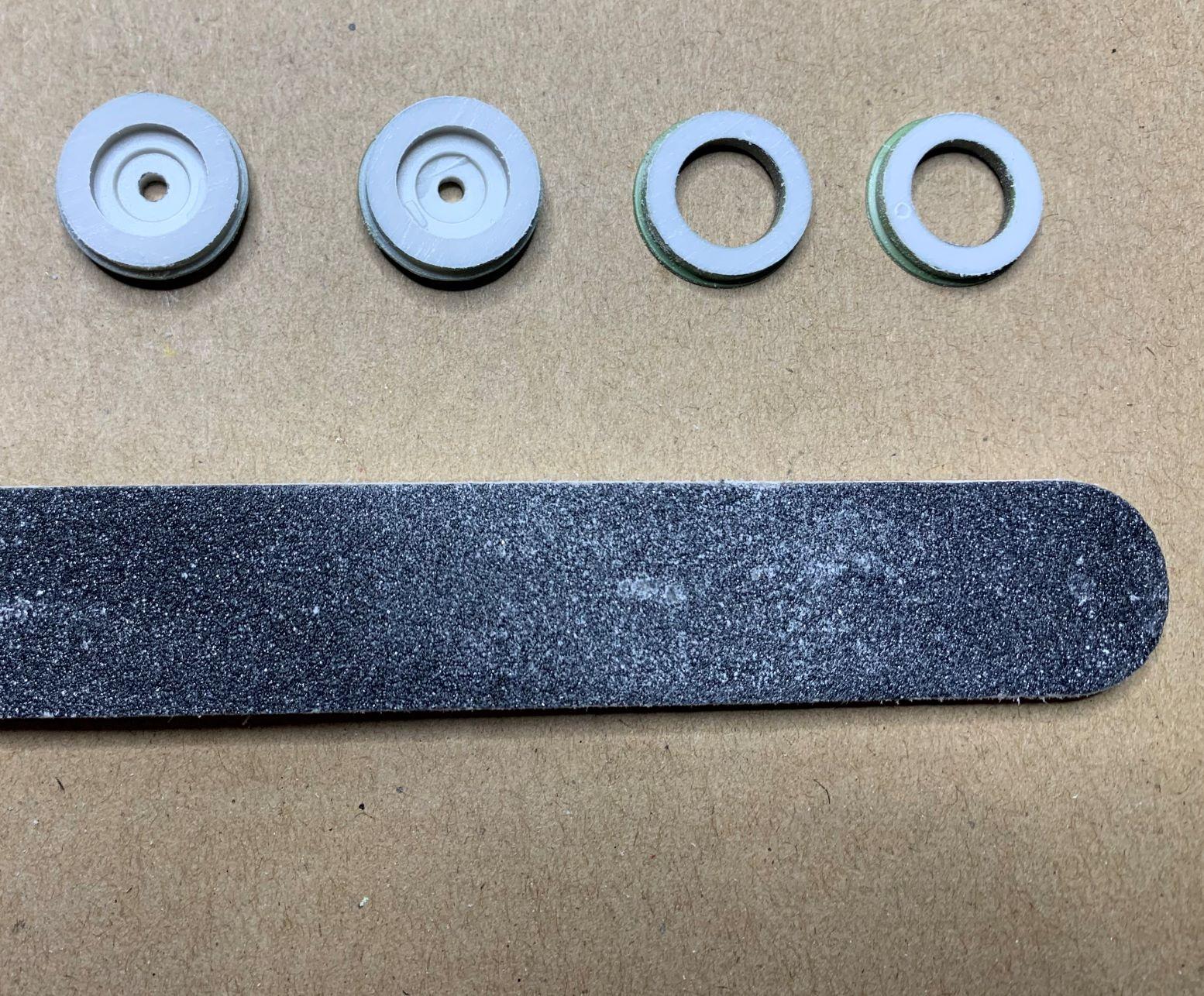

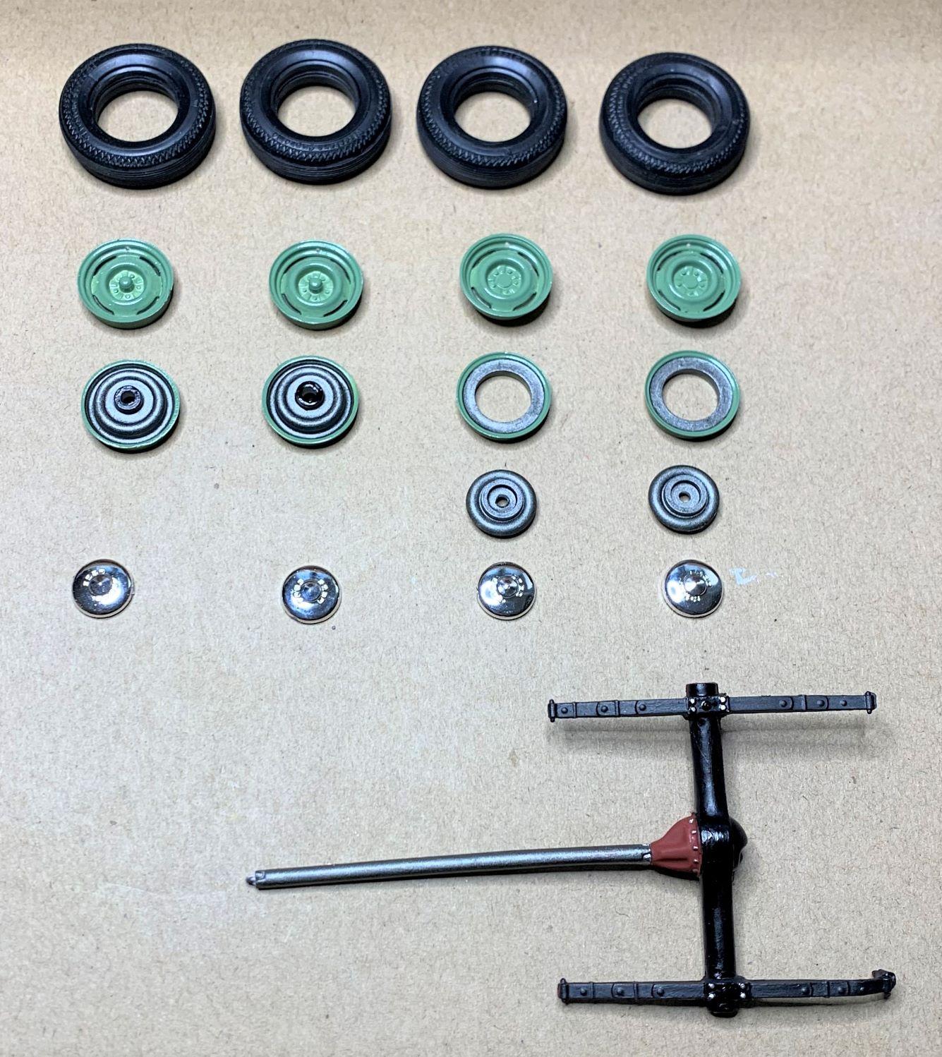

dino246gt Posted April 21, 2022 Author Posted April 21, 2022 (edited) The rims I had, well the fronts were damaged from sprue removal, so I'm using those as the rears, I can glue them with the damage up, hidden by the body. Won't matter that the fronts are in back and vise versa because I'm using hub caps, but I did have to switch the back halves of the rims. I sanded where the halves meet so the rims fit deeper into the tires, I like that look. I found some cool old Firestone tires in the parts box which I cleaned up and used. Drilled for valve stems, I use the same .030 ignition wire for these, a bit over size, but still cool to my eye, also did a black wash to highlight those 4 slots on the rims. Edited April 21, 2022 by dino246gt spelling

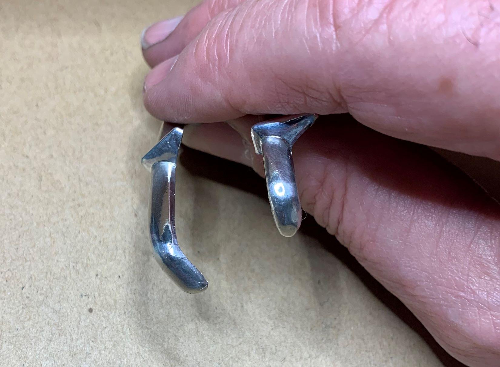

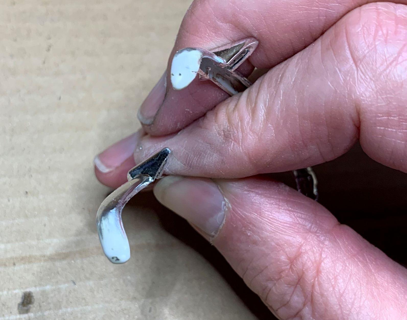

dino246gt Posted April 21, 2022 Author Posted April 21, 2022 (edited) The bumpers were also in poor shape, as usual the wrap-around corners need sanding. I foiled all 4 sanded corners. Of course I got little wrinkles where I tried to wrap the foil, but I think it's less of a "flaw" than the huge mold lines from the kit. After I install them, I'll polish the foil with Novus 2 for a better shine. Edited April 21, 2022 by dino246gt 1

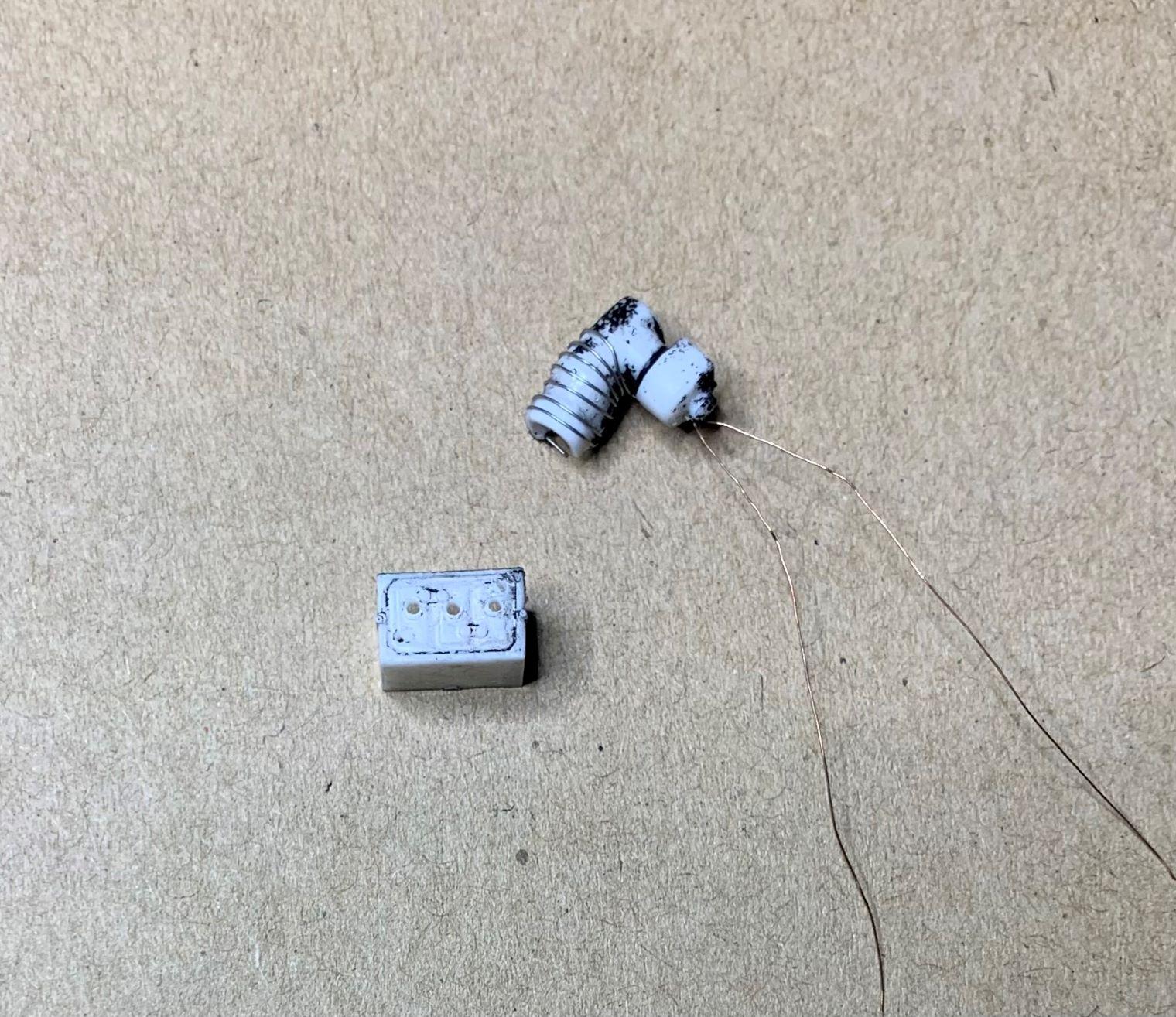

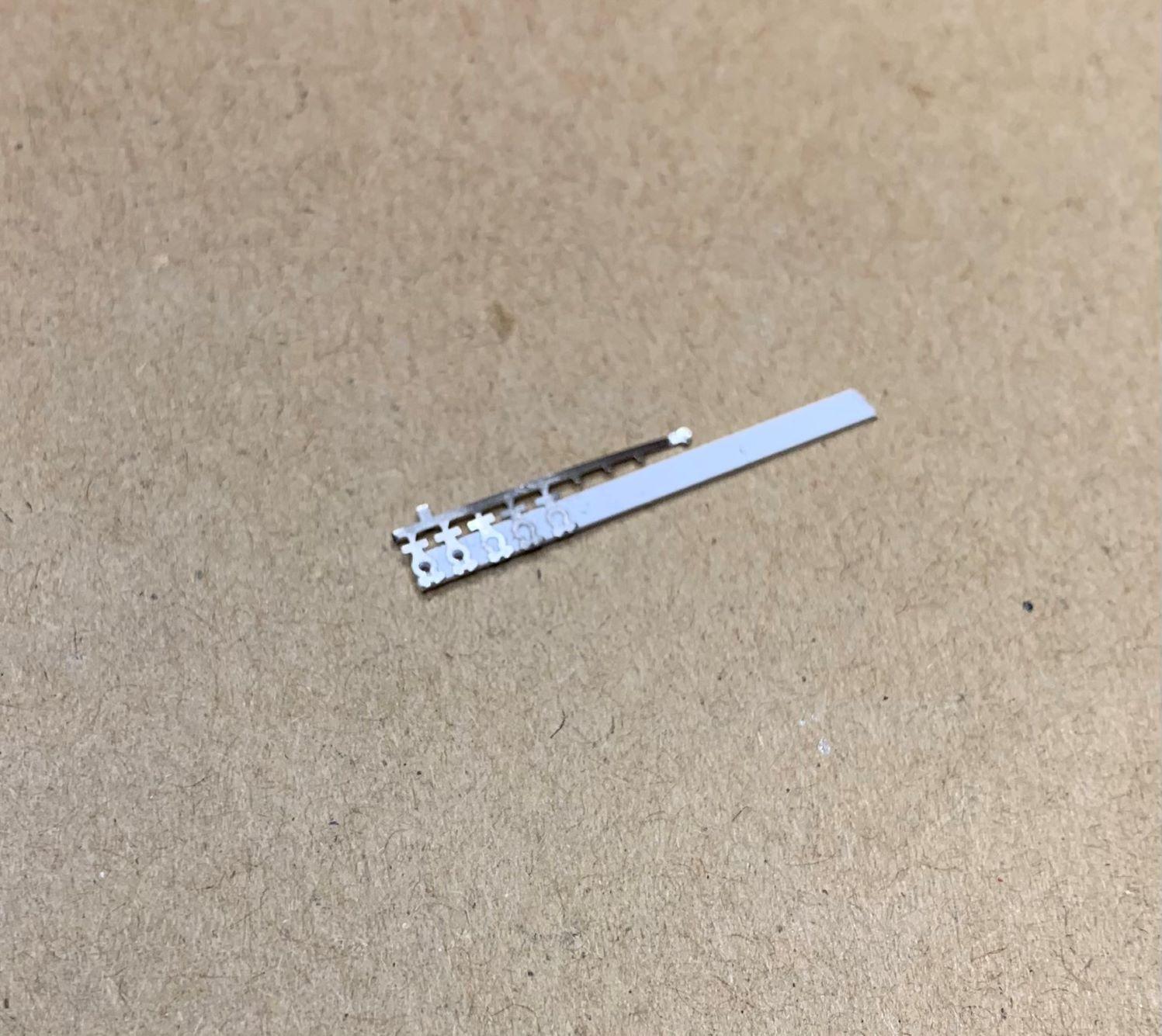

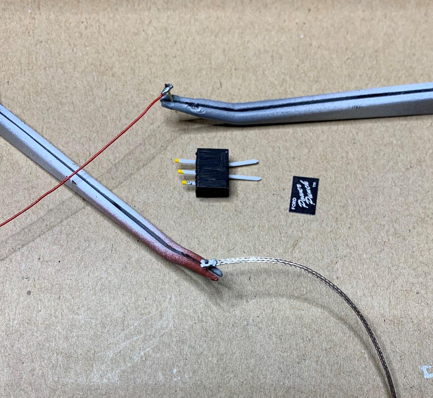

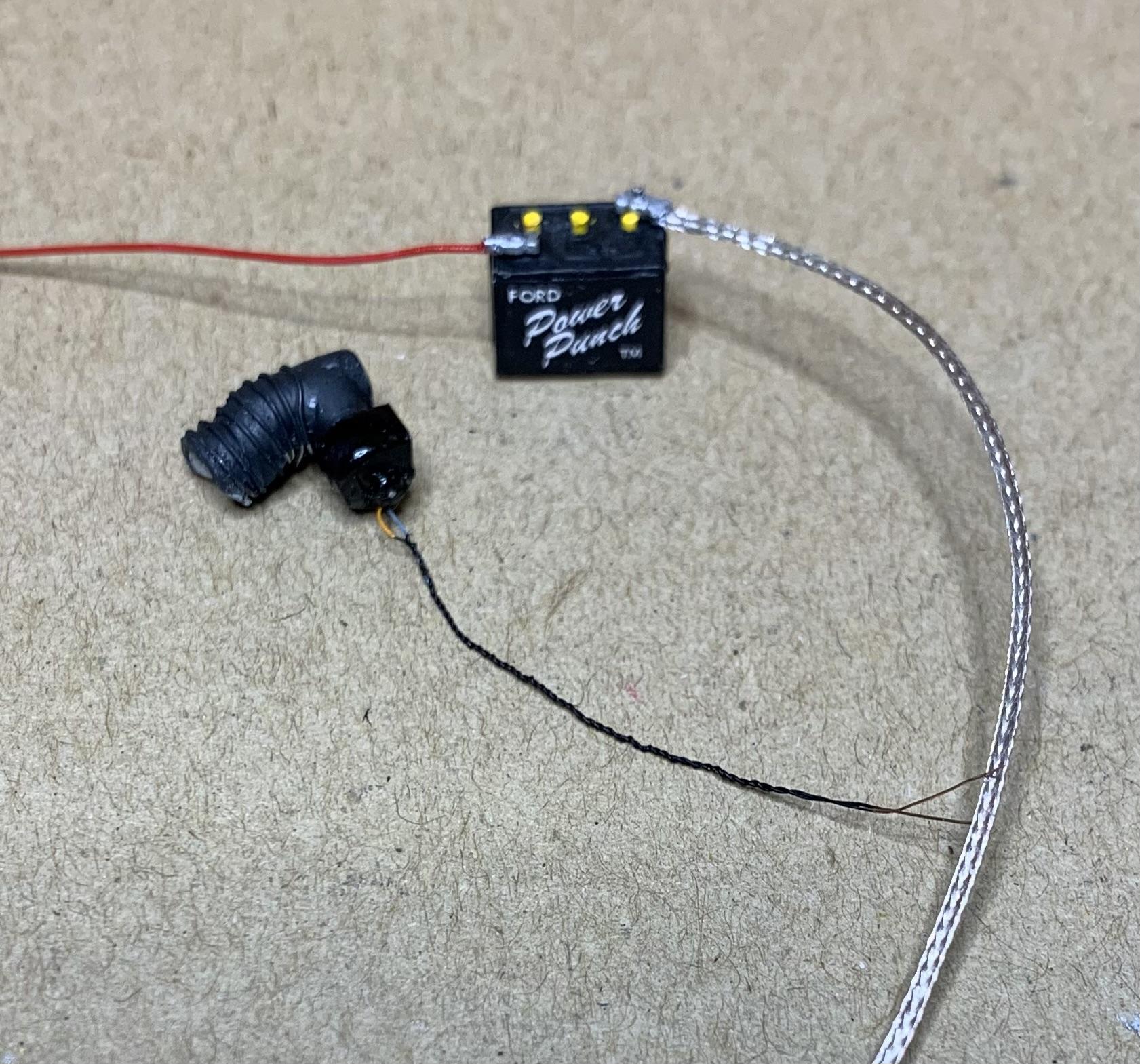

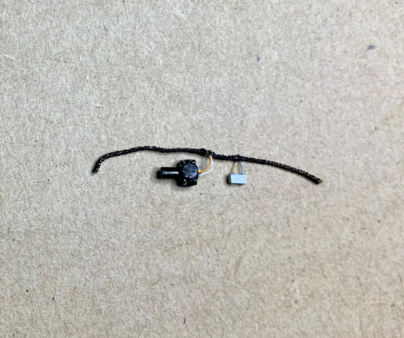

dino246gt Posted April 23, 2022 Author Posted April 23, 2022 I drilled out the old battery and added some simple detail to the heater motor. I glued photo-etch cable ends to a strip of .020 styrene then drilled and filed the styrene to follow the shape of the photo-etched parts. I added a center post, red wire and flat ground cable, then painted some .030 styrene rod with ends painted yellow for caps. Logo is just printed on a piece of plain paper. Here's the battery assembled and the heater motor. I also made up some "stuff" to put on the firewall, just scraps and sprue. 1

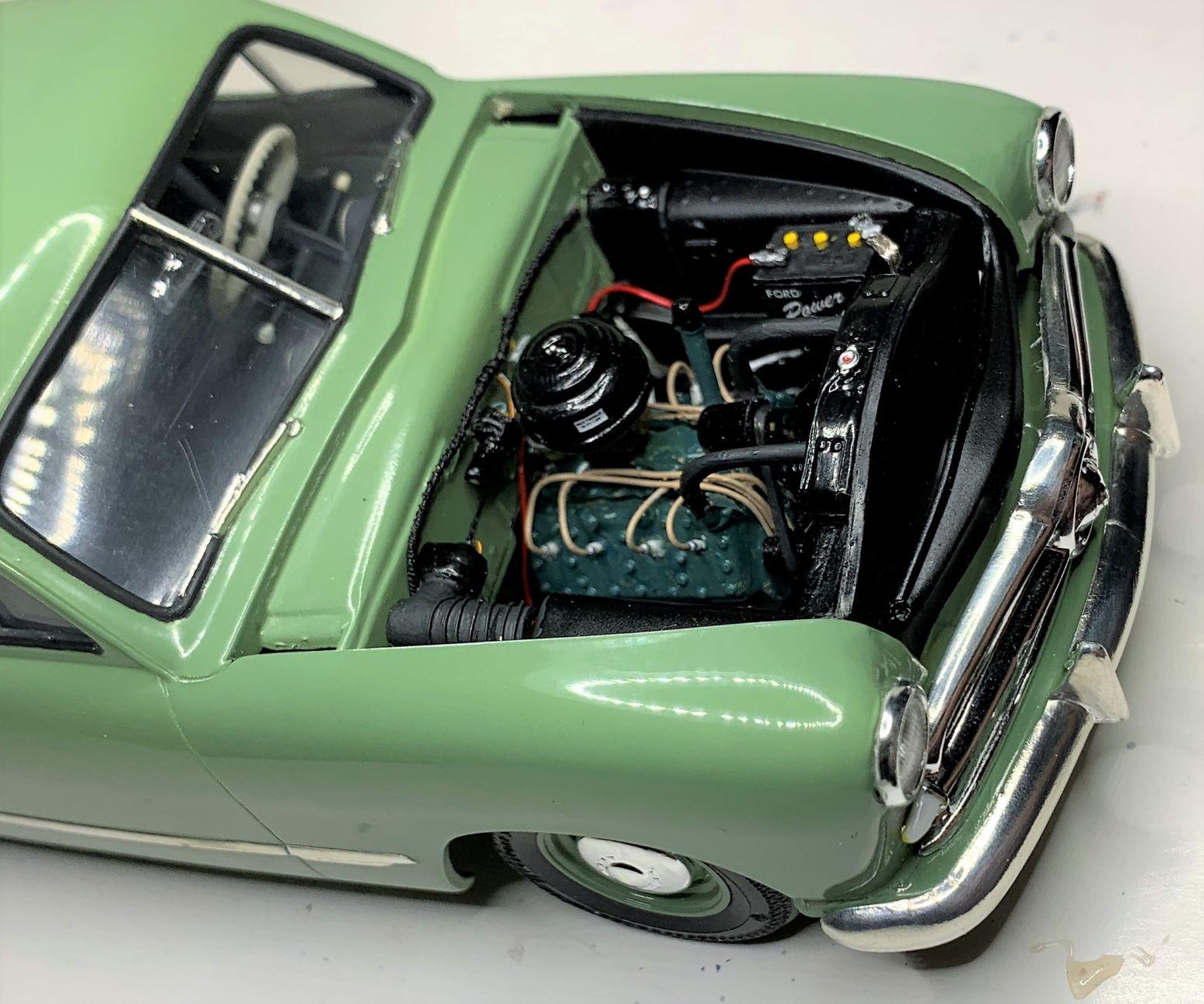

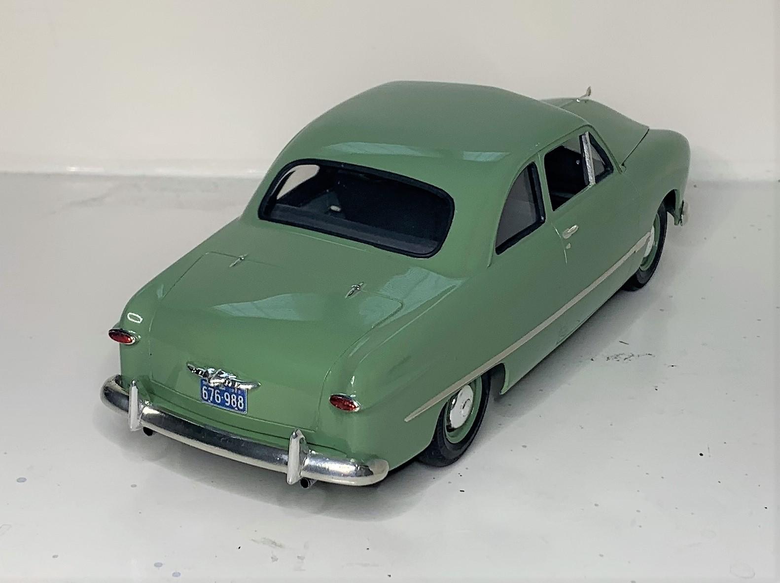

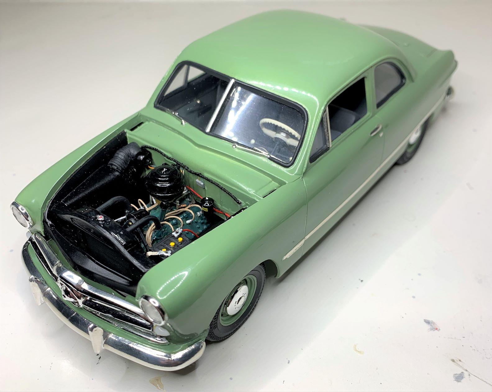

dino246gt Posted April 23, 2022 Author Posted April 23, 2022 (edited) Here's how all that stuff looks installed: Remember I didn't have a kit, so a lot of this is made from scraps, and what the glue bomb had attached. Do NOT have the trunk chrome handle, but I think I can trade for one with Jerry G. Edited April 23, 2022 by dino246gt 1
dino246gt Posted April 25, 2022 Author Posted April 25, 2022 (edited) I was able to score a trunk emblem from Jerry G. Thanks Jerry! I also foiled the rear trunk hinges, so I think this little glue bomb has been rescued! Edited April 25, 2022 by dino246gt 2
