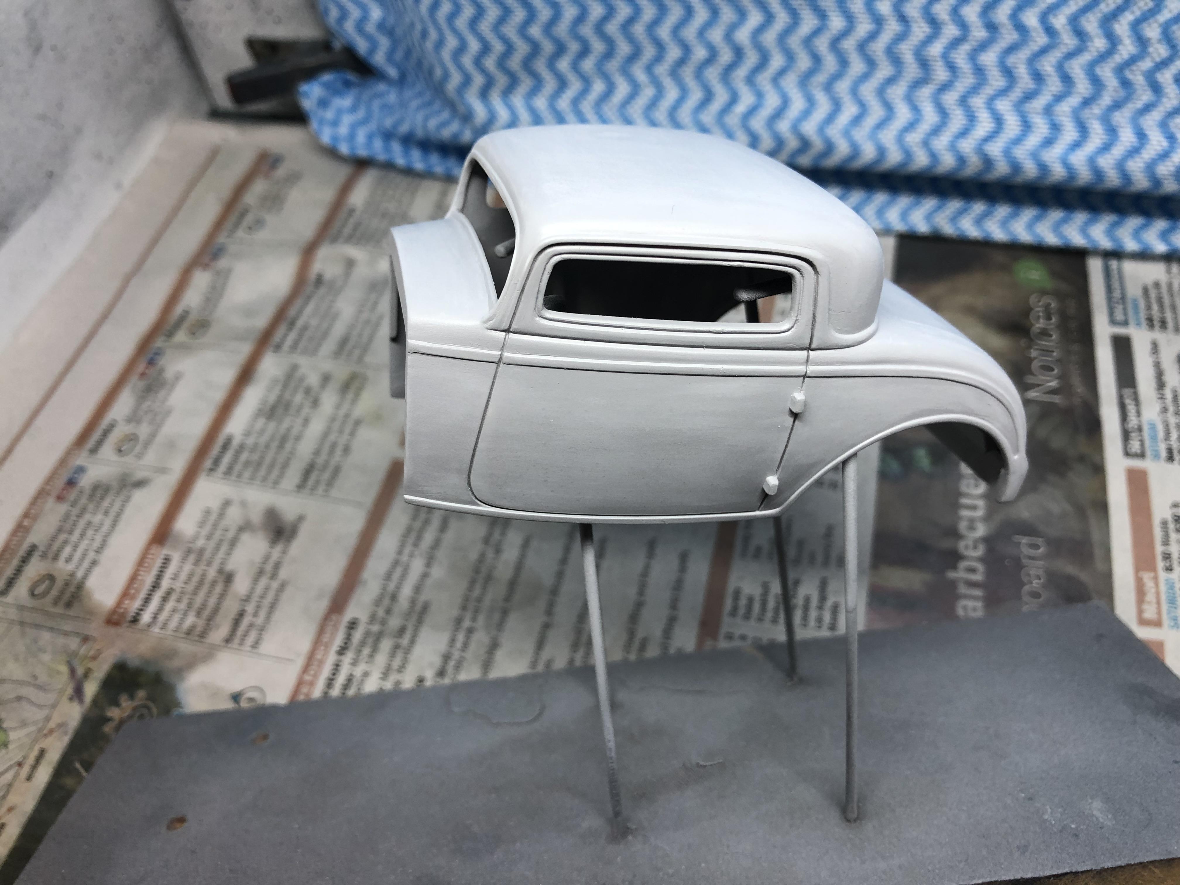

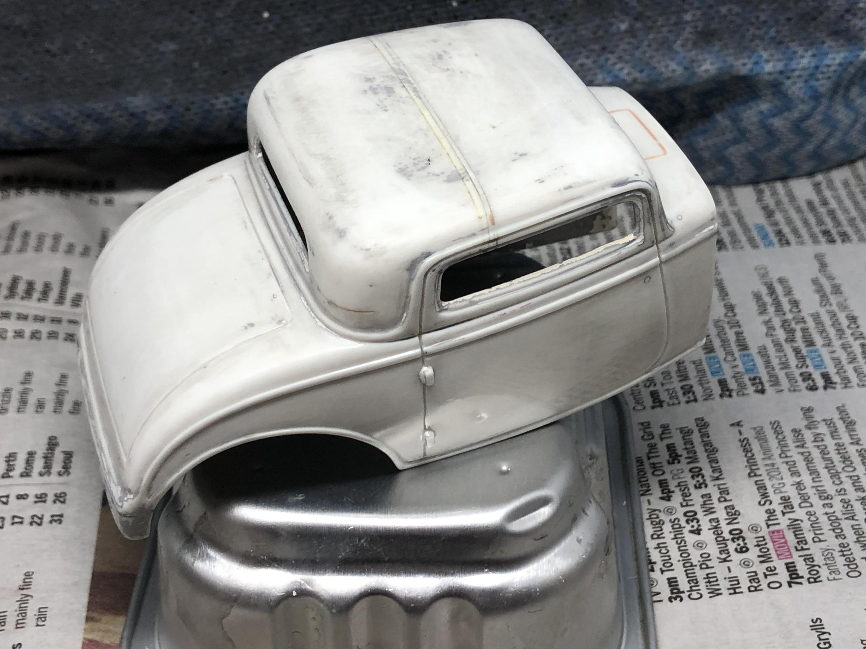

Just could not stand the refrigerator white paint - just does not scream hot rod. So into the dunk it goes. I use brake fluid and it took some effort with a brass wire brush, a toothbrush and a tooth pick to get all of the paint off but all the better for the effort
The chop job was a good one so hopefully not too much body work will be needed to get it ready for paint

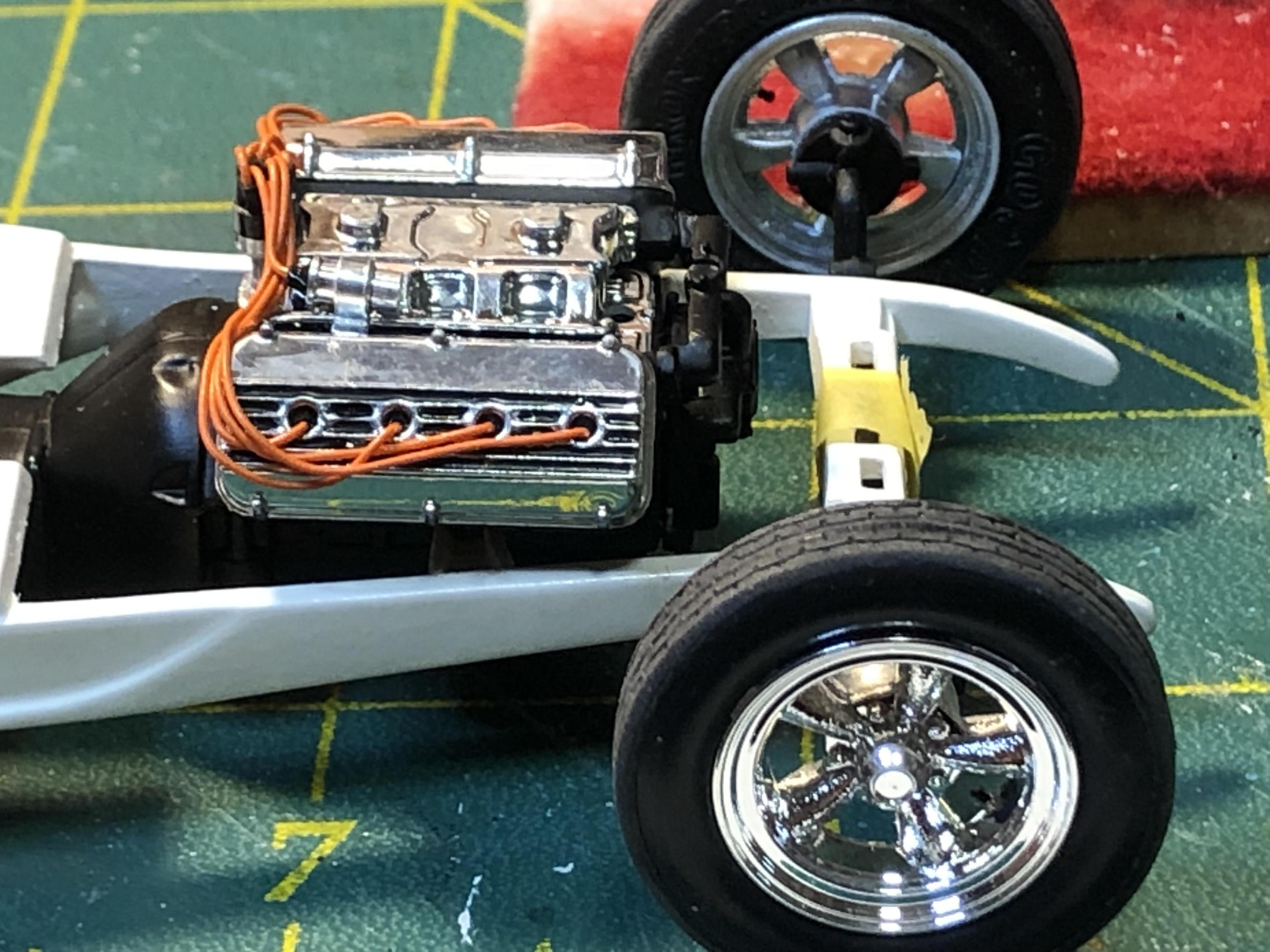

While the body was going for a swim I have been working on the engine and interior
The engine is wired with a prewired distributor that has been in my aftermarket box for yonks. The coil I turned up a while ago when I wanted one so made 4 or five for future projects. The valleys on the rocker covers were painted satin black as was the block and trans

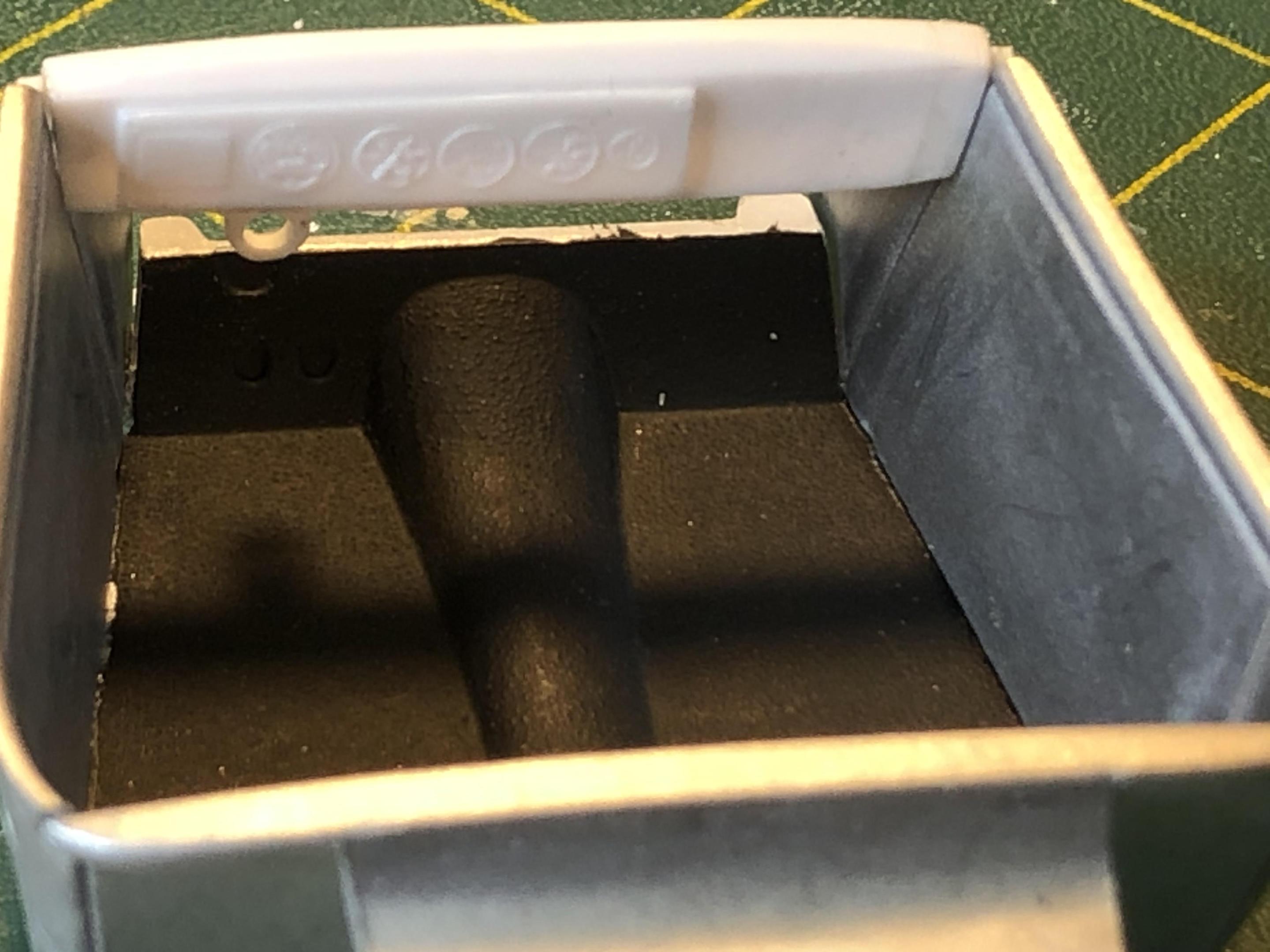

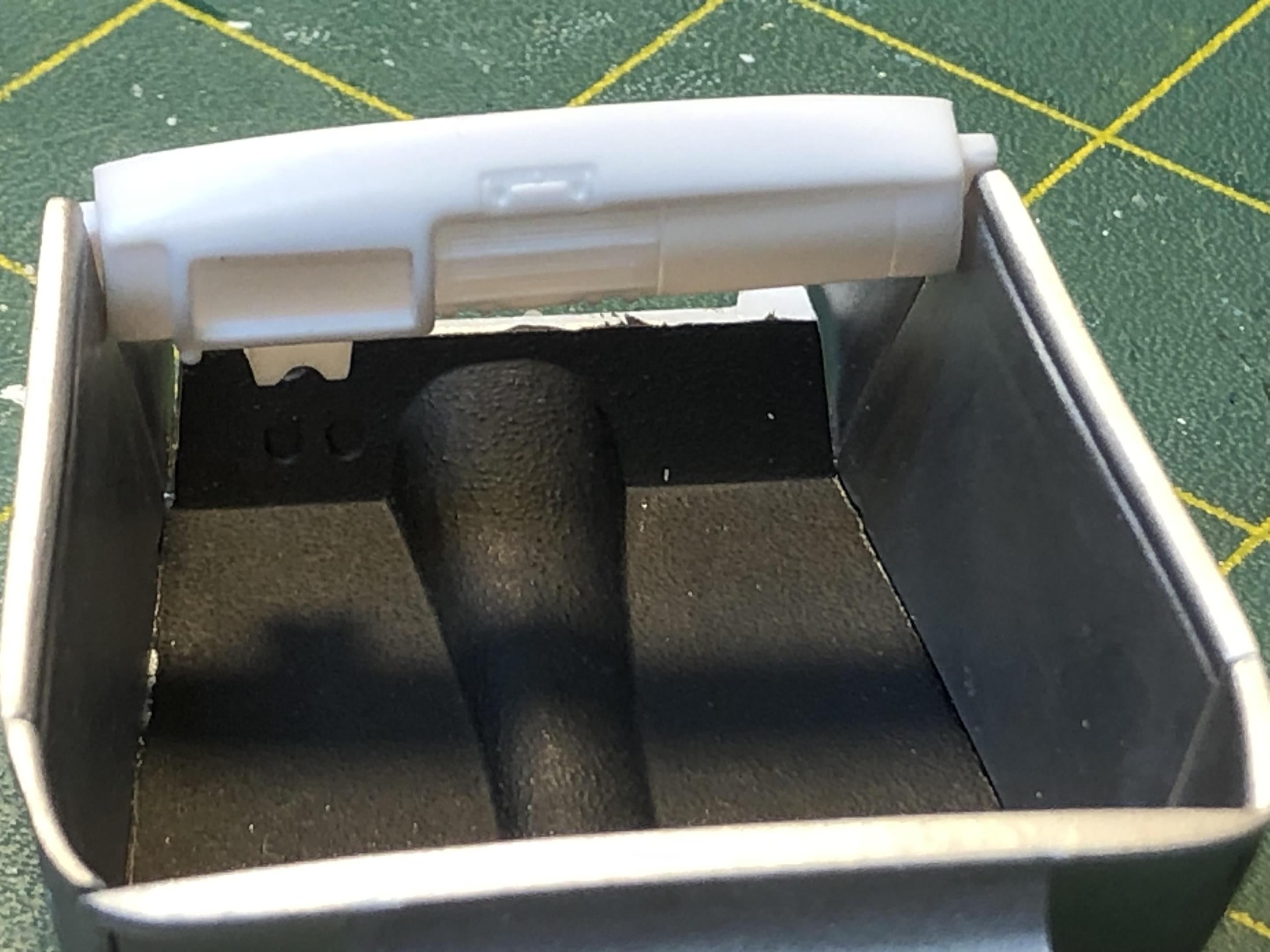

In the original build the interior was stripped down and painted aluminium to represent a race type ally interior. It was cleaned up and reprayed with Alclad polished aluminium
The dash is a sectioned width wise from a 69 Cobra race car option - for the race car look.
When I was looking for a dash I found that one from a Revell 40 coupe id a drop in for the Revell 32 rods - will keep that for another project street rod project

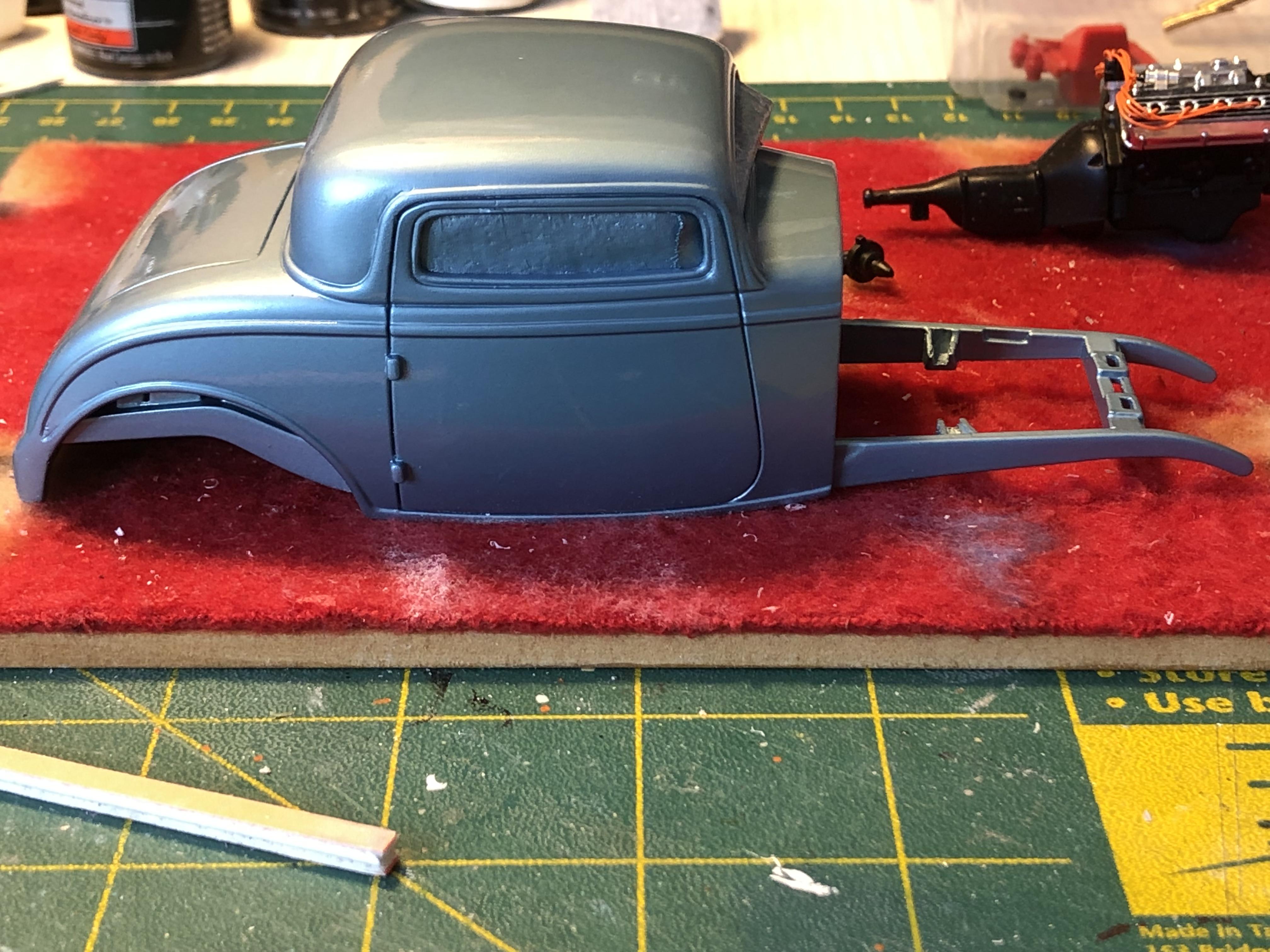

Its been a while since my last post. I got the body and chassis in colour during Oct/Nov then sodded off out of town for a couple of months for work. Every thing got parked up for a while and I missed the 2022 window for 90th anniversary so will need to celebrate the 91st instead.
 I worked on the rear inner guard fit and prepped the the body after paint removal and got some primer on it
Had some issues with the paint - I mixed a custom metalic blue Tamiya lacquer and got this on OK. When I clear coated the clear ate into the blue and tiger striped the finish. Resanded and reshot the blue then took it real easy with the clear with lots of mist coats - that sorted it. So it sat for a couple of months to cure whether it needed it or not

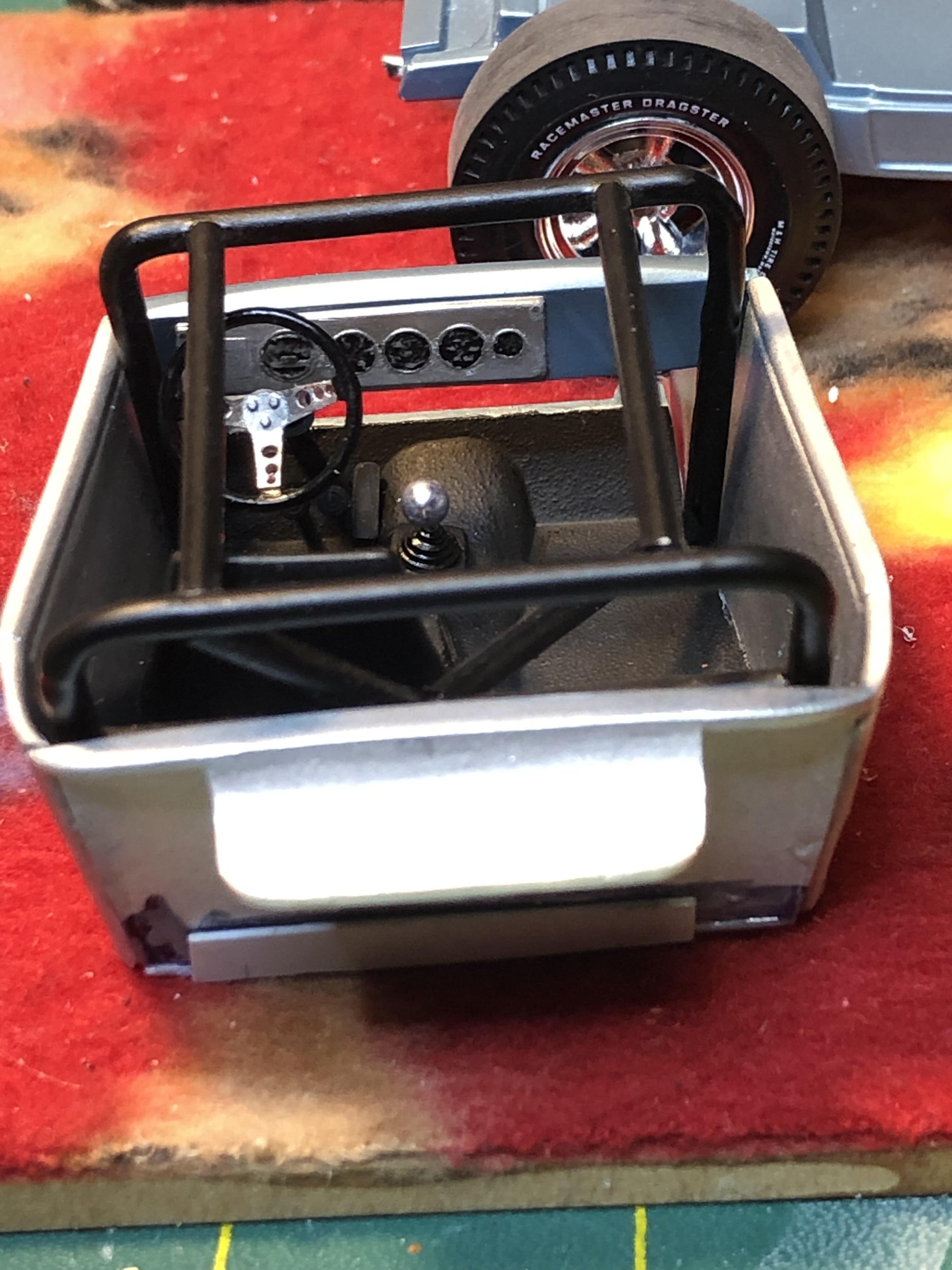

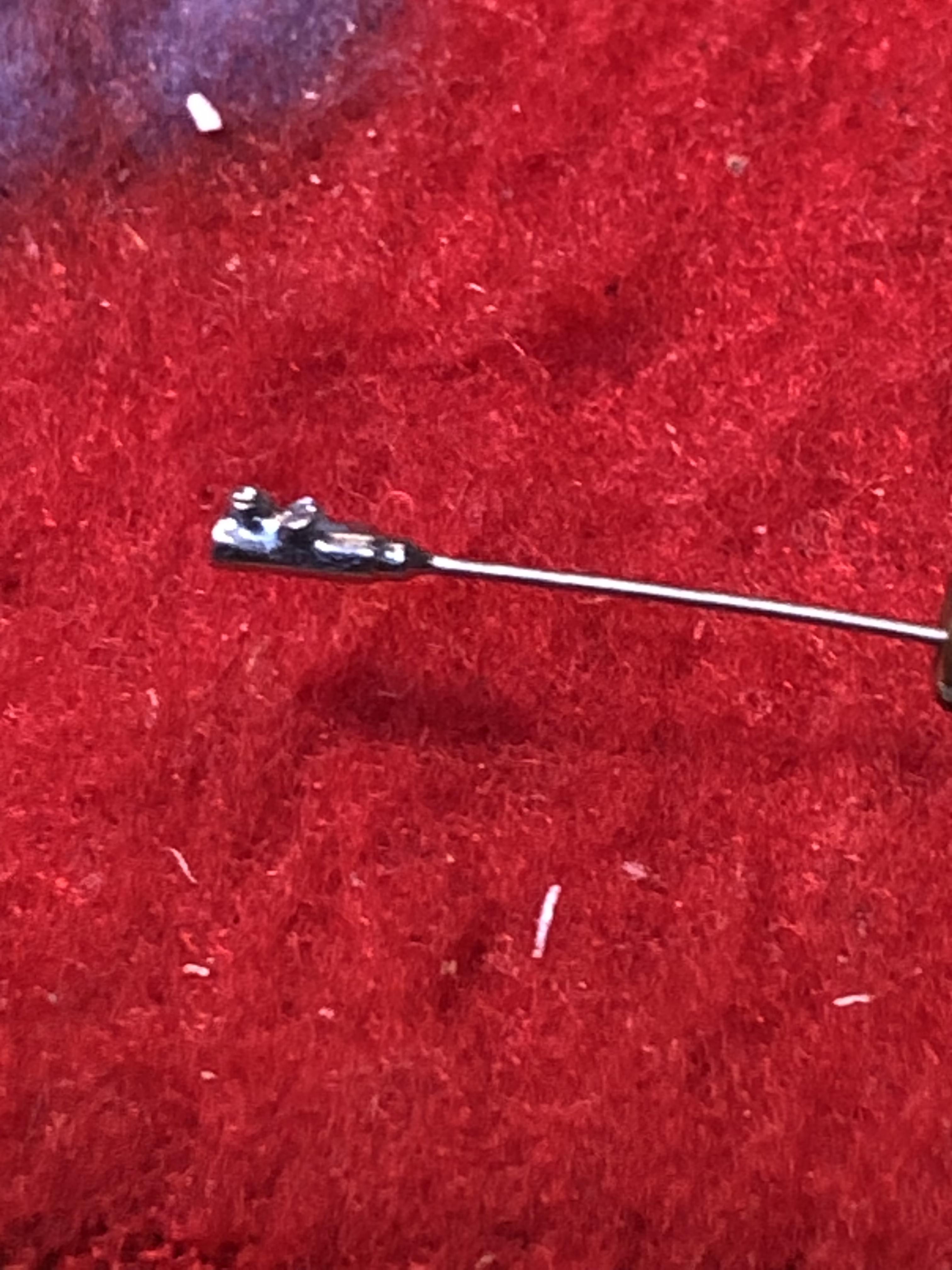

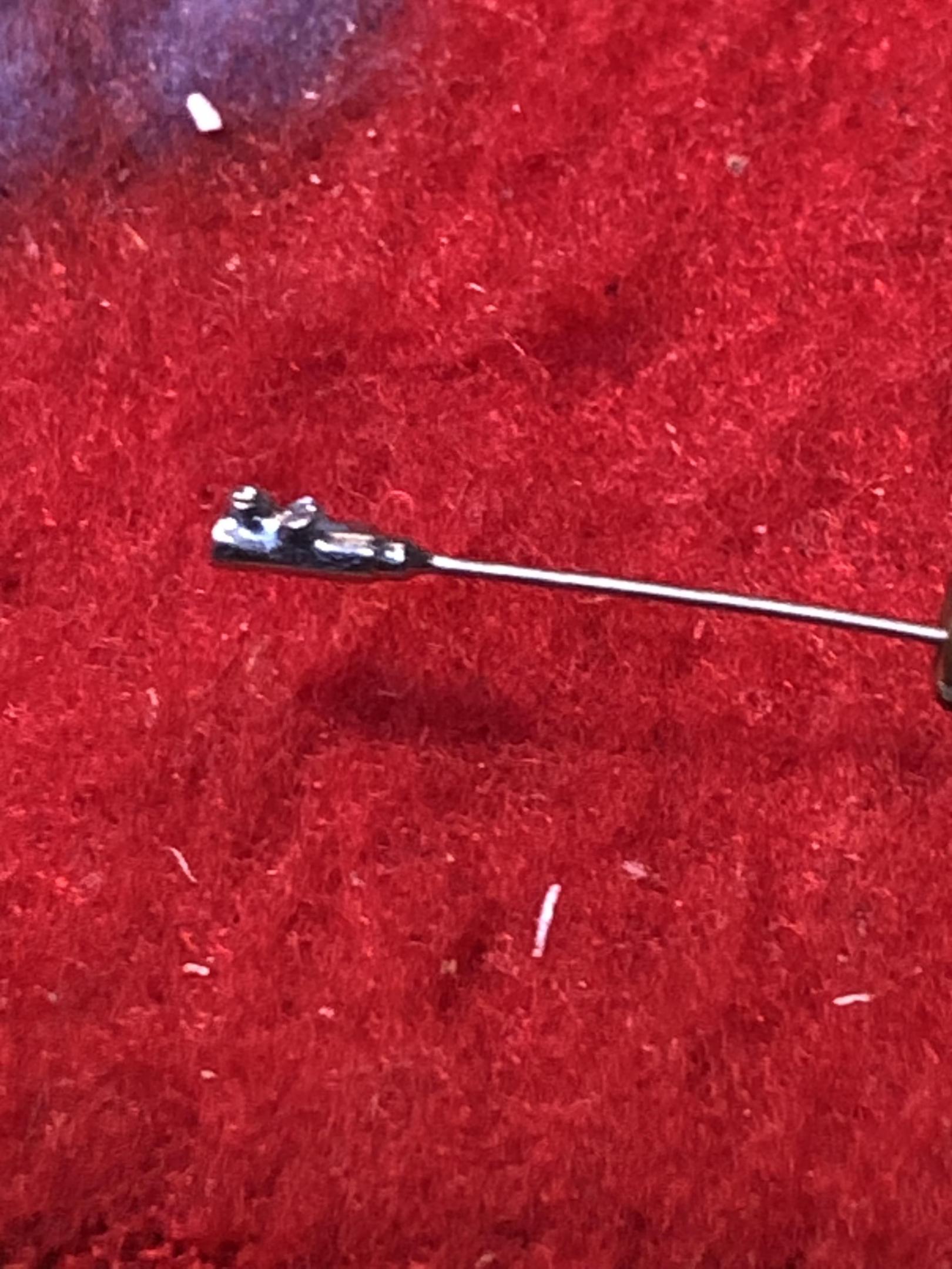

The interior is done. The shifter is a bent pin with the the ball chromed with Molotow and the shifter riser scratch built. The hemi is a manual so needed a third pedal so scratched an accelerator pedal. The roll bar is from the earlier build as is the bare door panels. The seat and steering wheel are from the spares box.

Interior gat taken care of - some original build and some new stuff. The gauge panel is from the spares box along with the seat
The original white paint job was not doing it so in the tank it went. Had to clean up the body a bit from the chop job it into primer and colour before I went away for work

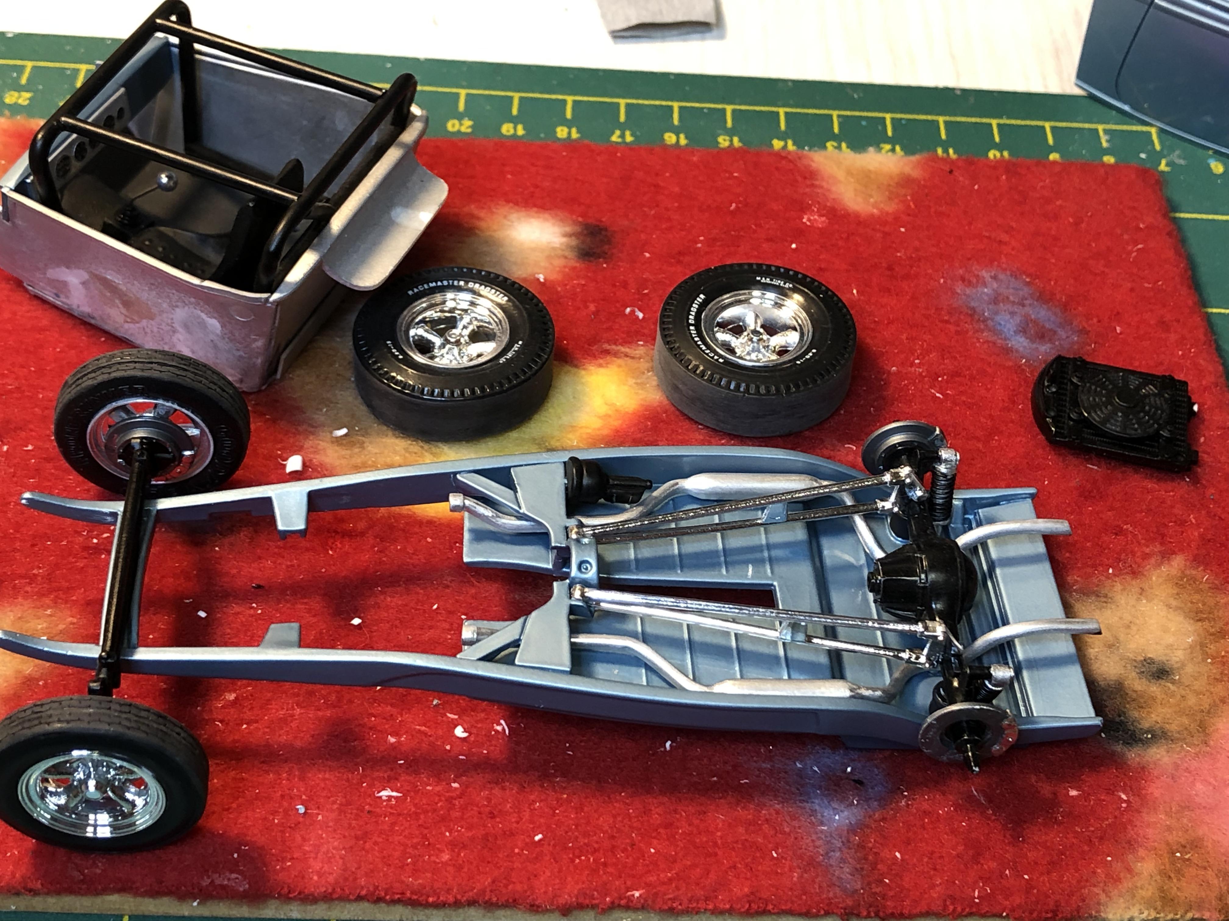

And a shot of the chassis and bits getting ready for assembly

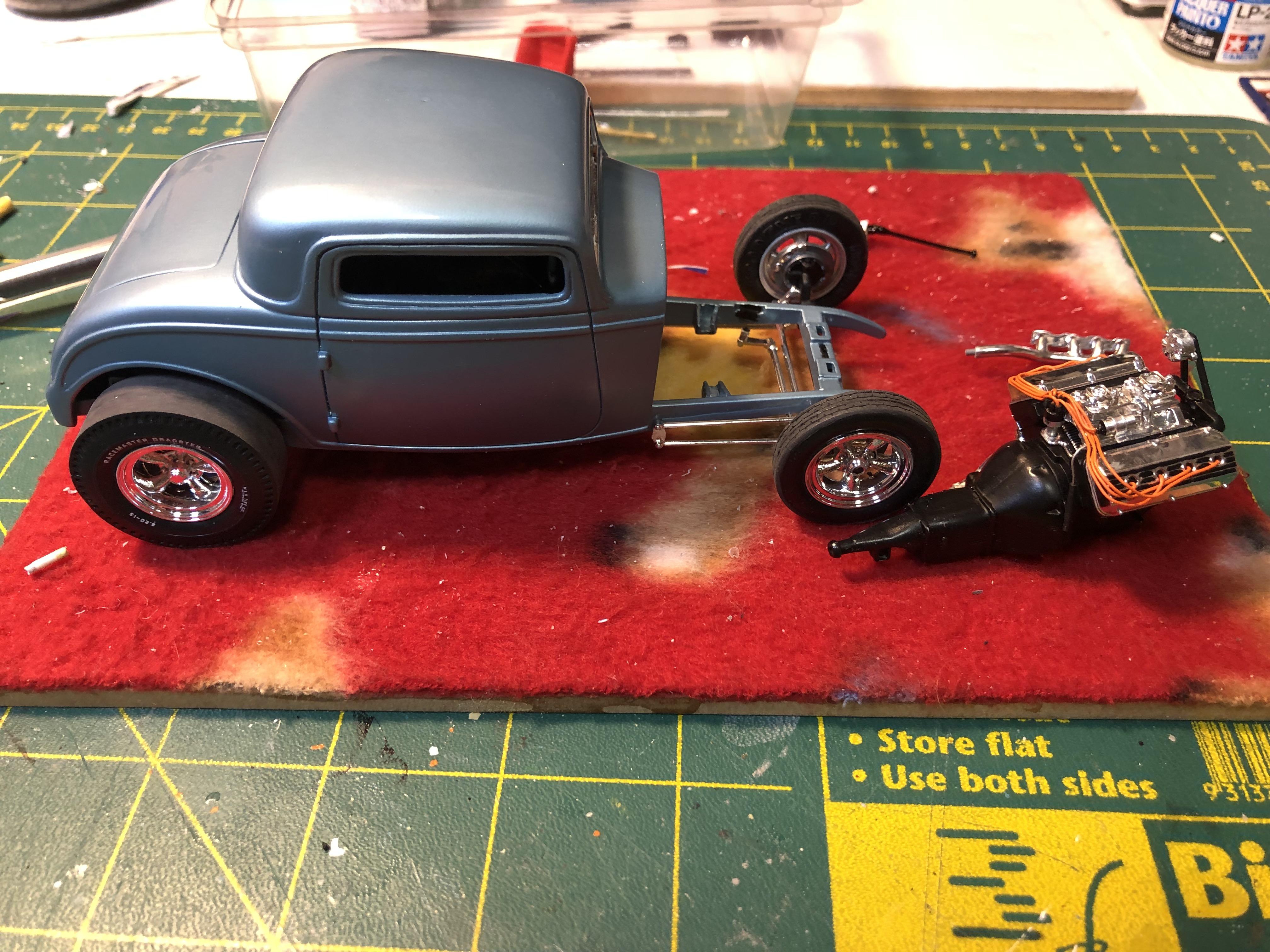

And chassis on all four

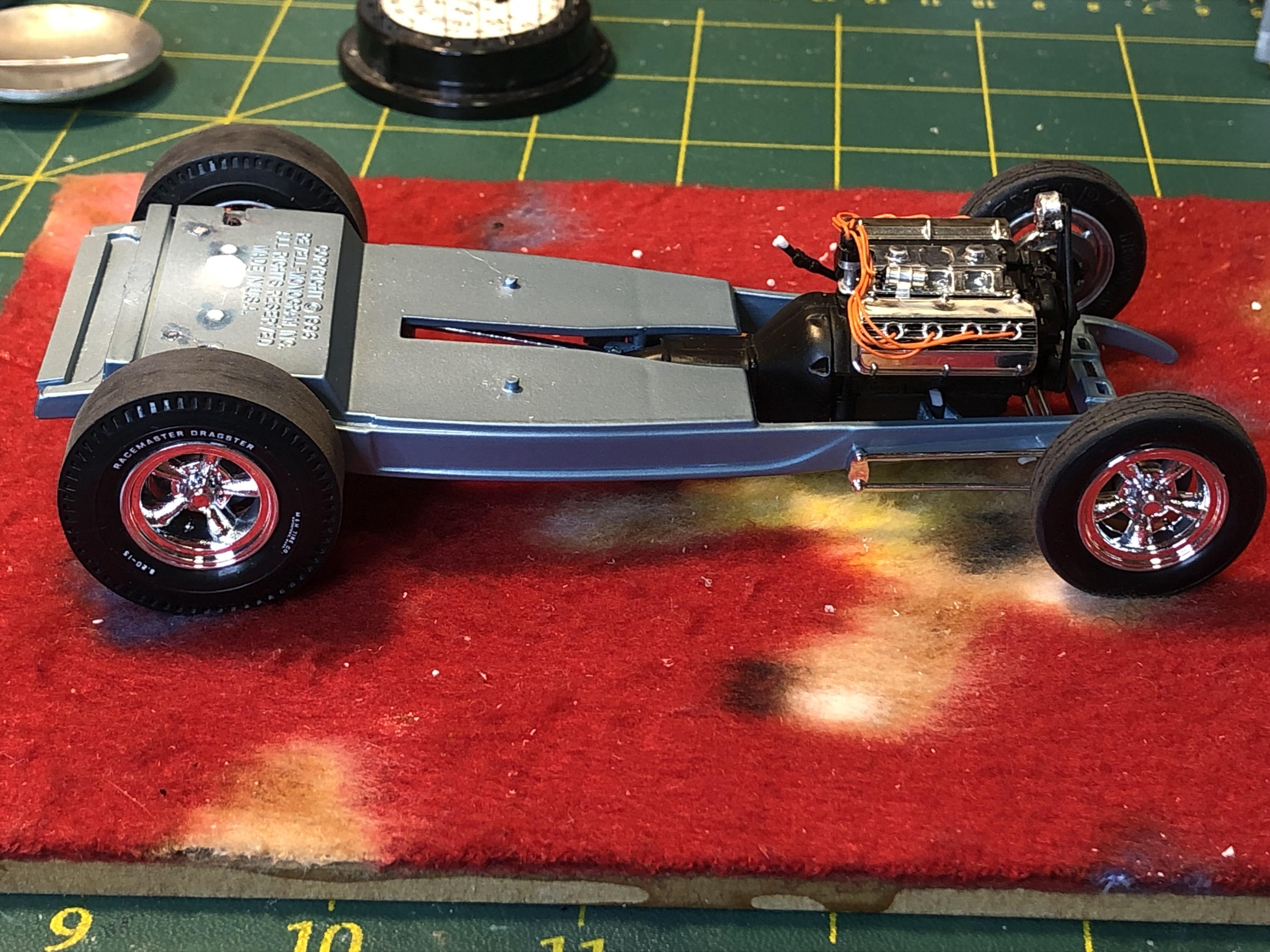

A quick mock up which showed issues with the fire wall - the recess was not big enough for the monster motor so had to do a work round by installing a flat panel behind the fire wall lip to mate up with the interior. Gosh this is a big motor to fit in a fairly small hole but this is what hot rodding is all about

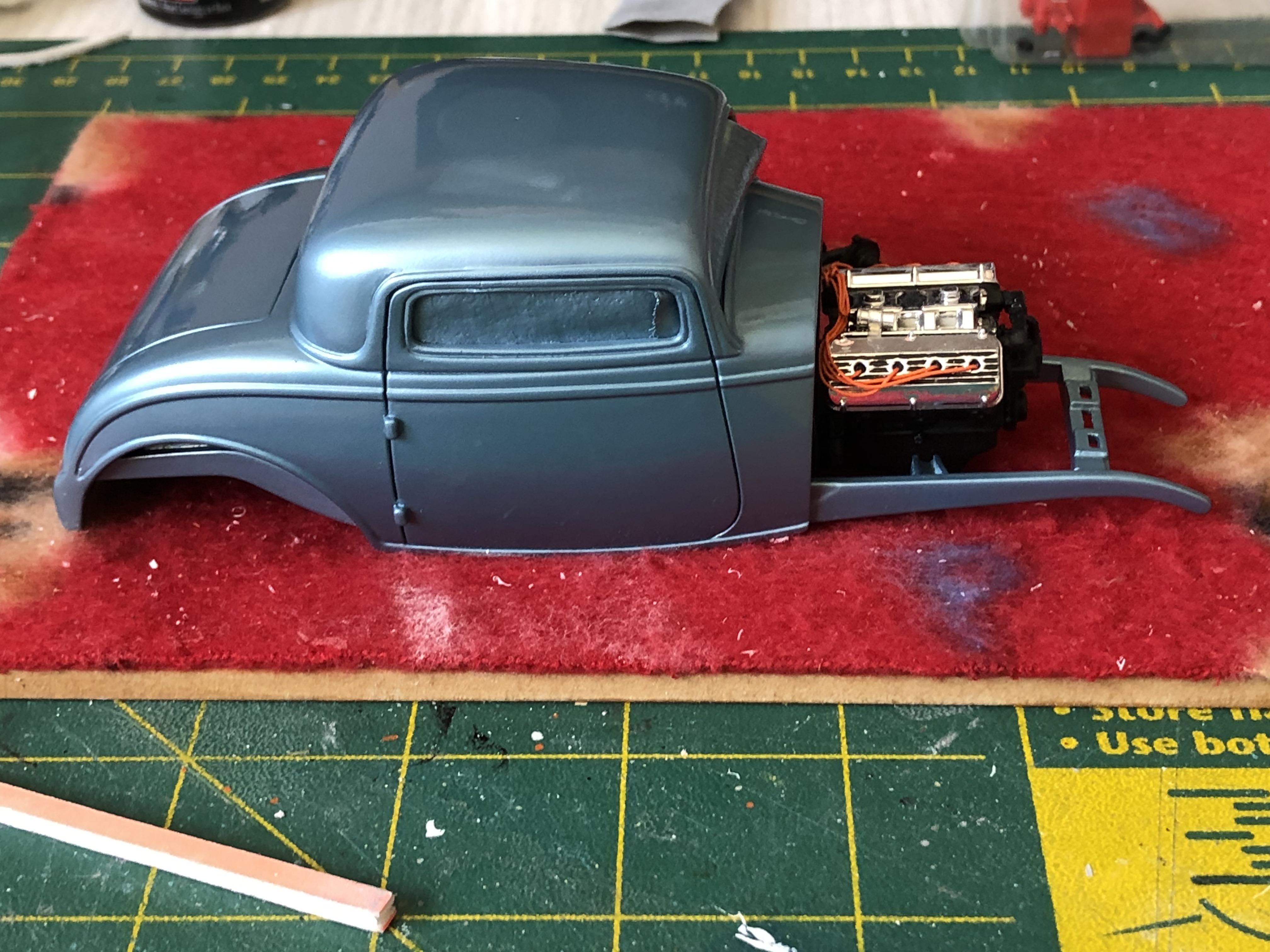

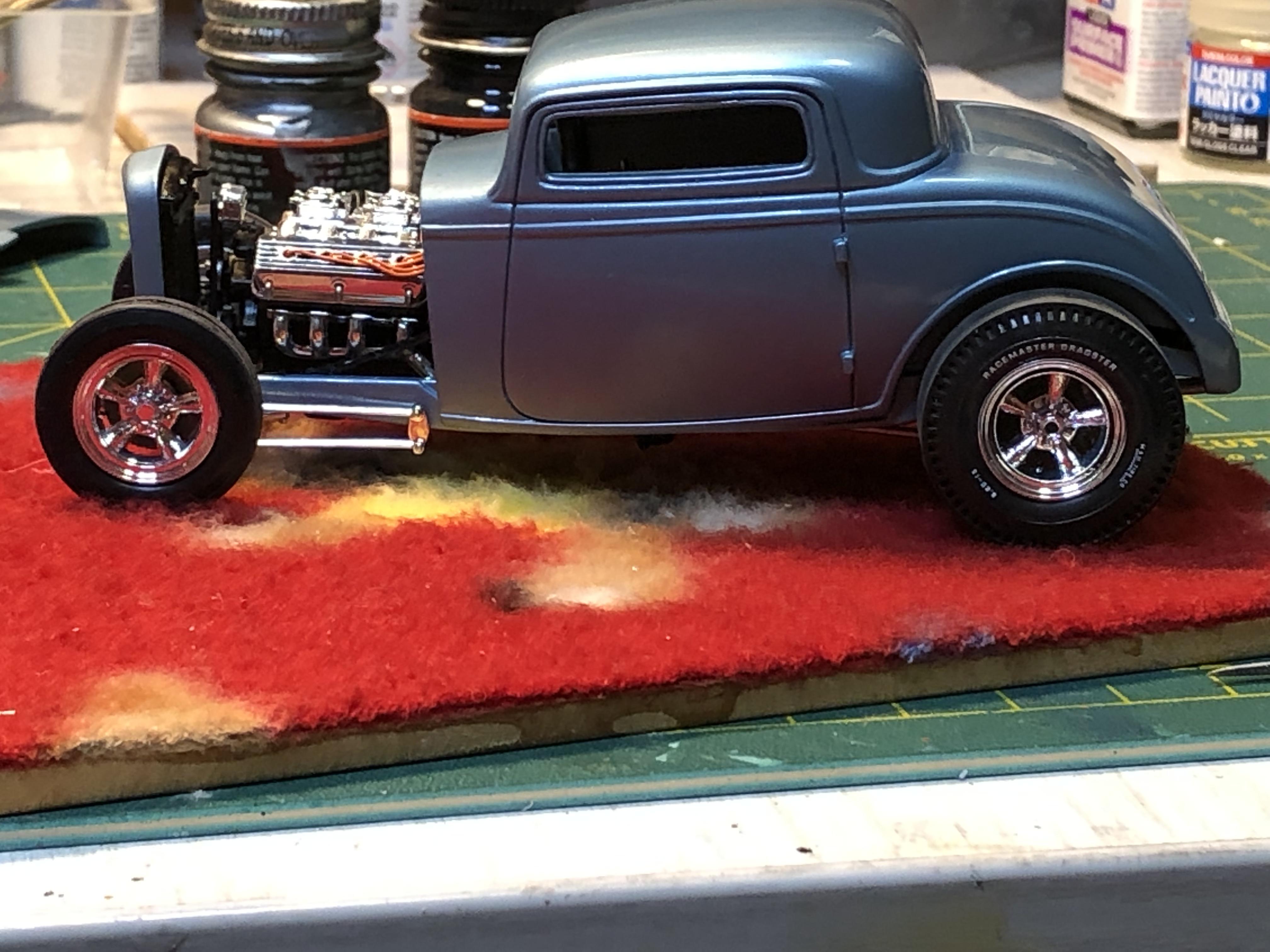

So we are now up to date. Motor is now fitted. The steering and exhausts are in as well after a wee fight with the engine but we got there in the end. And the body is now mounted to the chassis
Looking OK except the grill surround and radiator sits a bit too high when I mocked it up. I have shaved some more off the bottom where it sits on the cross member and have had to relieve some depth of the fan to get it to look good. I am using a chopped grill and radiator from R&MM but even the chop was not enough for the full chassis depth channel job. This has a nice PE grill insert to boot.
