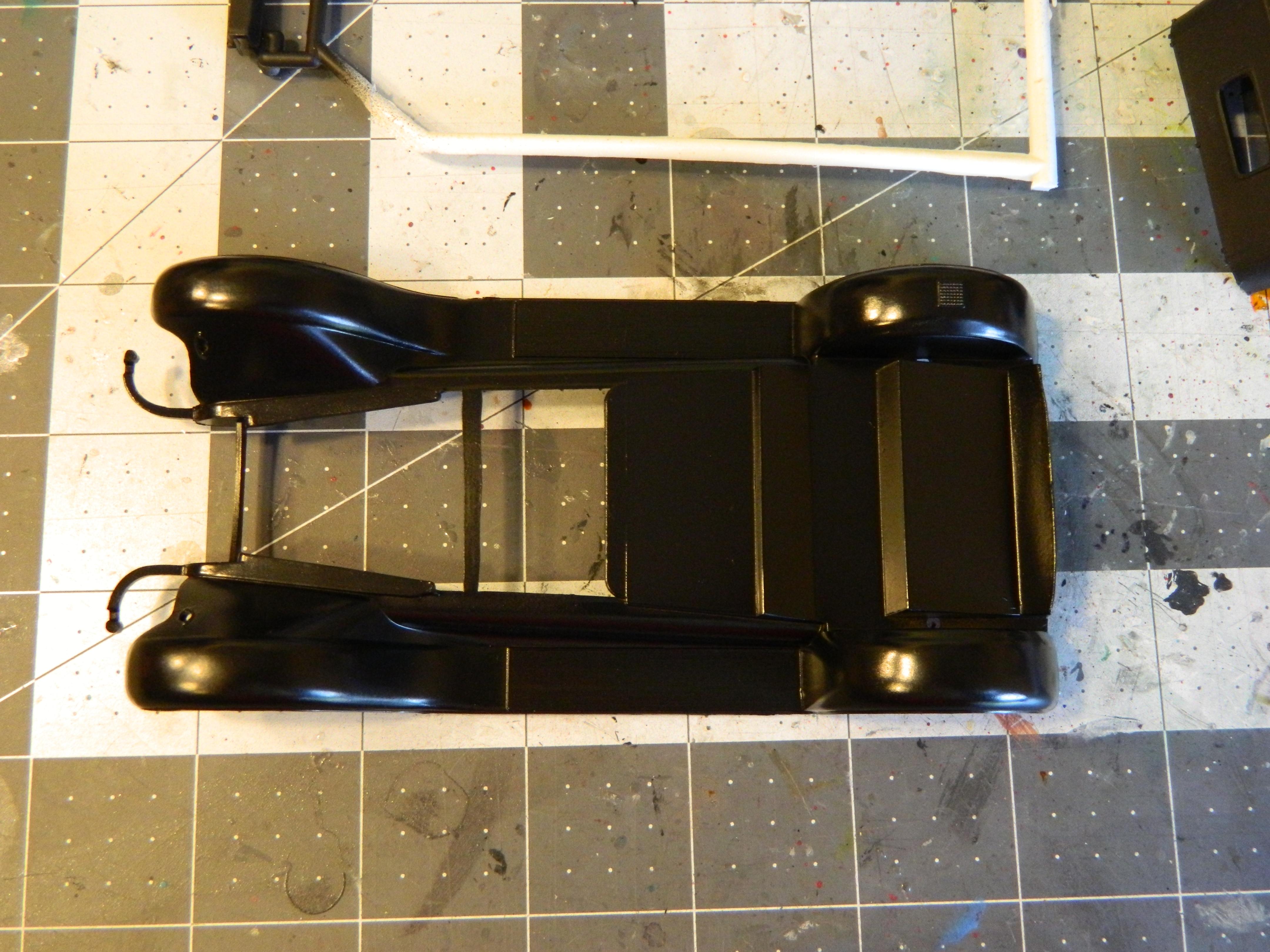

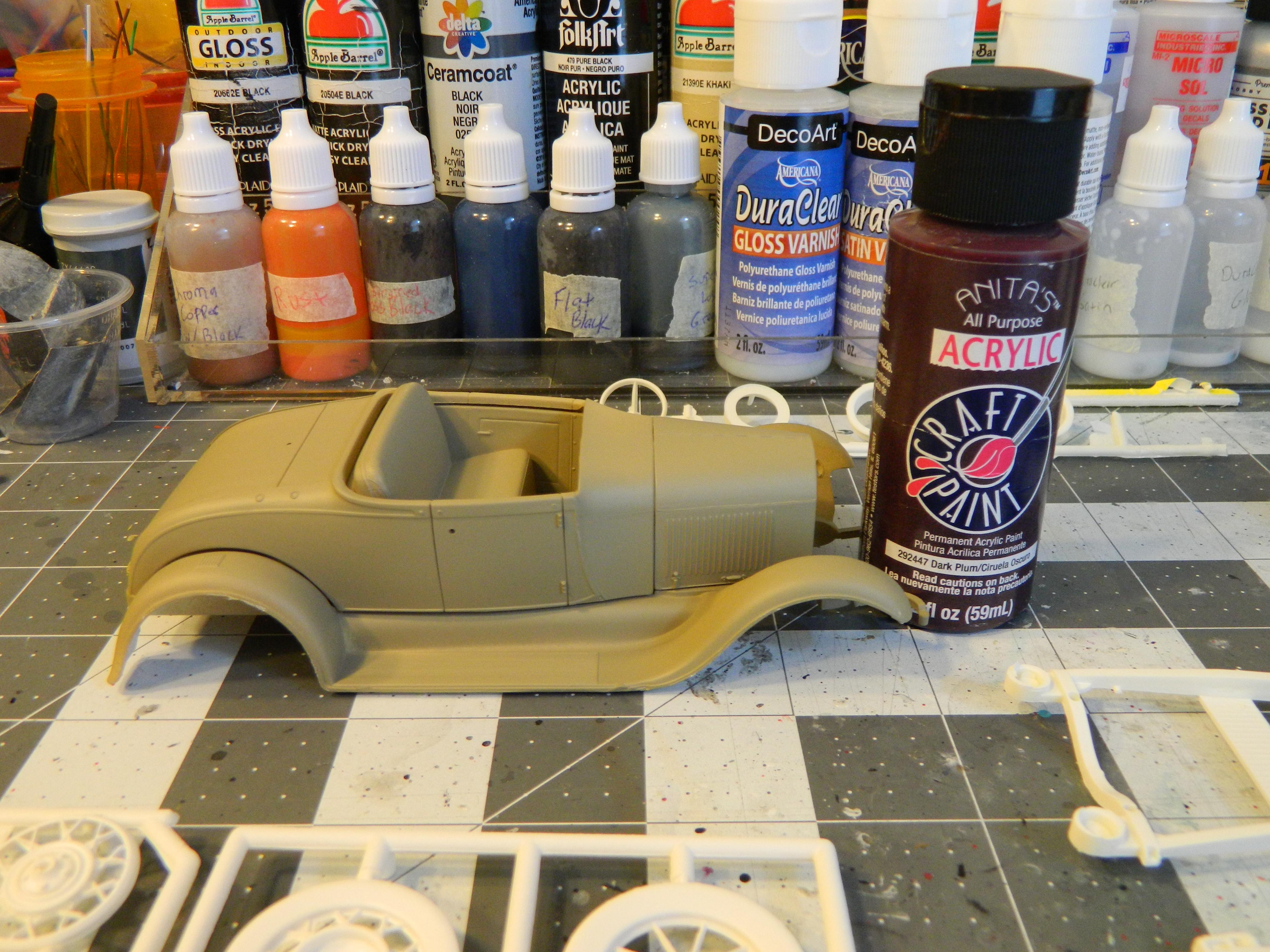

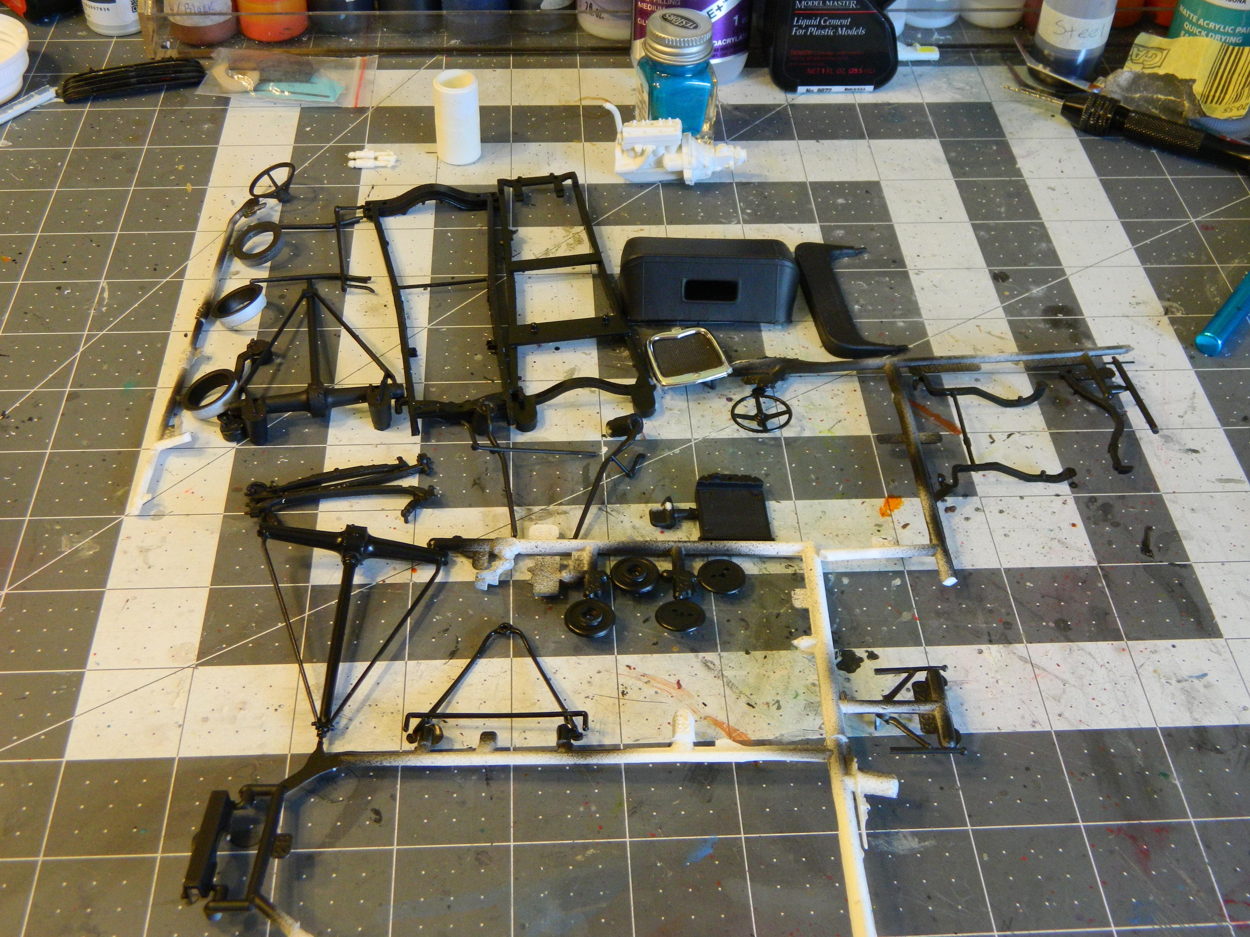

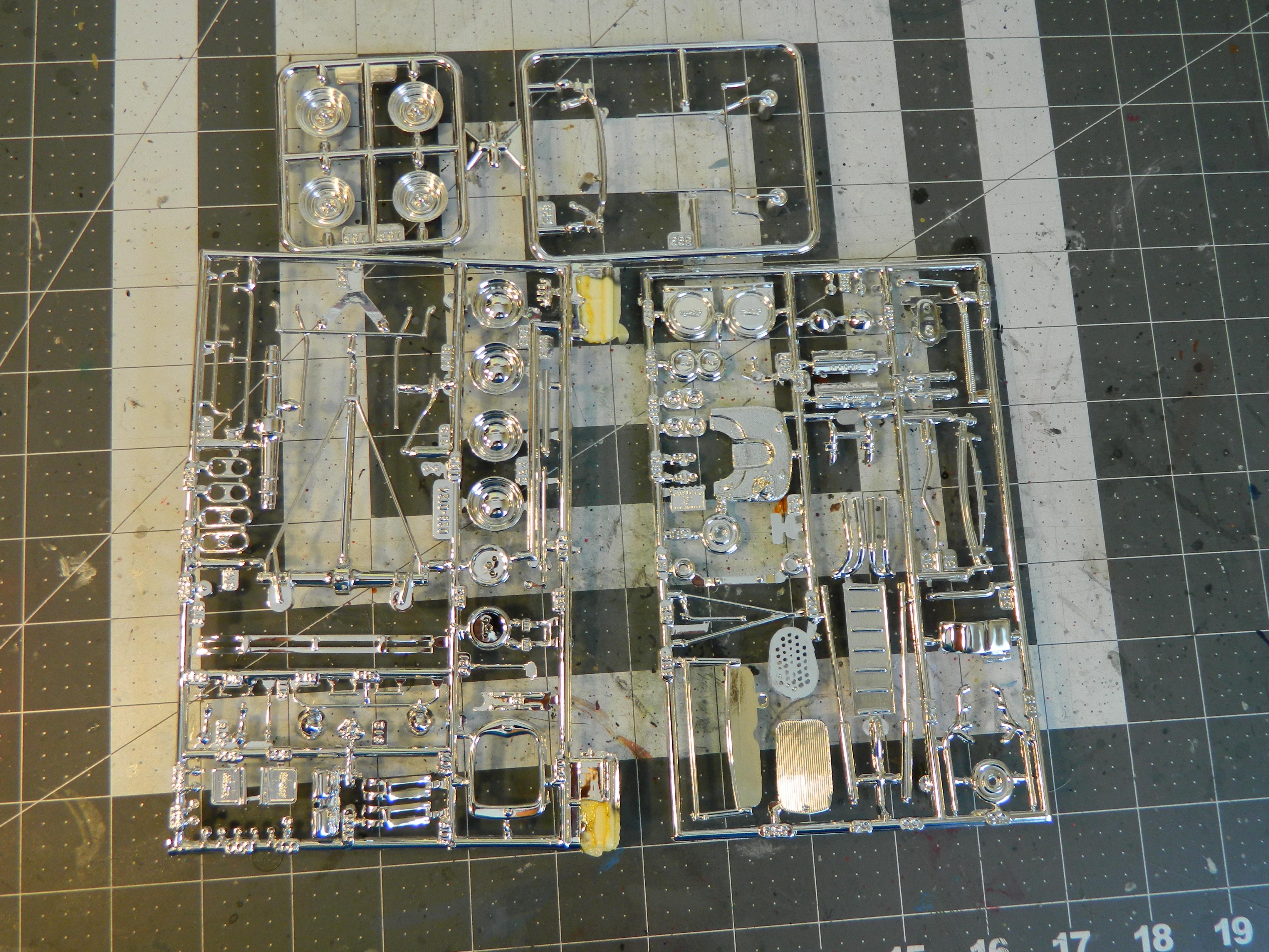

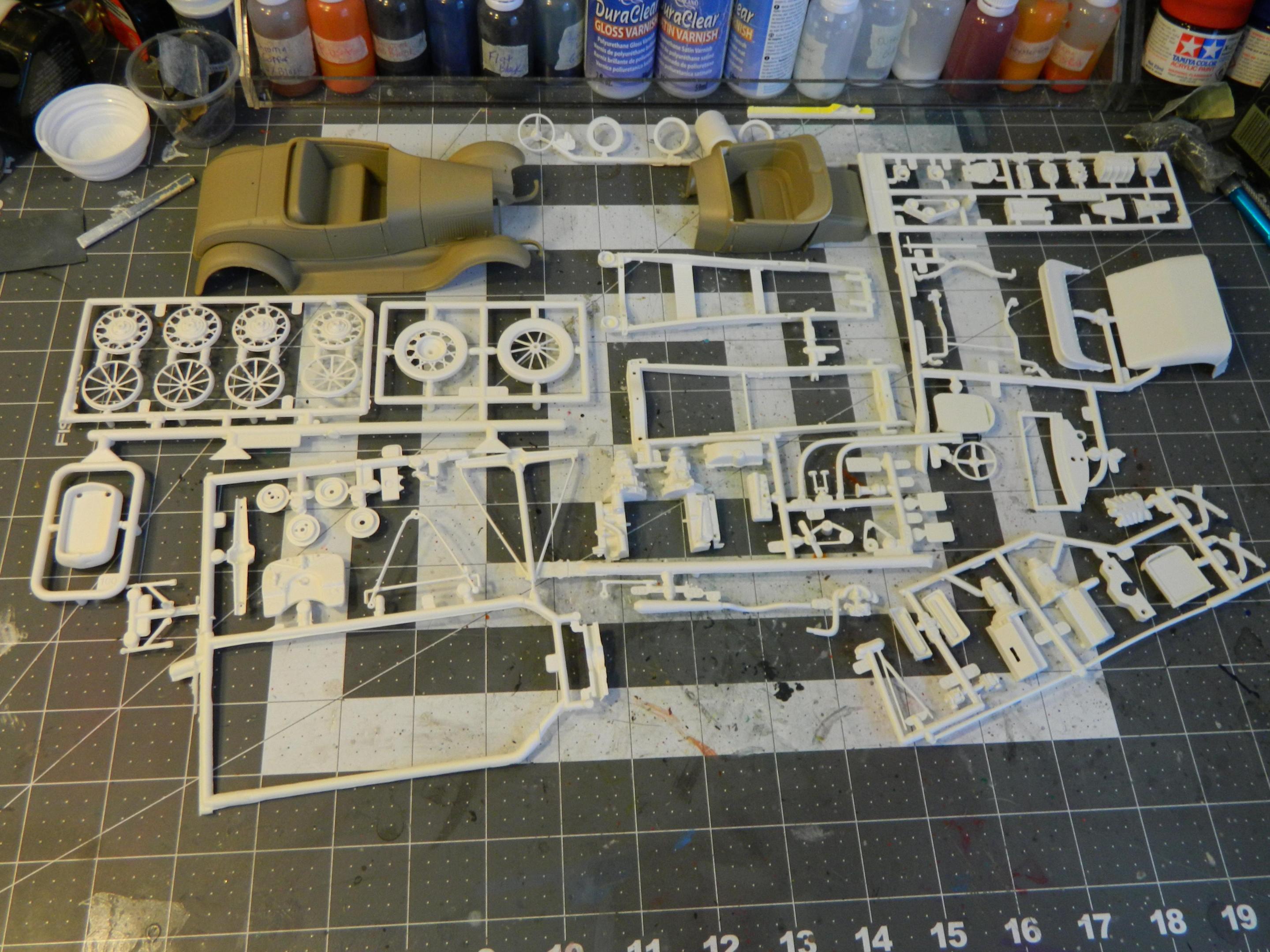

Dragonhawk1066 Posted August 17, 2022 Posted August 17, 2022 (edited) I decided to start the Mod Rod next, since I've really only built one car from this general era I figured it was time for another, or two actually. I'll be doing the stock version in Anita's Dark Plum craft paint with black fenders, top, and interior. I'm undecided on the color/scheme for the custom version but should be decided tomorrow. I got the parts I'll be using primed today, but still need to strip the chrome off more parts tomorrow to prime those as well. No real reason for the tan primer, I was gifted a can of Rustoleum Camo Flat Tan, so I thought I'd see how it works as a primer. Looks good so far. This kit has almost every part to build the Ala Kart, save for the nose piece and I would have built it like that, but I'll go for the old roadster look instead. Edited October 17, 2022 by Dragonhawk1066

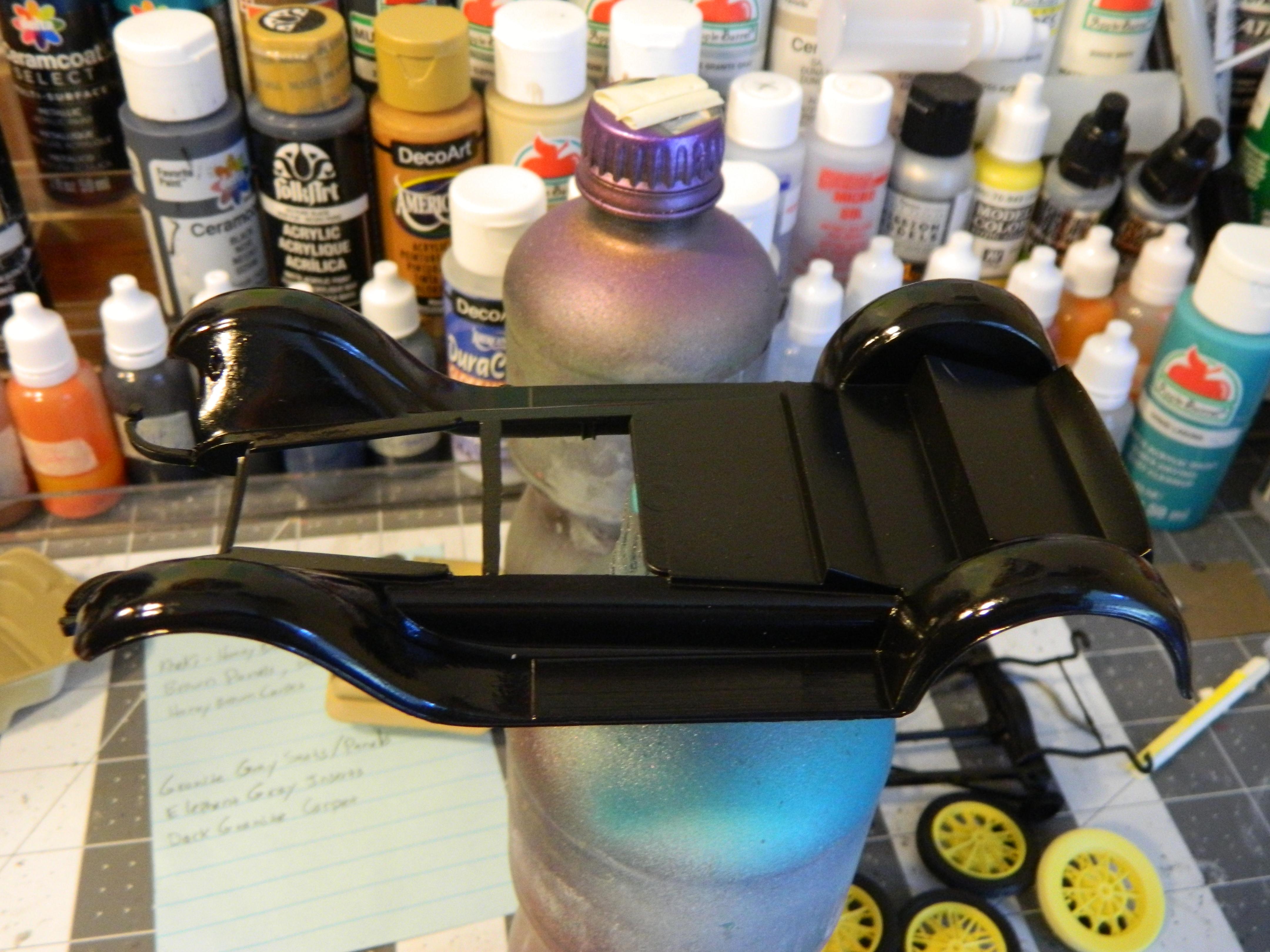

Dragonhawk1066 Posted August 19, 2022 Author Posted August 19, 2022 I got the flat black and glossy black painted on today, using Delta Ceramcoat for the flat, and Anita's for the glossy black. I did change my mind on the colors too, I'll be using an Apple Barrel color called Laguna for the stock version and Createx Pearl Plum for the custom roadster. Hopefully I'll be able to get those painted tomorrow. 2

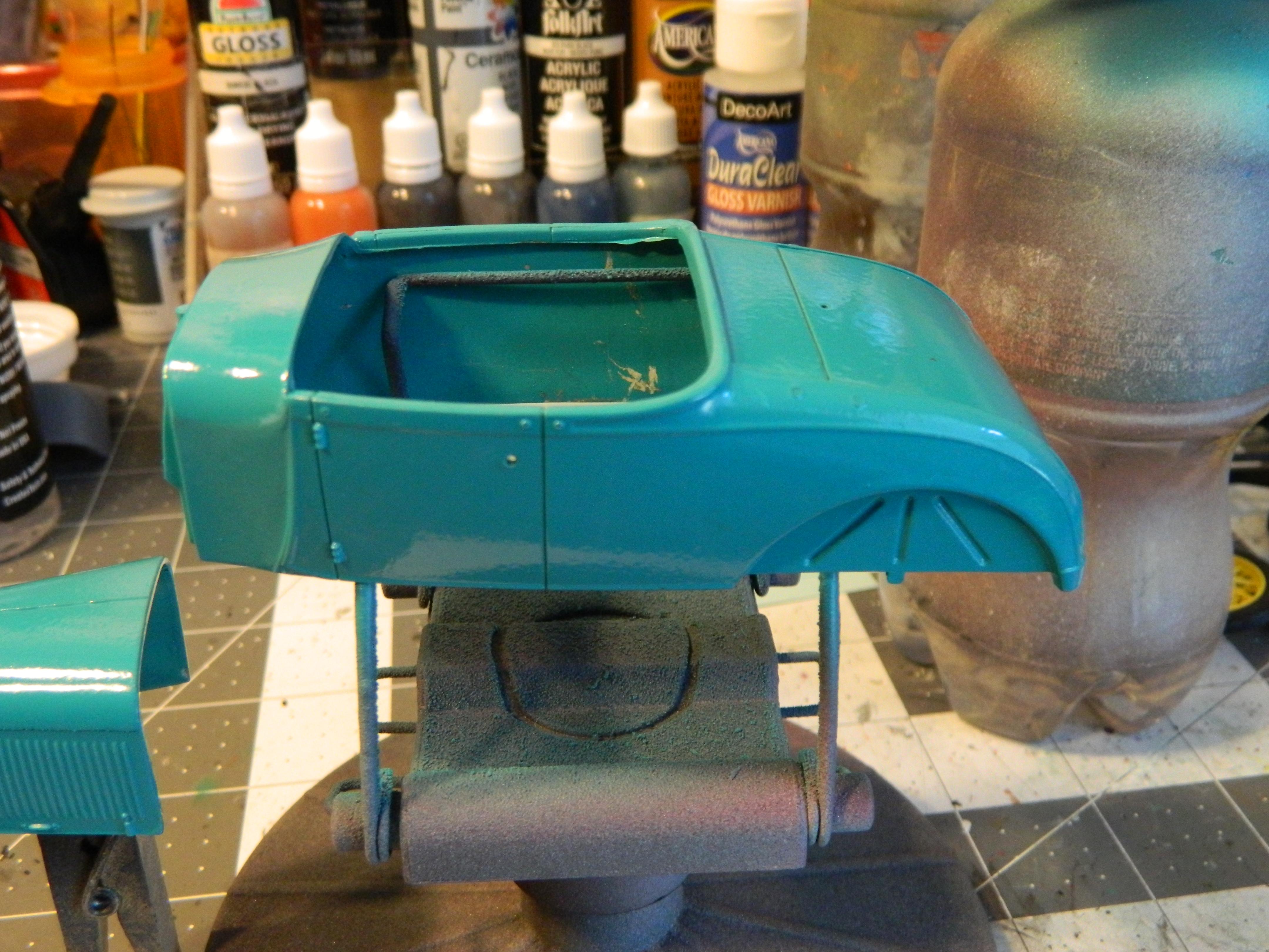

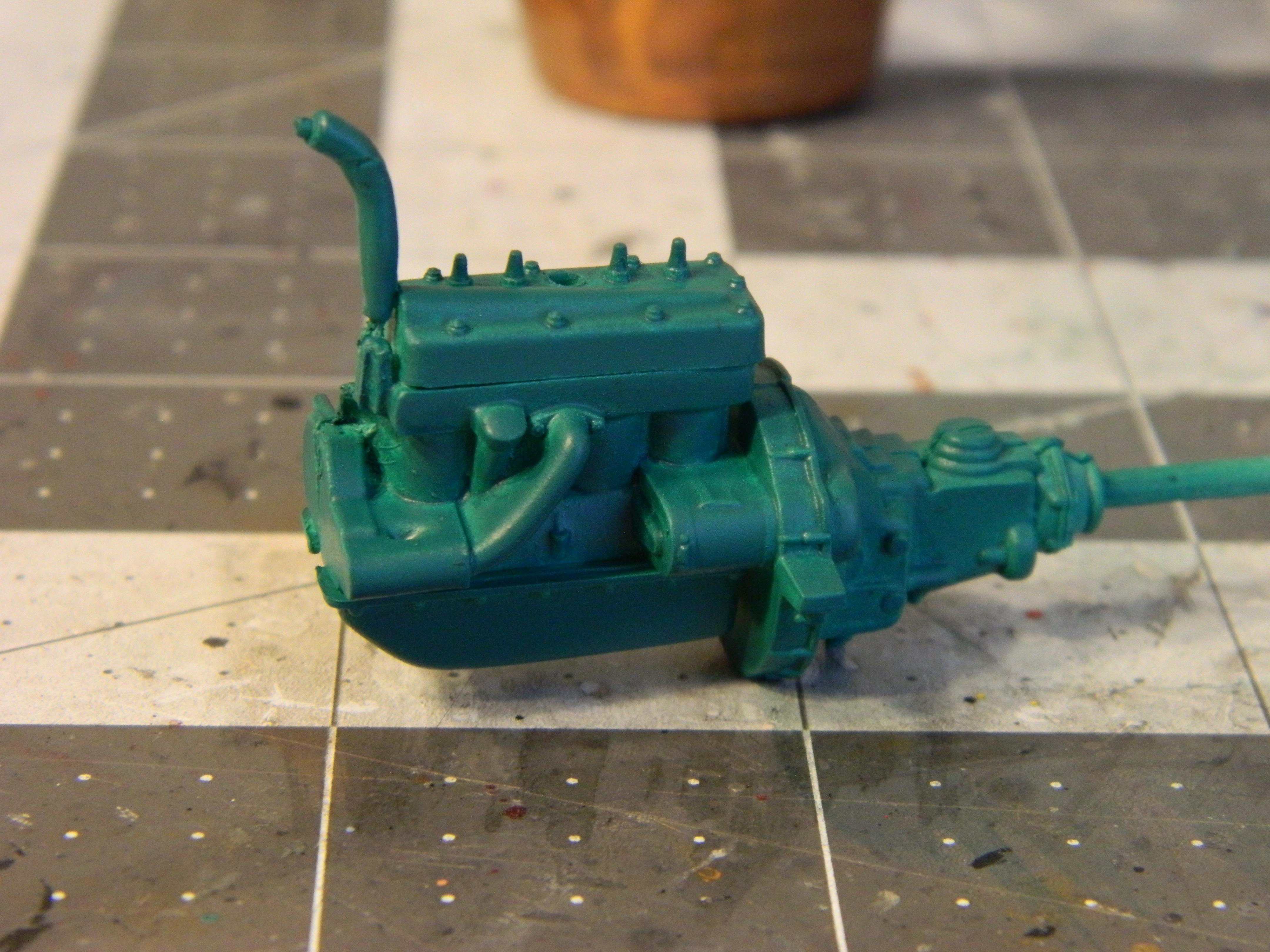

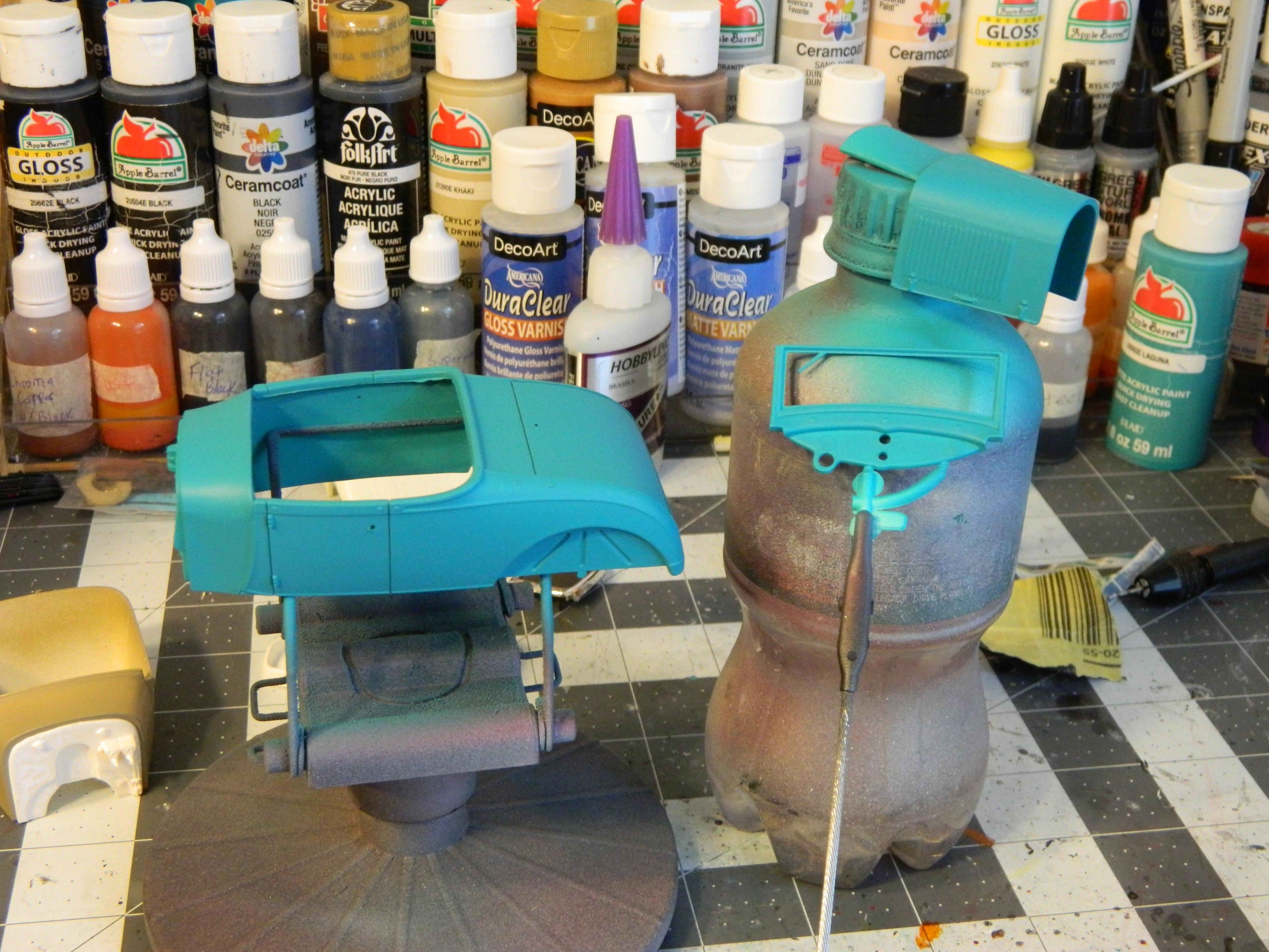

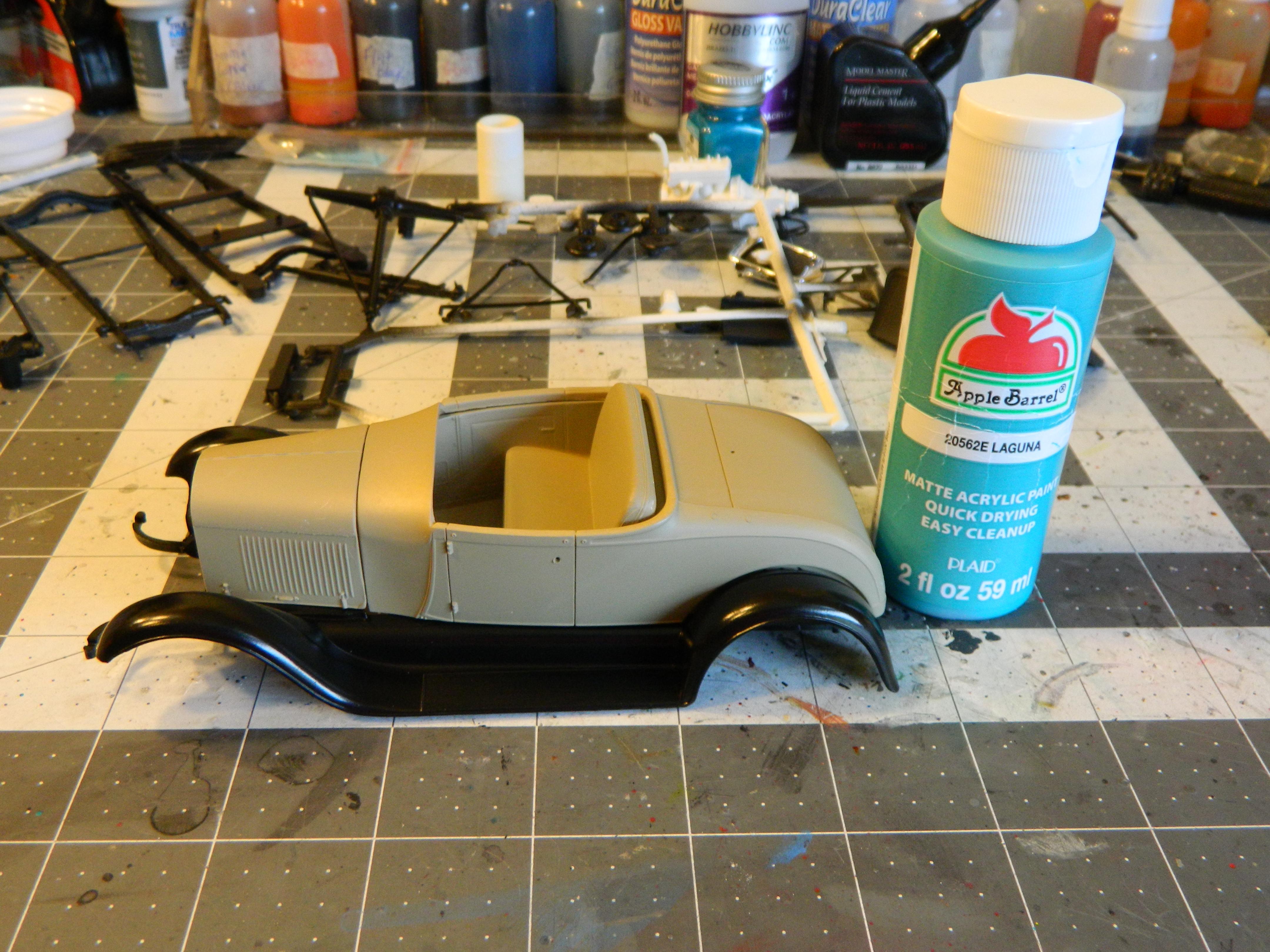

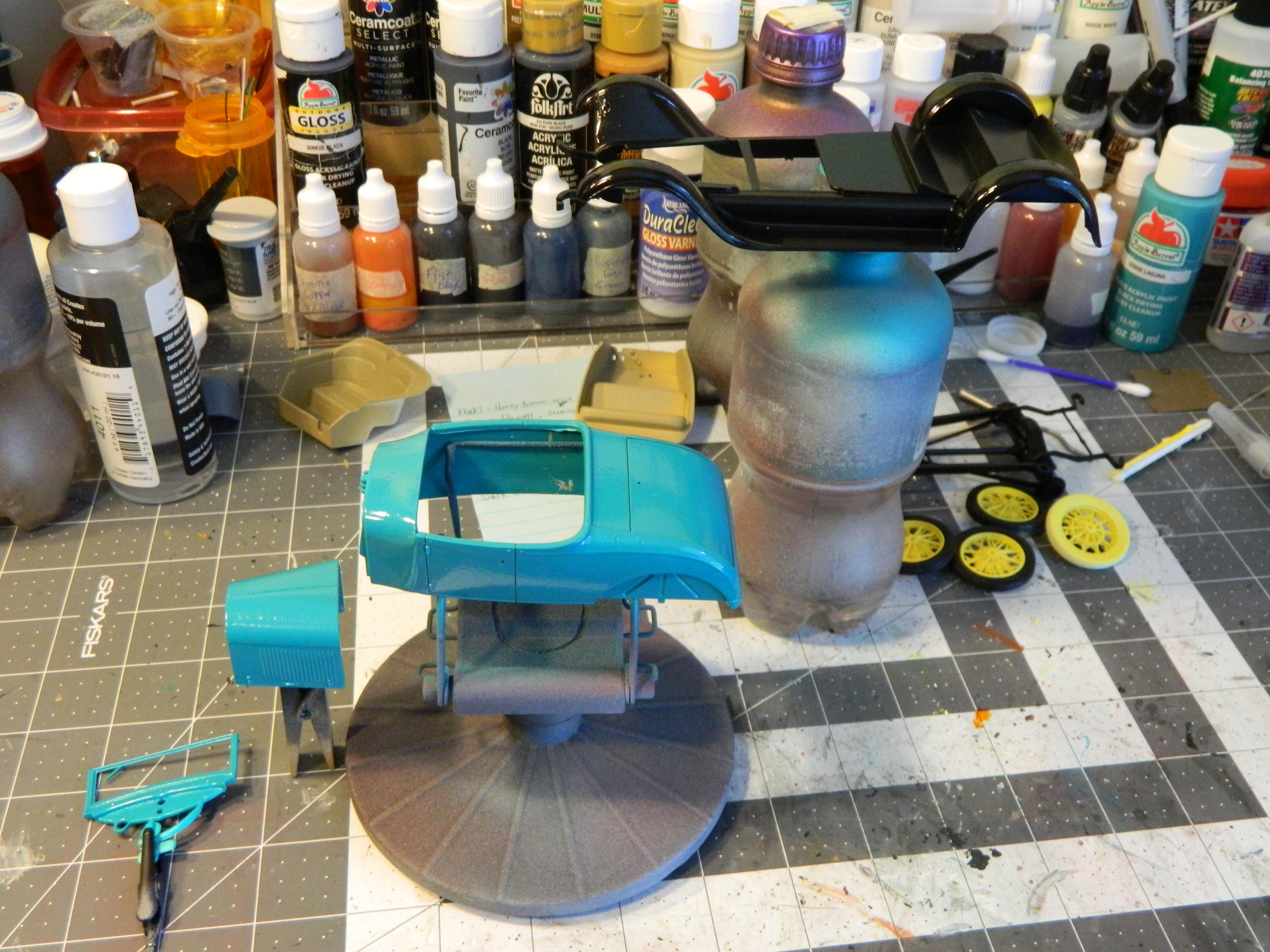

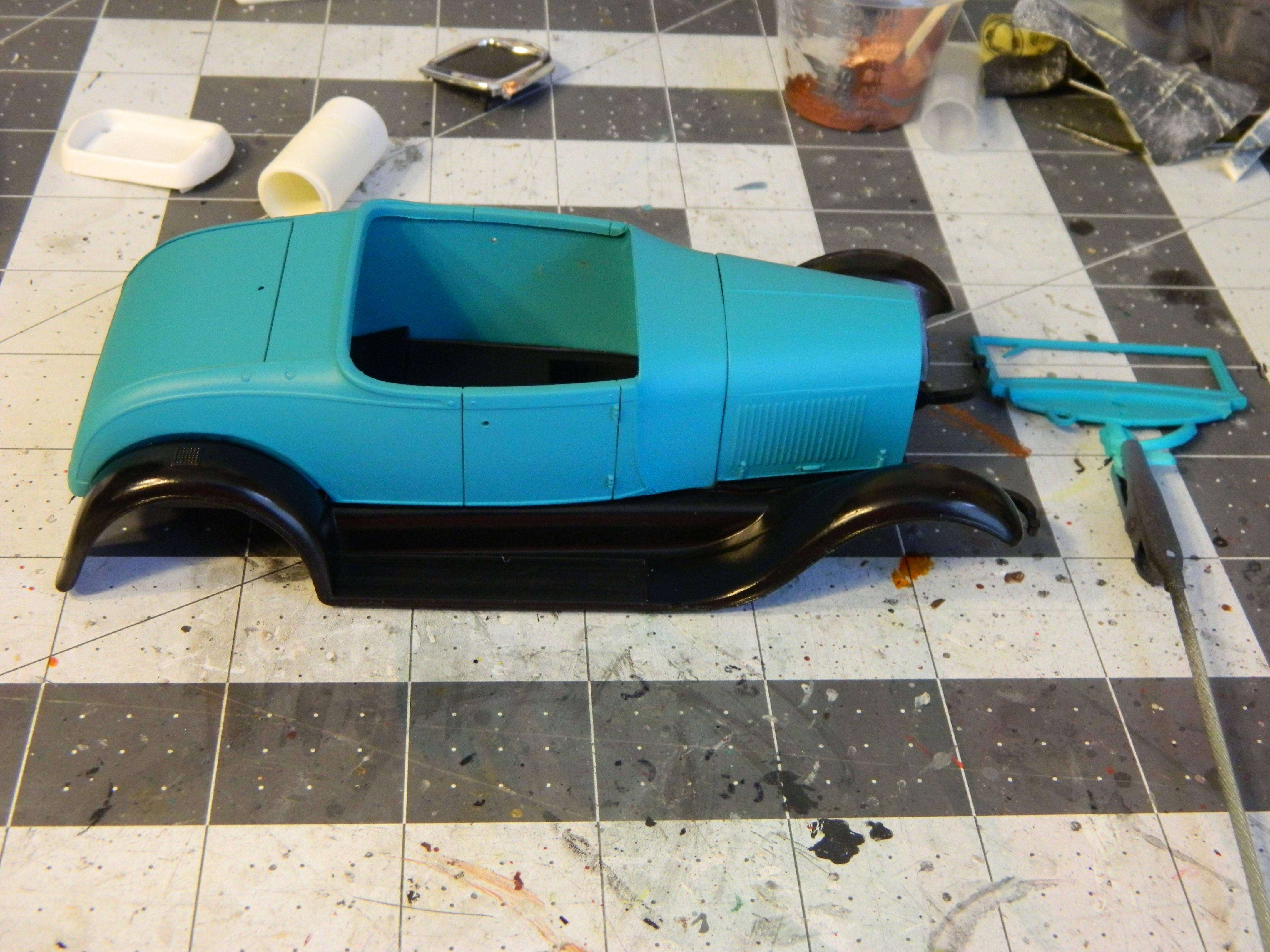

Dragonhawk1066 Posted August 20, 2022 Author Posted August 20, 2022 I managed to get the Laguna Blue sprayed on the stock body today. I like how it looks and can't wait to get the clear on in a couple of days. I realized I needed to strip a few more plated parts for the custom version, so I did that today. I will primer them tomorrow and hopefully get the Hot Rod painted Monday. I also mixed up some engine paint and sprayed that this afternoon. 2

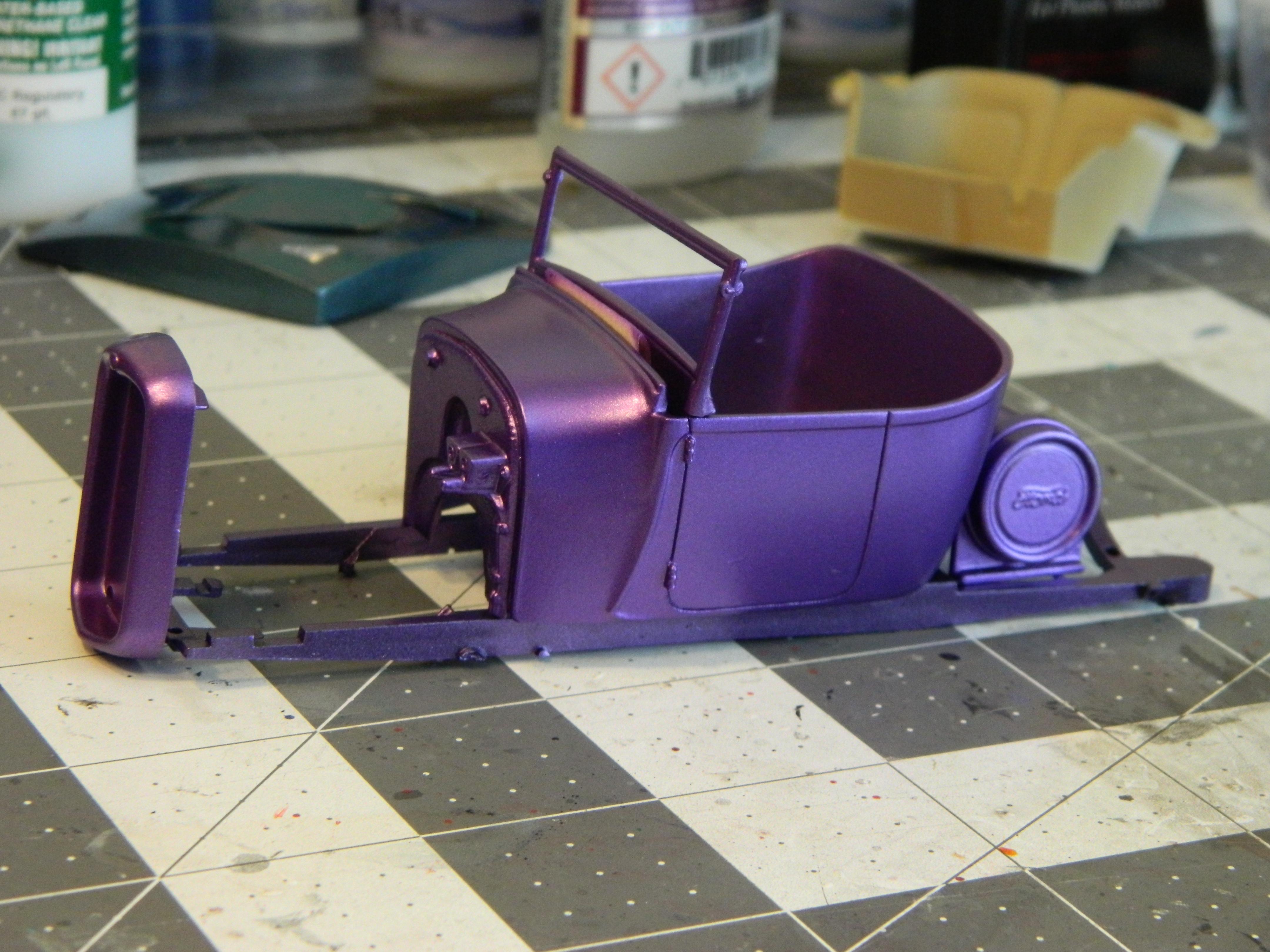

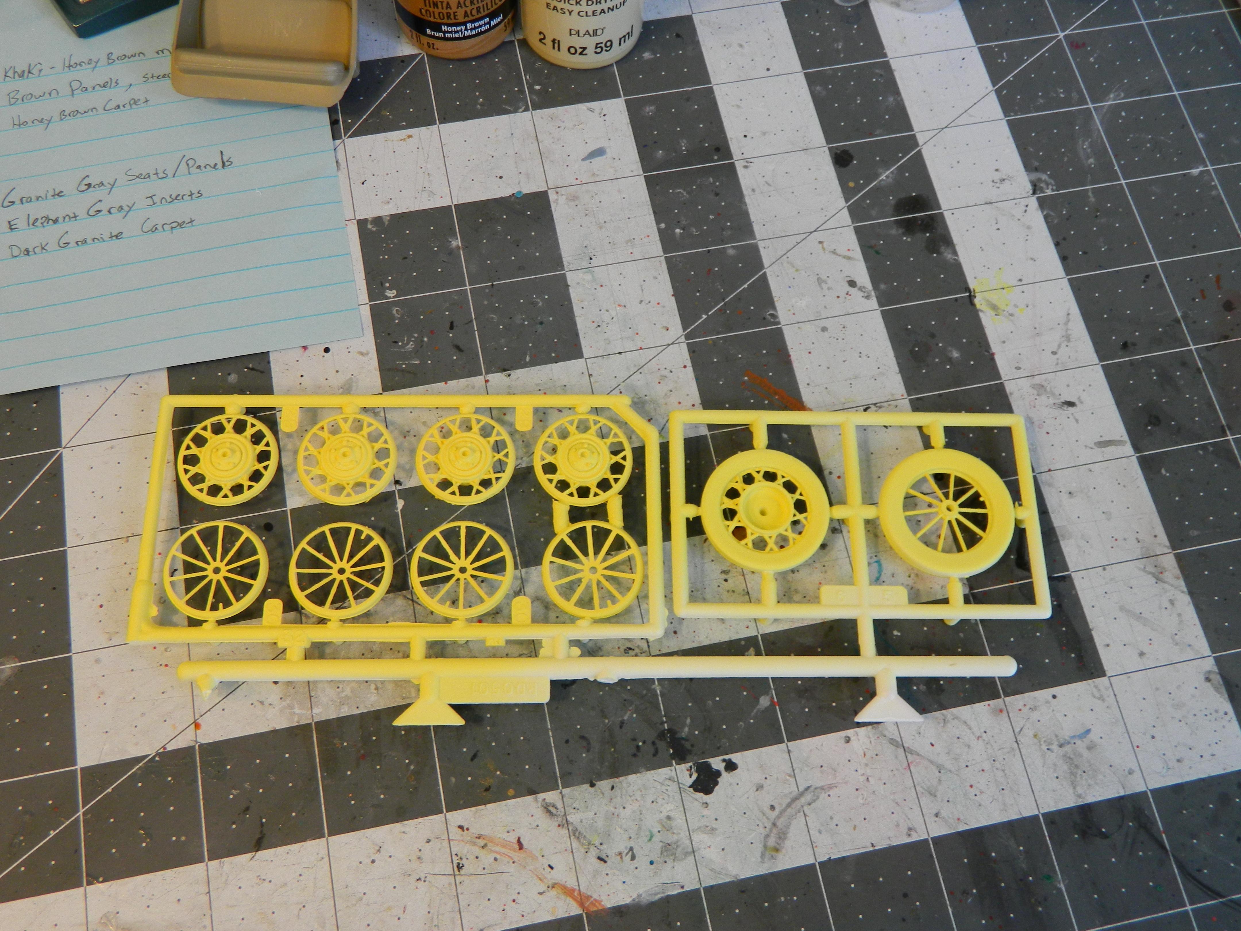

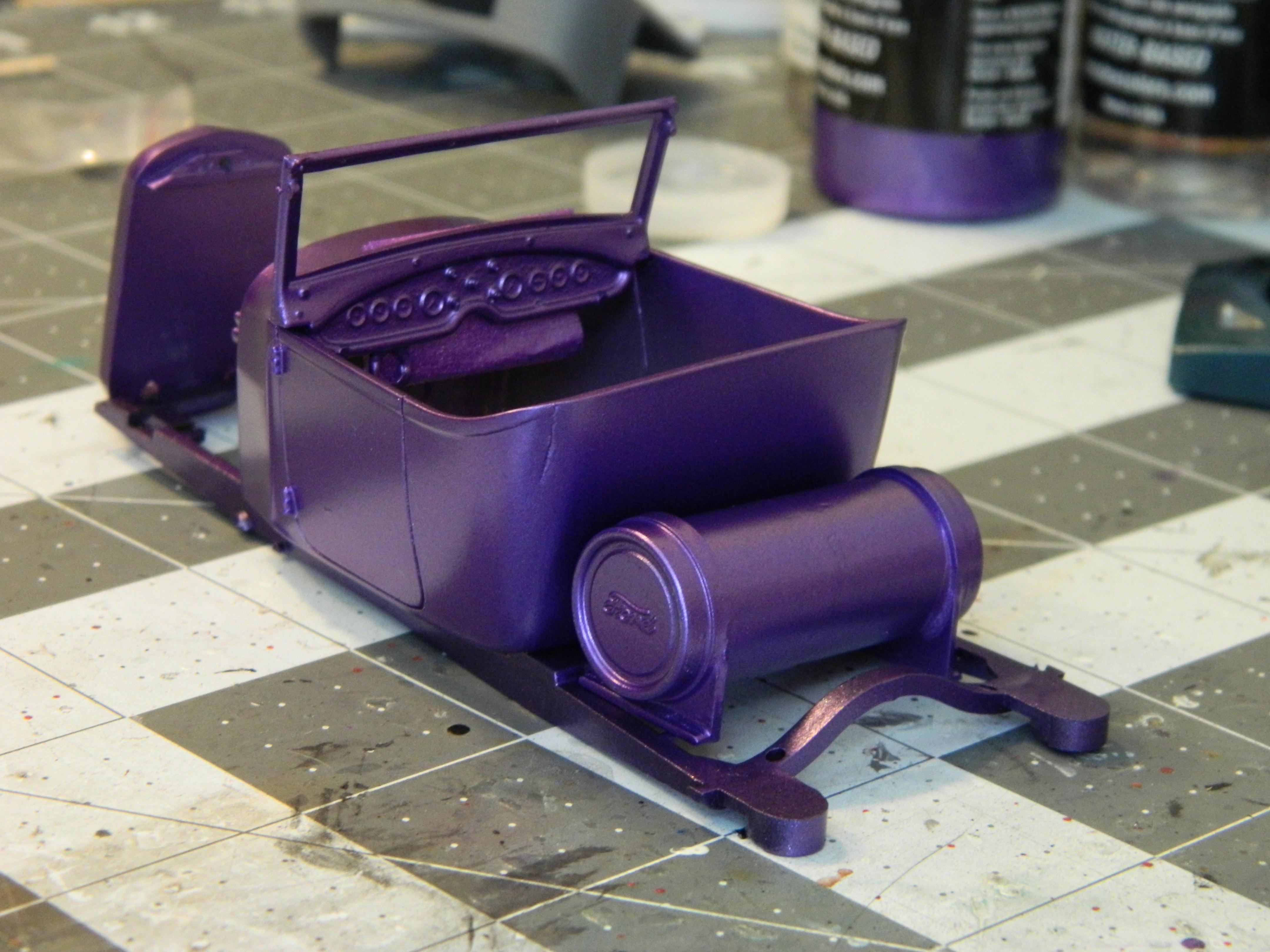

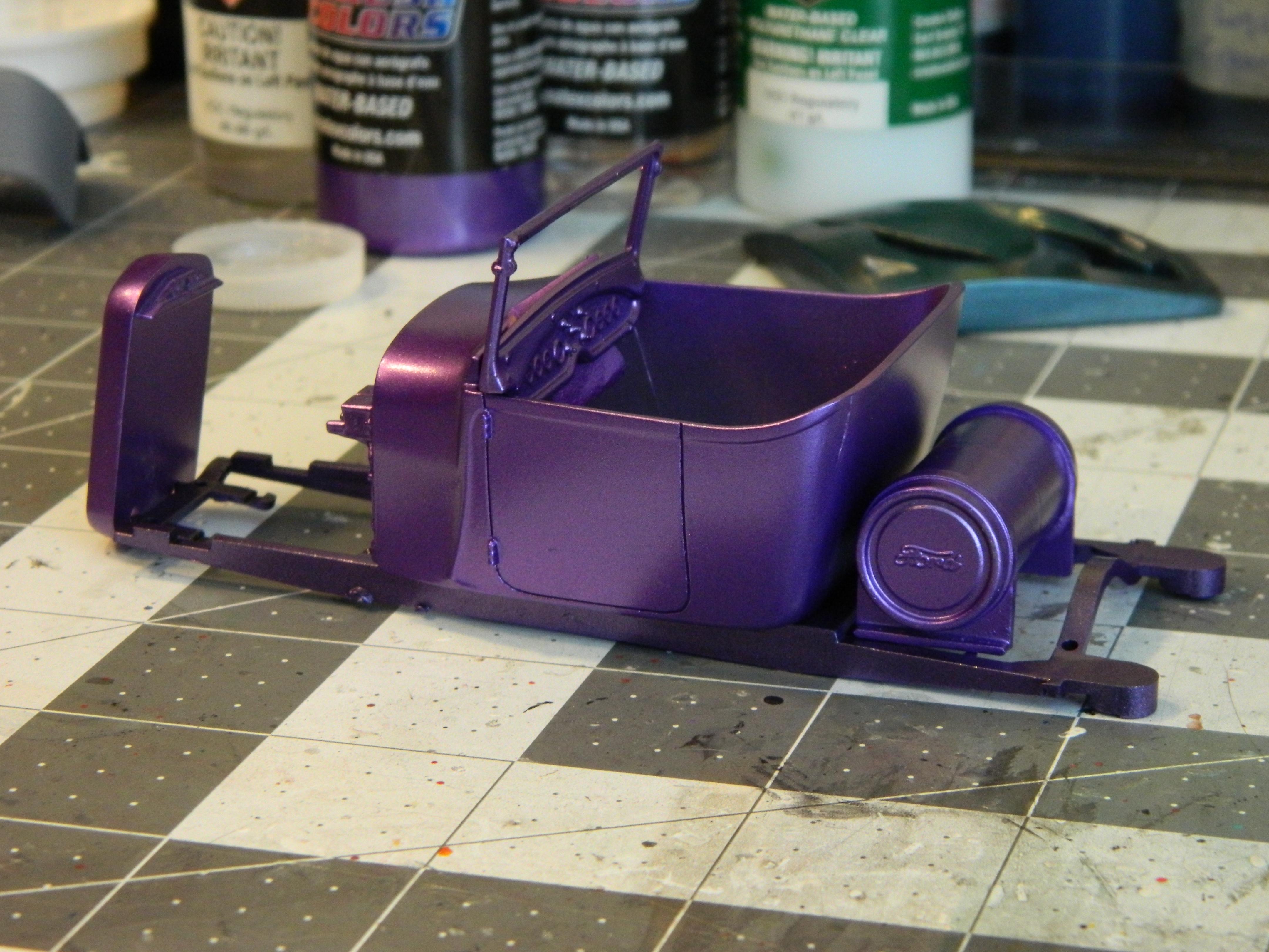

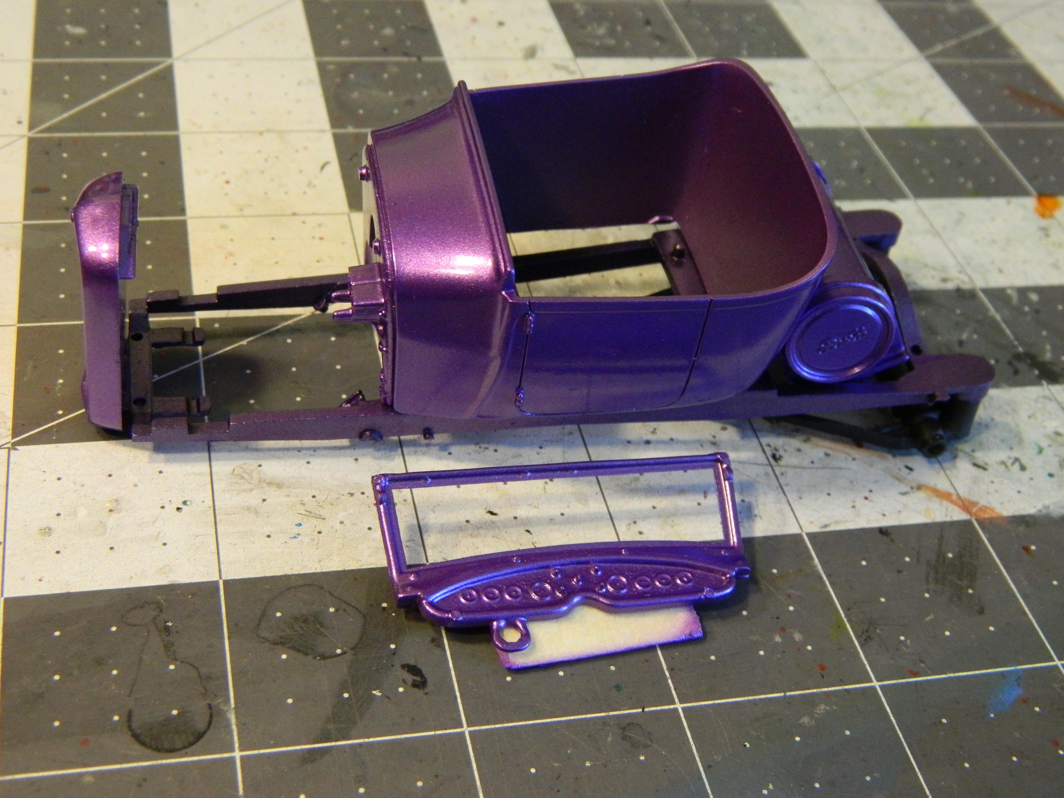

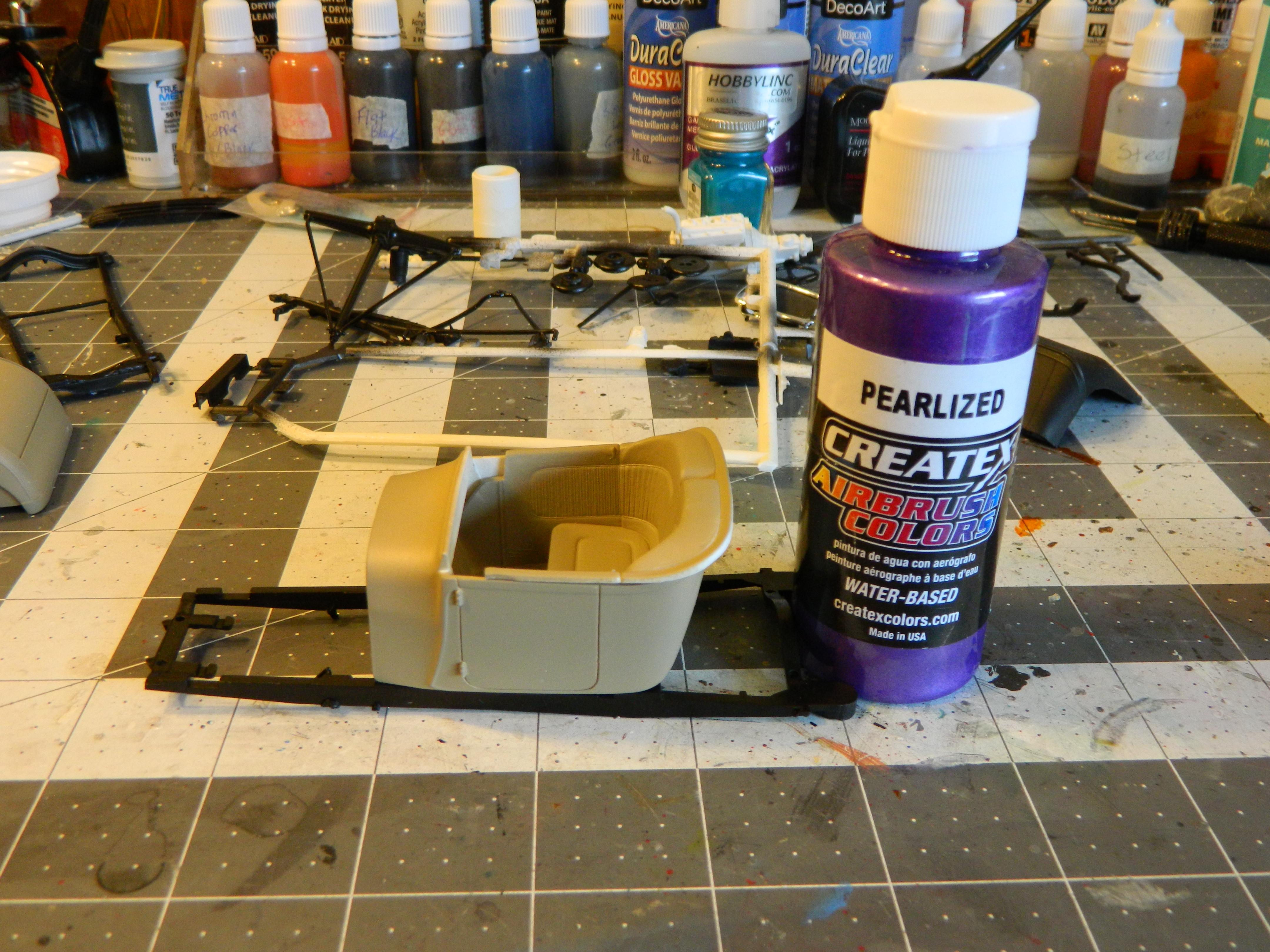

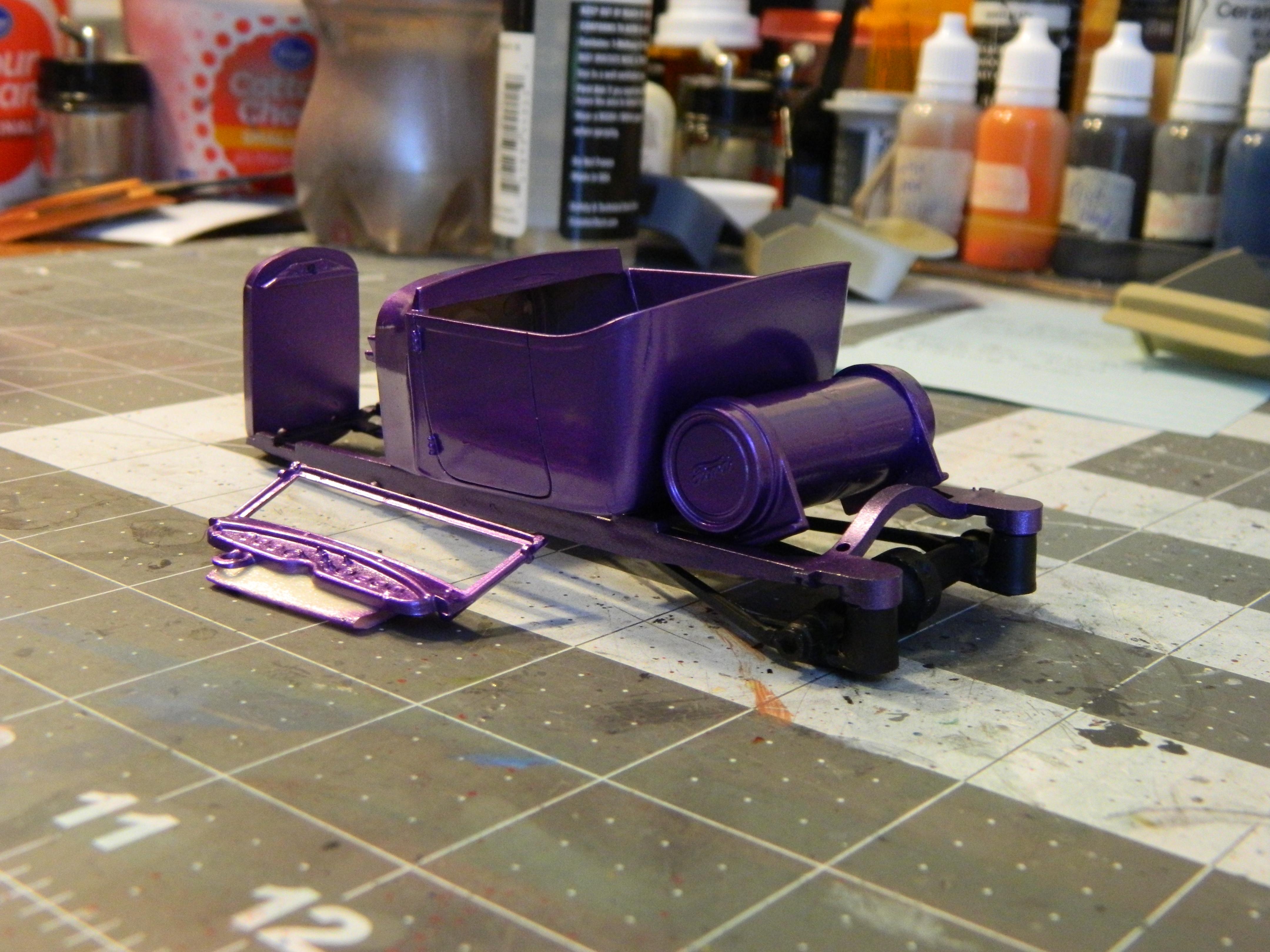

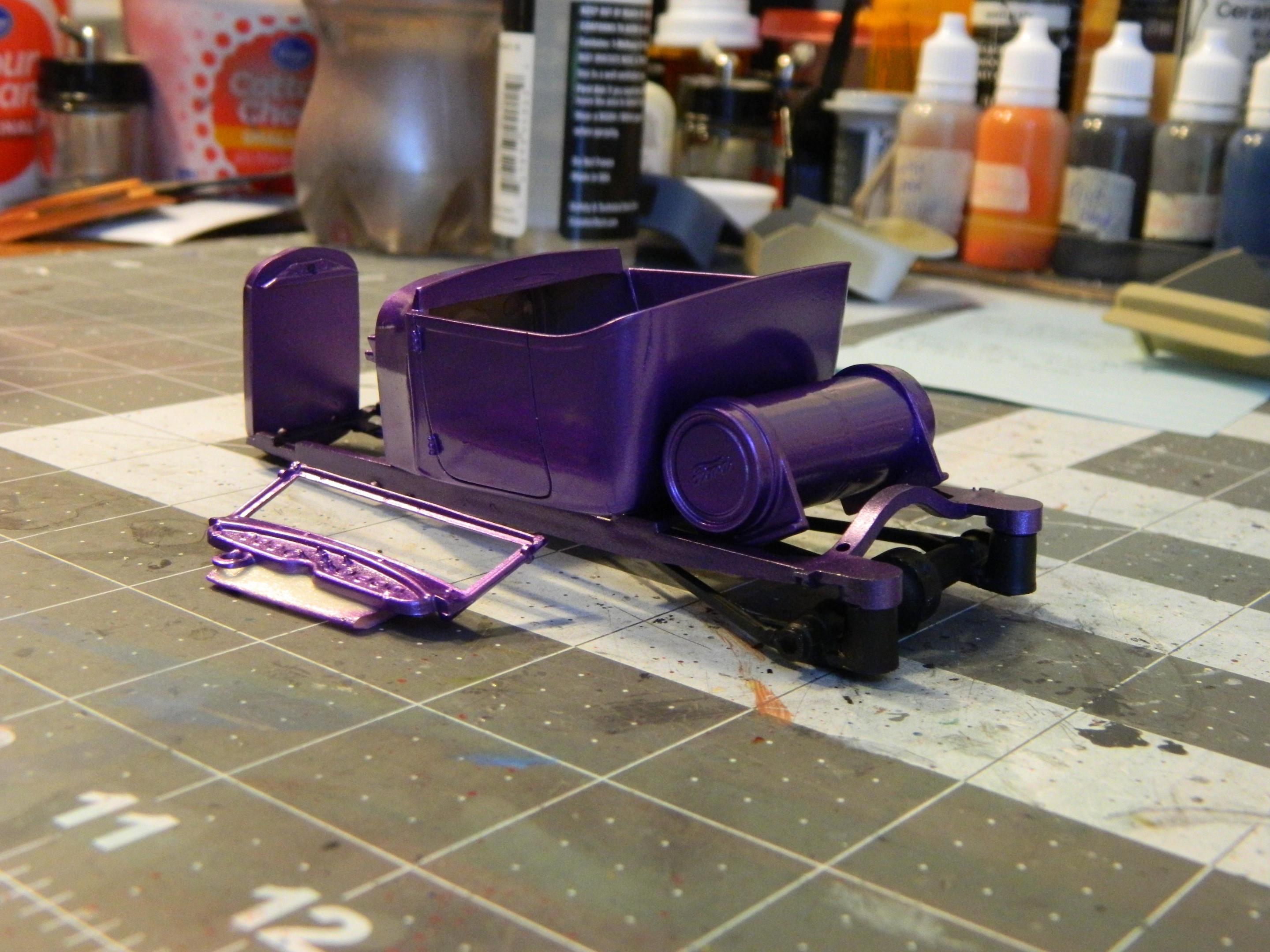

Dragonhawk1066 Posted August 22, 2022 Author Posted August 22, 2022 I mixed some metallic charcoal gray and sprayed it on the Hot Rod as a base coat last night, then sprayed the Createx Pearl Plum on this morning. I really like how it looks so far. I also sprayed Apple Barrel Sunny Day Yellow on the wheels for the stock version. I'm hoping to get the interiors sprayed tomorrow. 1

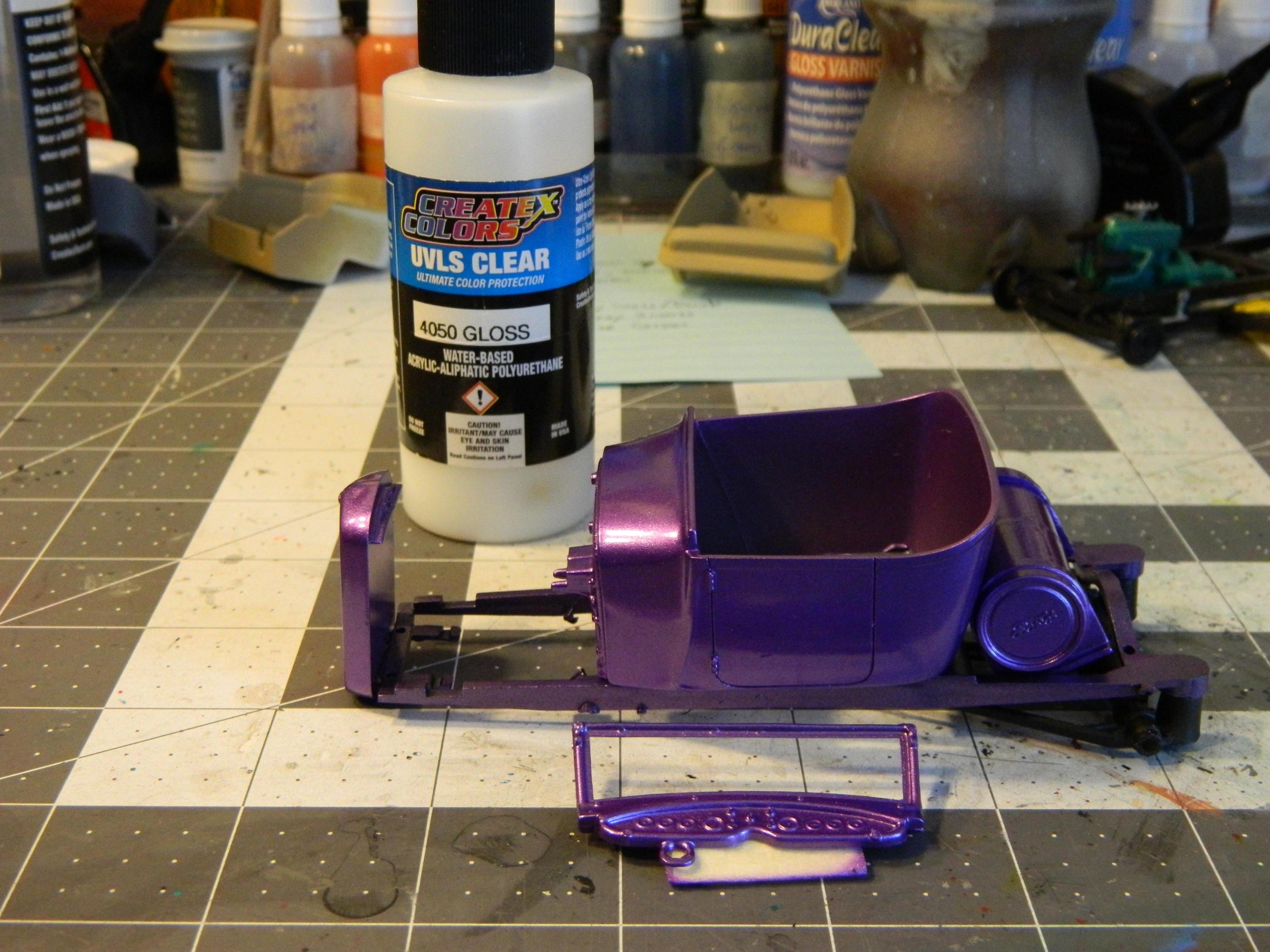

Dragonhawk1066 Posted August 23, 2022 Author Posted August 23, 2022 I sprayed the clear coats on both bodies today. I started with Decoart Gloss Varnish on the stock body, but either thinned it too much or not enough as it dried with some spots all over. After three coats, I decided to leave well enough alone and wait to see if it would sand/polish out. Next I mixed up Createx UVLS Gloss for the Hot Rod body, but mixed that a little too thick at first and my airbrush had some trouble spraying it consistently. After a couple of adjustments, I had a perfect mix. It laid down so nice on the Hot Rod, I decided to try it over the Decoart Varnish on the stock body. Two coats there did the trick. Still needs to be smoothed out, but much better.

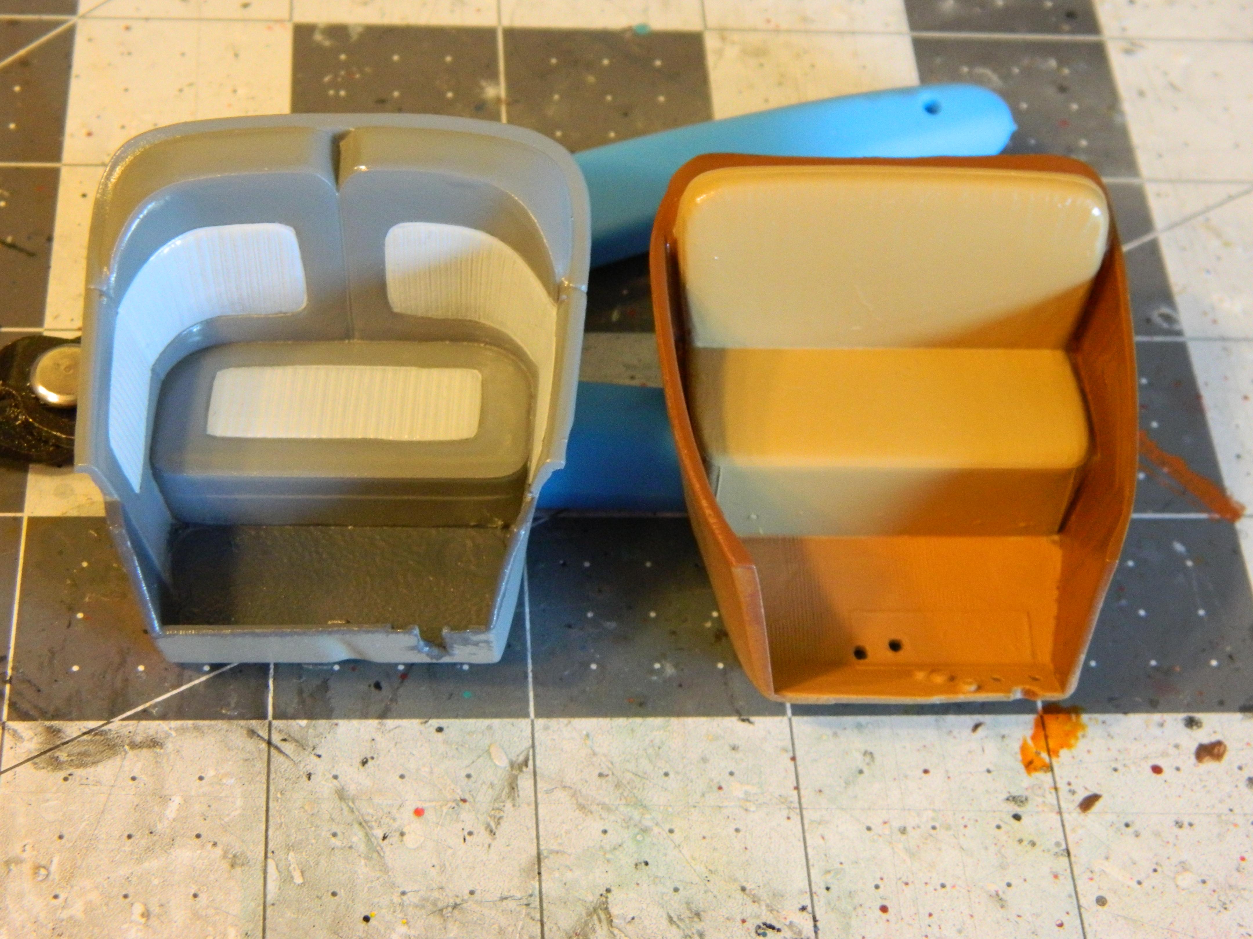

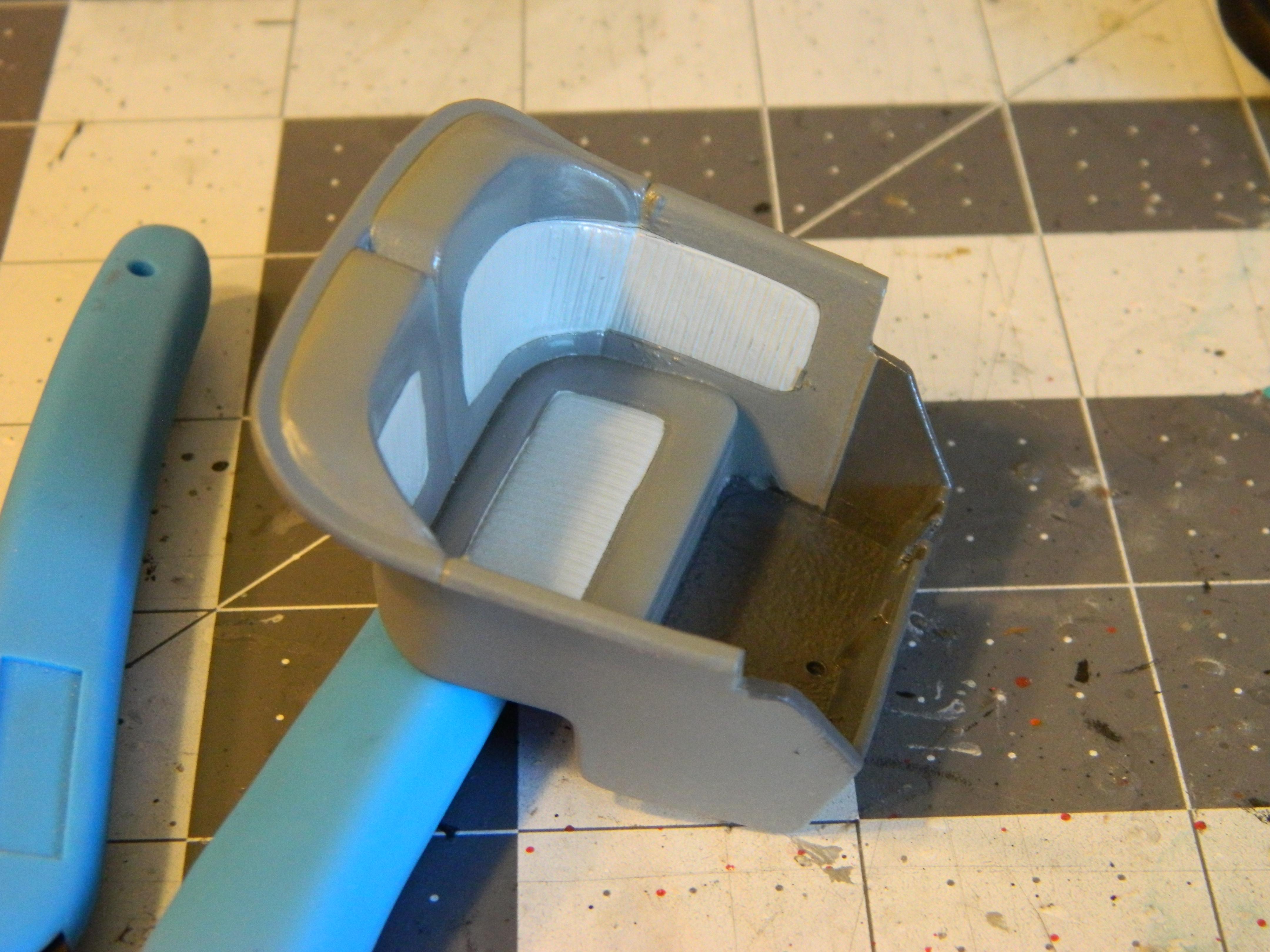

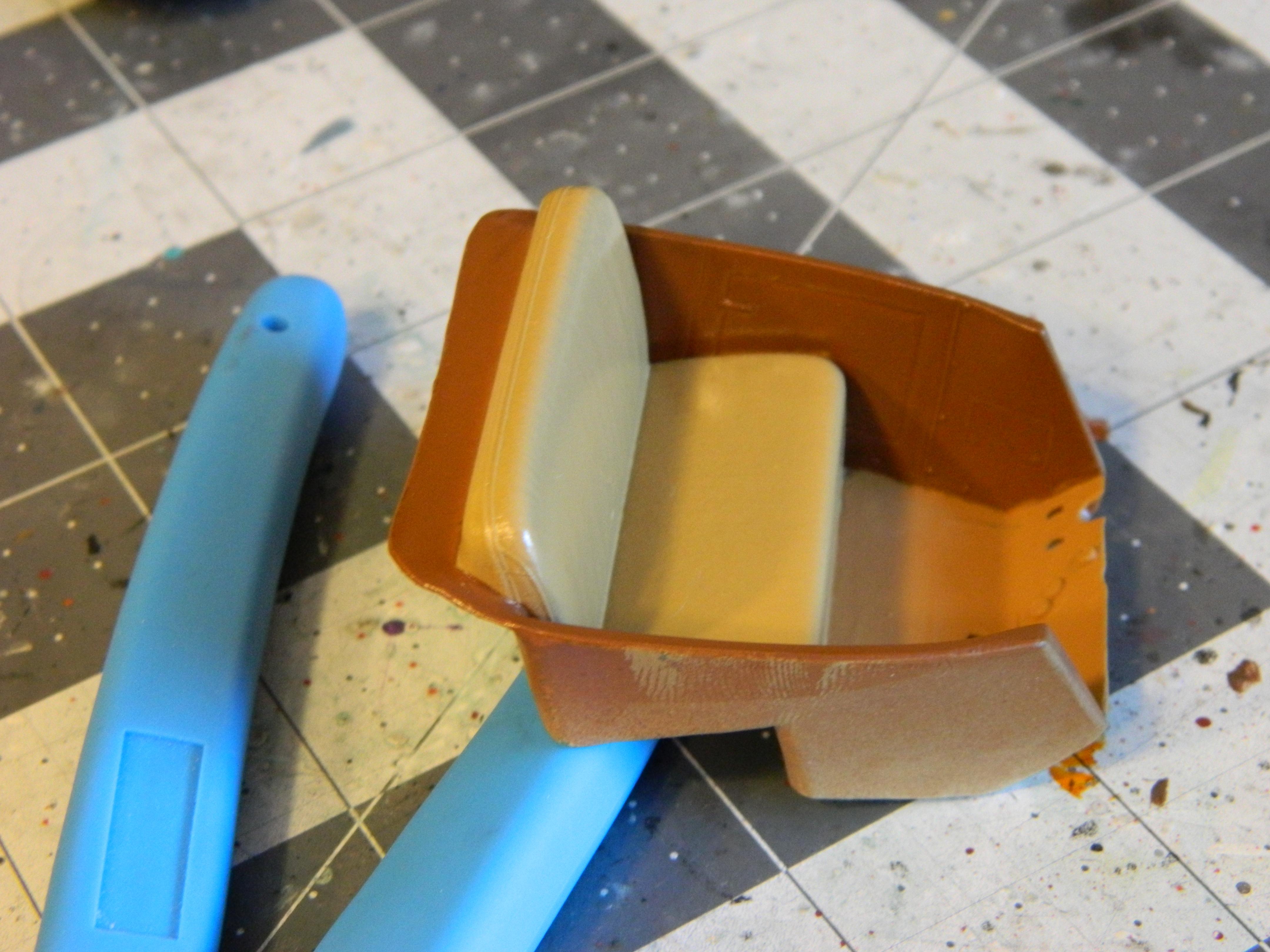

Dragonhawk1066 Posted August 24, 2022 Author Posted August 24, 2022 (edited) I got the interiors painted today, and also sprayed on some Satin Varnish to add some sheen. I still have some more details to paint, but I'll go ahead and start assembly and add the details when I get to them. I'll probably use the kit engine for the Hot Rod, but maybe a different induction system from the parts box. I'm also still tossing around wheel/tire combo ideas for the Rod. One of these years when I get a little extra cash?, I'll but some embossing powder for more realistic looking carpet. Edited August 24, 2022 by Dragonhawk1066
