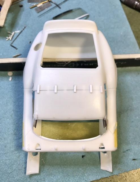

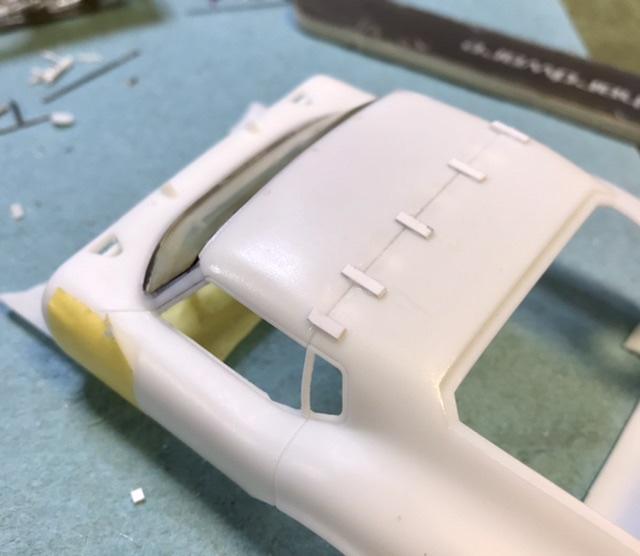

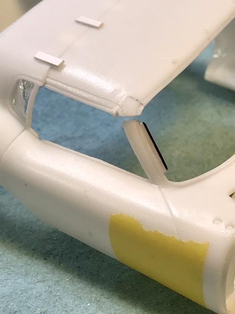

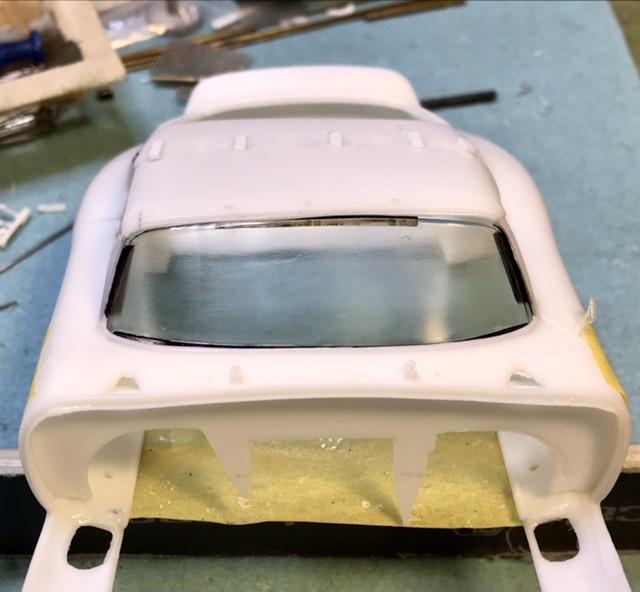

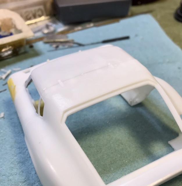

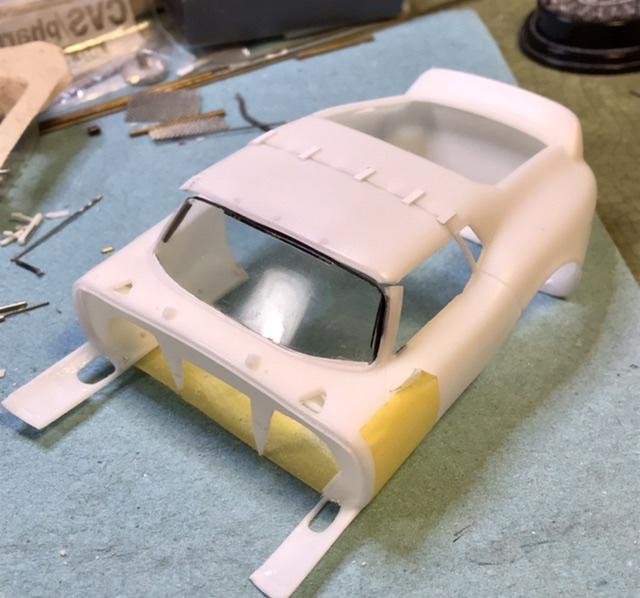

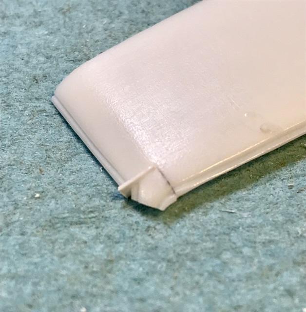

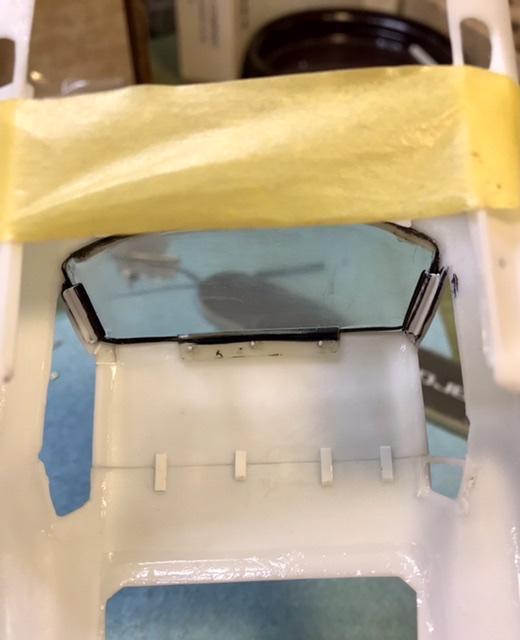

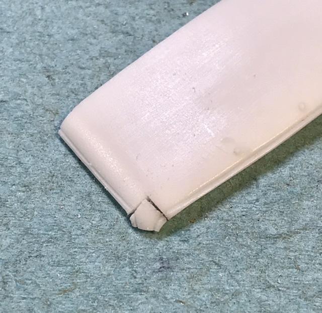

absmiami Posted August 30, 2022 Author Posted August 30, 2022 In order to line up the roof and get the A pillars symmetrical - Ive sawed off the right corner of the roof and re-glued it about one scale inch in - and then Ill re-profile the roof to make it all square …

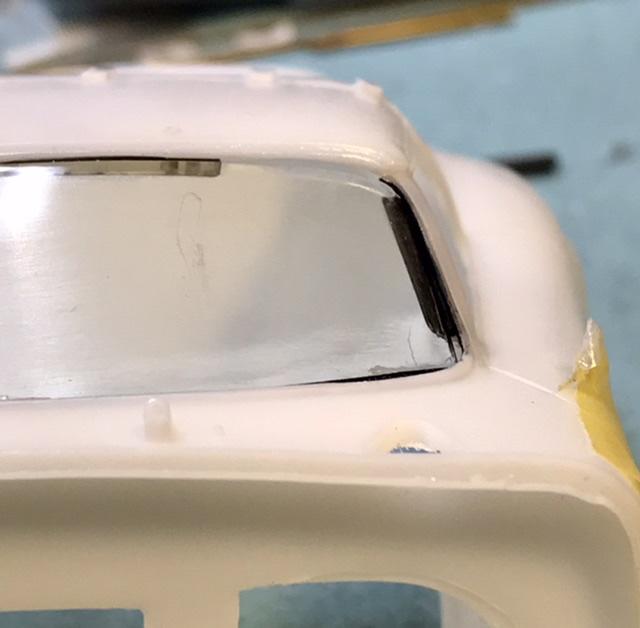

absmiami Posted August 30, 2022 Author Posted August 30, 2022 Almost done- another bath in hot water to shape the roof and then lots of CA glue …. The tabs are removed by sanding sticks - the windshield is in for good - i’ll mask it when I paint - I’ve still got small gaps at the roof line - but I’ll hide these with some sort of windshield seal…
Bugatti Fan Posted August 30, 2022 Posted August 30, 2022 That is a very advanced conversion you are doing Andrew.. I like your humorous response to my post. By the way, did you look on the C1 website to have a look at the Sebring MGC transkits?

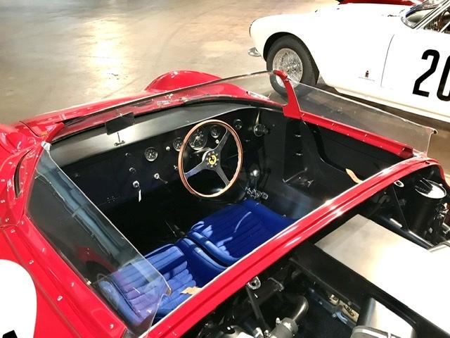

absmiami Posted August 30, 2022 Author Posted August 30, 2022 Pretty sure that this is our factory #21 Ferrari P entrant - owned by the Chinetti family - i photographed it at the Simeone Collection in 2020 - can’t recall if it is on permanent display there …. Whose claiming it ?
Gramps46 Posted August 30, 2022 Posted August 30, 2022 Simione is claiming it. 814P, last I know. In 1966 in caught fire and was nearly destroyed but rebuilt.
