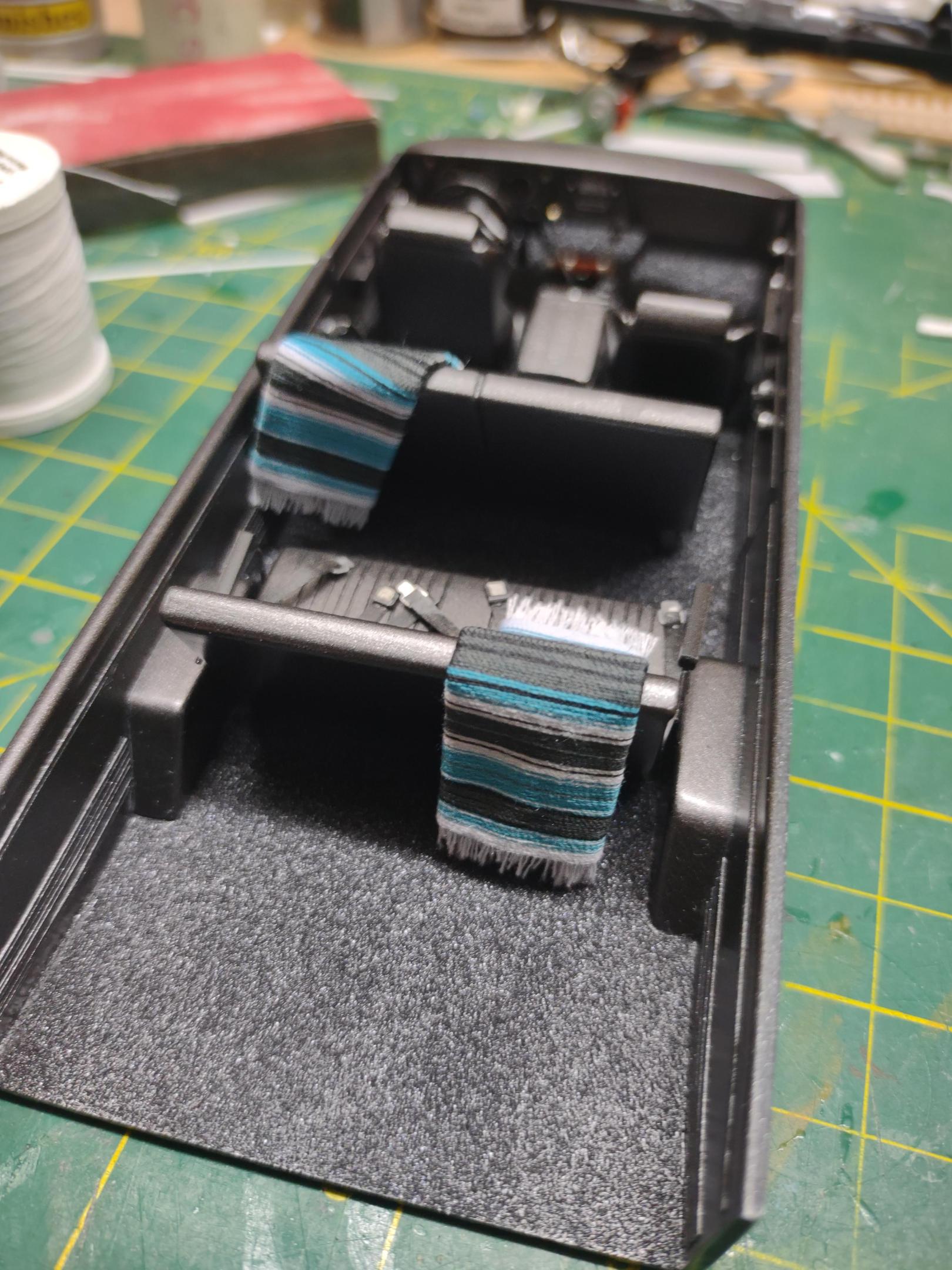

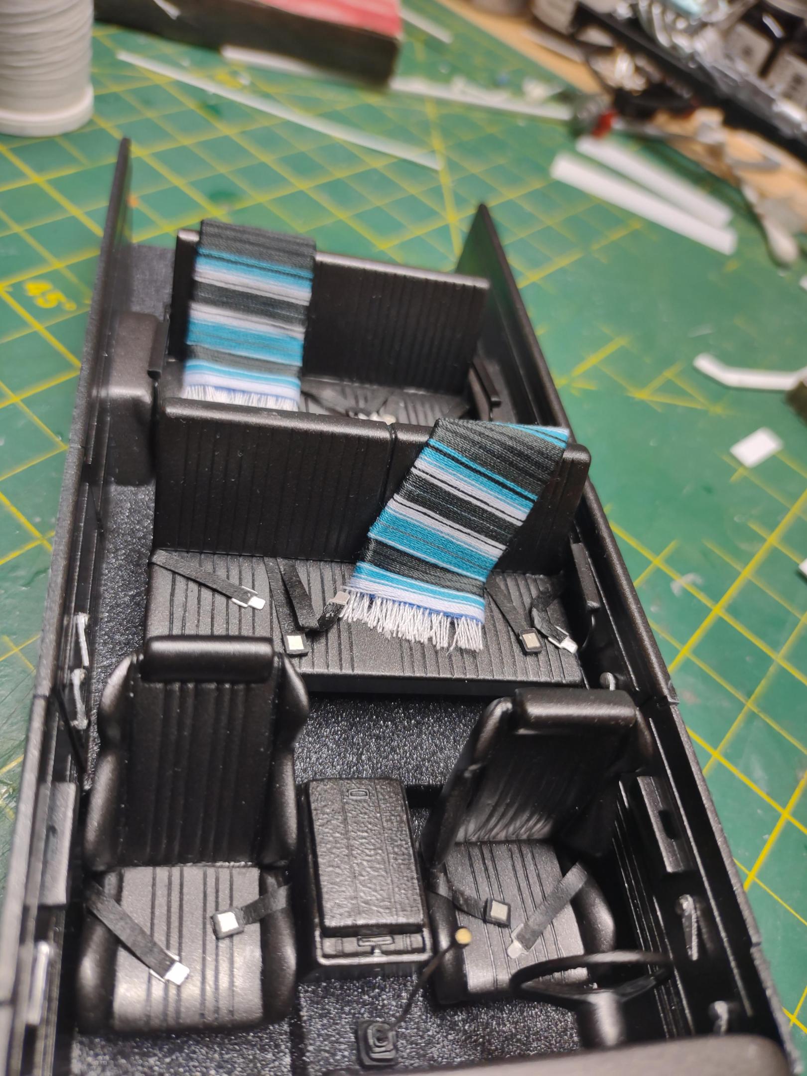

64SS350 Posted August 27, 2023 Author Posted August 27, 2023 Wanted to try this, so I made a couple extras for the interior. 4

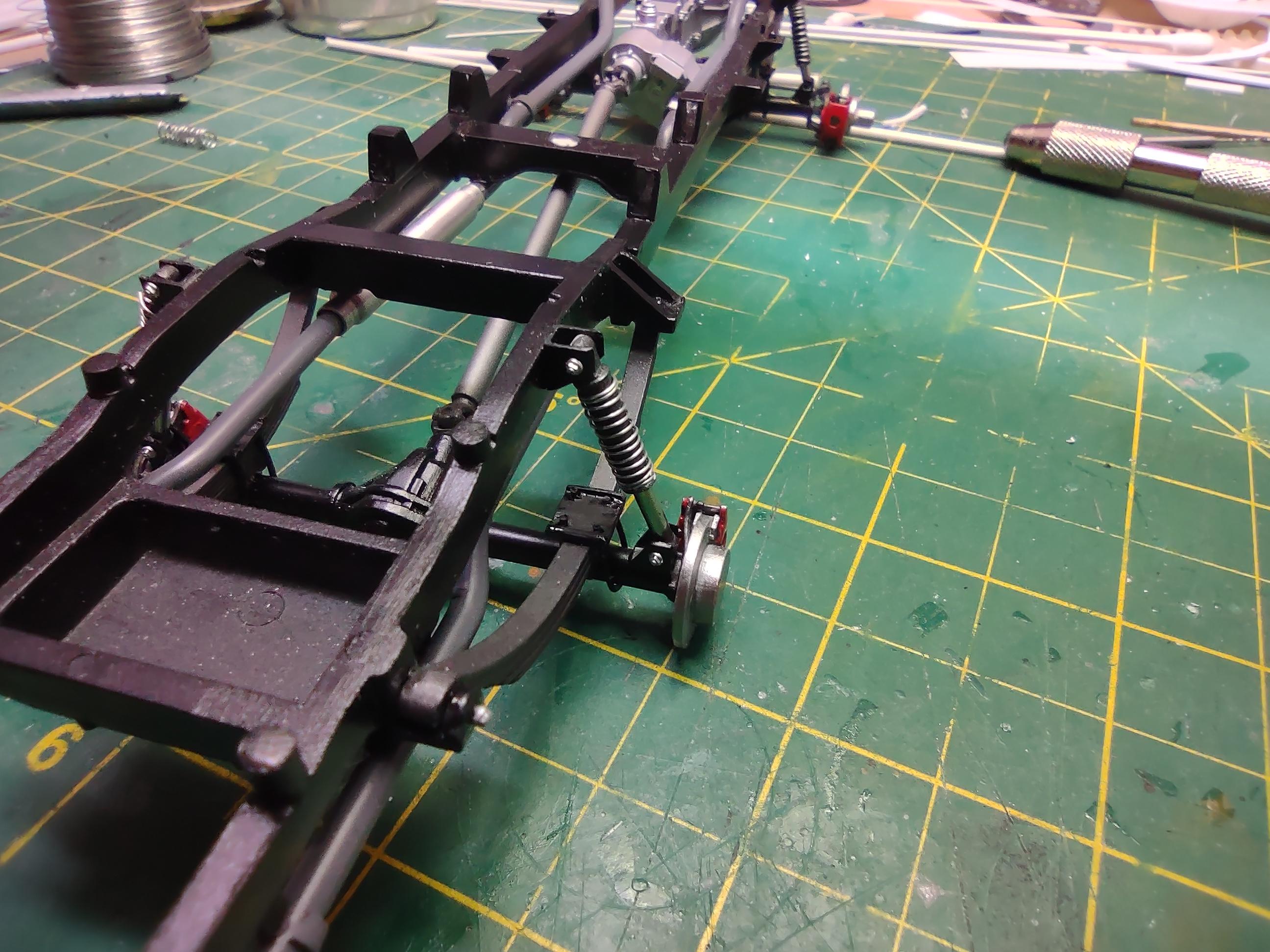

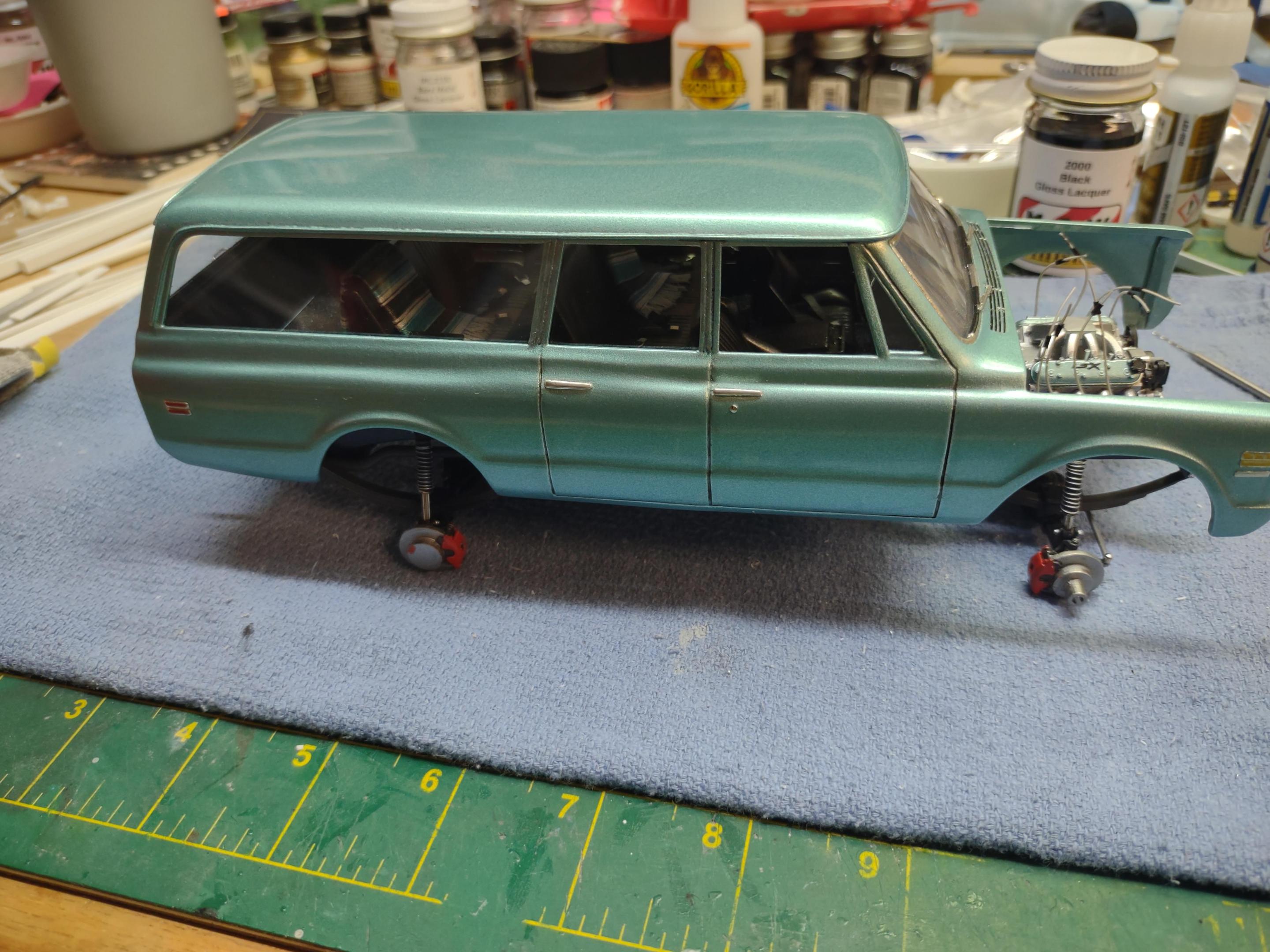

64SS350 Posted September 15, 2023 Author Posted September 15, 2023 Finally! The coilovers are done! 3
Bills72sj Posted September 15, 2023 Posted September 15, 2023 Nice work with the seatbelts and buckles.

NOBLNG Posted September 23, 2023 Posted September 23, 2023 On 9/14/2023 at 7:51 PM, 64SS350 said: Finally! The coilovers are done! Great work on the suspension, and those brake calipers look fantastic.?
Chariots of Fire Posted September 23, 2023 Posted September 23, 2023 Got a question. Does the center seat fold to allow entry to the back seat?
64SS350 Posted September 23, 2023 Author Posted September 23, 2023 Thanks for the encouraging remarks! If you look at the first bench seat, there is a center split. I added it after the seat was made. And yes it should be "1/3" or "1/4" split, but I wasn't rebuilding the seat.
Raymond Gallant Posted September 24, 2023 Posted September 24, 2023 On 9/14/2023 at 9:51 PM, 64SS350 said: Finally! The coilovers are done! I've been watching your project and really like where you're going with this. Can't wait to see it come together. Just a hint for your coil-over springs, next time try wrapping the wire in the threads of an appropriate size bolt. That way you can "unscrew" the spring and the coils will all be evenly spaced.
64SS350 Posted September 24, 2023 Author Posted September 24, 2023 17 hours ago, Raymond Gallant said: I've been watching your project and really like where you're going with this. Can't wait to see it come together. Just a hint for your coil-over springs, next time try wrapping the wire in the threads of an appropriate size bolt. That way you can "unscrew" the spring and the coils will all be evenly spaced. That sounds like a good idea. But the wire I had and what I could find is aluminum, so holding the shape is challenging. 1

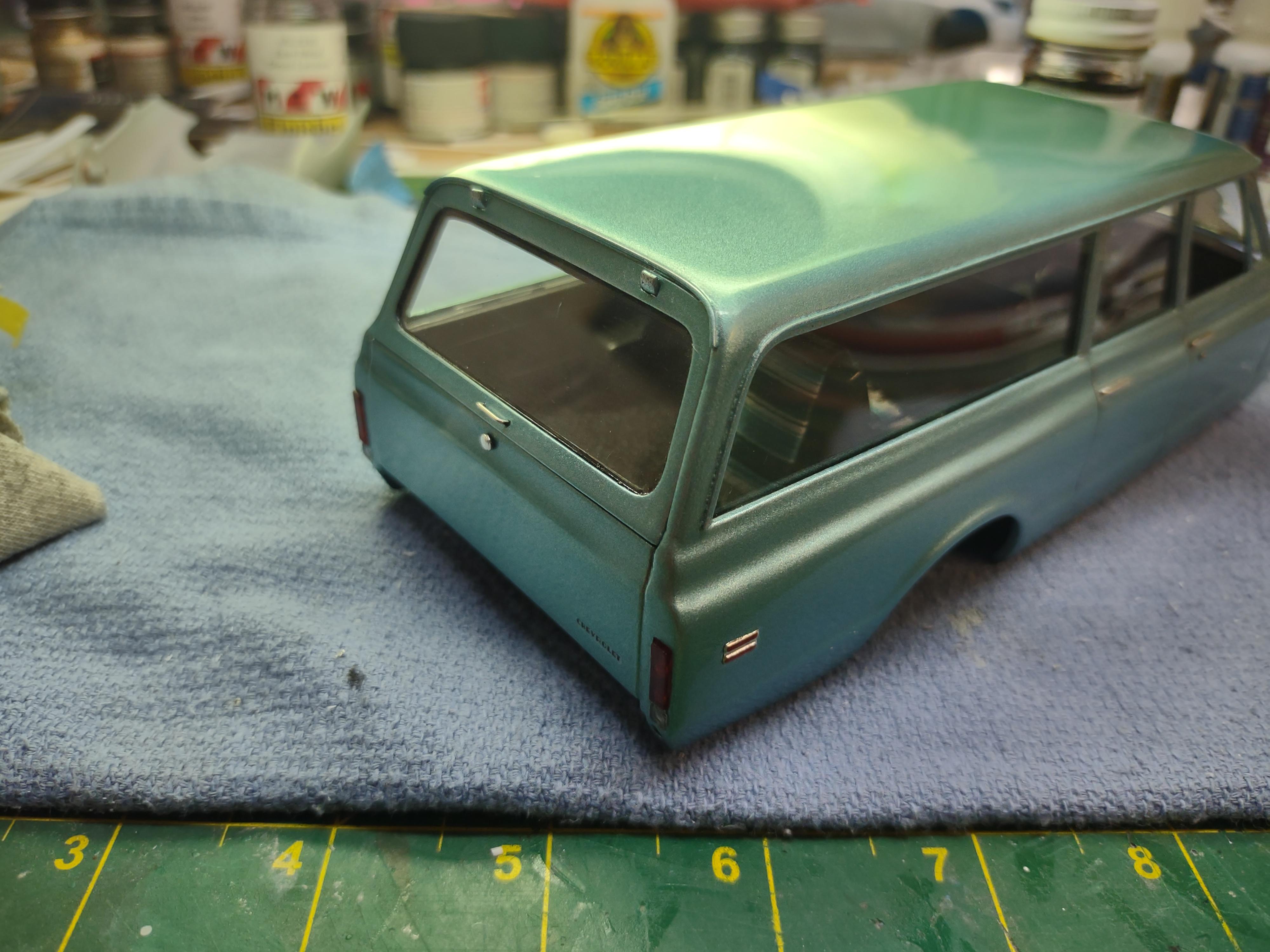

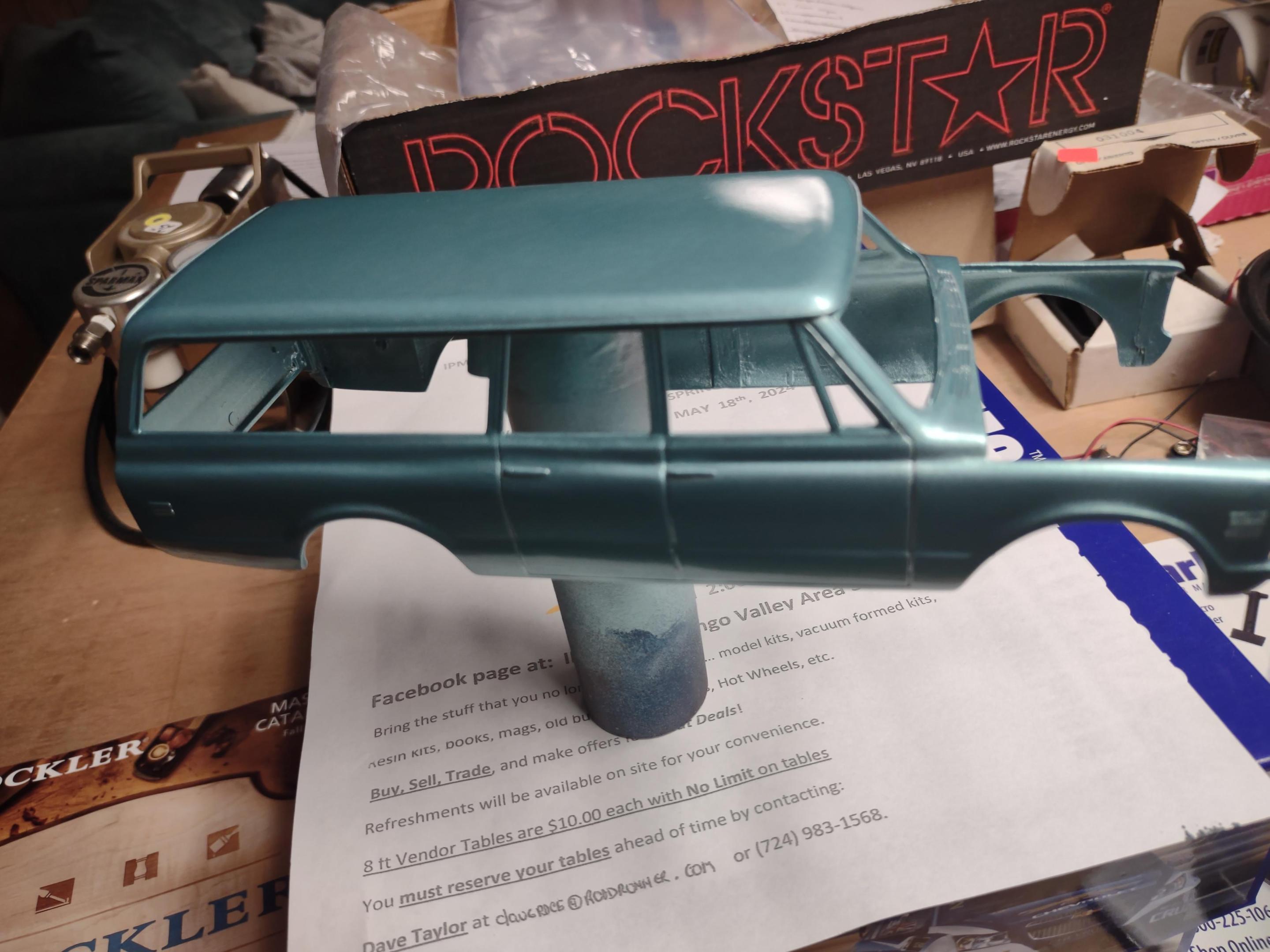

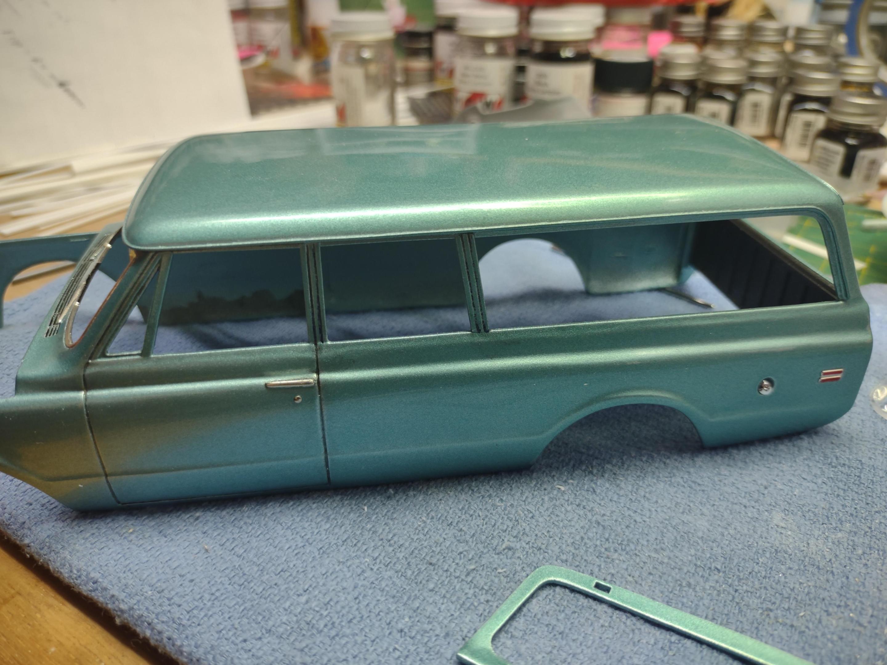

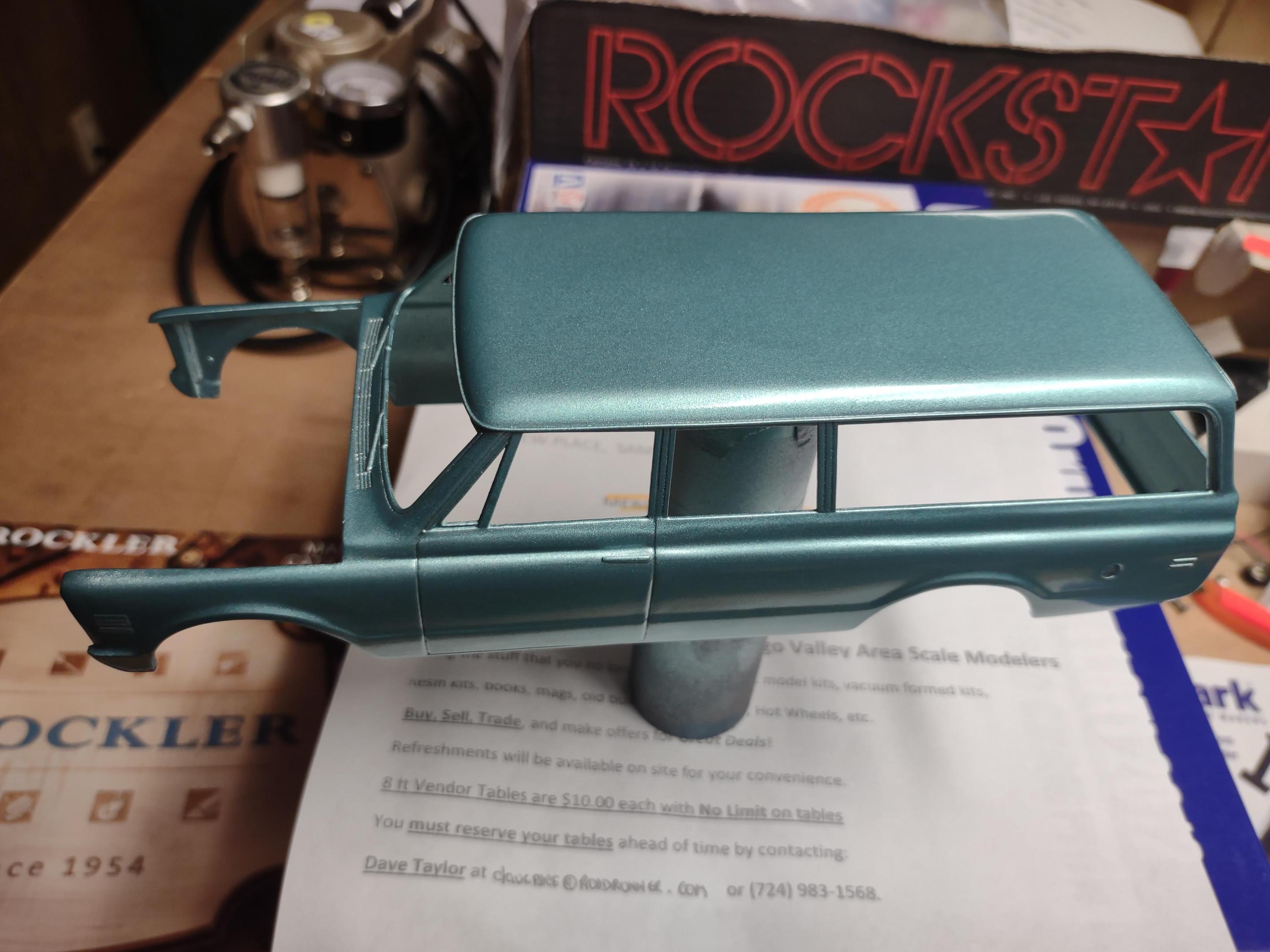

64SS350 Posted November 14, 2023 Author Posted November 14, 2023 (edited) Painted the body a couple weeks ago, spray can Model Master lacquer. I now the body work wouldn't be perfect, just ready for it to be painted. After I used MCW clear, a couple spots showed up that appeared to "raise". I sealed all the mudded areas with super thin CA and final sanded, plus Duplicator primer. It's only on the hood and the roof joint, pondering to fix or let go.(and no...I don't drink Rockstar..lol) Edited November 14, 2023 by 64SS350 3
NOBLNG Posted November 15, 2023 Posted November 15, 2023 I hate it when that happens. Paint is always the part that intimidates me the most. I can’t see anything wrong with the roof in the pics. Shame about the hood, the color looks great on it though. 1
64SS350 Posted November 15, 2023 Author Posted November 15, 2023 The roof problem is in the middle, at the joint. Hard to see in pics, but stands out to the naked eye. I even blocked that roof several times. I'm thinking of buying a printed roof rack for it anyway. I too like the color, but heavy on the metallics. 1

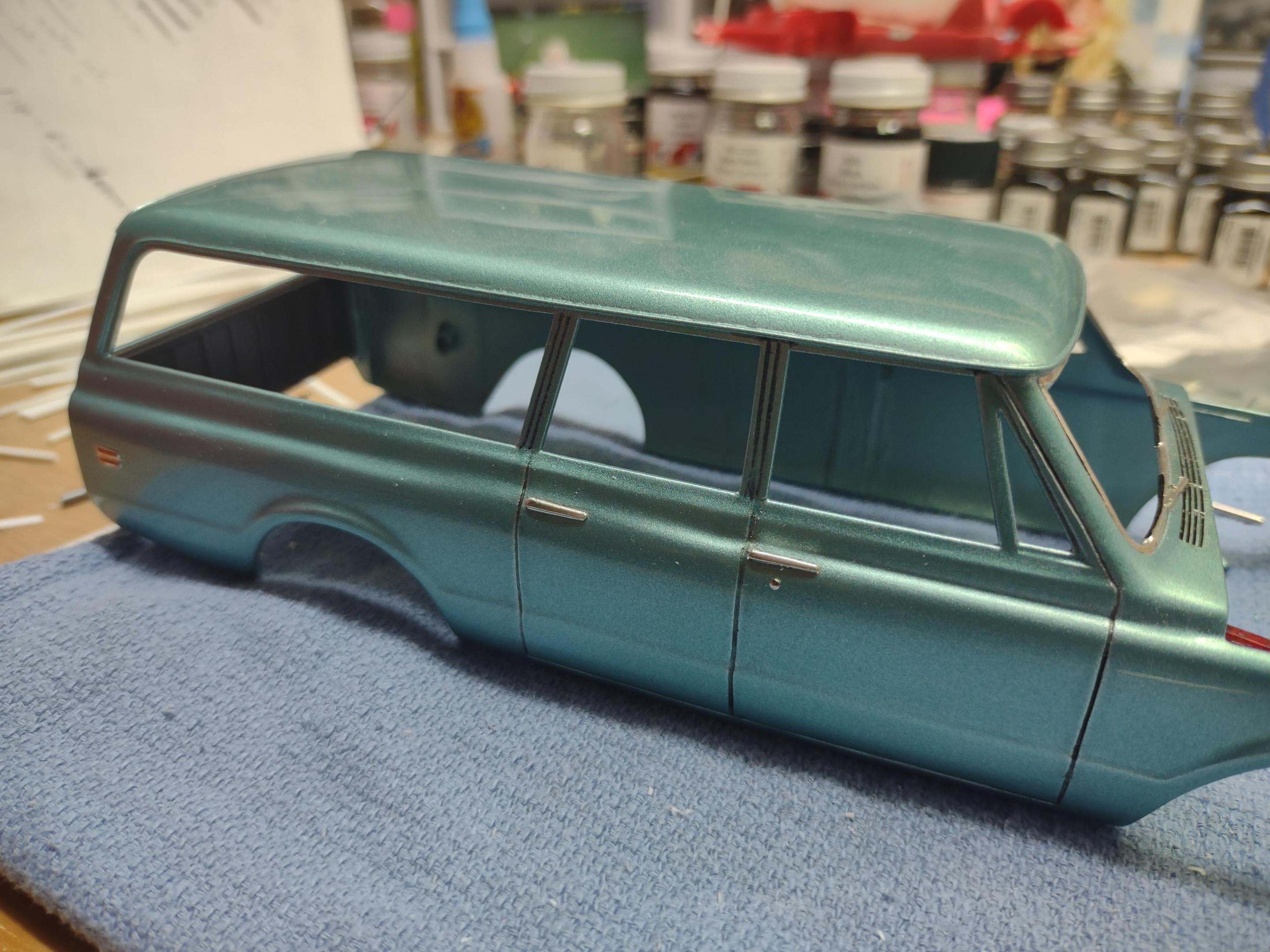

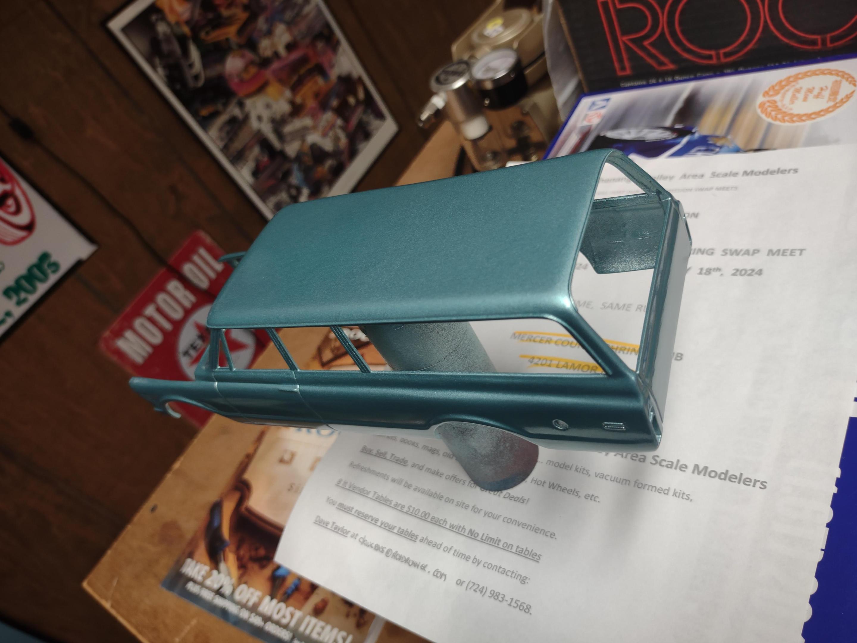

64SS350 Posted November 17, 2023 Author Posted November 17, 2023 (edited) Hood is in the brake fluid, polished the body in the meantime, which actually removed the lines that I previously mentioned on the roof! Edited November 17, 2023 by 64SS350 4

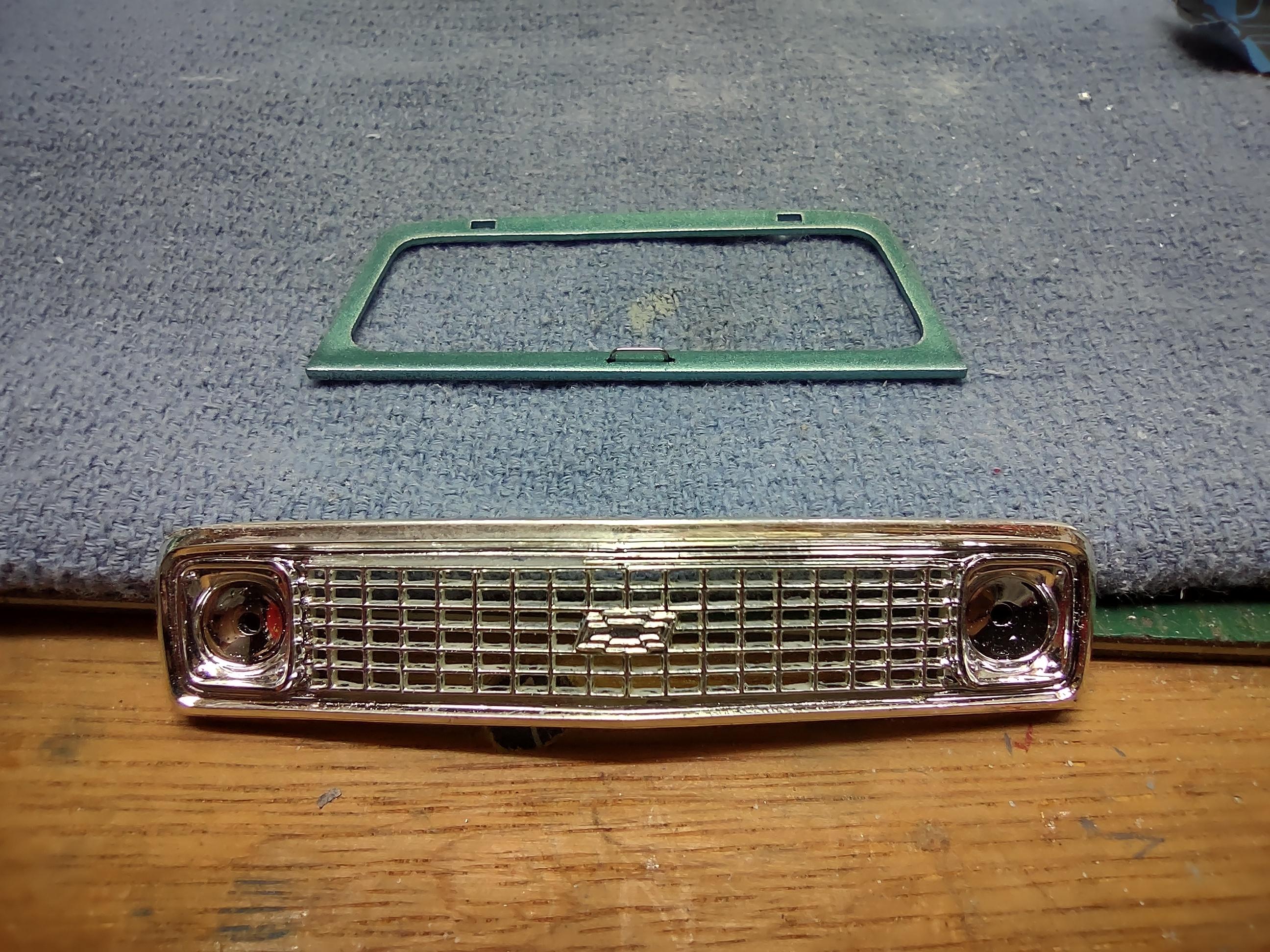

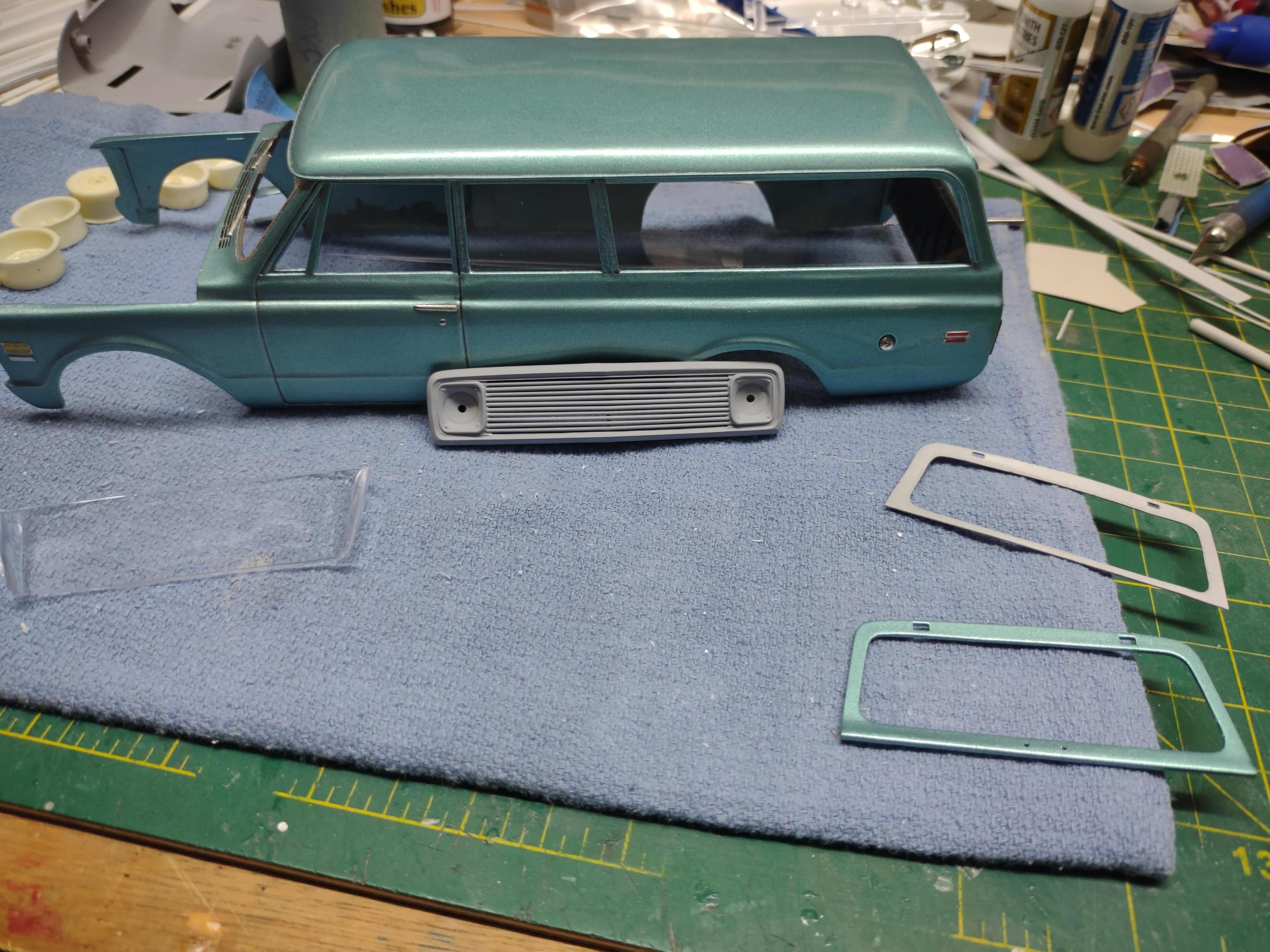

64SS350 Posted January 1, 2024 Author Posted January 1, 2024 Sooo, I got tired of trying to make the grill slots look even, and changed to this style. Working on windows also, sides are in, front and rear are next. Hood is ready for clear. 1

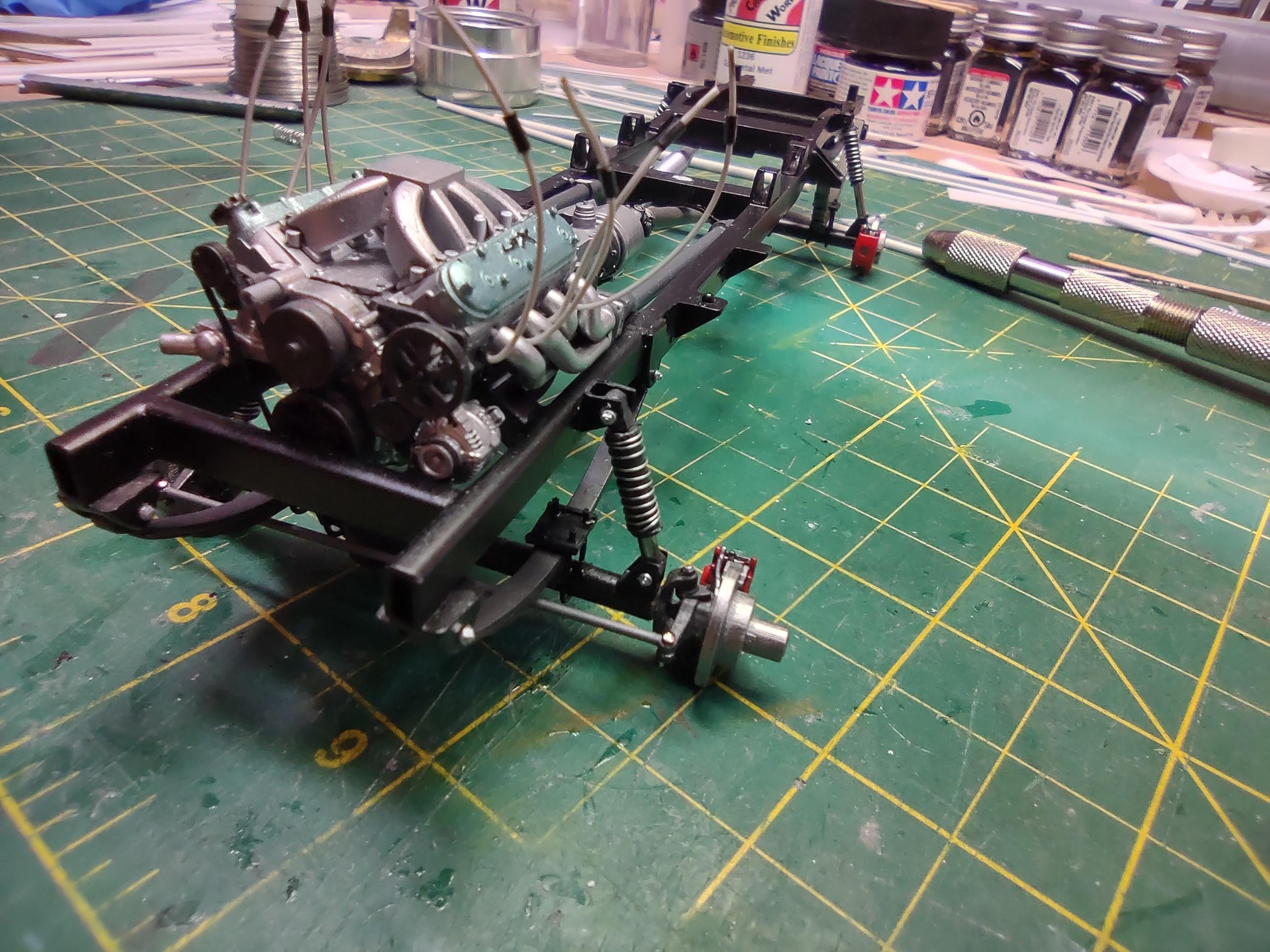

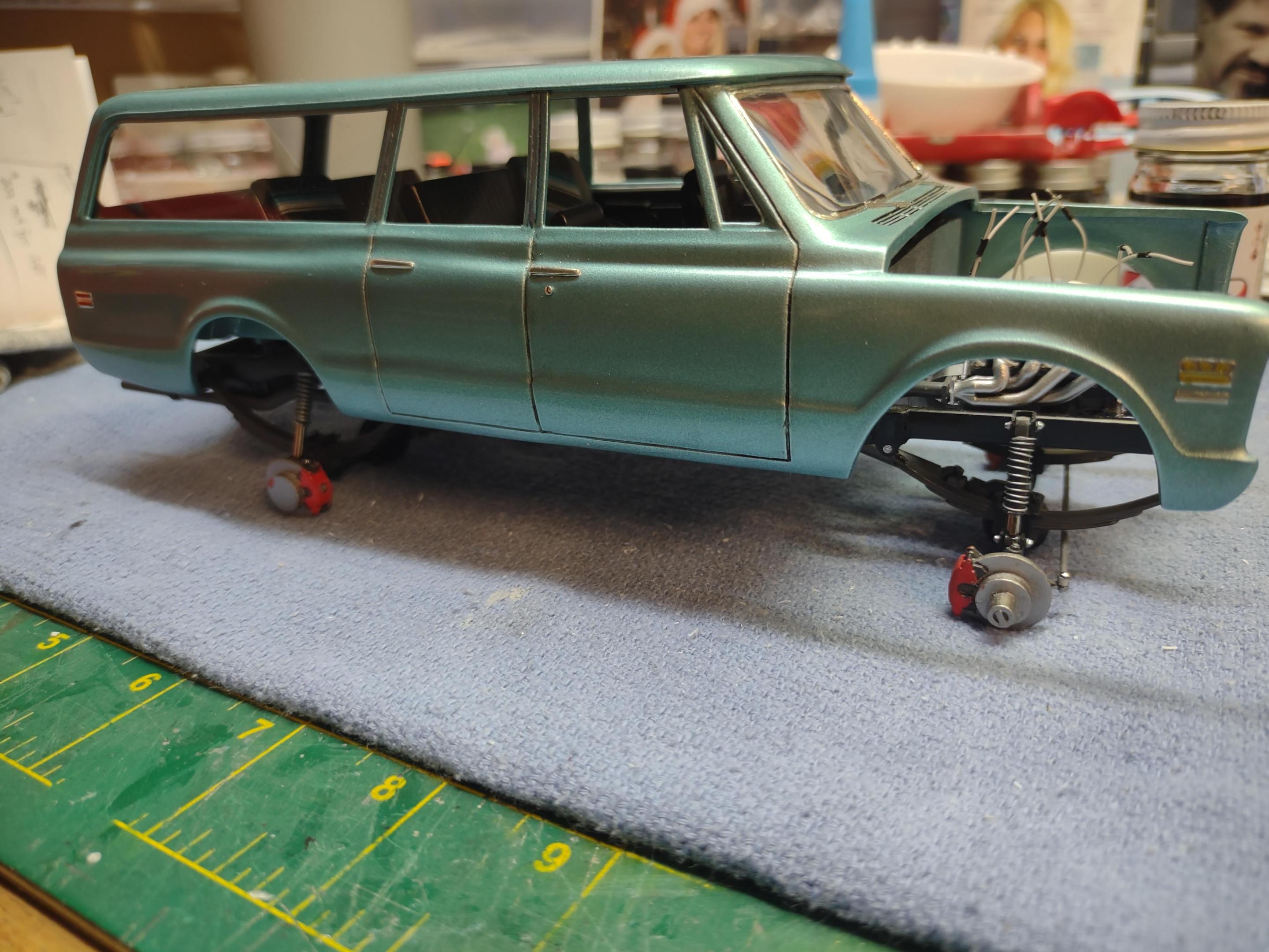

64SS350 Posted January 3, 2024 Author Posted January 3, 2024 All windows are in, as well as interior tub. Back hatch is not glued shut, but tight enough fit I don't want to try to open it. Going to test fit the chassis next and choose tires. I think this is going to end up taller than I expected or wanted. Engine bay is going to have a mold made of it before I slightly modify one to accommodate the headers. 2
