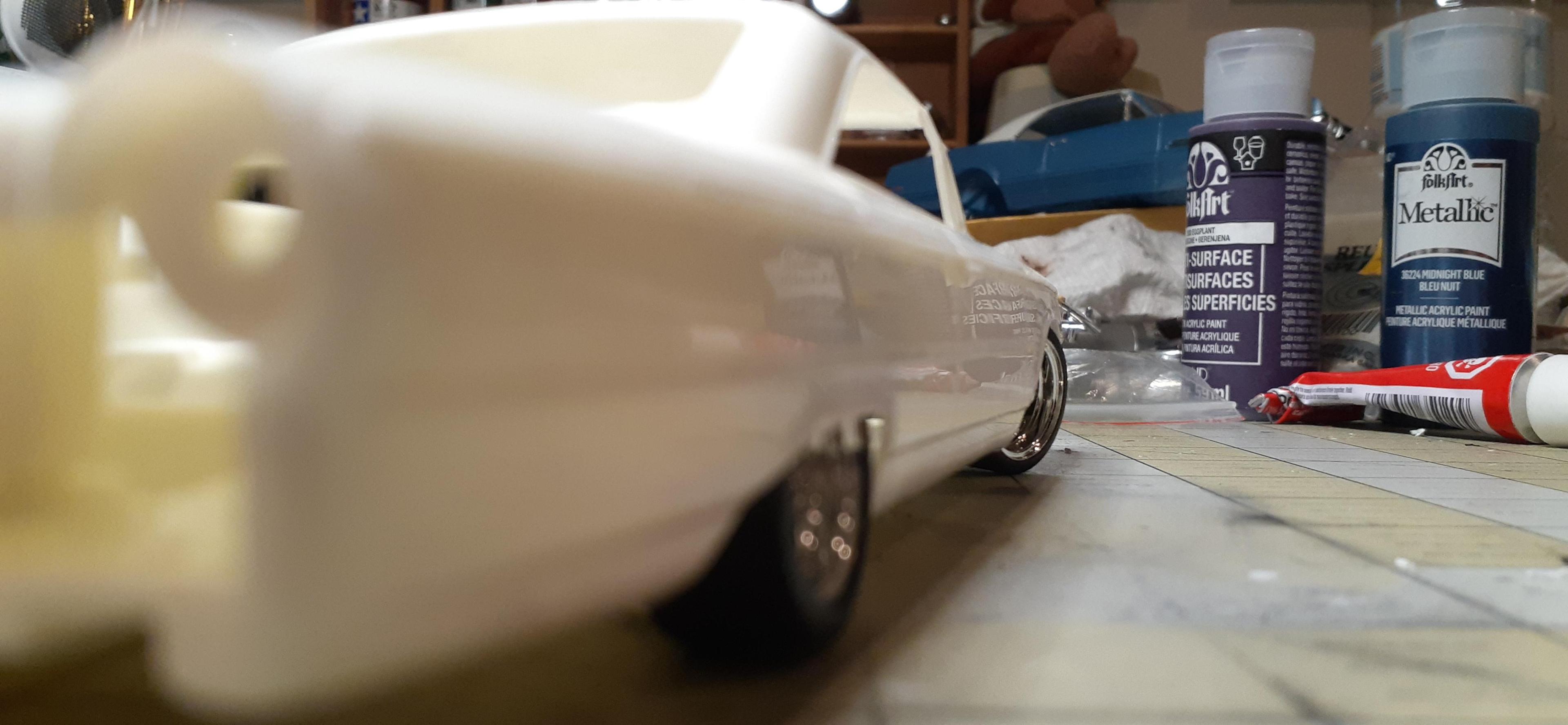

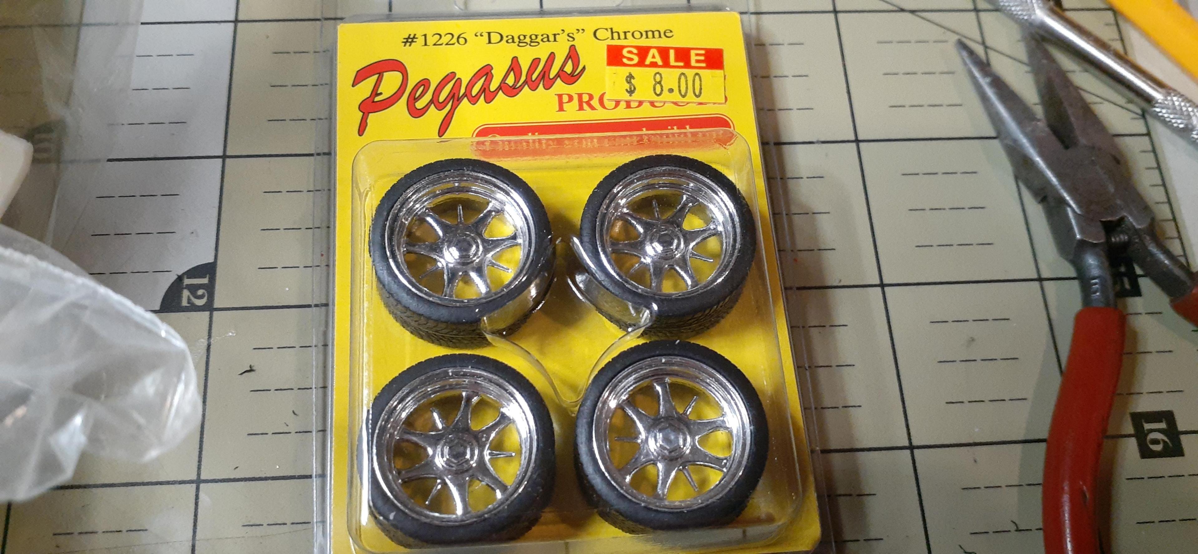

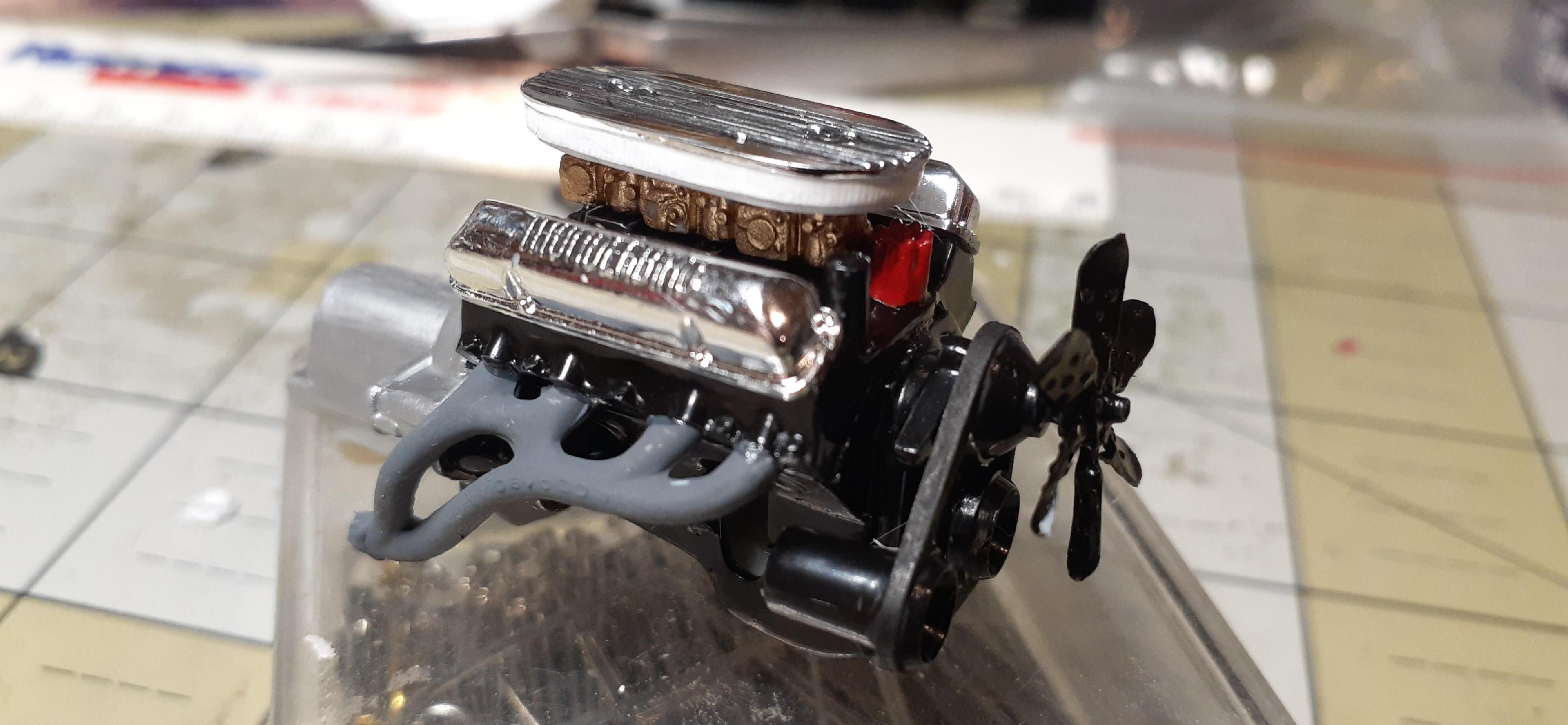

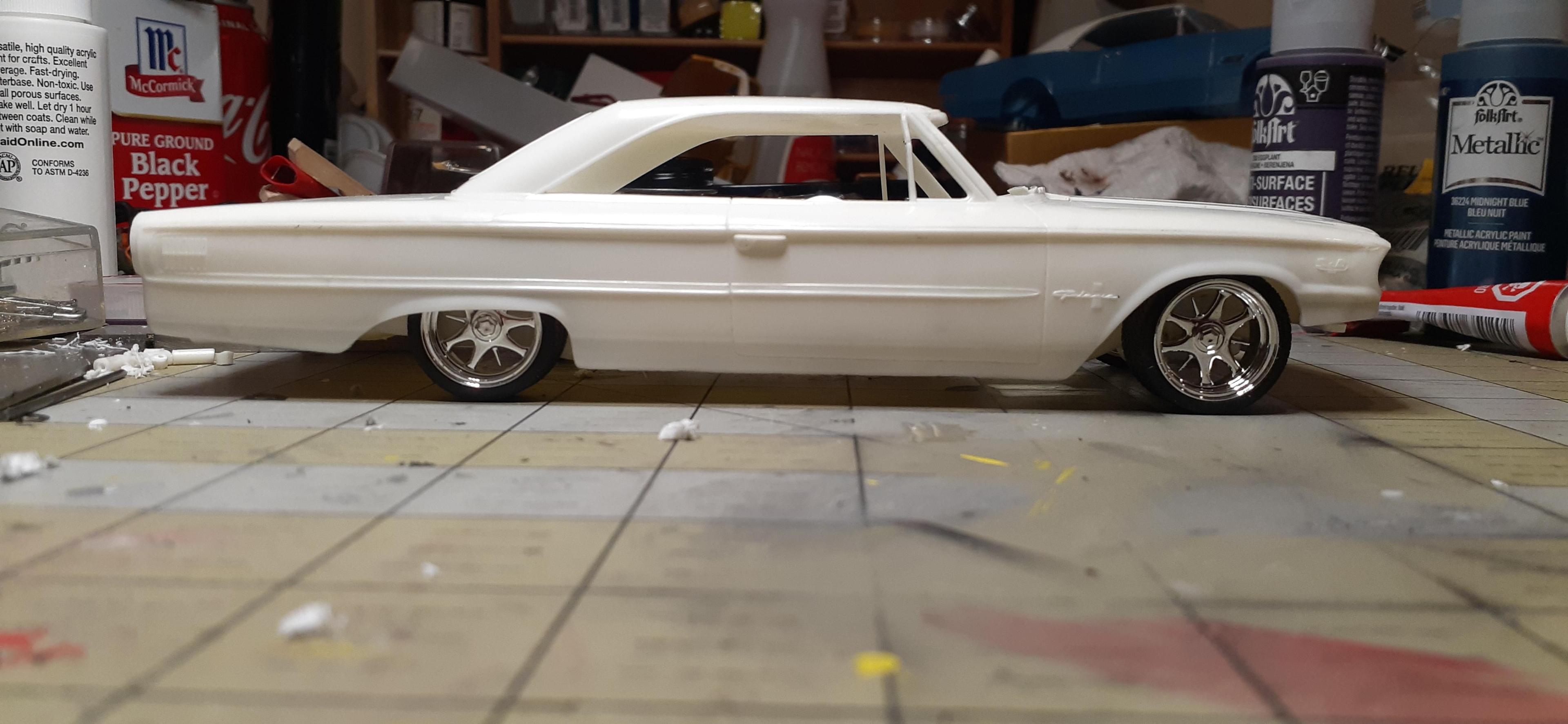

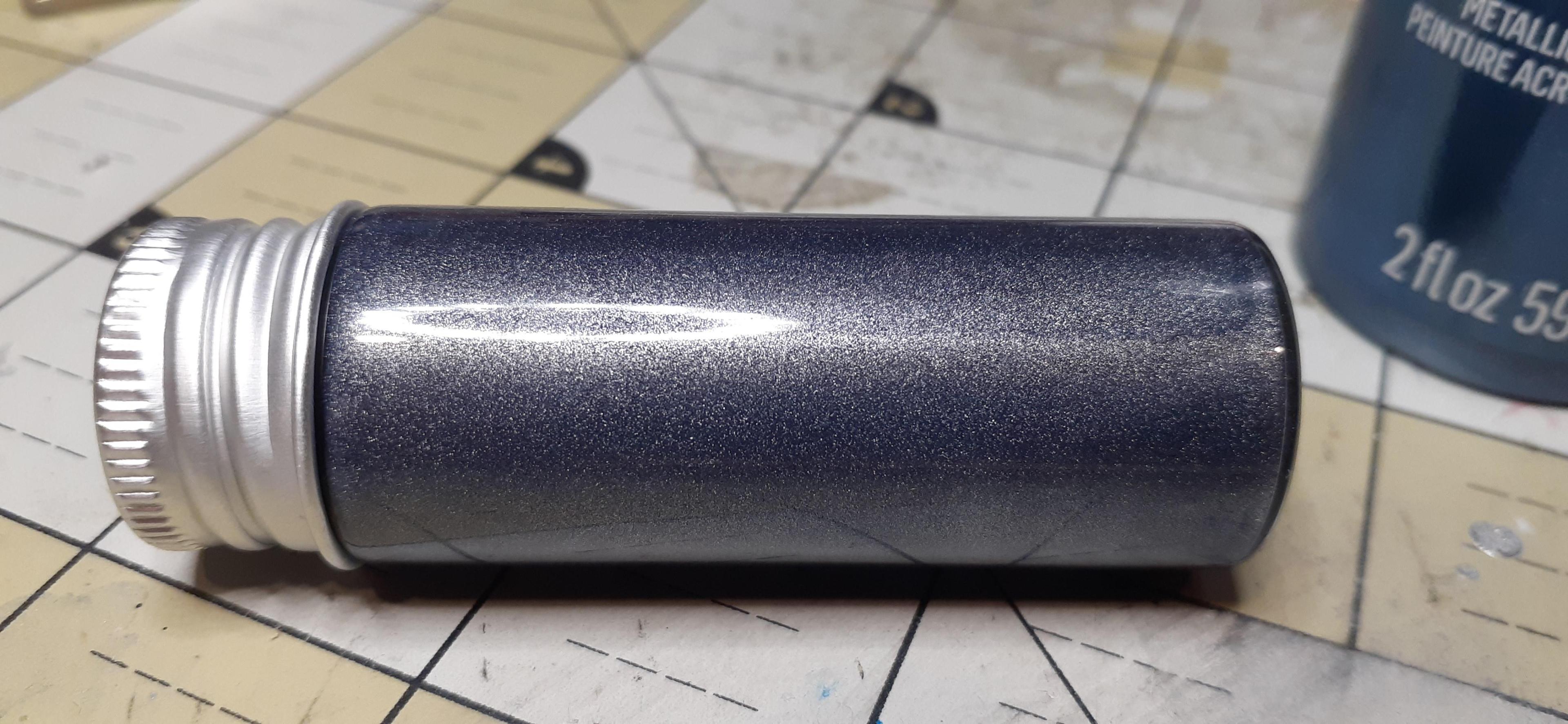

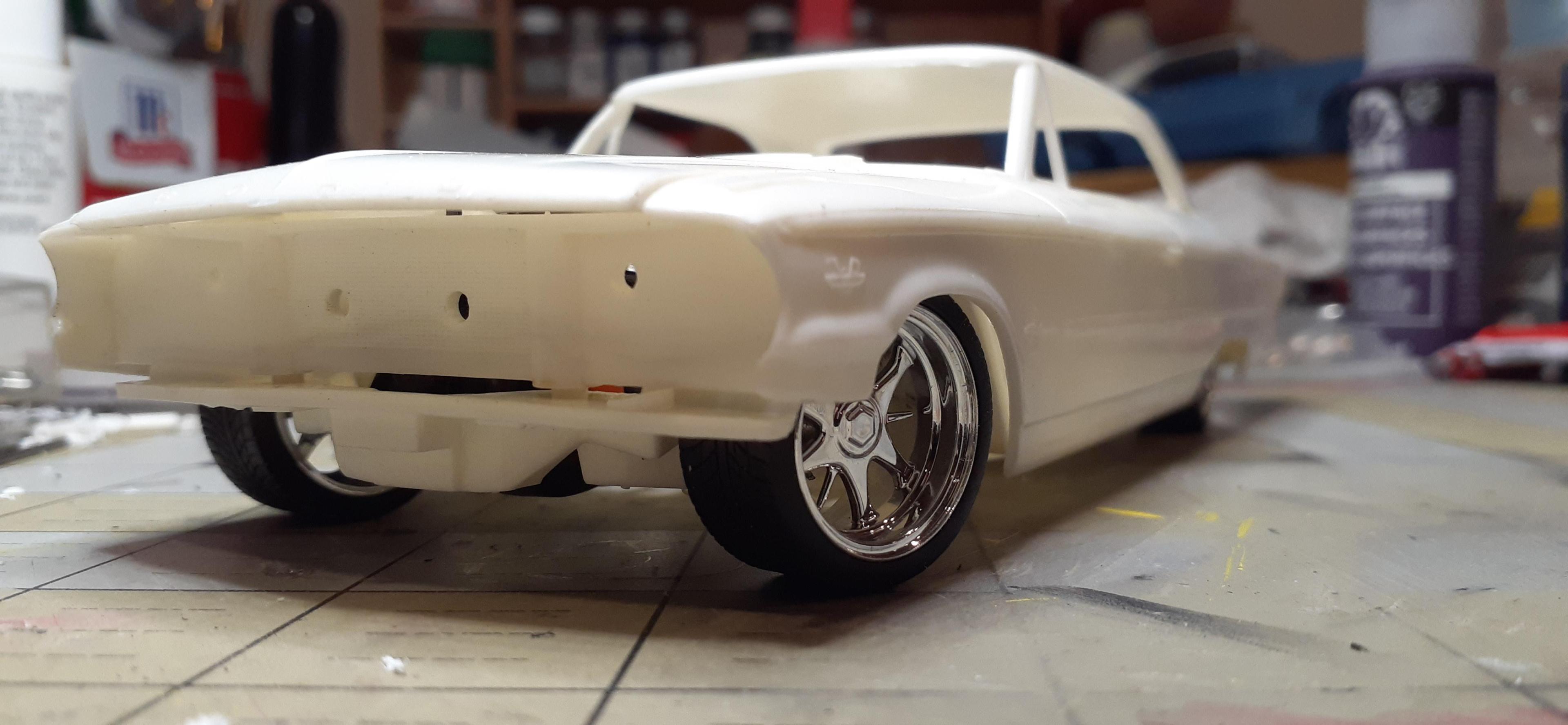

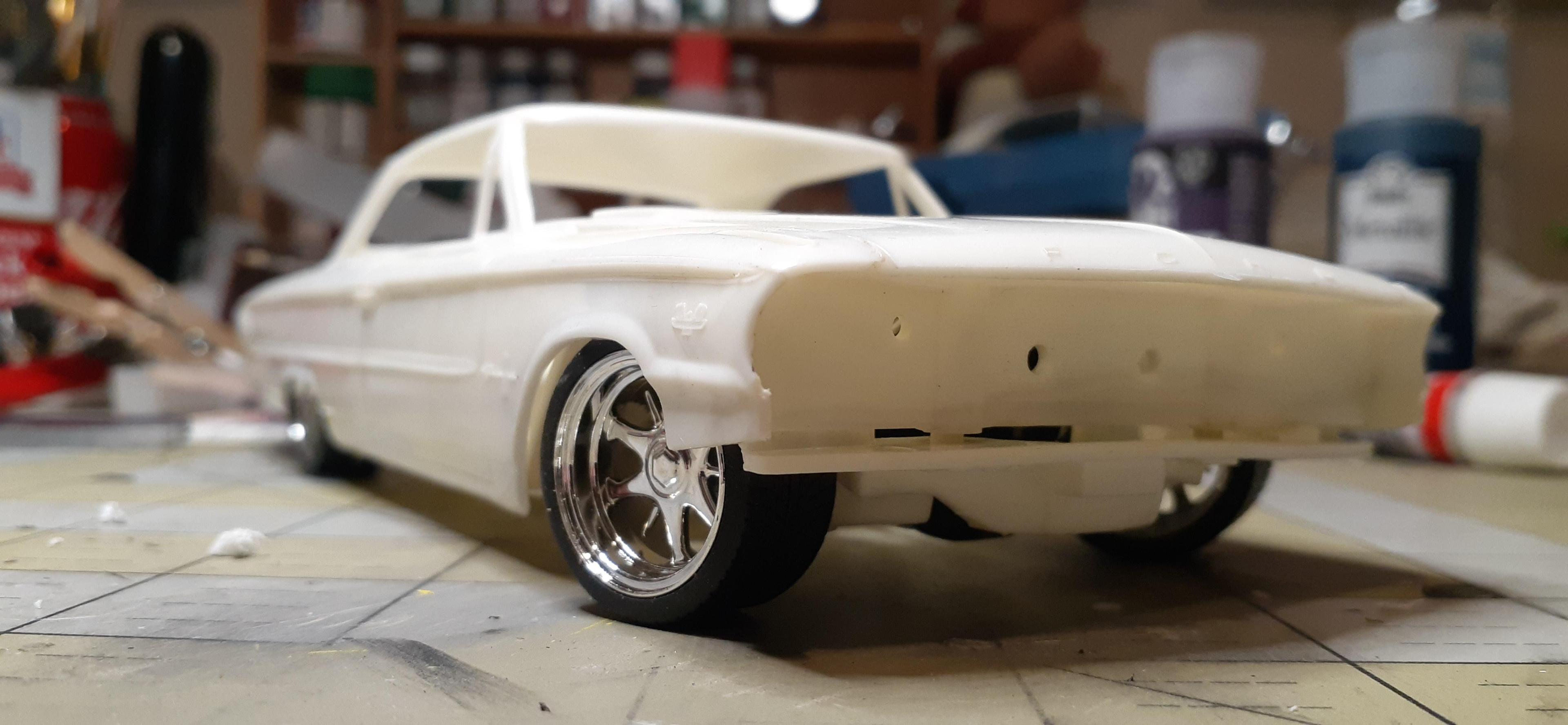

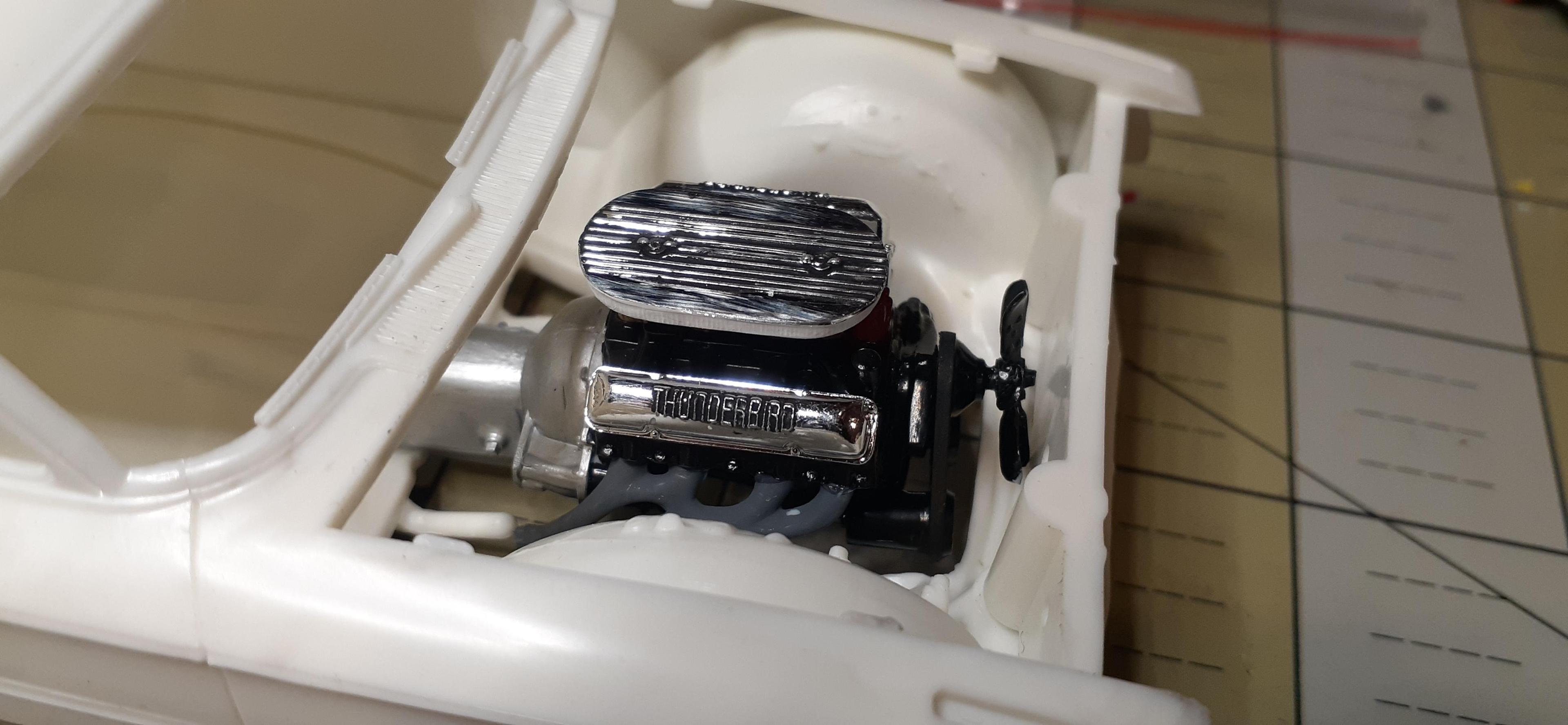

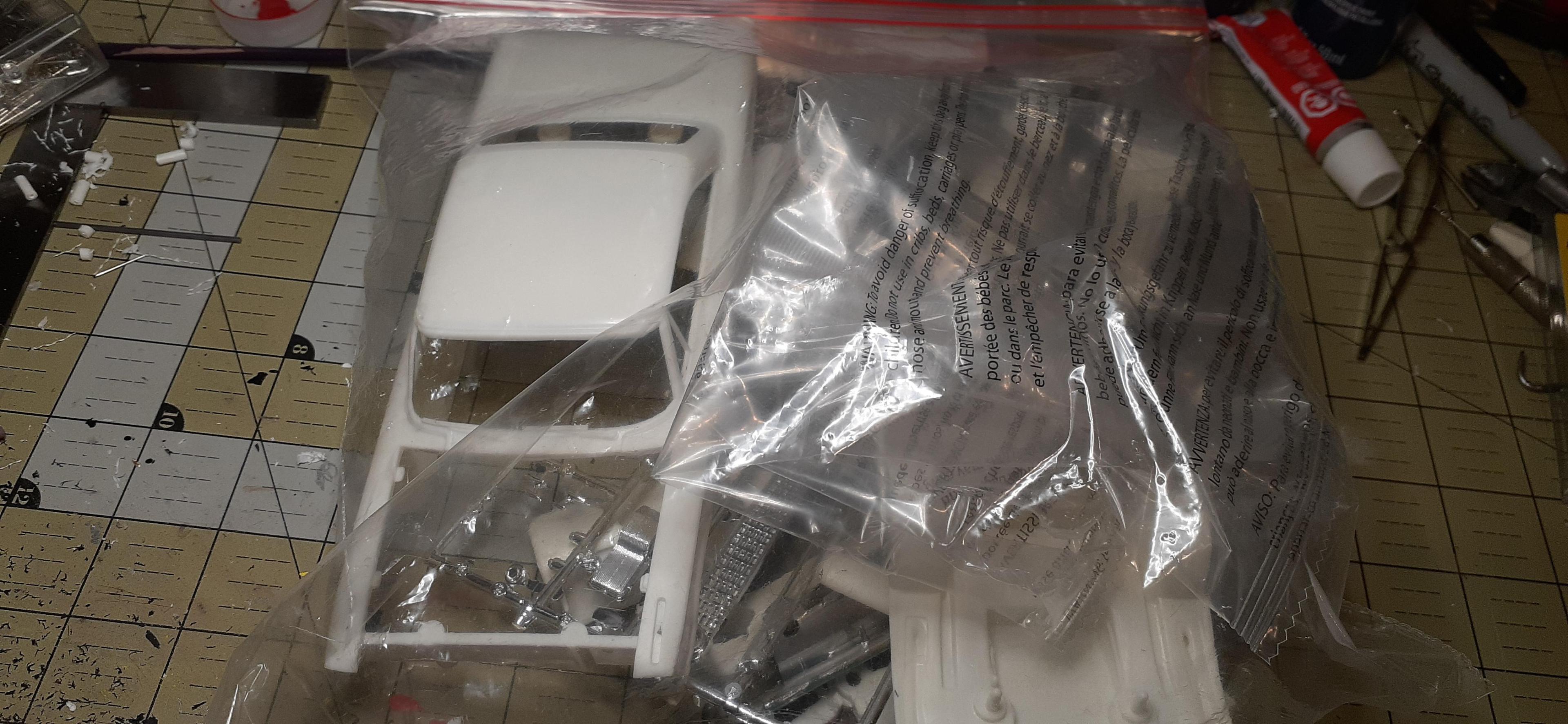

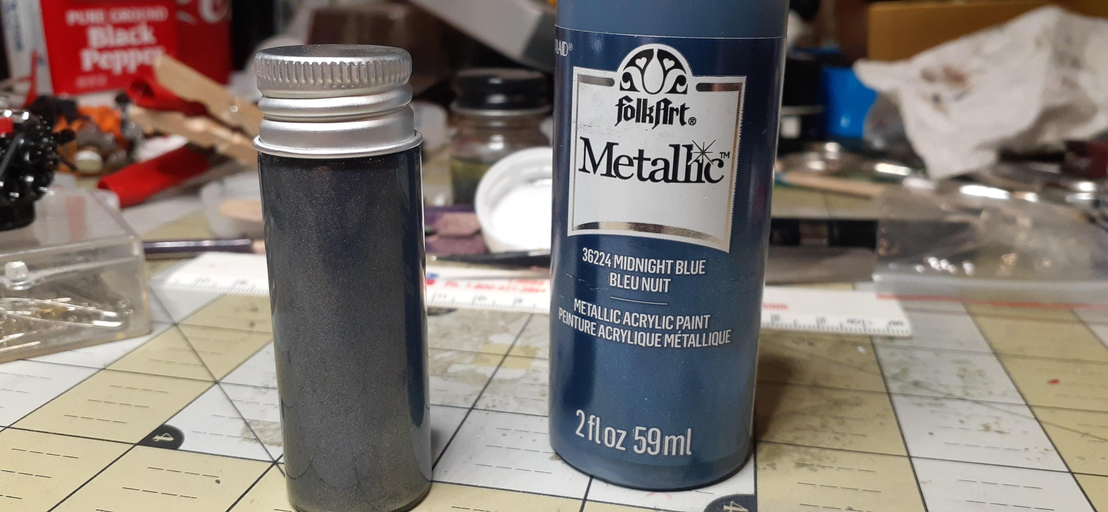

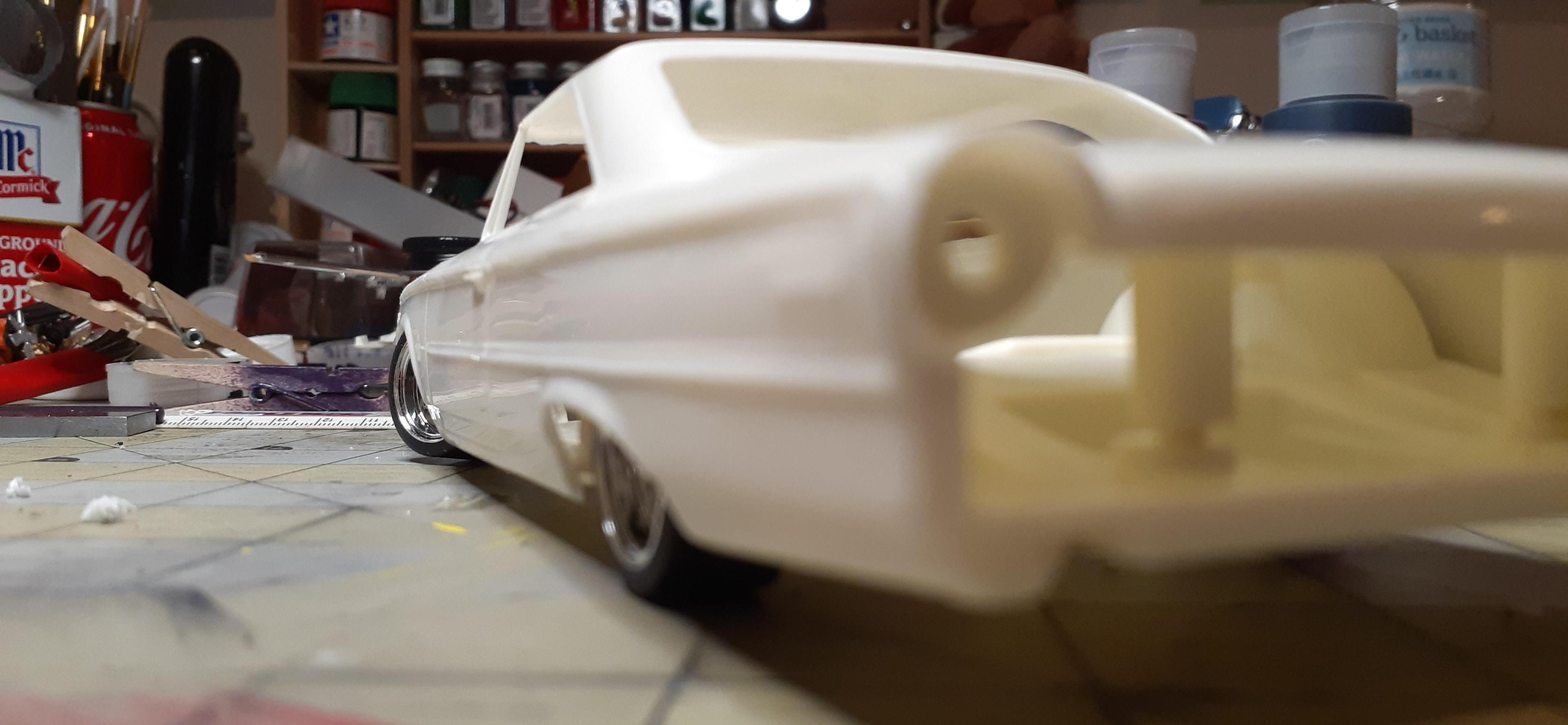

Slotto Posted September 4, 2022 Share Posted September 4, 2022 As seen in the Mock up thread I picked this up at last months club meeting for 10 bones. It was all there except for the instructions and the front glass. I also grabbed these too. The plan for the shell is this I found the paint and glass jar at Wally World. The jar contains the reduced material ready for the airbrush. so far I've got the engine figured out. Nothing special. and the foundation is just like I want it. Stay Tuned... 2 Quote Link to comment Share on other sites More sharing options...
Modlbldr Posted September 4, 2022 Share Posted September 4, 2022 Looks great so far. Perfect stance. Later- 1 Quote Link to comment Share on other sites More sharing options...
cobraman Posted September 4, 2022 Share Posted September 4, 2022 Long and low, the way to go. 1 Quote Link to comment Share on other sites More sharing options...
bisc63 Posted September 4, 2022 Share Posted September 4, 2022 Great looking body style, it will look nice in that blue. I did a '64 in a similar dark blue, and was very happy with how it looked. Good lines can wear just about any color well. 1 Quote Link to comment Share on other sites More sharing options...
TransAmMike Posted September 4, 2022 Share Posted September 4, 2022 Always liked the '63 and '64 bodies. I'll be watchin' 1 Quote Link to comment Share on other sites More sharing options...
Bronzekeg Posted September 5, 2022 Share Posted September 5, 2022 great stance. 1 Quote Link to comment Share on other sites More sharing options...
TarheelRick Posted September 5, 2022 Share Posted September 5, 2022 (edited) The prettiest late model Ford ever built, the '40 was the prettiest early model. Looking forward to you work on this one. Really interested in the small jar of glitter (?), are you going to mix that in with your paint. What is it called and where in the store is it found? Edited September 5, 2022 by TarheelRick Quote Link to comment Share on other sites More sharing options...
Slotto Posted September 5, 2022 Author Share Posted September 5, 2022 Thanks Ricky. The words under the pictures tell the story Quote Link to comment Share on other sites More sharing options...

slusher Posted September 6, 2022 Share Posted September 6, 2022 I am a fan of 60’s Fords! Your wheels and stance is sweet! 1 Quote Link to comment Share on other sites More sharing options...
David G. Posted September 6, 2022 Share Posted September 6, 2022 The engine looks great, nice stance, good color selection. It seems that you're off to a solid start. David G. 1 Quote Link to comment Share on other sites More sharing options...

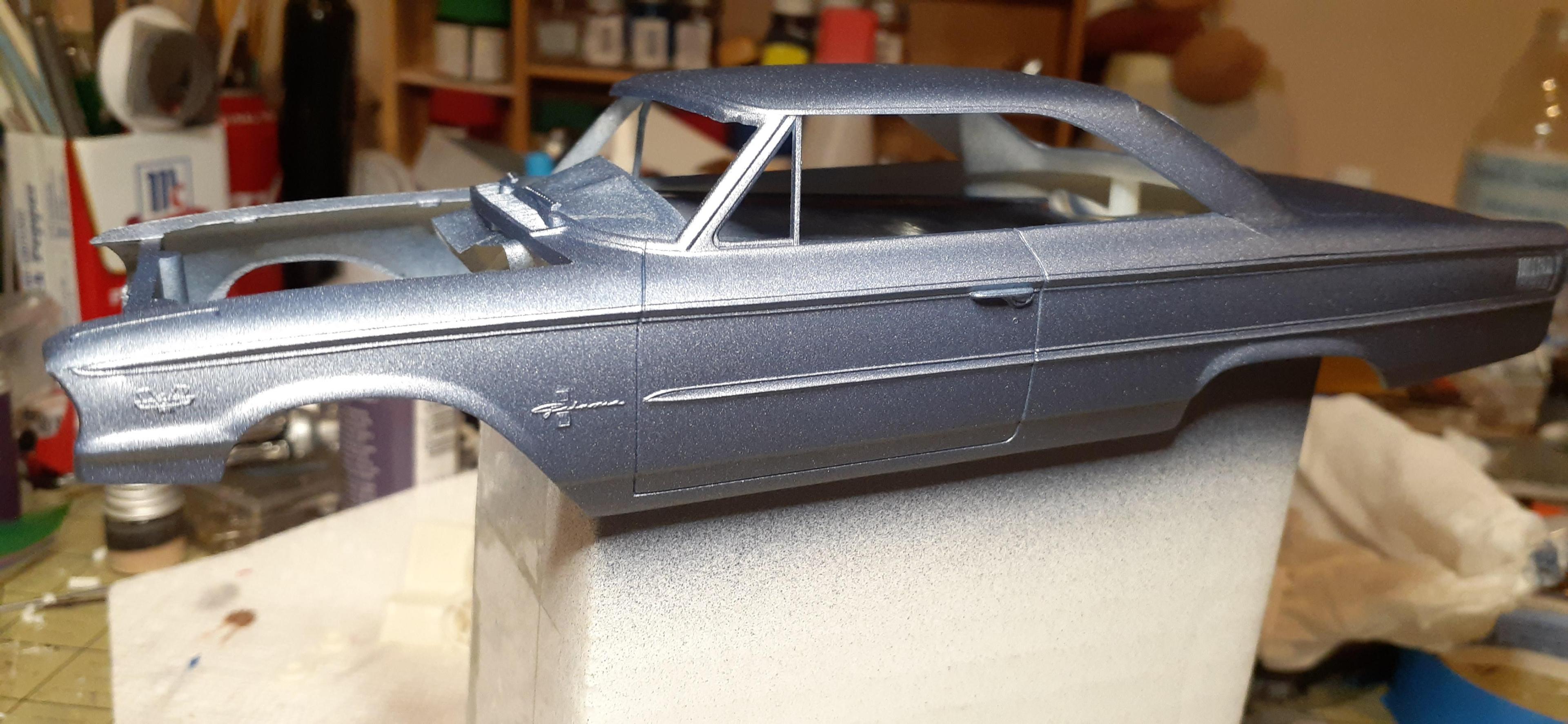

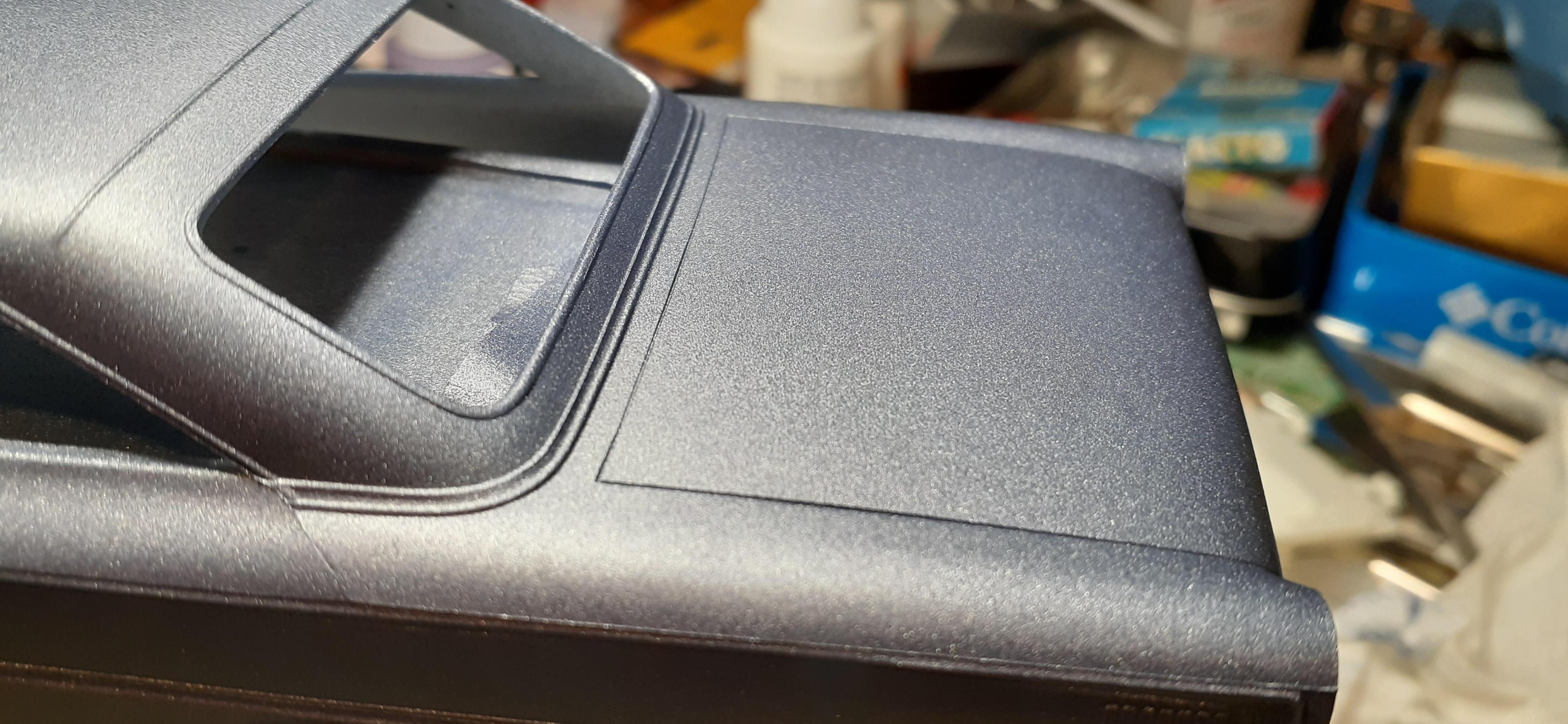

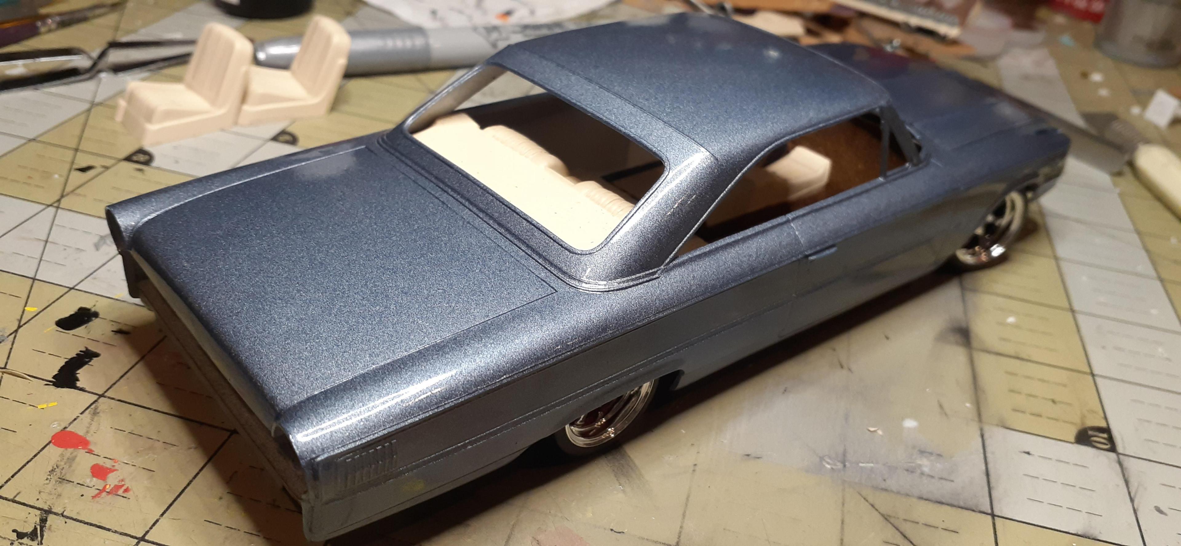

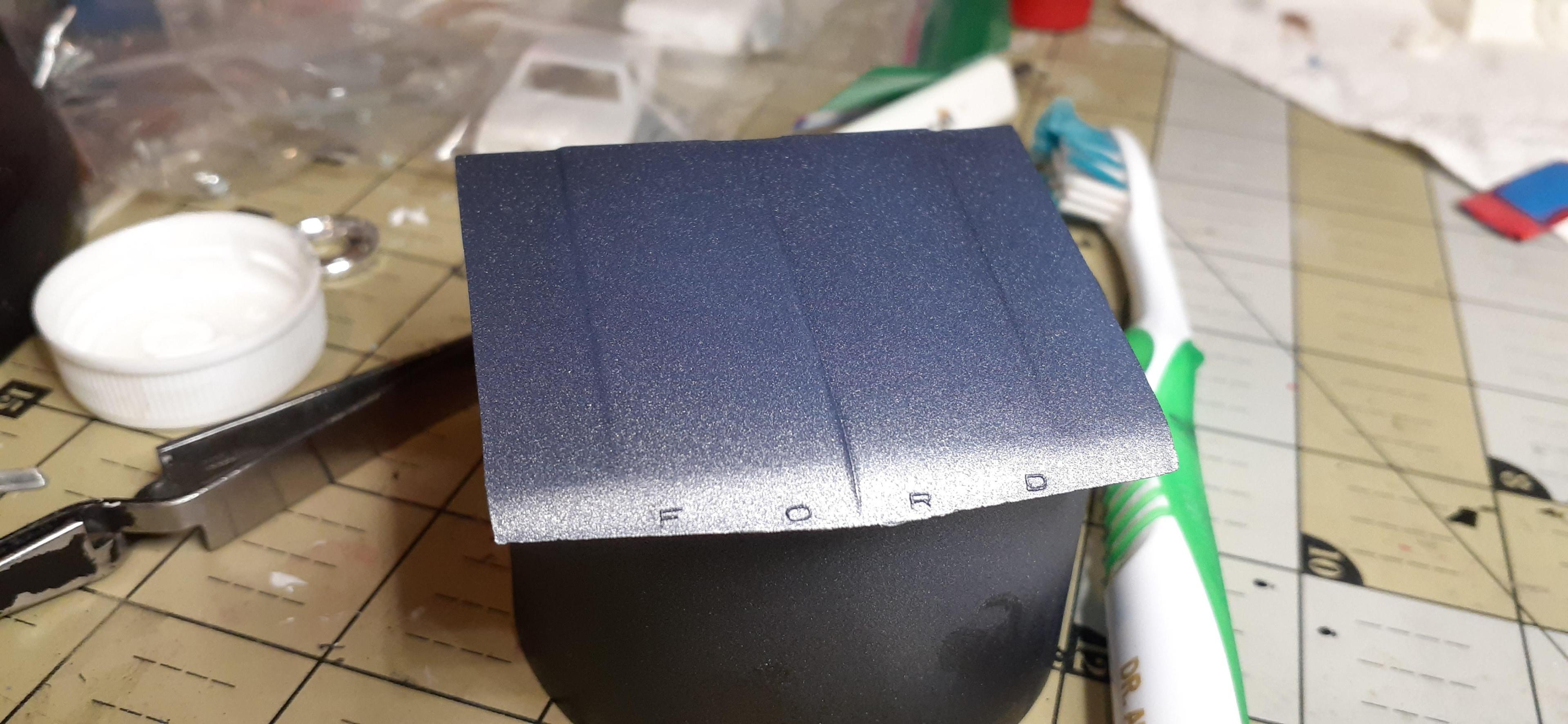

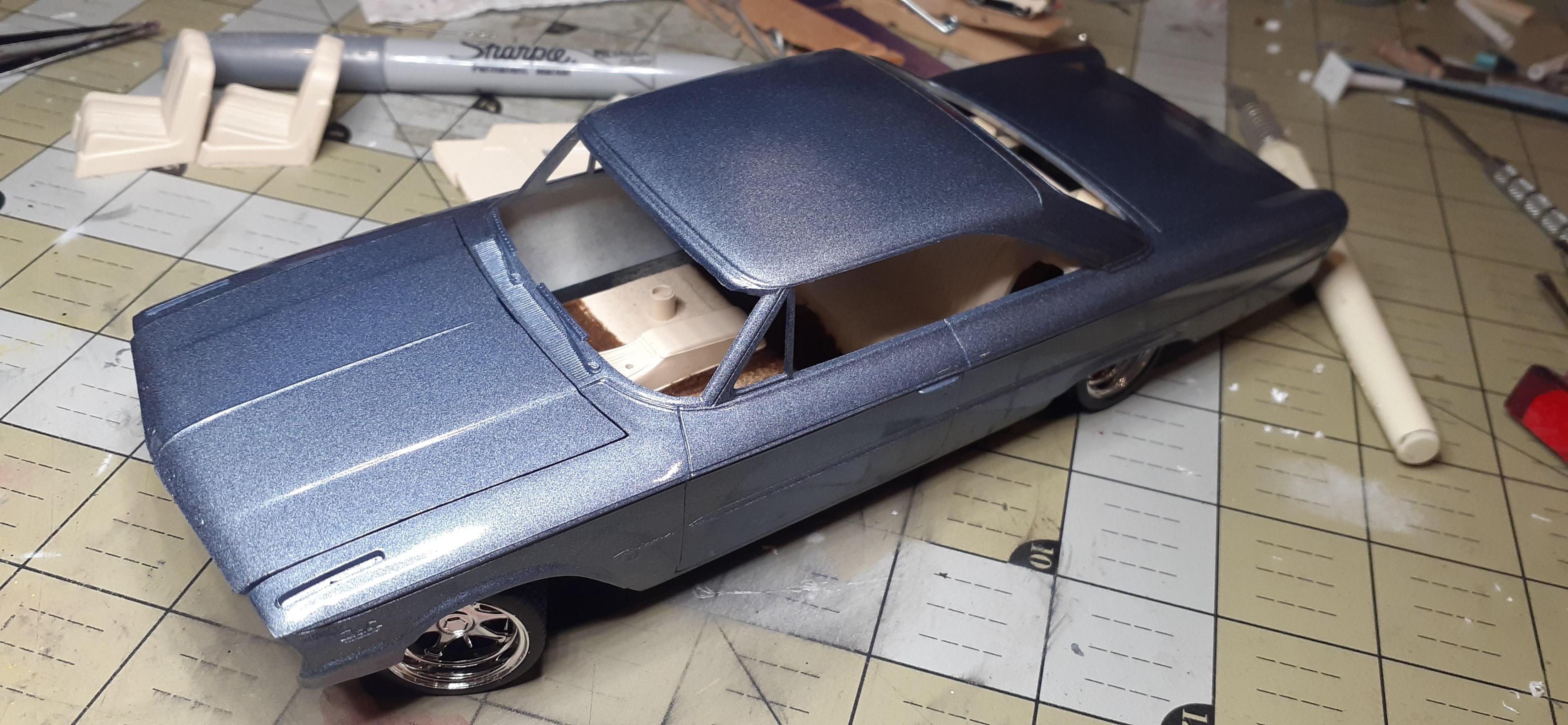

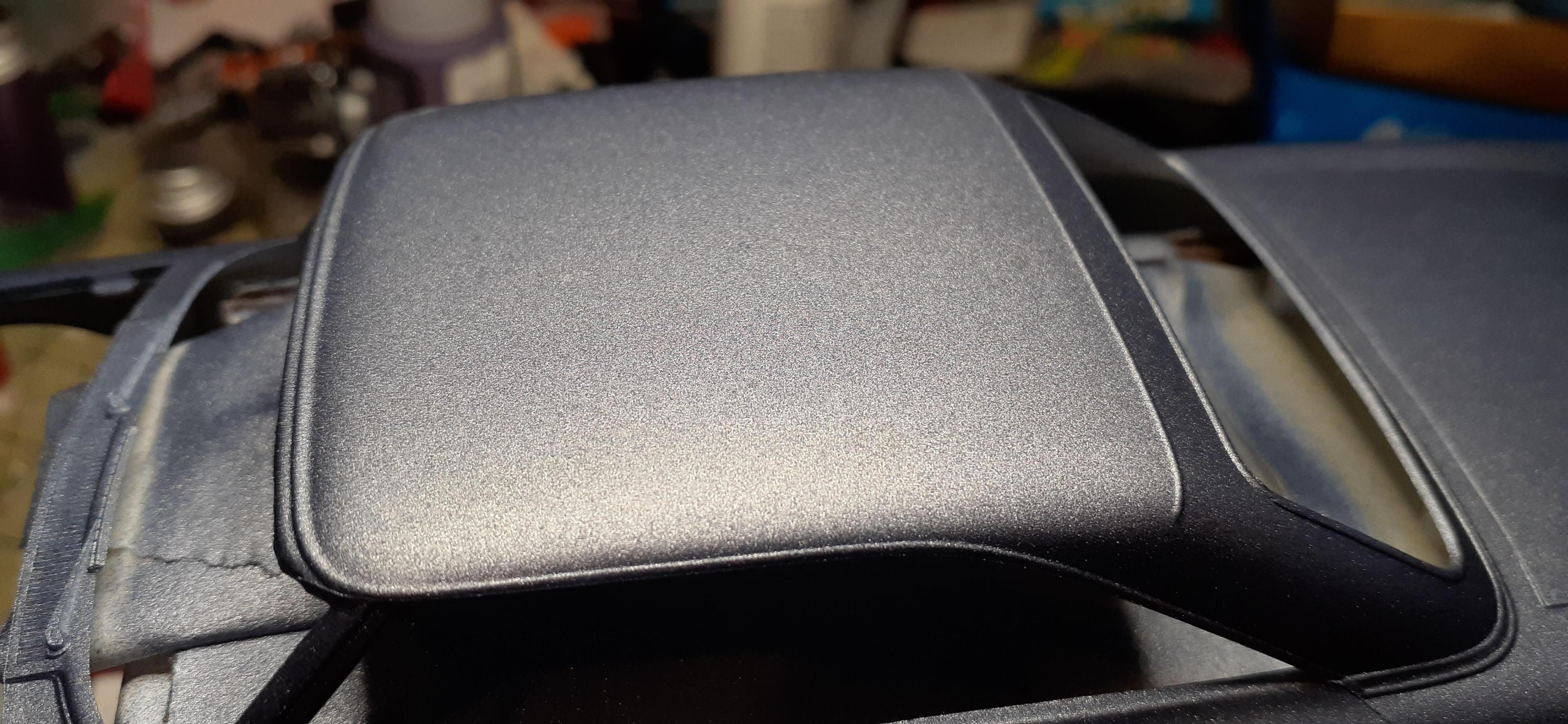

Slotto Posted September 6, 2022 Author Share Posted September 6, 2022 Shot some color today. This is my 1st ever airbrush attempt. No idea what I'm doing here. At one point it was spitting out but I think I got it covered. 10psi with the crank about half way open. I'm using a dual action gun. I shot the hood but a piece of dust landed on it. Soap and water rinse and I'll do it again. Any and all tips are welcome Stay Tuned... Quote Link to comment Share on other sites More sharing options...
TransAmMike Posted September 6, 2022 Share Posted September 6, 2022 You should get quite a few informed comments. You didn't say what the paint is. My first would be that 10 psi is darn low. Seems no primer. Also you need to work on removing mould lines like the one at the C-pillar. Take it away guys. 1 Quote Link to comment Share on other sites More sharing options...
slusher Posted September 7, 2022 Share Posted September 7, 2022 Great color! 1 Quote Link to comment Share on other sites More sharing options...
gman Posted September 7, 2022 Share Posted September 7, 2022 Not to critique unnecessarily, but mold seam removal (as mentioned) is an important step in body preparation to get the paint job looking as good as it possibly can. Most examples of this kit I've seen have sink marks or raised areas on the trunk- mold distortion from the posts underneath where the original release screwed down onto the chassis plate. This is pretty common for kits of this vintage (its original release). I have my 40 some-odd year old Prestige issue of this kit tucked away somewhere, and it had two deep sink marks in the trunk lid. I got as far as puttying those and feathering the bodywork, and got distracted by other projects. If they are there on your kit, they don't show as bad as they did on mine. A primer coat helps show areas that require fine-tuning before colour, and helps the top coats adhere better to the base plastic during handling and final assembly. While not every paint type really demands use of a primer, most do benefit from using it. Air brushing takes some experimentation to get the mixture thin enough to minimize texturel yet thick enough not to run. Seeing as how that paint job seems to have laid down pretty nicely for you, if you can get the hood re-spray matching the rest of the body, then it might be worth hitting everything with some clear coat and finishing the build as-is. I am intrigued as to how your colour choice (I like it) will look under clear coat. I'll be following along. 1 Quote Link to comment Share on other sites More sharing options...

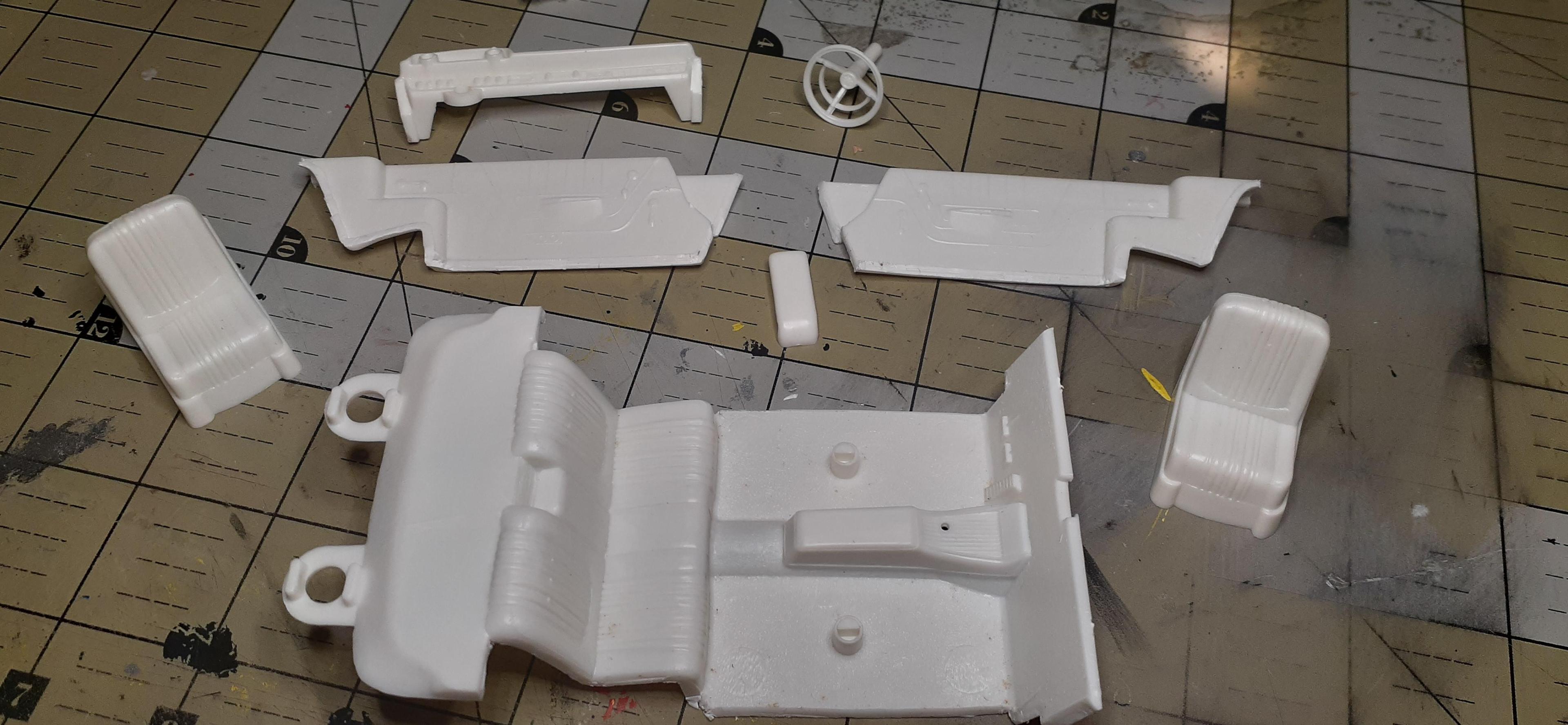

Slotto Posted September 7, 2022 Author Share Posted September 7, 2022 Thanks for the comments everyone. I looked before I sprayed and I did not see the mold lines until after I sprayed the color. Maybe i should have primed first. The trunk dimples are there but they are not that bad. I did reshoot the hood at 15psi and it turned out nice. I'm anxious for the clear coat. I also broke up the interior so I can detail up the door cards. stay tuned... 1 Quote Link to comment Share on other sites More sharing options...
David G. Posted September 7, 2022 Share Posted September 7, 2022 (edited) From what I see on the hood, it looks like your airbrush skills are already improving. David G. Edited September 7, 2022 by David G. typo 1 Quote Link to comment Share on other sites More sharing options...
Modlbldr Posted September 7, 2022 Share Posted September 7, 2022 The paintwork looks very nice to me, other than the aforementioned mold lines. I really like the color and I'm guessing that you used craft paint, due to the water and soap wash-up comment. I like using craft paint. They have a wide variety of colors and it is simple for clean-up. Later- 1 Quote Link to comment Share on other sites More sharing options...
TransAmMike Posted September 7, 2022 Share Posted September 7, 2022 6 hours ago, Modlbldr said: The paintwork looks very nice to me, other than the aforementioned mold lines. I really like the color and I'm guessing that you used craft paint, due to the water and soap wash-up comment. I like using craft paint. They have a wide variety of colors and it is simple for clean-up. Later- I second the comment Tom about craft paint. We use more expensive model paints and honestly, I get just as good results with craft paint when thinned properly. 2 Quote Link to comment Share on other sites More sharing options...

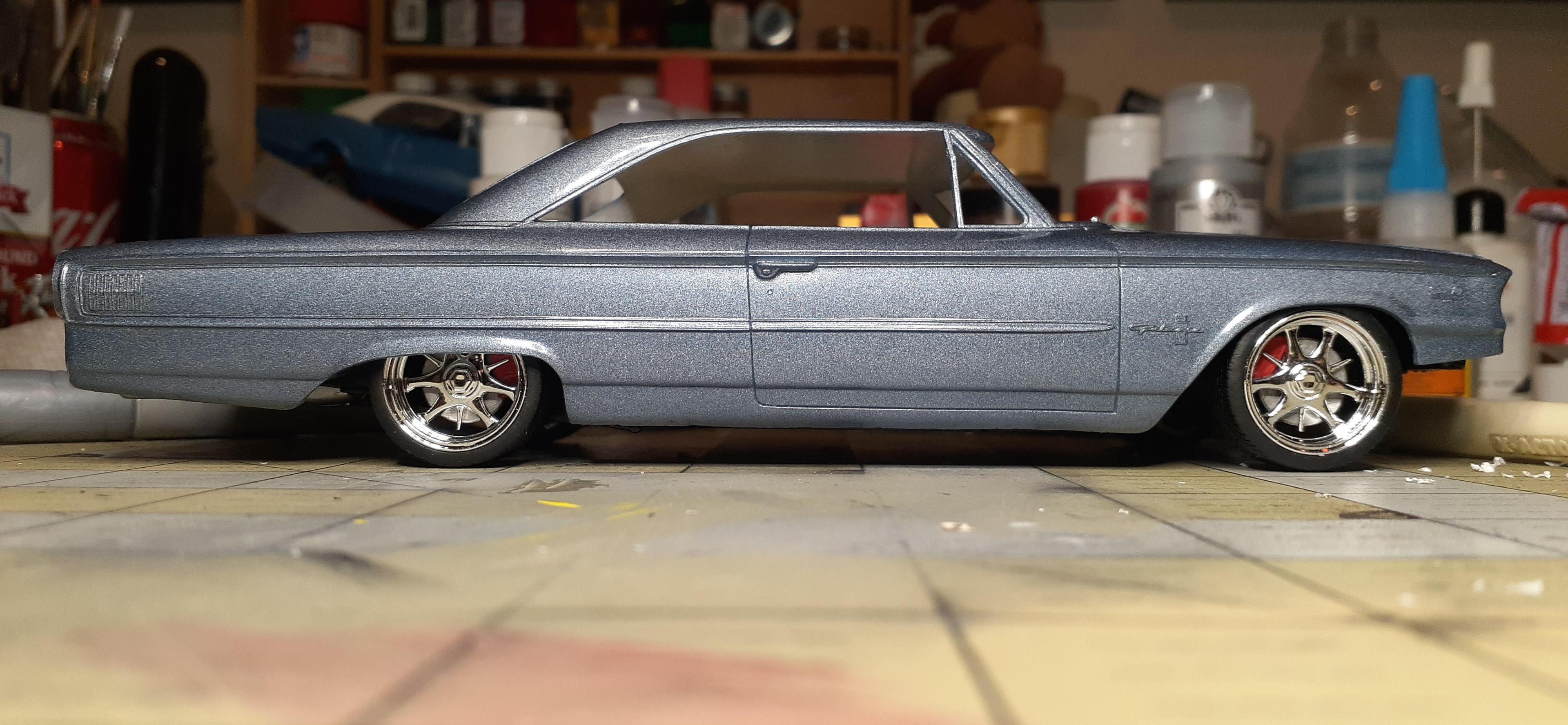

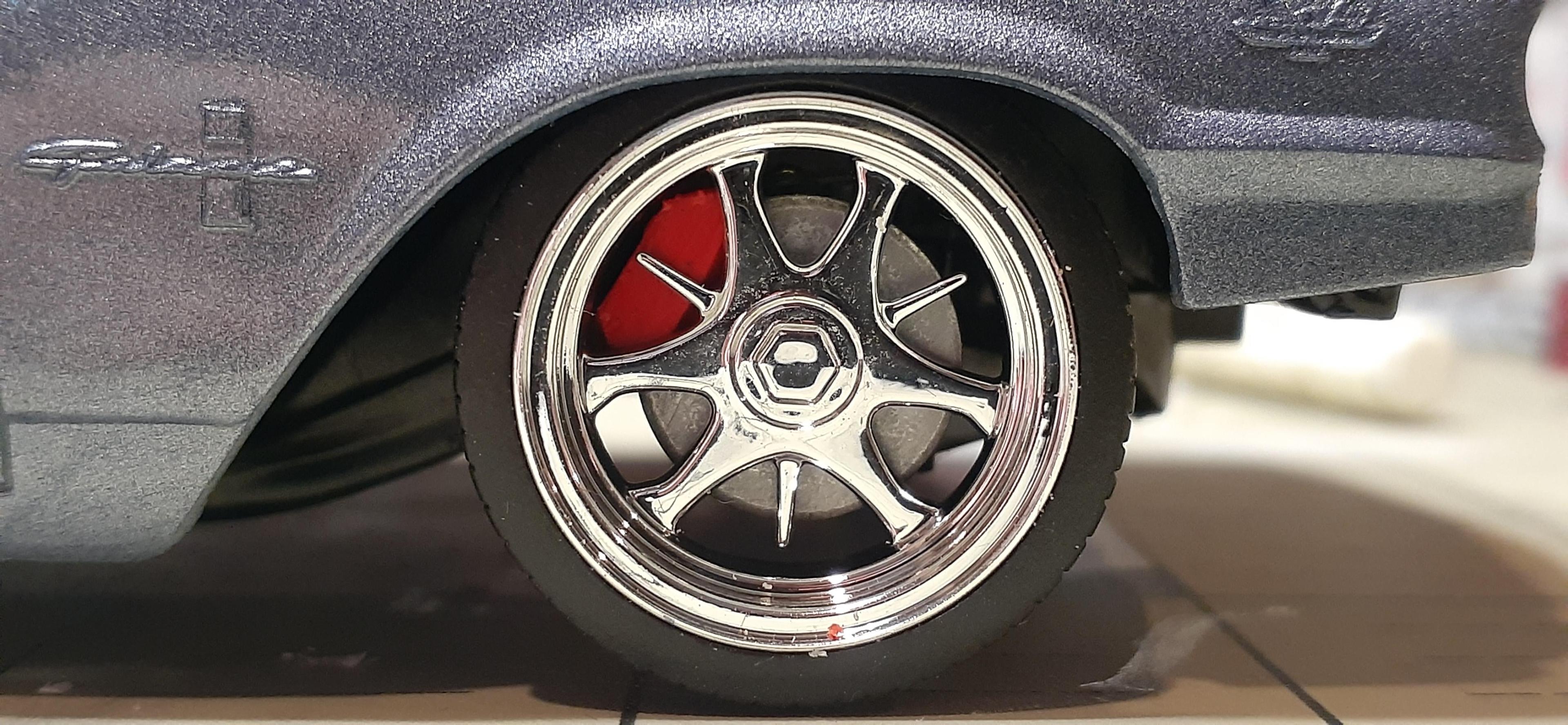

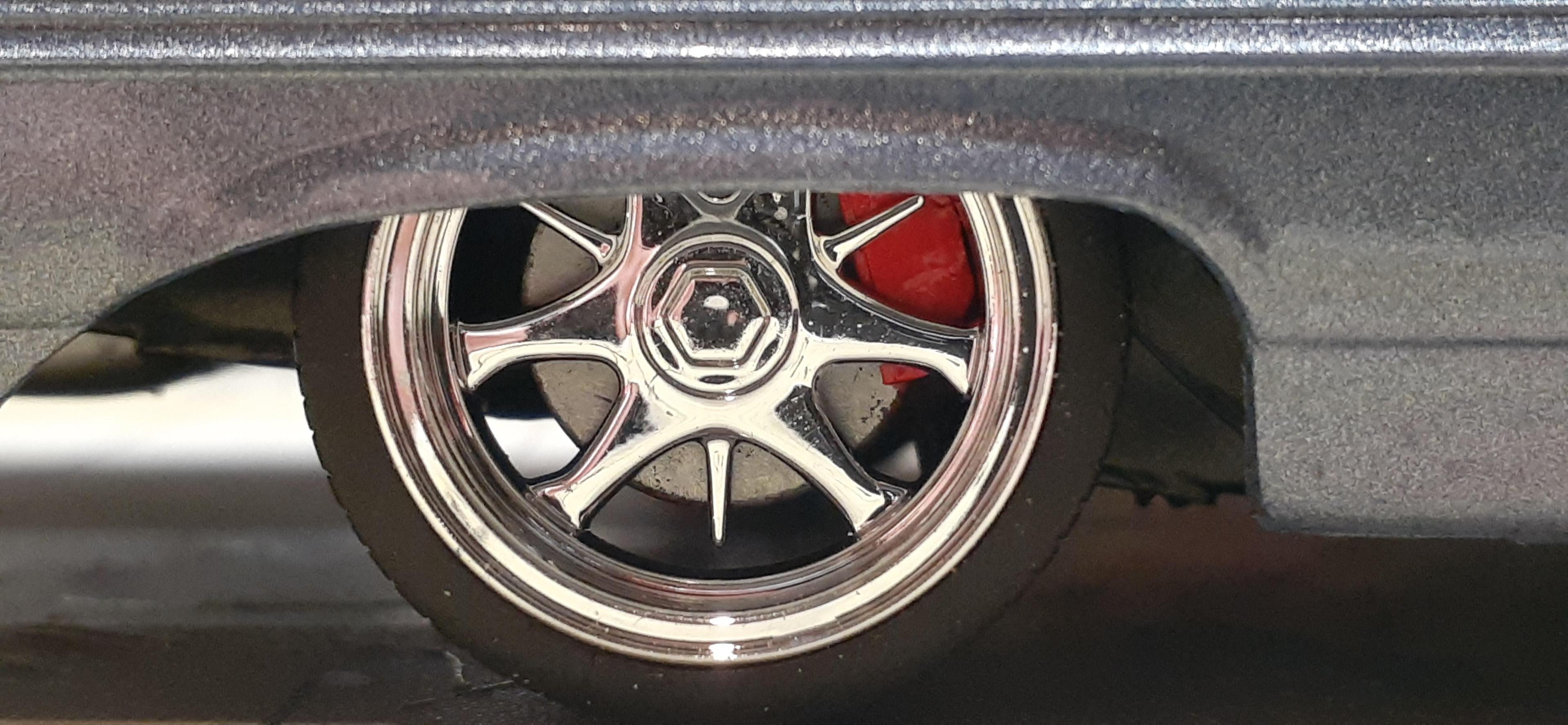

Slotto Posted September 10, 2022 Author Share Posted September 10, 2022 2 coats of clear. No buffing yet. Rotors are made from washers and the calipers are cut scrap plastic. went with indoor outdoor spray paint for the seats, package tray and door cards. Coffee bean craft paint as a base for the floor covered with dark brown flocking. Waiting on supplies to finish up the interior. Stay Tuned... 3 Quote Link to comment Share on other sites More sharing options...
slusher Posted September 10, 2022 Share Posted September 10, 2022 On 9/7/2022 at 5:06 AM, Slotto said: Thanks for the comments everyone. I looked before I sprayed and I did not see the mold lines until after I sprayed the color. Maybe i should have primed first. The trunk dimples are there but they are not that bad. I did reshoot the hood at 15psi and it turned out nice. I'm anxious for the clear coat. I also broke up the interior so I can detail up the door cards. stay tuned... Steve, what did you use to open up the interior tub with? Really great work so far Steve! 1 Quote Link to comment Share on other sites More sharing options...
Slotto Posted September 10, 2022 Author Share Posted September 10, 2022 11 minutes ago, slusher said: Steve, what did you use to open up the interior tub with? Really great work so far Steve! Thanks! The past 3 builds I had to do this too. It's kind of a pain but if you want to do up the door cards, it must be done -at least I need to do it. Basically I just score the corners until they snap off. Then I go back and flatten down the ridges caused by the knife so it goes back together. 1 Quote Link to comment Share on other sites More sharing options...
David G. Posted September 11, 2022 Share Posted September 11, 2022 I like the way you handles the disc brakes, I'll have to remember that technique for the future. David G. 1 Quote Link to comment Share on other sites More sharing options...

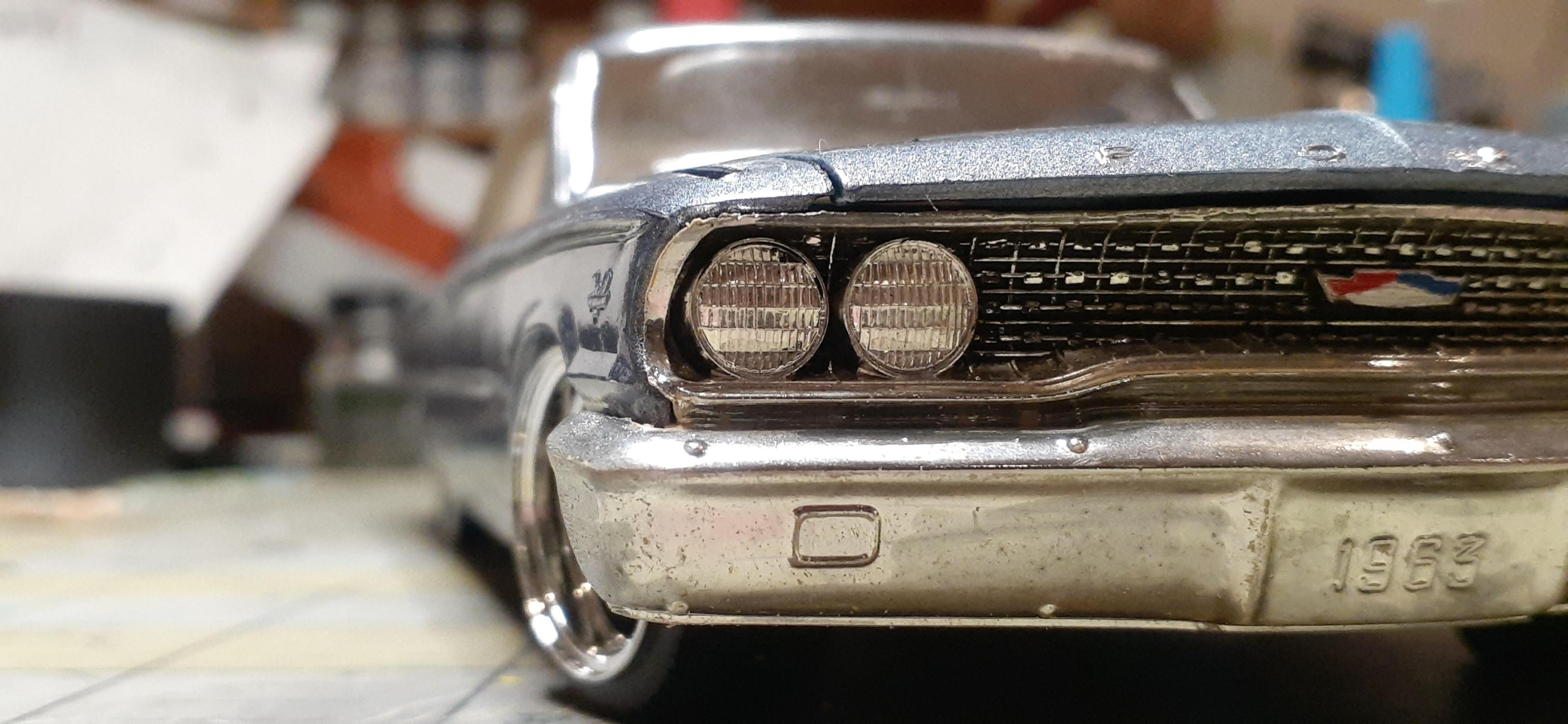

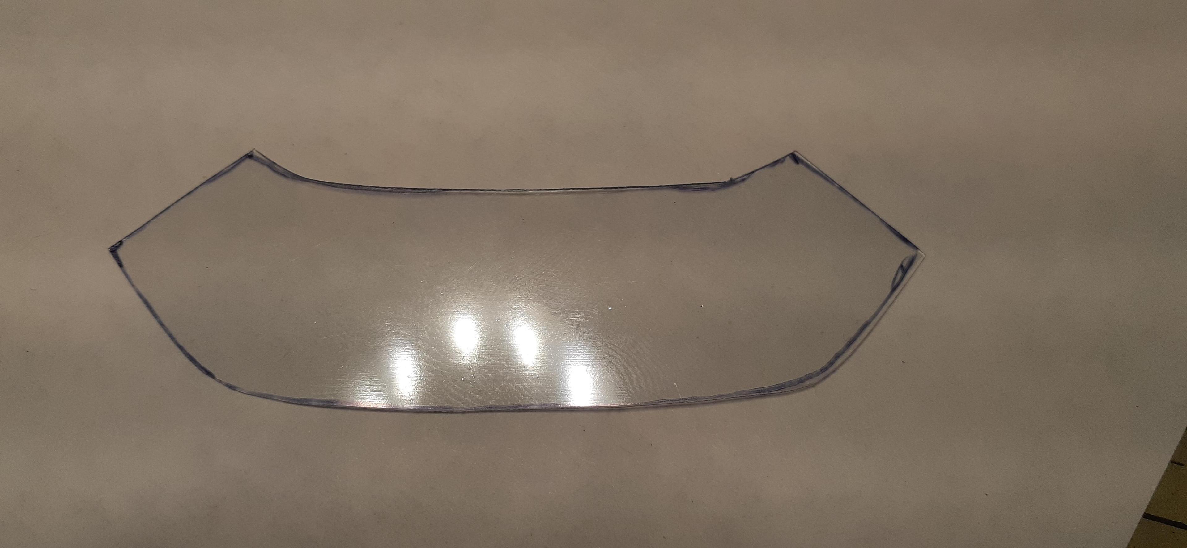

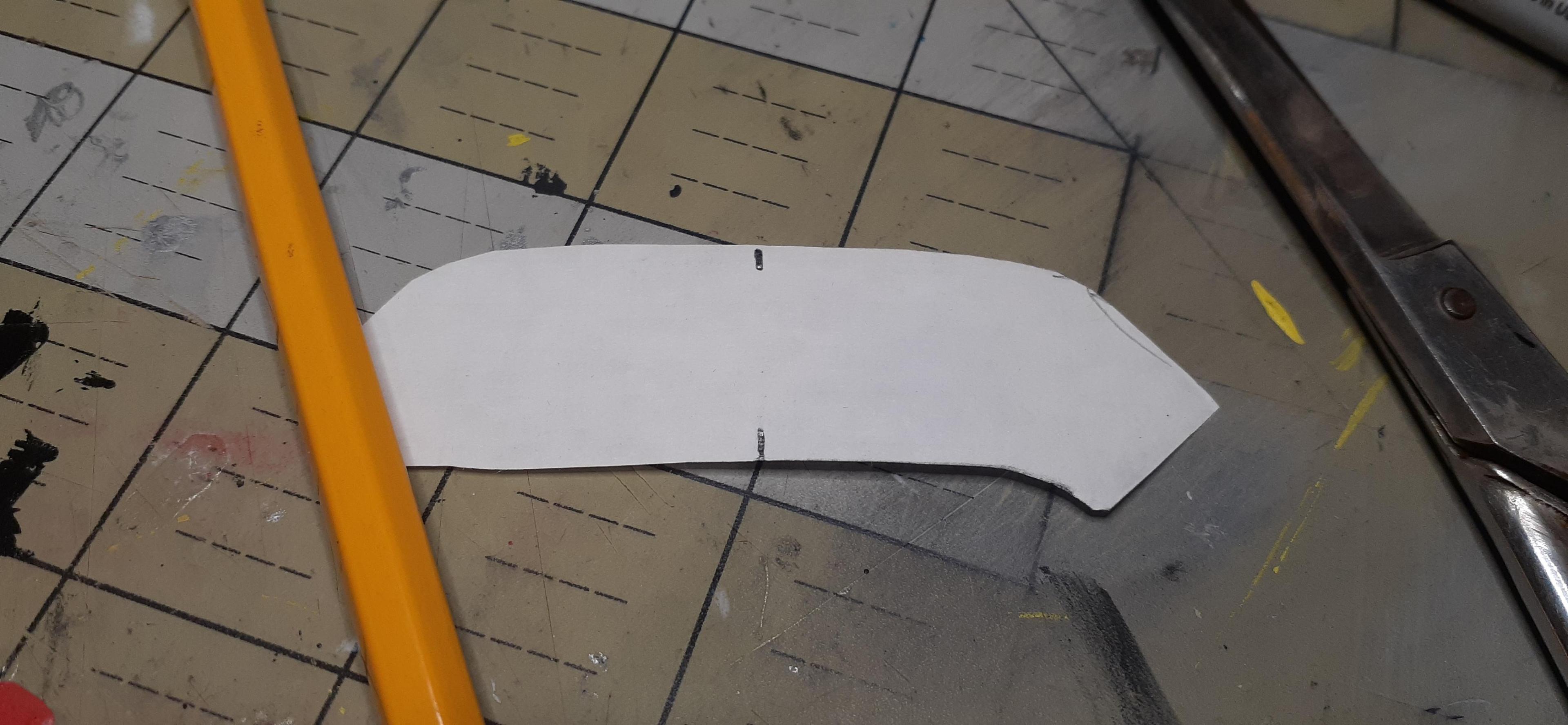

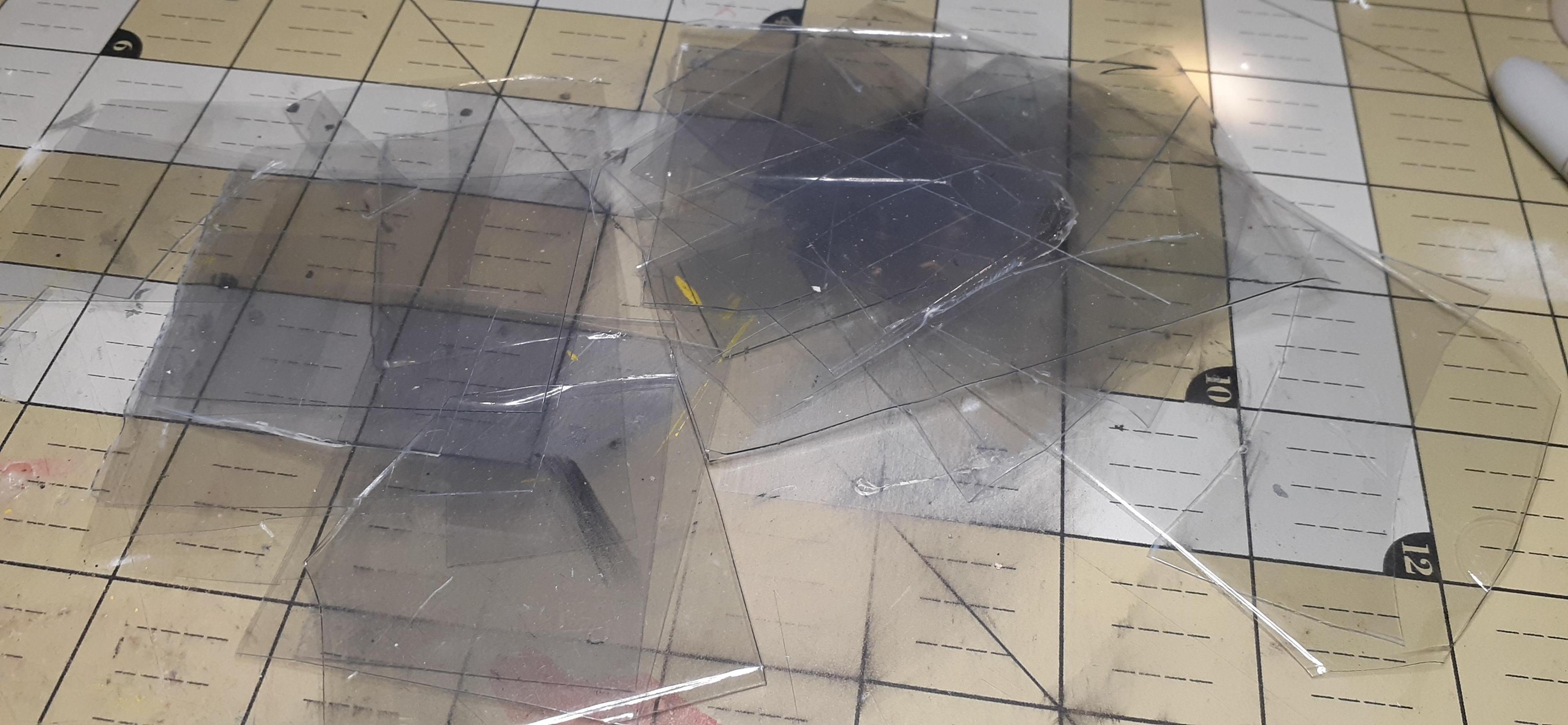

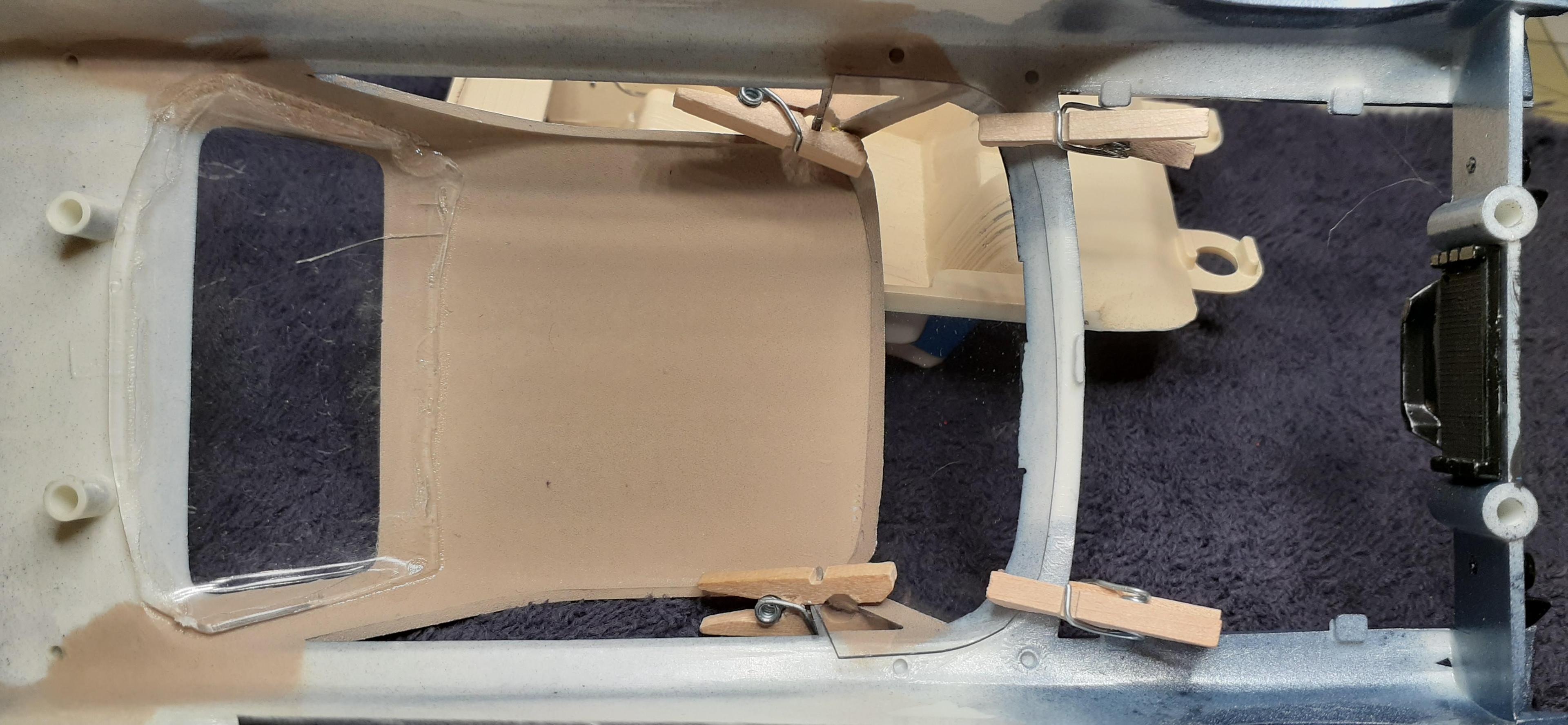

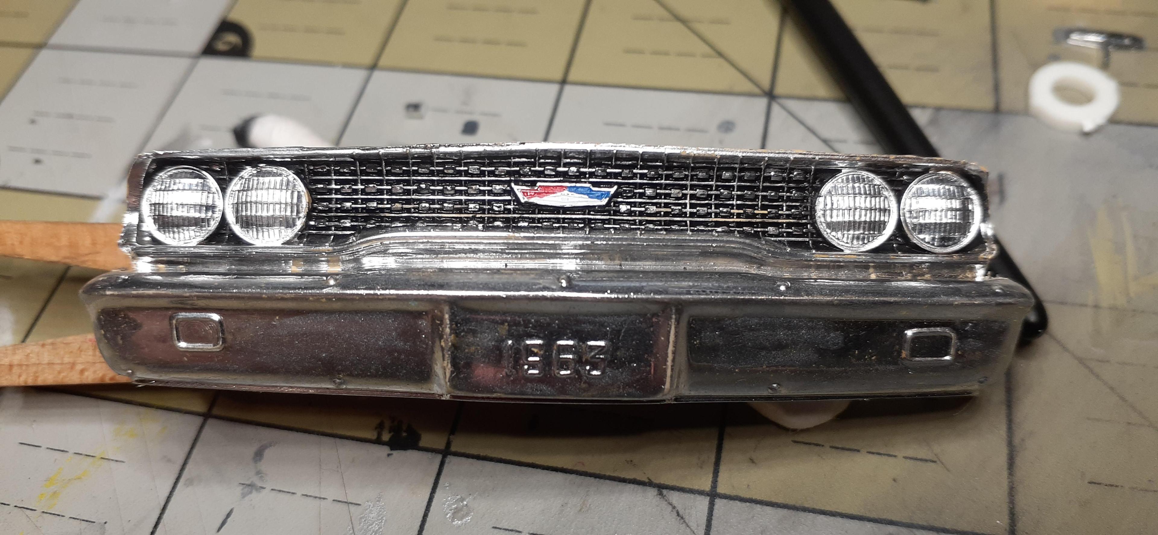

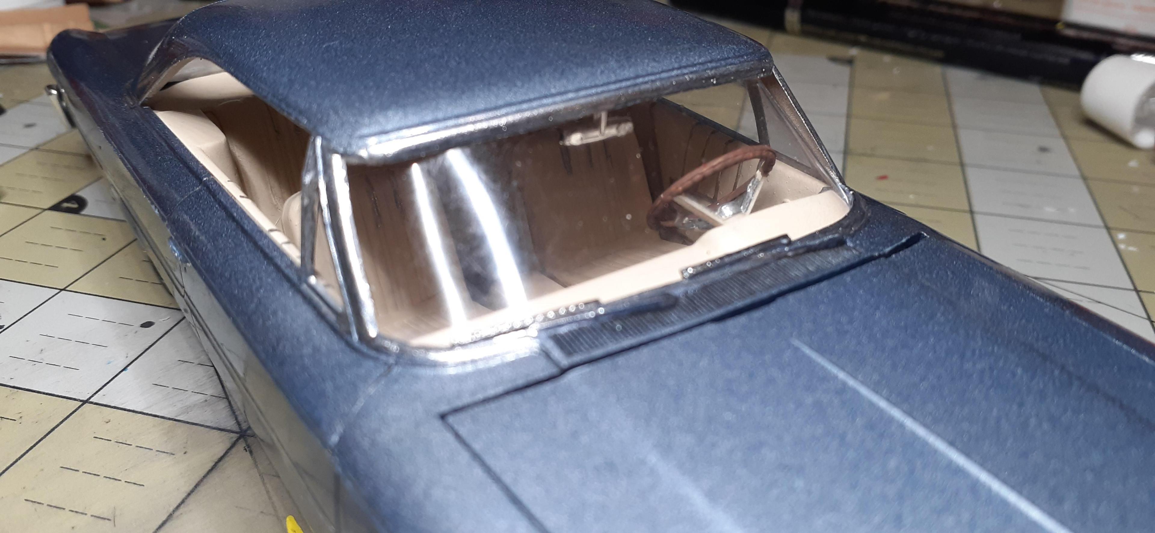

Slotto Posted September 13, 2022 Author Share Posted September 13, 2022 Chugging along. I mentioned earlier that this kit was missing the front glass. Well, I made one. I used the clear plastic from blister packs. anytime I get something that comes packaged this way, I cut apart the package and store it away for just an occasion. first I made a paper template then... transferred it to a piece that was big enough. then I bent it to fit the curve and held it in place with mini clothespins and glued it in place. 30 minutes later I was good also got the grille all detailed up. And the interior is done. I'm almost there. Only thing left is the firewall and overflow tank. I couldn't help myself, I had to test fit it together. Here's a preview Stay Tuned... Quote Link to comment Share on other sites More sharing options...
slusher Posted September 13, 2022 Share Posted September 13, 2022 Nice work an the window and grill detail.. 1 Quote Link to comment Share on other sites More sharing options...
