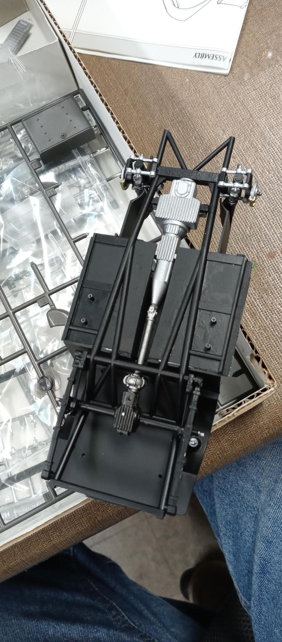

Justin Porter Posted October 7, 2022 Posted October 7, 2022 I've been wanting to start on this kit for a while as it's one of those "once in a lifetime" builds. It's the Gunze Sangyo "High Tech" series Ferrari 250GT SWB and it's a really amazing kit with most of its components in white metal as well as a huge photoetch fret including the wire wheels. I plan to build it box-stock except for replacing the admittedly awful tires with nicer ones from a Fujimi 250GTO. Last night I started the process by building up the chassis and getting it into Mr Surfacer Black primer. 2

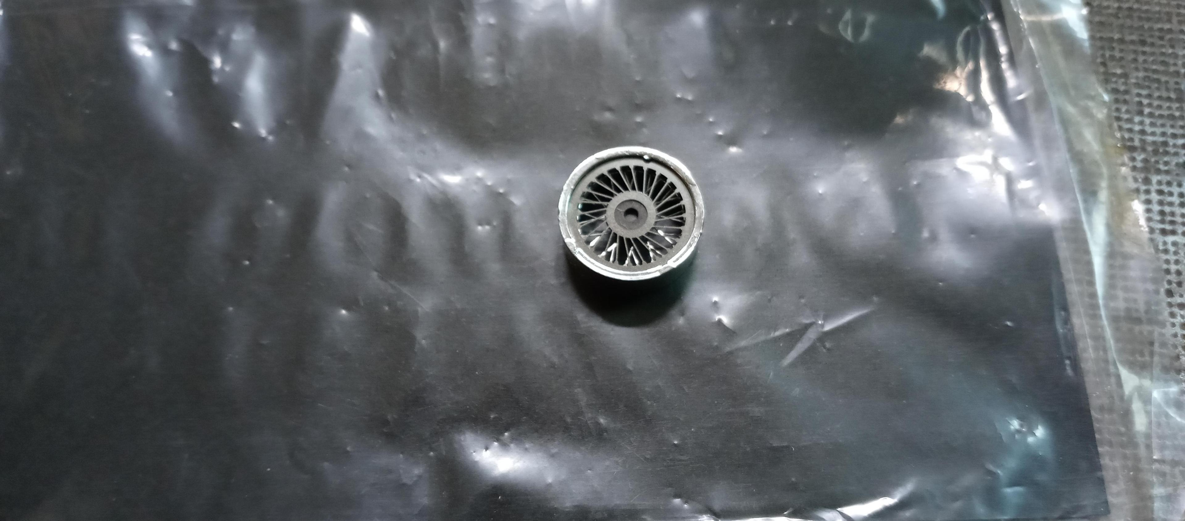

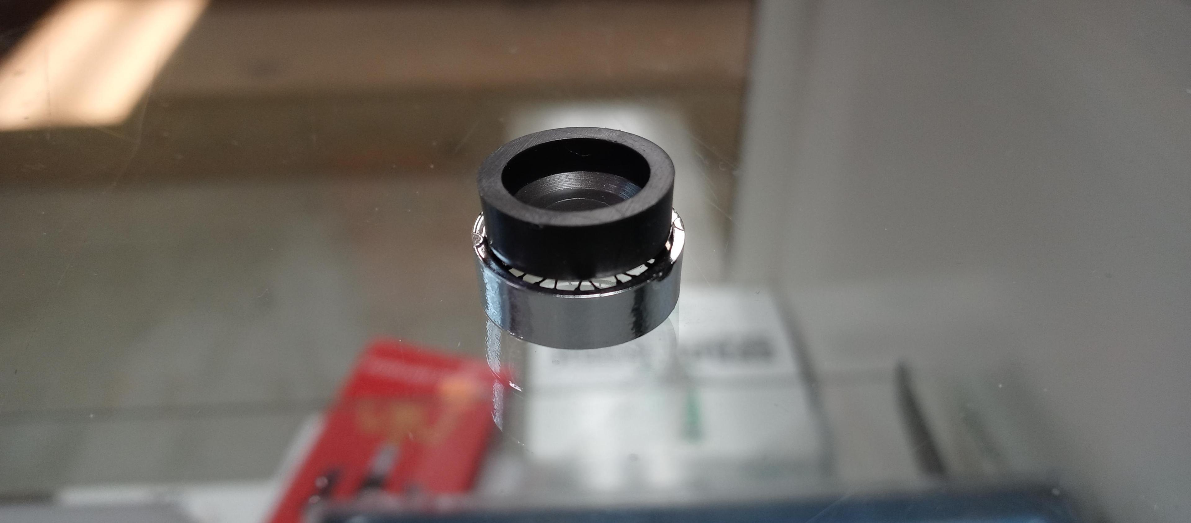

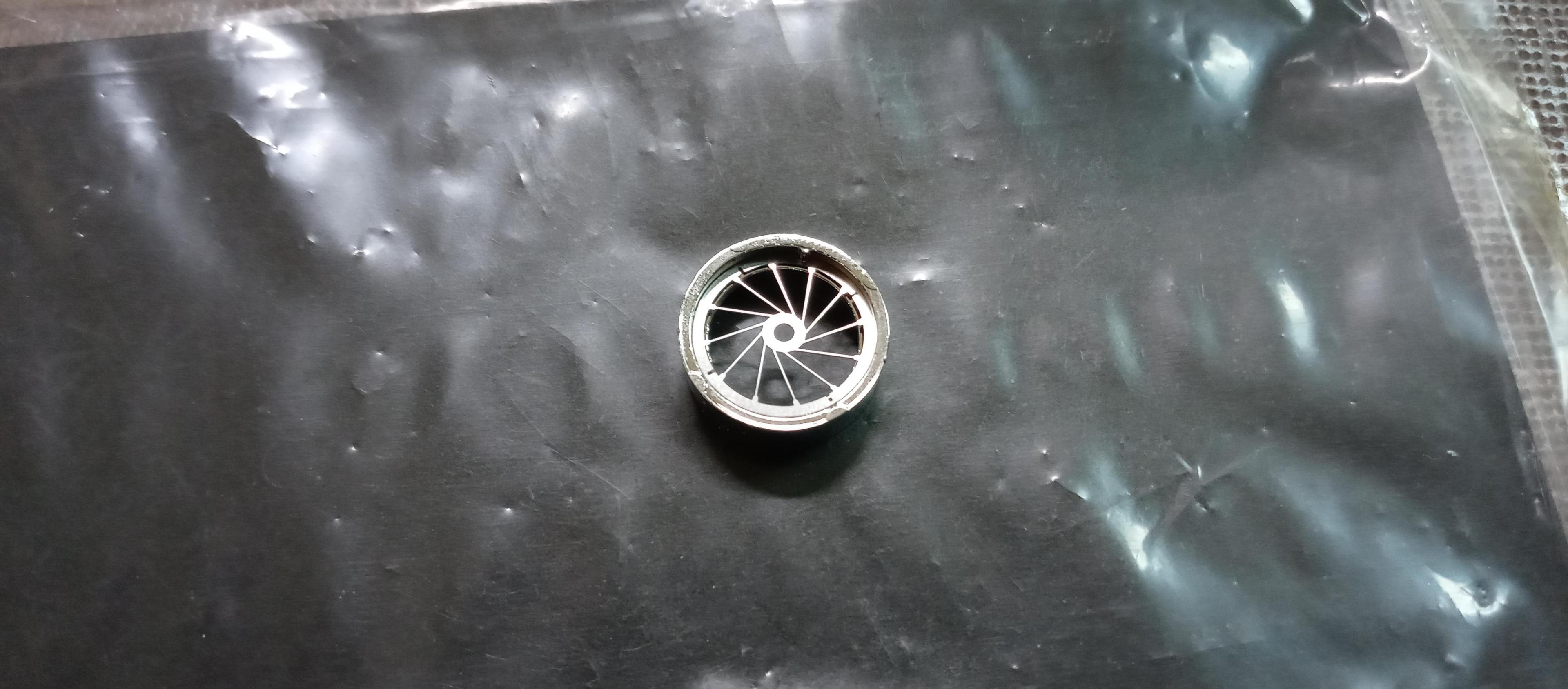

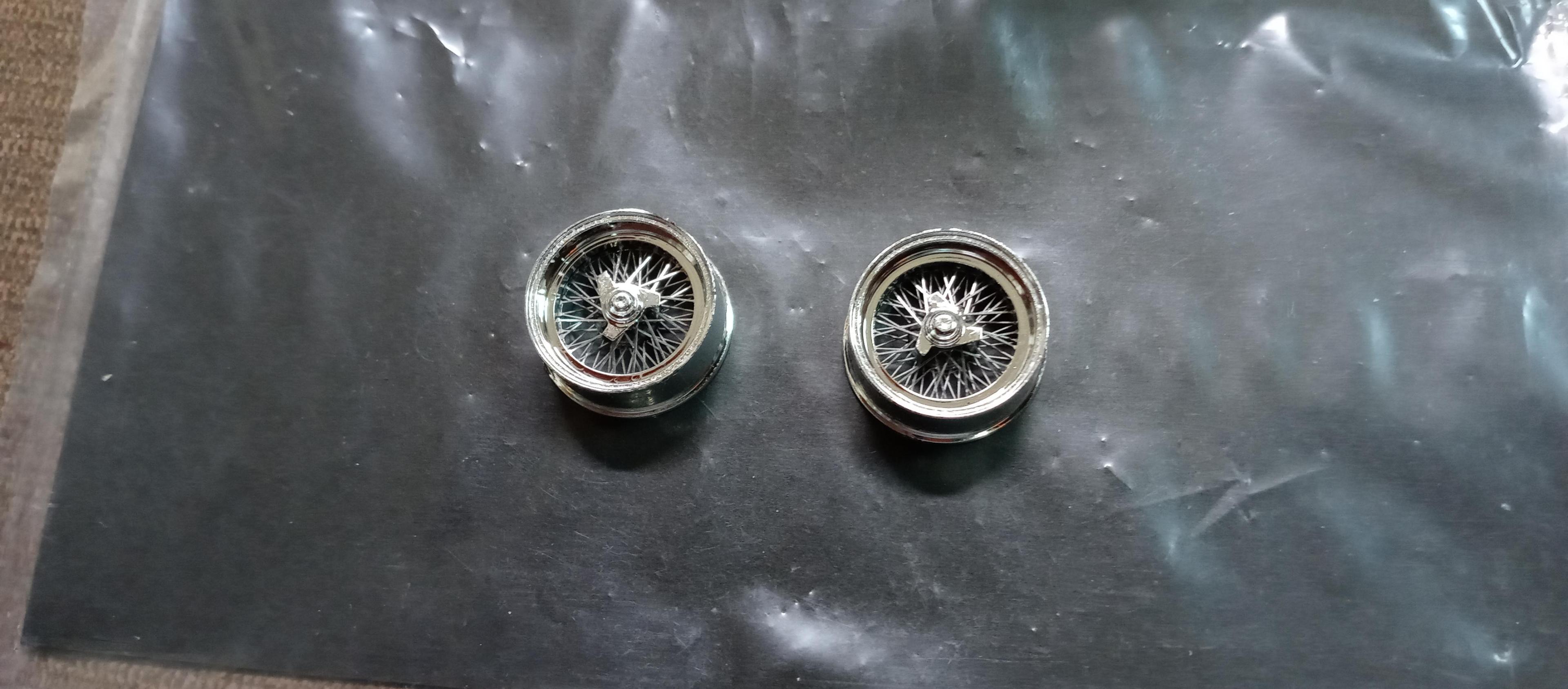

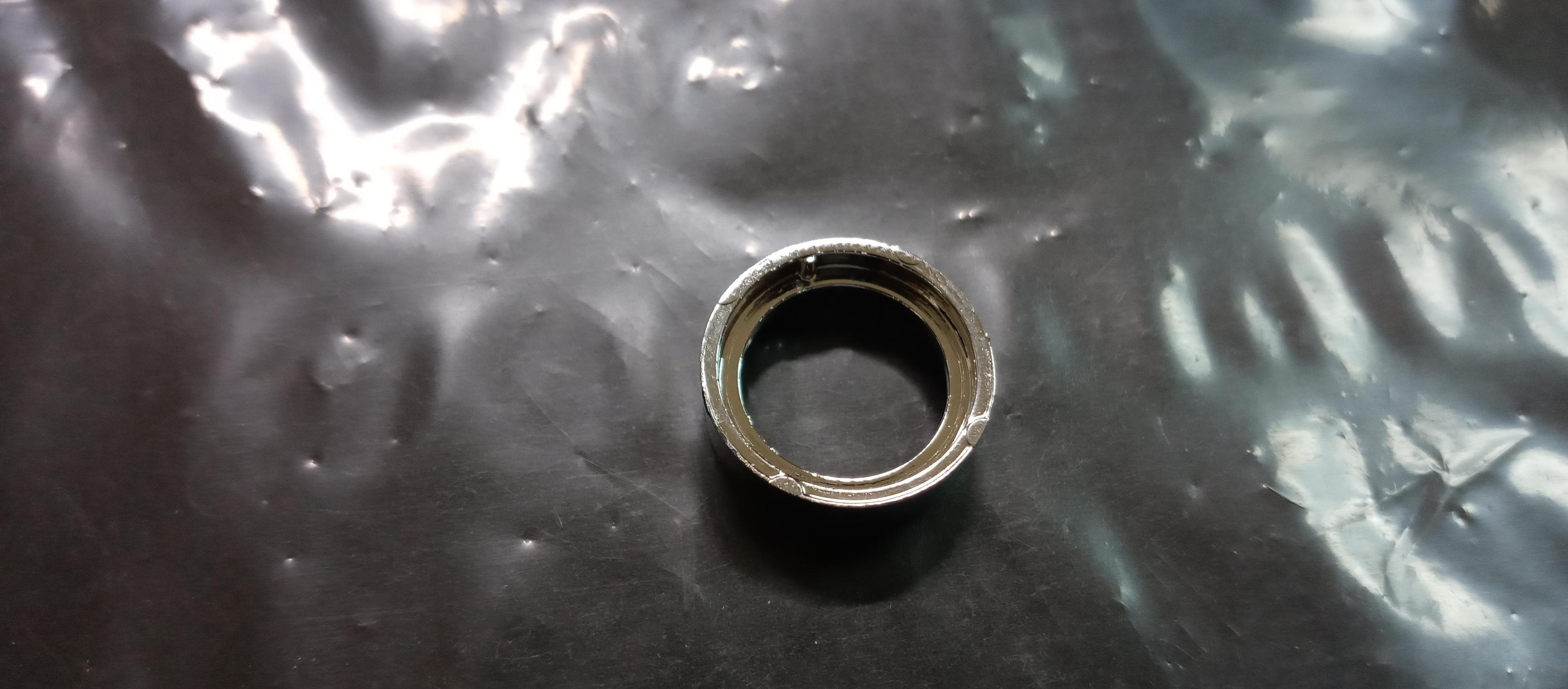

Justin Porter Posted October 9, 2022 Author Posted October 9, 2022 So got a bit of time at the bench and decided to tackle this kit's signature: those gorgeous photoetch wire wheels. Fortunately, they're not nearly so tricky as could be expected. The combination of my AK Photoetch Scissors, a good fine sanding stick, and Bob Smith purple cap CA meant that they genuinely went together well! 3

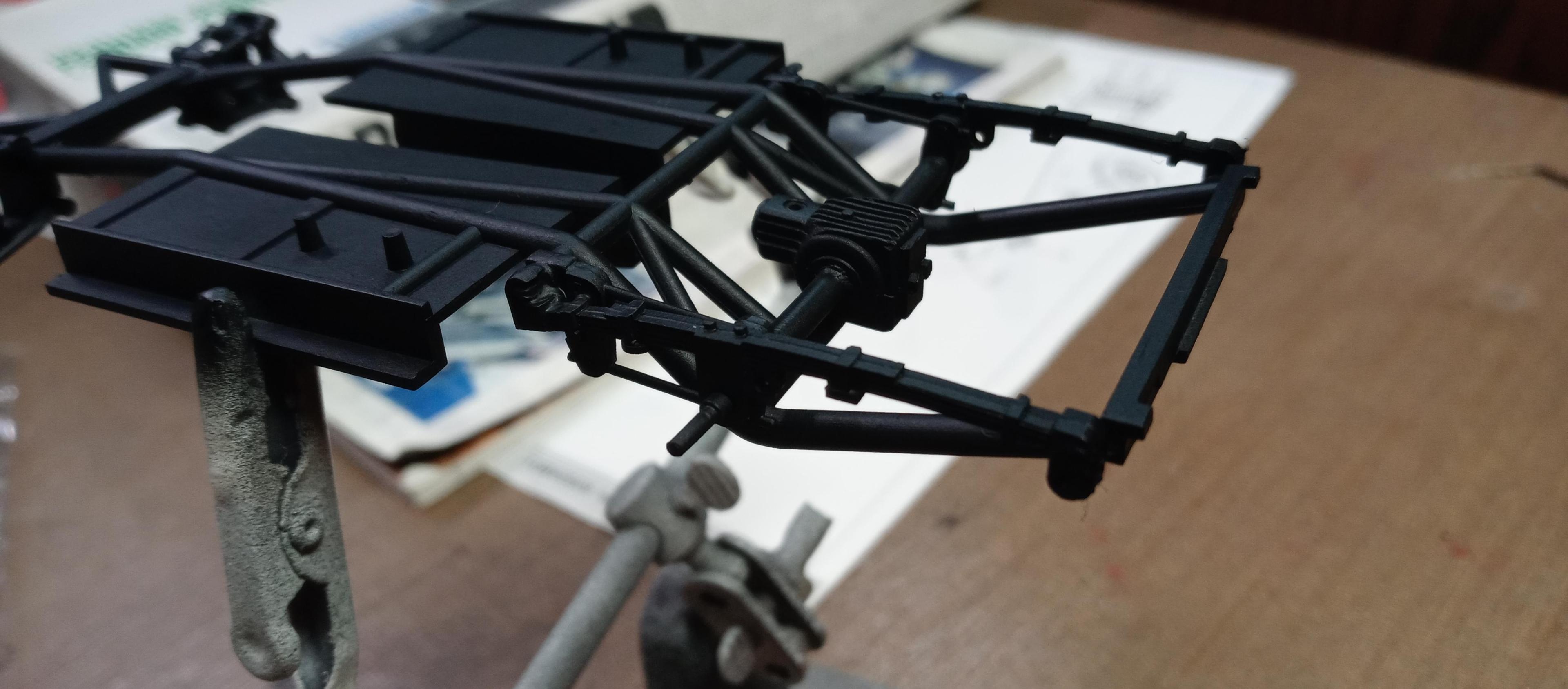

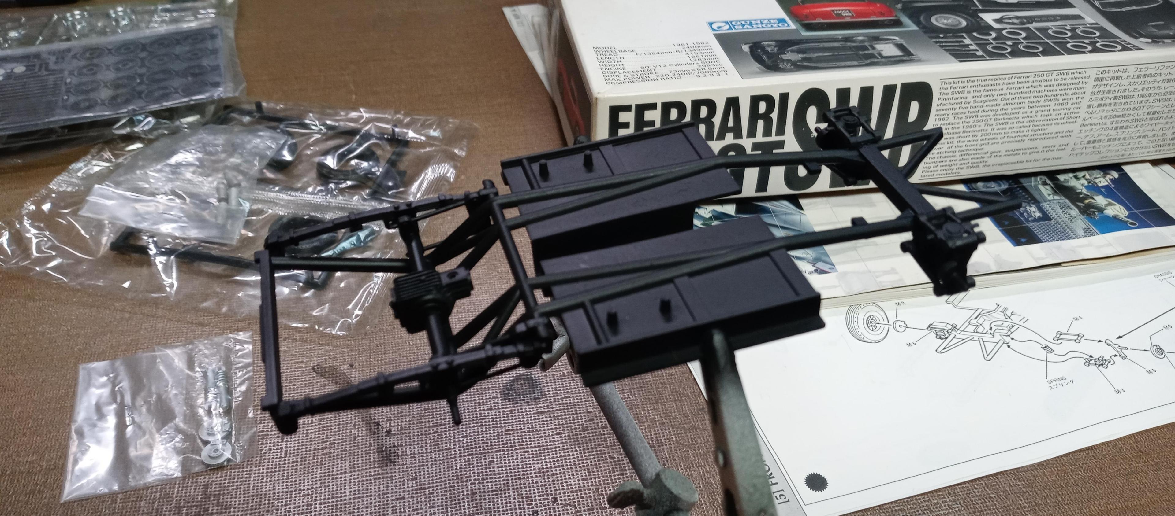

Justin Porter Posted October 11, 2022 Author Posted October 11, 2022 Chassis is all together. It's kind of a shame that the chassis is missing so much in terms of detail. The kit front suspension has no front sway bar, no steering linkage, no steering gearbox, just a representation of control arms, some spindles that exist solely to give the wheels somewhere to attach, and some admittedly very nice metal coil springs. The rear suspension comes off much better which is good since the stance of the car means it'll be much more visible. I masked off the floorboards and airbrushed the frame and suspension with semi-gloss black, then picked out the differential in C28 Steel and the control arms in C8 Silver. I chose to leave the brake rotors bare metal, with the calipers picked out in Vallejo Metal Color Gold. The Fujimi 250GTO Avon tires really do look so much nicer than the kit tires as shown in the mock-up, BUT they're at least a scale inch larger in diameter than the Gunze Sangyo wheels so I'm either going to have to wrap the rims in sheet styrene to bulk them up OR wave the white flag and use the Gunze tires. What a predicament!

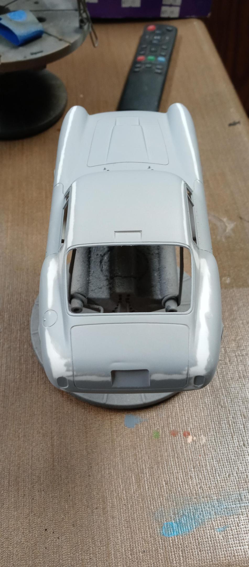

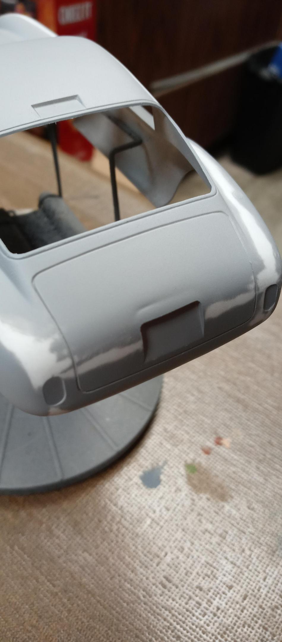

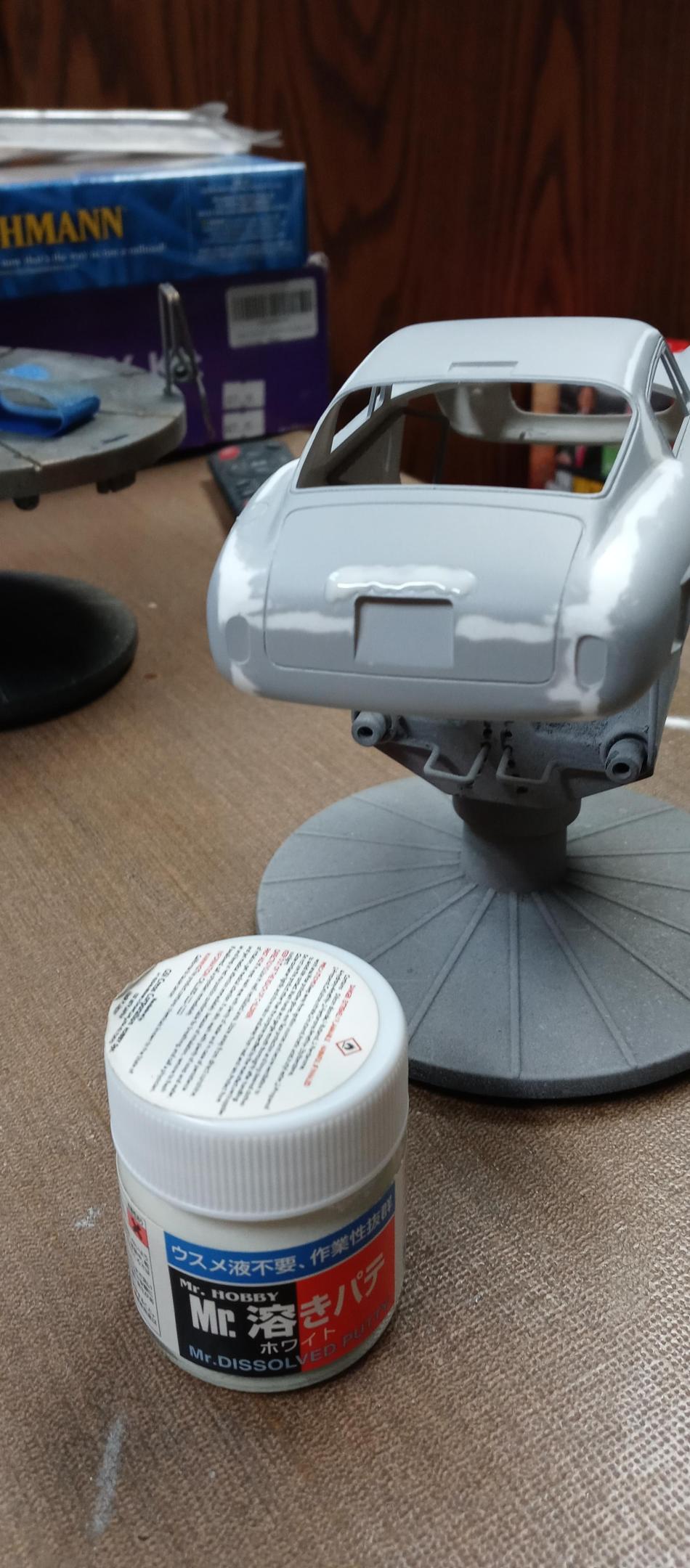

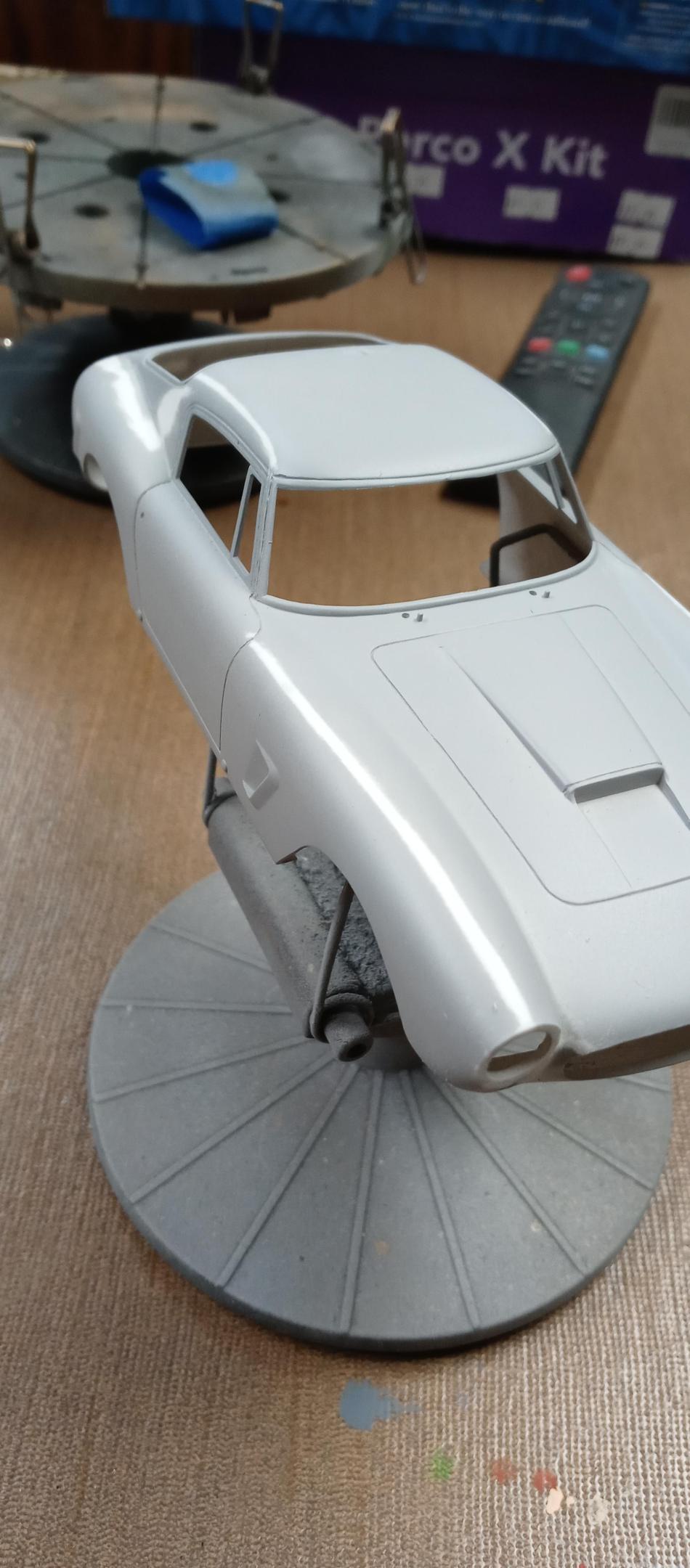

Justin Porter Posted October 17, 2022 Author Posted October 17, 2022 Even dream projects using highly collectible kits aren't immune from bodywork. In this case Gunze Sangyo saw fit to bless the builder with a good host of fine but noticeable mold lines which were difficult to see before a coat of Tamiya Fine Gray Primer. On top of that, there's some genuinely awful sink marks around the rear license plate. Out came the Mr Dissolved Putty to fill in those!
Matt Bacon Posted October 18, 2022 Posted October 18, 2022 It does capture the pumped and pugnacious shape really well, though, IMHO… best, M.

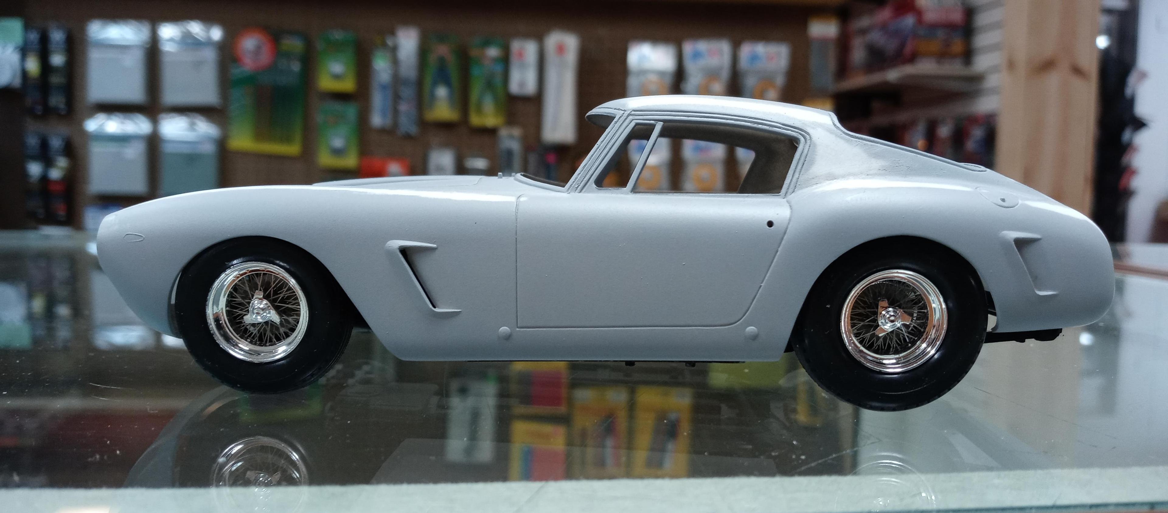

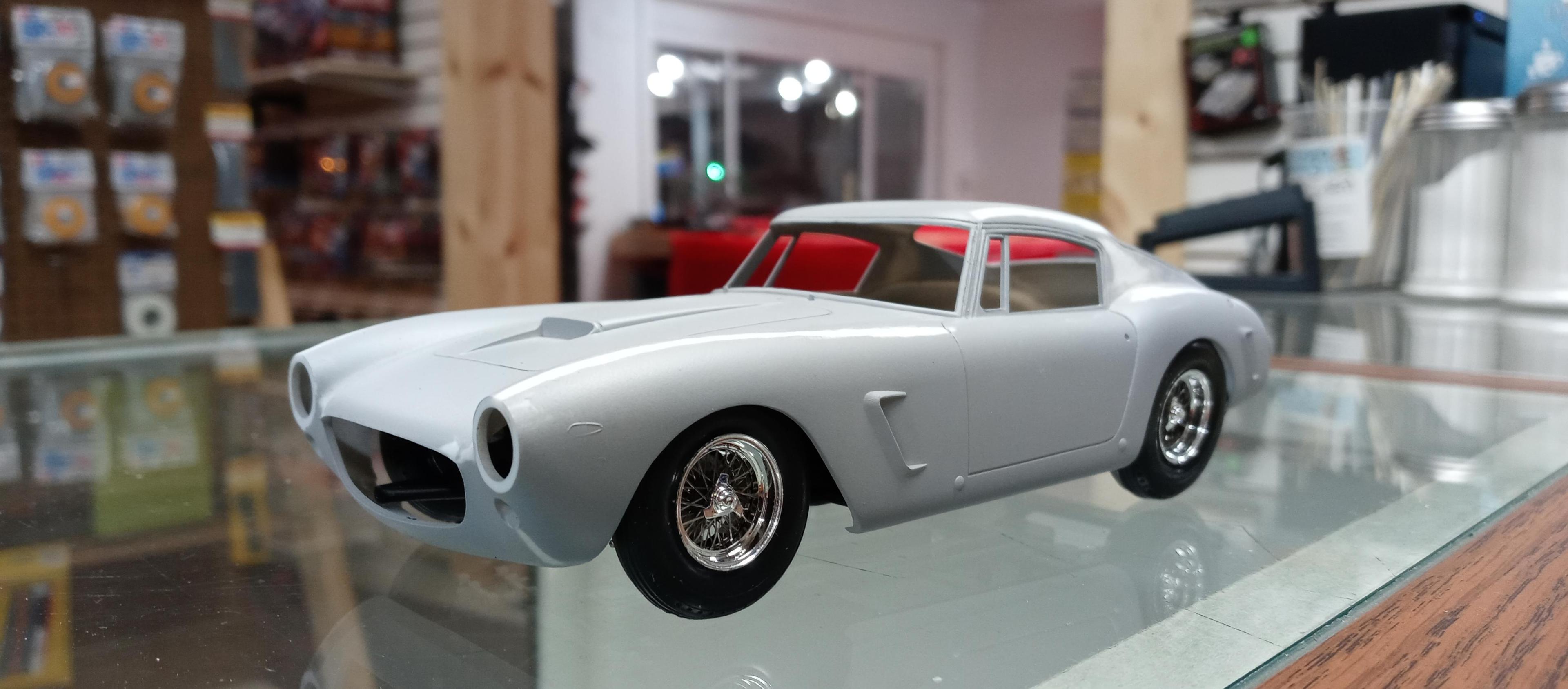

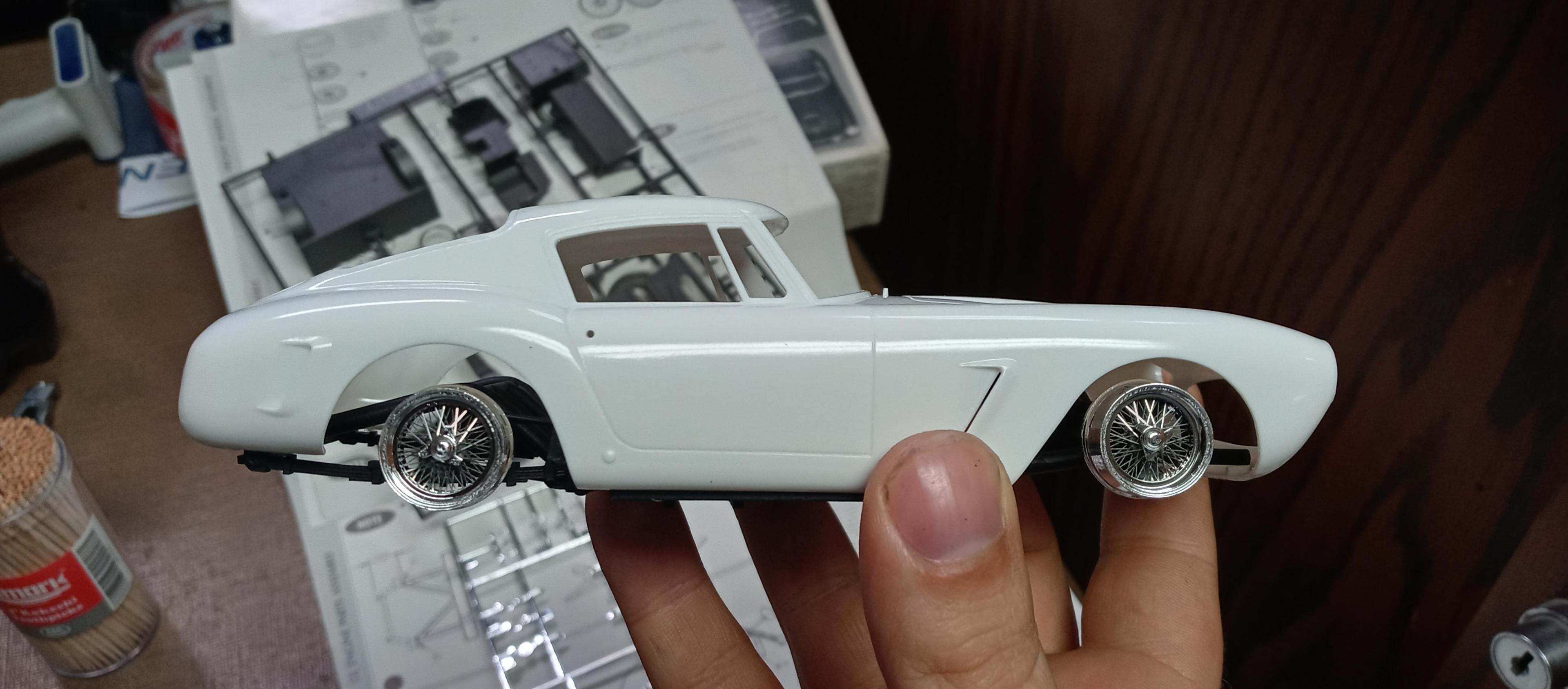

Justin Porter Posted October 19, 2022 Author Posted October 19, 2022 Got the front inner fenders in place and that meant finally an opportunity for a true mock-up. After much deliberation, I decided that the Gunze Sangyo tires will be okay for the build particularly since the stance does look quite good. A little bit more sanding and on will go the next coat of primer. 2

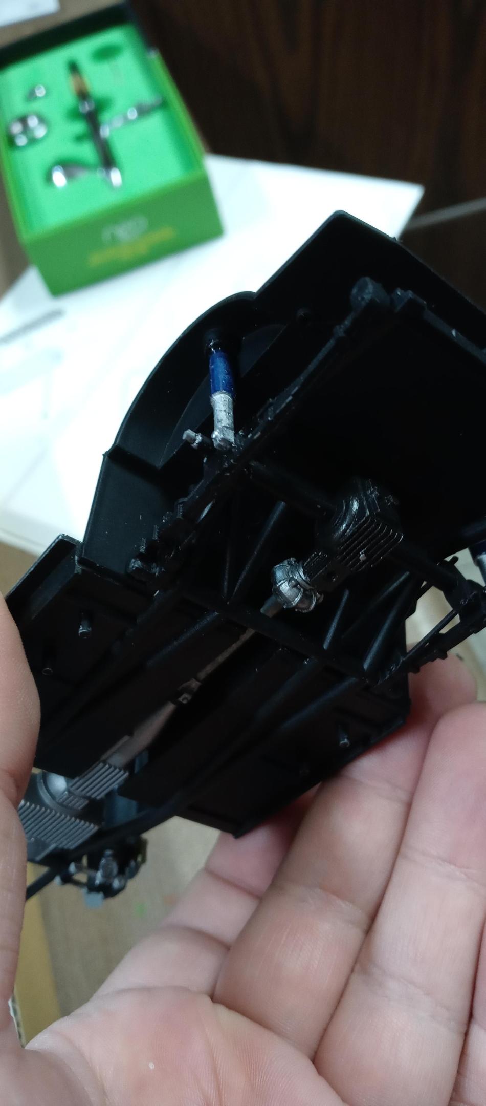

Justin Porter Posted October 21, 2022 Author Posted October 21, 2022 Added the shocks to the suspension as the 250GT continues towards being a completed build. 1
Matt Bacon Posted October 21, 2022 Posted October 21, 2022 Sharp, clean work @Justin Porter. I might argue about some of the decisions about what’s in this kit and what isn’t, but what they did give us is very well engineered. Looking forward to seeing more. best, M.

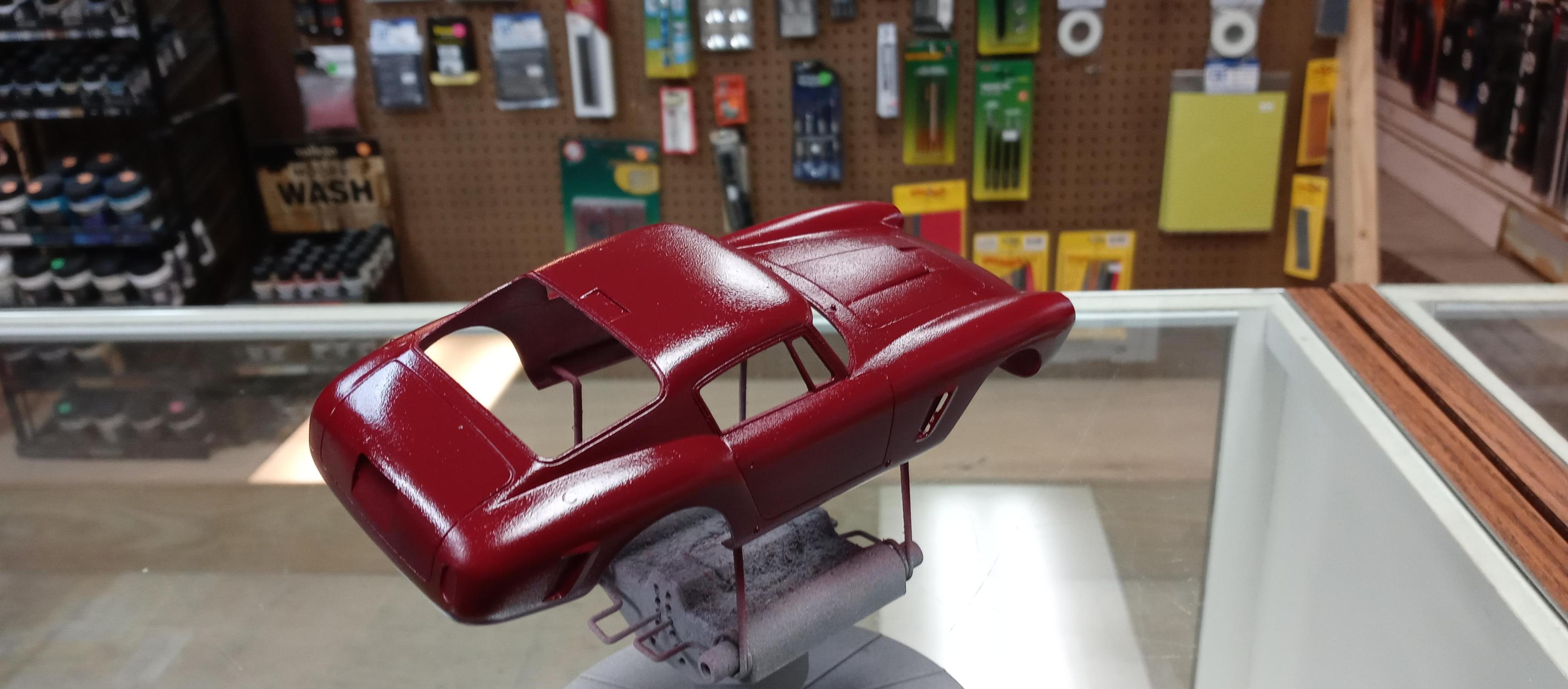

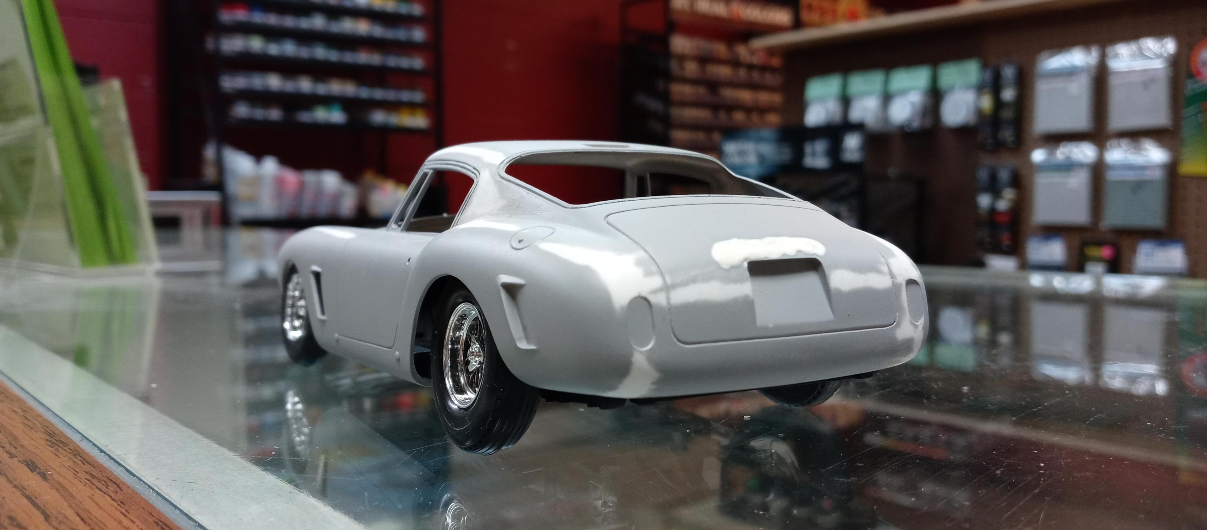

Justin Porter Posted November 7, 2022 Author Posted November 7, 2022 This past Sunday at the Cleveland Model Show, I was finally able to address a big concern hanging over the project: the paint. The car I want to approximate - though not necessarily replicate - was painted an obscure Ferrari color named Rosso Bordeaux. Unfortunately, there wasn't a ready source for just that color. Thankfully, Mike of MCW Automotive Finishes took some time during the show to try and match against my reference photos and we settled on Royal Maroon from his lacquer line. This is the first color coat, sprayed straight from the jar and then backed up with a mist coat of Mr Leveling Thinner to level out the paint. 1
