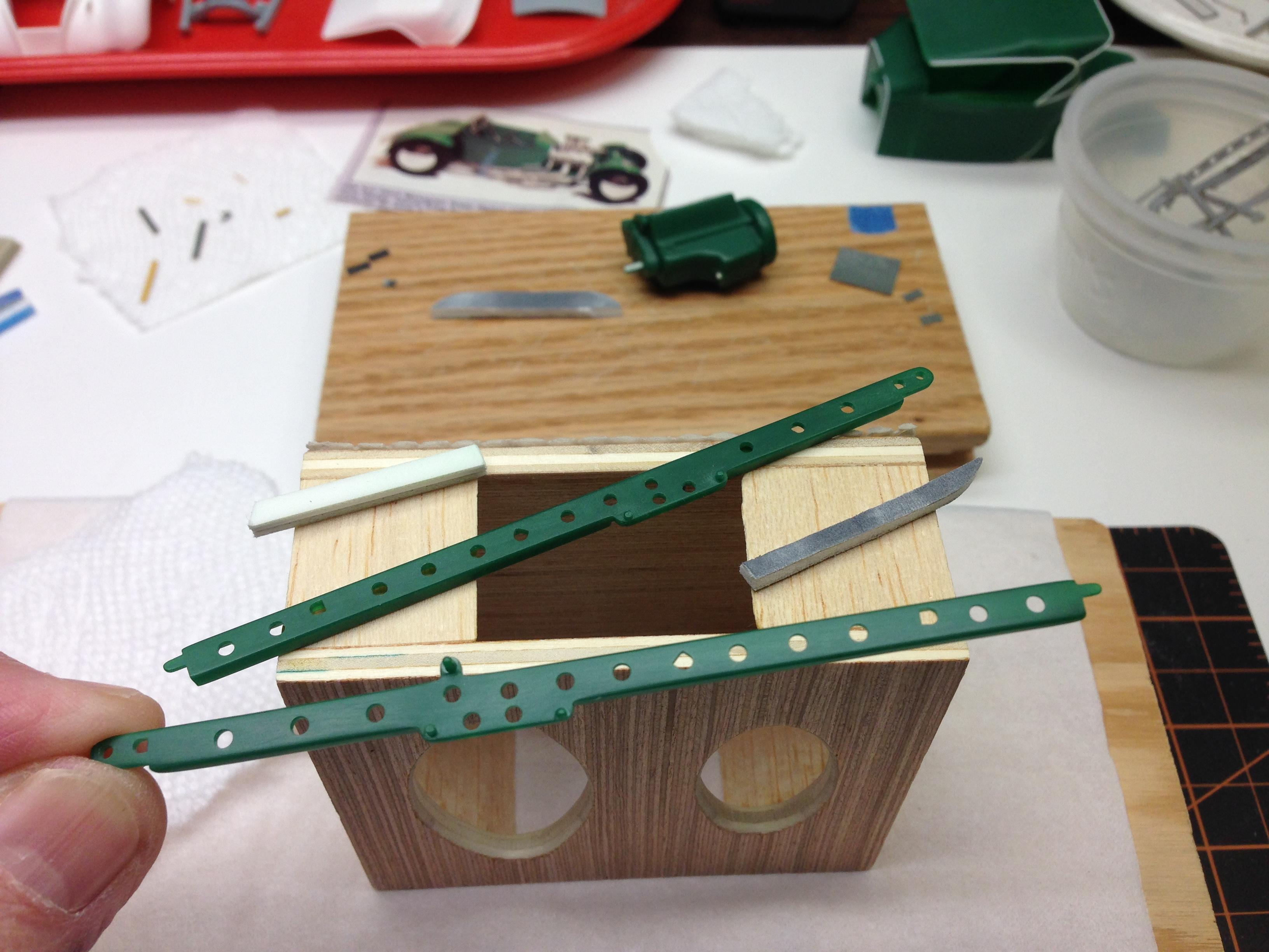

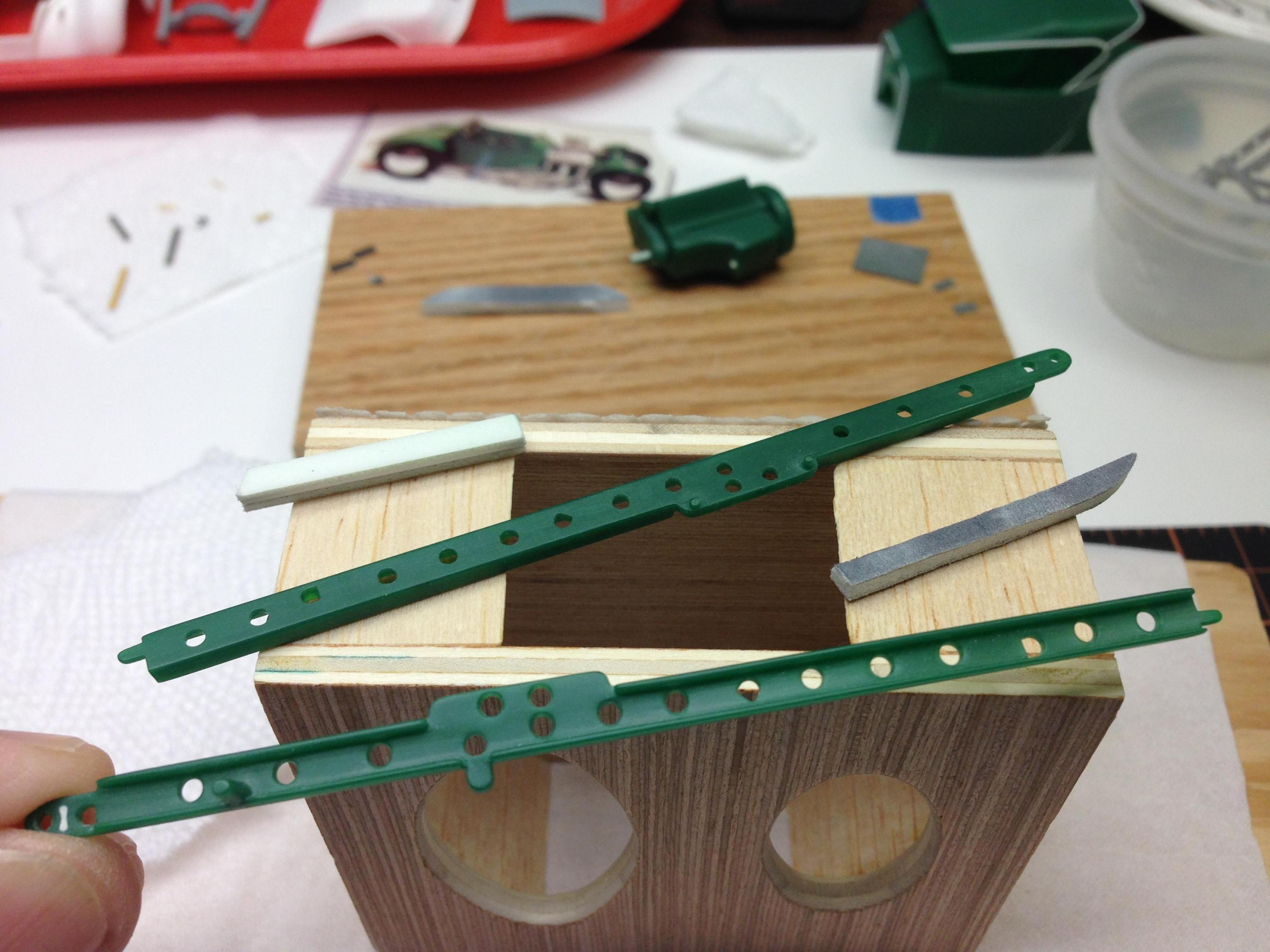

Joe Nunes Posted November 26, 2022 Author Posted November 26, 2022 (edited) Have been sanding the rails and getting parts ready for primer. The rails smoothed out nicely and I will finish sanding the body and the top next. And onwards we go! ? Joe Edited November 26, 2022 by Joe Nunes Forgot to add photos ? 1

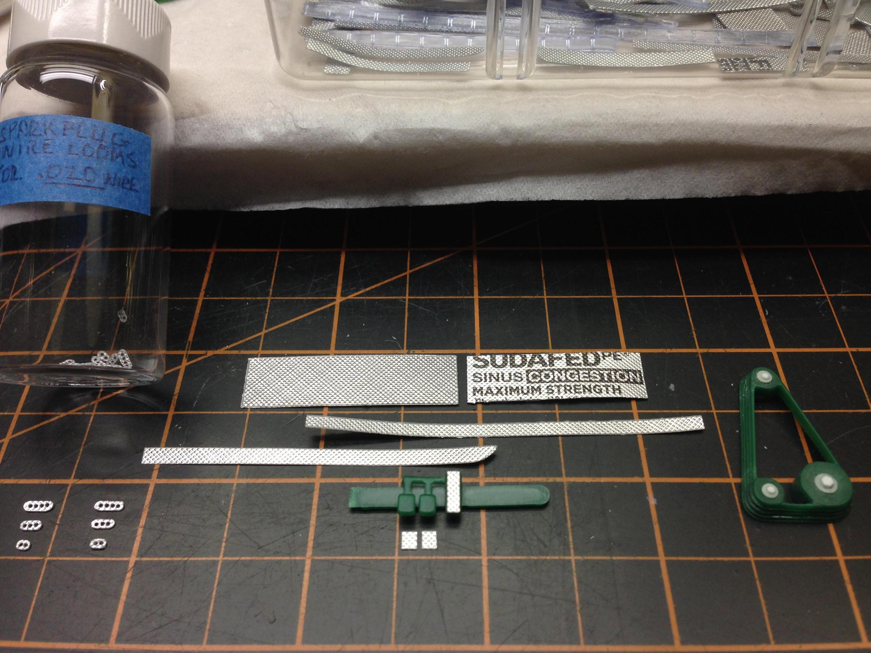

Scott8950 Posted November 27, 2022 Posted November 27, 2022 On 11/13/2022 at 9:13 PM, Joe Nunes said: The pedal cover pieces and wire looms were cut from the plastic that encased Sudafed pills and has an embossed aluminum appearance. It's amazing what modelers can come up with. Thanks for this tip I will be trying this. 1

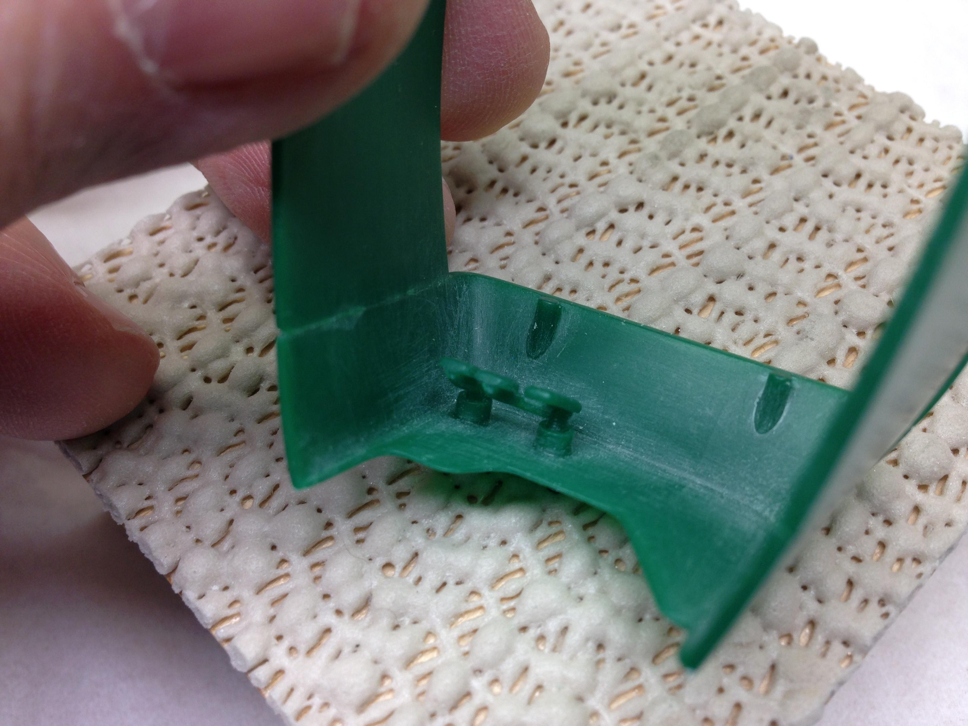

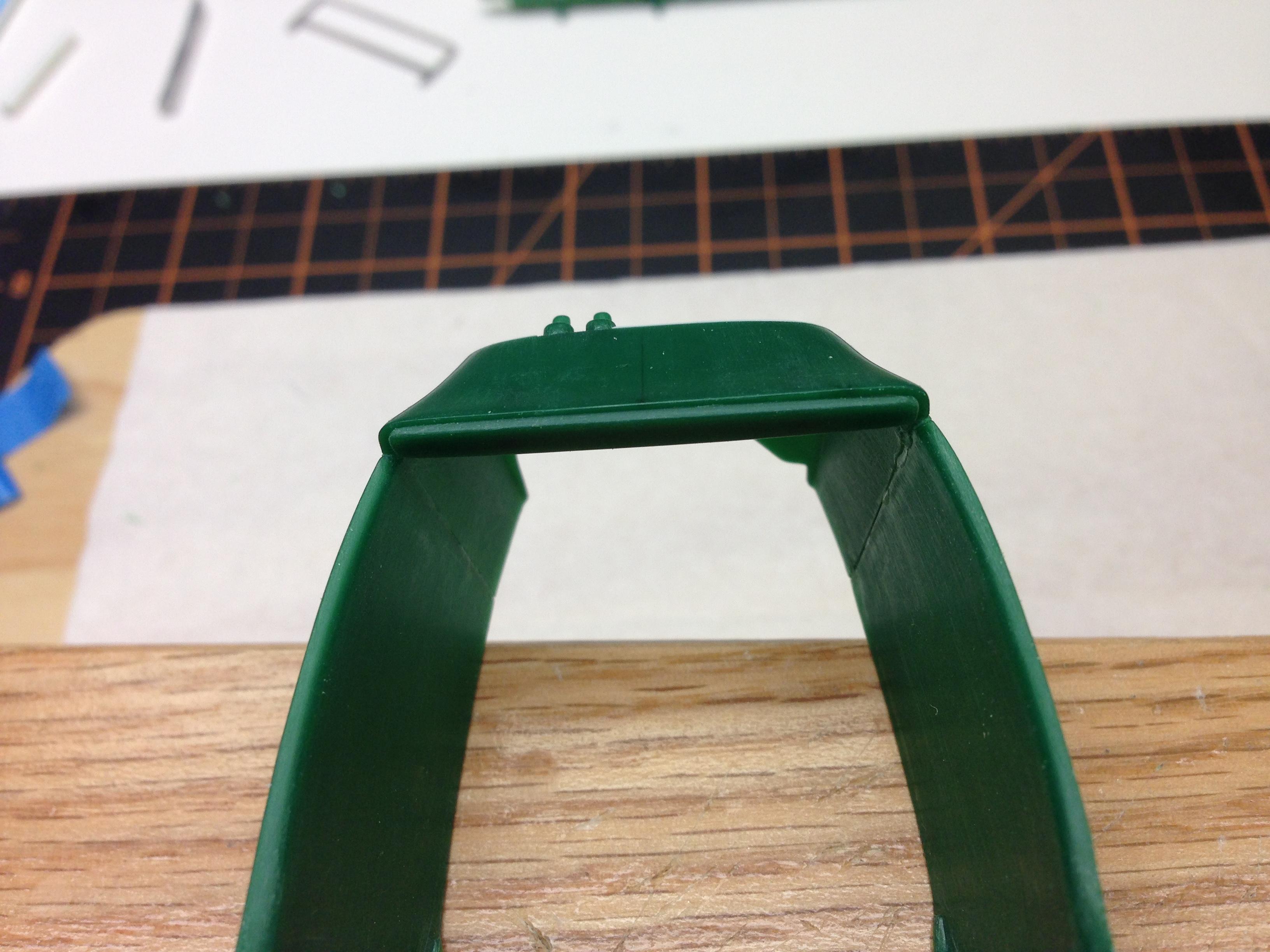

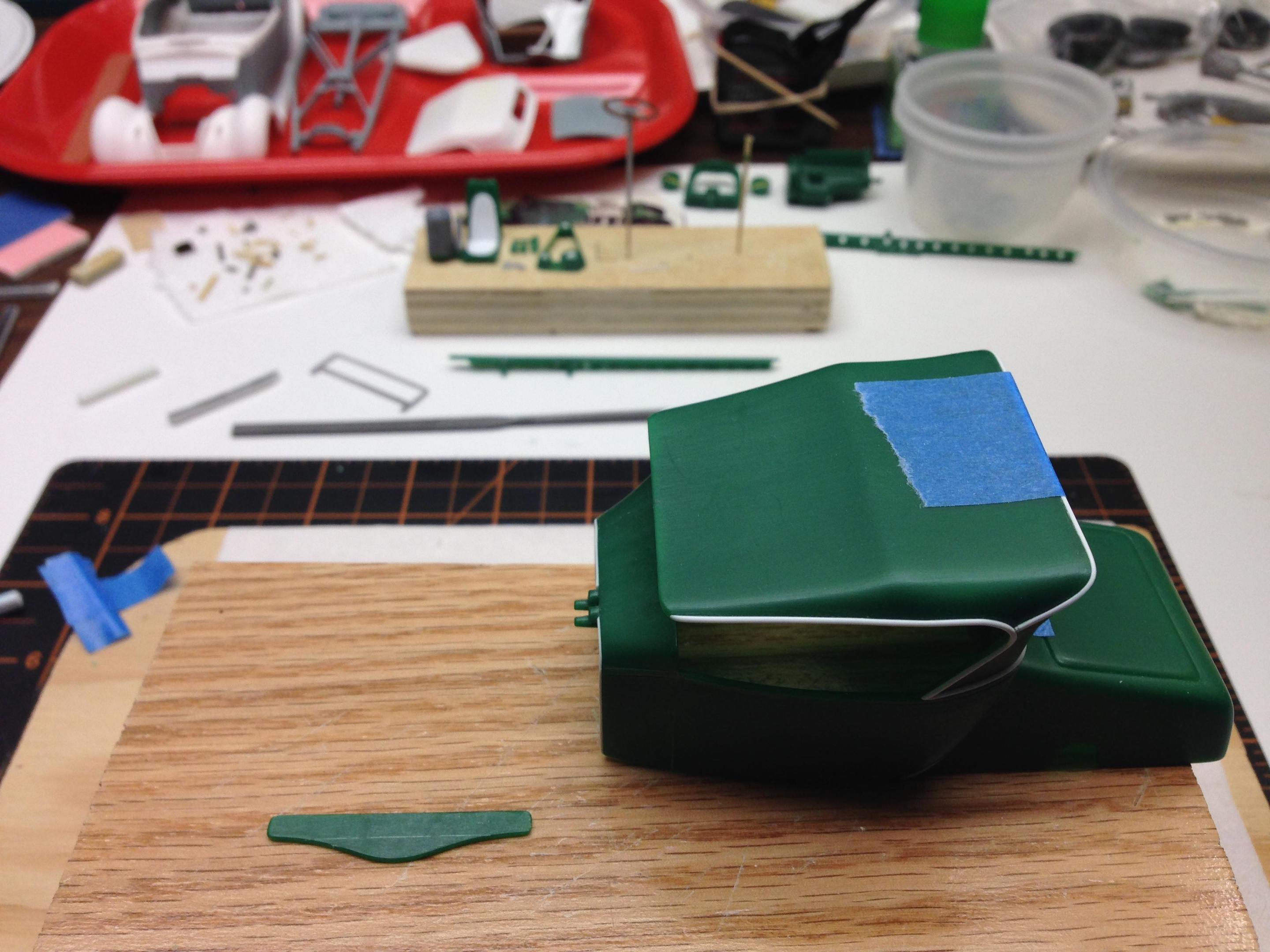

Joe Nunes Posted November 28, 2022 Author Posted November 28, 2022 Clean up and sanding time on the inside of the body and top is the task at hand. Joe

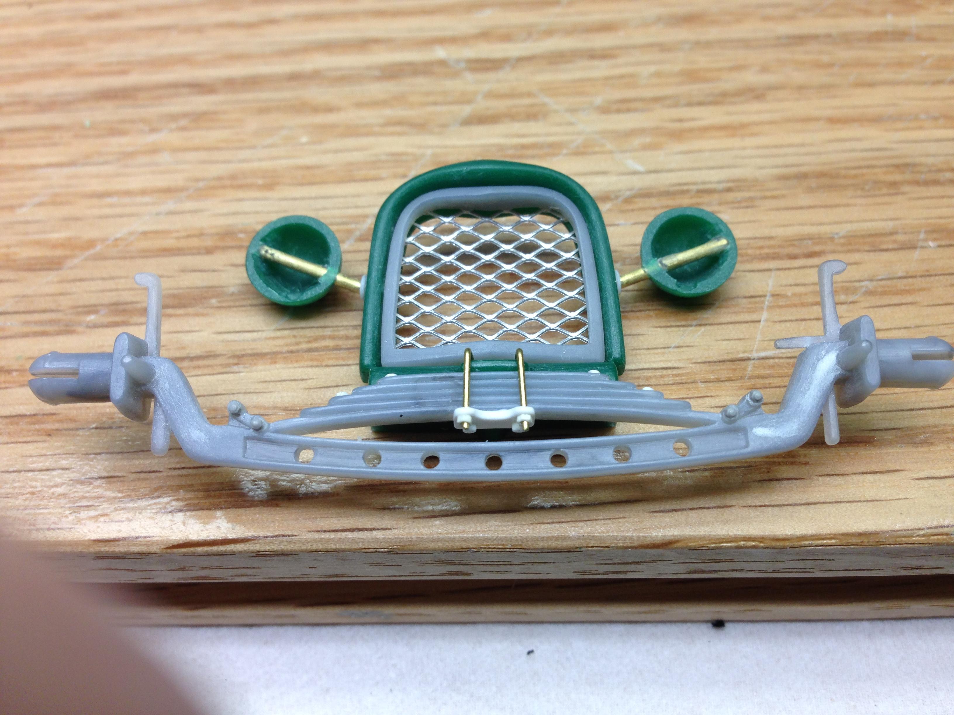

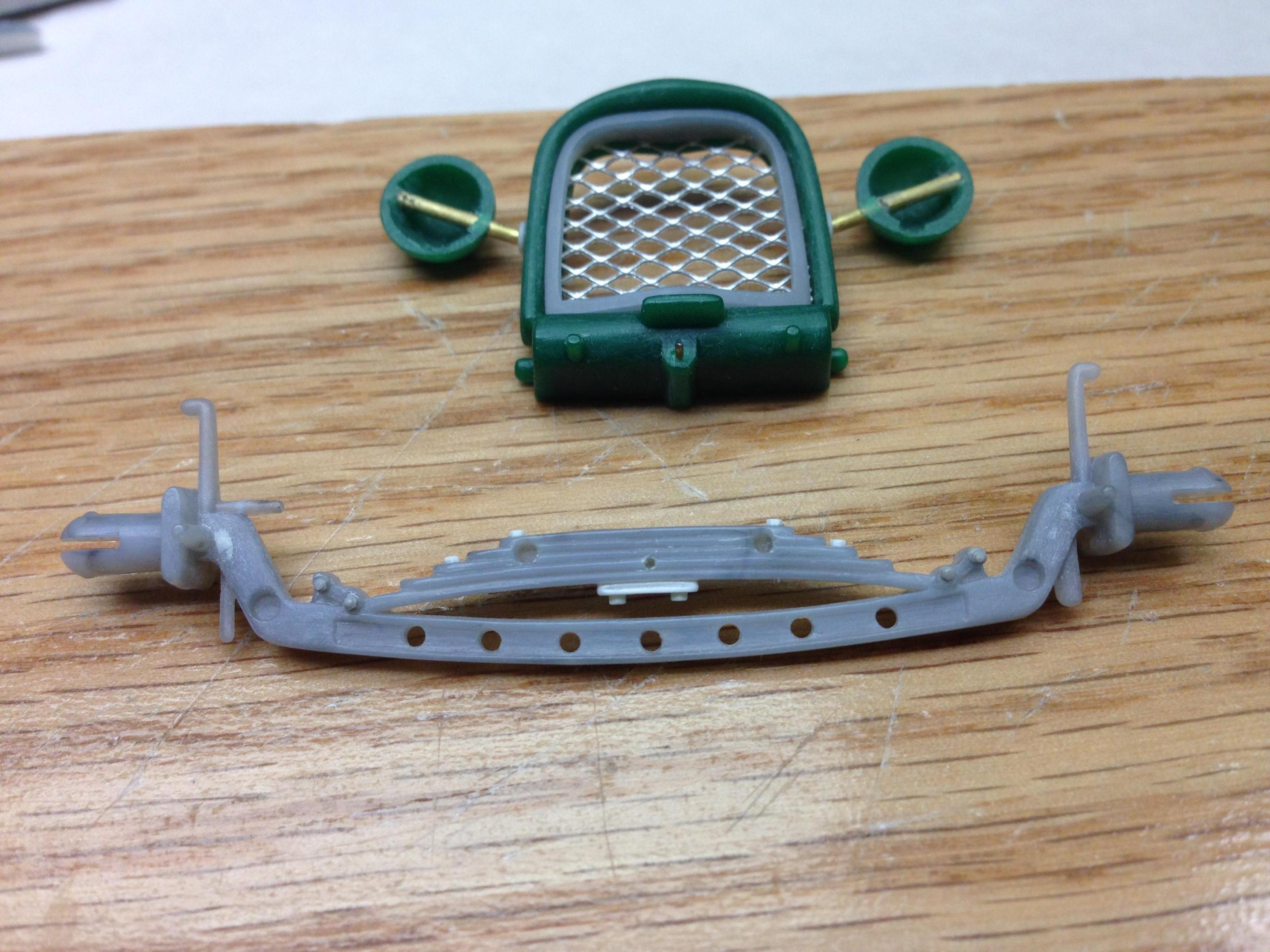

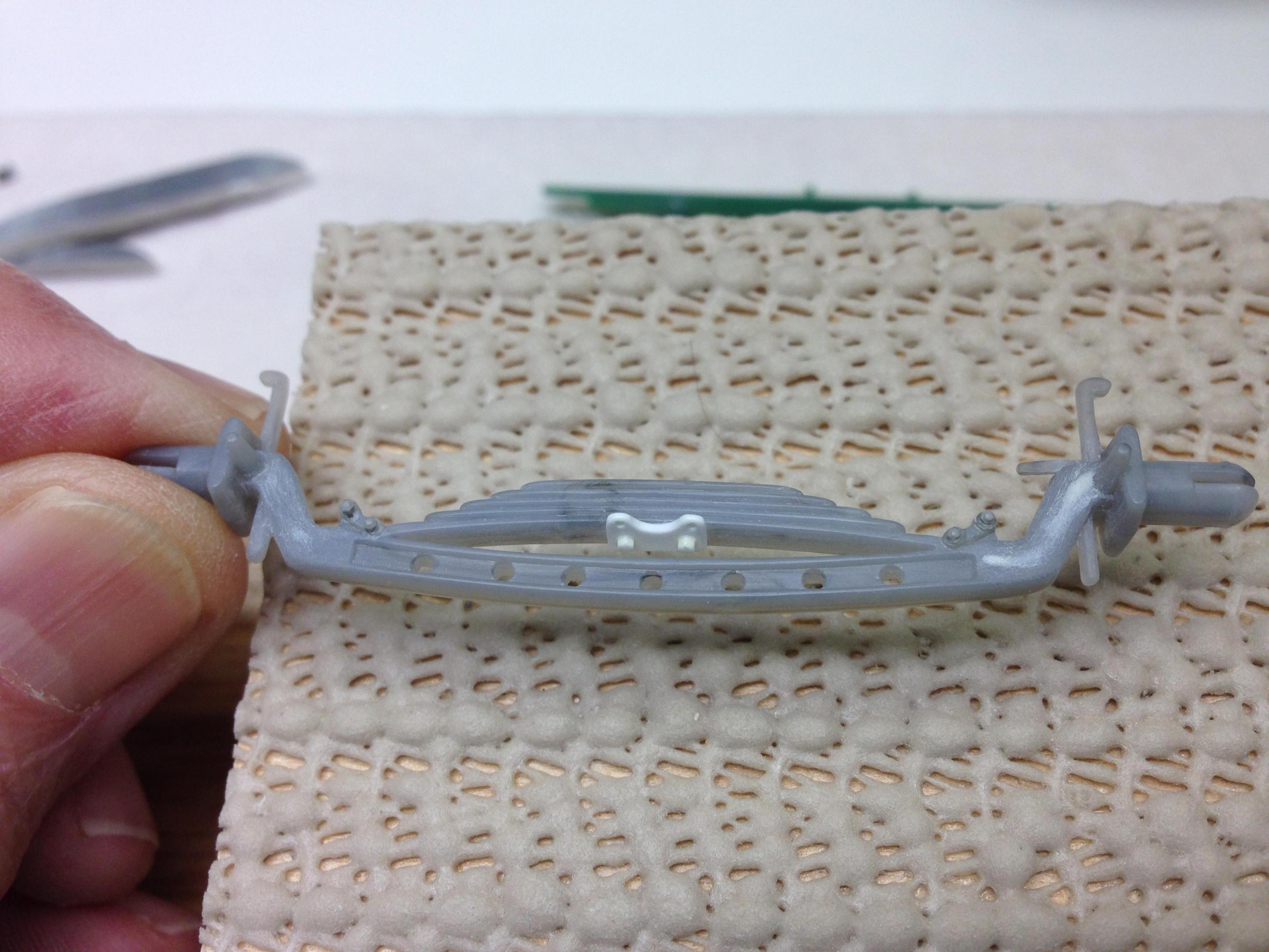

Farmboy Posted December 3, 2022 Posted December 3, 2022 Clean work like you're doing turns a kit into a looker every time, Joe. Are those bumper pads on the front leaf? Nice quiet detail touch! If they're not, well, I'm old lol. All kidding aside, I'll be adding pucks like that to my next cross leaf build. Wel done!

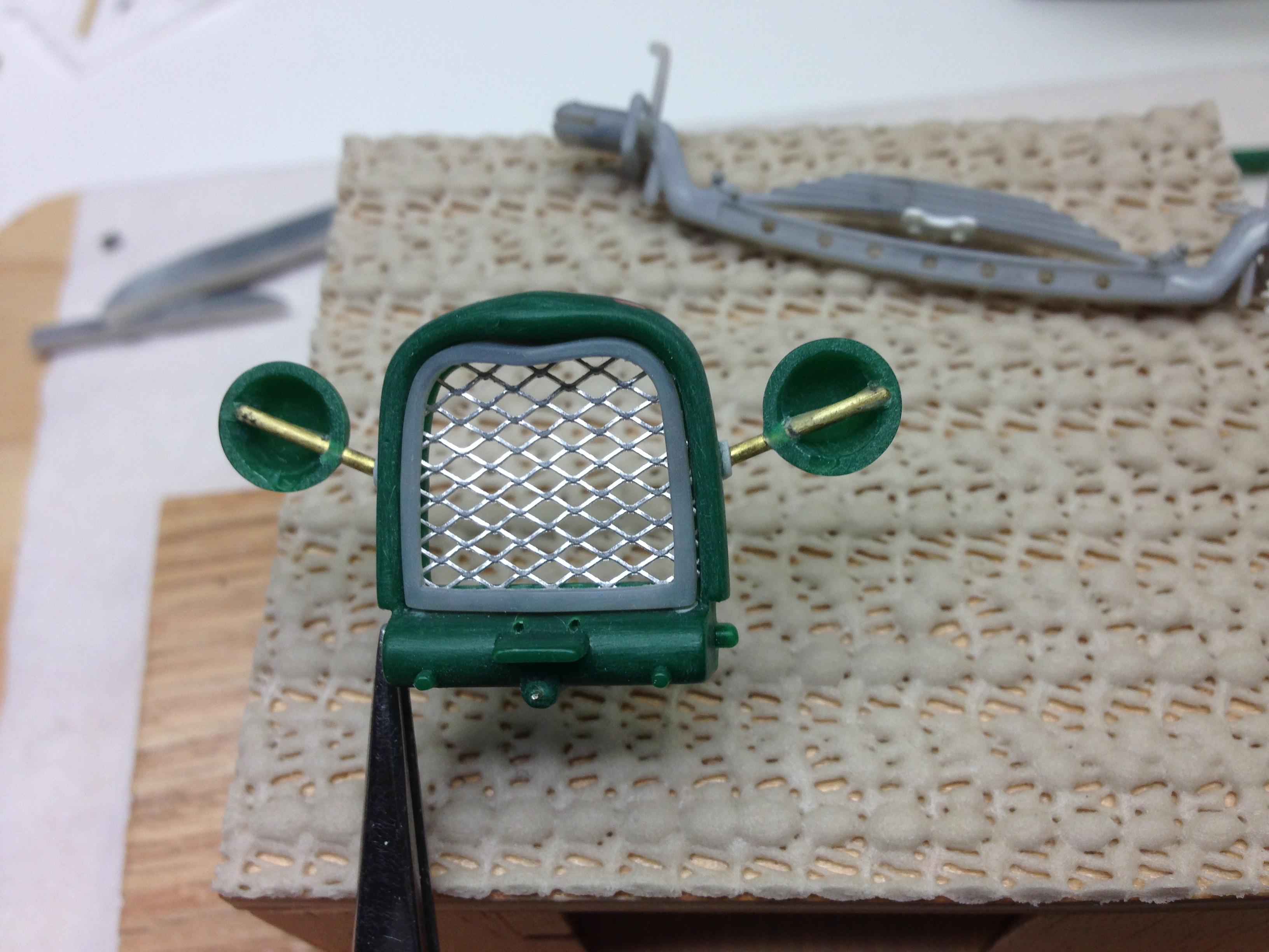

Joe Nunes Posted December 3, 2022 Author Posted December 3, 2022 Mike, I am not sure what you are referring to as bumper pad however I went down to the bench and took some photos to show what I am doing with the front axle. May not be scale but I like it so far. Joe 2
Farmboy Posted December 3, 2022 Posted December 3, 2022 Guess I was a bit vague. On your leaf spring, what do the 4 round pieces of rod represent. I recall puck-like rubber spacers (looking somewhat like those) on the axles and the backs of some leaf assemblies back in the day. Kept metal from hitting metal due to bad potholes, rr crossings, etc. I thought your leaf spring was under a frame cross member and that would explain their (more for looks) function. Whatever, they're a nice detail.
Joe Nunes Posted December 3, 2022 Author Posted December 3, 2022 Oh...those. Just something I added so it would look like the spring would stay together as a unit. Joe
Farmboy Posted December 4, 2022 Posted December 4, 2022 Found these examples of leaf spring bumpers and protectors on Amazon. Not a big deal to modify to suit the application, and you can bet it's a small understated detail not everyone thinks of. I think the simple 'puck' style works well in scale. 1

Dragline Posted December 13, 2022 Posted December 13, 2022 That Sudafed idea ia pure genius. You'll forgive me if I swipe it. As for the rest. .. Keep your chin up and never let em see you sweat 1

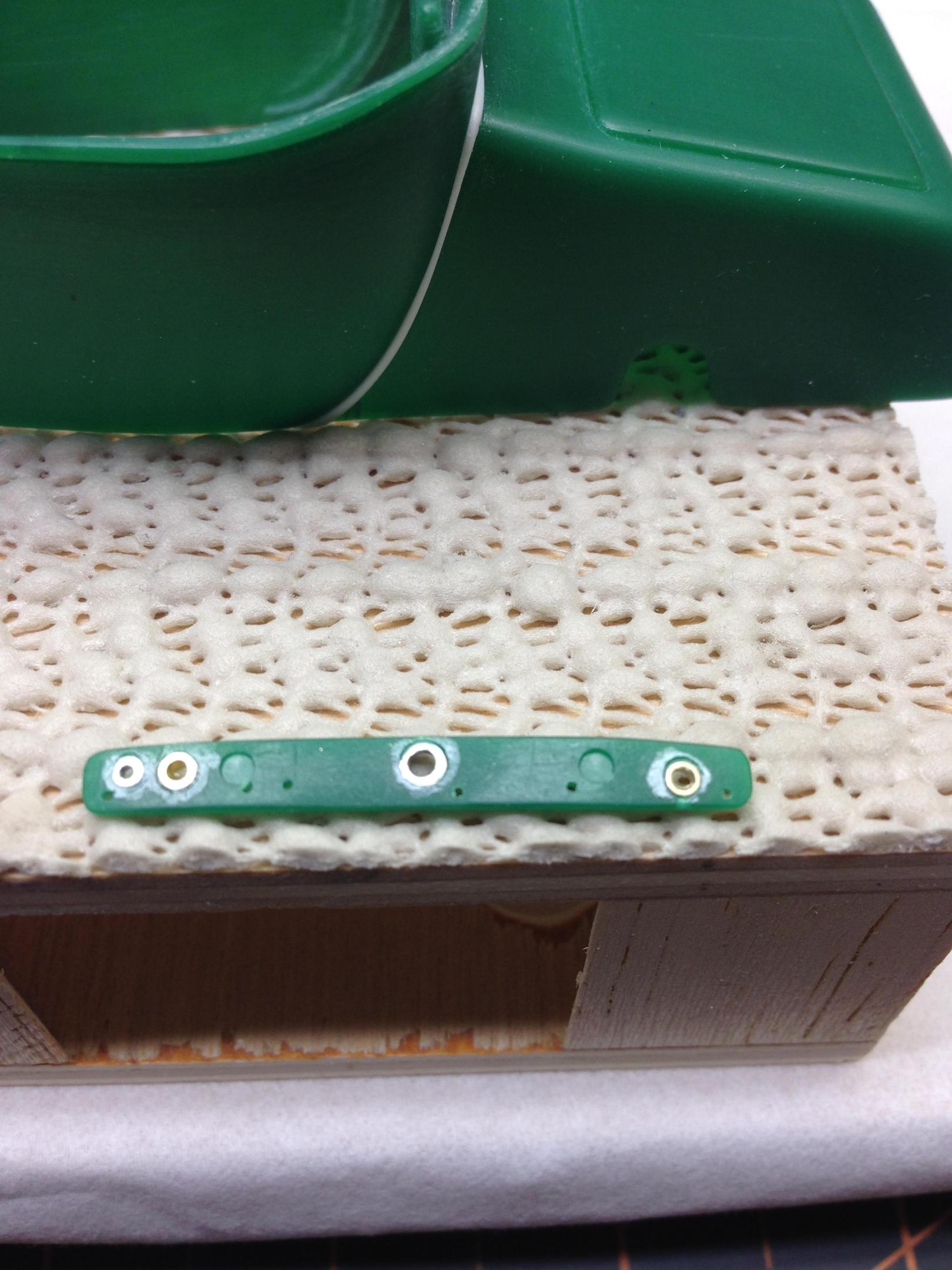

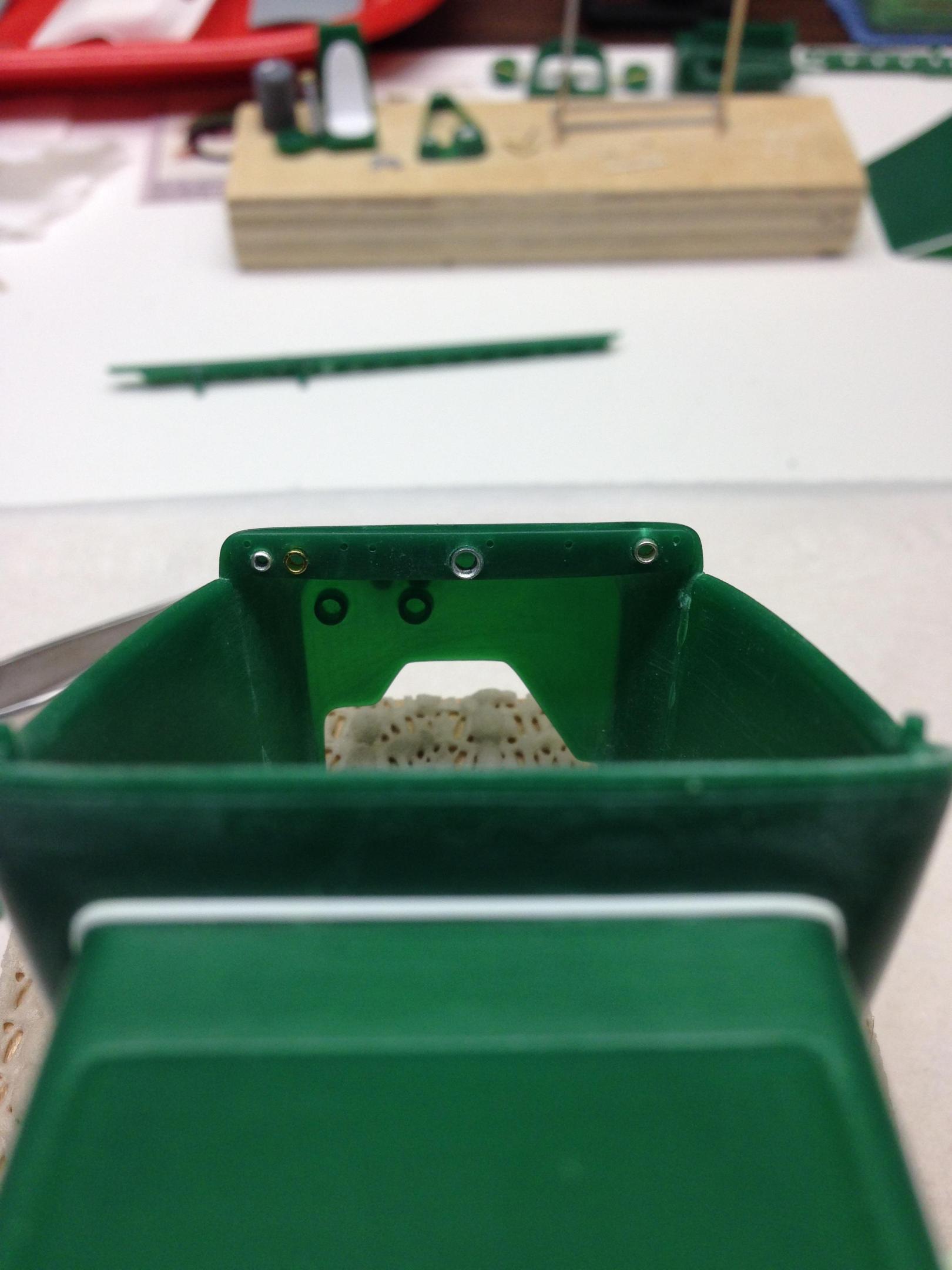

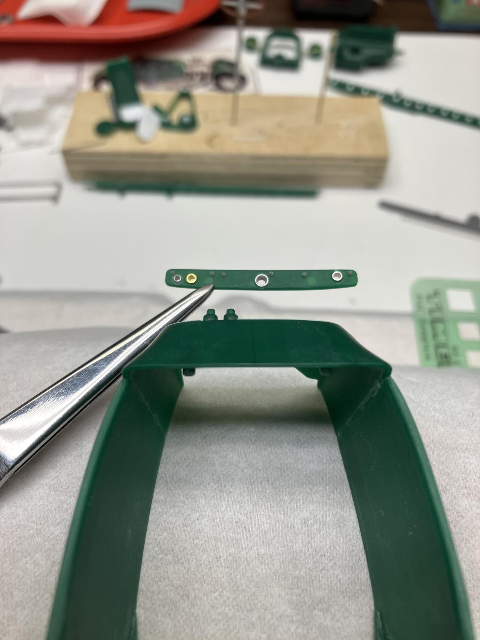

Joe Nunes Posted December 15, 2022 Author Posted December 15, 2022 Thought I had better get a little something done on the build so I came down to the bench and drilled out the gauge openings to fit the aluminum and brass pieces that represent the bezels on the dash. I cut the metal to length and will level the gauge faces to a uniform height after the glue dries. Also found a small Grant HO Scale nut and bolt item that, when the tops get sanded down a bit, can stand in for the dash screws. I’ll fill the metal bezels with a drop of epoxy and add a bit of gauge detail so they can look like glass covered gauges…small as they are. Add some paint and away we go! Still having a good time at the bench. Joe 1

Straightliner59 Posted December 16, 2022 Posted December 16, 2022 10 hours ago, Joe Nunes said: Thought I had better get a little something done on the build so I came down to the bench and drilled out the gauge openings to fit the aluminum and brass pieces that represent the bezels on the dash. I cut the metal to length and will level the gauge faces to a uniform height after the glue dries. Also found a small Grant HO Scale nut and bolt item that, when the tops get sanded down a bit, can stand in for the dash screws. I’ll fill the metal bezels with a drop of epoxy and add a bit of gauge detail so they can look like glass covered gauges…small as they are. Add some paint and away we go! Still having a good time at the bench. Joe Looking really good, Joe! Those model RR NBWs are the cat's meow! I've been using them, forever. There used to be one of the finest model railroad hobby shops, in the world, here in Denver, Caboose Hobbies. I bought so many detailing and scratchbuilding supplies, in that place, it's not even funny! It was a huge store. Sadly, no more. 1

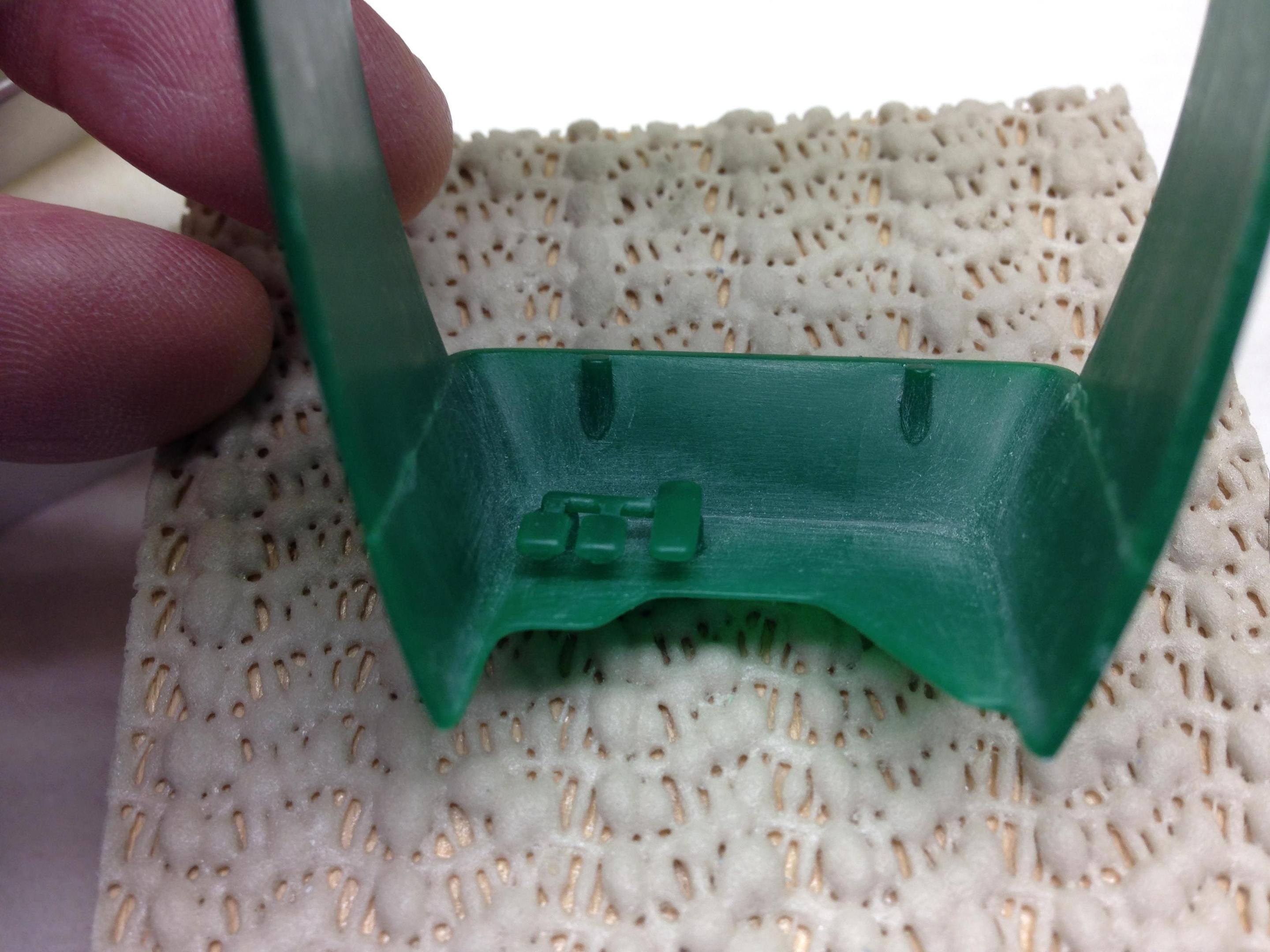

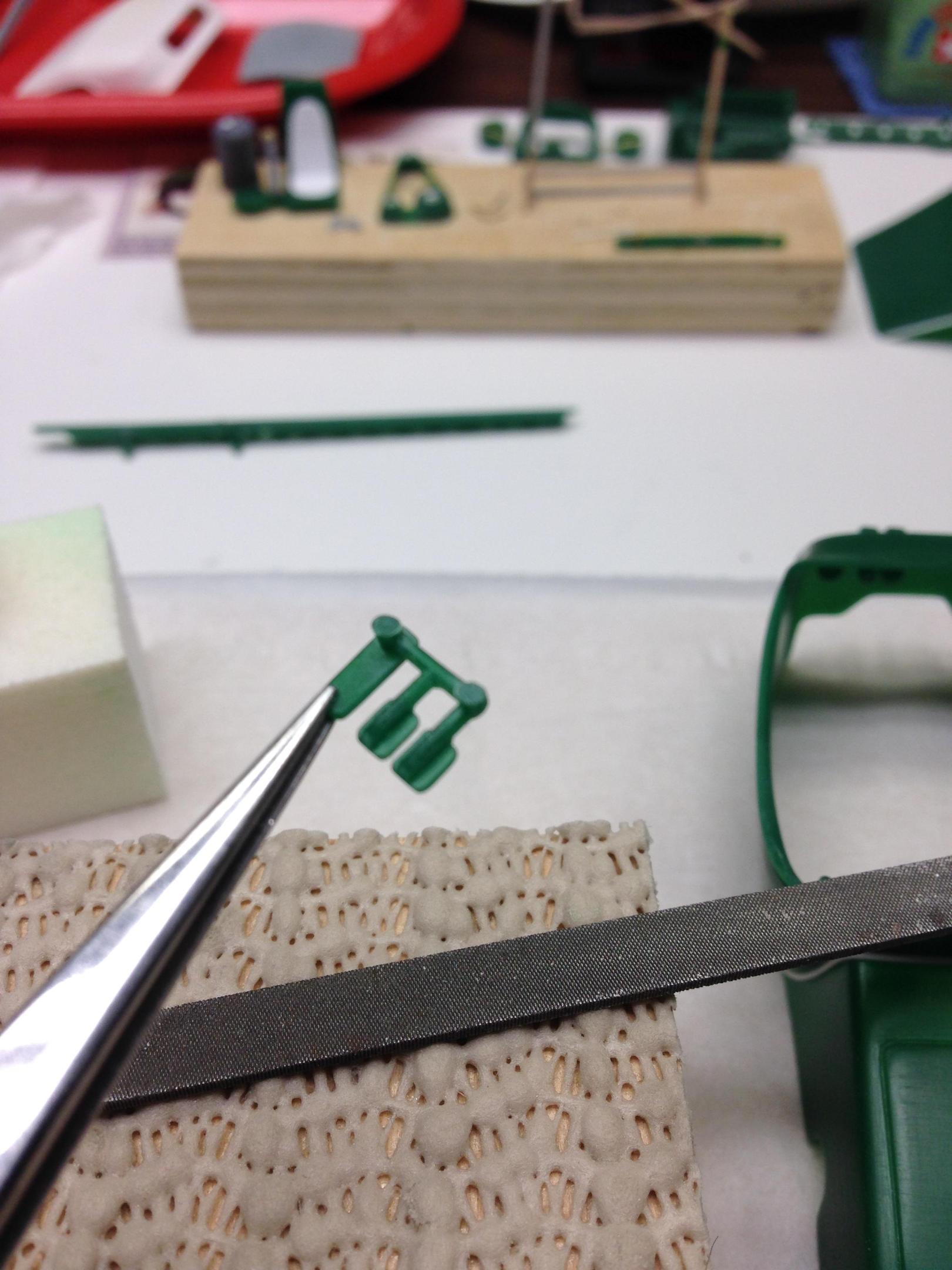

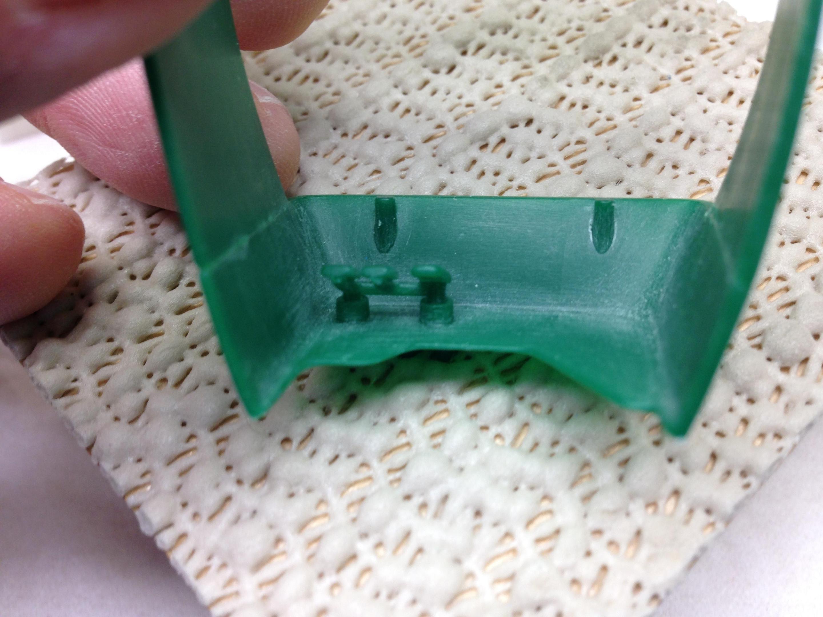

Joe Nunes Posted December 16, 2022 Author Posted December 16, 2022 I filed the metal bezel pieces down to the plastic surface on the back of the dashboard and applied some glue to those areas. While waiting for the glue to dry I decided to change the way the pedals hang on the model, which is straight down and vertical. A matching bevel was sanded on the pedal piece mounting locations and this will allow a more natural and better orientation for the pedals when viewed on the finished model. Will probably separate the gas pedal from the unit for a better look, too. Now I can add a heel rest to the bottom of the gas pedal, get the pedals painted and then glue on the "shiny plates" which were made beforehand. Joe 2
