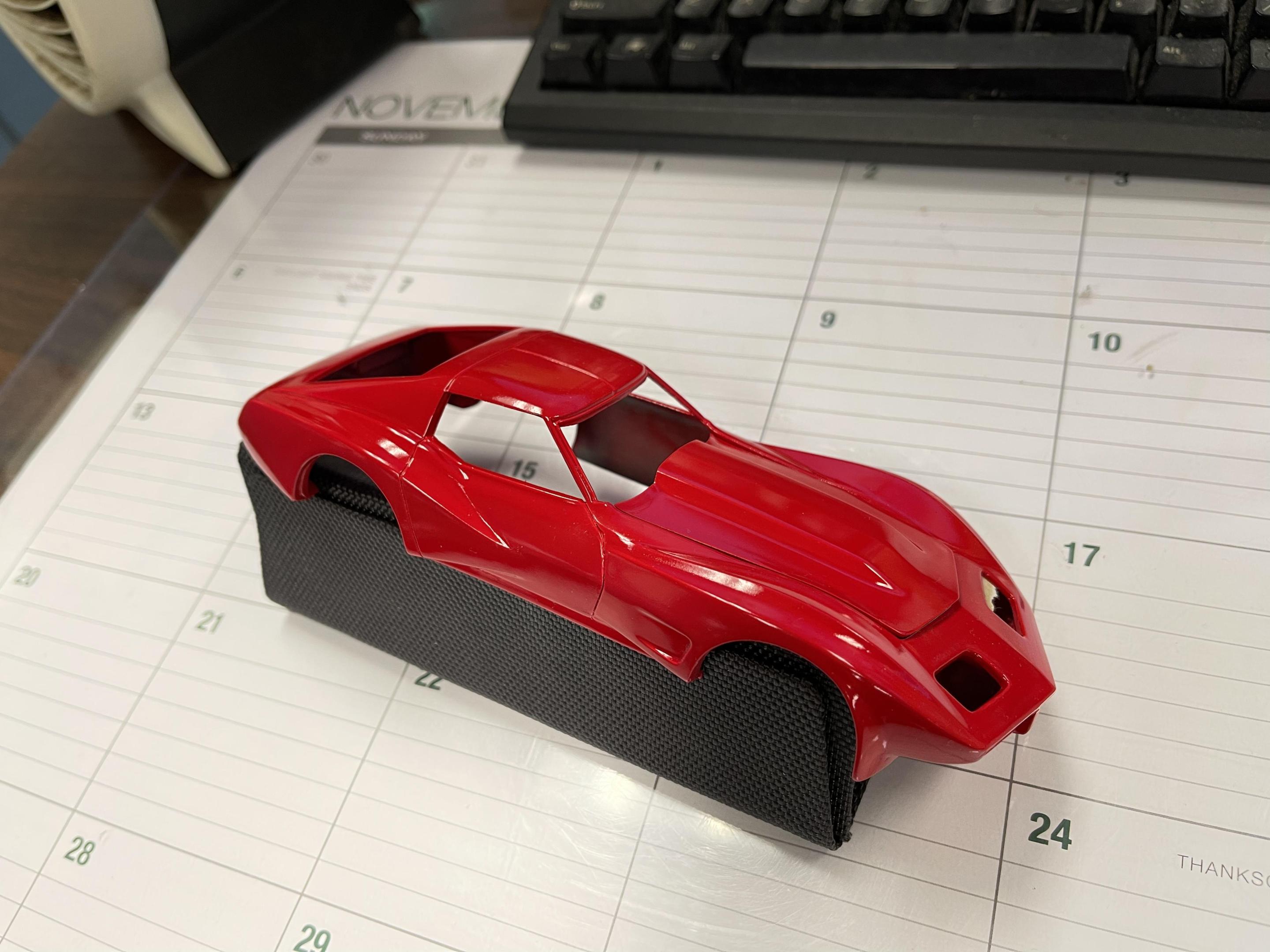

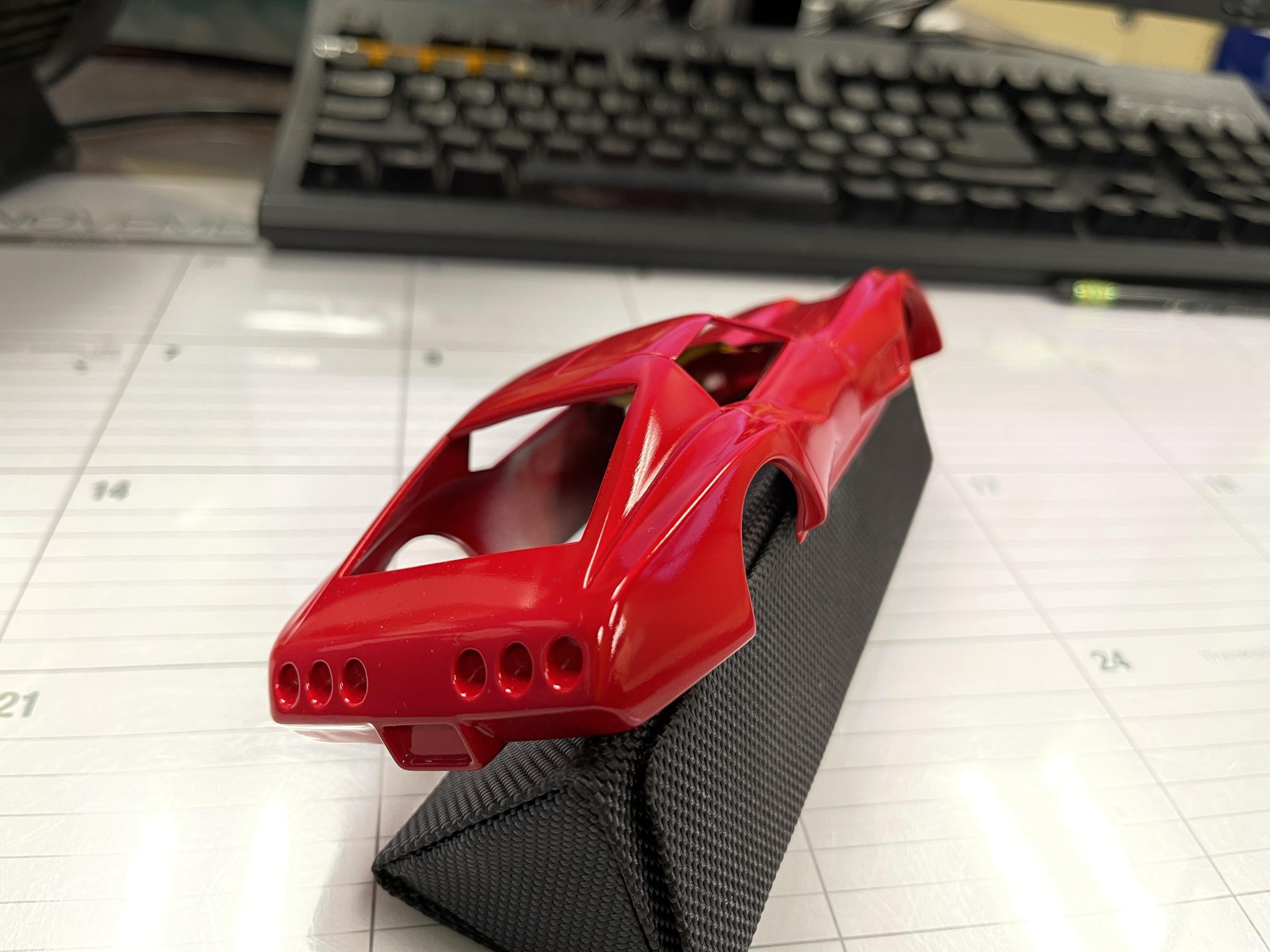

87C03584-561A-4FCC-8591-2284509C75DC.jpeg.ec4b0dd26aff593eaf3945a8414a6e9b.jpegStarted over 25 years ago, as evidenced by the squadron green putty. (I haven’t use that stuff, since at least that long ago!) If it hasn’t cracked by now, I guess it won’t! One was molded in red plastic and the other in white. So it was a no-brainer to do the candy cane car using the red plastic model. I finished up the bodywork and put the car in primer. A couple little tweaks here and there, and it was ready for paint.

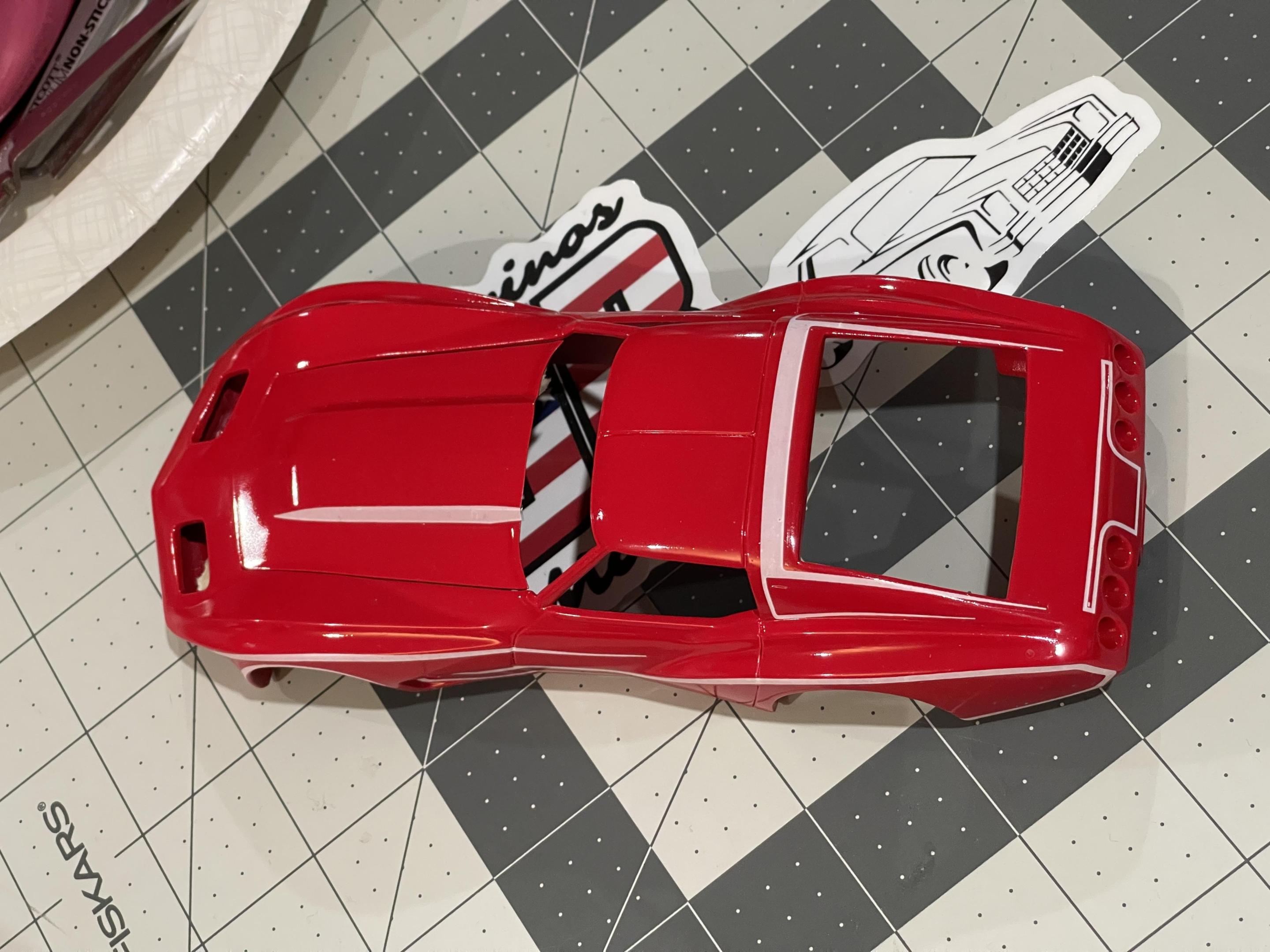

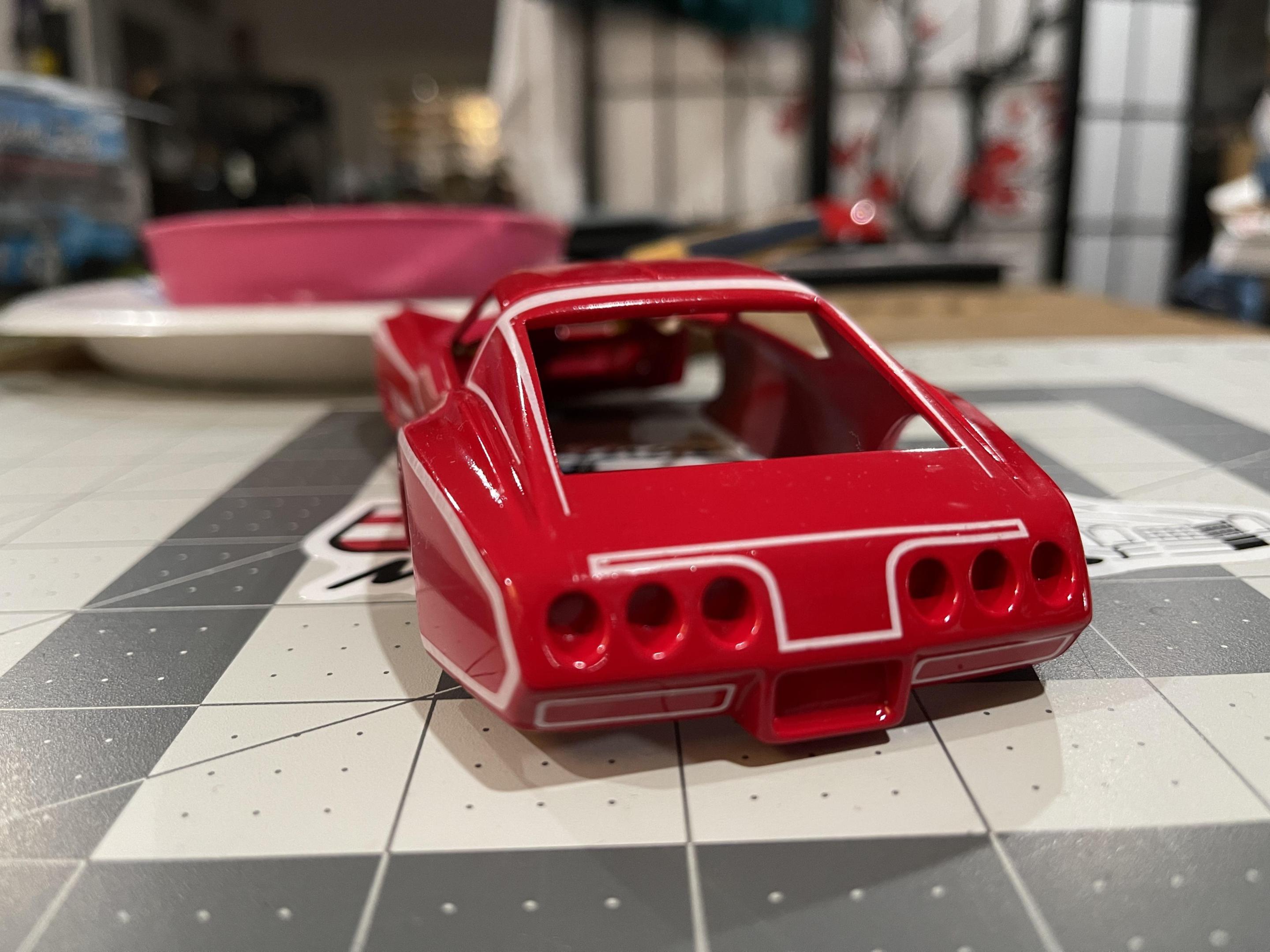

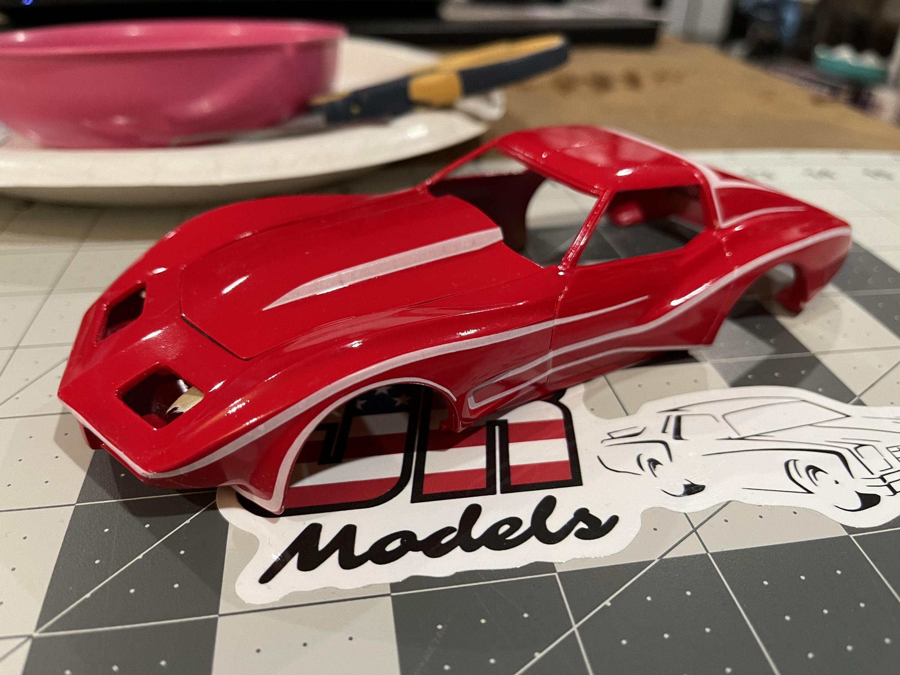

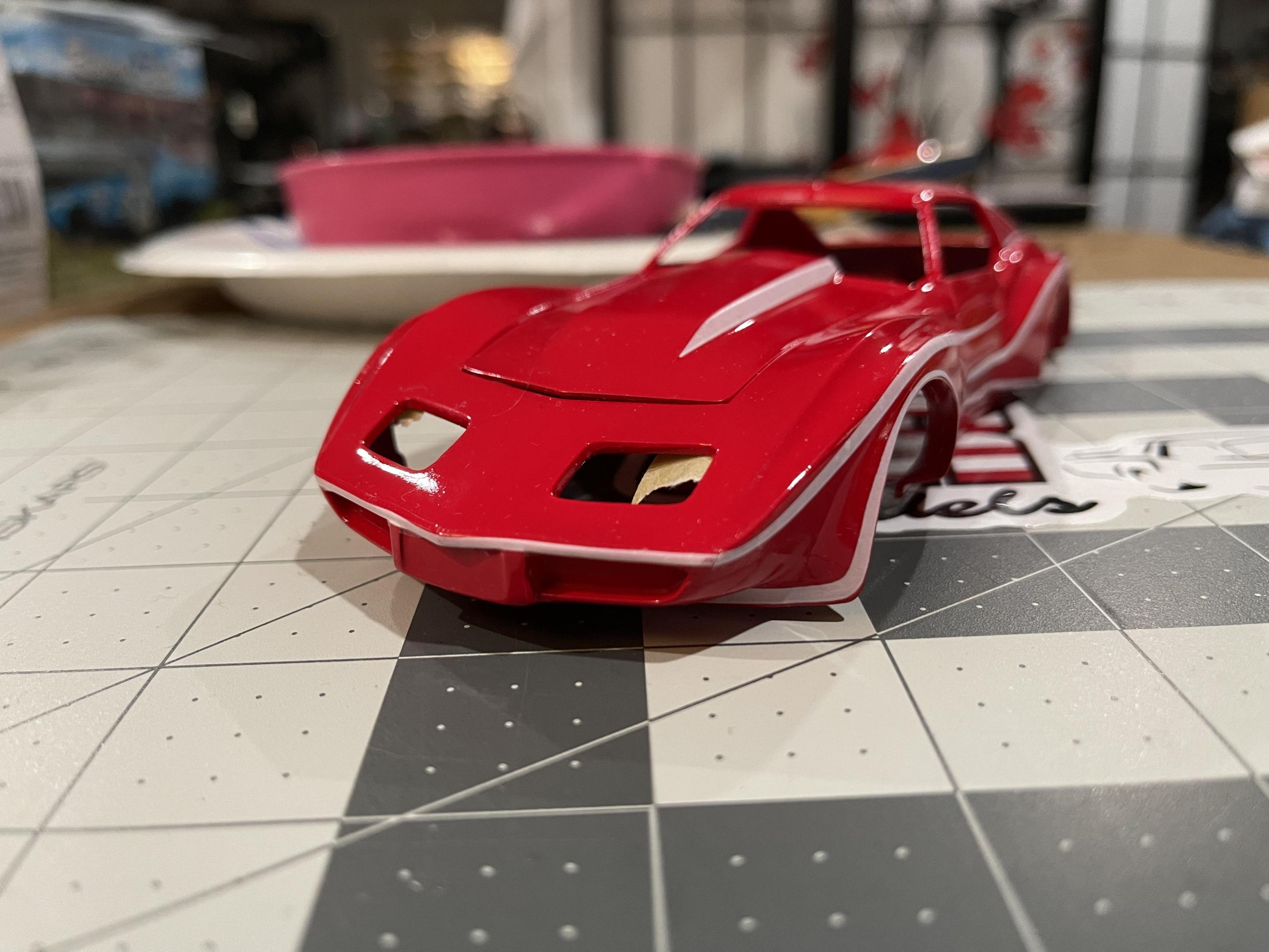

3ACC088D-8E13-42B0-94CB-EFC1795AB21D.thumb.jpeg.bfb1168a8e7ffcdc844dd97c7be35048.jpeg928B220F-683F-432B-882C-ADEDE3237ABD.thumb.jpeg.599f6d0ba1d8dd92842e4c549cd5823b.jpegI decided to use Tamiya Italian red on this car. Since Joel was always fascinated with Italian style sports cars, I figured it was a good choice. The plan was to draw the decals in my artwork program and print them out with my special ghost printer cartridge. It’s a white toner, LaserJet cartridge, that you have to fool the printer into thinking you’re printing black. Works pretty well!
1A8FD564-BDE9-4A91-84EB-1C28DA7ED5FC.thumb.jpeg.f9ce53b3da77166f0be25a4d87438ccd.jpeg97956A8D-9948-4443-90C9-252C56428EF1.thumb.jpeg.7990d1014f3007b3eaa4f6e375bf3454.jpeg1340D555-A623-43D7-8FD9-605E1BFA2EF7.thumb.jpeg.971396638efc07638f6be950cc2bb2fc.jpeg

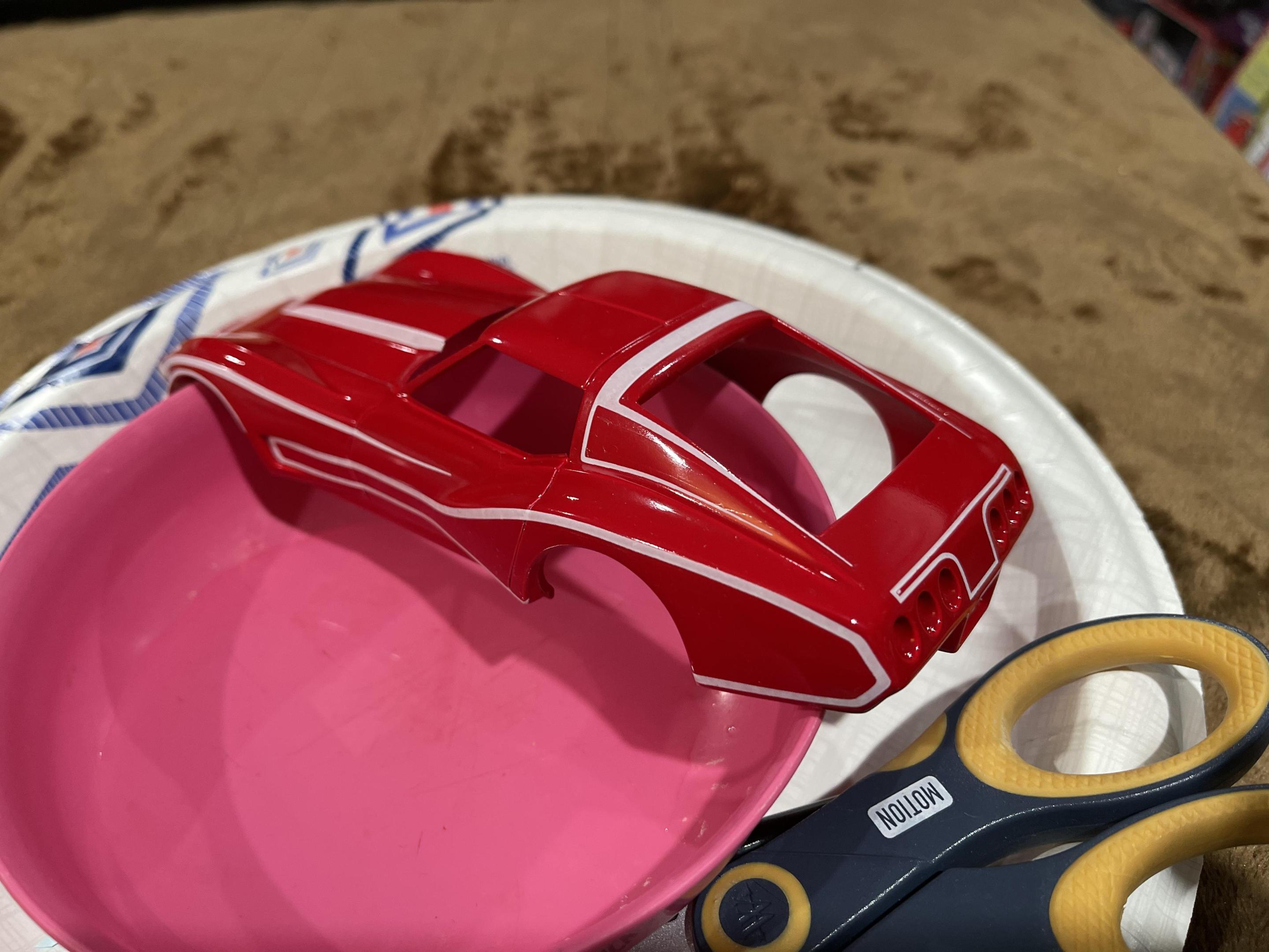

I had a couple rolls of automotive pinstripe hanging around and thought I might give that a try. Cutting it to the correct widths and getting it on the car wasn’t too much trouble. But in the end, they did not look right. They kept popping up in corners and you could see the scale thickness was out of whack. So I carefully peeled it all off and set about my original plan, drawing the decals.
732ED1B2-9923-4DAD-B9FC-BB67314B419C.thumb.jpeg.79e5a09ba842a39d5d4edc4b2d6a5383.jpegA5E74FC3-9474-4D22-A930-507AB3131B7F.thumb.jpeg.0ca9905e1d67c2939274f0c0b9ae9393.jpegC39DDC3D-3D1E-4300-8BDA-98228FD8B199.thumb.jpeg.a17d347408bfaacb005ab4c92376f563.jpegAfter a couple test prints on standard paper, I was where I wanted to be. I ran the Decal film through the printer and was on to Decal application. Some of the decals are quite delicate, especially about the back window. That was put on in one piece. I didn’t want any seams between any of the decals. I did, however, end up with three seams on the car. I’m happy with the way. It turned out this time around.

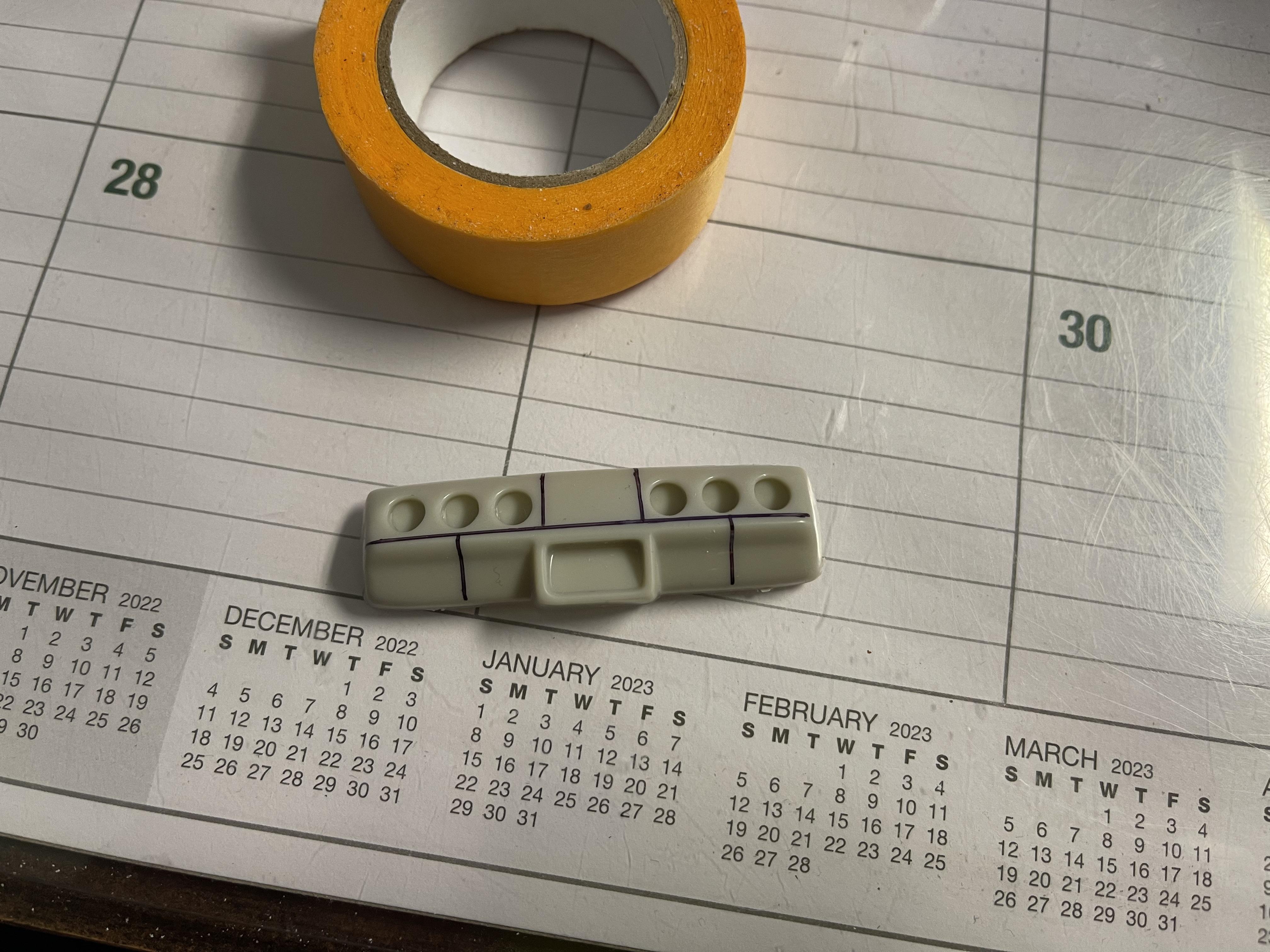

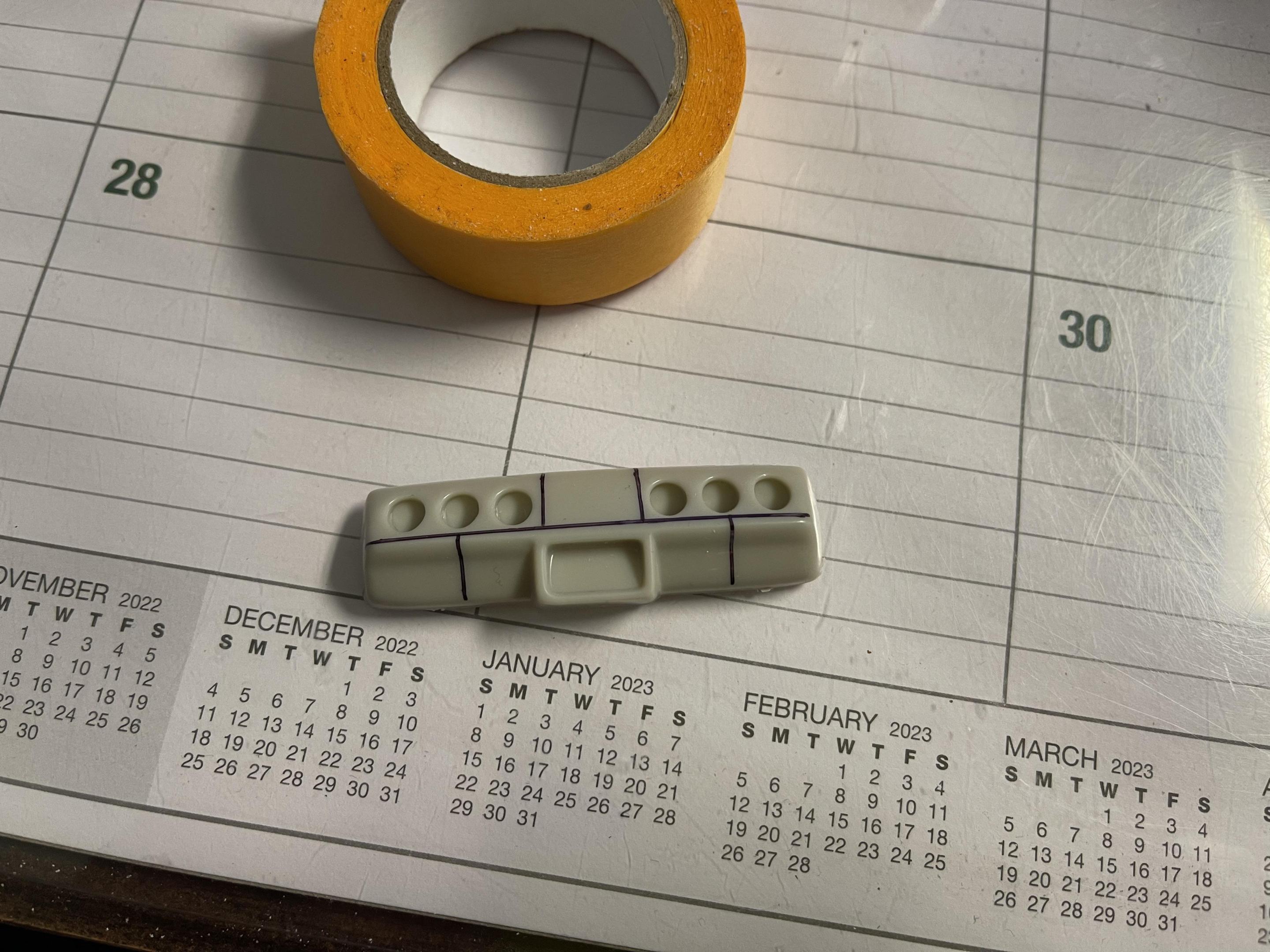

Bouncing back and forth between the red car and yellow car, I noticed something about these Motion cars that I hadn’t noticed 30 years ago. These Motion cars are a bit wider than the Eckler cars. The inner most taillights are not that close to the license plate cut out. And the hatchback opening is over the middle taillights.?ABF130CE-1415-44F5-9C3C-2C2311158787.jpeg.ed6be6ca2bb602873affc79d7c20ff42.jpeg
I marked off my cut lines on the bumper cover.

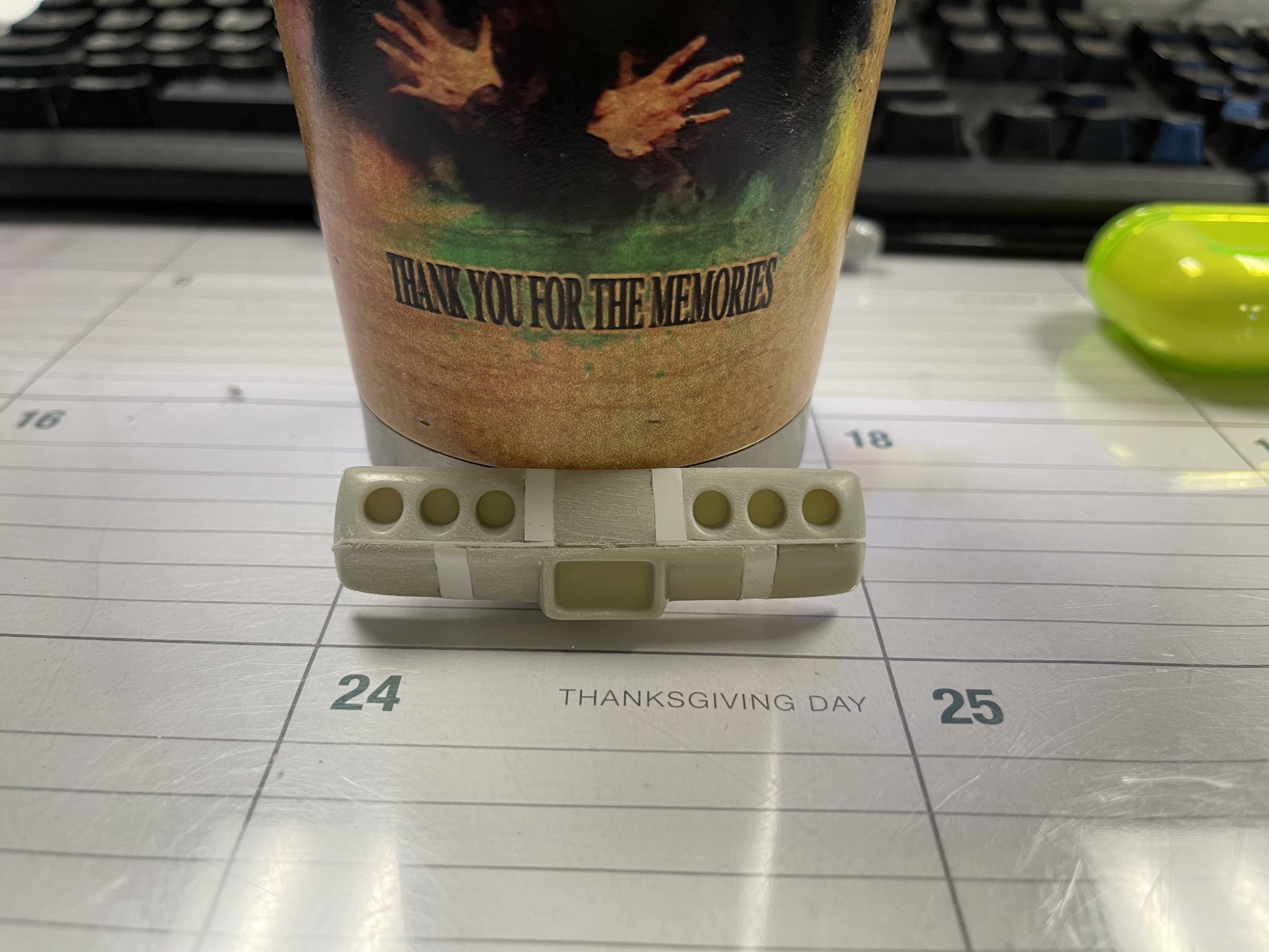

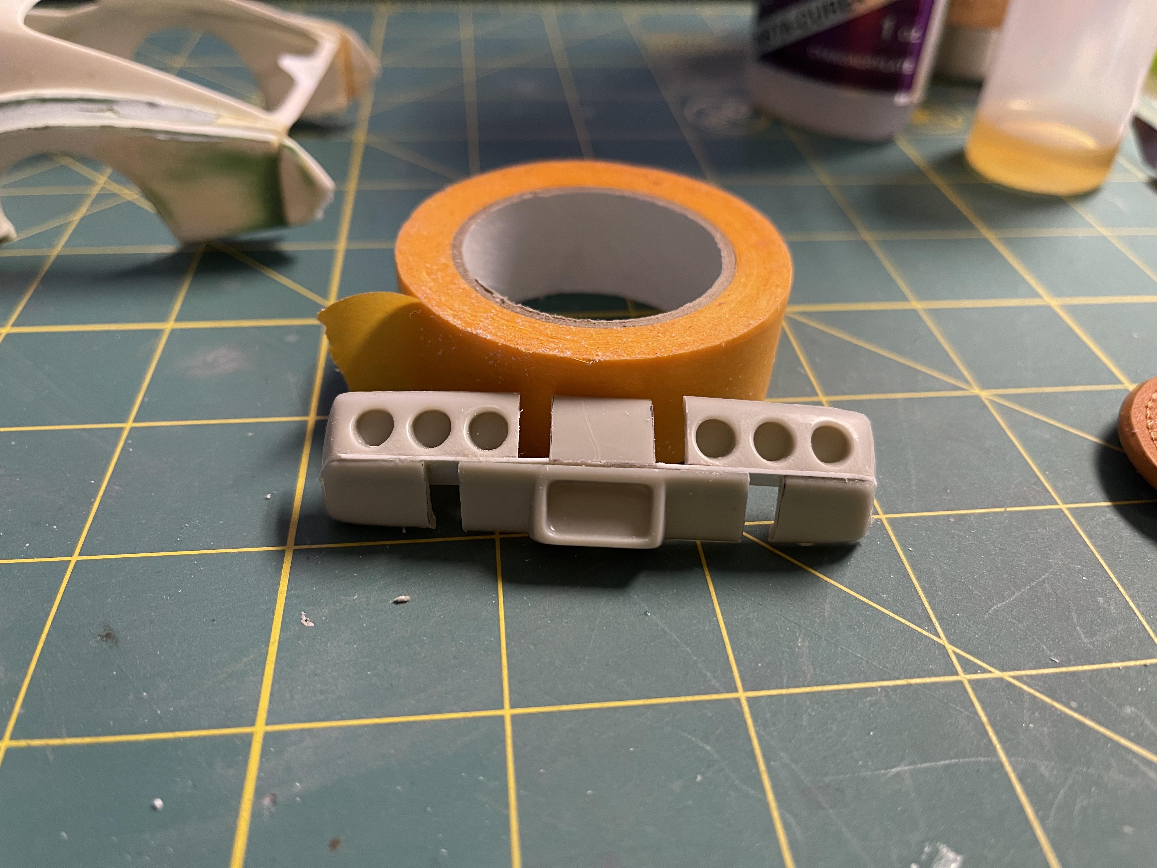

And then I started piecing it back together, spacing everything out and adding an extra quarter inch.
The hatchback opening is not going to line up exactly where it should with the tail lights, but the extra width does help bring the widebody fenders out enough to almost go straight back. There’s still a slight hourglass back in towards the bumper cover, just not as dramatic as it was out of the box.
I hope to do some test fitting tomorrow.
