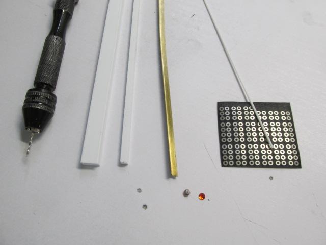

Ian McLaren Posted May 26, 2023 Author Posted May 26, 2023 I had a couple of questions asked about what went into this panel, so to answer the questions here are the materials and the process Main body .200 x .300 Evergreen retangular tube (this is for 1/12th scale)grind off one of the narrow sides to give you a U channel, sand to required depth to fit chassis tube. Panel ends .125 square evergreen rod glue a short section at each end to cloes the ends of the panel. The switches are .030 for the handles ( a little over scale but look OK) and .080 dia x .040 hole photo etch washers. I used a brass L channel as a guide to drill the switch holes in a straight line, then paint the panel the color you want it, I chose Tamiya semi gloss black. Cut short but over length sections of the .030 rod and glue them in the holes don't worry how long they are as long as the shortest one is longer than you want the handles to be. Slide the washers over the handles ( I chose to do it before I installed the handle and used a drop of CA to secure both). At this point you can cut all of the handles to the desired lenght and carefully paint them with your favorite silver/chrome paint. The pilot lights are up to you, mine are from one of my wifes Diamond painting kits, but gems like these are available in most craft stores of model raillroad shop. Some are flat mount like these but most will require a mounting hole being drilled (very shallow) The yellow and red stripes are from a left over 1/72 scale aircraft weapons set. and the harness is just a piece of black wire that looked like the correct size. 1

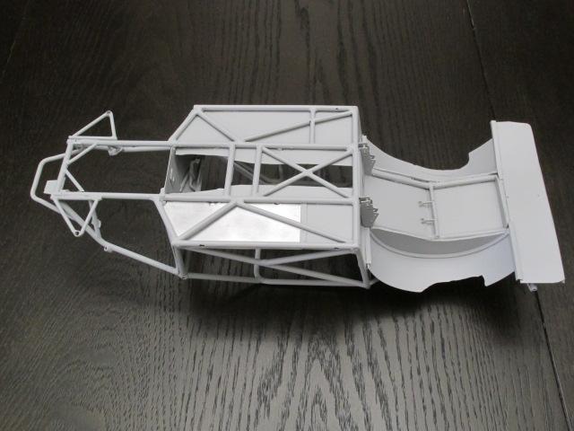

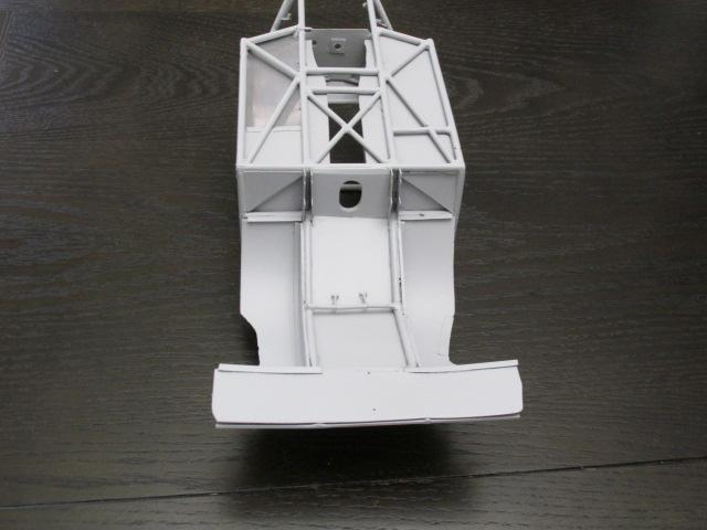

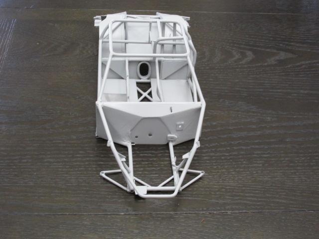

Ian McLaren Posted May 27, 2023 Author Posted May 27, 2023 Big step today the chassis is in primer, not perfect but the repair are all minor. 2

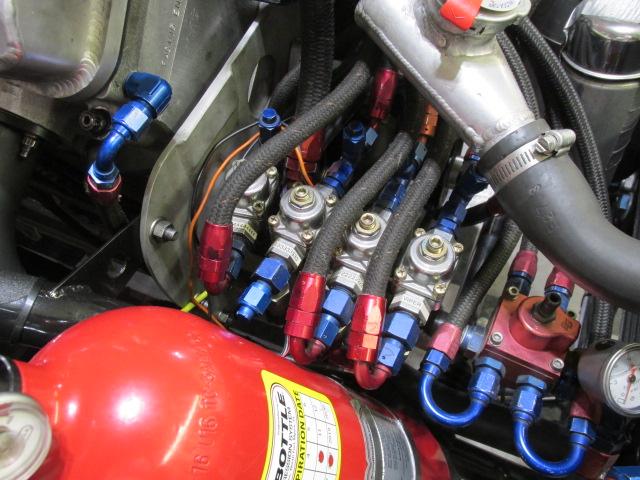

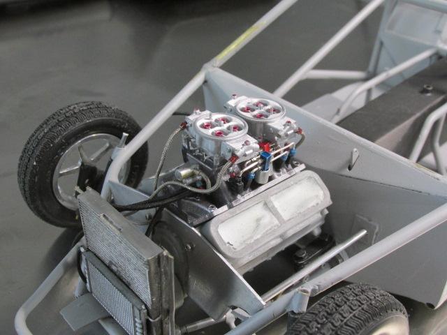

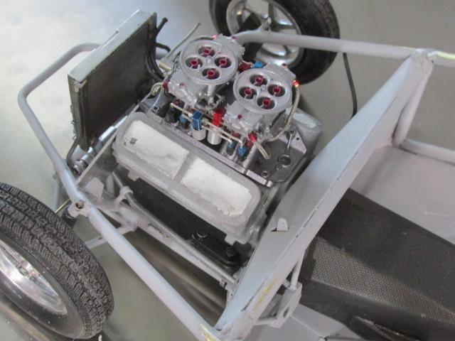

Ian McLaren Posted June 9, 2023 Author Posted June 9, 2023 1/12 scale LHP1320 BBC long block and 1050 Dominator carbs. Wilson style intake manifold with 2 added nitrous systems, fogger nozzels in the runners and a Viper Style stage in pleuium system (two solidoids on the front face). Starting to plumb the engine with nitrous and fuel lines, easy stuff done now it's the regulators and fuel blocks from the pump as shown in the photo of the real deal. 3

Ian McLaren Posted June 9, 2023 Author Posted June 9, 2023 Drilling holes and bolting bits in, starting to get a bit tight in here. still the pan evac system and dry sump pieces to install 1
