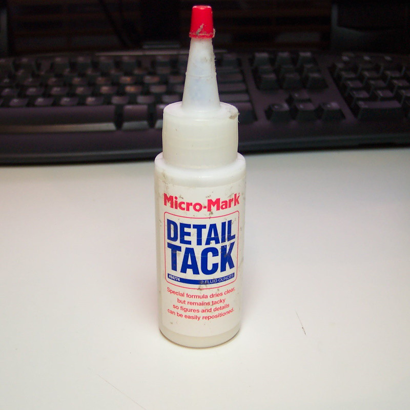

You will get a dozen different ideas so here's mine . I use Detail Tack from Micro Mark , probably the same as Tacky Glue at Michael's . A small dab using a toothpick on your painted surface , let it dry , then place the light or mirror in place . . . done .  Some will worry about it drying out over time but I have models on my shelf 10 years old and the mirrors are still there . If you are concerned apply Tacky Glue to both surfaces  , it works like contact cement and will create a very strong bond but can still be carefully removed if needed . This bottle is 10 years old , it lasts a loooong time .
Detail Tack

@TooOld  Hmmmm.  Tacky Glue.  I have some of that, I'll give it a try.
@Ace-Garageguy  Yeah, I thought about pinning.  I might try a combination of both:  Pinning the bigger stuff (muffler brackets, luberfiner) and using tacky glue on the smaller stuff.
