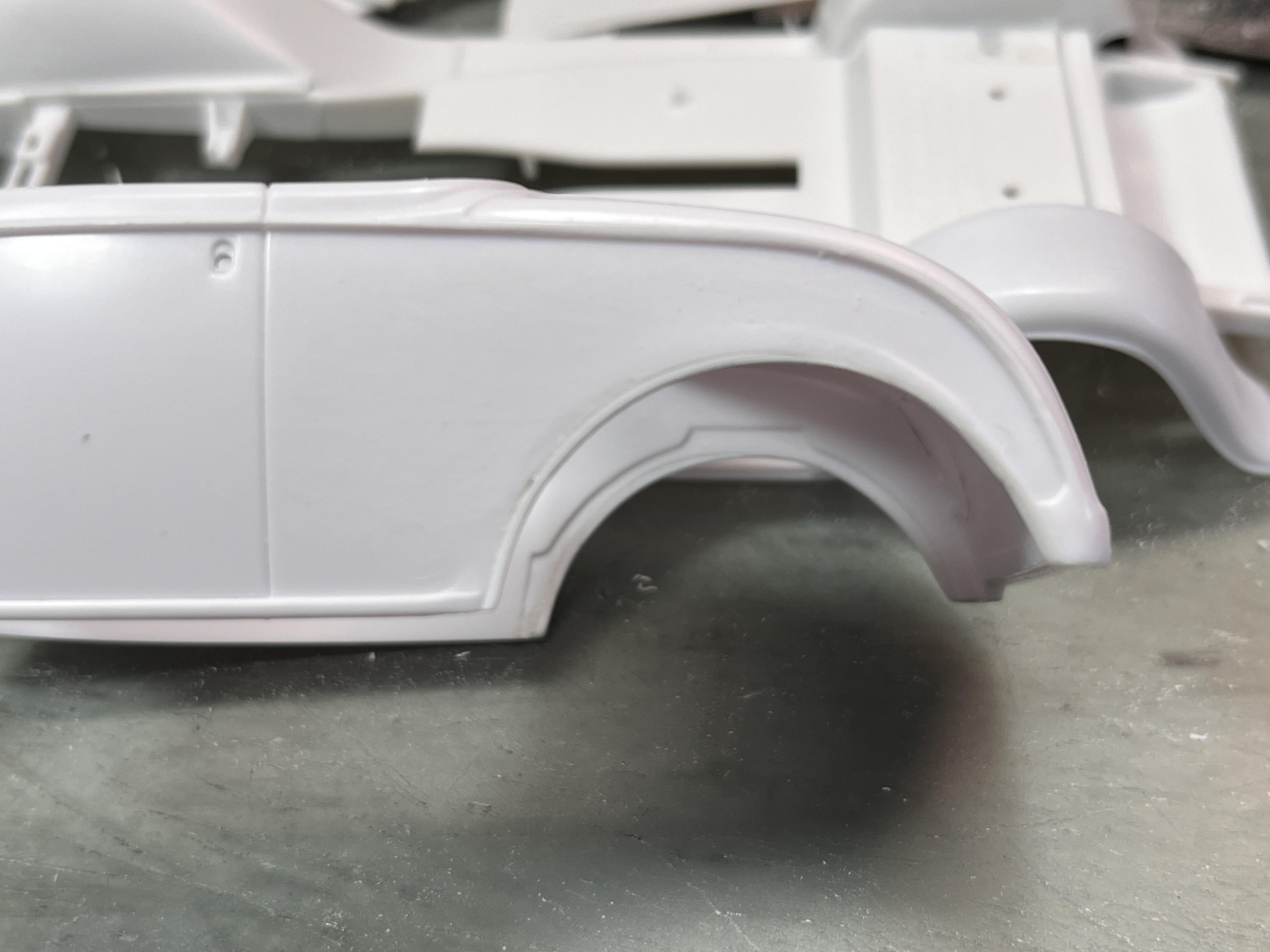

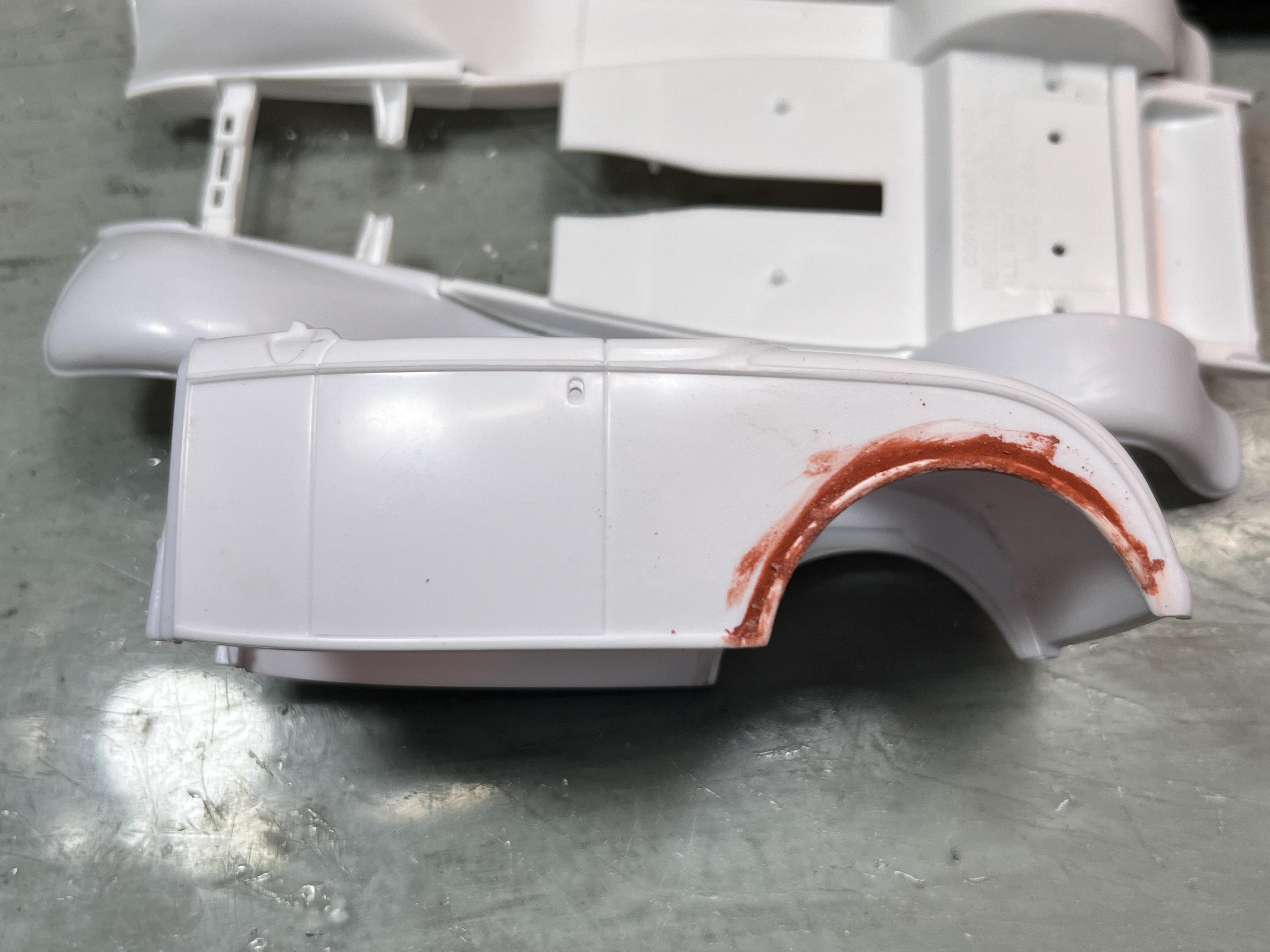

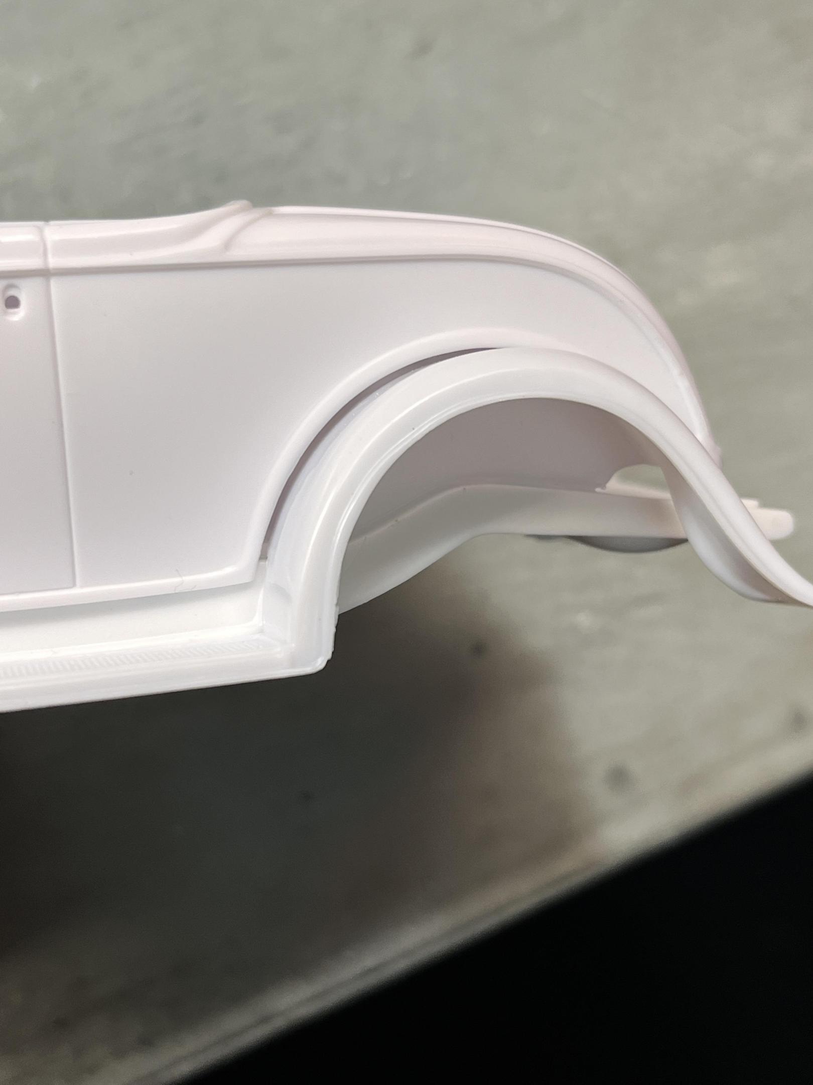

Lining everything up showed a gap between the body and the fenders. This was not even across the whole arc, just in the front. The little strip of plastic inside the wheel well on the body was cut off first (if you look at a body, you'll know what I mean).....
2118702756_kjnjnjn.thumb.jpg.f74ec2f967e083d86d99143641d81e86.jpg I sanded, scraped, filed etc. off the bead around the opening on the body and then added a strip of 0.040" Evergreen around the opening. This was carefully sanded down to close the gap. Much test fitting and massaging ensued... (sorry for the slightly out of focus pic)...

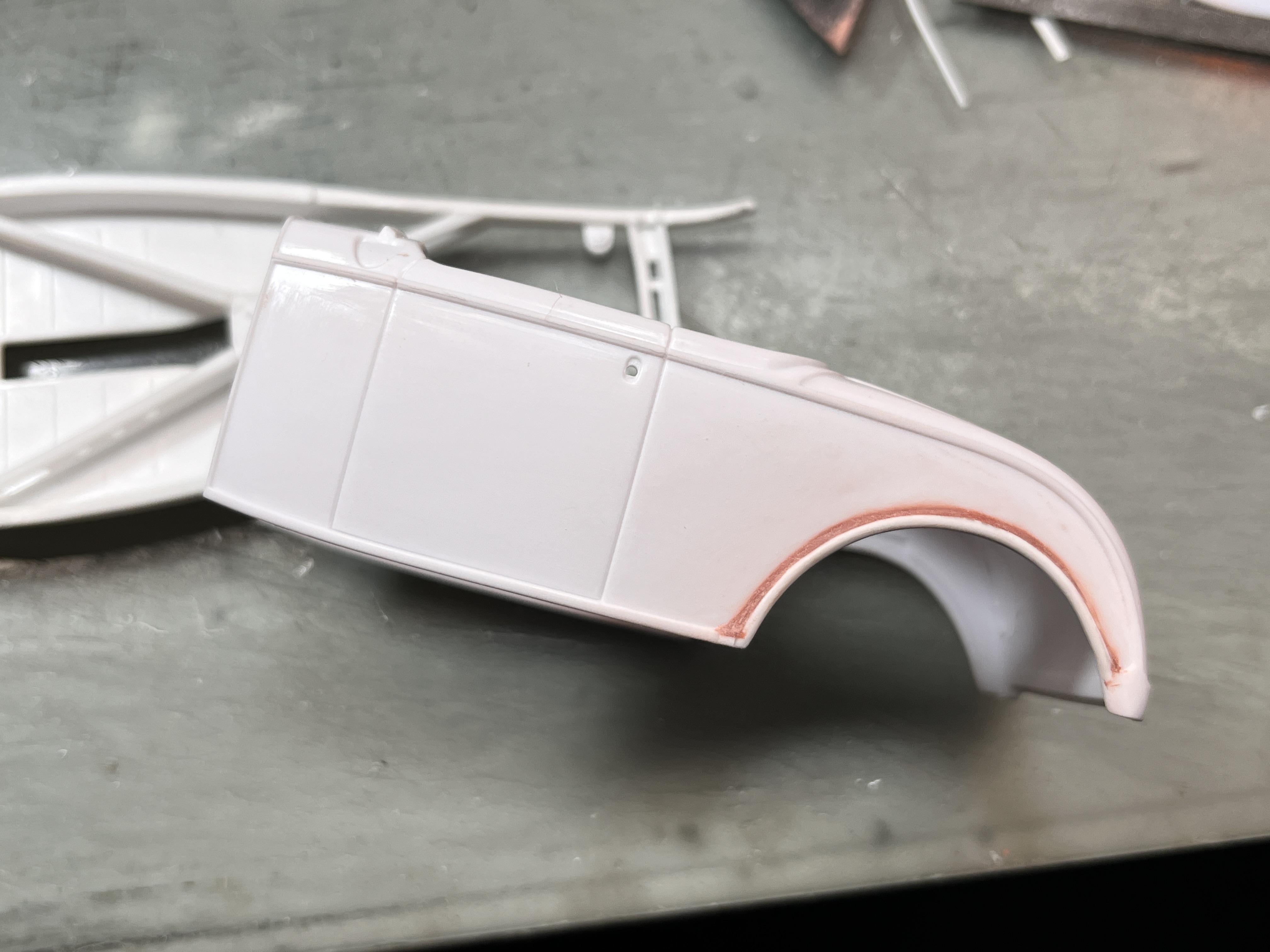

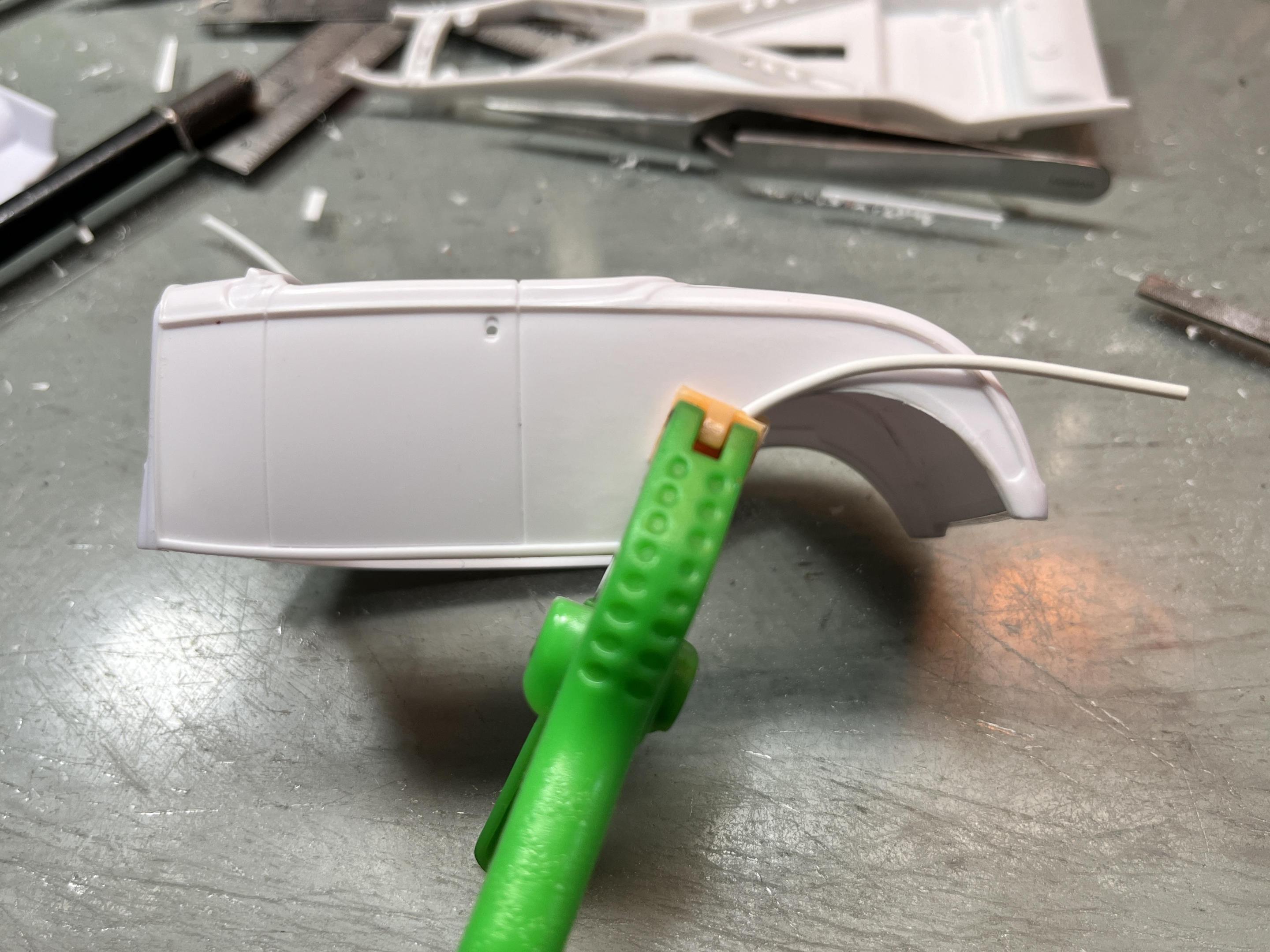

Next, I glued on a strip of Evergreen half round. It helped to preform the half round a bit by stretching it to form a bit of an arc.......
I then sanded the half-round down to bring it in to the proper shape....

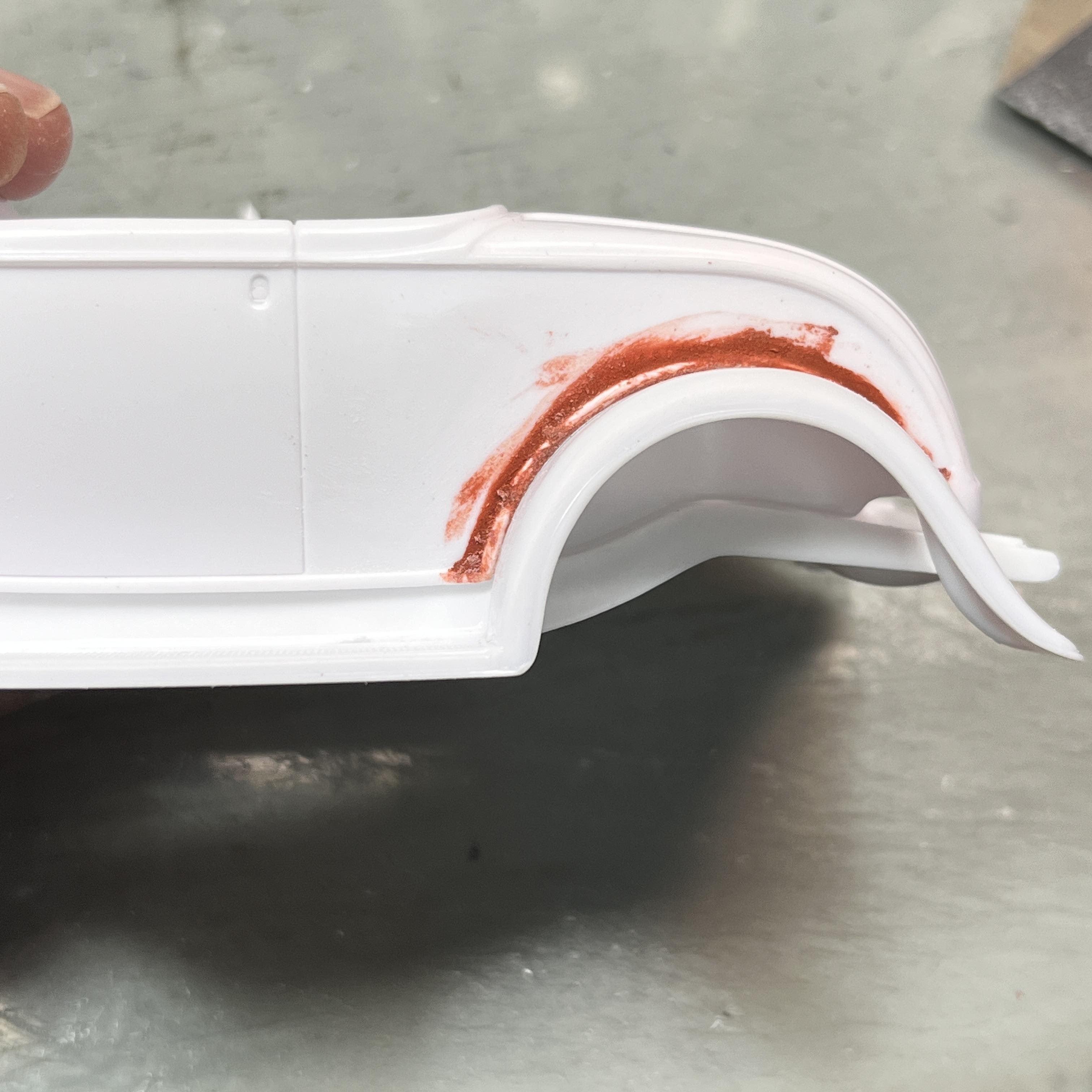

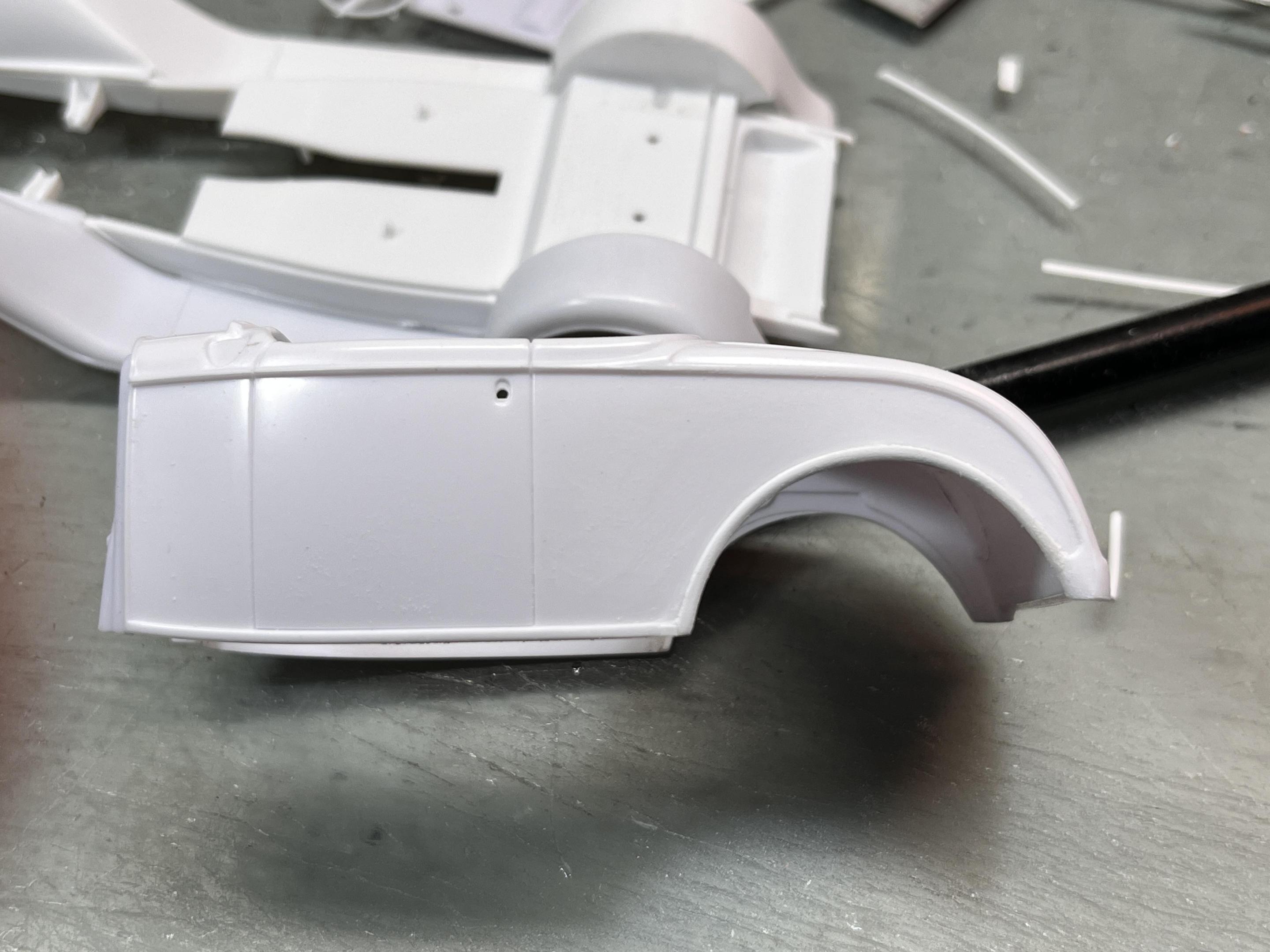

A schmear of putty, looks pretty good.....
Some work with 400 to 600 grit sandpaper, gets it here. I left a little extra putty, once I hit it with primer, this will be further sanded down and a few more coats of primer and additional sanding with progressively fine 'paper will dress up the area....

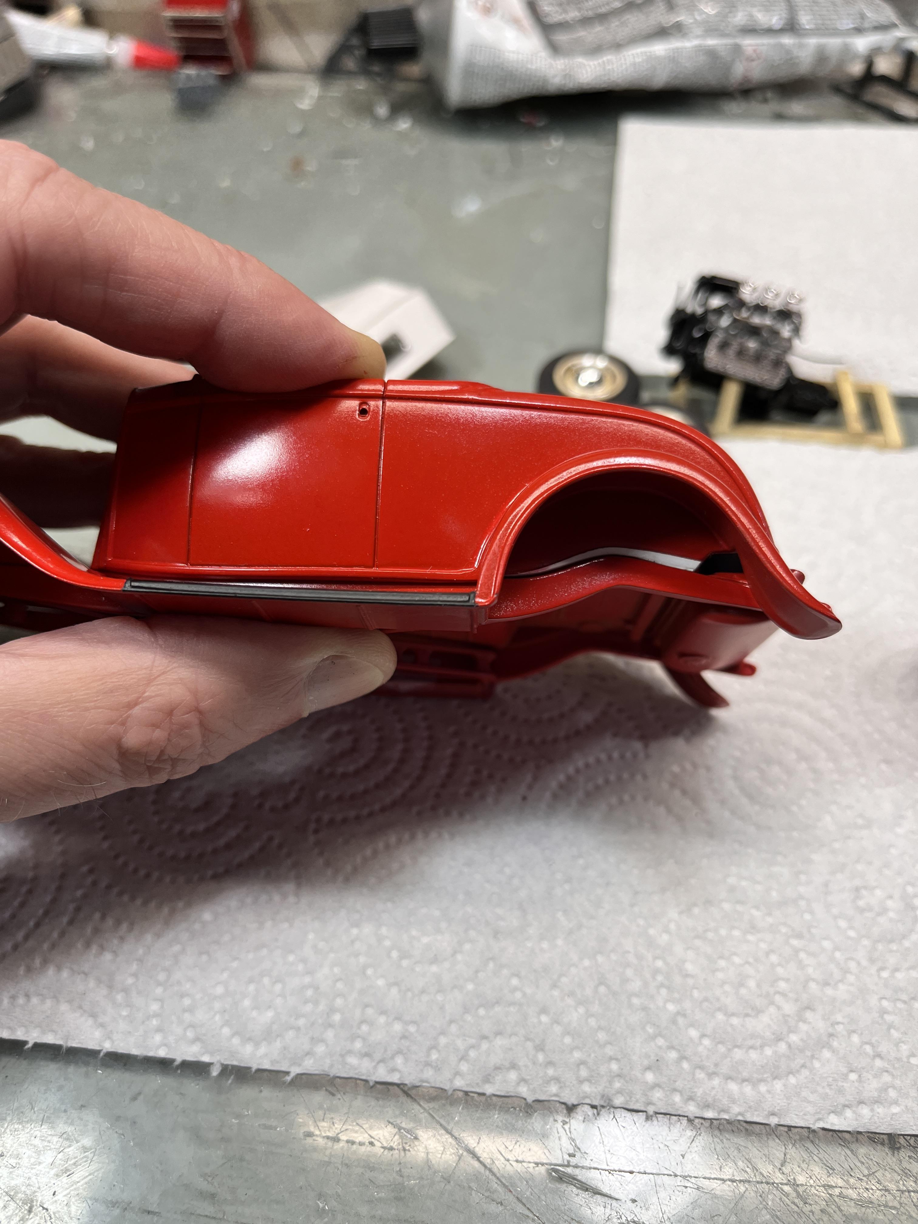

Well, it's been the better part of a year since I worked on this build. Once I got it painted, the fitment of the fenders to the body was leaving a gap. The driver side has more of a gap than the passenger side (?). I got frustrated with it and threw it in a box. New year, new opportunity. I started fitting and futzing around with this again yesterday...
sorry for that crappy pic....

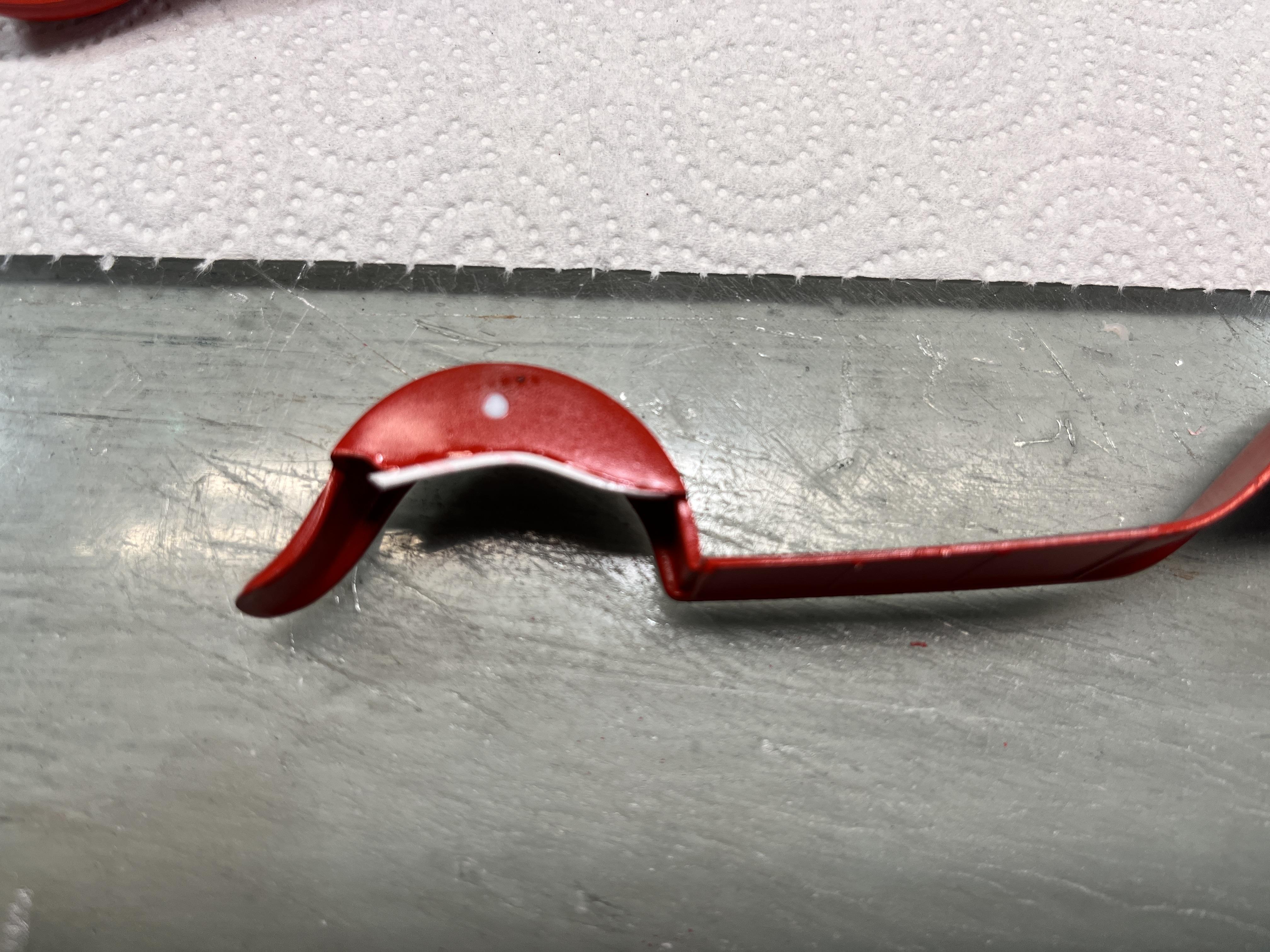

I glued on a wedge shaped piece to the the bottom of the fender where it meets the frame. This forces the fender up in to the body. I also carefully (since it's already painted) sanded down the fender opening on the body where the fitment was the worst. This seems to have fixed the problem. I did add a small strip on the passenger fender as well to snug it to the body. I painted up the white wedge with the Tamiya Pure Red. It will be hidden by the tire, so it won't be obvious...
