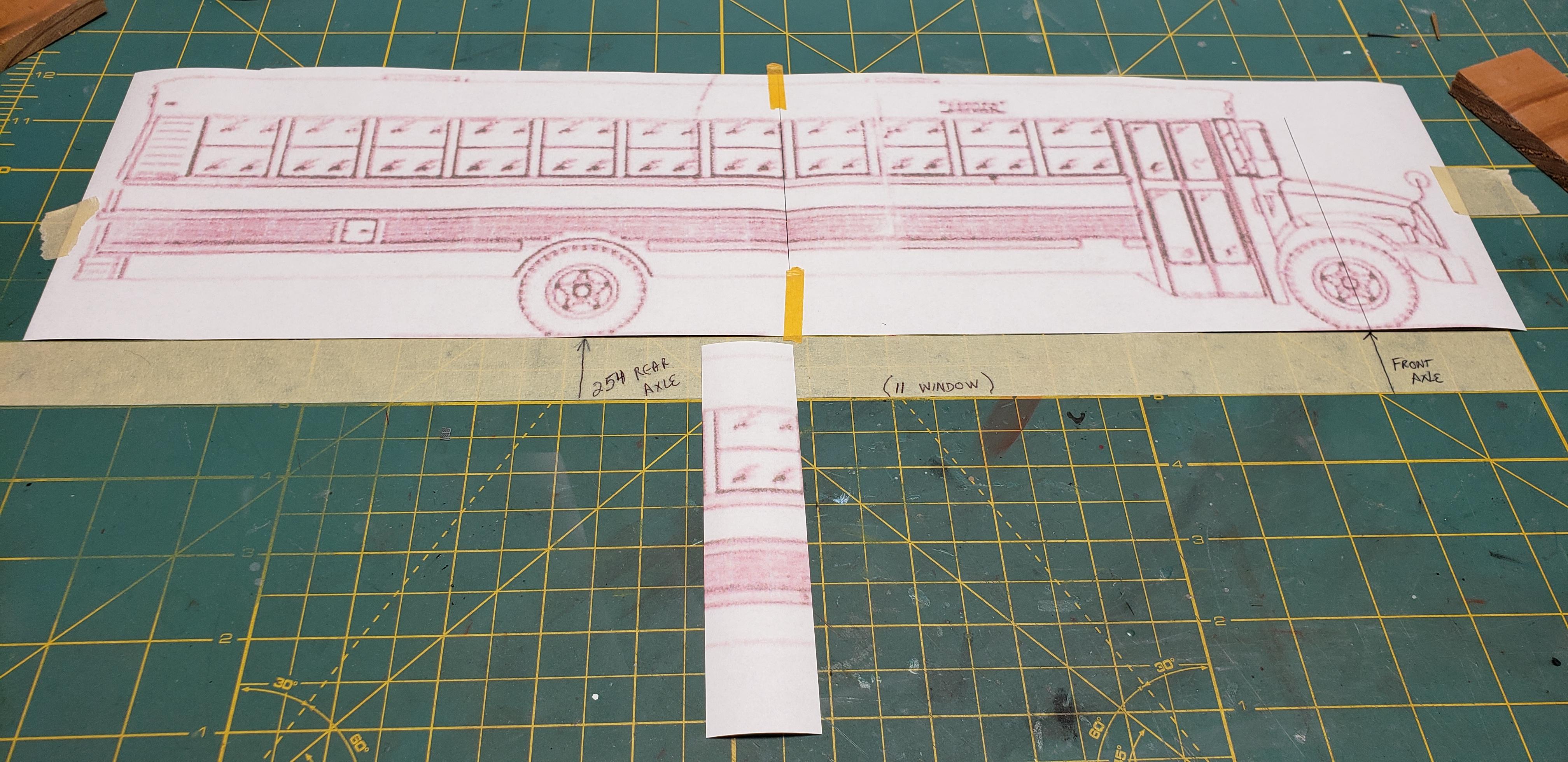

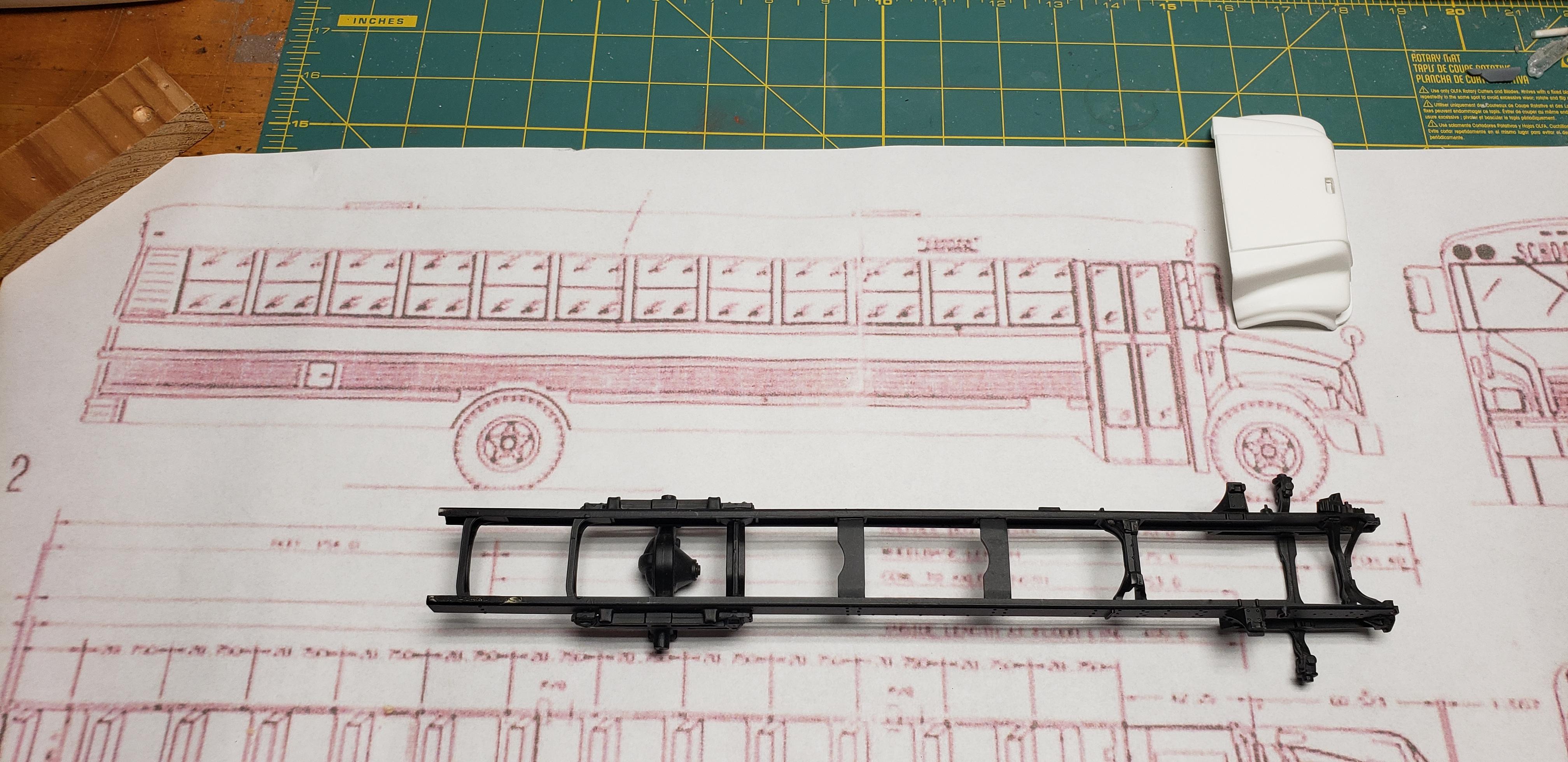

gotnitro? Posted January 7, 2023 Posted January 7, 2023 My next project has plenty of seats for everyone to ride along, I'm building a replica of my late father in laws school bus he drove till retirement. The bus will be based on a mid 90s International 3800, 11 window conventional bus. It will accommodate 65 passengers, or 22 seats. I scoured the web for photos, knowing this would be a daunting task. This is a similar bus to my intended build The 1st challenge was locating a proper hood. Luckily a short message to Daniel, owner of Plaskit, provided a correct hood. Its a conversion hood for the S- series truck, and right era I needed. I couldn't believe I was this lucky..but knew a mountain laid ahead. I wanted a set of plans for this build. Theres was plenty available as downloads, so off to Staples for enlargements. A couple tries at matching the copies to the rear tire I brought along, and I was rewarded w suitable drawings. The frame being used is a stretched chassis from the Ford Short Hauler. I unfortunately can't recall who I purchased it from, and apologize! The drawings showed a 12 window bus, so I removed one after a quick measurement. My wife's uncle worked for a bus garage, and was invaluable getting the info for this. The bus needed to have a 254 inch wheelbase, after removing the window it was perfect. 3

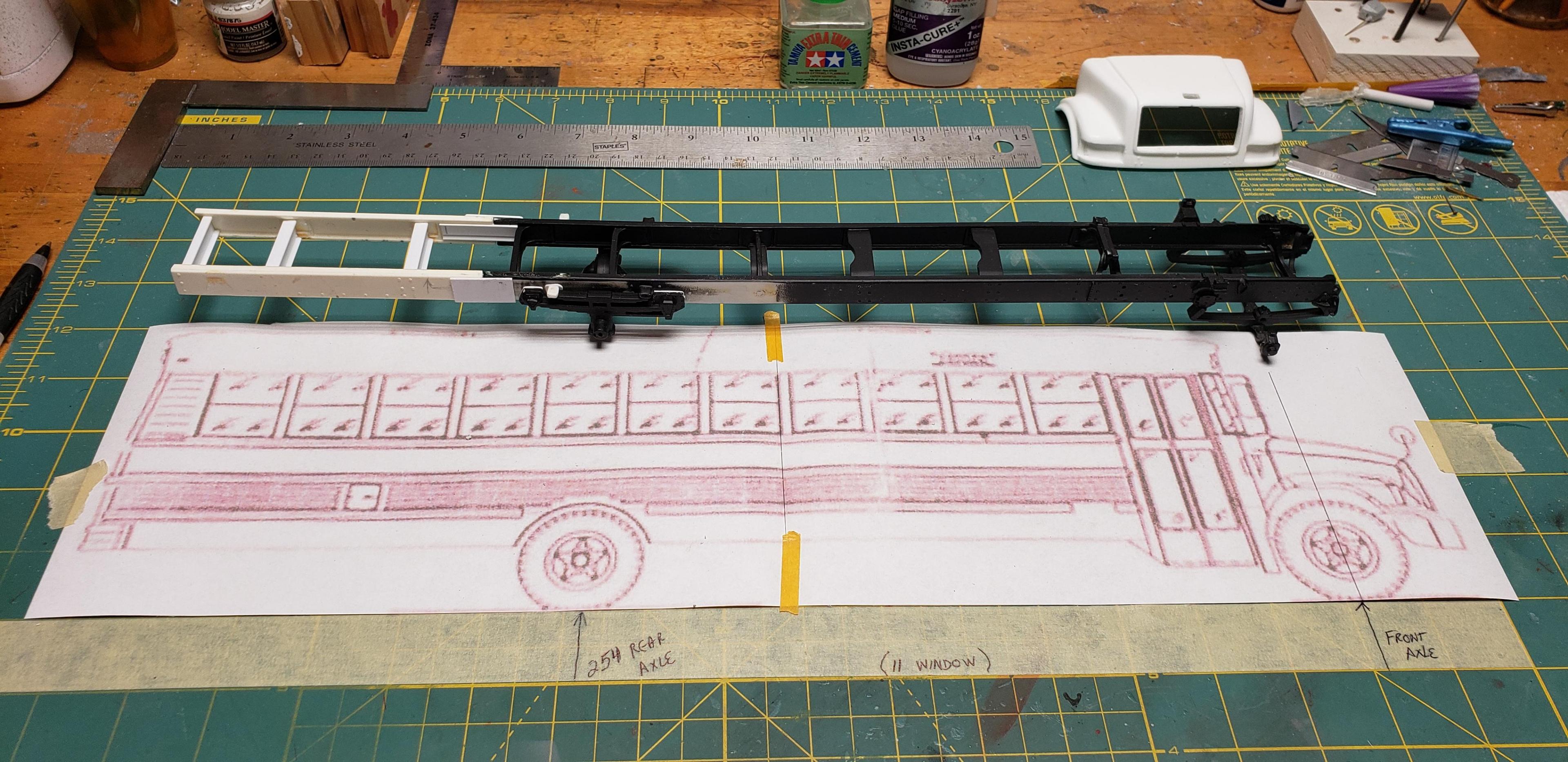

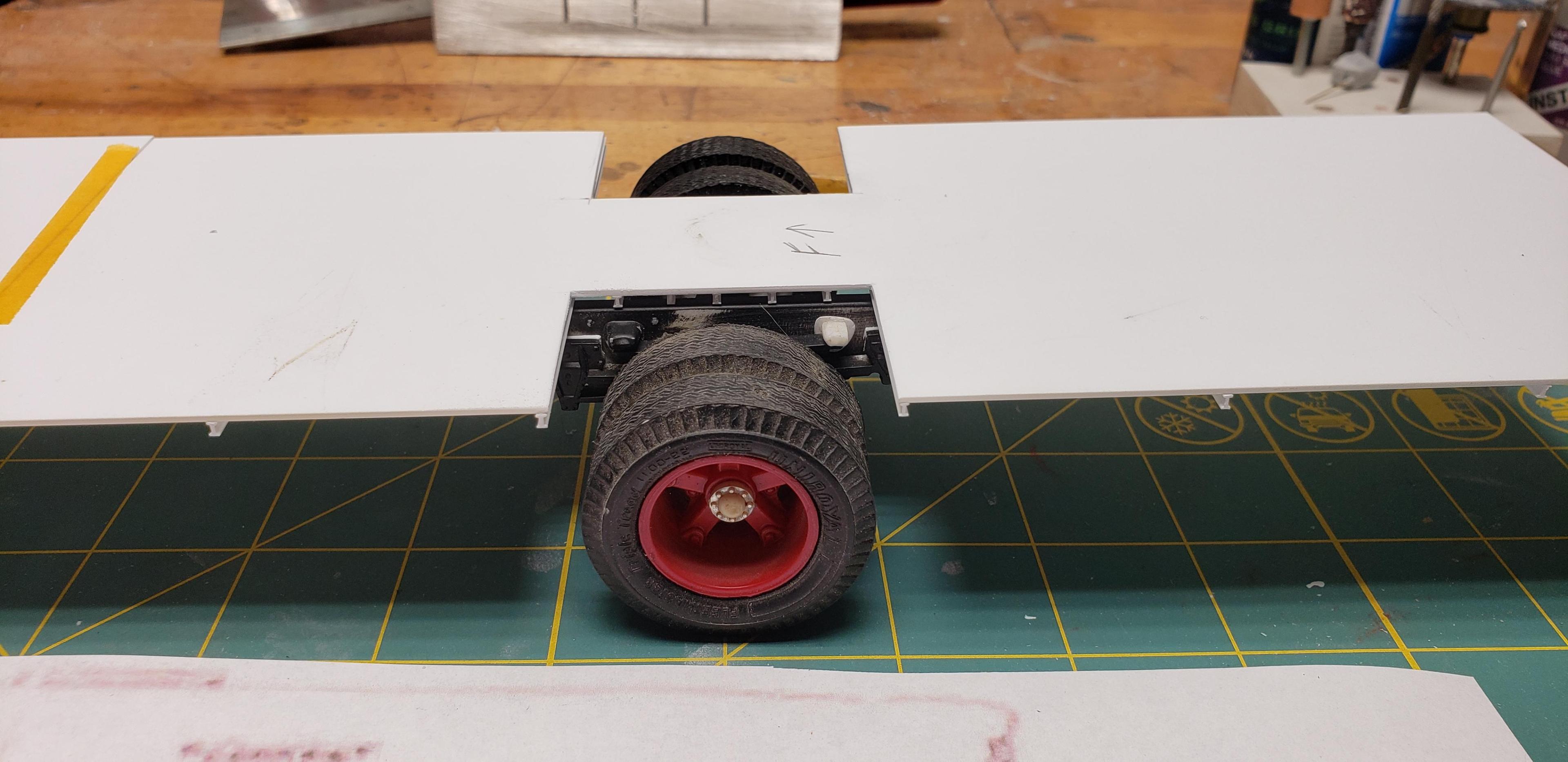

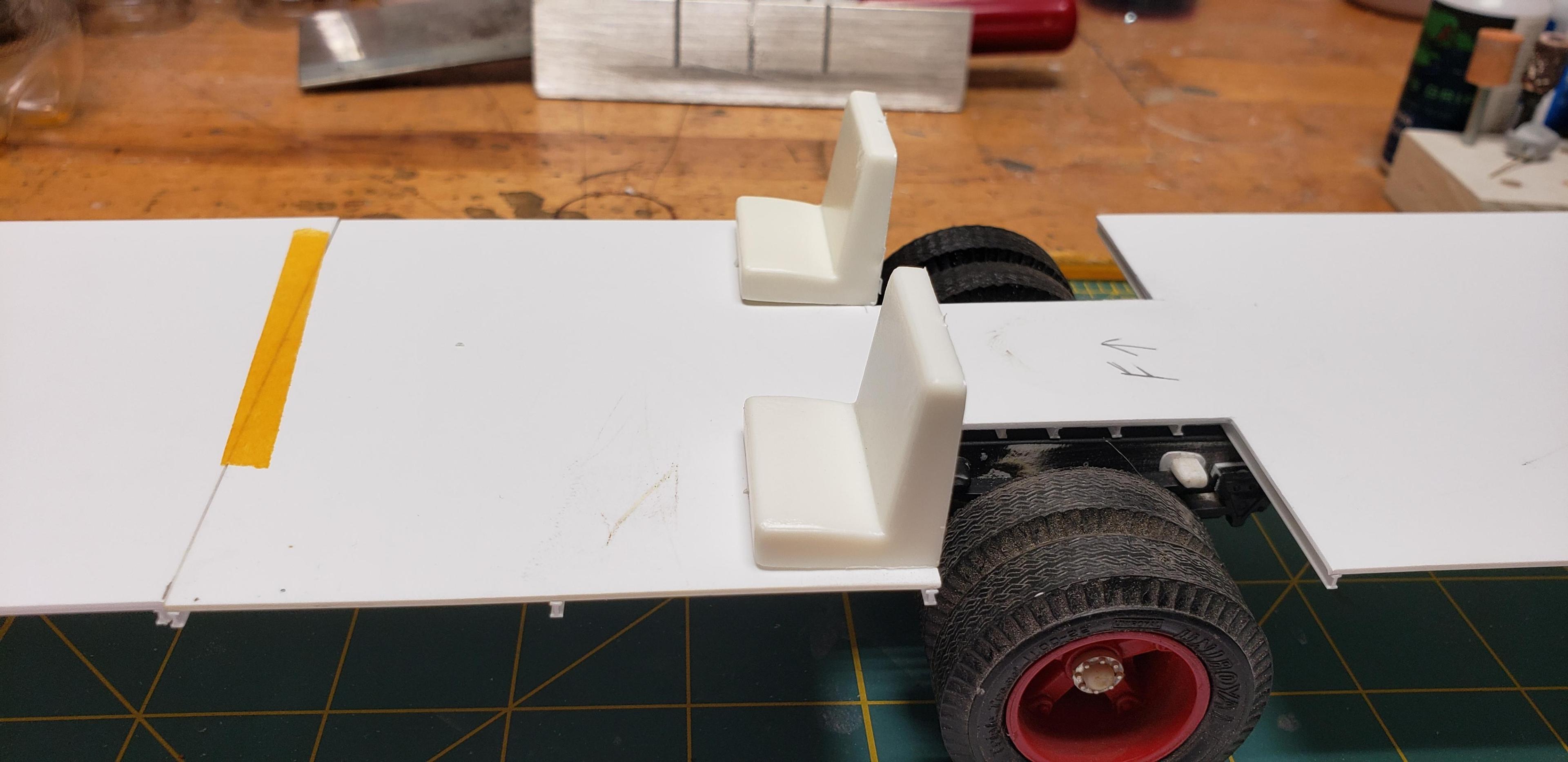

gotnitro? Posted January 7, 2023 Author Posted January 7, 2023 I stretched the frame an additional 4 1/2 inches , now its ready for a floor! A floor of 040 th sheet was laid down after notching the rear wheel openings. I used 2mm I beam for the floor supports, but need more. A few seats were mocked up and these didnt have any gum stuck underneath ! Jeff 2

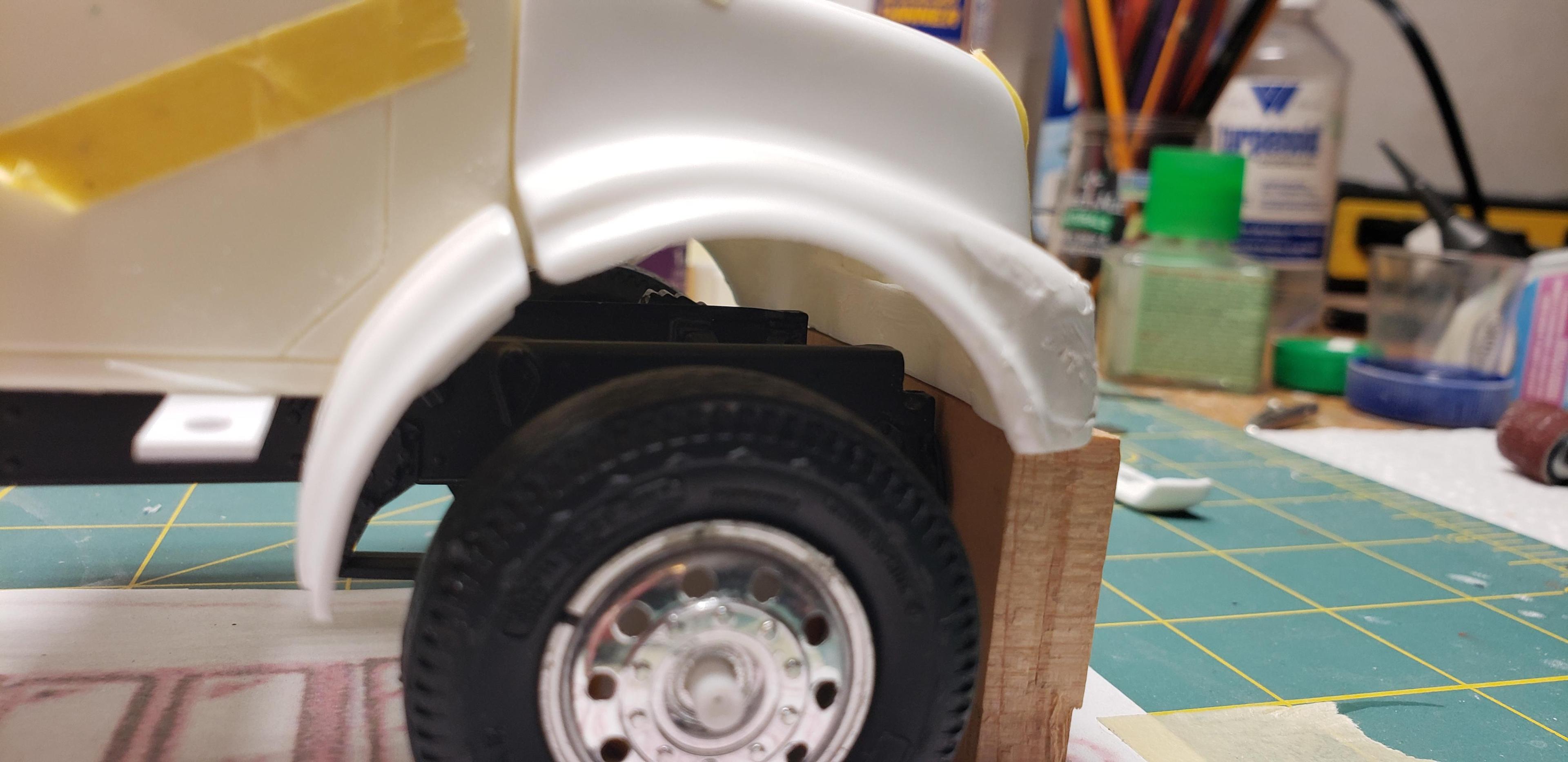

gotnitro? Posted January 9, 2023 Author Posted January 9, 2023 19 hours ago, leafsprings said: Great idea! Beyond my skills, but sure to learn a lot from this build. At one time somebody offered a resin DT466, would be perfect for this IH. I'd love to find a dt466 for this! I have the Ford V8 assembled from the short hauler kit, w the auto transmission if I can't locate one. @Warren D thanks ! I've been pouring over auction pages looking at profile photos.. I have the hood mocked up,, just sitting on blocks until I can fashion up the hinges. I found a clear photo of a hood open showing an angled frame rail. Ill Sawzall mine and attempt to hinge this. The cab being used will donate its cowl to the build, its a resin IH Daniel sent w the hood 1

gotnitro? Posted January 10, 2023 Author Posted January 10, 2023 @DRIPTROIT 71 Thanks for asking Brian! I'm sure I'll need photos along the way, will send ya a pm I have the V8 from the Louisville hanging around the bench I might try modifying into the 7.3. At least it has the auto transmission I need . I robbed hinges off a long ago built DR, fitting them into the frame rails and hood tonite. The biggest challenge is getting everything lined up now, to avoid a crooked body later. Thanks everyone for suggestions its greatly appreciated

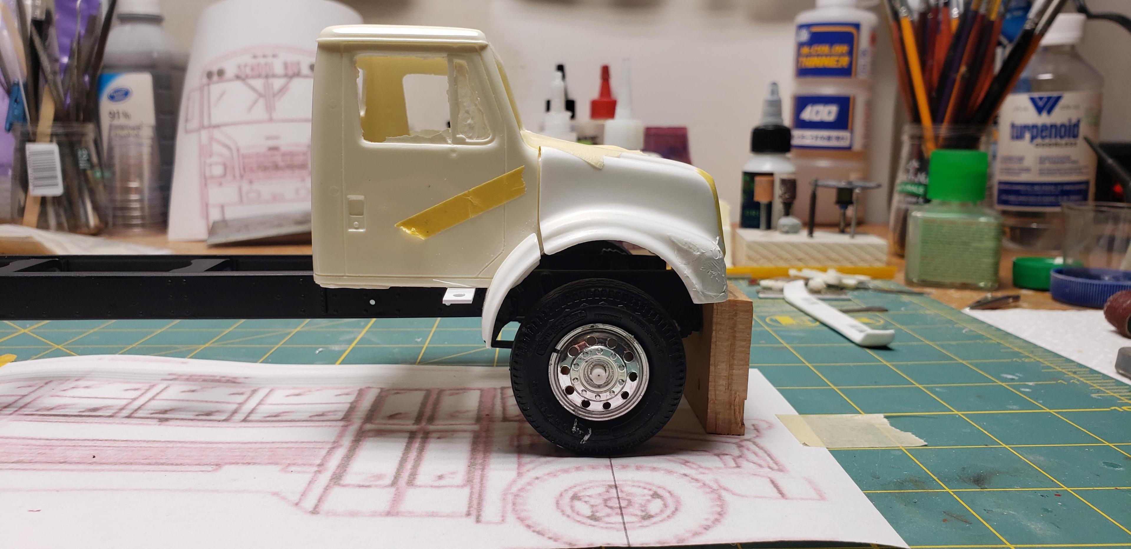

gotnitro? Posted January 11, 2023 Author Posted January 11, 2023 Smallish update I've been plugging away making brackets for the hood hinges to attach to. I stole the concept from the DR kit if it looks familiar! While these cured, I hacked up the resin cab to begin cowling work. The top needs to be a flat panel instead of curved..but the squirrels will eagerly resolve that. Jeff 3
