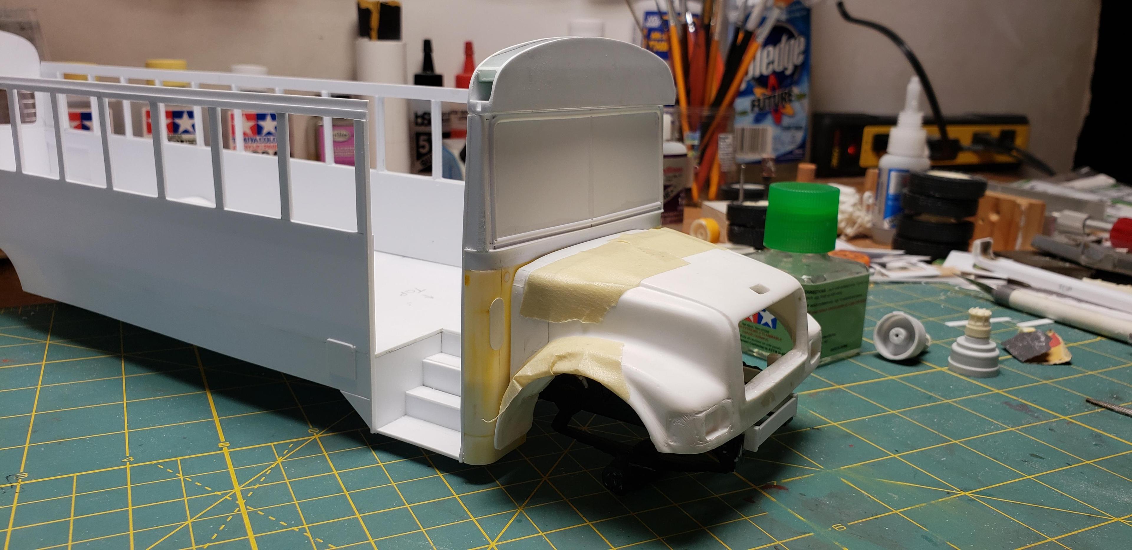

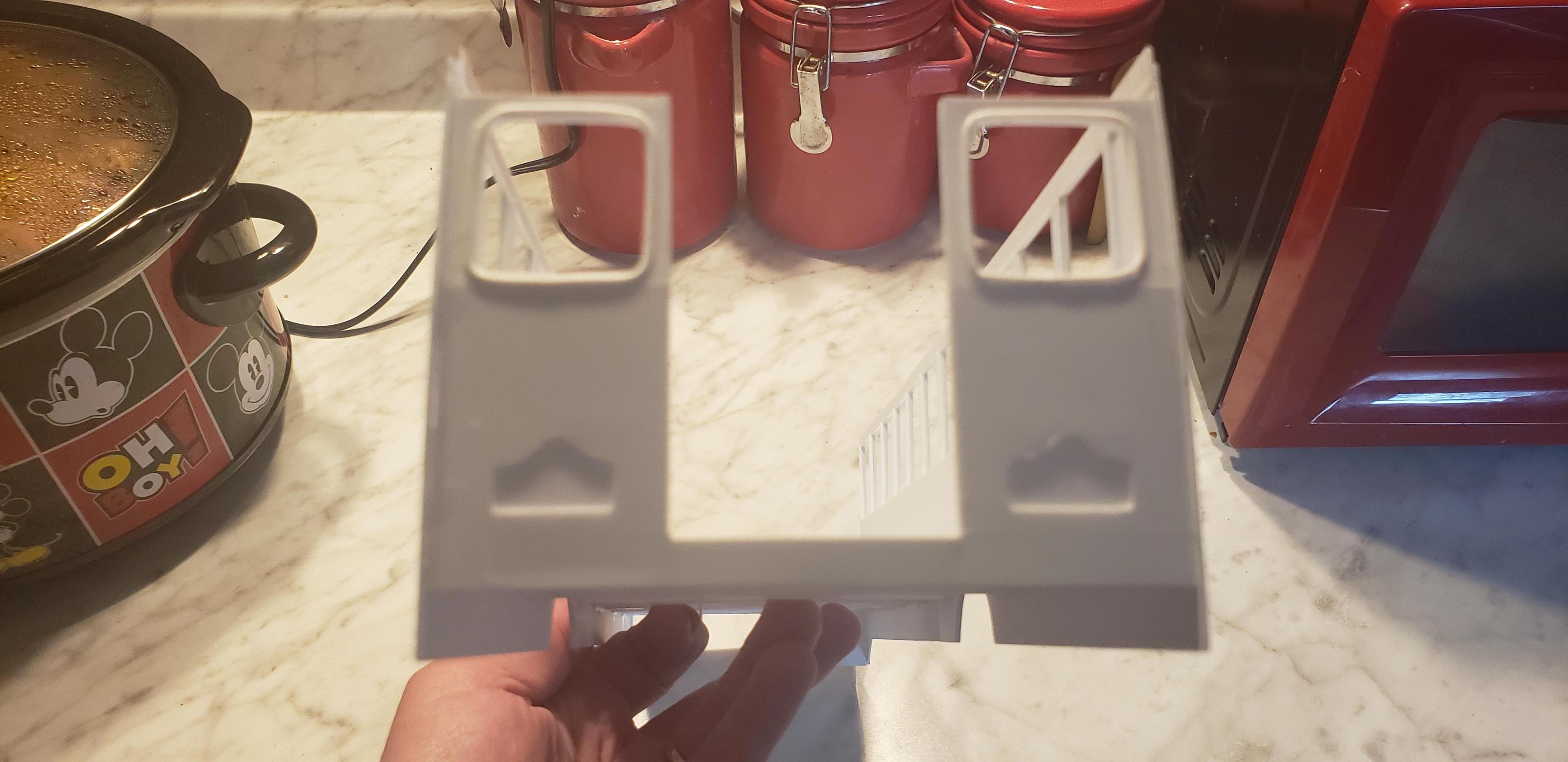

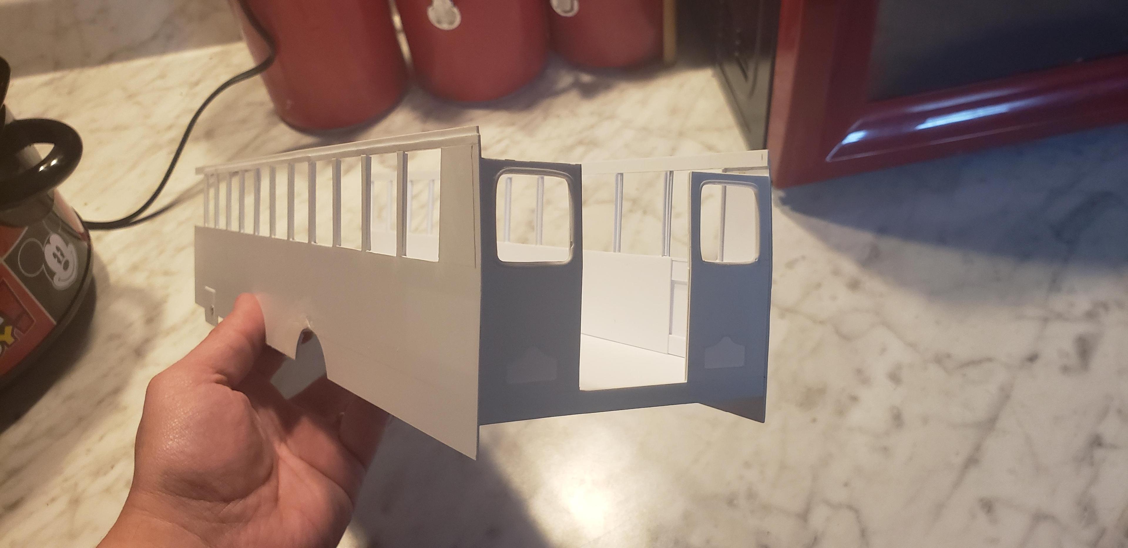

gotnitro? Posted January 29, 2023 Author Posted January 29, 2023 Little update for the wknd. I taped all the body parts I had together to keep the mojo going. Everything is still roughed in, but definitely showed its going the right direction. The original axle position is incorrect now, and needs to be shifted back. Peek inside...oops floor pan was flipped around lol Added a few angle strips to tie the floor into later, and verify where my lower rub strips would need to be. I found my drawing was causing more questions than answers, so I reverted to photos and Mk. 1 eyeball. 1

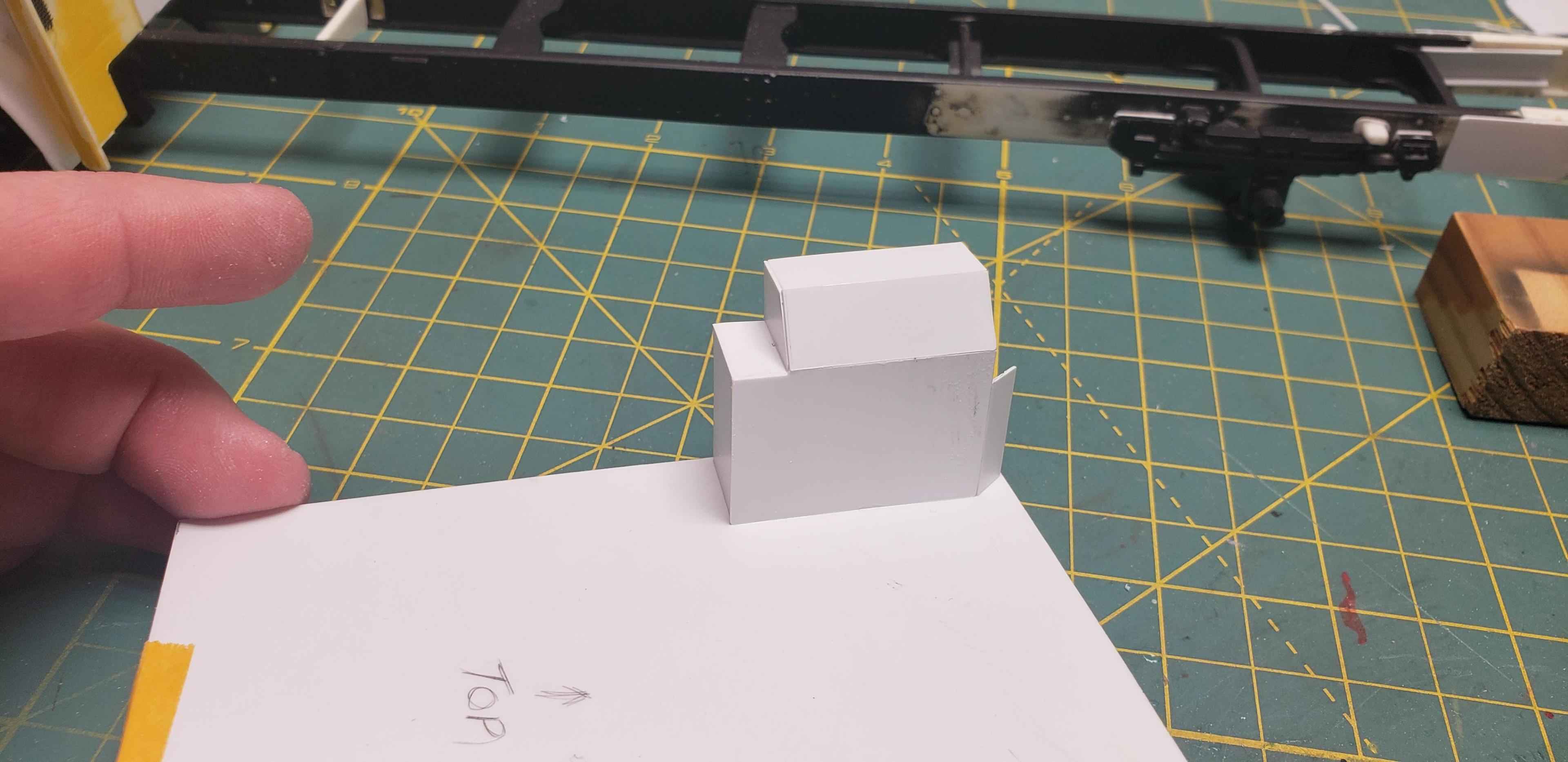

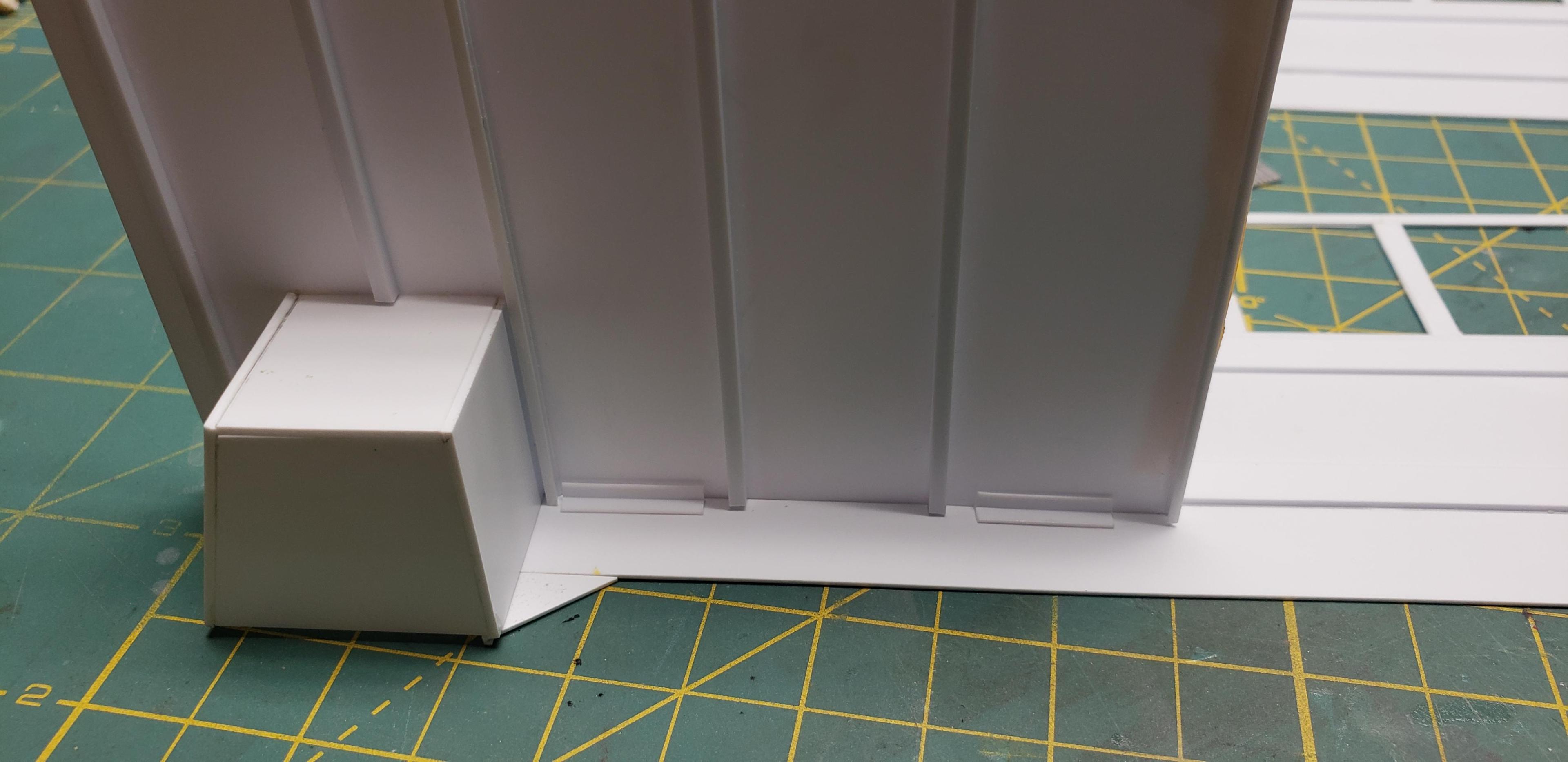

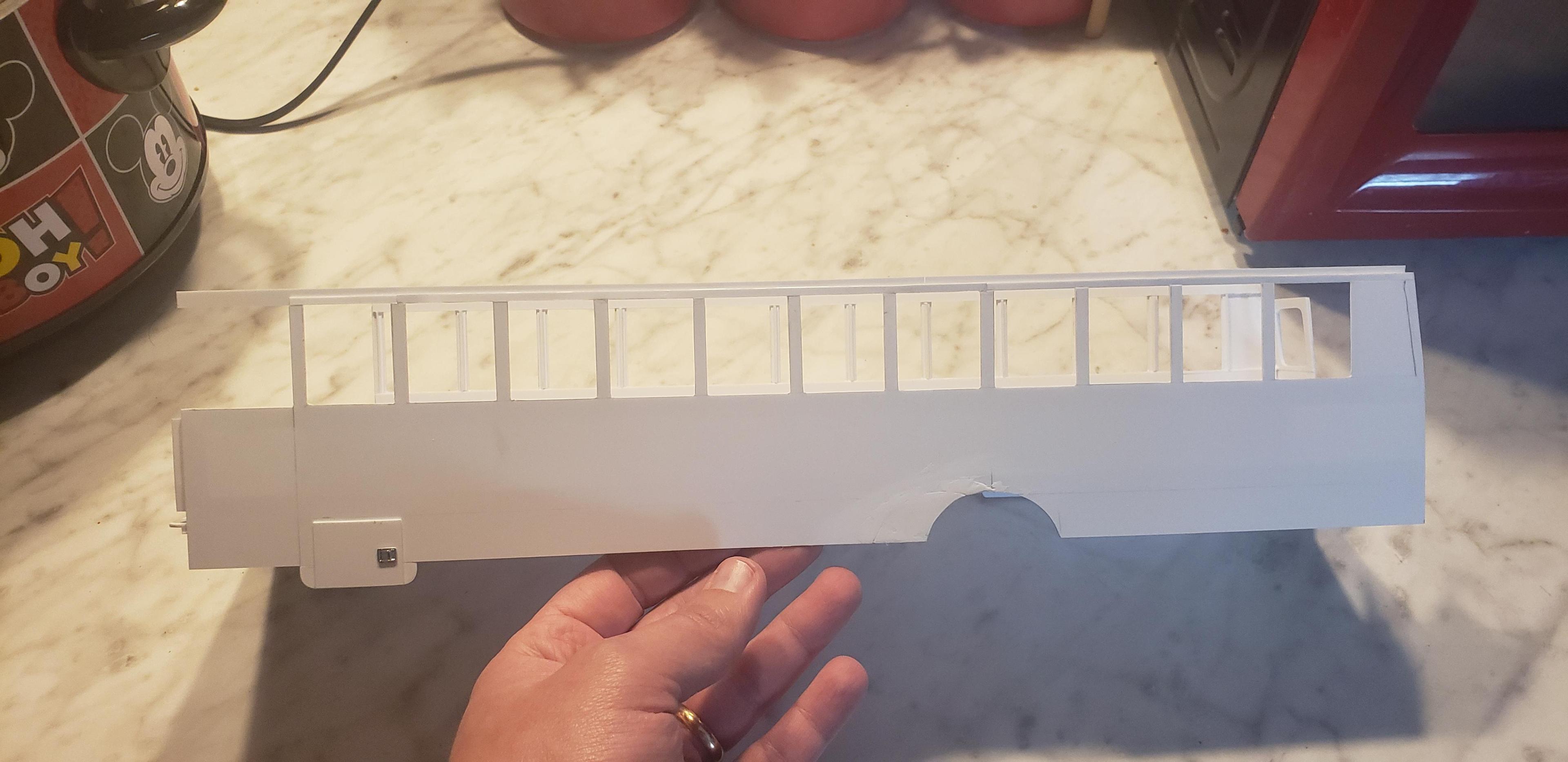

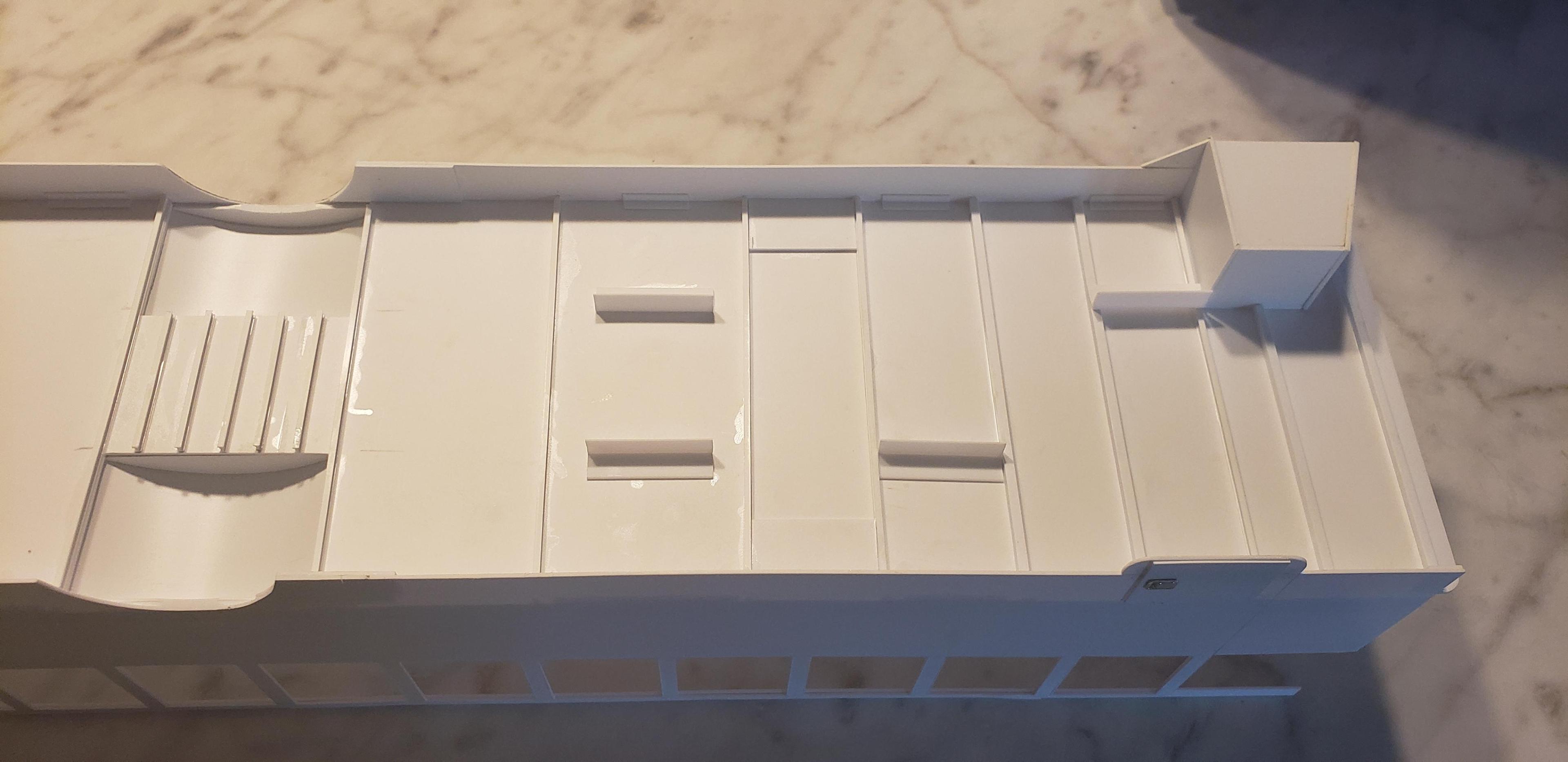

gotnitro? Posted February 5, 2023 Author Posted February 5, 2023 Fabbed up the bus heater, and the first section of roof was added to close off the front bulkhead. The heater console will get the switch panel detailed The left side wall got its battery box door and slam lock from Don Mills. 2

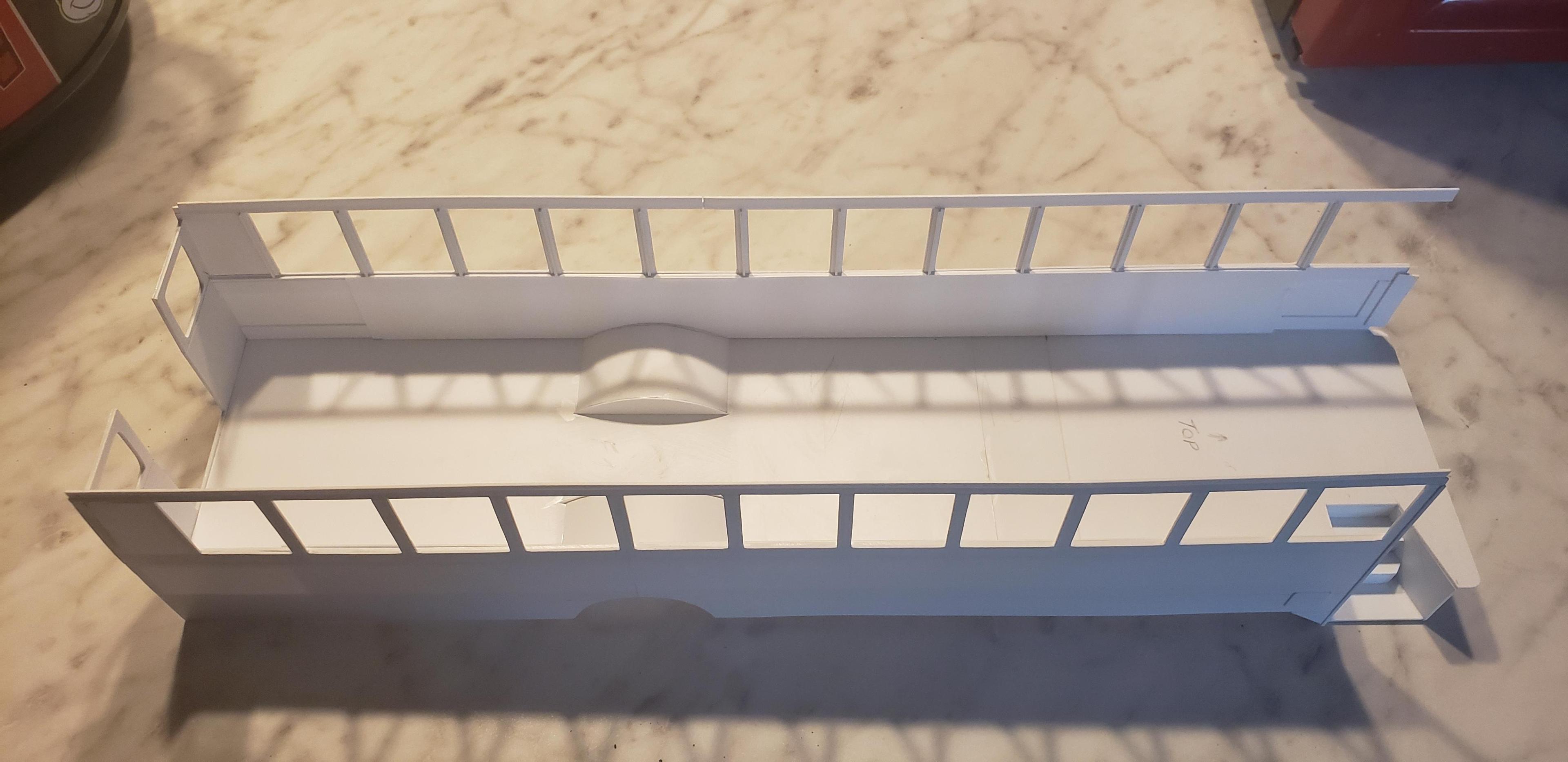

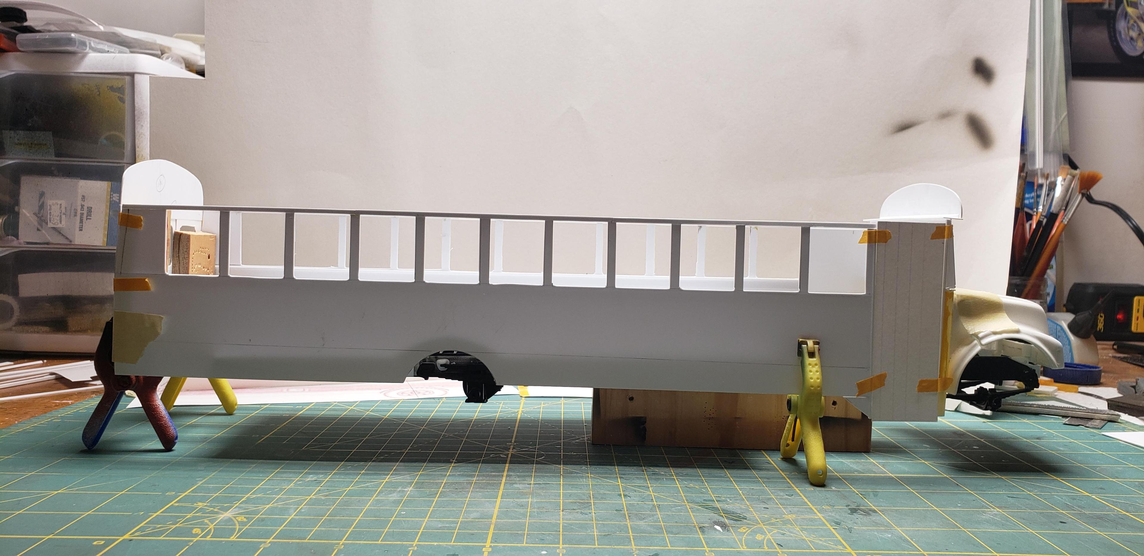

gotnitro? Posted February 5, 2023 Author Posted February 5, 2023 The bus body is one huge piece now !! I added tabs under the floor to keep the walls aligned, then soaked the joints in tamiya extra thin. The wheel openings were filled and recut before mounting the floor. The frame and axle will finally get matched to the body now. I messed up measuring from the fuzzy drawings..the sides were longer than I planned. Next to go..the roof ! Wish me luck ! 3

gotnitro? Posted February 6, 2023 Author Posted February 6, 2023 12 hours ago, Perspective Customs said: This is like a TV series we're I can't wait for the next episode. Great work. Haha thanks! hopefully I won't make you wait long for the next episode. 3 hours ago, Rockford said: It's a credit to you that it looks so clean and sharp. Any misalignment in those windows would stand out like a sore thumb. I don't know how you do it, I can't seem to cut a straight line anywhere. Thanks! Those windows were drawn out a couple times to find a pattern I liked, and they still turned out narrower than I planned. I used a machinist square to cut the lines but they still needed shaping.

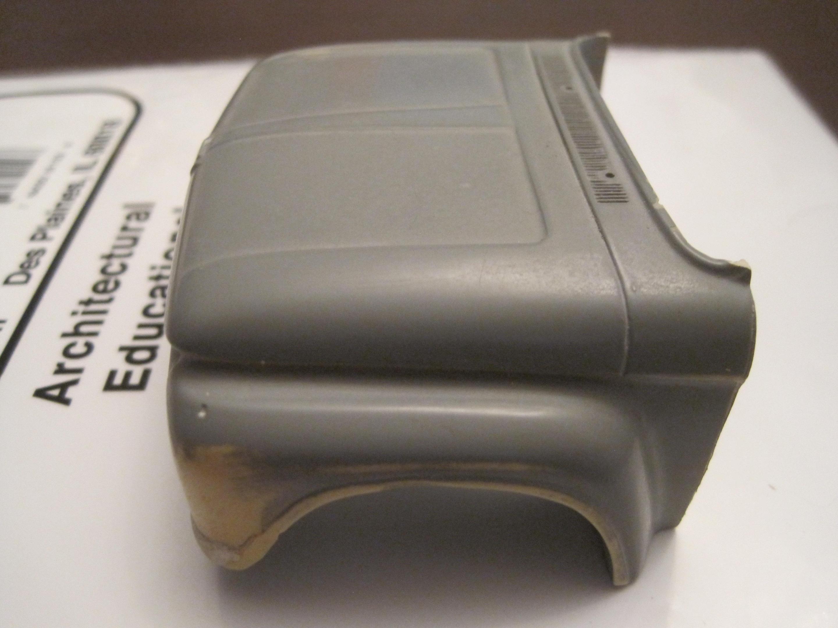

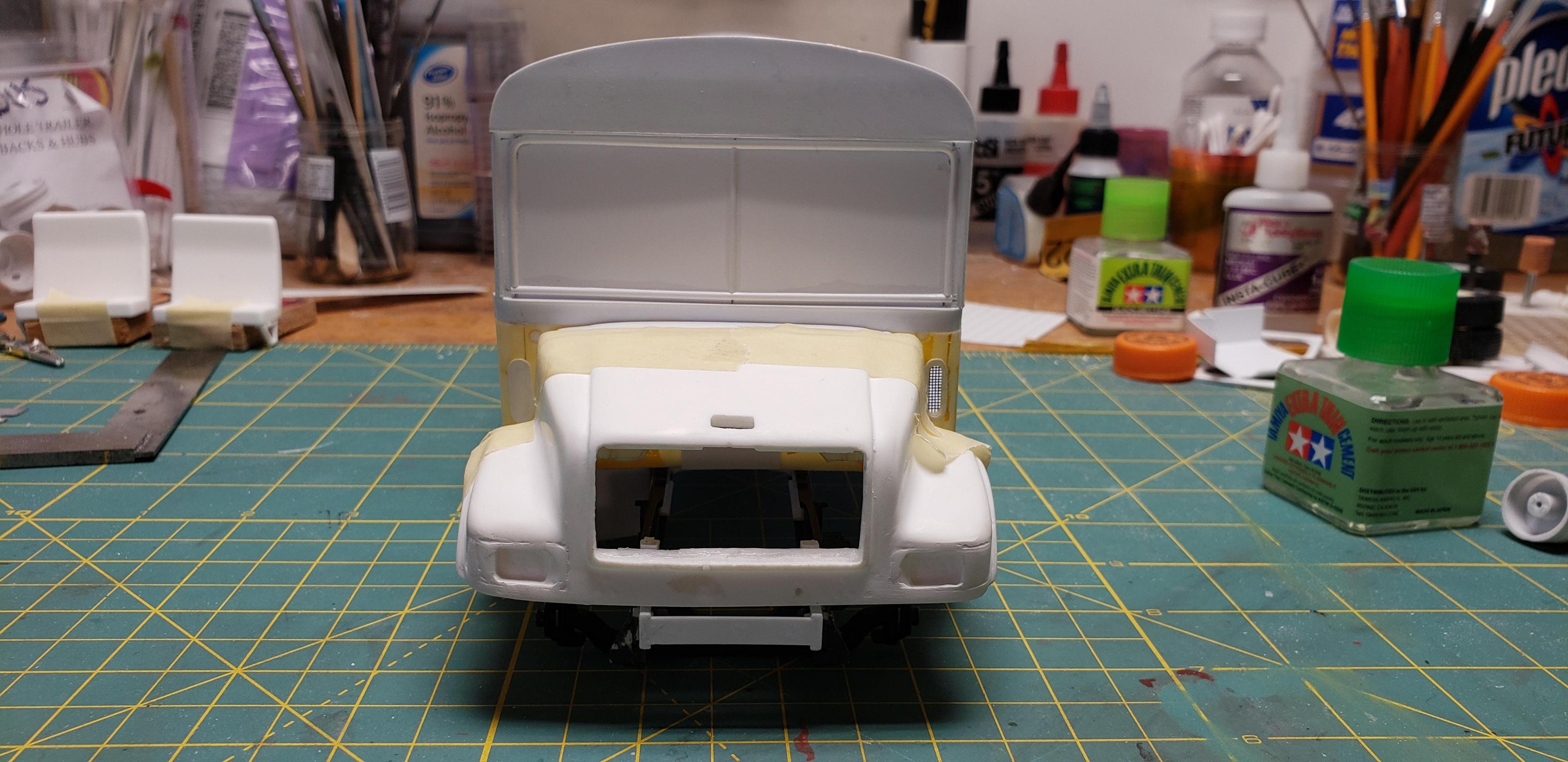

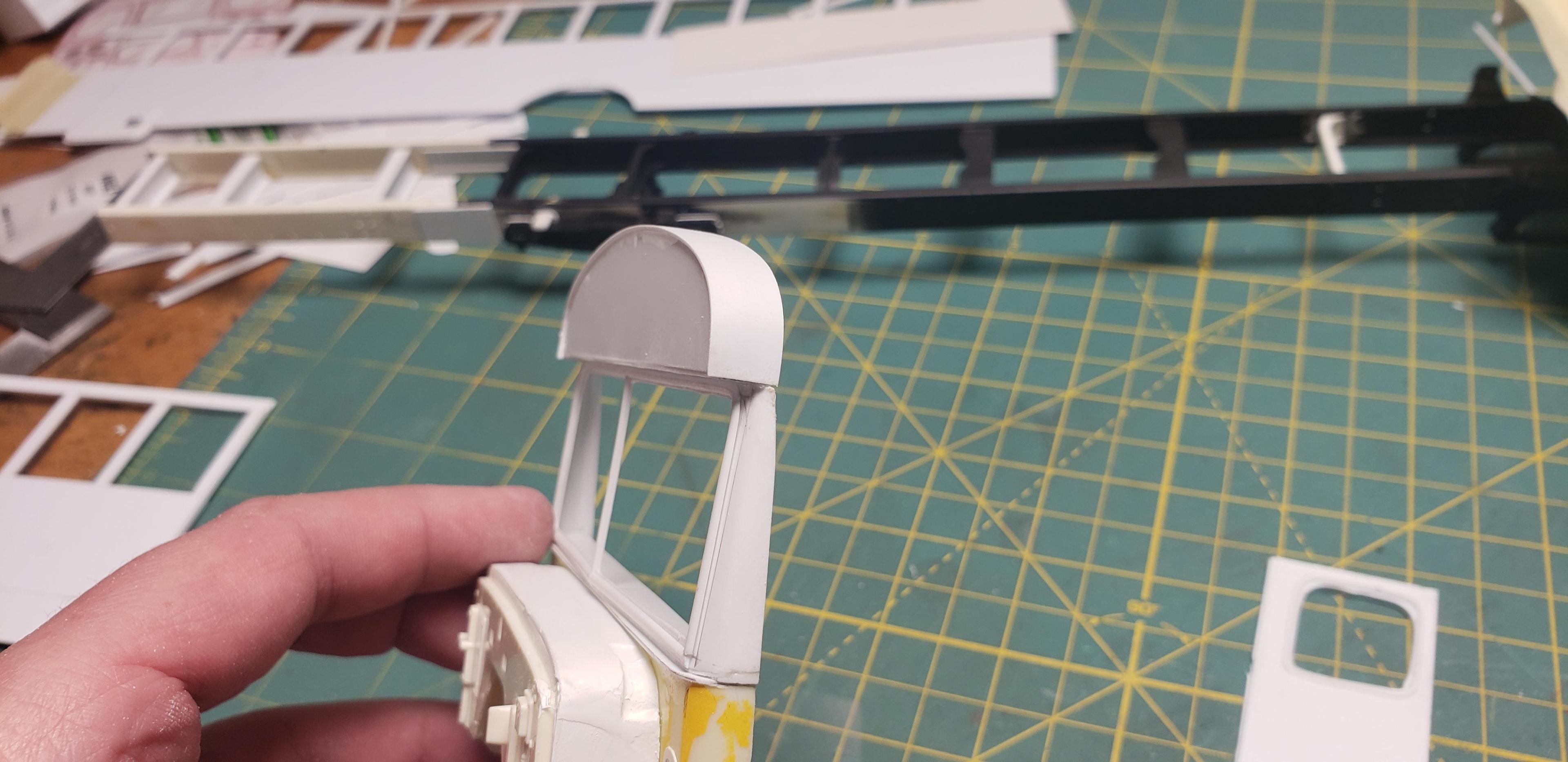

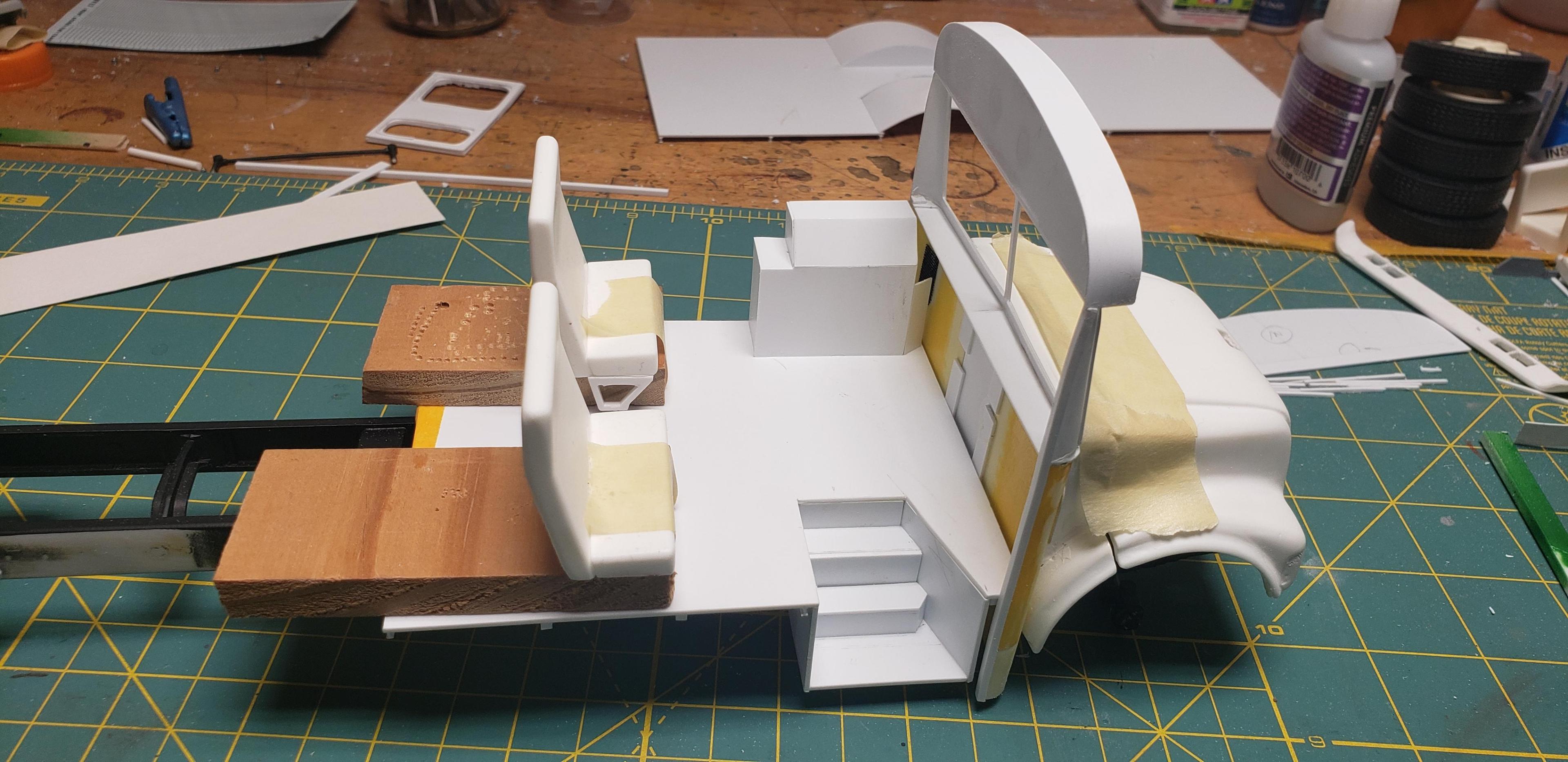

gotnitro? Posted February 12, 2023 Author Posted February 12, 2023 (edited) Wknd update..pics are gonna look familiar. I found out the cowl was wider than the body. After many long minutes of staring at the parts, I decided to get busy fixing it. I removed the front section, and rebuilt the entire area today. I built the windshield and A pillars stronger this time..allowing me to sand the round corners. The next focus was the seats and aisle walkway. My manual showed a standard aisle was 22 inch, so cut the seats down to 36 inches wide. Thanks for everyone following along ! Edited February 12, 2023 by gotnitro? 4

TarheelRick Posted February 15, 2023 Posted February 15, 2023 On 2/12/2023 at 6:03 PM, gotnitro? said: My manual showed a standard aisle was 22 inch Thanks for that information, I have often wondered how wide those aisles were. It was always a bit tight for me walking down to do my 'sleeping kid' check. Really like watching this build, you are doing some excellent work. 1
gotnitro? Posted February 15, 2023 Author Posted February 15, 2023 12 hours ago, peteski said: Nice to keep seeing progress. Looks like you took care of that little setback very well, and improved the model at the same time. Are you planning on building all those individuals seats, or you going to take the set you made and resin cast the remaining ones? Thanks I have 22 seats i ordered, those will get cut down and sanded. I need to add legs to window side still.
peteski Posted February 15, 2023 Posted February 15, 2023 7 hours ago, gotnitro? said: Thanks I have 22 seats i ordered, those will get cut down and sanded. I need to add legs to window side still. I had to go back to the initial post to see that you had the seats even back then, but I didn't see any mention where you got the seats. Who makes these?
gotnitro? Posted February 16, 2023 Author Posted February 16, 2023 15 hours ago, peteski said: I had to go back to the initial post to see that you had the seats even back then, but I didn't see any mention where you got the seats. Who makes these? Plaskit resins in Canada cast the seats. Daniel had a mold available from another project, and offered to make my bus seats. 2 1

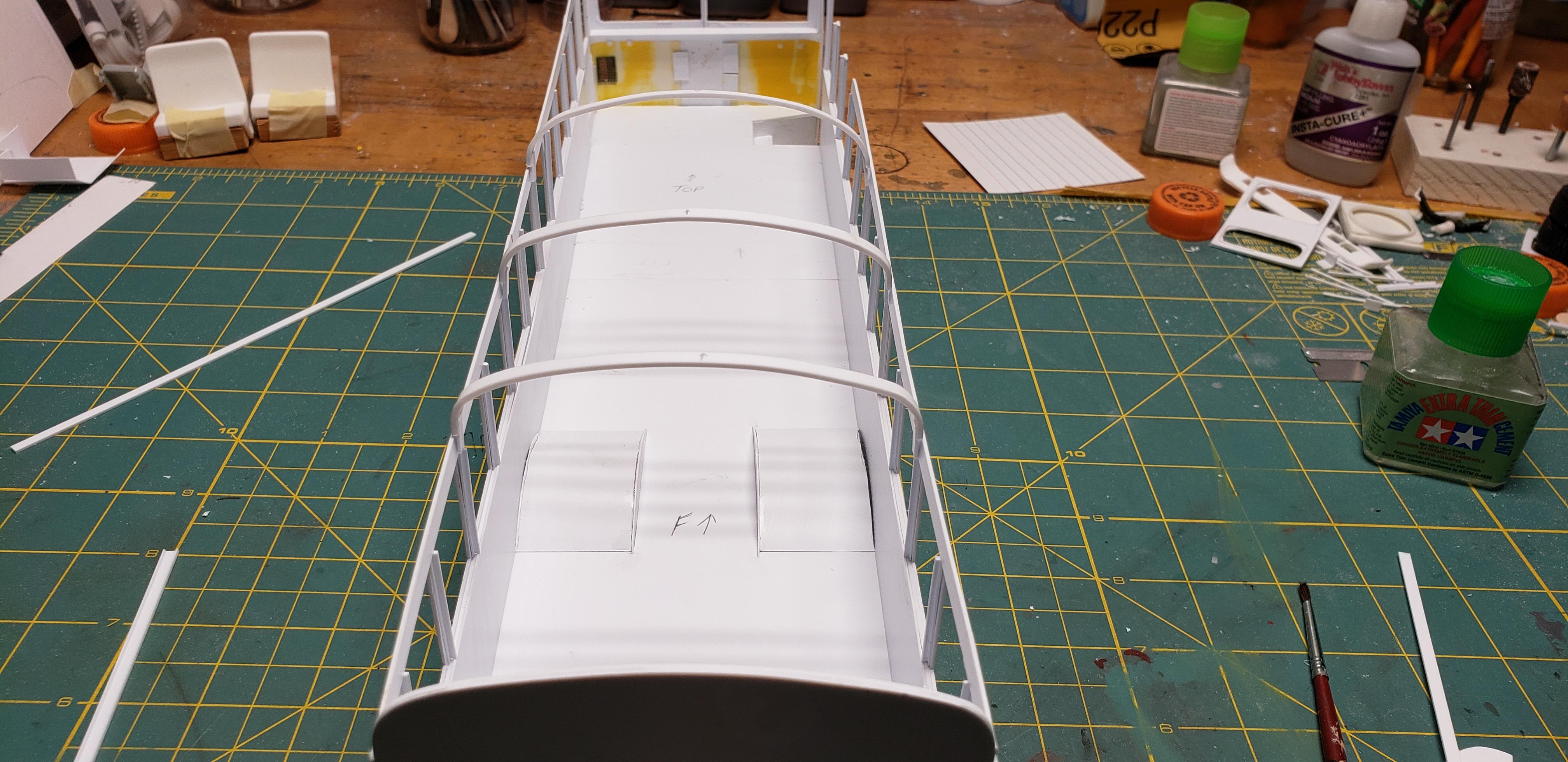

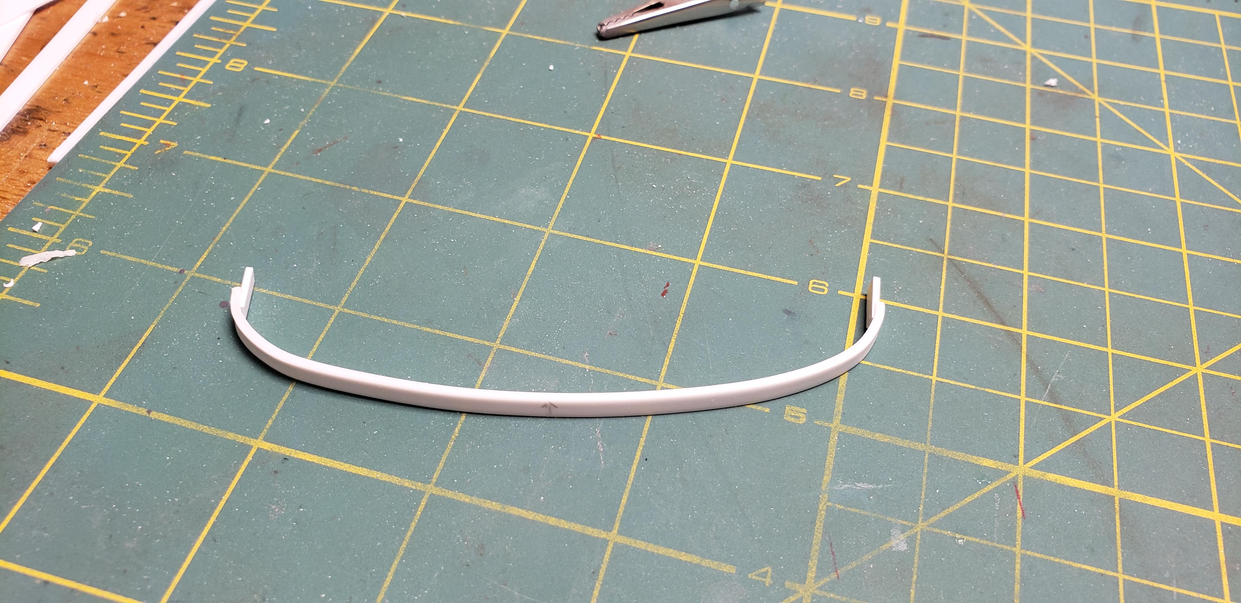

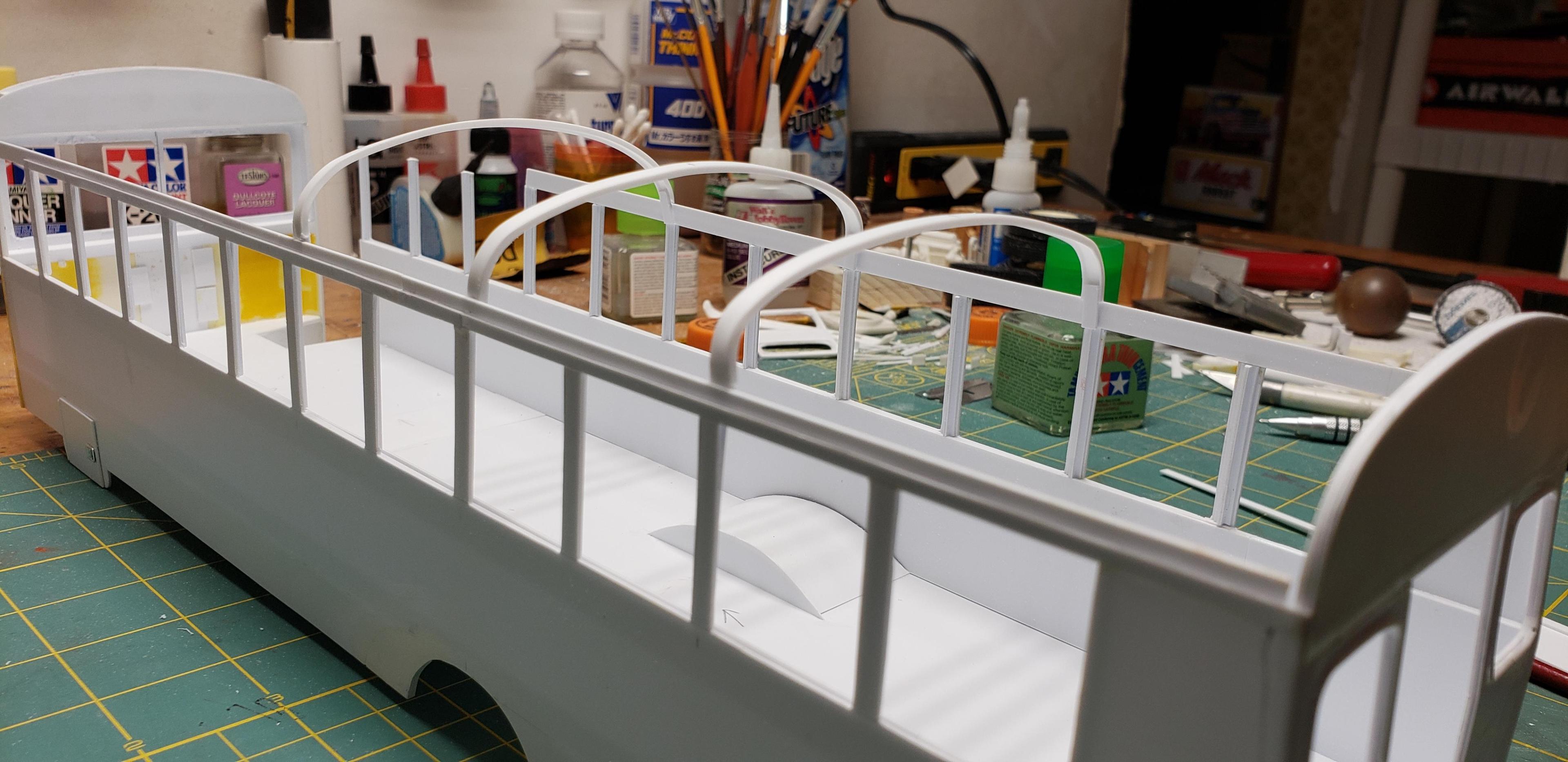

gotnitro? Posted February 17, 2023 Author Posted February 17, 2023 Today I worked on making bows for the roof. Several different shapes were tried until I found a suitable size C channel. I modeled them after the bows found on our military trucks I worked on in motorpool. Bending each w a dowel until they matched the rear then sliding a tab into the groove to lock it against the body. Only 8 more to go lol Thanks for following along! 3
