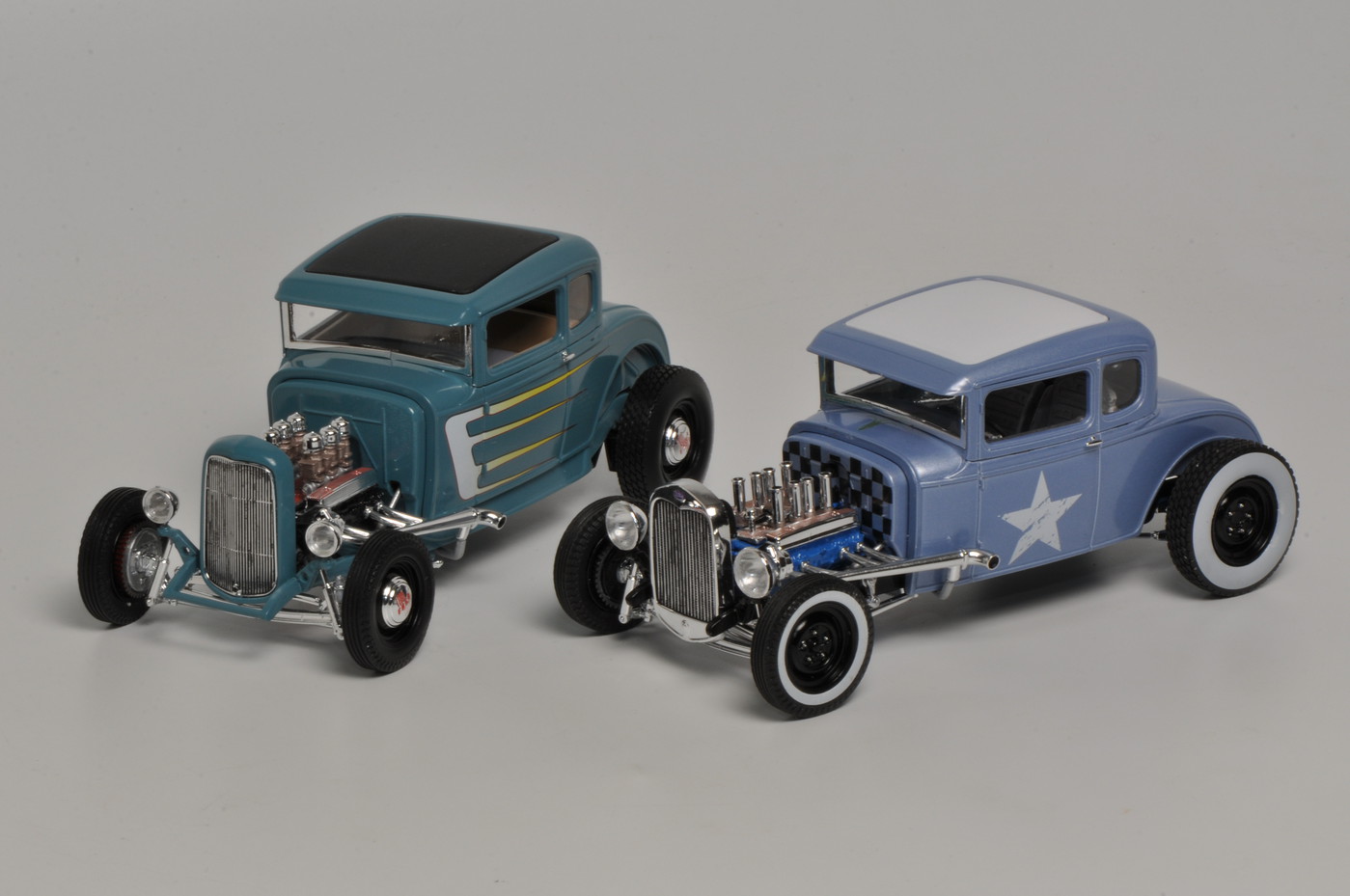

Craig and Chuck....I did shoot clear (I think it was Tamiya Semi-Gloss) before applying the whitewalls, primarily to give the decals a panted surface to adhere to.  I'm not aware of any degradation...it's been nine years since I built it - but I will check it out and get back to you all....TB
  • Like 1
  • Thanks 1
On 10/26/2023 at 2:44 PM, Chuck Kourouklis said:
Now that you mention it, Bob, I remember that!  Wonder if he's had the same experience then, guess I'll have to search his content a bit and see what I can excavate...
Craig, Chuck, and Bob:
Today I checked on the Roadster (built in 2015) and the Five Window Coupe (built in 2021?) that used the whitewall decals.  On the 2015 build (where I had to use a ton of MicroSol to get the rar whitewalls to settle down), there were a few spots where the decal had pulled away ever so slightly from the tire, and the front whitewall decals had some minute wrinkles that were not there originally, but it both cases you had to look really hard to see them.  In the 2021 build, the decals looked fine but in handling the model, the rear whitewalls have developed a sticky surface of sorts.   Neither situation would be enough to keep me from doing this process again, but does suggest that there may be a few mid-long term tradeoffs of sorts....TIM

Thanks very much, Tim!  Yep, on future ventures I'll probably put a semi-gloss barrier coat on the sidewall first.  I'm also of a mind to try deliberately applying one outer surface-in, just to see if that might be what happened with the one wheel that isn't tacky.
It was a lot of solution in my case too, but they conformed so nicely they deserve another shot with some troubleshooting in mind.  I'll stand by the rest of my observations about current Revell decals.
