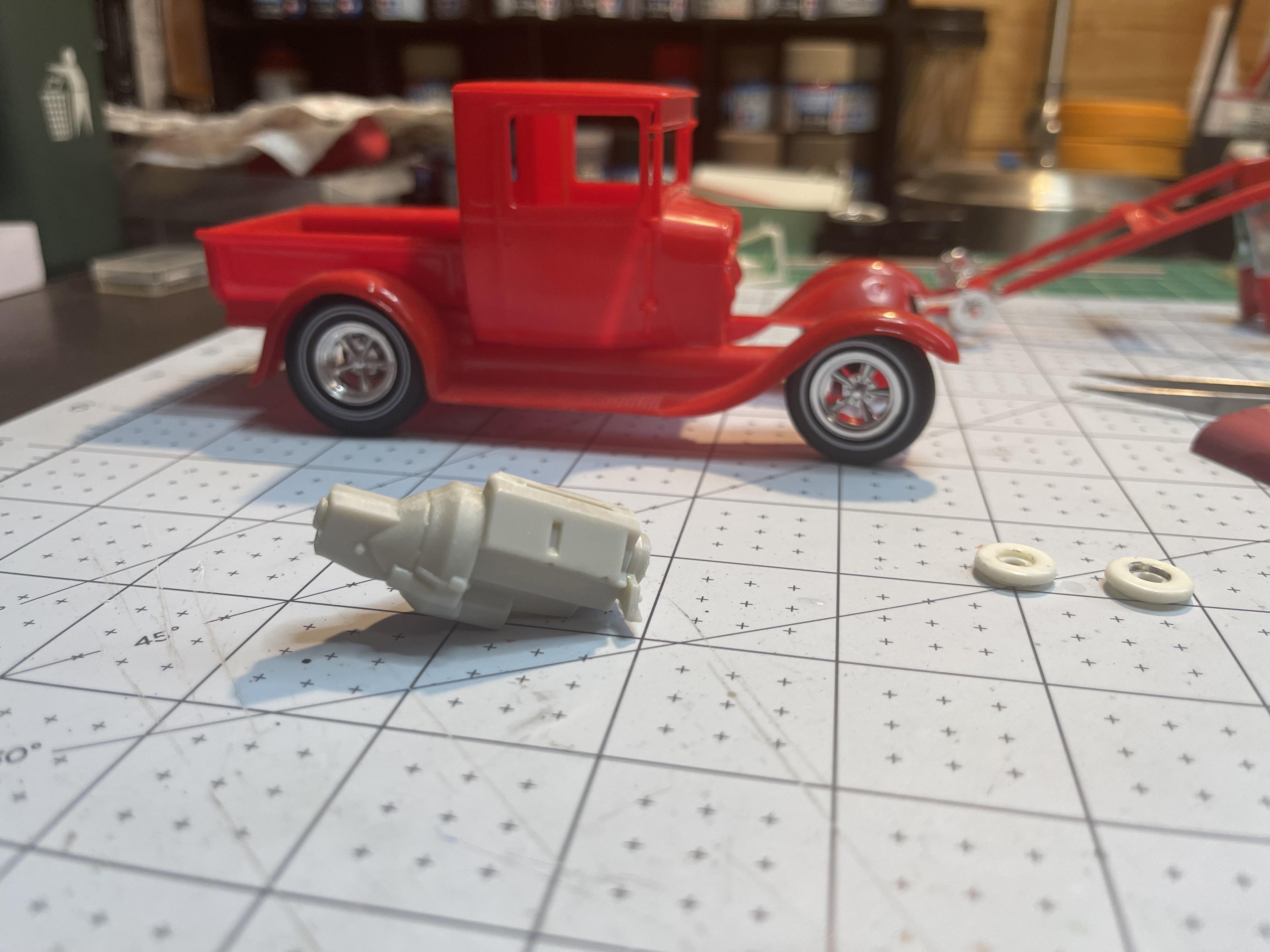

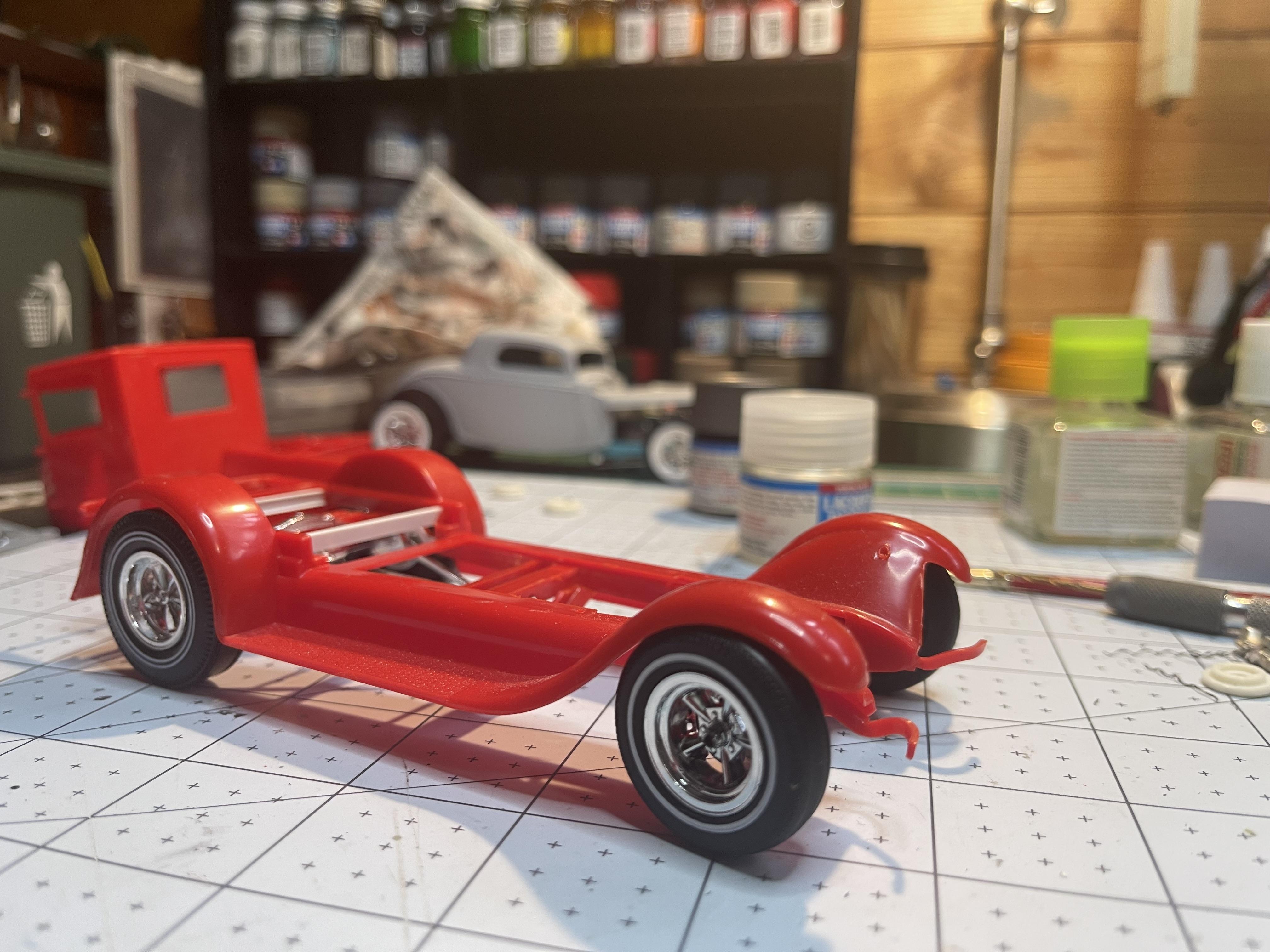

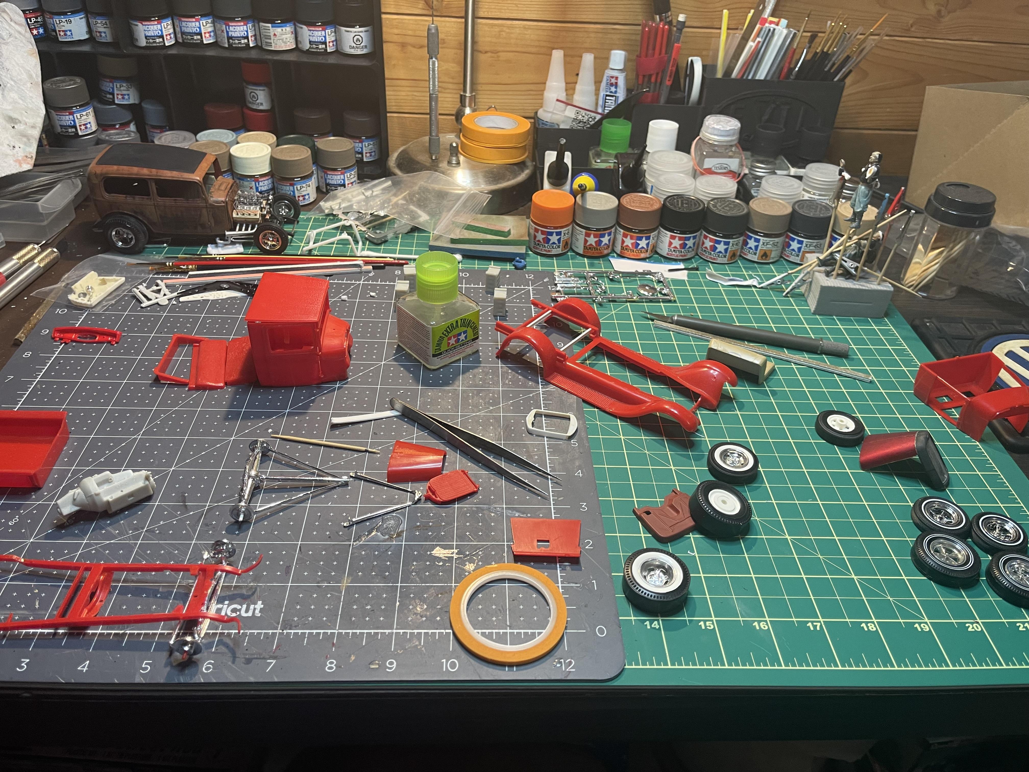

Bullybeef Posted August 26, 2024 Author Posted August 26, 2024 Well I unboxed and have started sorting through what I had planned and I’ve decided that the ole truck will be indeed powered by ford, I’m going with a flathead from the amt 34 ford. Found that the frame rails had separated at the Z, so I have added some inner boxing plates at the joins. This ole red plastic is not playing very nice, if I continue to have bonding issues( I’ve never had an issue with the selection of glues I have before) I’ll have to switch over to the newer rat rod kit. and of course the obligatory mock up again to see the vision again. 6

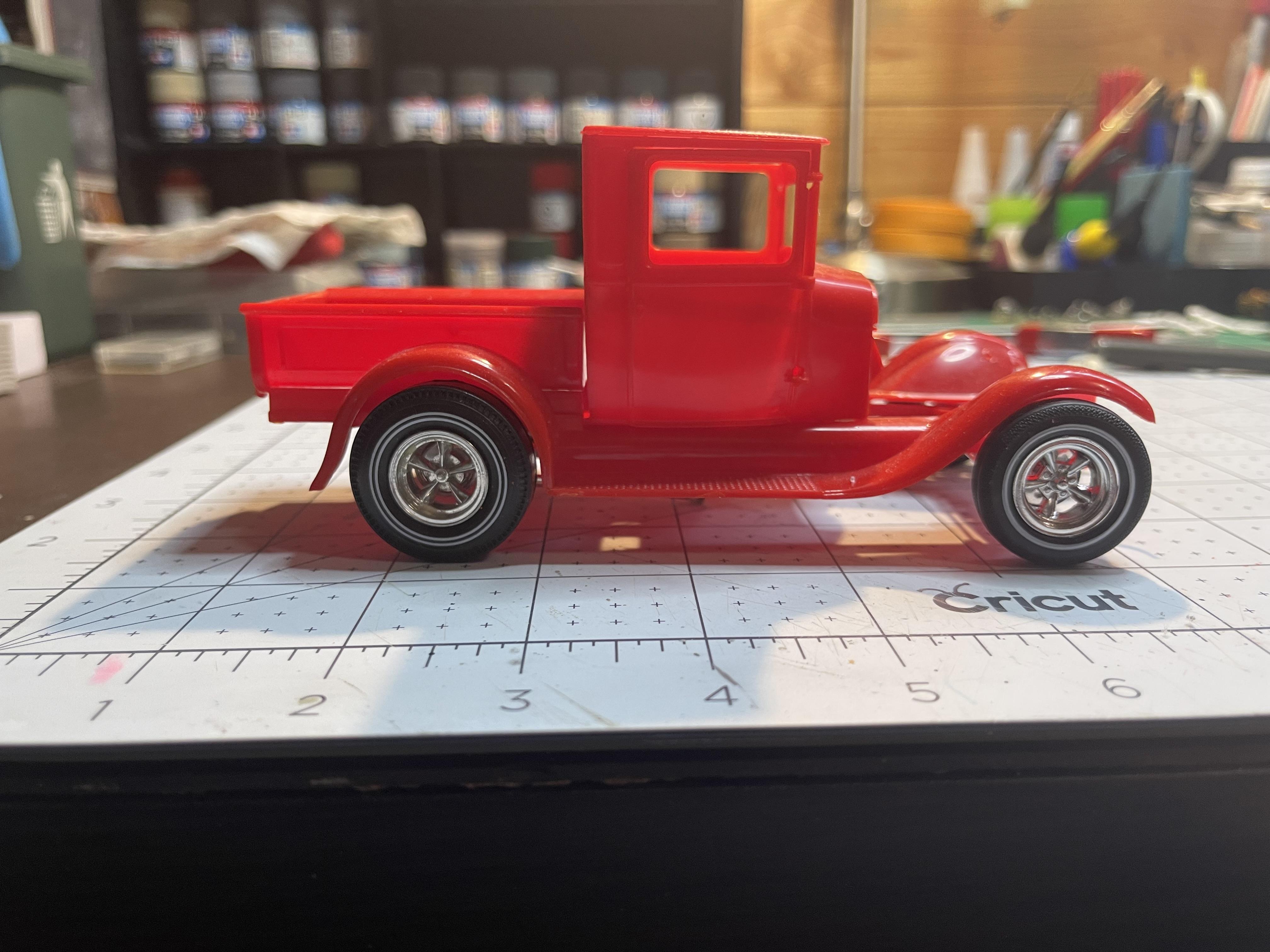

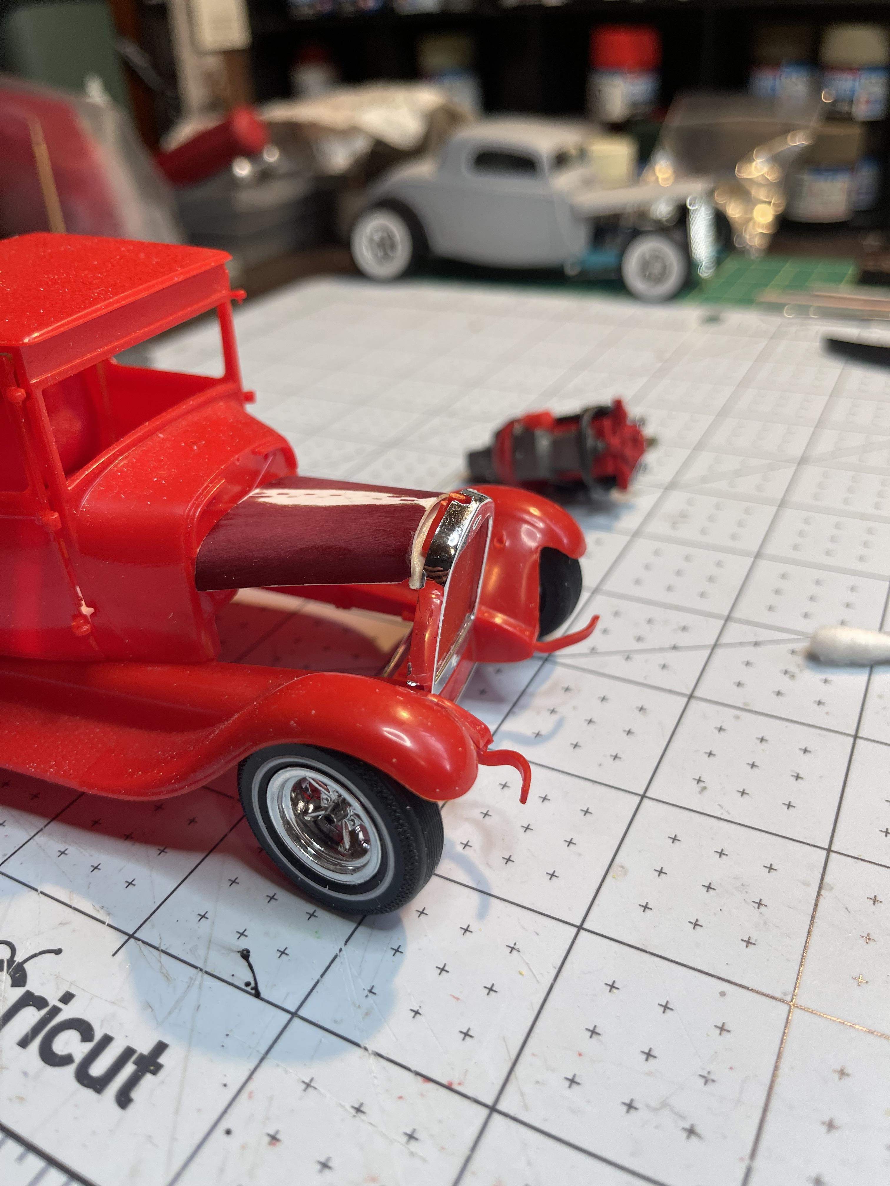

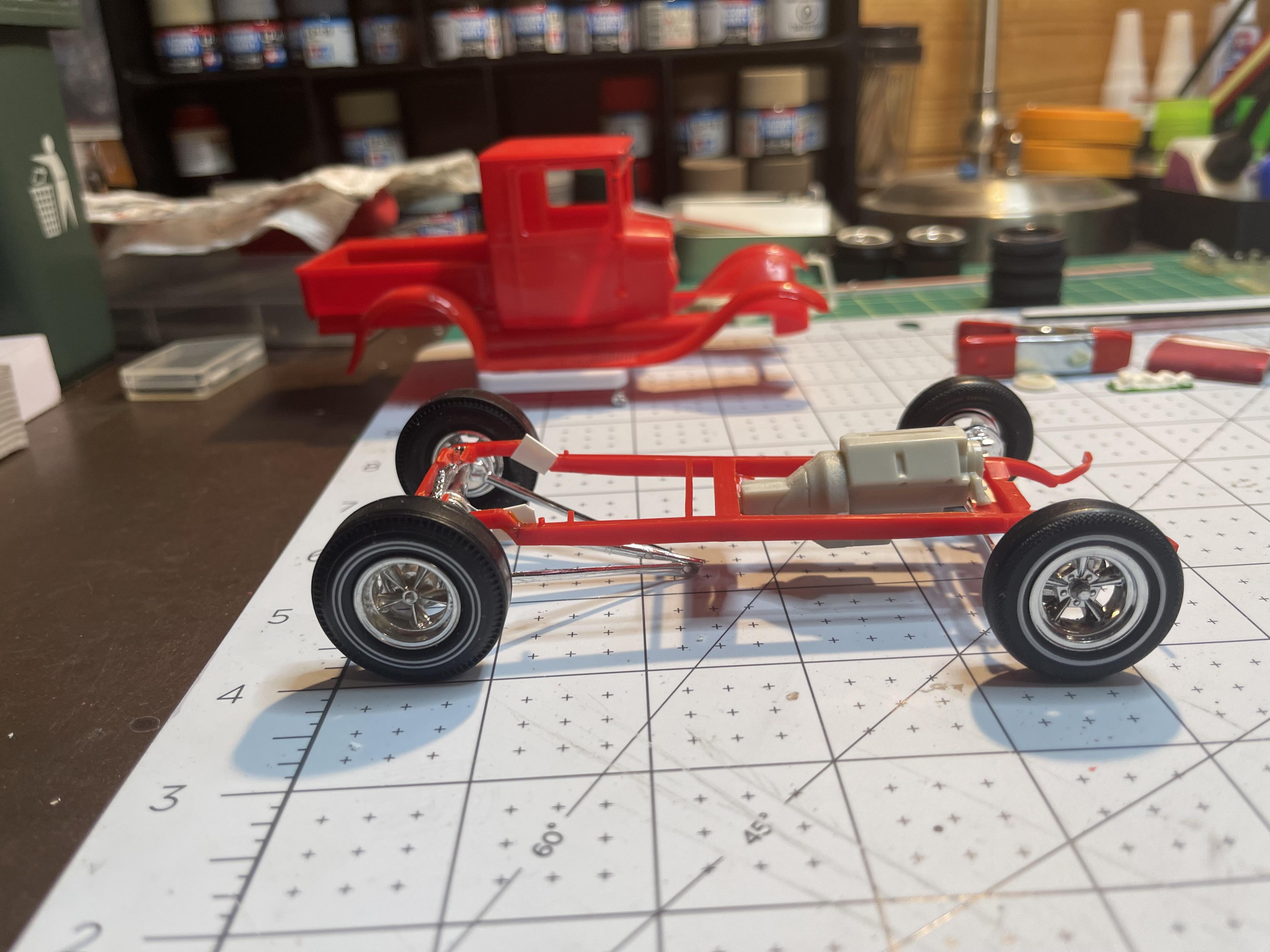

Bullybeef Posted August 26, 2024 Author Posted August 26, 2024 Well I got it up on four wheels with suspension components and I’ll have to address the front track, she’s a tinch too wide and the rear could come down a little more. That’s all workable which is great news 4

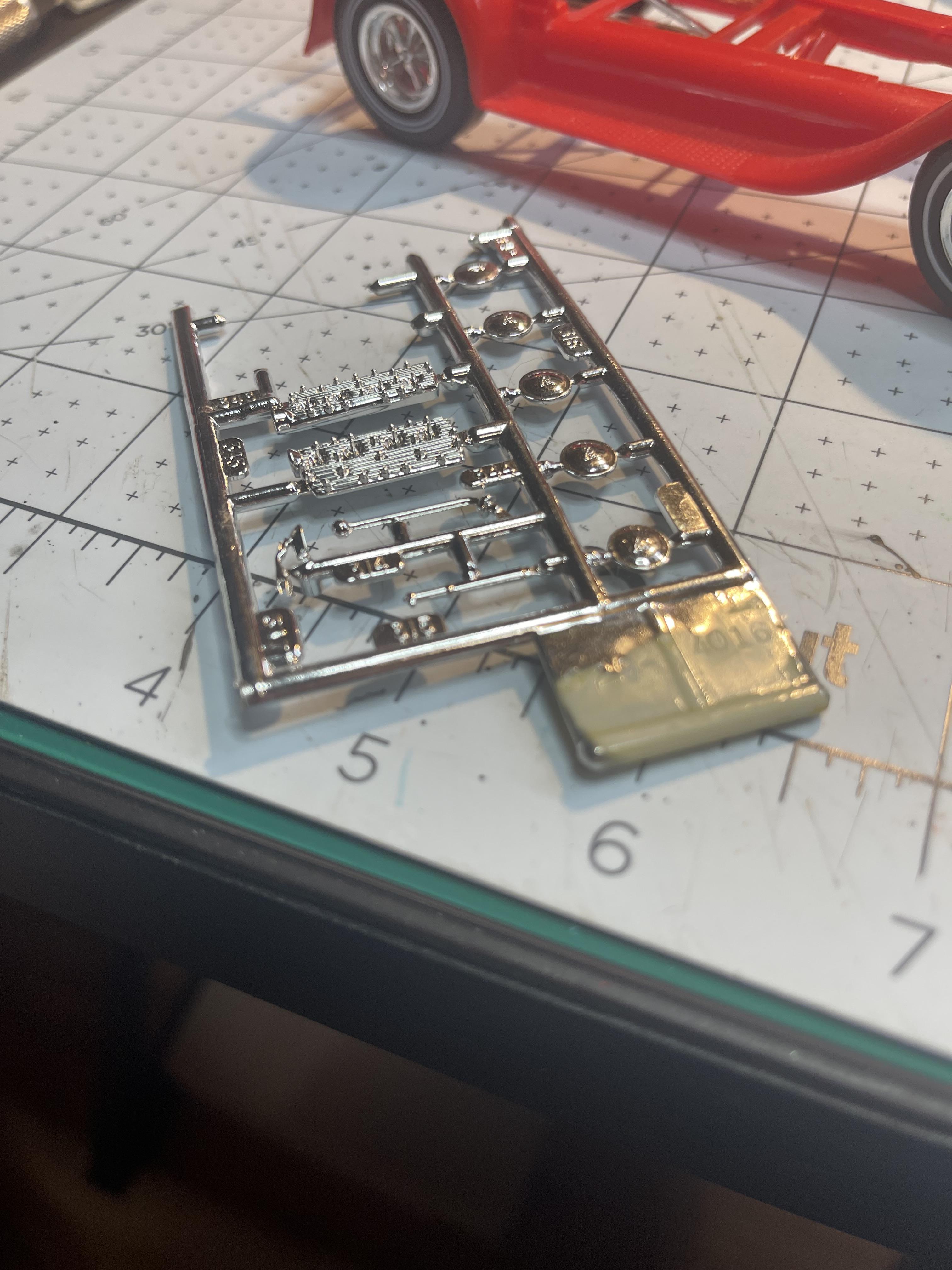

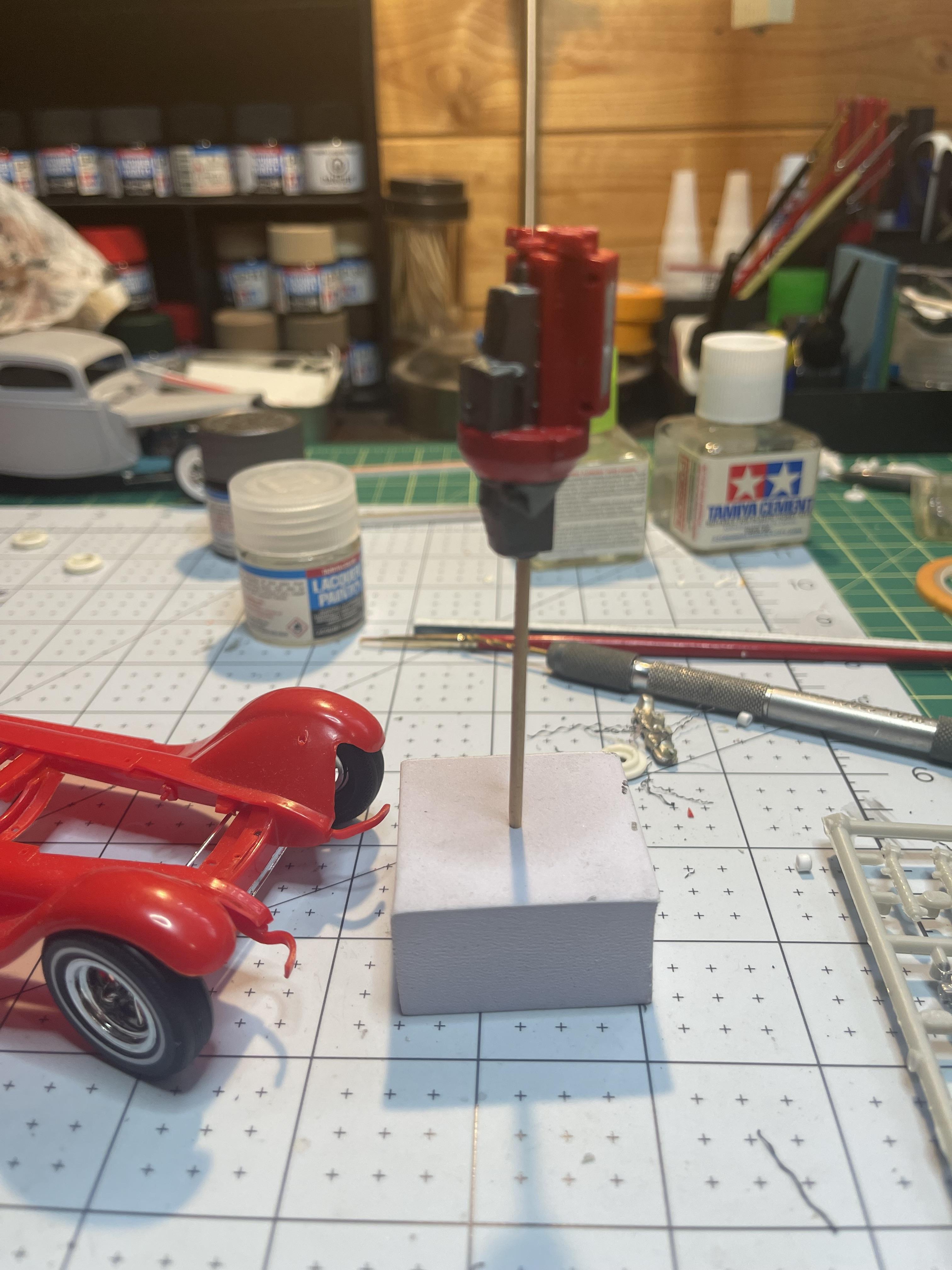

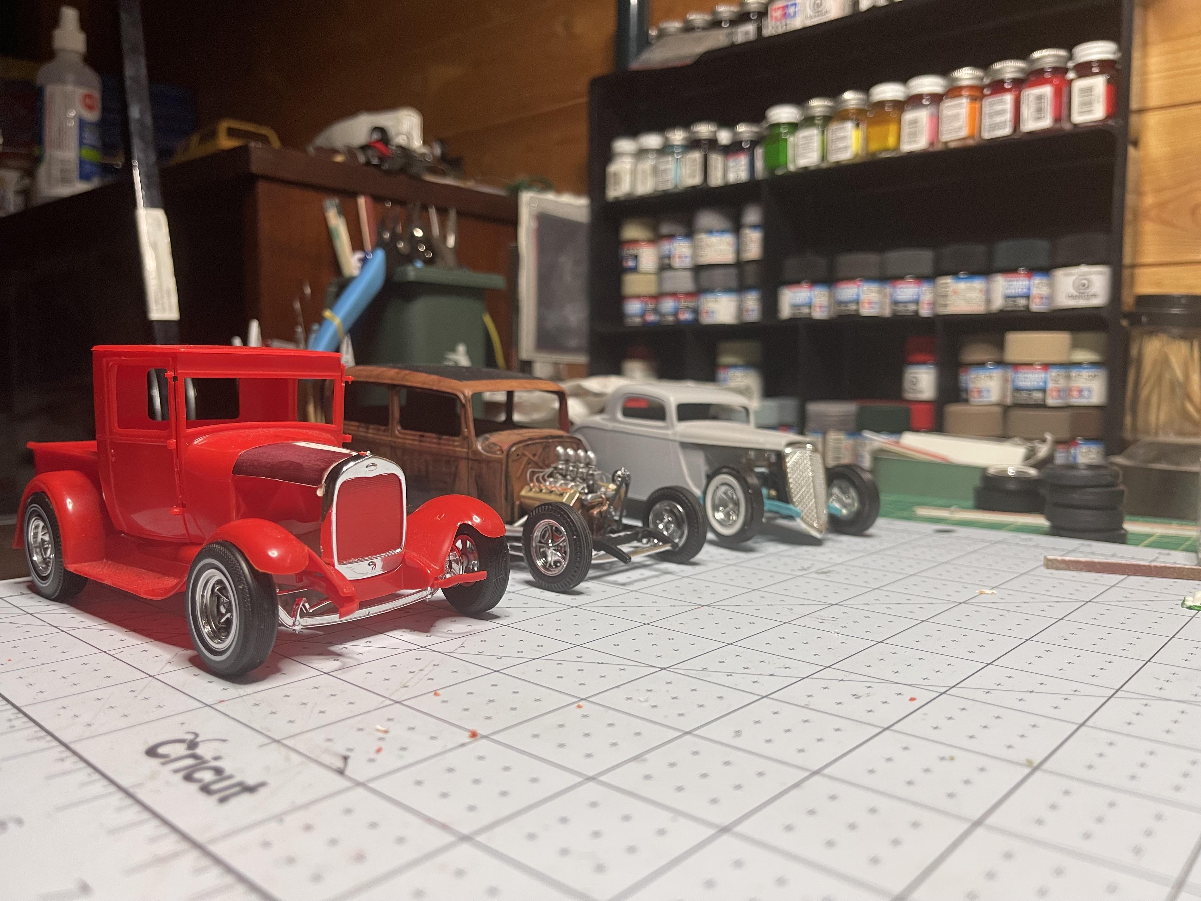

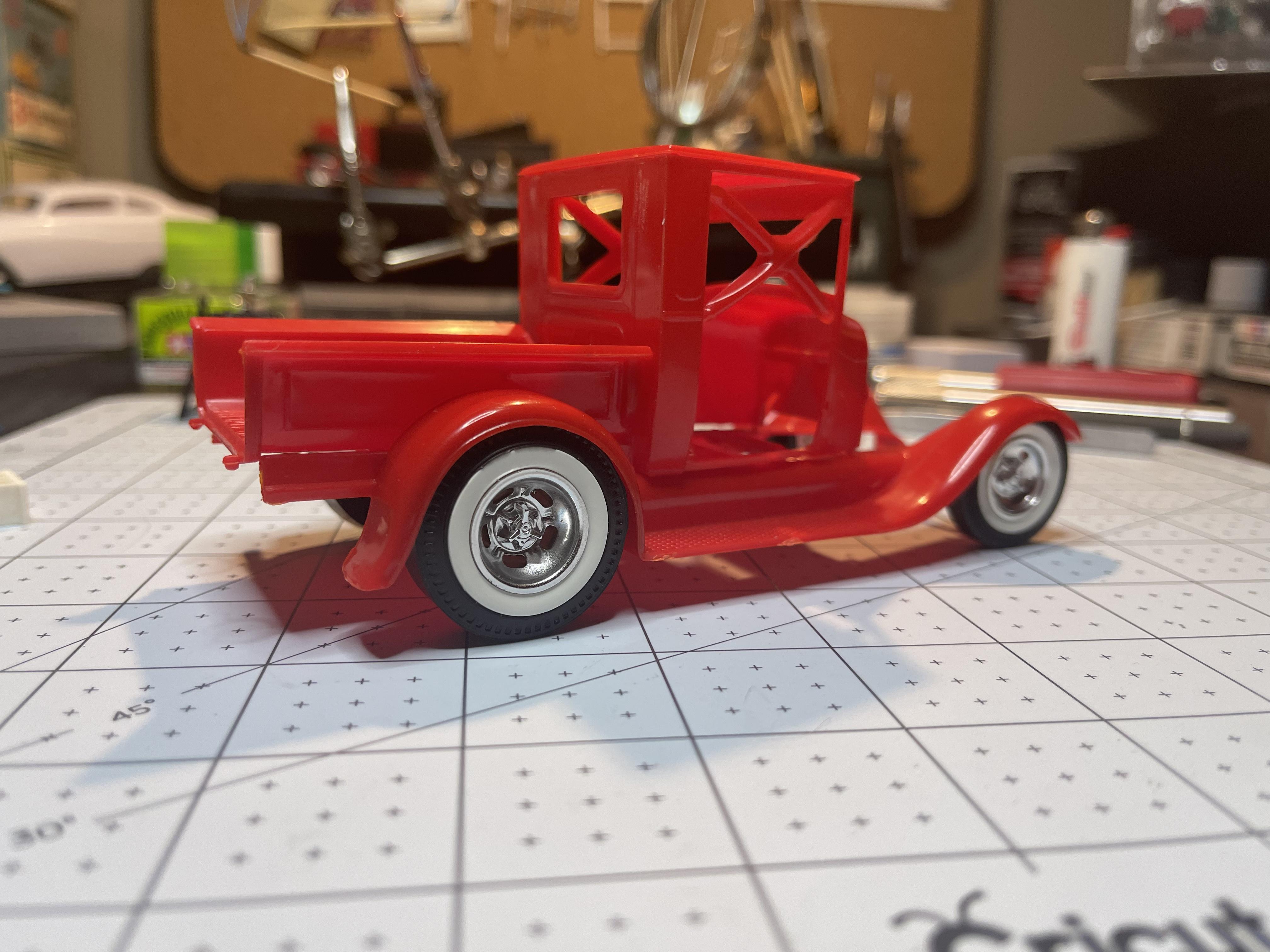

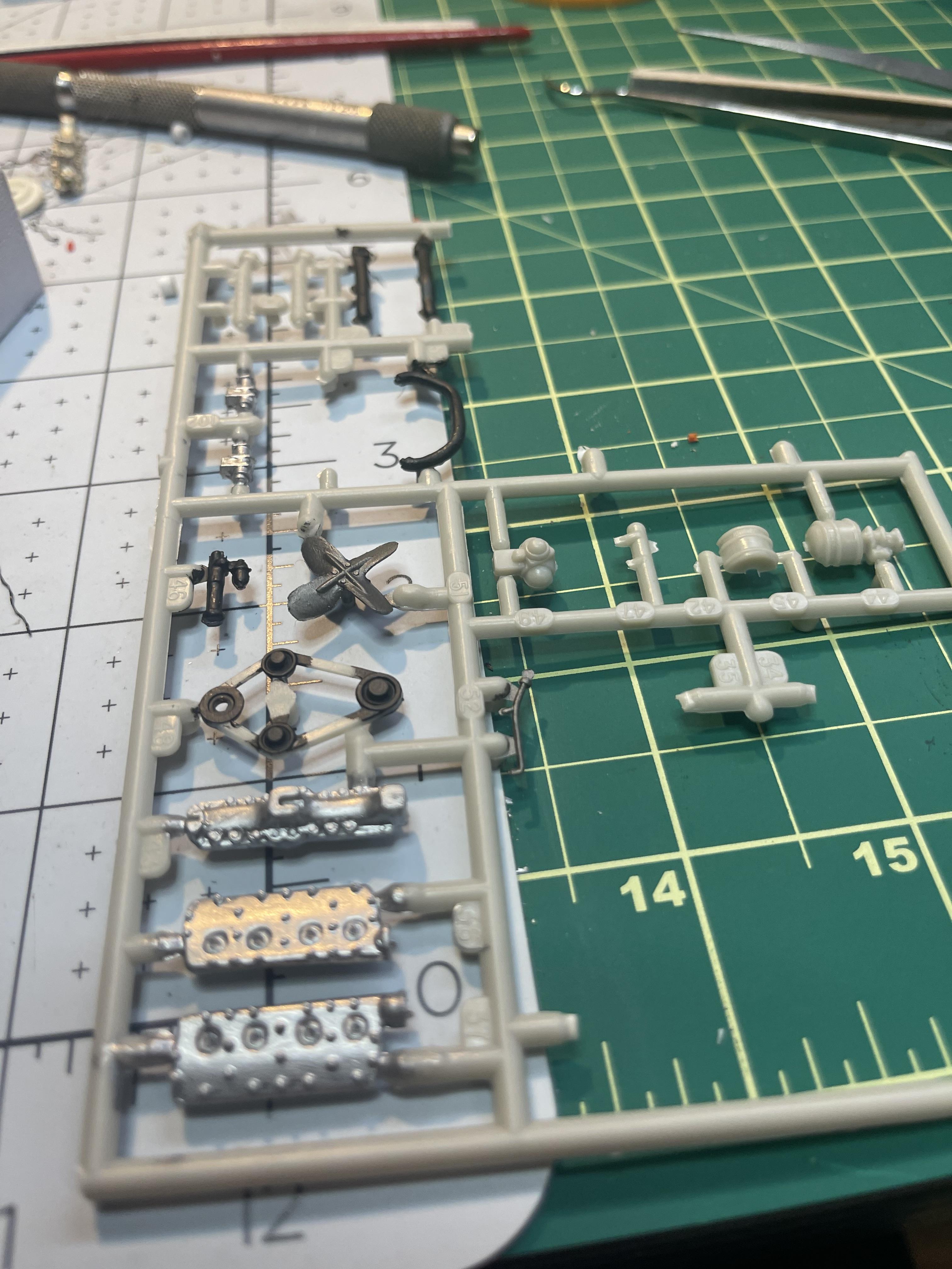

Bullybeef Posted August 27, 2024 Author Posted August 27, 2024 Well we are inching ever closer to having a stance that will bring it closer to my vision! dis the ole tried, tested and true method of taking some springs from the front spring pack that gets the front down to a almost Tire touching the fender look I’m after! The rear is not as bad as it had looked before. It will see another tweak later. Had to get at least one item in paint though so I started on the flathead. Our highschooler has gone with the flattie from a 34 ford and will give it a proper spray can rebuild with the addition of a dual carb manifold. He has his eye on a set of chrome cylinder heads but they may be out of his reach atm. He is still broke from the outlay for the mismatched five spokes and new Firestone’s. Once we can temp in the engine we can start the complicated exhaust work. The last pic is the gang of hotrods I’m currently working on. 6

Bullybeef Posted August 28, 2024 Author Posted August 28, 2024 7 hours ago, Radretireddad said: I’m have the exact same kit and I’d really be interested in how you end up doing the rear suspension as the ride height with the stock parts is way too high. Well Brian let’s see if I can shed some light here for you, I started with a Zed frame in the rear and have hollowed out the rear spring perch so that the spring pack can sit higher in the frame. I’ll try to get some detailed pics to show that.
slusher Posted August 29, 2024 Posted August 29, 2024 Bill your truck has a great stance a looking good. You have the other two build looking good also.. 1
Bullybeef Posted August 29, 2024 Author Posted August 29, 2024 8 minutes ago, slusher said: Bill your truck has a great stance a looking good. You have the other two build looking good also.. Thank you Carl, I’m happy with the stance of the truck now, it took some fettling to get it exactly how I wanted. I’m almost finished with the extended mock up process(especially for me) the exhaust is hopefully finished today! More soon thanks for following along and as always feel free to comment!
Zippi Posted August 29, 2024 Posted August 29, 2024 The little pickup is looking pretty kewl there Bil. Three nice looking Hot Rods. 1
Bullybeef Posted August 30, 2024 Author Posted August 30, 2024 (edited) On 8/29/2024 at 8:35 AM, Zippi said: The little pickup is looking pretty kewl there Bil. Three nice looking Hot Rods. Thank you Bob, my bench is getting hectic again with 5 builds going simultaneously, time to start getting the bench squirrels under control again! More soon. Edited August 30, 2024 by Bullybeef
bill-e-boy Posted August 30, 2024 Posted August 30, 2024 Good to see this moving again Bil With the glue thing I use Tamiya thin and if it is to be structural, I usually do a back up run with thin CA. Works for me. And yup the standard A-Bone chassis is way too high in the back and needs to come down by any means. Have you got a spare Revell roadster Lo-Boy chassis as this is Z'ed but most probably the same as you have now and it has a flat rear crossmember so you can use a quickie unless you graft in the x-member from the A-Bone I like your wheel and tire choice too
Bullybeef Posted August 30, 2024 Author Posted August 30, 2024 2 hours ago, bill-e-boy said: Good to see this moving again Bil With the glue thing I use Tamiya thin and if it is to be structural, I usually do a back up run with thin CA. Works for me. And yup the standard A-Bone chassis is way too high in the back and needs to come down by any means. Have you got a spare Revell roadster Lo-Boy chassis as this is Z'ed but most probably the same as you have now and it has a flat rear crossmember so you can use a quickie unless you graft in the x-member from the A-Bone I like your wheel and tire choice too Thank you Bill, I’m going to stick with the kit frame as I’ve already done all the modifications to get it at the stance I wanted. I had thought of using one after following the Tim Boyd tribute thread. This is still a high school hot rod and a work in progress not a high buck show car. junkyard v8 from s wrecked 34 ford sedan, removed springs to lower it, mismatched wheels with new firestones, this as low buck as a hot rodder could afford on his part time job at the gas station job could pay for.

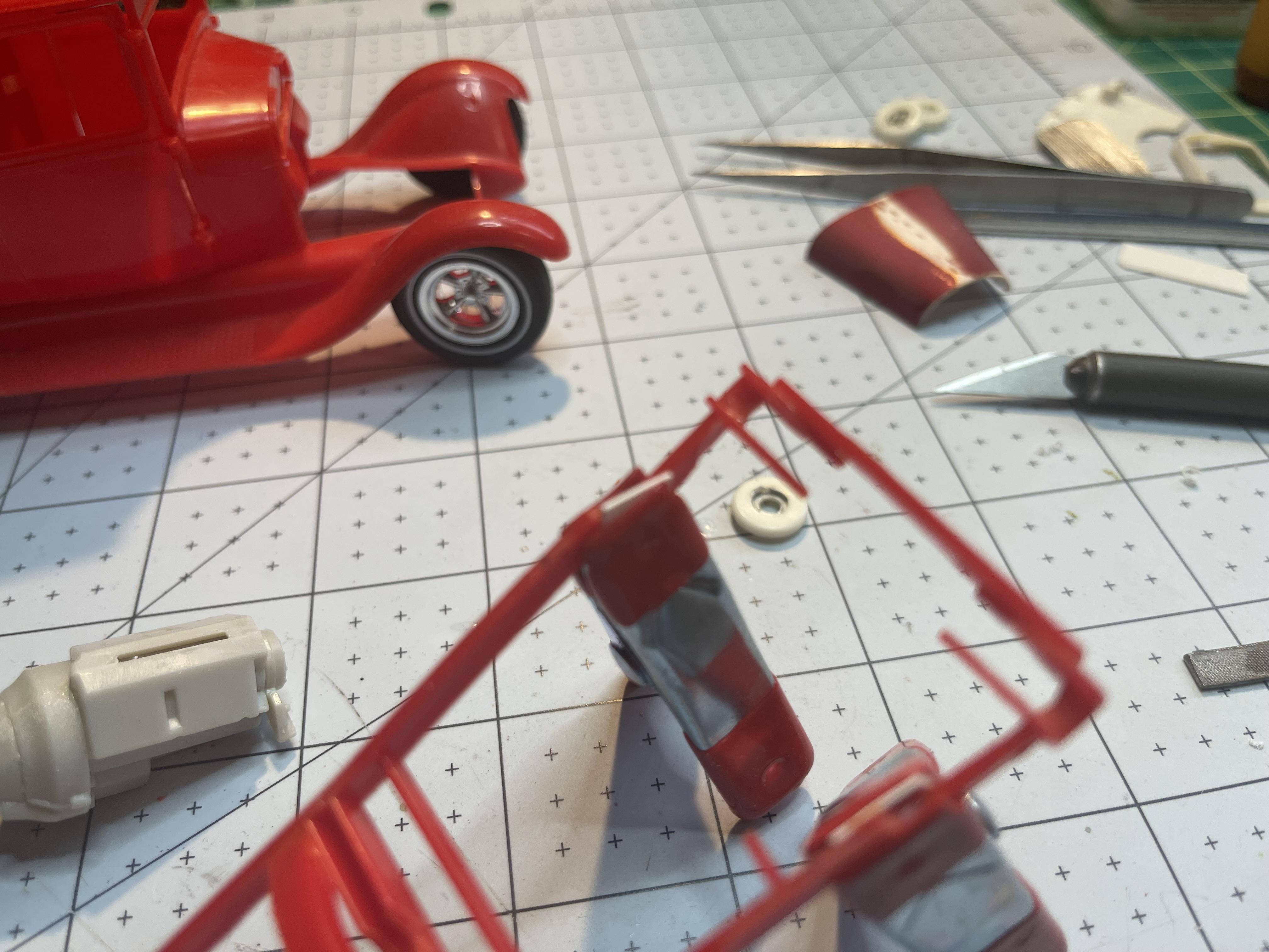

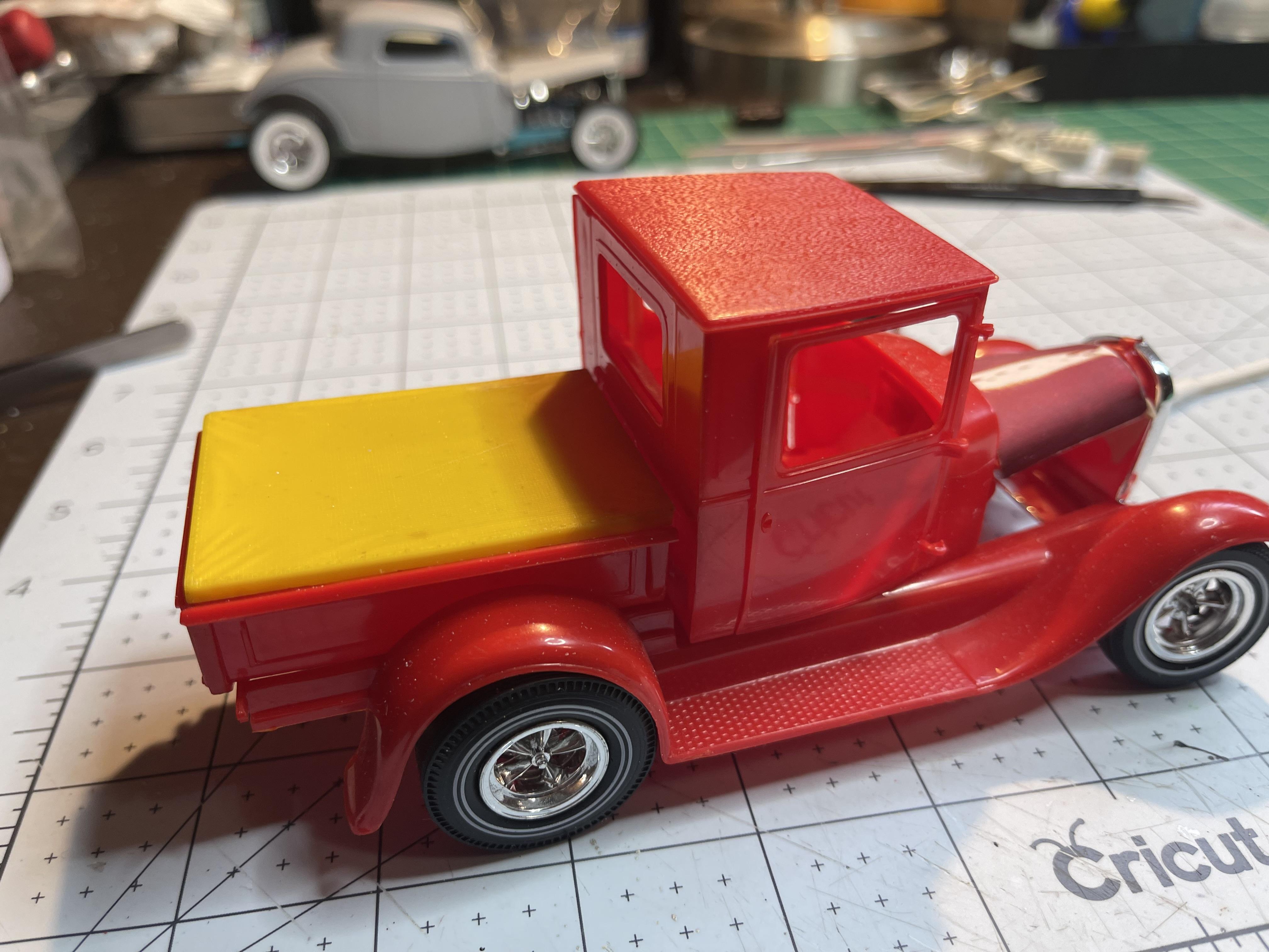

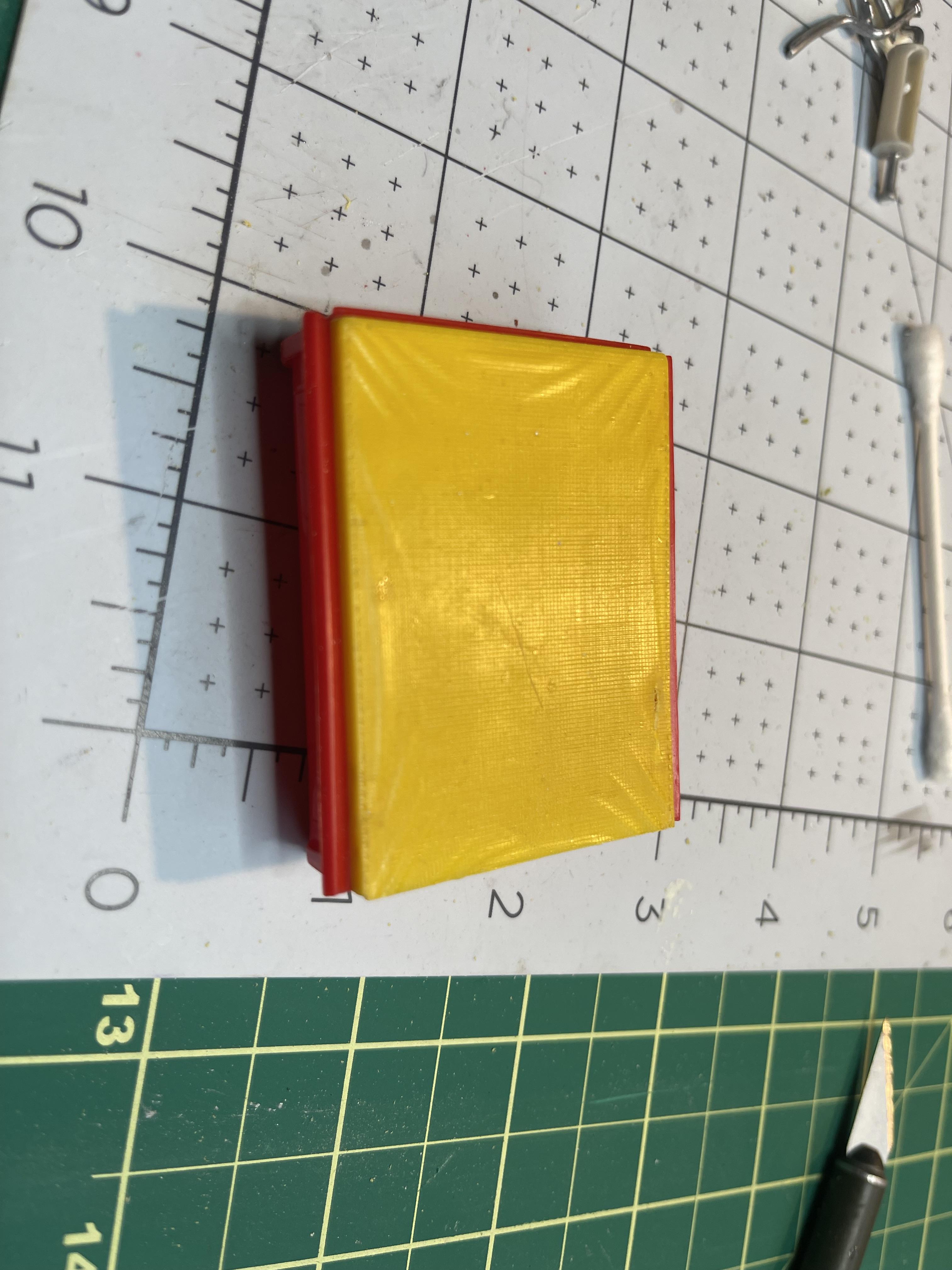

Bullybeef Posted August 31, 2024 Author Posted August 31, 2024 Rescued a tonneau cover from one of the old toylike lindberg( I think) 32 ford trucks. Not sure if I’ll end up affixing it or not but it will look good I think. Also started work on getting an amt 29 hood to fit and make it a smoothy one piece. 3
