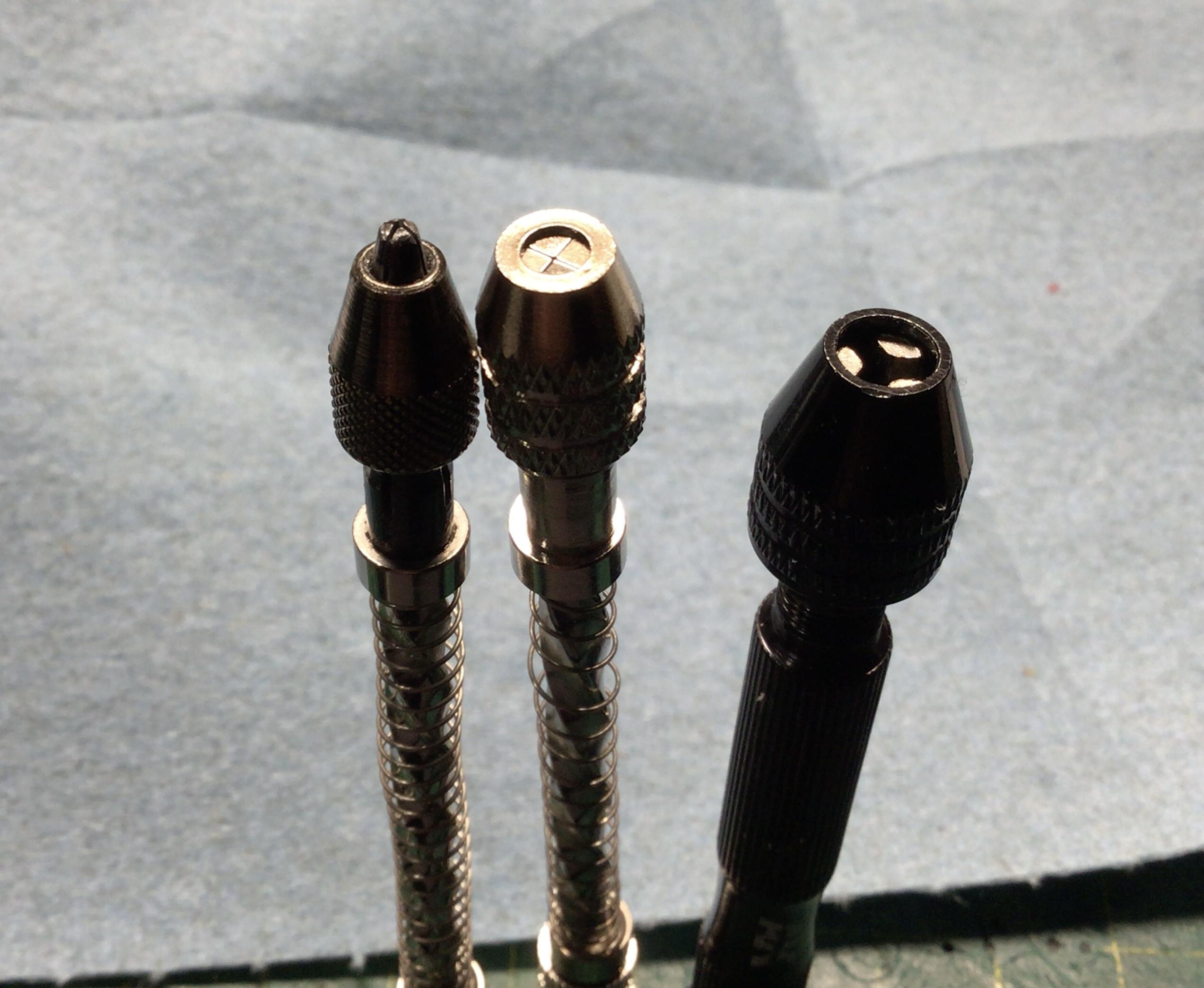

A better pic of the business end.? The drill on the left is my favourite (which looks similar to the one sold by Micro Mark) because of the slender jaws that protrude from the collet. It makes it a lot easier to see what you’re doing in tight spaces. The center one is a cheap Chinese one from Amazon. It worked Ok, but I wound up stealing the spring off it to repair the first one. The AK pin vise on the right is very nice too. The three jaw chuck is true and will hold from a #80 up to a 5/32” drill bit.

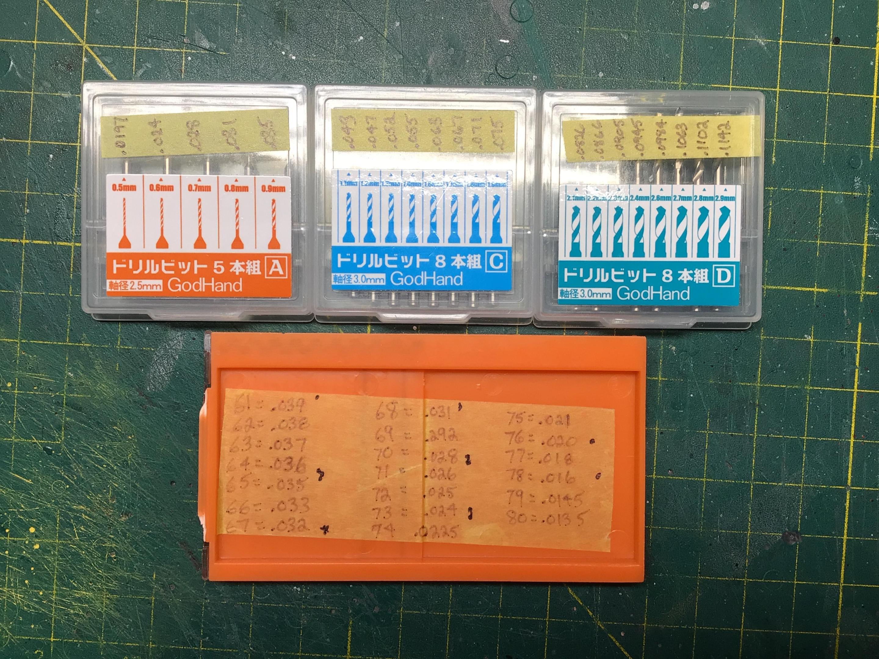

0.025”? Most of the Evergreen or Plastruct I use is Imperial sizes. That’s why I mark all the decimal equivalents on the cases. I never have to do the calculations again.?
Greg, you are definitely one of thee most organized builders. I always enjoy, and learn from your posts. I will screen shot this page “just in case” I need it in the future. ? I was born in the USA, grew up here in Canada, and went to school during the metric transition. I still prefer using metric for my hobby stuff, just simplifies it for me. Thanks for the info!
