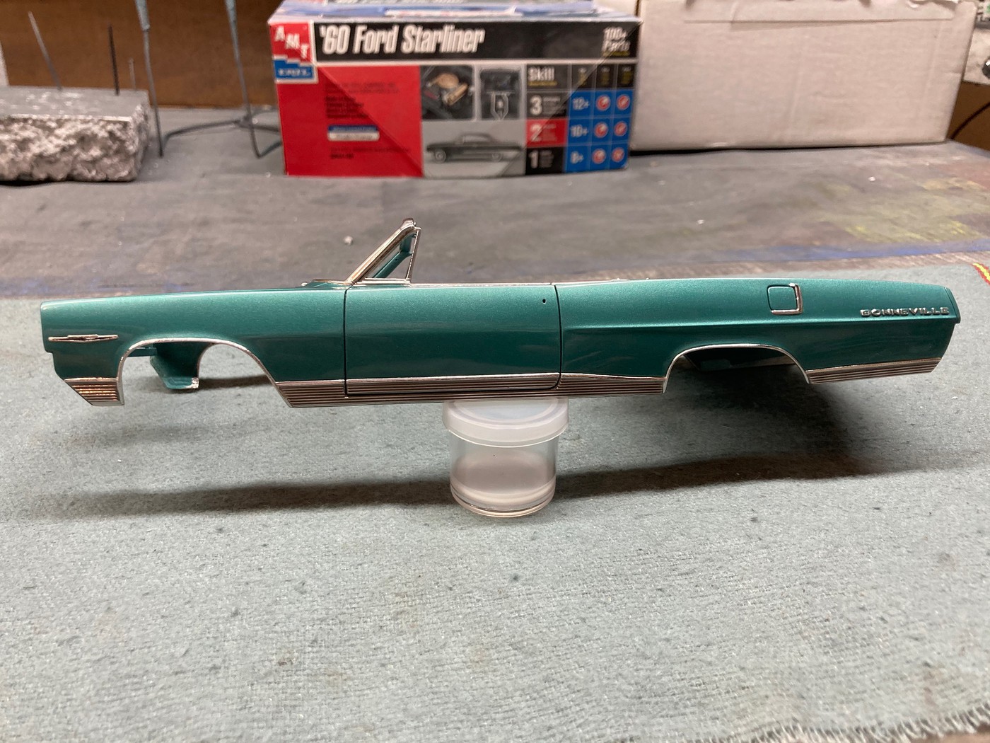

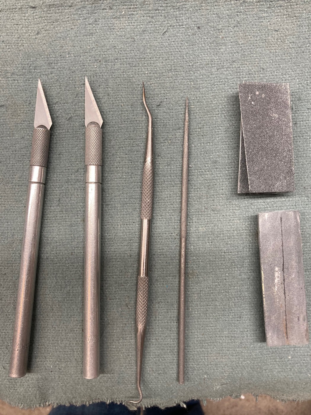

StevenGuthmiller Posted March 30, 2023 Posted March 30, 2023 (edited) I used to use a BMF scribing tool, but I found that I get better results with an old, dull, backwards #11 blade. The BMF scriber is too wide for a convincing panel line. My technique is as follows. Run a sharp #11 blade around the panel lightly a few times to give the dull blade something to dig into. Then I begin using the backwards blade, just a couple of inches at a time until I am about to the depth that I'm shooting for, then move on to the next couple of inches. Rounded corners are the most difficult, but as with any scribing tool, you just have to go slowly and lightly until the depth develops. Once I've finished with the #11 blade, I'll usually get down into the groove a little more with a sharp pointed dental tool, and possibly a pointed round file, just to clean things up a little. Finally, I'll lightly sand the edges of the groove to ease over the sharp edges a little. It's kind of hard to describe some of these steps, but I find that I can get a lot better job, a lot faster with the #11 blade, than I ever could with the scriber. The panel lines on the '64 Bonneville I'm working on were done in this fashion, and if I recall correctly, I don't remember the blade jumping out and scratching the body once. No darkening of the panel lines is required at all if you get them deep enough. I also do all of the body moldings in the same fashion to give them more depth and make them easier to foil. These are the tools that I use in order from left to right, with the second from the left "dull blade" doing the brunt of the work. (By the way, by a "dull blade" I mean that it actually has the very tip broken off) Steve Edited March 30, 2023 by StevenGuthmiller 1

Bills72sj Posted April 1, 2023 Posted April 1, 2023 Experience and finesse are the key. I use a #11 blade with just a smidgen of the tip broken off. You must start out slowly and with a light touch. You can get a little more aggressive as you progress. I bought a Tamiya scribing tool and made 2 off line gouges in the first five strokes. Once I settled down, I found the groove too wide for my liking. It will probably be used for something else some day. Scribing is a finessed skill. Practice on junk bodies. Panel liner after the fact is hit or miss so far for me. Too dark on lighter colors and sometimes goes/wicks where I do not want is to. Steve's results speak for themselves.

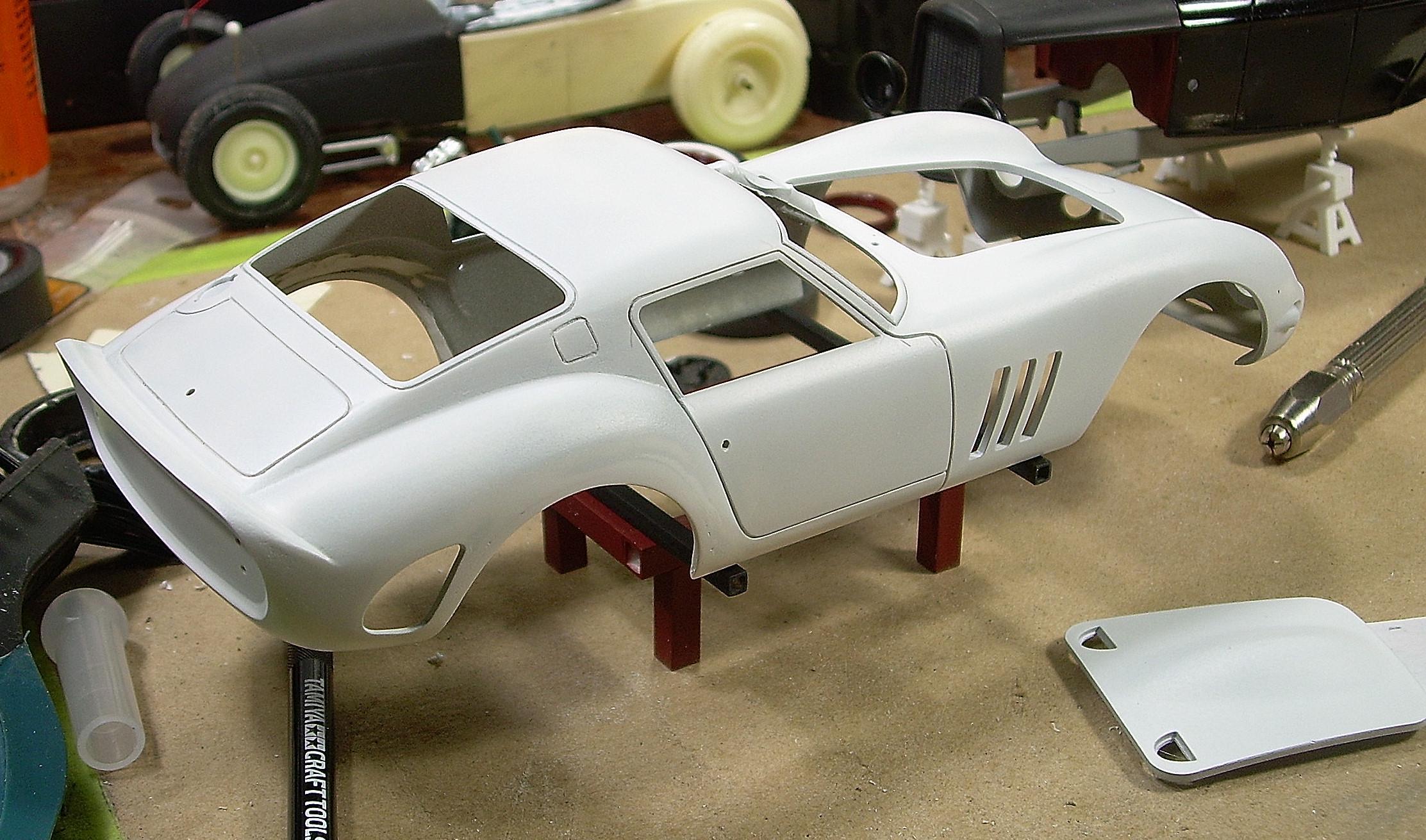

chepp Posted April 3, 2023 Posted April 3, 2023 Does anyone have panel scribing advice for a body made of a variety of materials? For example, a custom with these: Kit styrene and Evergreen styrene with liquid cement CA glue Filler putty (two-part such as Bondo) When building customs I've found it impossible because of the differing hardness of the material, especially when the filler is feather-edged to the styrene in the to-be-scribed area.
NOBLNG Posted April 3, 2023 Posted April 3, 2023 On 4/3/2023 at 2:47 AM, chepp said: Does anyone have panel scribing advice for a body made of a variety of materials? For example, a custom with these: Kit styrene and Evergreen styrene with liquid cement CA glue Filler putty (two-part such as Bondo) When building customs I've found it impossible because of the differing hardness of the material, especially when the filler is feather-edged to the styrene in the to-be-scribed area. Expand The only thing I can suggest is use a good quality, sharp scriber with a very light touch on all passes. Clamp a straight edge guide on for straight sections until you have a deep enough trench to freehand it. 1
Pete J. Posted April 3, 2023 Posted April 3, 2023 On 4/3/2023 at 2:47 AM, chepp said: Does anyone have panel scribing advice for a body made of a variety of materials? For example, a custom with these: Kit styrene and Evergreen styrene with liquid cement CA glue Filler putty (two-part such as Bondo) When building customs I've found it impossible because of the differing hardness of the material, especially when the filler is feather-edged to the styrene in the to-be-scribed area. Expand For sections crossing the boundaries of material types I recommend a good set of photo etched saws and a straightedge to get the groove started then scribe from there. I have been using Hasegawas saws for a long time. They have several different types that vary in thickness and tpi. Very adaptable. This is the fine set and yes they have teeth. You just have to look very closely. http://www.hasegawa-model.co.jp/hsite/wp-content/uploads/2014/03/tp4pk_th.gif
