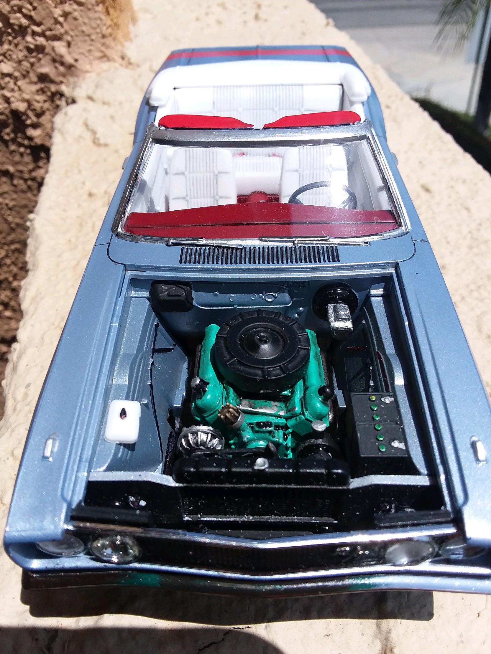

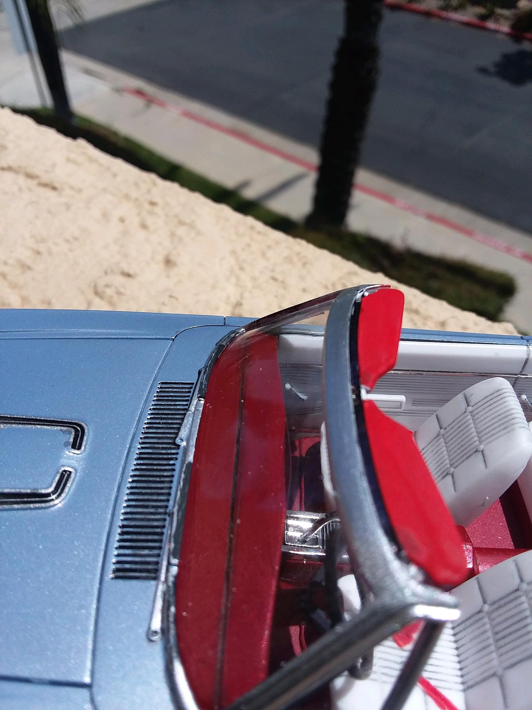

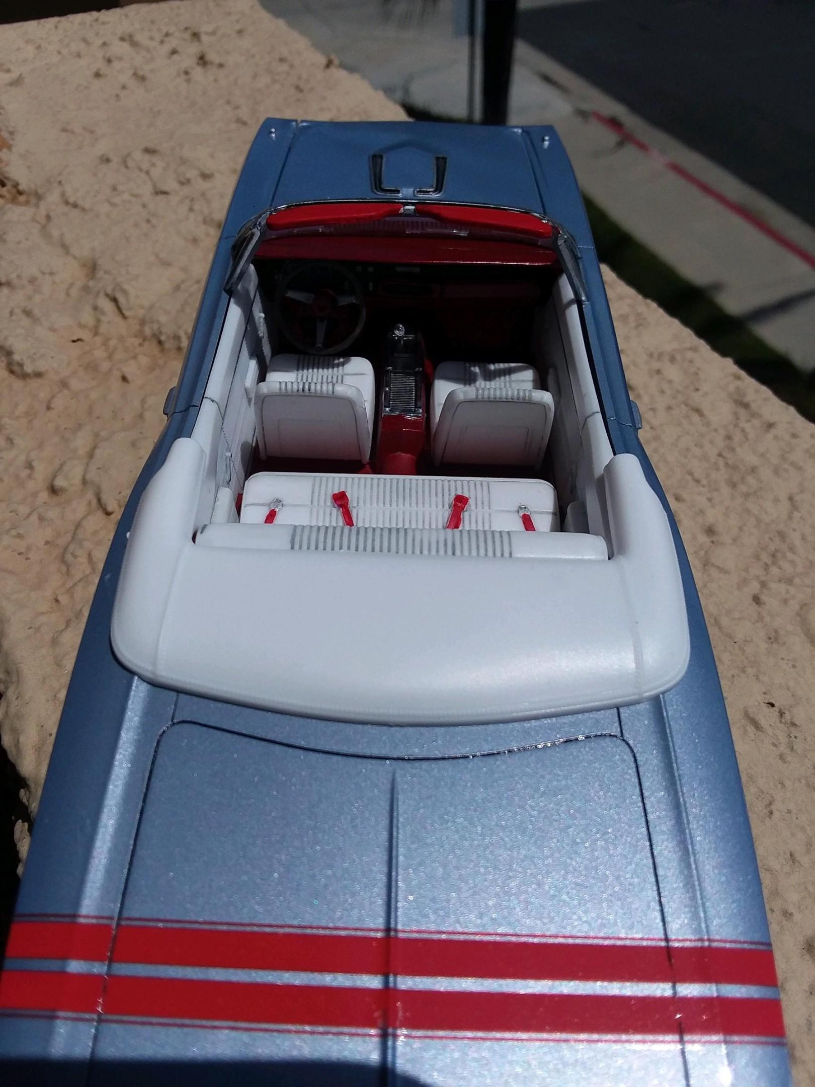

1972coronet Posted April 25, 2023 Share Posted April 25, 2023 MPC 1968 Coronet R/T Convertible Tamiya Light Blue Pearl (Mr. Surfacer primer base)Future/ Pledge Clear Tamiya Mica Red (red oxide primer base) on 'carpet', console, steering column, and dashboard; matt clear. Seats & Door Cards are natural white plastic; Tamiya Light Grey Panel Line Accent (overzealous) Convertible Boot is natural white plastic Tamiya Flat Red on sun visorsInline Tubing 'chrome' touch-up pen on windscreen frame ("dumped" some of the pen's contents into a plastic 'pallet', then brushed-on) I scratch built a brake master cylinder; results are okay -- better than the kit's incorrect 1966 & earlier version; rest is OOB. I'm going to chalk this one up as a learning curve (I have another unbuilt copy which I'll do better with... haha). Stance is too low OOB; I did nothing to 'correct' it. All in all, a fun kit ! Quite happy to have this one back, and in much better condition than the 1967 original. Thank you, Round2 ! Critiques and accolades welcome, as are ad hom. attacks . 8 Quote Link to comment Share on other sites More sharing options...

1972coronet Posted April 26, 2023 Author Share Posted April 26, 2023 I'd neglected to mention the (easy) modification I'd made to the dashboard: I marqued a line with tape side-to-side in order to create a separation between the dash frame and the dash pad. Using a jeweller's saw, I carefully cut a line along the marqued area. Then I taped the dash pad, and c-a-r-e-f-u-l-l-y planed the 'metal' part of the dash until it was just-below the 'pad'. I ran some Tamiya Black Panel Accent through the separation, then primed with grey primer. Then wet sanded the 'frame' to smooth it. Then it was on to the red oxide primer, followed by the Mica Red (aerosol). An easy modification that even a myopic simpleton like me can perform it. The only caveat is: be careful with the 'plaining' of the 'metal' portion, as the kit part is quit thin already. It's easy to burn-through if one's not careful. More detail-oriented folks can either : 1.) Add some P.E. defroster vents and speaker grille, or; 2.) Add that 'metal' part from one of the Revell 1968-1970 Charger kits (similar to how @StevenGuthmiller did with his (awesome) 1968 Coronet R/T Hardtop -- at the risk of presenting his masterpiece as being that simplistic). Quote Link to comment Share on other sites More sharing options...
