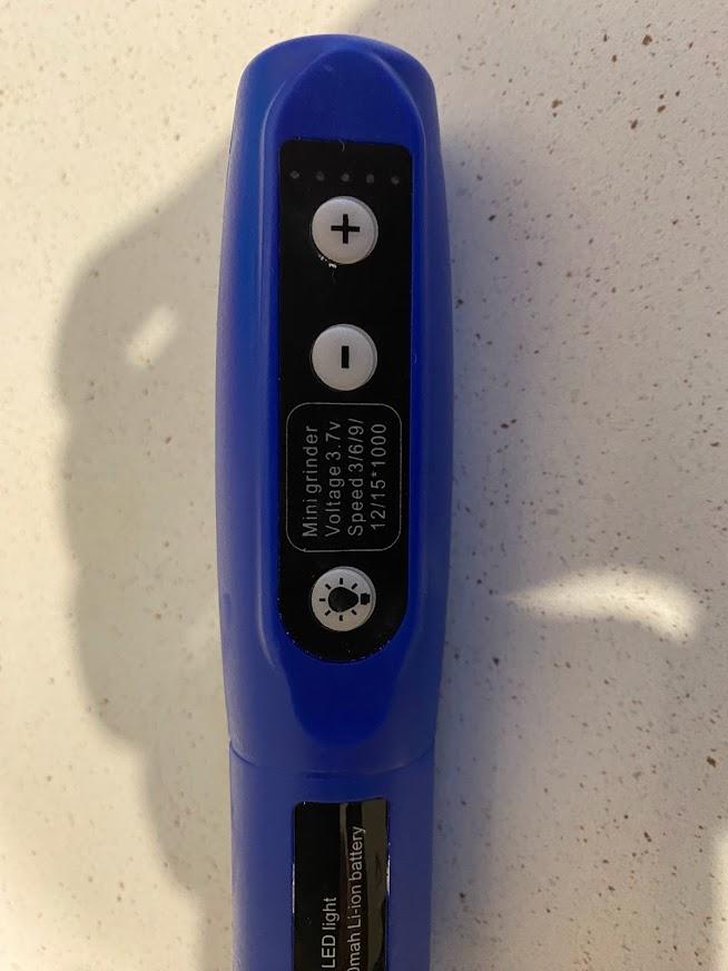

DaddyJ Posted May 9, 2023 Posted May 9, 2023 Hi all - I have recently become obsessed with a perfect polished finish for my models ? I have purchased a hobby rotary tool and follow the process below when it comes to polishing: 1. Sand with micromesh up 12000 2. Tamiya Polishing compound - Coarse, Fine, Finish (using polishing pads) 3. Mr Hobby ceramic compound (polishing cloth) 4. Final polish with rotary tool using Meguiar's carnauba wax Its a process I learned from the fantastic "Scale Model Experiment" you tube channel (check it out he is great). Unfortunately, when I complete the final polish with the rotatory tool it introduces scratches. Its very frustrating. Has anyone had an experience with this? I suspect its the head I am using, or is the tool too powerful? Can any one who has done this successfully recommend what type of heads to buy? I have attached a photo of the tool and head I use. FYI I am using Mr Hobby Super Clear as my clear coat (lacquer based) Thanks in advance! Andrew

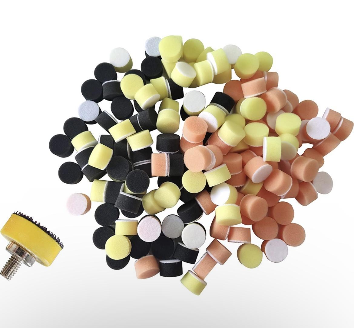

Dpate Posted May 11, 2023 Posted May 11, 2023 (edited) Well that clear is a soft clear as it’s not 2K. So you have to be careful, and use around 2-3K RPMs. I use these for polishing clear, the attachment part in the pic isn’t showing the 1/8 shank you’ll need for it to work with a dremel. Black pads can be use for wax as the black pads have no cut, and yellow is medium cut, and orange course cut. I use meguiers cleaner wax & ultimate compound for 2K. Edited May 11, 2023 by Dpate 1 1
ctruss53 Posted May 11, 2023 Posted May 11, 2023 50 minutes ago, Dpate said: Well that clear is a soft clear as it’s not 2K. So you have to be careful, and use around 2-3K RPMs. I use these for polishing clear, the attachment part in the pic isn’t showing the 1/8 shank you’ll need for it to work with a dremel. Black pads can be use for wax as the black pads have no cut, and yellow is medium cut, and orange course cut. I use meguiers cleaner wax & ultimate compound for 2K. I use these foam pads on a electric toothbrush. 1
DaddyJ Posted May 11, 2023 Author Posted May 11, 2023 1 hour ago, Dpate said: Well that clear is a soft clear as it’s not 2K. So you have to be careful, and use around 2-3K RPMs. I use these for polishing clear, the attachment part in the pic isn’t showing the 1/8 shank you’ll need for it to work with a dremel. Black pads can be use for wax as the black pads have no cut, and yellow is medium cut, and orange course cut. I use meguiers cleaner wax & ultimate compound for 2K. Nice thank you. I did suspect that the clear was “soft” (in my opinion it’s still a great clear though). I will look into getting those pads and keep experimenting. I have had a little bit more success since I posted this and suspect that the way I’m sanding may be a problem rather than the use of the rotary tool. Out of interest when sanding do you change direction after each grit? I sand in one direction the whole process…
