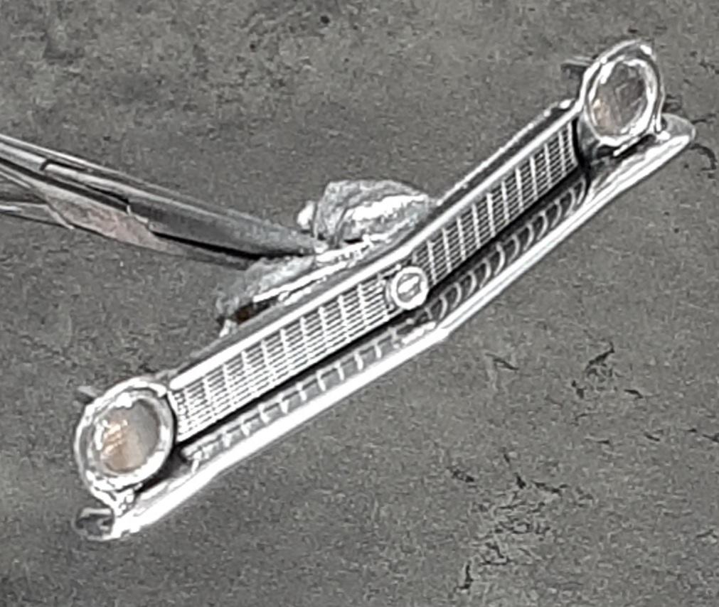

I painted an original issue MPC 1970 Challenger front bumper with Revell chrome about ten days ago.  Back in the day (er..that would be 1971...) I had partly removed the front bumper guards for a Pro-Stock project; so for this test I had to finish removing the bumper guards, then sand that area to a smooth finish as well as sand off all the remaining original plating.  The first round was 360 grit, followed by 500 and finished with 1500.
I then applied  a single, pretty heavy coat of Revell Chrom.  It flowed really nicely and gave a glass smooth appearance out of the  spray booth.  Looked equally good after a day (no sign of any sanding or mods to the part).  Yesterday (about 10 days after) it still looked just as smooth. So far no issues after light handling, and still a perfect finish.  No dehydrator in this case, and no clear coat.  Very, very encouraging.   At least so far.  Clearly superior to anything else I've tried.   TB
Update.  When installing the front bumper on the model (probably about 3-4 weeks after spraying it with chrome, the edges of the bumper showed discoloration from holding the bumper in place as the Five Minute Epoxy (main body was a resin rebop) dried.  So....looks like I will need to use ClearCoat in the future.  Tried to order SpaxStic Clear Chrome spray but they were sold out; did acquire it in airbrush form.  Area of bumper that was not touched during install still looks great.
You can see the discolored area on the portion of the bumper that faces the driver's side front...
Best....TIM

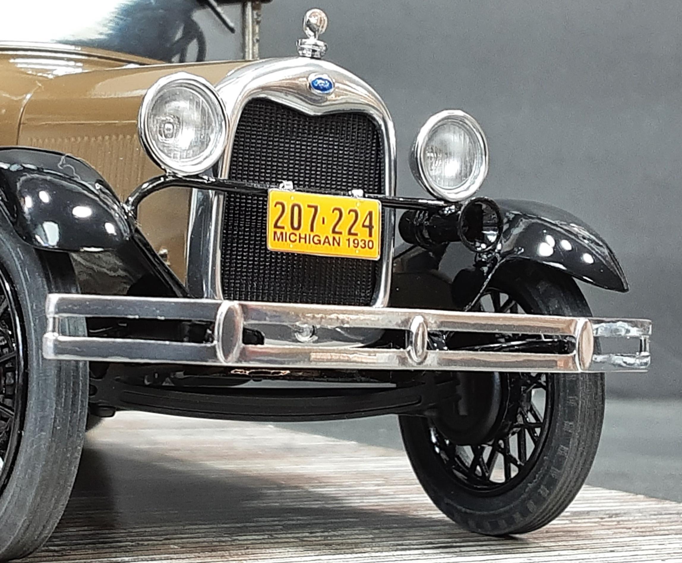

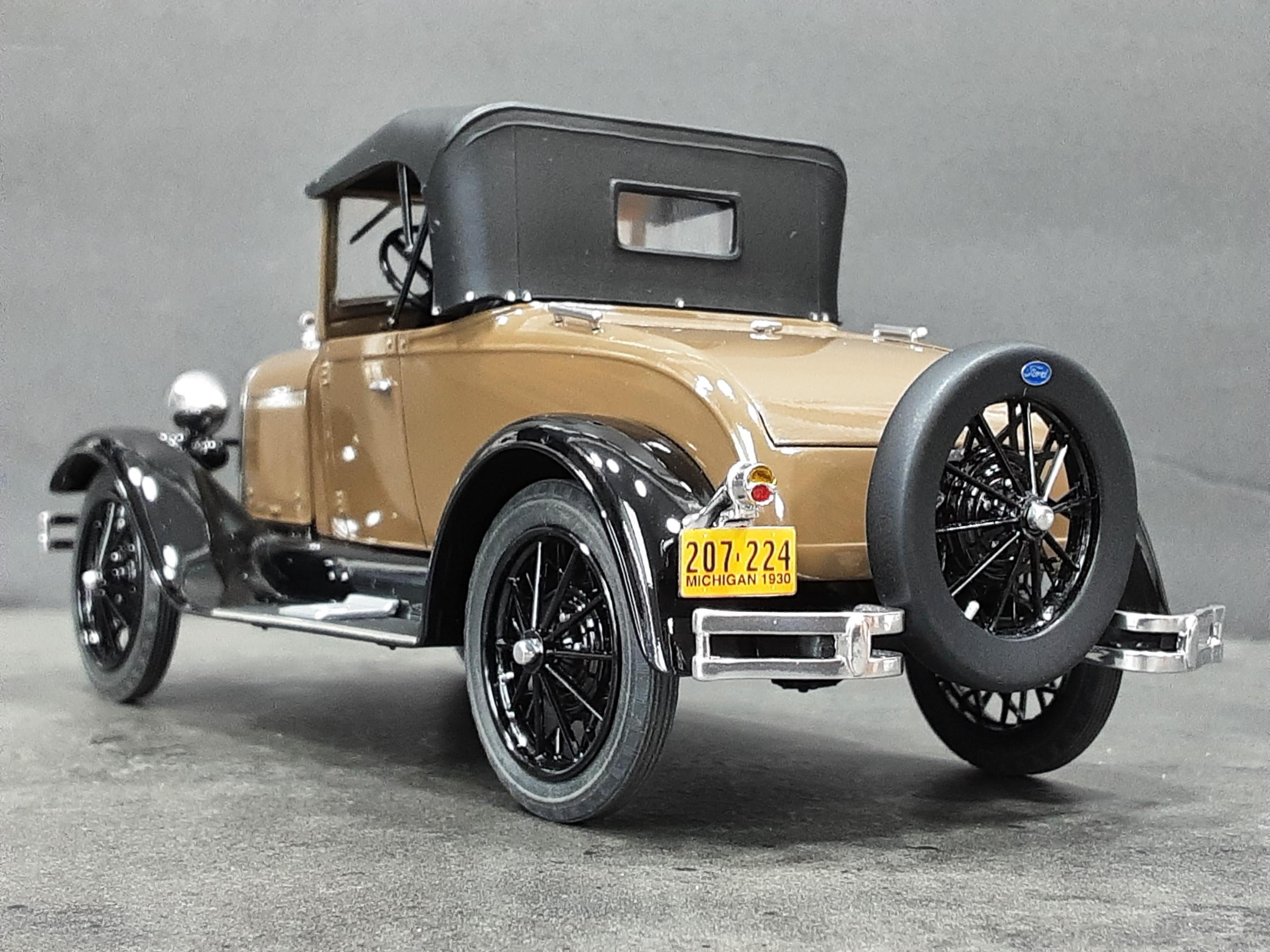

AMT '29 Ford roadster, stripped the chrome and shot it with Revell spray chrome. I use nitrile archival gloves when handling the "re-chromed" parts and have zero issues with marring the parts.
It's  shiny but looks more like nickel than chrome which in this case is OK as Hank used nickel plating on most of the shiny bits instead of chrome.
For what it's worth I prefer Green Stuff World Chrome for airbrush as it looks more like chrome and seems to be more durable than Revell Chrome and certainly not nearly as costly.

Thanks for the info...good suggestion on the nitrile gloves, too!  Cheers...TB
PS - that's a very, very sharp build of that old AMT kit!!!

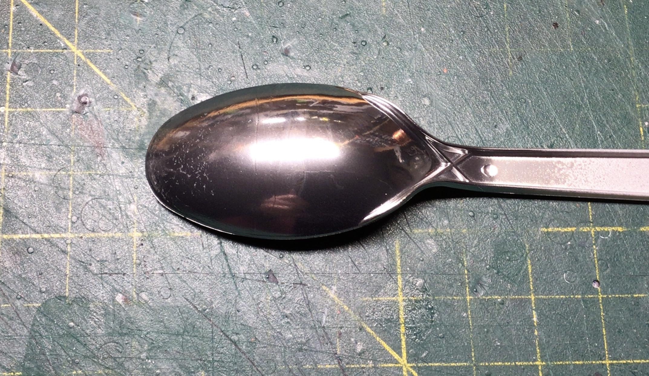

After Dave (yh70) recommended the Spax Stix clear, I grabbed a can this morning. I am optimistic about it. This spoon is coated with the Revell chrome paint and has been sitting in my dehydrator for weeks. I sprayed one light coat on the tip half of the spoon and then an hour later one heavy coat. The heavy coat seems to have maybe melted through and disturbed the chrome a bit? I think with the multiple LIGHT coats as suggested it would be fine. The shine of the chrome is hardly diminished in my eye. They also have it in bottles for airbrushing (10900).
Thanks Dave!
your welcome Greg..
