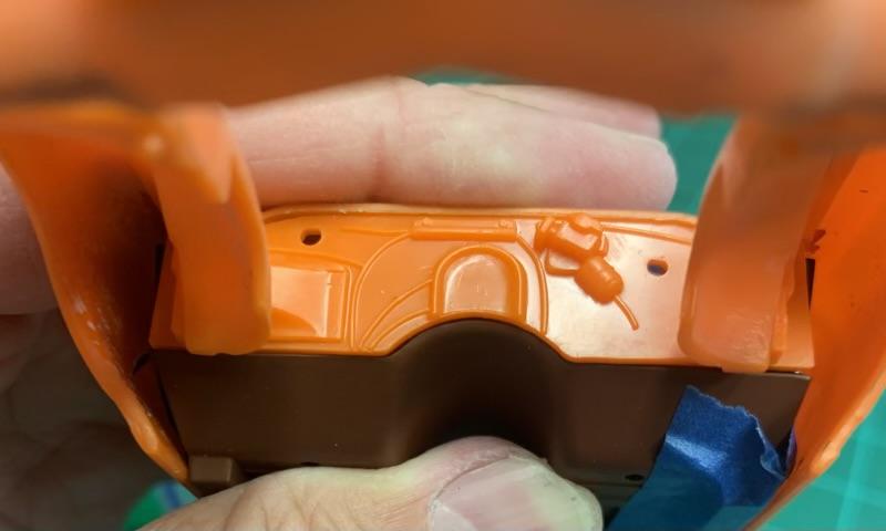

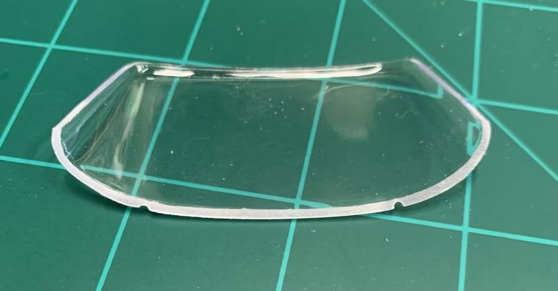

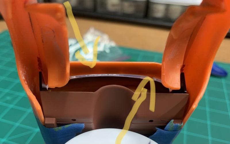

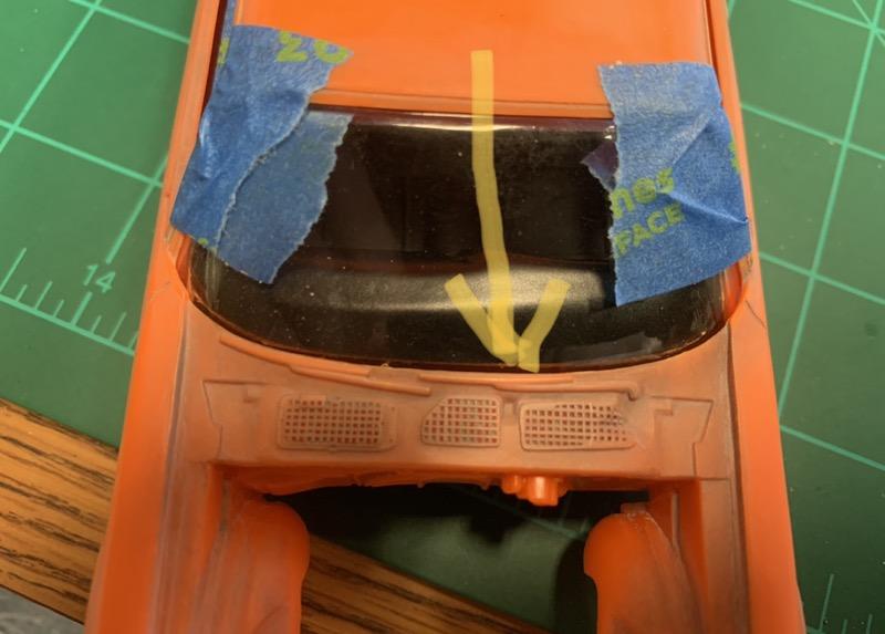

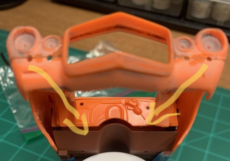

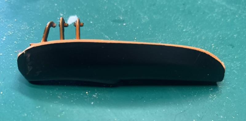

atomicholiday Posted June 21, 2023 Author Share Posted June 21, 2023 Just finishing work on the firewall gap. I referenced the thread mentioned above (thanks very much!) plus another one I found, for this fix. I know it’s all been done and documented before but I’ll post it here to in case maybe it will be of use to someone down the road. If you’re unaware of this problem, here’s what it looks like when you start. Notice the huge gap where the firewall meets the floor pan. Here’s a shot of the root cause. Interference between the windshield and dashboard. The first thing I did was file the lower edge of the windshield even with the inside of the body. It sticks down just enough to interfere with the door panels. I think you could get away with just removing material at the corners, but I leveled the whole windshield in hopes of resolving the entire issue. But that by itself didn’t do the trick. The dashboard will still interfere. Next, I filed off the offending edge of the dashboard. Note the missing gas pedal and bent e-brake? Looks like I have some repair work to do. If you go this route, I recommend going slow and test fitting frequently. I kept at it until the gap at the firewall/floor pan was closed. Hardest part about it was the test fitting. Squeezing that floor pan into the body repeatedly gets old quick. I highly recommend doing this before you paint anything, especially the body. Here is what it should look like when you finish this step. Question for those that have built this kit before. One thing I noticed after all this. Looking through the windshield down at the back edge of the dashboard, there’s a visible gap now. Not sure how I could have avoided this and still close the gap. Did you guys have that too? I don’t think it will be noticeable after some touch up, but still…🤔 As always, questions, comments, & criticism are welcome. 2 Quote Link to comment Share on other sites More sharing options...

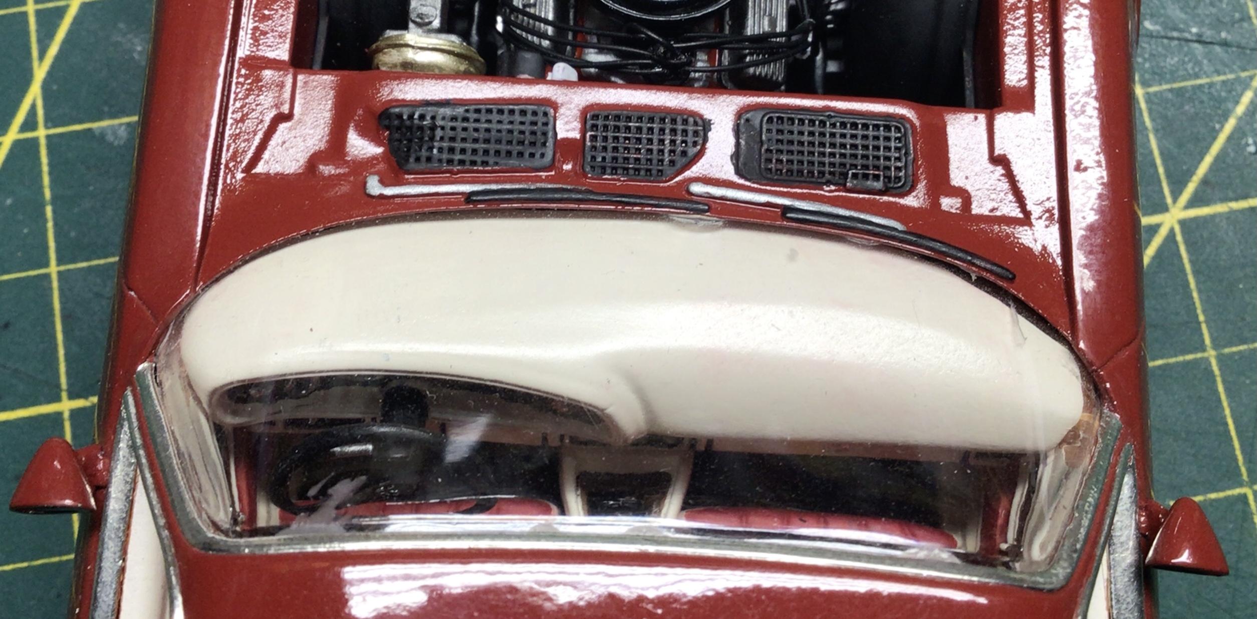

NOBLNG Posted July 3, 2023 Share Posted July 3, 2023 (edited) On 6/21/2023 at 4:21 PM, atomicholiday said: Question for those that have built this kit before. One thing I noticed after all this. Looking through the windshield down at the back edge of the dashboard, there’s a visible gap now. Not sure how I could have avoided this and still close the gap. Did you guys have that too? I don’t think it will be noticeable after some touch up, but still…🤔 Good work so far.👍 There is no real gap on mine, but I ground down my windshield after it was glued in place. There is a slight gap on the passenger side, but I think that is from trimming the dash slightly.😕 Is your interior and floor pan far enough forward? Edited July 3, 2023 by NOBLNG 1 Quote Link to comment Share on other sites More sharing options...
slusher Posted July 6, 2023 Share Posted July 6, 2023 On 6/21/2023 at 4:21 PM, atomicholiday said: Just finishing work on the firewall gap. I referenced the thread mentioned above (thanks very much!) plus another one I found, for this fix. I know it’s all been done and documented before but I’ll post it here to in case maybe it will be of use to someone down the road. If you’re unaware of this problem, here’s what it looks like when you start. Notice the huge gap where the firewall meets the floor pan. Here’s a shot of the root cause. Interference between the windshield and dashboard. The first thing I did was file the lower edge of the windshield even with the inside of the body. It sticks down just enough to interfere with the door panels. I think you could get away with just removing material at the corners, but I leveled the whole windshield in hopes of resolving the entire issue. But that by itself didn’t do the trick. The dashboard will still interfere. Next, I filed off the offending edge of the dashboard. Note the missing gas pedal and bent e-brake? Looks like I have some repair work to do. If you go this route, I recommend going slow and test fitting frequently. I kept at it until the gap at the firewall/floor pan was closed. Hardest part about it was the test fitting. Squeezing that floor pan into the body repeatedly gets old quick. I highly recommend doing this before you paint anything, especially the body. Here is what it should look like when you finish this step. Question for those that have built this kit before. One thing I noticed after all this. Looking through the windshield down at the back edge of the dashboard, there’s a visible gap now. Not sure how I could have avoided this and still close the gap. Did you guys have that too? I don’t think it will be noticeable after some touch up, but still…🤔 As always, questions, comments, & criticism are welcome. This is real helpful information,! 1 Quote Link to comment Share on other sites More sharing options...
atomicholiday Posted July 6, 2023 Author Share Posted July 6, 2023 On 7/3/2023 at 4:46 PM, NOBLNG said: Is your interior and floor pan far enough forward? It's possibility out of position a little. Test fitting was pretty difficult. I'll be watching that very carefully during final assembly. Thanks for the suggestion. Quote Link to comment Share on other sites More sharing options...
atomicholiday Posted July 6, 2023 Author Share Posted July 6, 2023 5 hours ago, slusher said: This is real helpful information,! Thanks Carl. This thing has been a bit of a beast so far. But I'm hopeful that it comes out nice in the end. It's just such a cool car! Quote Link to comment Share on other sites More sharing options...

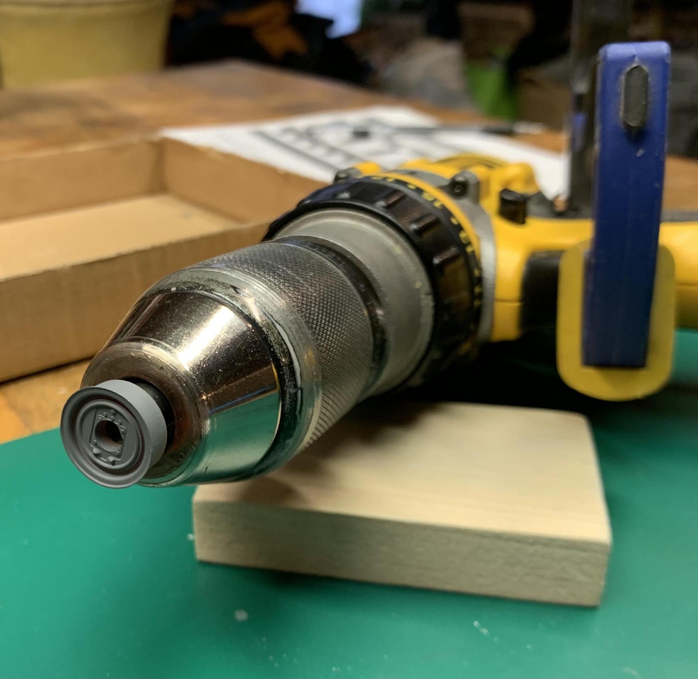

atomicholiday Posted October 29, 2023 Author Share Posted October 29, 2023 I got back to this one for a while this afternoon. Did a little work to the wheels. Like to use a drill on a very low speed to get clean circular lines when doing this type of stuff. wheel backs before… …and after. I used the same technique on the other side. And while I was at it, I did the trim ring on this set for another project. These didn’t come out as clean as I wanted. I’ll think about it for a while, but I might redo them. 5 Quote Link to comment Share on other sites More sharing options...
Rattlecan Dan Posted October 30, 2023 Share Posted October 30, 2023 Wow, such diligence, perseverance and dedication. Gotta' equal great success! Great encouragement to us slackers. 1 Quote Link to comment Share on other sites More sharing options...
Zippi Posted October 30, 2023 Share Posted October 30, 2023 Those wheels look pretty good using the drill. Pretty kewl. 1 Quote Link to comment Share on other sites More sharing options...
