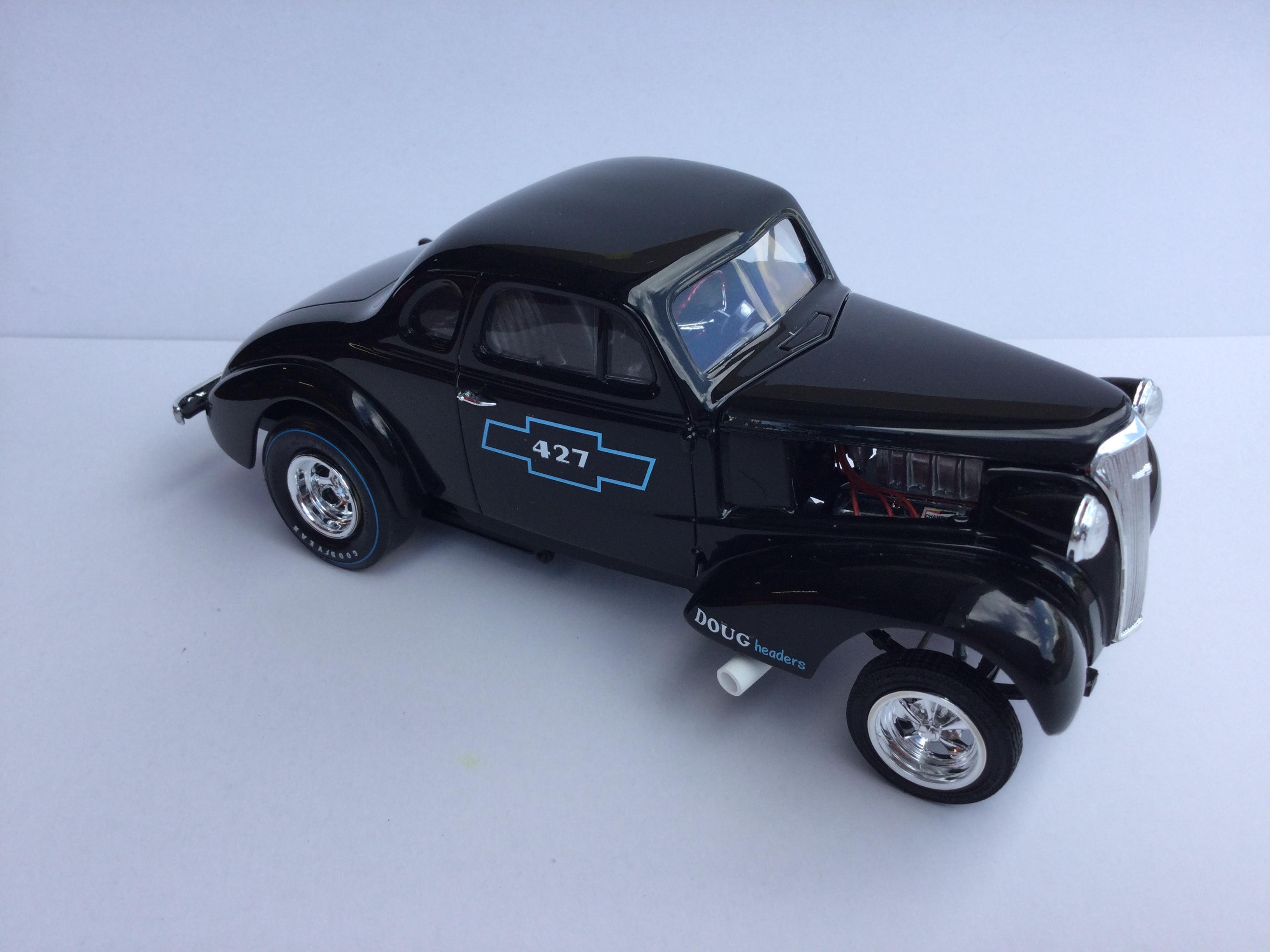

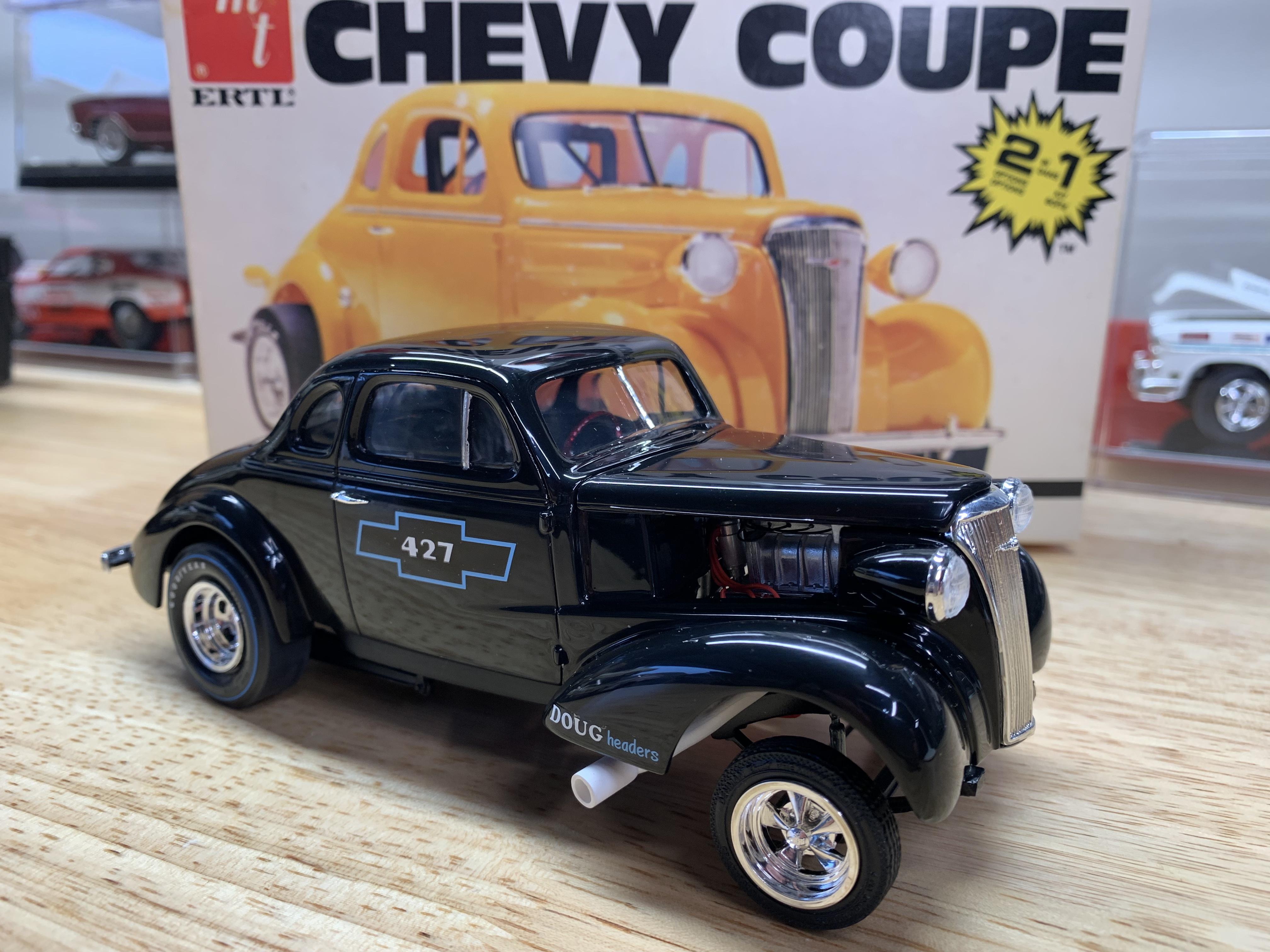

dragcarz Posted June 25, 2023 Posted June 25, 2023 I’m calling this one finished. It’s not perfect but for the most part I’m satisfied with it. I learned a lot about this kit during the building. Some experimenting went on with this one. Windshield needed the bottom trimmed as the interior didn’t fit and now the chassis isn’t squared with the body so the front right tire isn’t sitting on the ground. I added the headlights after painting, big mistake as the attachment points were buried in paint, and it made placement really hard. The superglue I used to mount the door handles fogged the black paint. Comments, criticism welcome. Thanks for looking. 13
carrucha Posted June 25, 2023 Posted June 25, 2023 Sweet gasser. Nice black paint job. I like how the blue in the decals matches the slicks.
Zippi Posted June 25, 2023 Posted June 25, 2023 Great build Roger. The blue line tires and the blue on the decals just brings it all together. Nice detail work.
Rattlecan Dan Posted June 25, 2023 Posted June 25, 2023 That came out really Nice! Smooth and clean. Good job. Thanks for posting.
M W Elky Posted June 26, 2023 Posted June 26, 2023 A great rendition of my favorite Chevy gasser of of amt’s finest kits
larman Posted June 26, 2023 Posted June 26, 2023 Nice job! I like the engine mods you did, a big improvement over the kit parts!

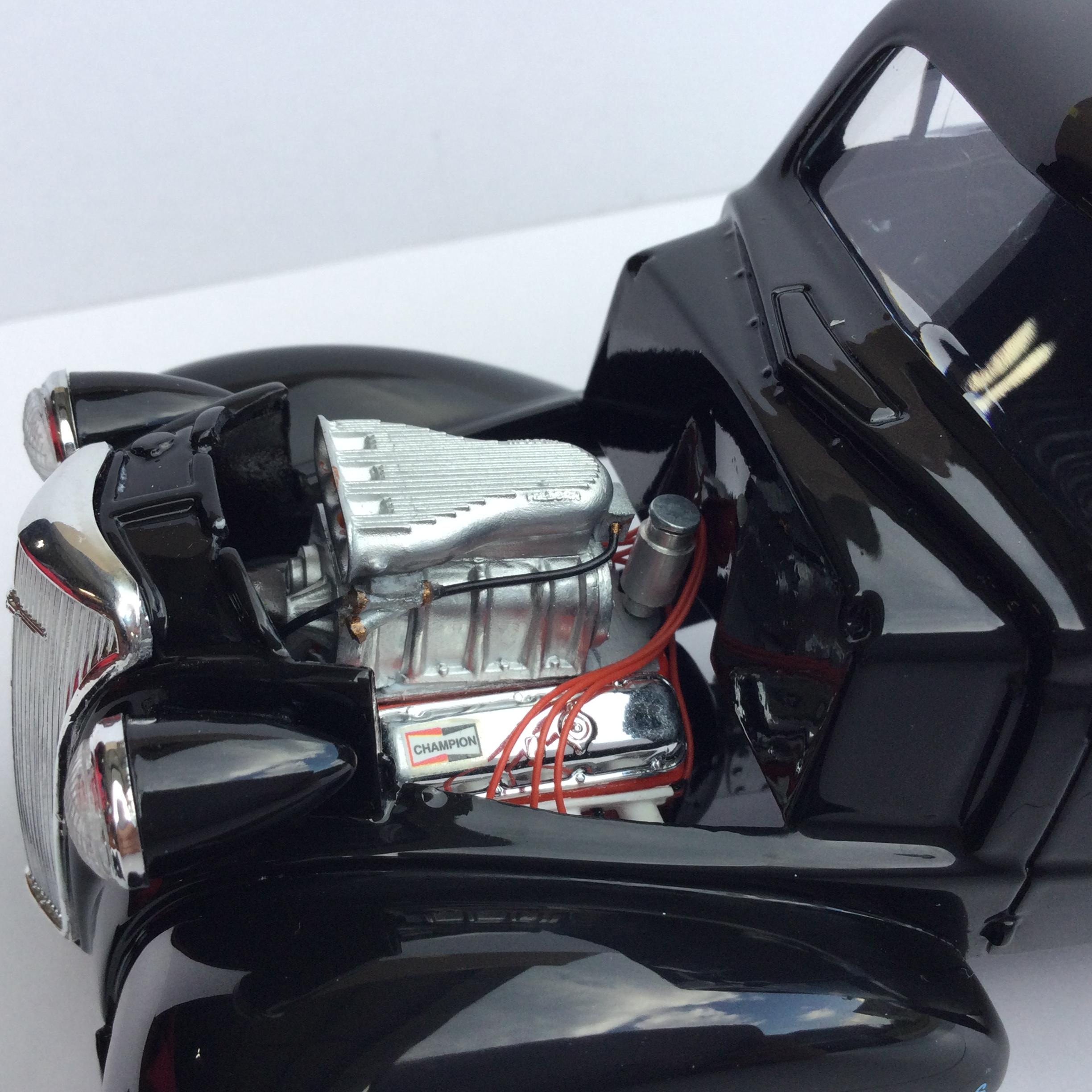

dragcarz Posted June 27, 2023 Author Posted June 27, 2023 On 6/25/2023 at 9:03 PM, larman said: Nice job! I like the engine mods you did, a big improvement over the kit parts! Thanks Larry, most of the engine is kit parts, I sanded the ribs off the oil pan ,swapped the injector from the parts box and valve covers from the Revell 67 Chevelle kit.
echo Posted June 29, 2023 Posted June 29, 2023 Nicely done, the '37 Chevys make nice gassers and yours is no exception, clean building style and paintwork. You as the builder see the flaws but to me it's a very nice model.
James2 Posted July 2, 2023 Posted July 2, 2023 Outstanding rendition, that paint it smooth, and you added just enough detail. Well done...

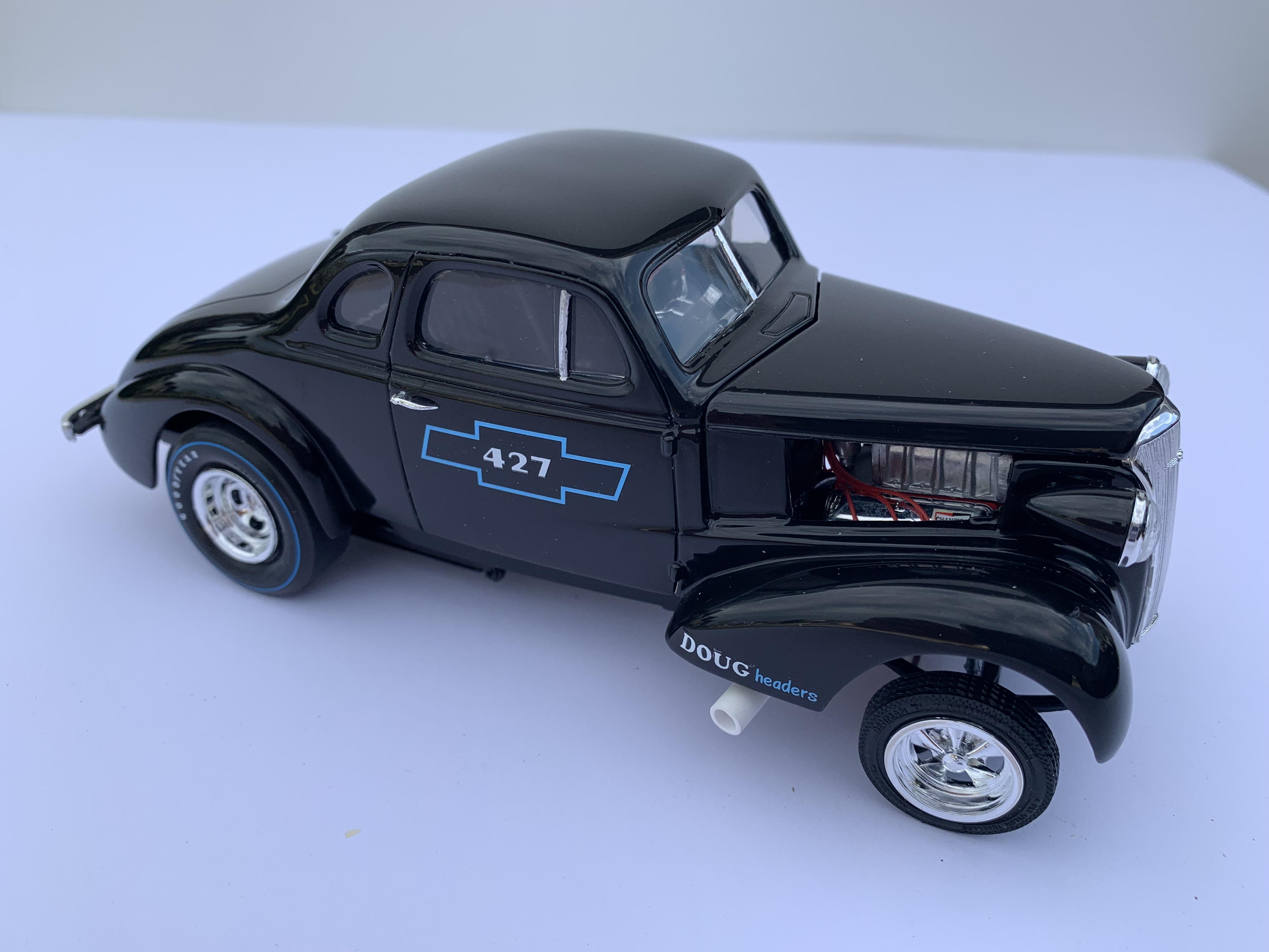

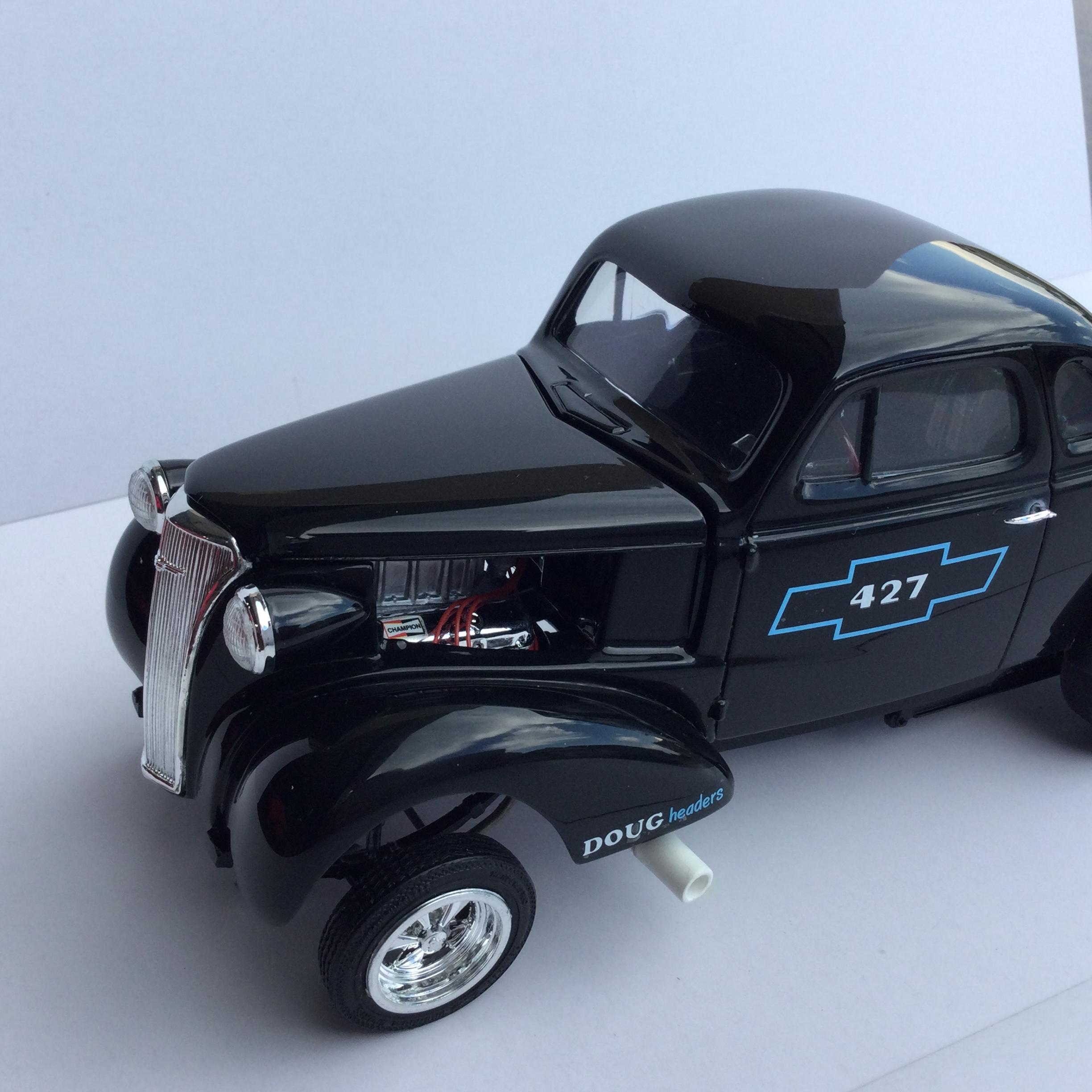

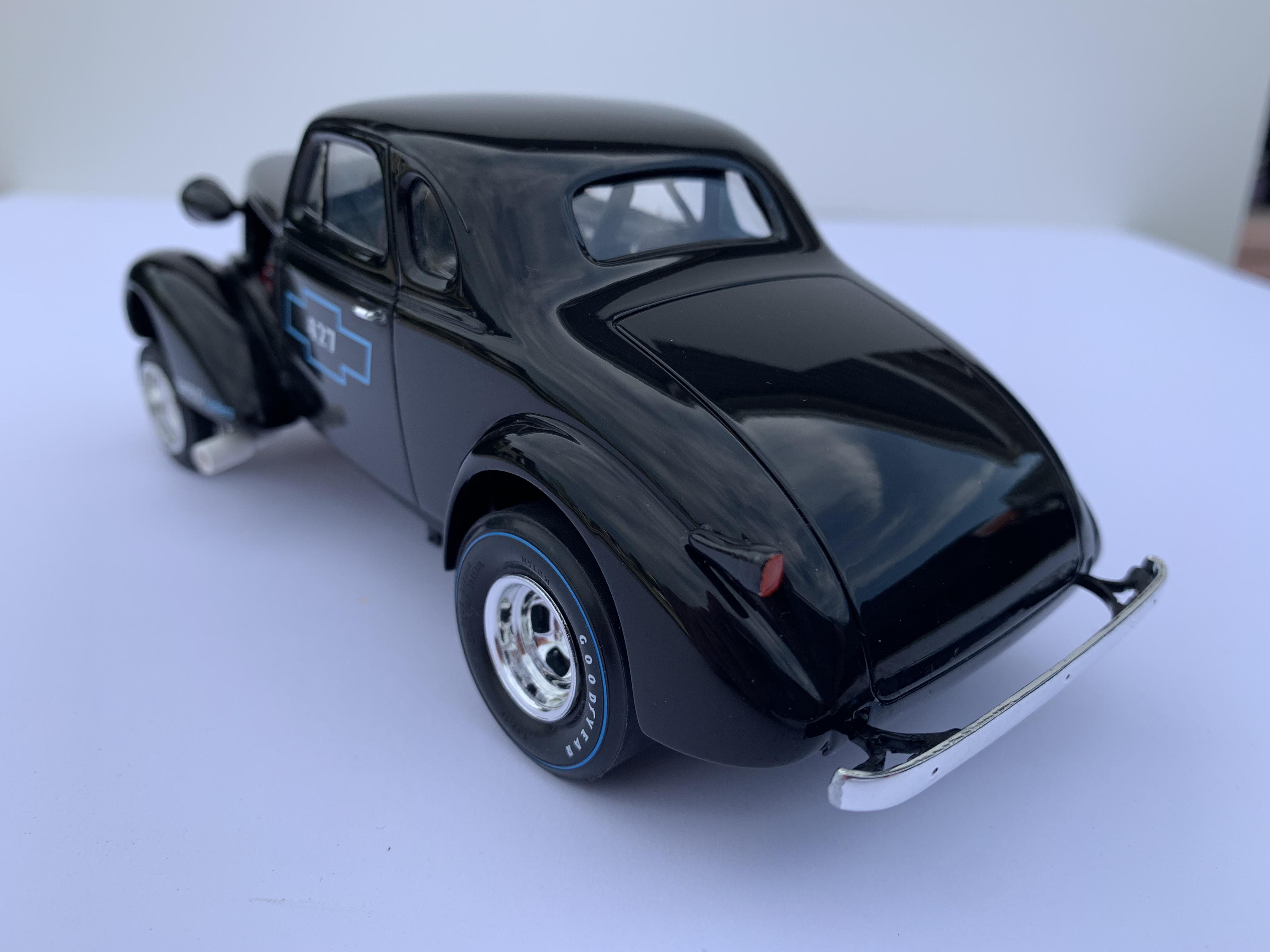

dragcarz Posted July 9, 2023 Author Posted July 9, 2023 I came across a couple more shots of the 37. 2
customline Posted July 10, 2023 Posted July 10, 2023 Roger, this thing is awesome. You can paint, sir! You should be very proud of this gorgeous gasser. CONGRATS! When I have items like those headlight pods or mirrors and handles that must be attached post paint, I will pre-drill the body before paint and use .020 brass wire to "pin" them on afterward (just run the bit through the holes to clean out the paint.) That way you get a good positive attachment using only the tiniest bit of CA. If I can drill it, I pin it. Mirrors and handles can be tricky but if the item is big enough to drill with a #75 bit, you're in business. (You can go smaller if you have those small bits but I can't keep those below #75 - I just break them ?.) I will also do this with rear spoilers too. Try it! 1
dragcarz Posted July 10, 2023 Author Posted July 10, 2023 Thanks Jim, I’m going to start pinning more of my parts. I thought the location marks for the headlights would show through the paint and while one was faint,the other disappeared. Same for the tail lights, the instructions said to drill out the holes indicated under the body, but there were none. There was locating holes for the door handles which I really appreciated. A little more prep before painting would save me a lot of headaches. Thanks for the advice!
