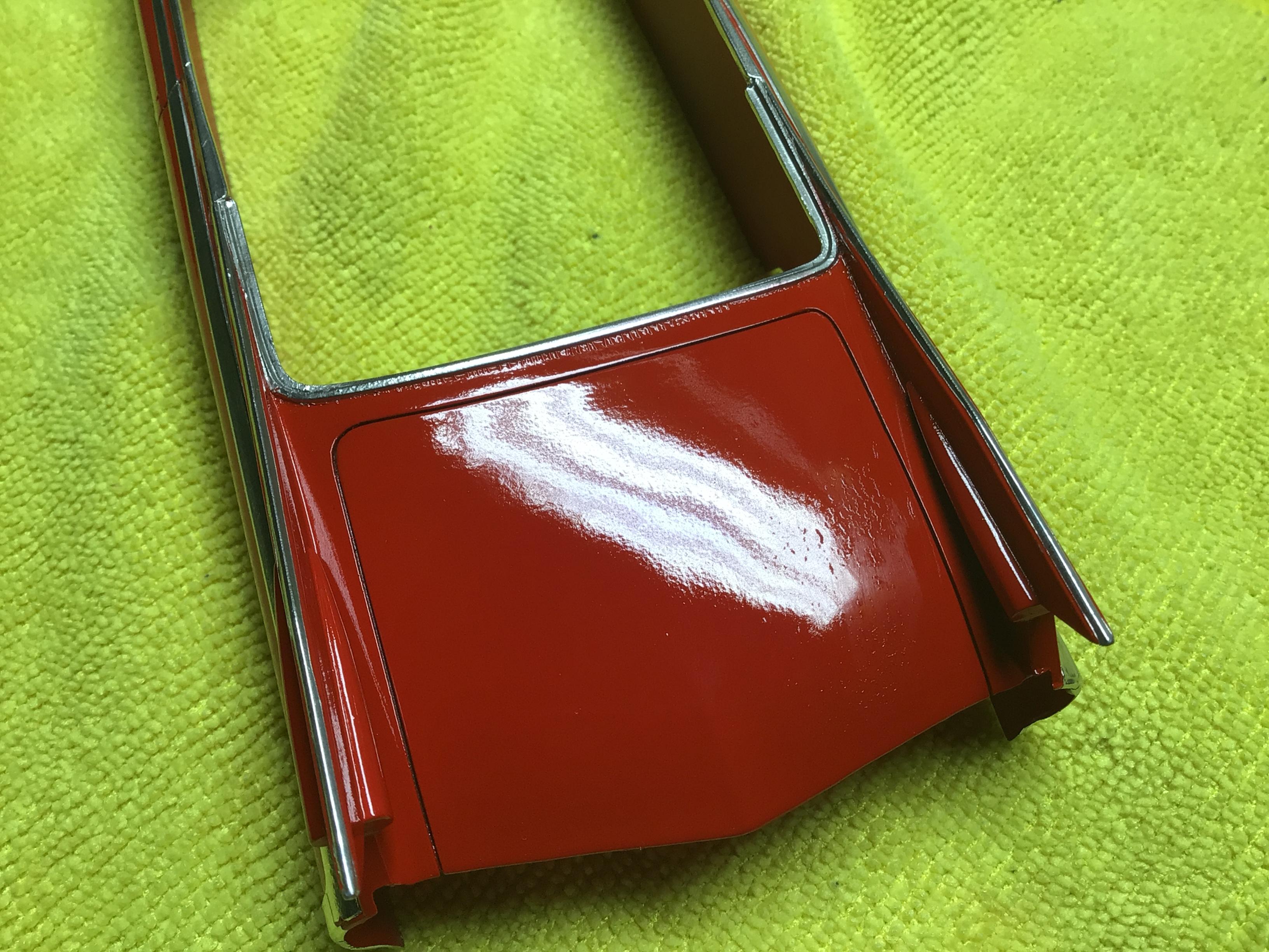

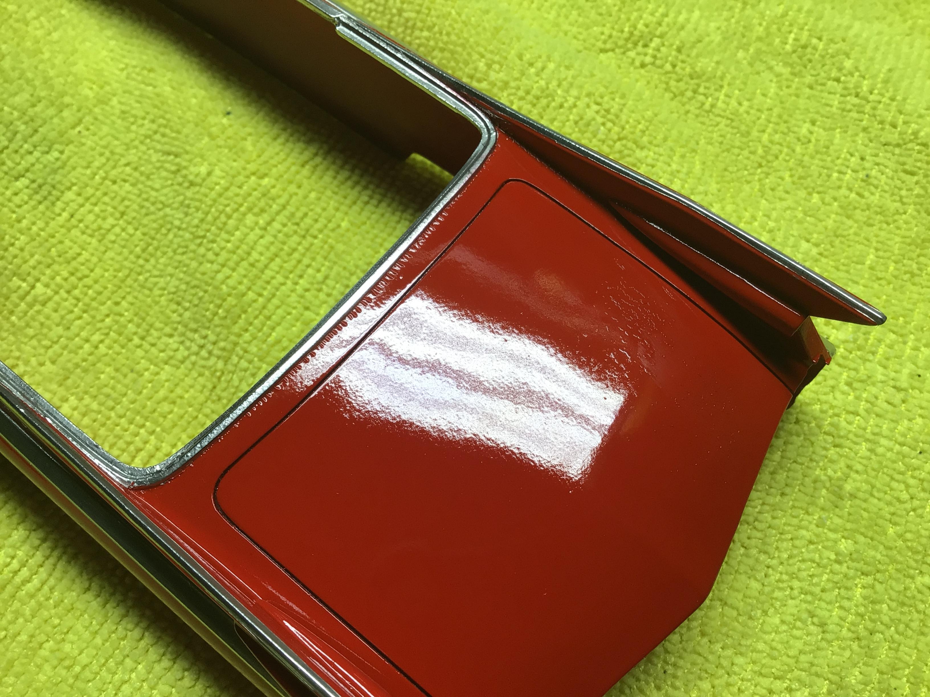

NOBLNG Posted July 19, 2023 Posted July 19, 2023 (edited) 4 hours ago, ctruss53 said: I use Mr Super Clear UV Cut gloss clear from Mr Hobby. It is a lacquer, and I can't explain the chemistry, but it has worked over everything I have sprayed it on. Having said that I have not applied it over enamels, because I don't use them. But it works over acrylic and lacquer paints. And it also works over decals. The can says not to use it over decals. You may have gotten lucky? 3 hours ago, StevenGuthmiller said: If it works over decals, chances are very good that it'll work over enamel. Steve This is the UV Cut clear over enamel. 99% of it worked fine though. Edited July 19, 2023 by NOBLNG
