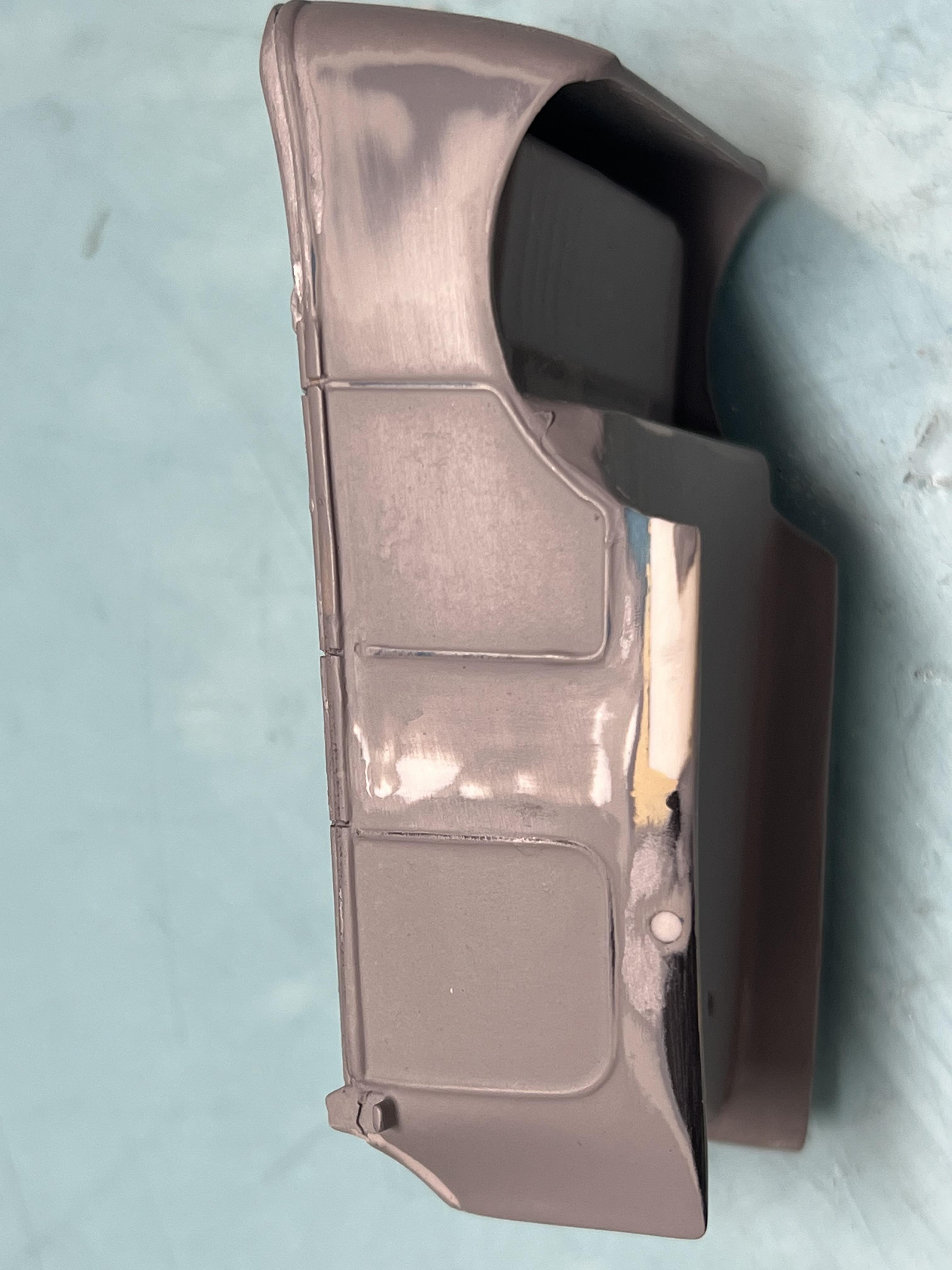

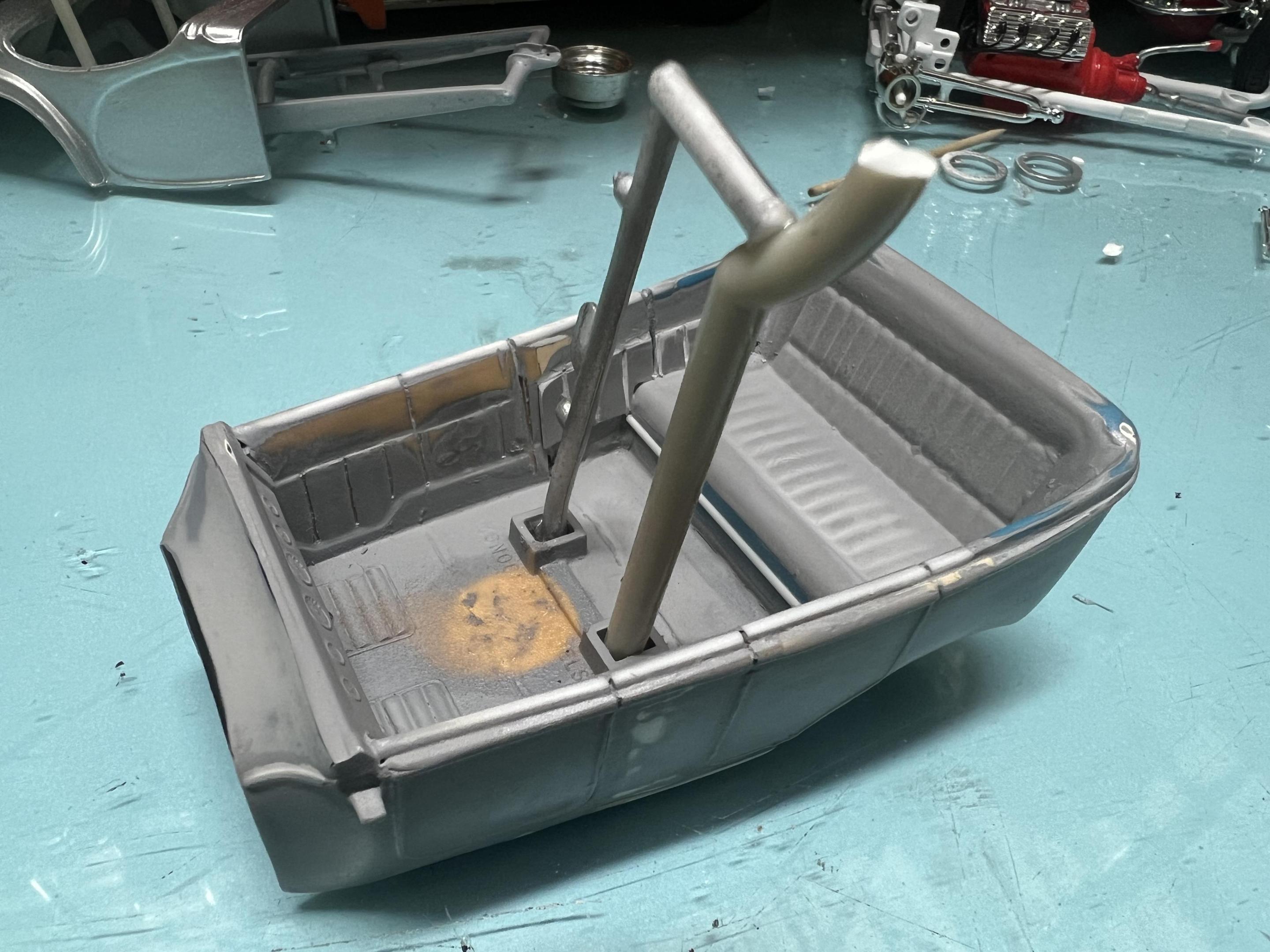

I was first inspired by seeing a similar conversion in the first ever Scale Auto Enthusiast contest annual in the early eighties. I recall that it was built by a Swedish modeller.  I started it about four years ago when I came across a spare Monogram T bucket body and a spare Revell 27 T touring body. Some will notice that this body looks different to the real Big Tub from Monogram and there is a good reason for that.

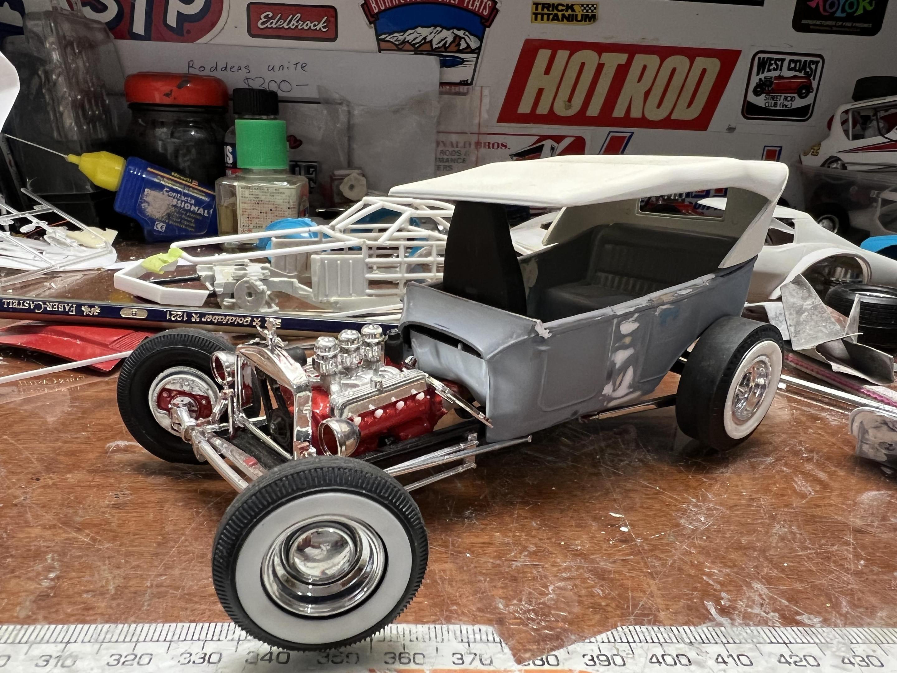

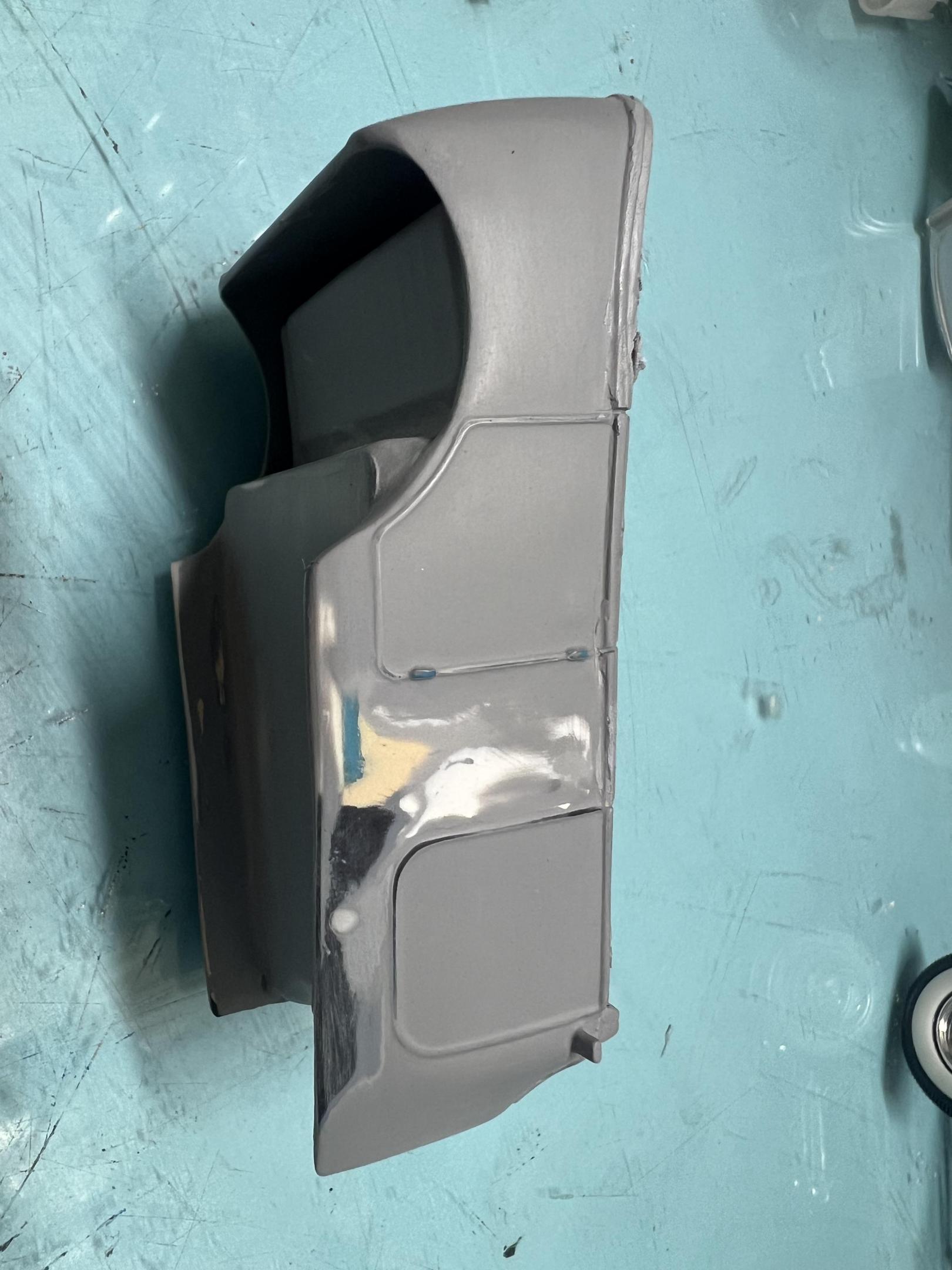

The Monogram '23 touring uses full doors front and rear. If I had attempted this conversion using two long halves of a Monogram T bucket body, the straight rear door line would have intersected with the radius of those big pie crust slicks. On the other hand the Revell body had the radiused door line that would clear the tyres.
A further benefit was that the Revell body came with a roof that was a near perfect fit on this conversion and it also came with a full rear seat and interior side panels.  I also used a second rear seat to create a front seat, using flat sheet and putty to fill in the missing areas.

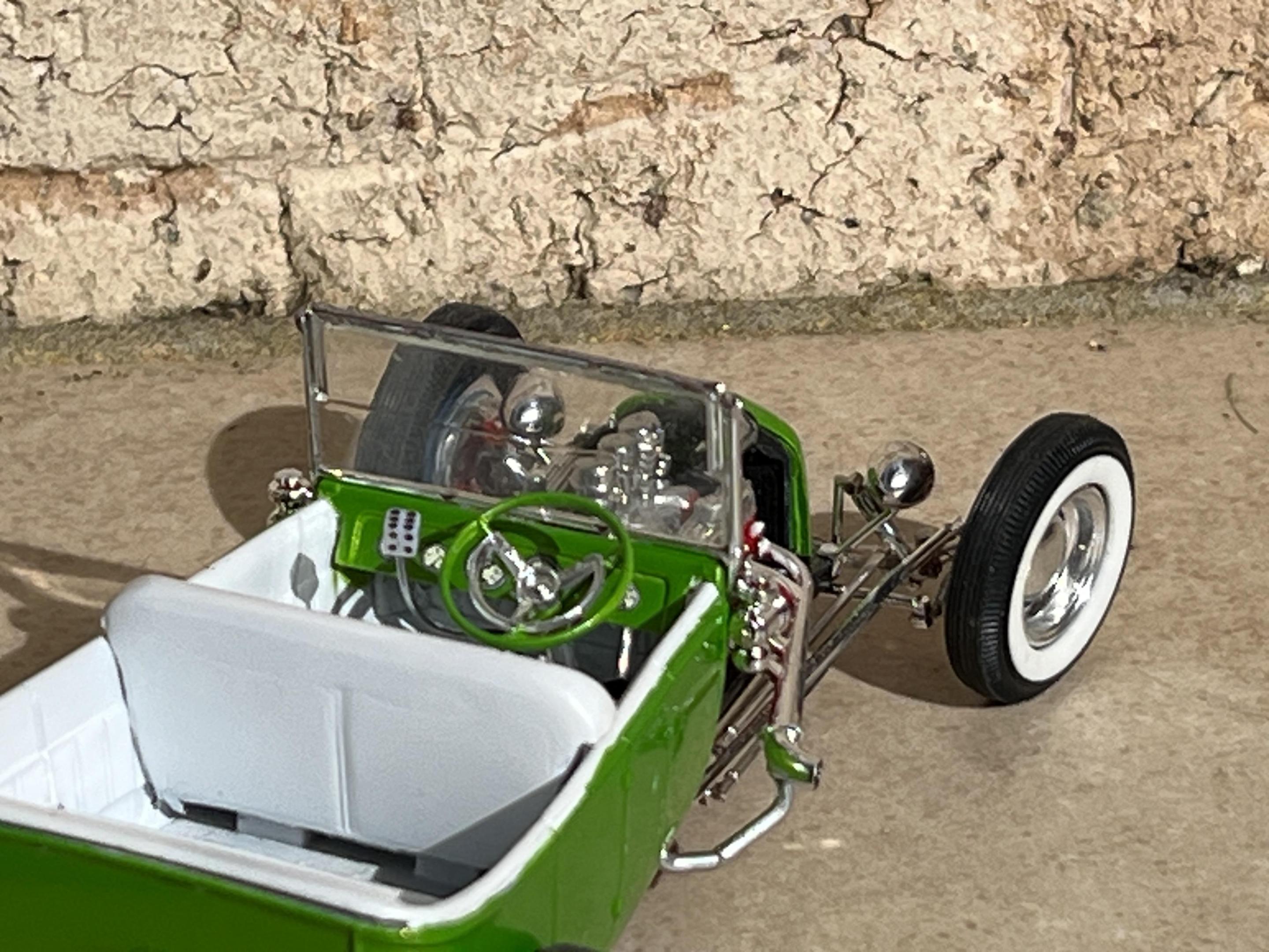

The frame was also modified quite a bit a the rear.  It was extended about 1/8th of an inch and the Zee was pushed to the very rear of the frame to clear the rear seat. Extra crossmembers were added in a nod to engineering requirements.

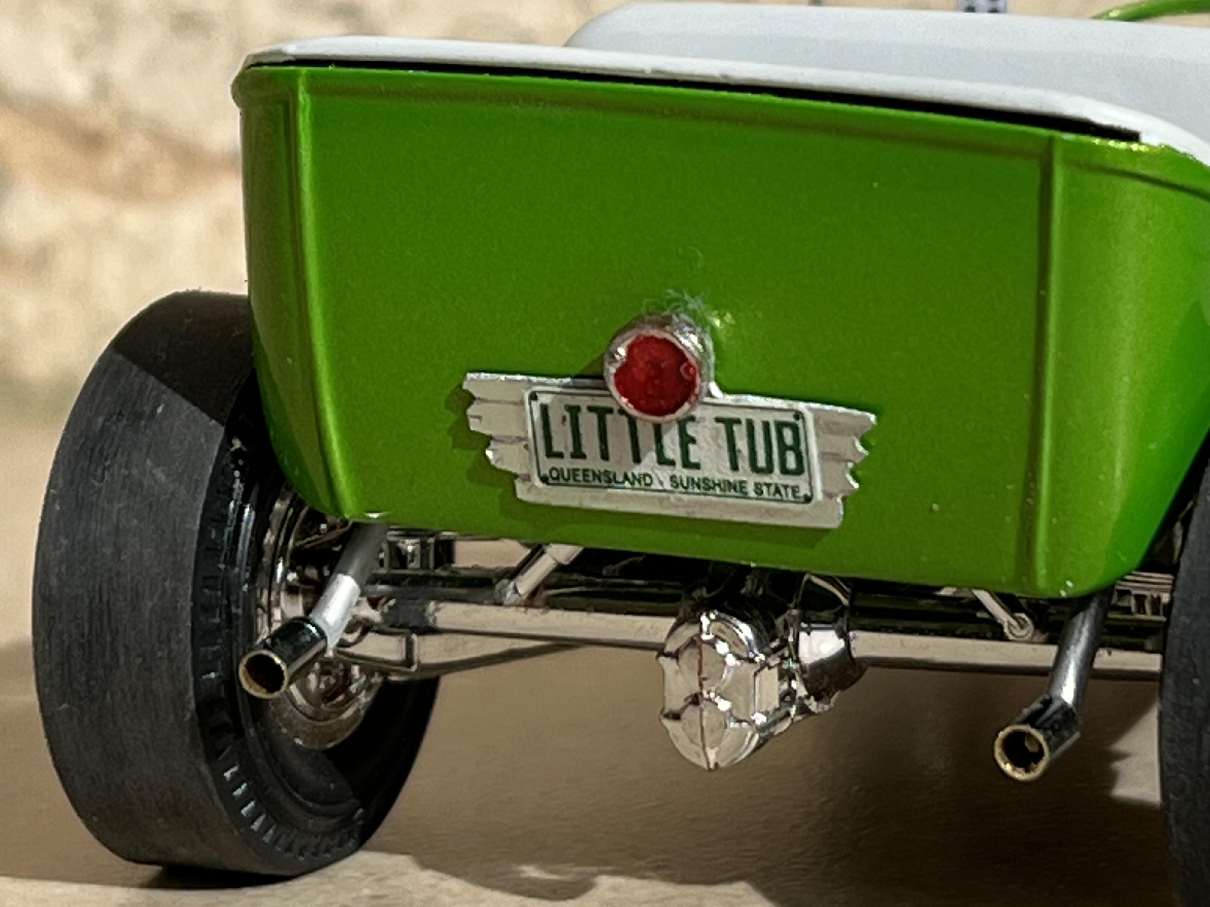

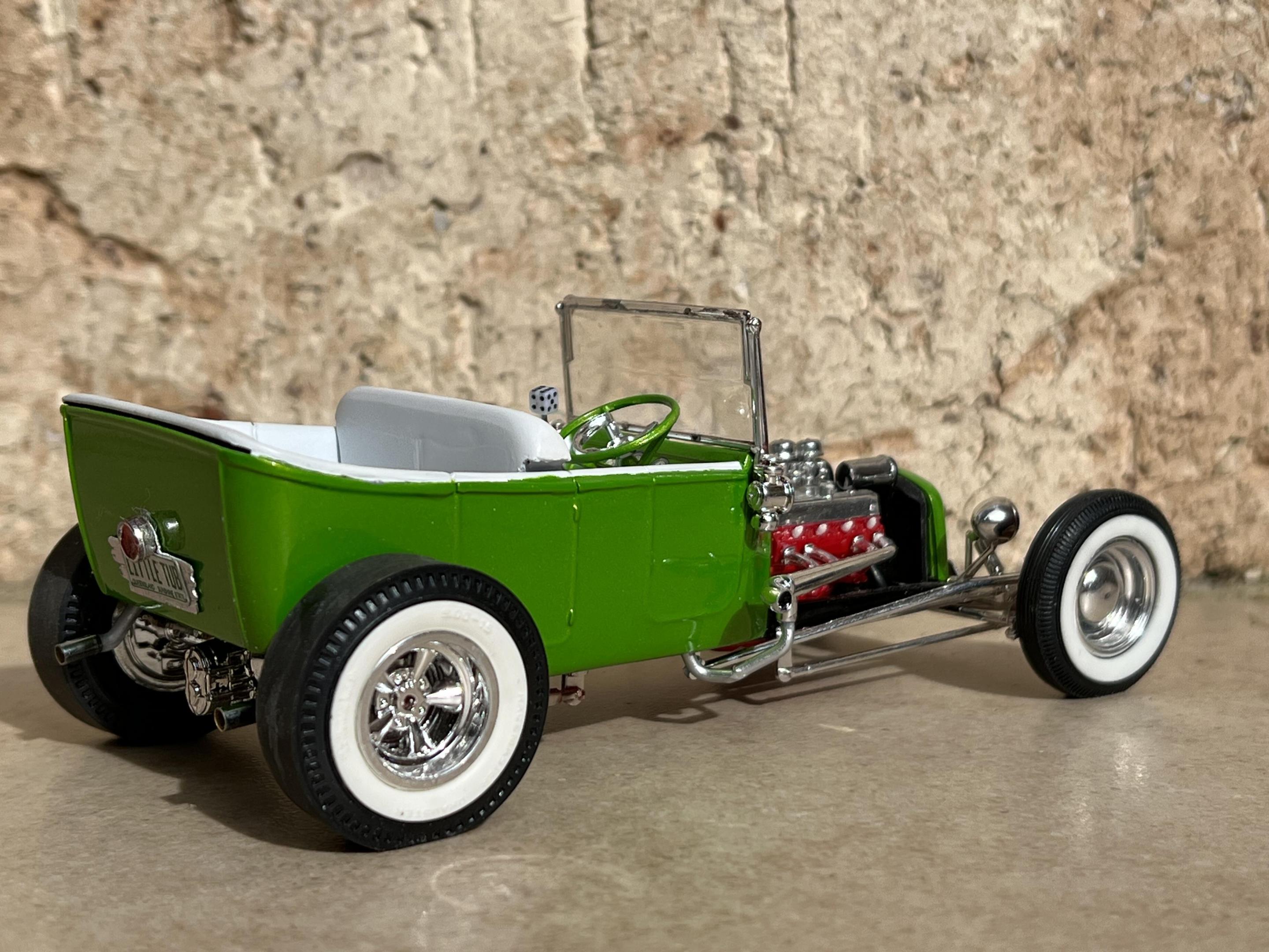

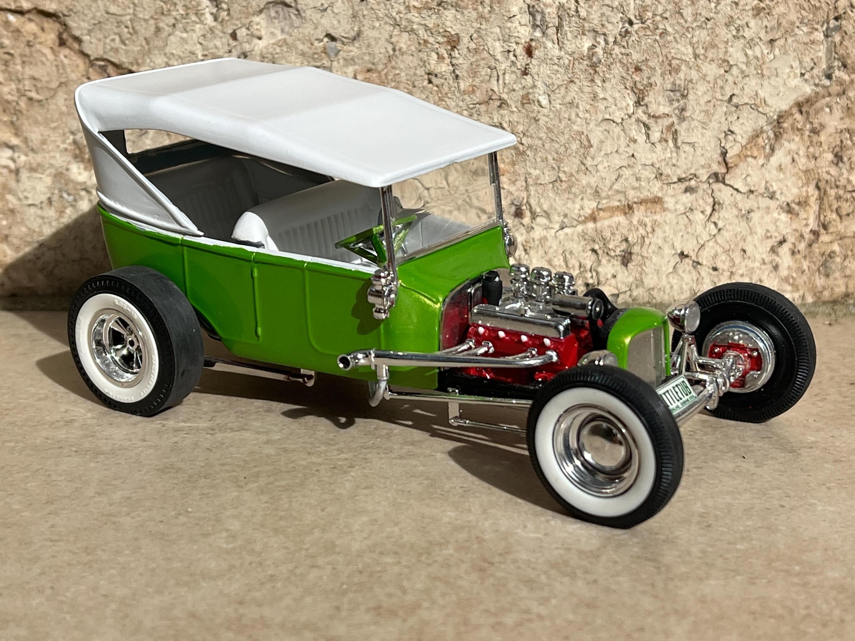

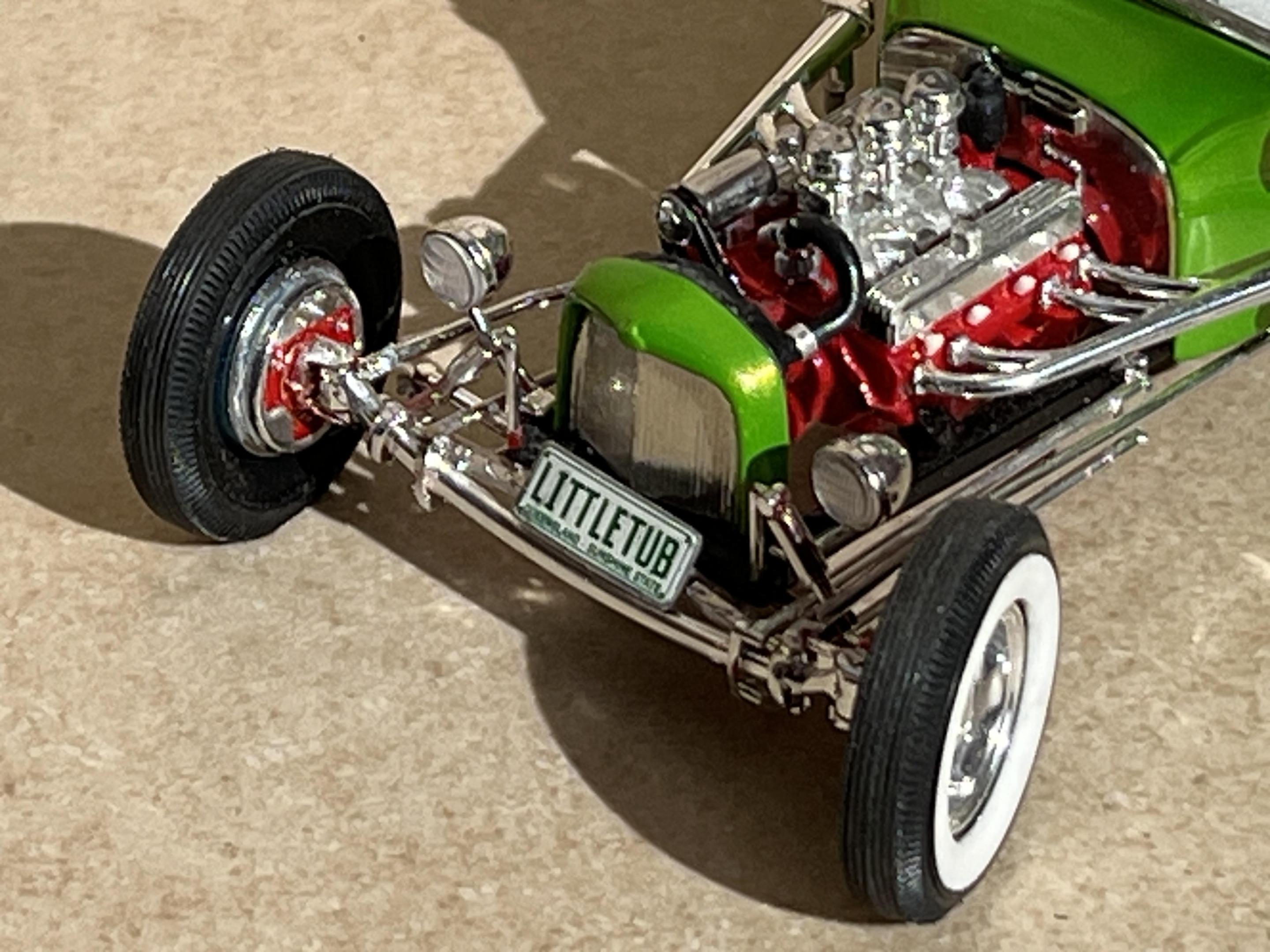

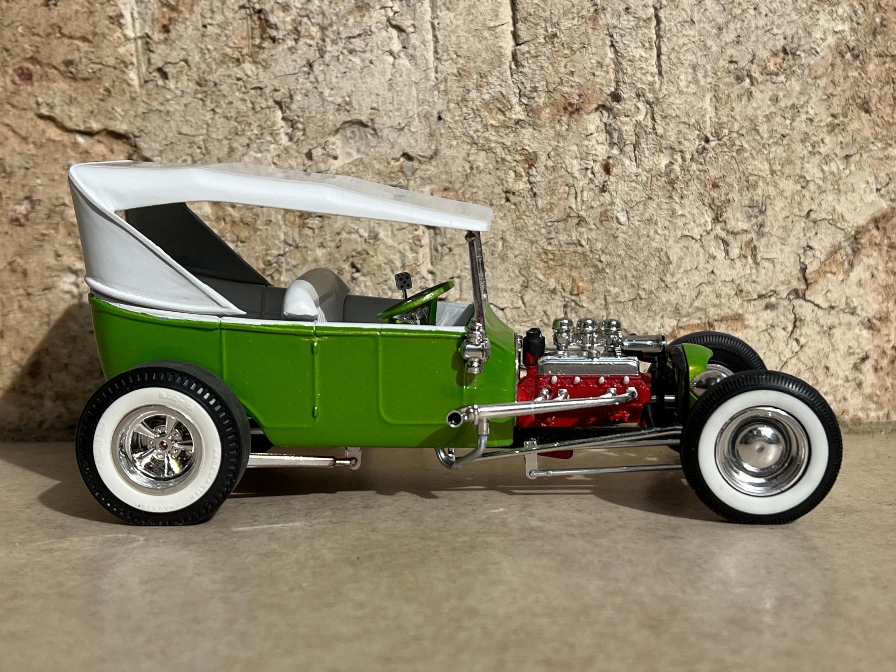

The engine is a Nailhead Buick from an AMT 40 Ford, just to be different yet era appropriate with headers from the Revell Model A hiboy kit. The grille is cut down from a Monogram 32 Ford. The colour is Tamiya Lime green pearl over white primer.
Getting the bodywork tied up where the two bodies were joined caused me enough grief to put it away several times over the years but I finished it a few months ago and am very happy with the results.

Cool little Hot Rod Alan…love the lime green with white top and interior.  Also, the nail head Buick fits the build perfectly.
