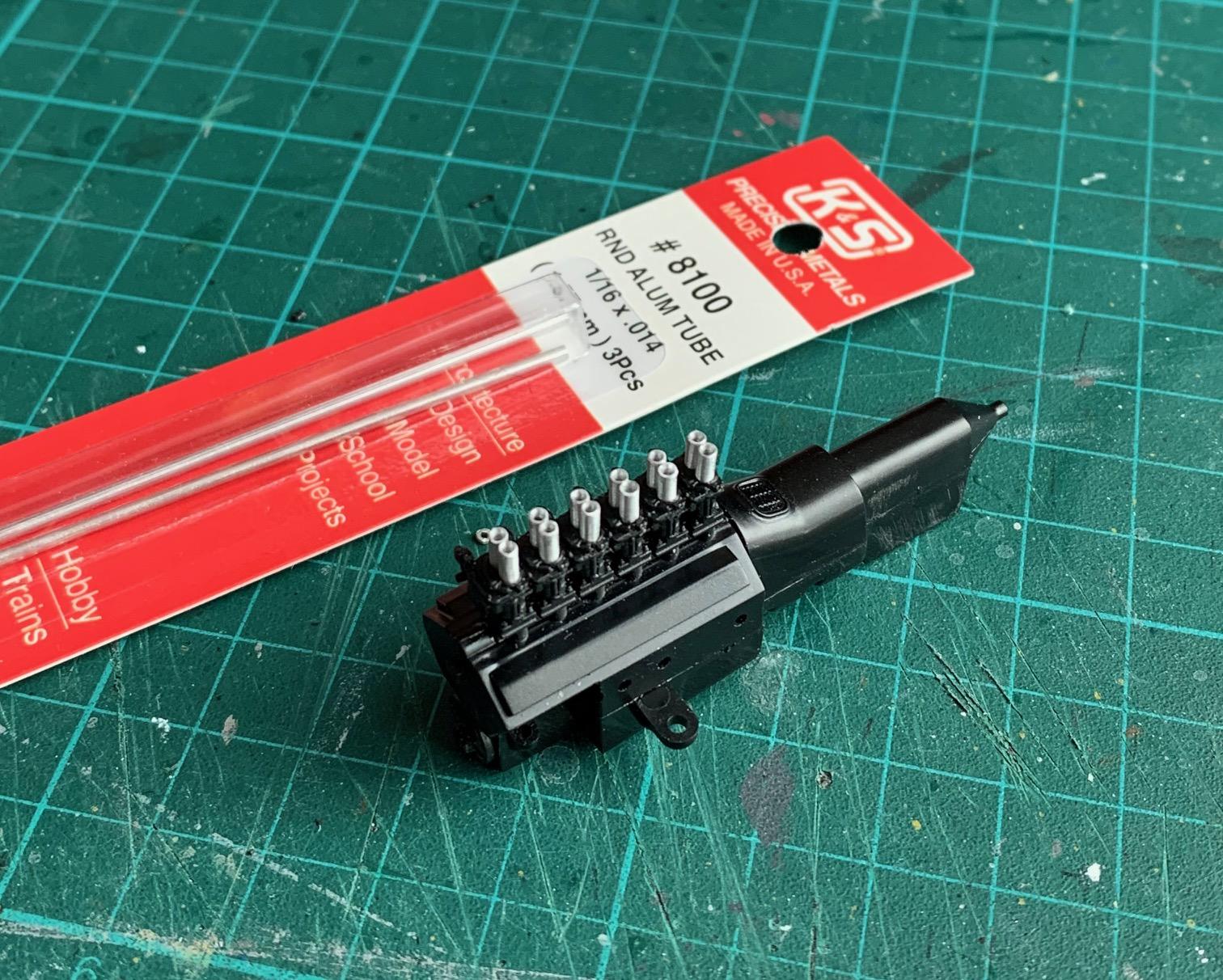

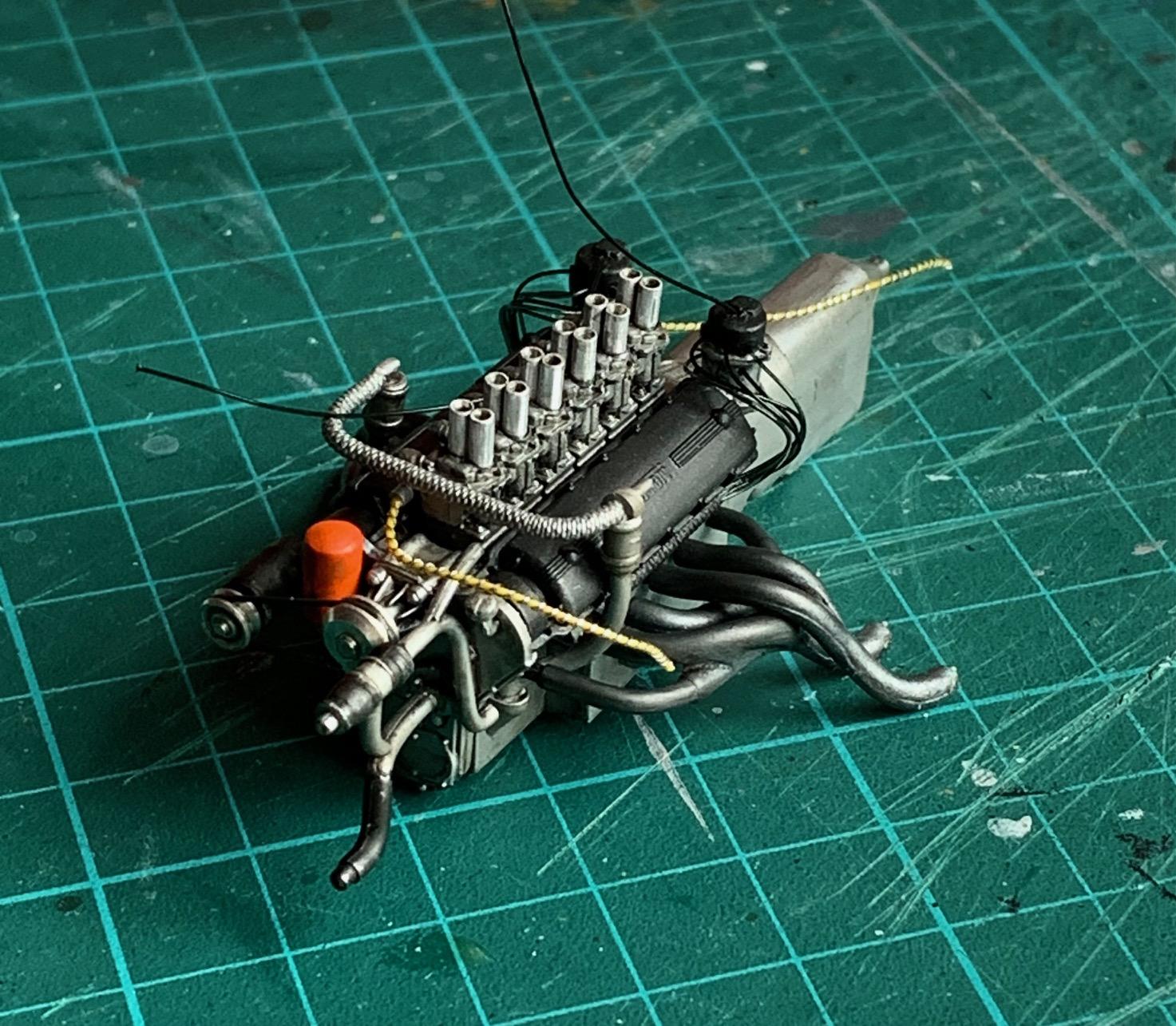

Pierre Rivard Posted November 13, 2023 Author Posted November 13, 2023 Job one was the engine. It is not representative in some areas but chose against a full transplant and decided to add detailing to improve it's presentation. I made air intakes using 1,5mm aluminium tubes Used 0.29mm soft line as ignition wires and black jewelry and embroidery wire for the collector. The black j&e wire was painted silver and used as corrugated tube tying to the oil breathers and an extra length will eventually lead to the collector can. The slimmer (and very finicky) silver j&e wire was stretched and wrapped around yellow ignition wire to create the reinforced fuel lines Finally the molded pullet/strap assembly was substituted with Ted's Modeling units.

Ace-Garageguy Posted November 13, 2023 Posted November 13, 2023 (edited) Looks good. I have every 250 GTO kit, including this one (already moved west, pretty much without cracking open the box). The kit's rendition of the engine and gearbox strike me as more blobular than I'd expect from Fujimi, but most of the lack of detail will be hidden after assembly anyway. I never understood Ferrari's choice of that odd yellow corrugated fuel line, and it always struck me that it would be a bear to model in smaller scales. Really interested in seeing your project here unfold. Edited November 13, 2023 by Ace-Garageguy
absmiami Posted November 13, 2023 Posted November 13, 2023 Suggesting an engine mockup - your forward silver line mite run afoul of the bonnett - good use if sm diameter plug wires …

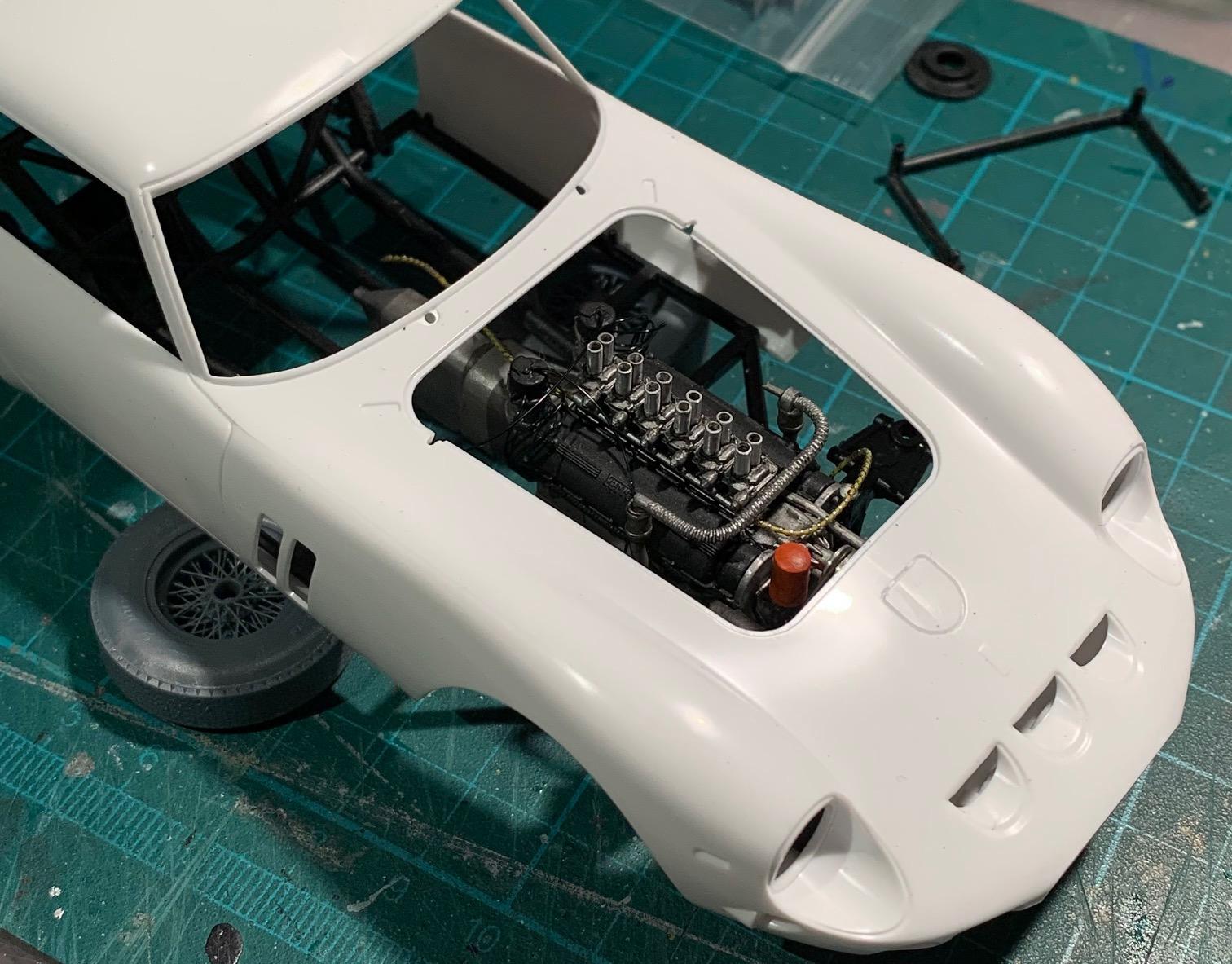

Pierre Rivard Posted November 14, 2023 Author Posted November 14, 2023 Thanks for the interest guys. Completely agree with Ace that the engine is so so (where's the bell housing?) but it can look reasonable once dropped into the engine bay. Something I gotta check before bed time. Relief...goodnight fellows. ? 1

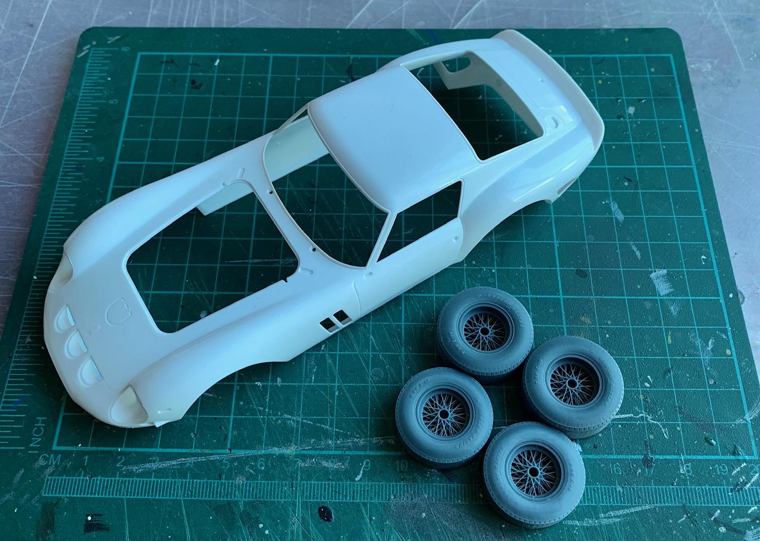

afx Posted November 14, 2023 Posted November 14, 2023 Great start. Are the wheels and tires printed as a single unit?
Pierre Rivard Posted November 14, 2023 Author Posted November 14, 2023 3 hours ago, afx said: Great start. Are the wheels and tires printed as a single unit? Tires, wheels and spinners are separate units. This came off from a small group (including me) working directly with Jason Hupin (Jack_Modelling). Borranis and matching Dunlops to replicate the setup of series 1 GTO's. I don't see them on his regular catalog but certainly he will accept new orders if contacted directly. contact.jackmodelling@gmail.com 3

Pierre Rivard Posted November 14, 2023 Author Posted November 14, 2023 Thanks Helmut, no kidding it is an OBB..ish build as the engine and the wheels & tires see an upgrade but the rest of the kit is excellent as it is. Thanks Justin, I also watch and learn a lot from your builds. If only I could get my hands on one of those rare Gunze 250 SWB kits. I have the AMT kit but I don't think much can be done with it... That being said, a key task I try to do early in a build is a mock up of the chassis and making sure the track, wheelbase and ride height are properly set. I did not need to make adjustments here other than lengthening the hubs and adapting them to the aftermarket wheels. I like the way she sits. Now that this is done the body can go it's separate ways to the various painting stages while I build the rest of the car on a parallel path.
