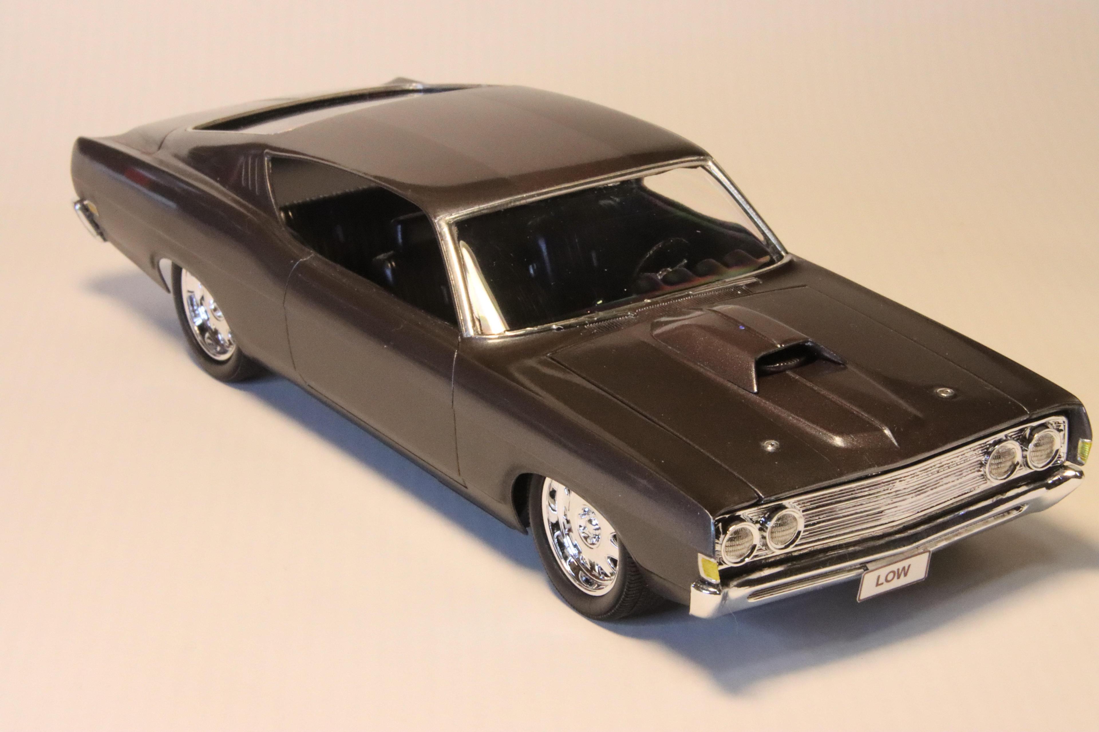

bill-e-boy Posted November 17, 2023 Posted November 17, 2023 The Tamiya light gunmetal would be my choice with a coat of semi-gloss clear. The real thing looks like a metalic finish to me. Here is a kit panted gunmetal with light gunmetal stripe.

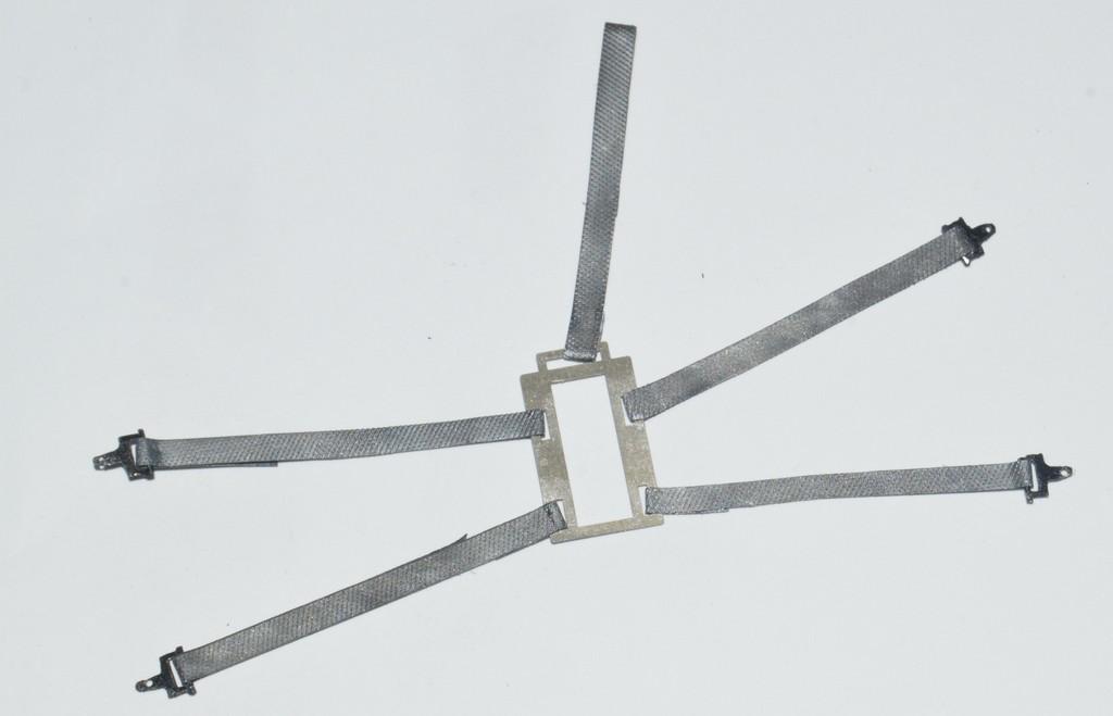

Straightliner59 Posted November 18, 2023 Posted November 18, 2023 On 11/16/2023 at 6:27 AM, NOBLNG said: Thanks guys. I had run across the SEM bumper paints while searching. The graphite idea is interesting and I have some (for lubricating locks) on hand. I also thought this Mr. Hobby Black/Green looks possible…maybe it and the graphite? I did these blower restraints with SNJ aluminum powder rubbed into flat black. I have a couple of brass and bronze metal powders, but, I want to experiment with more of them. there's quite a variety, on Ebay. 1

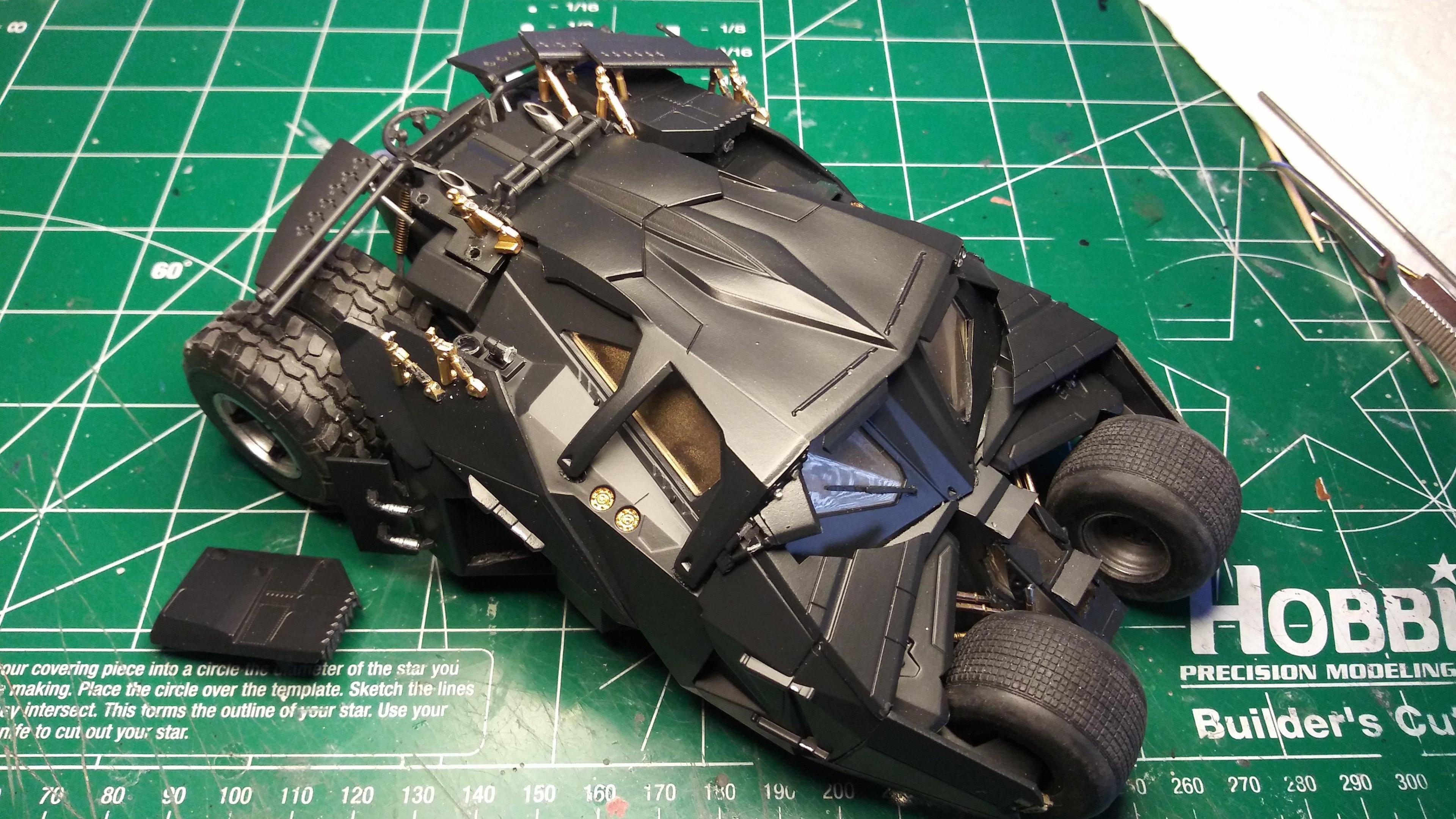

David G. Posted November 18, 2023 Posted November 18, 2023 Hi Greg. I used Dupli-Color Basic Flat Black on my Tumbler. I think this looks similar to the effect you're seeking. Regards, David G.
