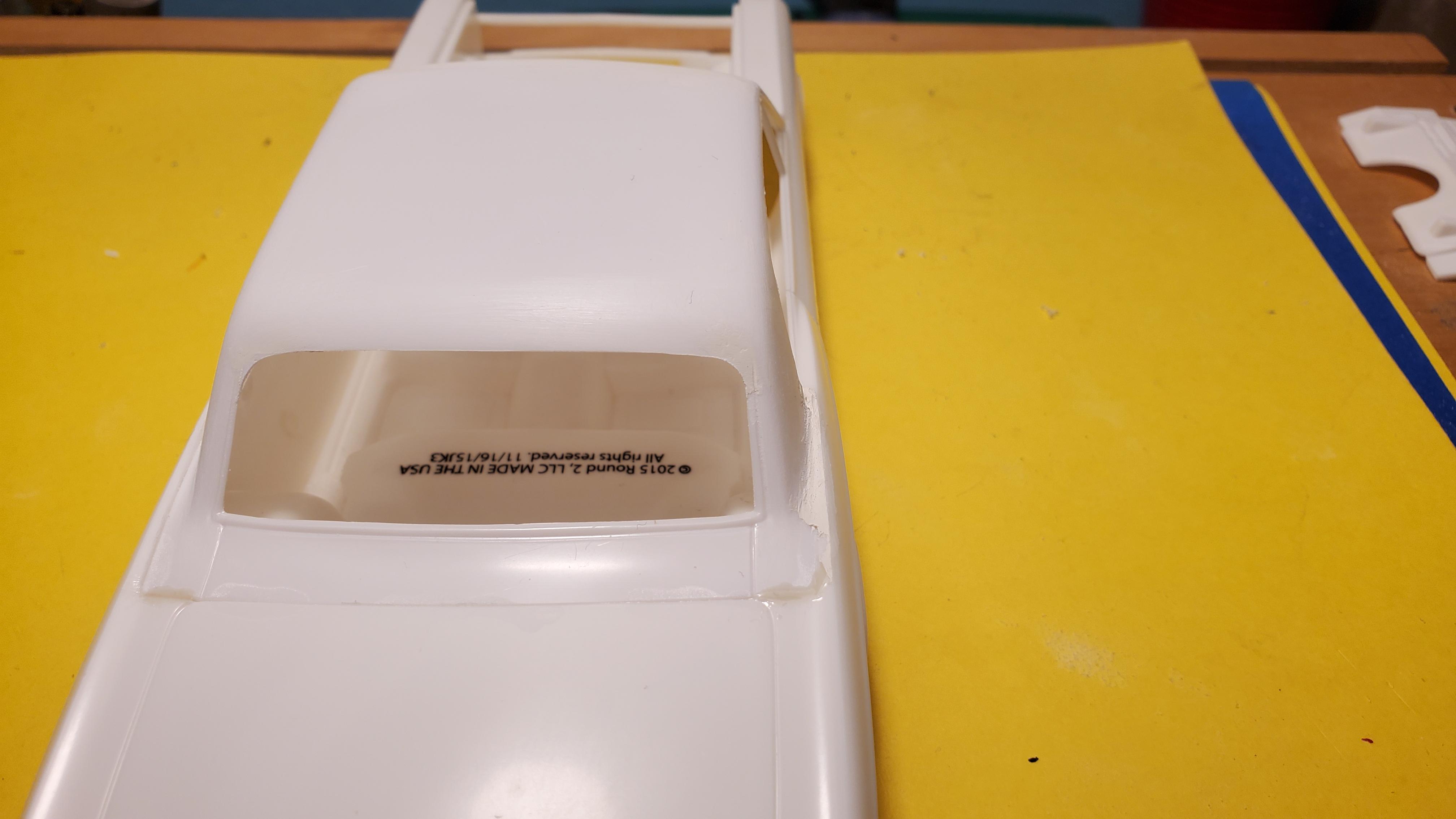

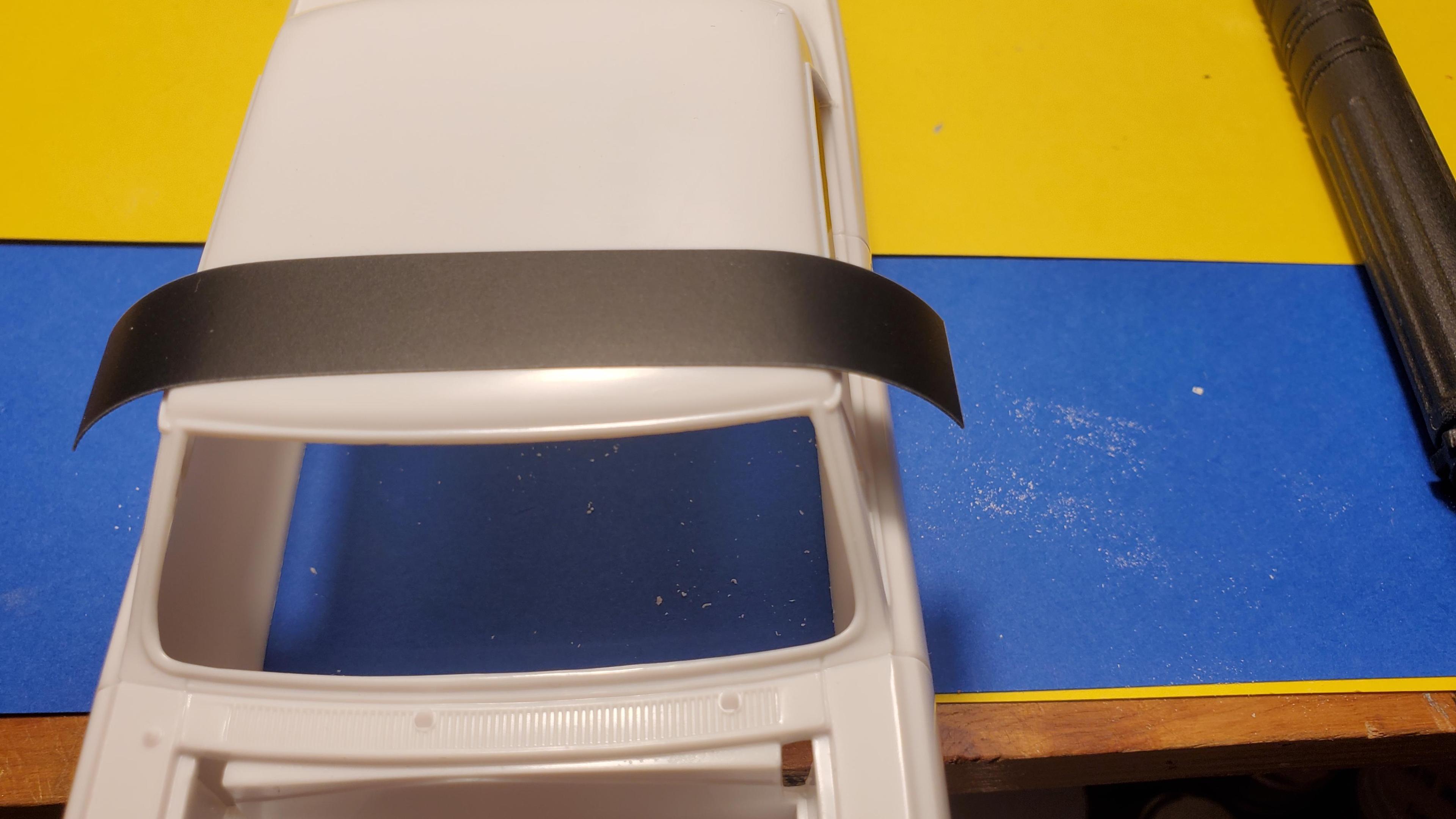

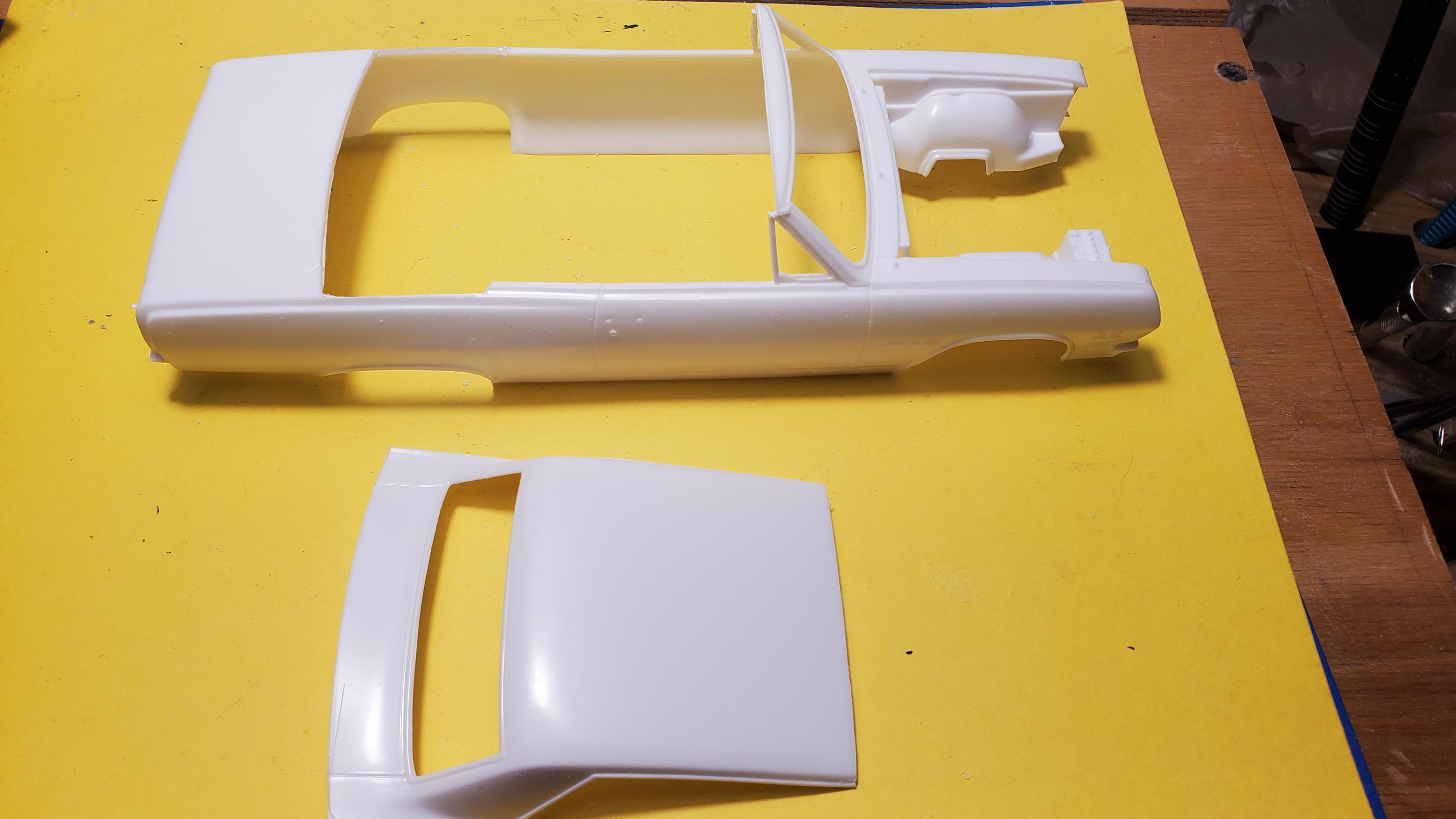

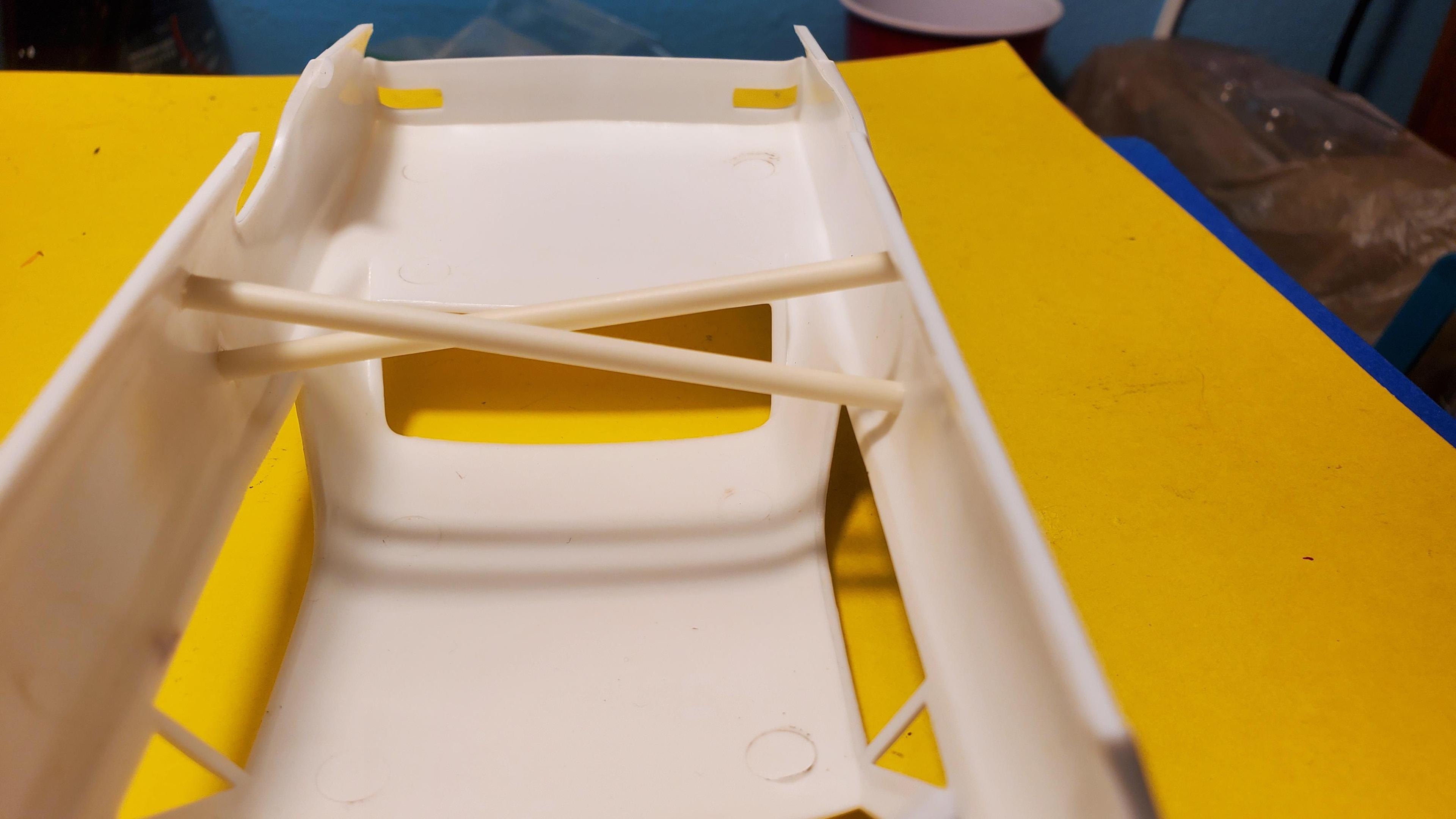

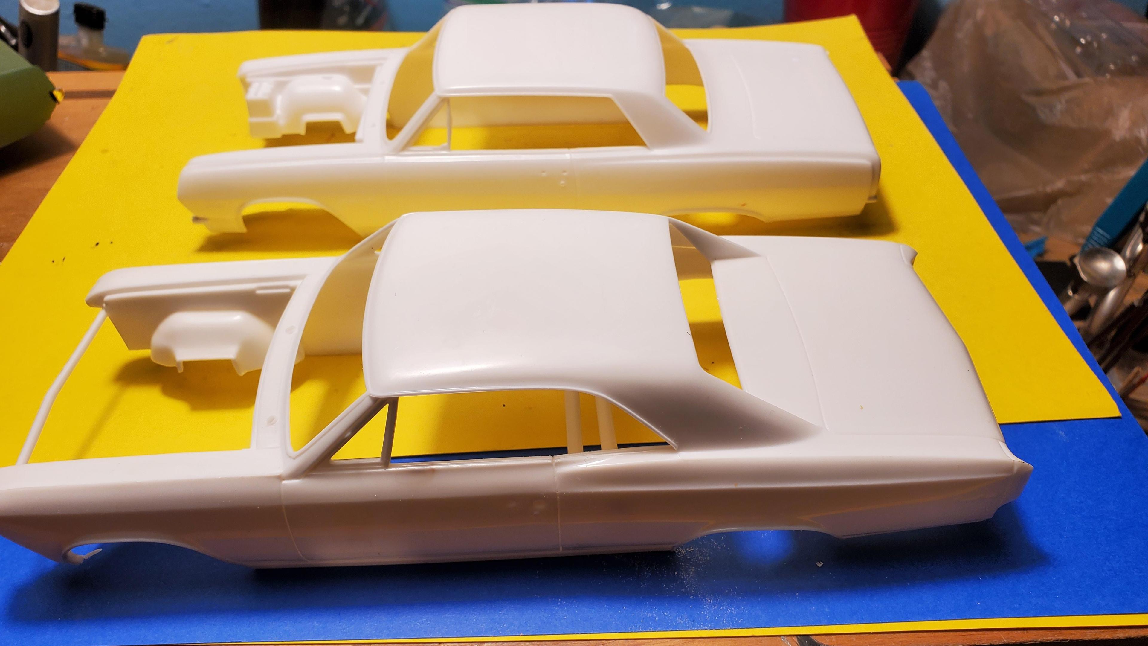

Steamboat Posted November 22, 2023 Posted November 22, 2023 Next up is a model of my 1:1 Chevelle Model 300 4-door sedan, which I bought from a farmer's widow around 1978. It was stored in a chicken coop, and not matter how much soap and air fresheners I used, it always smelled like chicken $#!7. It had a 230 straight six with 2-speed Powerglide, and manual everything else. Other than needing a battery once, it never let me down. I wish I still had it. I'm starting with the Lindberg '66 Hardtop, and using the top from the Revell '65 Chevelle Z-16. You can see the radical difference in the '66 in the foreground. I braced up the inside of the Lindberg before performing surgery. Even though the plastic seems fairly thick, I'm being cautious about warping or breaking the body. A bit of Dymo tape helps me make a straight saw cut on the top of the '65. '65 with the top removed. Do I see a '65 convertible or a phantom hardtop in the future? More to come... 7

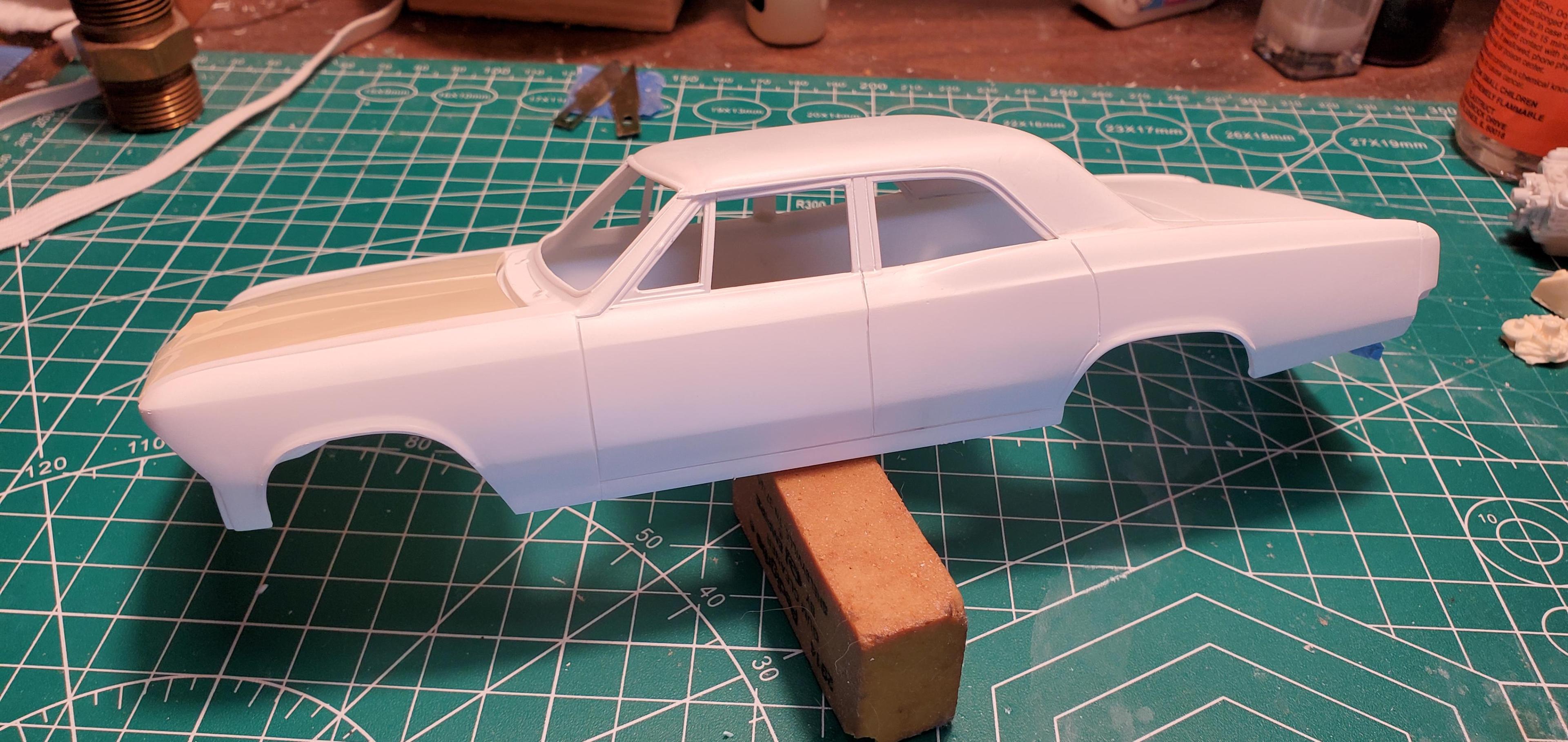

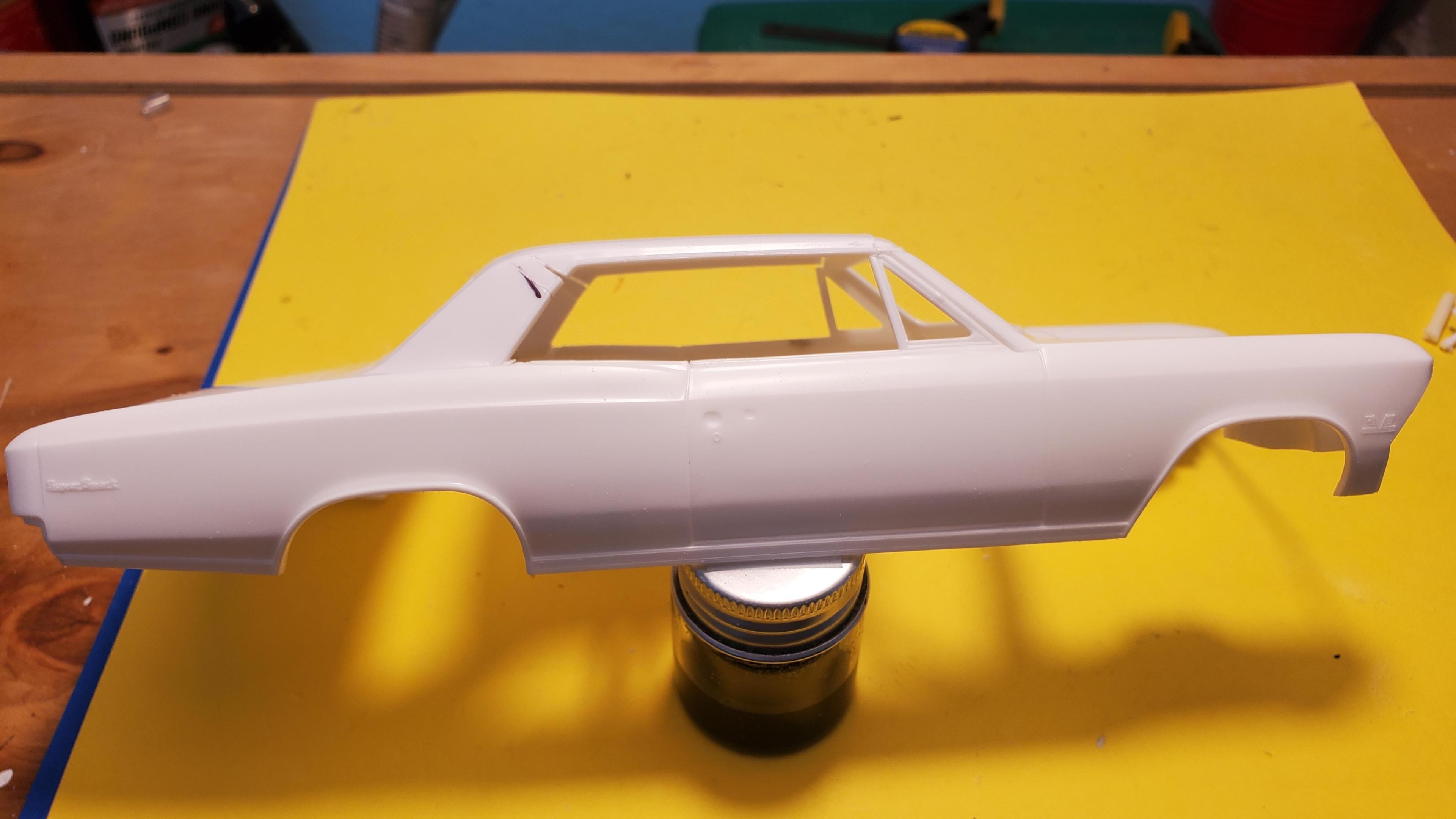

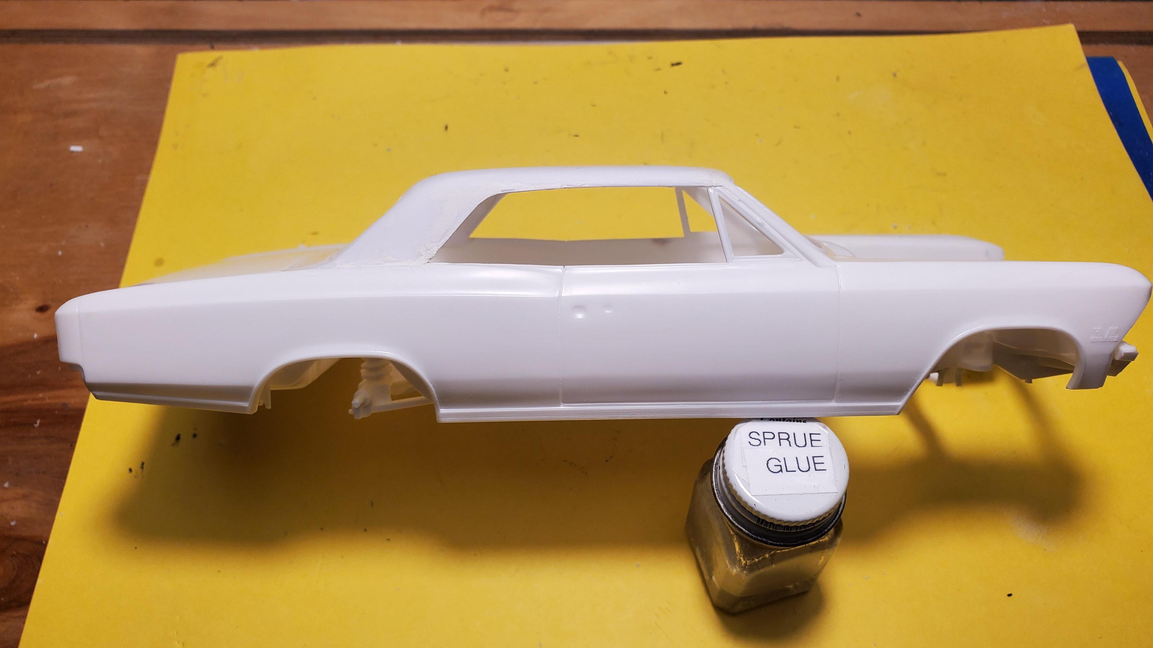

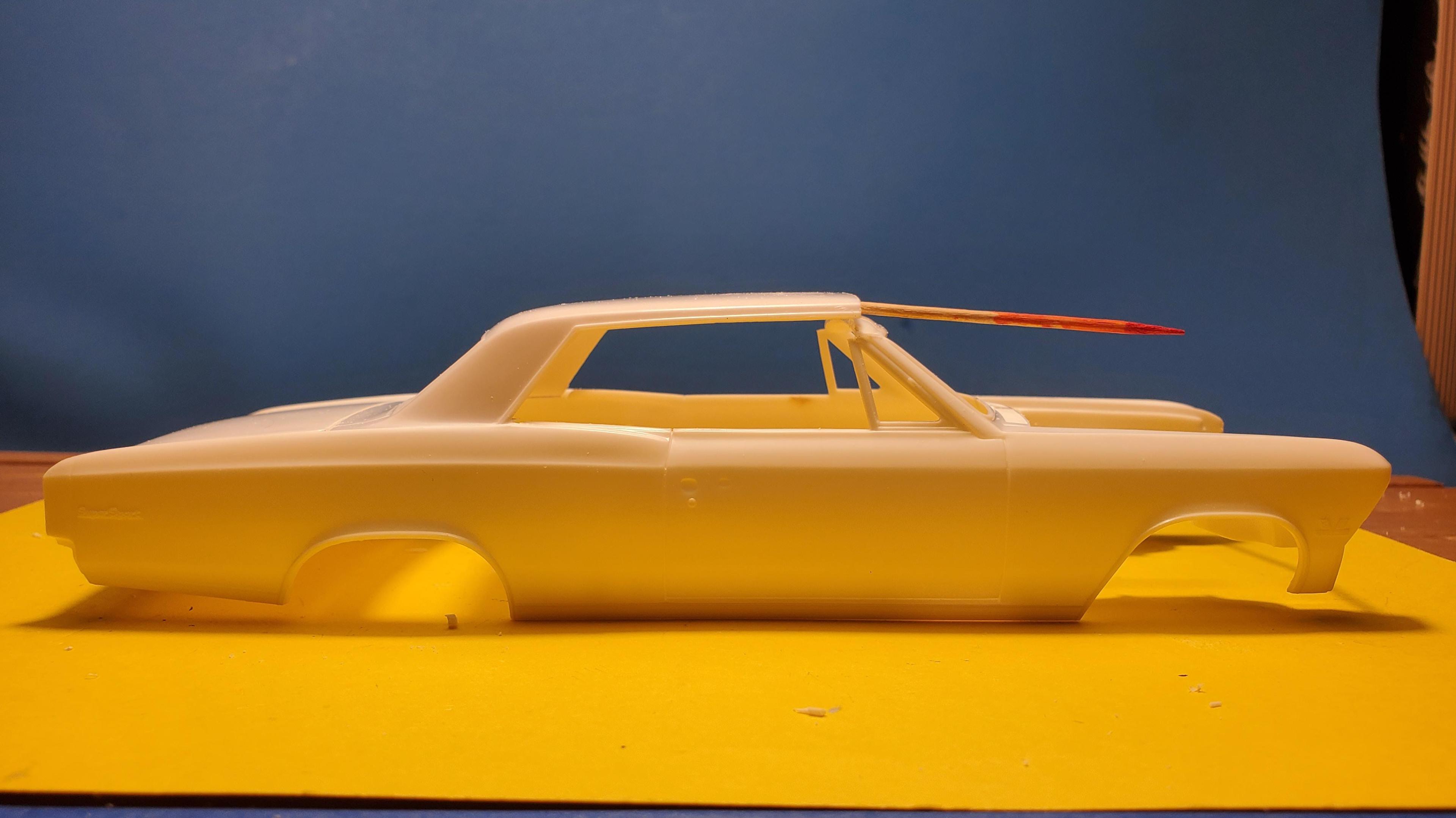

Steamboat Posted November 29, 2023 Author Posted November 29, 2023 First test of the roof section on the '66 and it was too high in the front. I made a few pie cuts in the C-pillar to lower it. There are some other changes needed to the C-pillar so I'm not too concerned about body work on it right now. The second fit is much better. Now it needs to be lowered just a bit in the rear. Should be easy enough to do by incrementally shortening the distance between the C-pillar and the trunk lid. 5 1

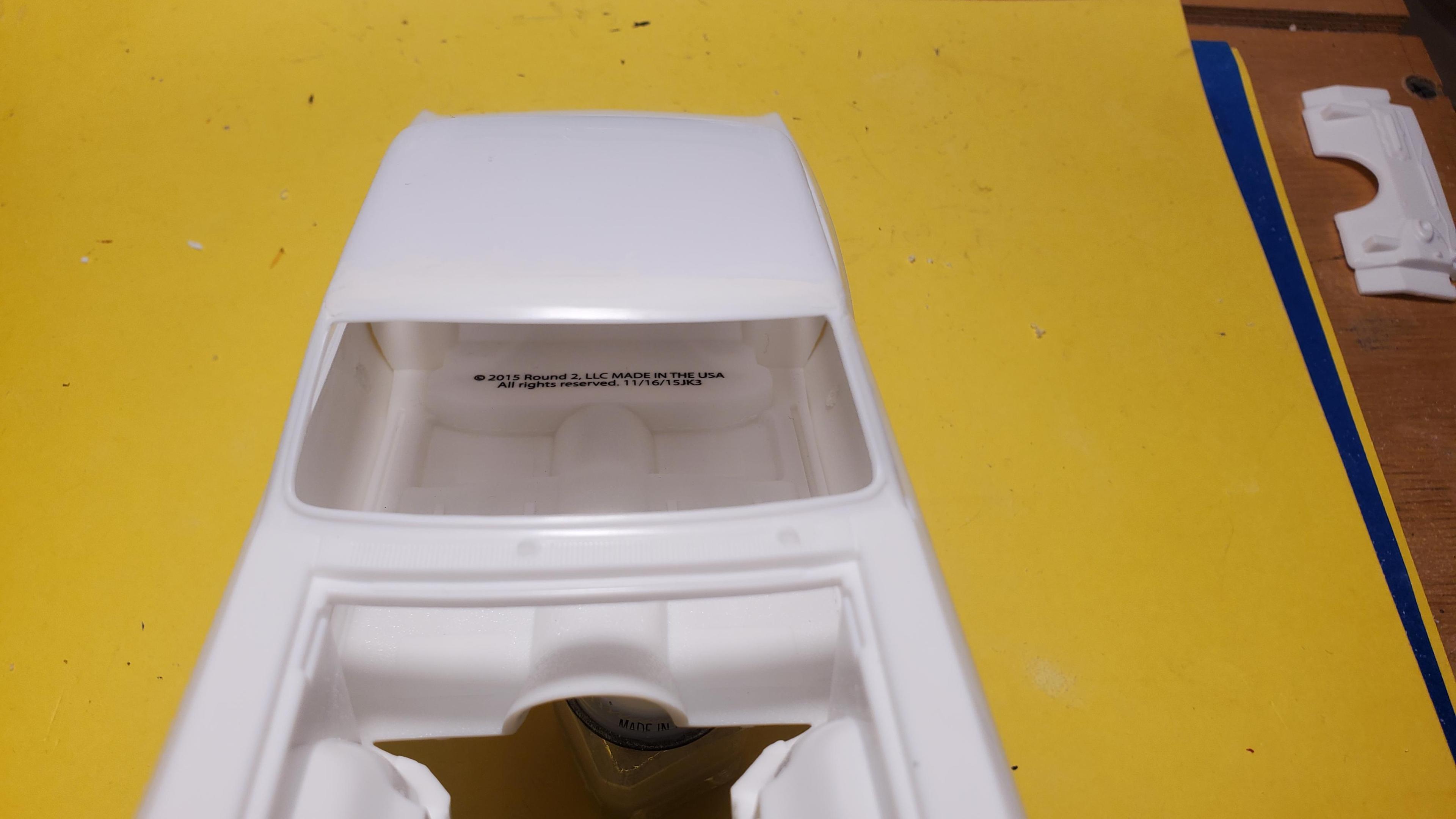

Steamboat Posted December 6, 2023 Author Posted December 6, 2023 After adding some styrene strips, filing and Tamiya putty it's starting to look like a Chevelle again. I rounded the upper corners of the back glass opening. I also raised the windshield opening as the Lindberg windshield looked too small compared to 1:1 photos. 1

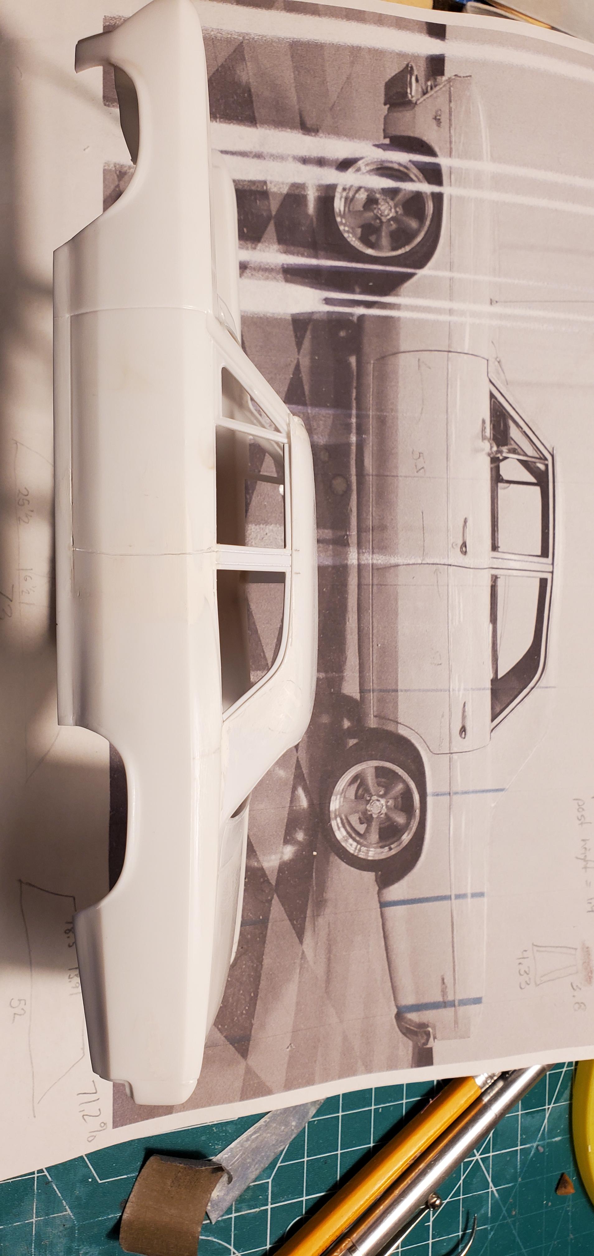

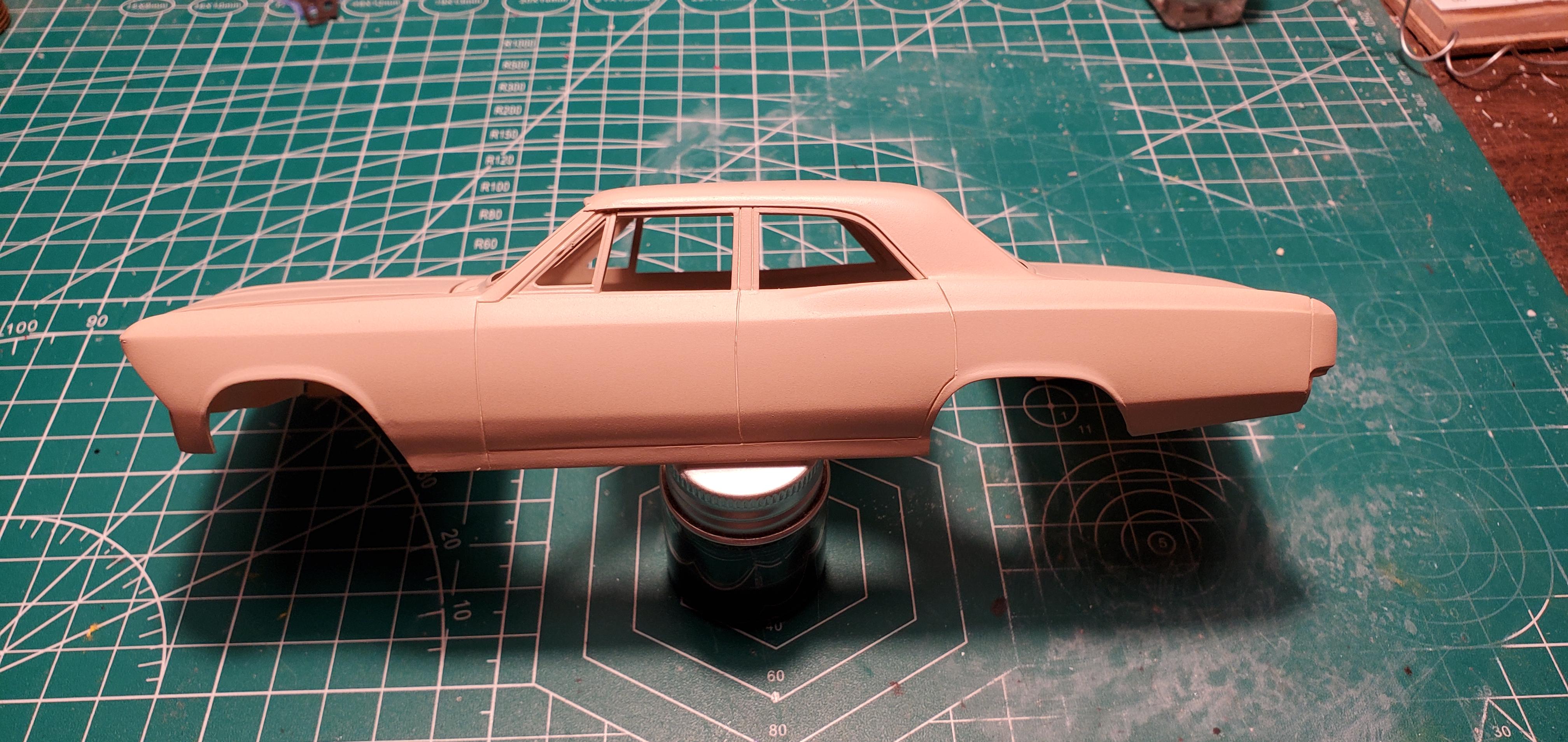

Steamboat Posted November 20, 2024 Author Posted November 20, 2024 After a long time on the shelf of doom, it's back on the bench. I had to make some compromises. The a-pillar on the Lindberg kit has more rake than the 1:1, causing the roof and window openings to be smaller. I didn't notice this until it was too late to correct. Notice that the door seam between the doors now runs straight down from the front of the b-pillar, as opposed to the rear of the b-pillar on the 1:1. I had to do this because the rear doors looked too small otherwise. The second photo shows a comparison with the 1:1. Sorry for the sideways image. I couldn't find a way to rotate it. Anyways, it's time to finish it up and move on. 1

1972coronet Posted November 25, 2024 Posted November 25, 2024 On 11/19/2024 at 6:43 PM, Steamboat said: The a-pillar on the Lindberg kit has more rake than the 1:1 I'm surprised that no one ( myself included ) chimed-in earlier about that issue. I'd have recommended that you start with the Revell 1966 Chevelle Wagon and/or the '66 El Camino as your base. Now, that's not to say that the work you've performed is bad by any stretch of the imagination ; that's some mighty fine skill you've got ! May as well turn what' you've got there into a 1960's custom - chopped top, lowered, hopped-up six / 'glide , pinstripe white walls, and chromed steelies with Spider caps ?

Steamboat Posted November 25, 2024 Author Posted November 25, 2024 3 hours ago, 1972coronet said: I'm surprised that no one ( myself included ) chimed-in earlier about that issue. I'd have recommended that you start with the Revell 1966 Chevelle Wagon and/or the '66 El Camino as your base. It'll be good enough for me as is. I think most people will think it looks a little off but won't be able to pinpoint why. All I set out to do was recreate my 1:1 car that I owned 45 years ago. Lesson learned the hard way as usual. 1
