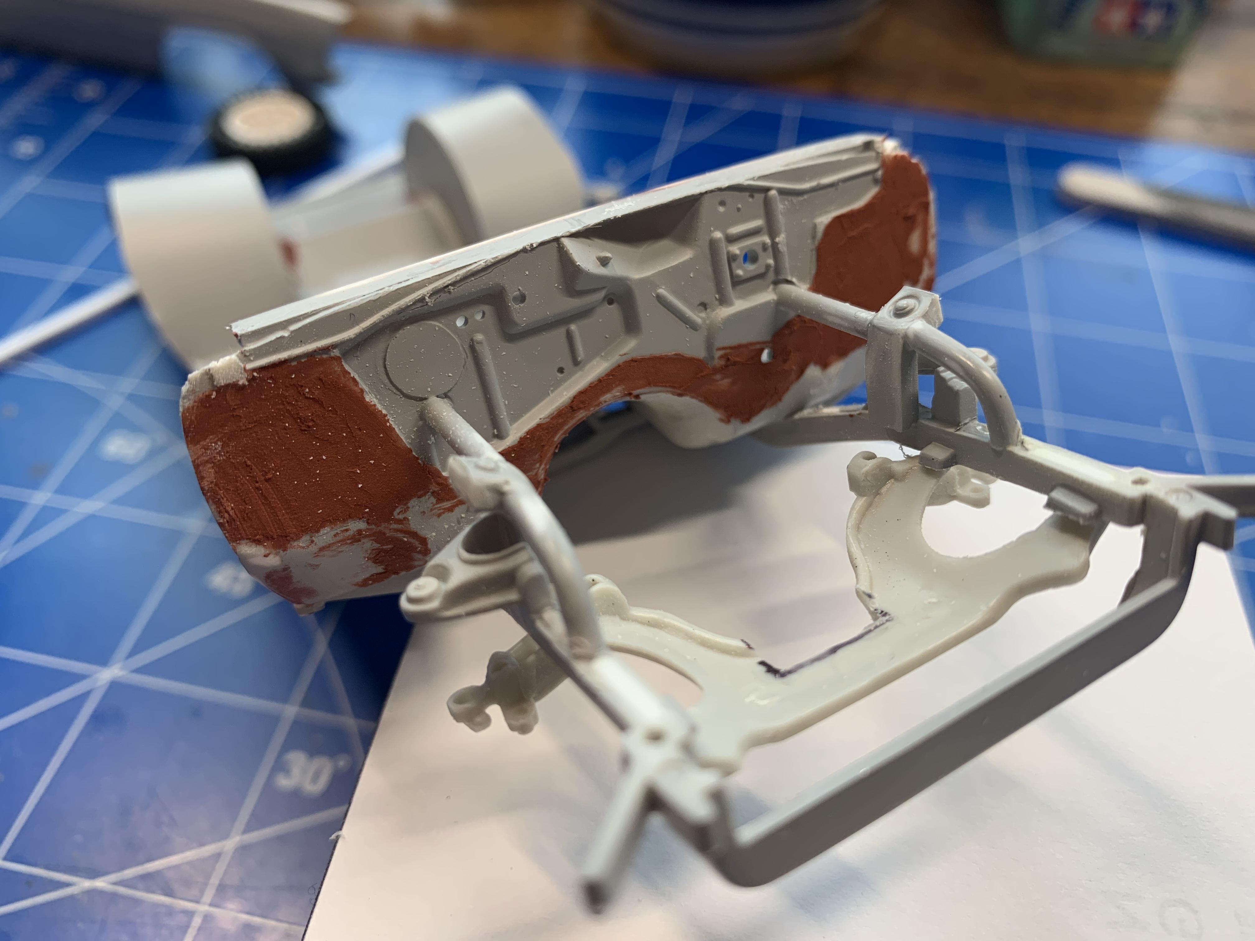

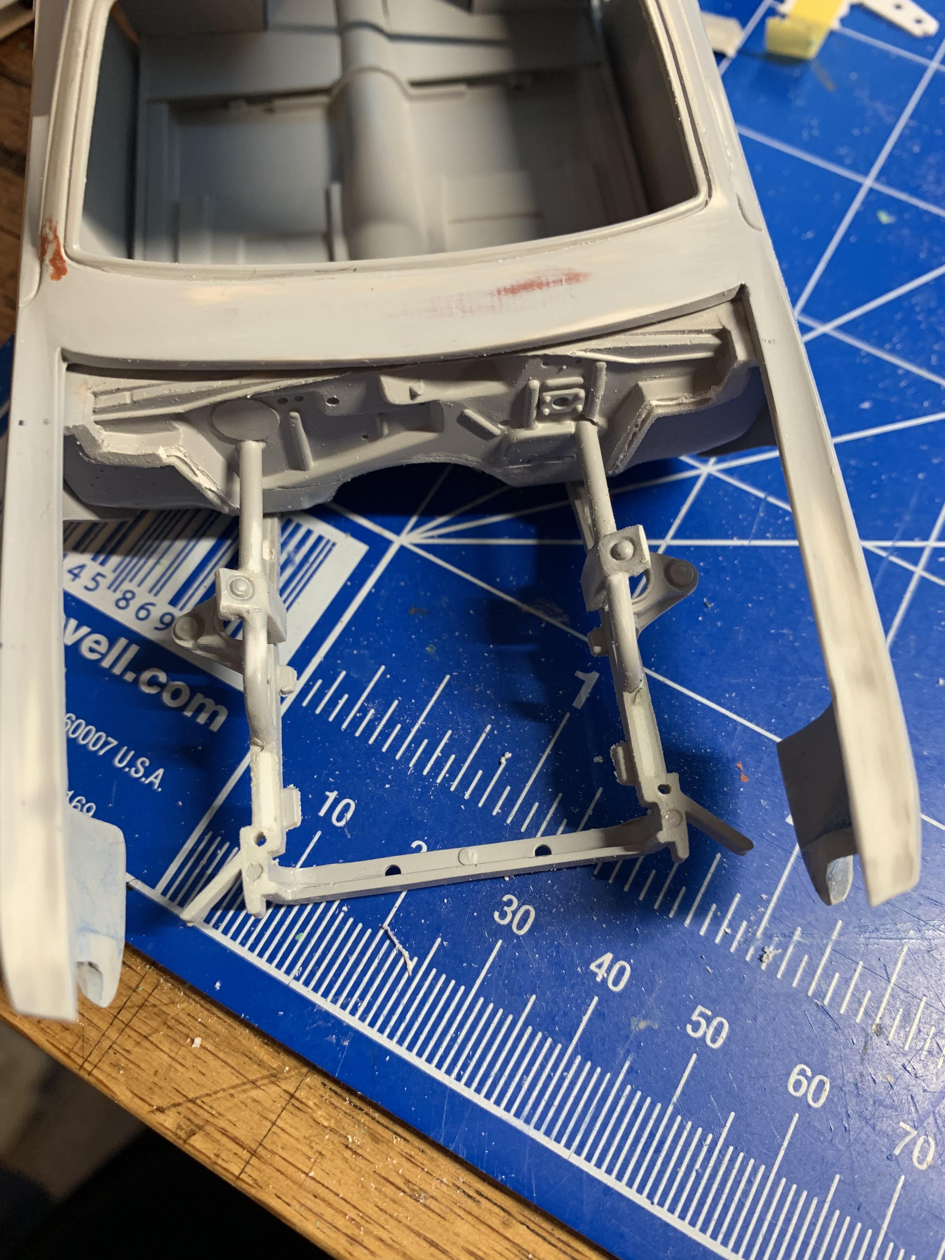

dragcarz Posted May 5, 2024 Author Posted May 5, 2024 Where do I start? To get the front end low enough the K member sits on the ground and the front tires hit the fender aprons. So the spindles need to be raised, the K member needs to be trimmed to fit closer to the frame rails, and the aprons need to be replaced, so I disassembled most of the work I’ve already done. I trimmed the aprons off and re-sanded the attachment points. I grabbed another K member from my parts kit and trimmed the mounting points to raise closer up. The kits design has the K member doubled up so it’s rather thick, I’m only using the lower K member now. The space between control arms is now too narrow and I’ll probably have to scratch build the spindles. I’m a little concerned about the radiator support being to low now, but I will have to test fit everything to see where it’s at. During all the test fits I have now tore the rear wheel tub. I seriously think Einstein’s theory of relativity was easier than re-engineering this kit. 1 1

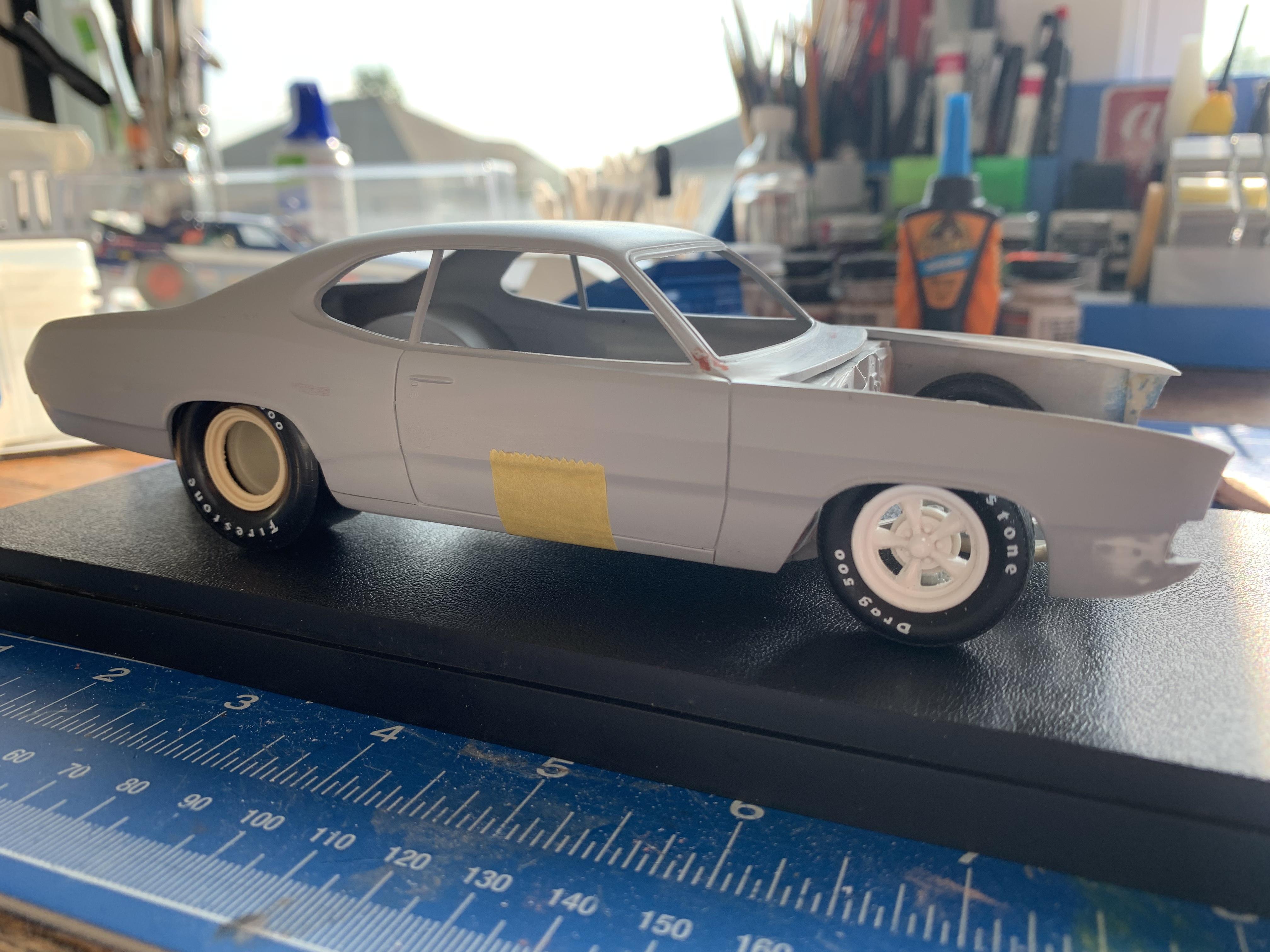

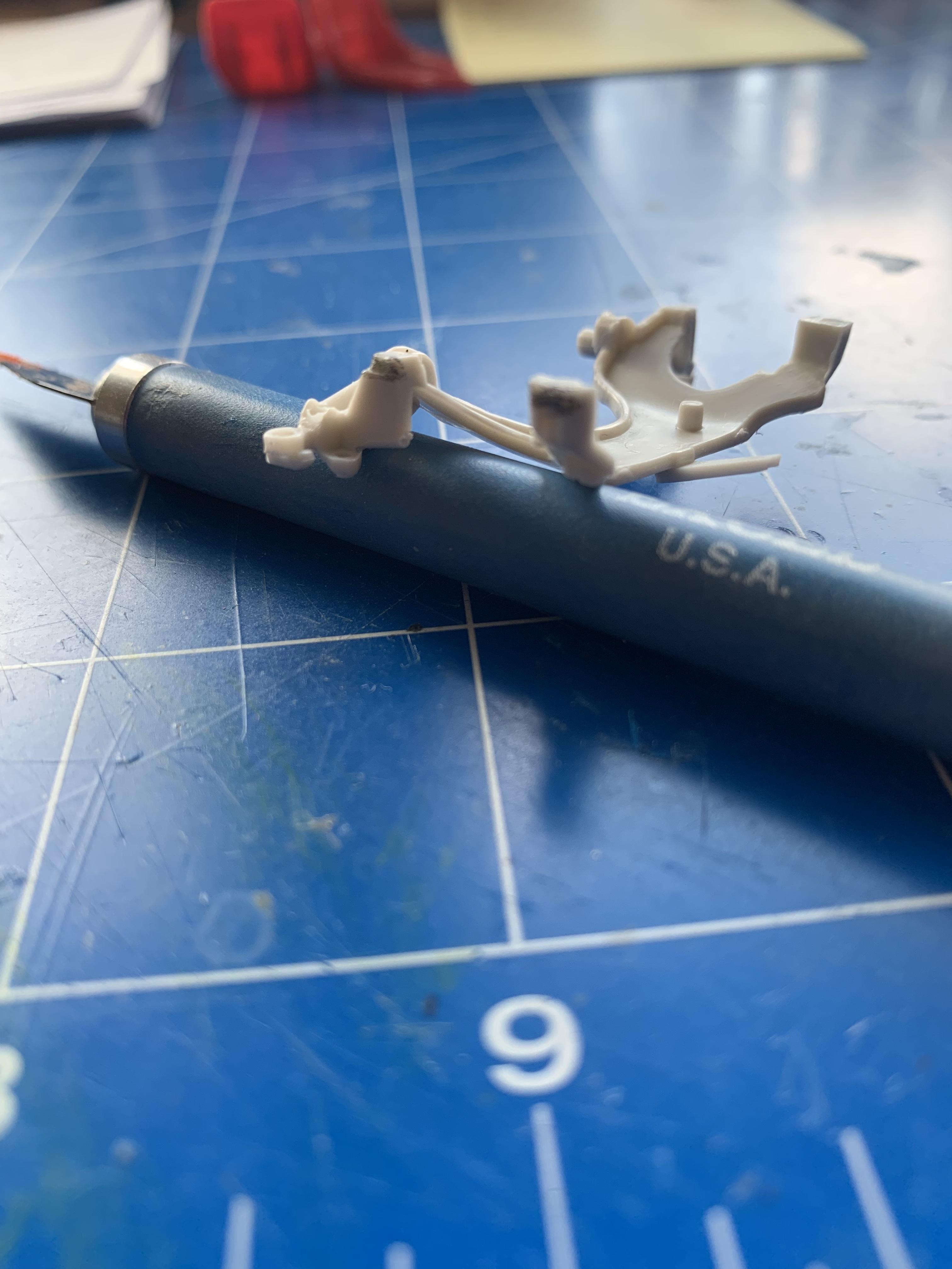

dragcarz Posted May 25, 2024 Author Posted May 25, 2024 Here’s a small update on a large problem. It took a lot of thought ( for me anyway), but I raised everything up to get the stance correct. I removed the inner fenders, I sanded the cowl to lower it, and I shortened the K member. I scratch built new spindles. I’m happy with how the front sets now. 1

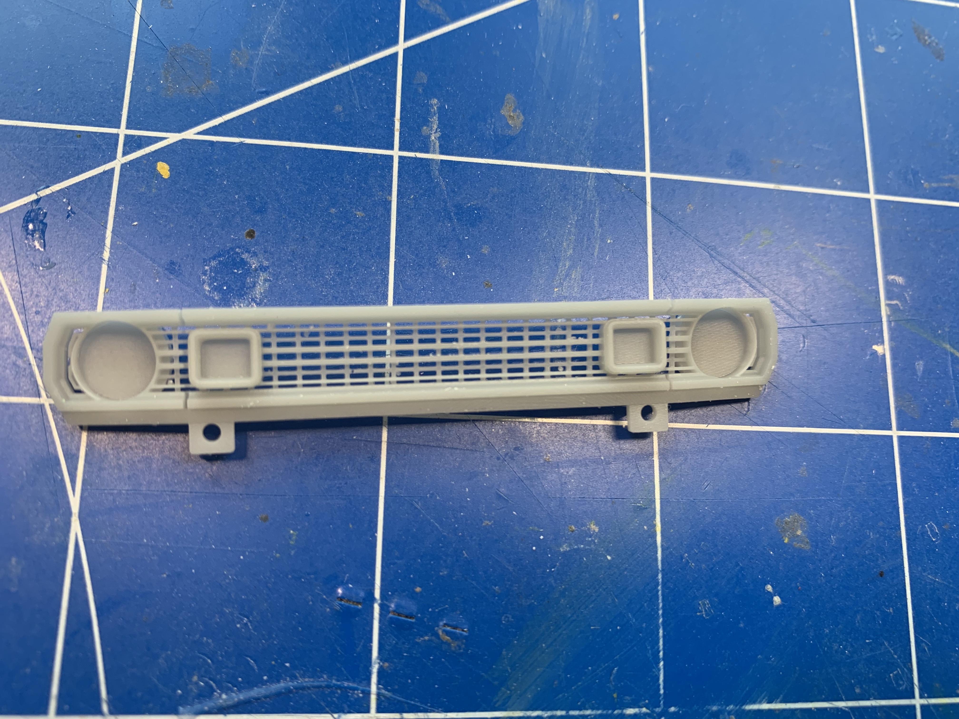

dragcarz Posted May 25, 2024 Author Posted May 25, 2024 About a week ago I was on EBay and came across this 3 D printed Grille for the 72 Demon. I ordered 2, as I have a tendency to have to do things more than once. They arrived very quickly and I was very pleased with the quality and fit. So much better than the resin grille I was going to use. I highly recommend this product it’s available through Few Spurs Loose LLC. 3
Moparman18064 Posted May 25, 2024 Posted May 25, 2024 (edited) Thanks Roger, I will be getting one for my build also! Front end solution looks really good, glad it worked out. Edited May 26, 2024 by Moparman18064
dragcarz Posted May 26, 2024 Author Posted May 26, 2024 Thanks Bob, it’s good to get back to this build. I was really impressed with this Grille, also ordered grilles for the 70 And 71-72 Duster, and their amazing also.
dragcarz Posted May 26, 2024 Author Posted May 26, 2024 You won’t be disappointed Rich, I would suggest you order soon as I have a feeling they will be really popular. Spell check corrected, it should read Few Spru’s Loose LLC.

iBorg Posted May 28, 2024 Posted May 28, 2024 I salute you're efforts to get the front down. Most pro stock models set way too high.

catpack68 Posted May 28, 2024 Posted May 28, 2024 (edited) The stance is perfect Roger? I got that same 3D printed 72 Demon grille in the mail today.Im really looking forward to seeing how you tackle the rear end. Edited June 4, 2024 by catpack68
