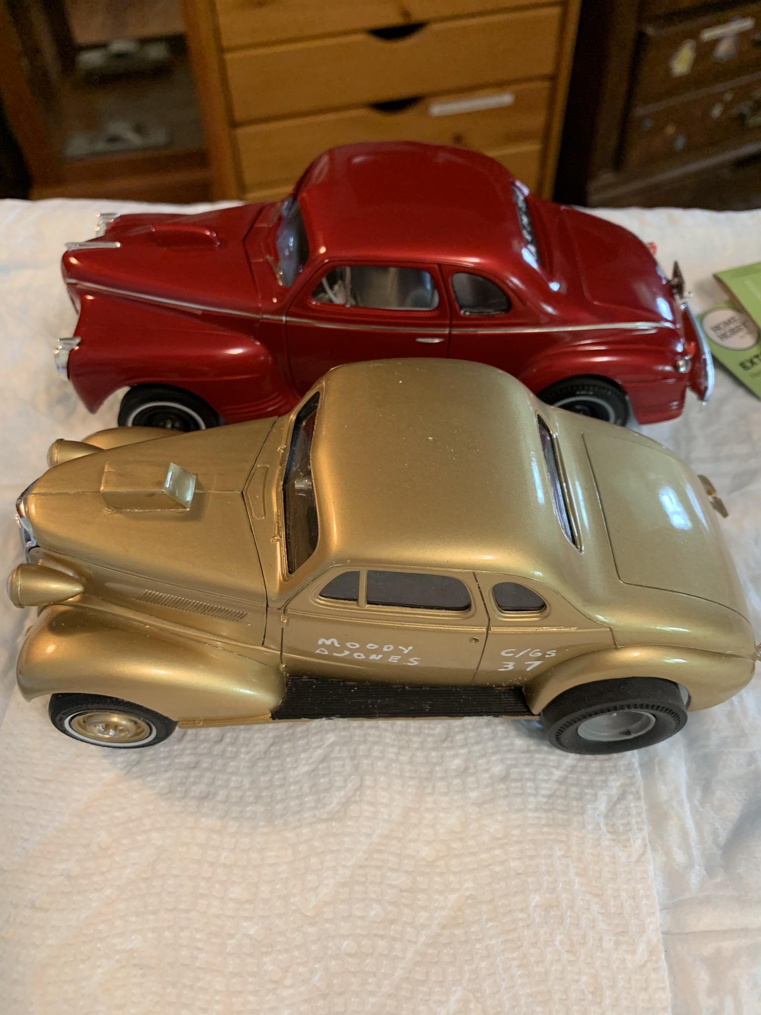

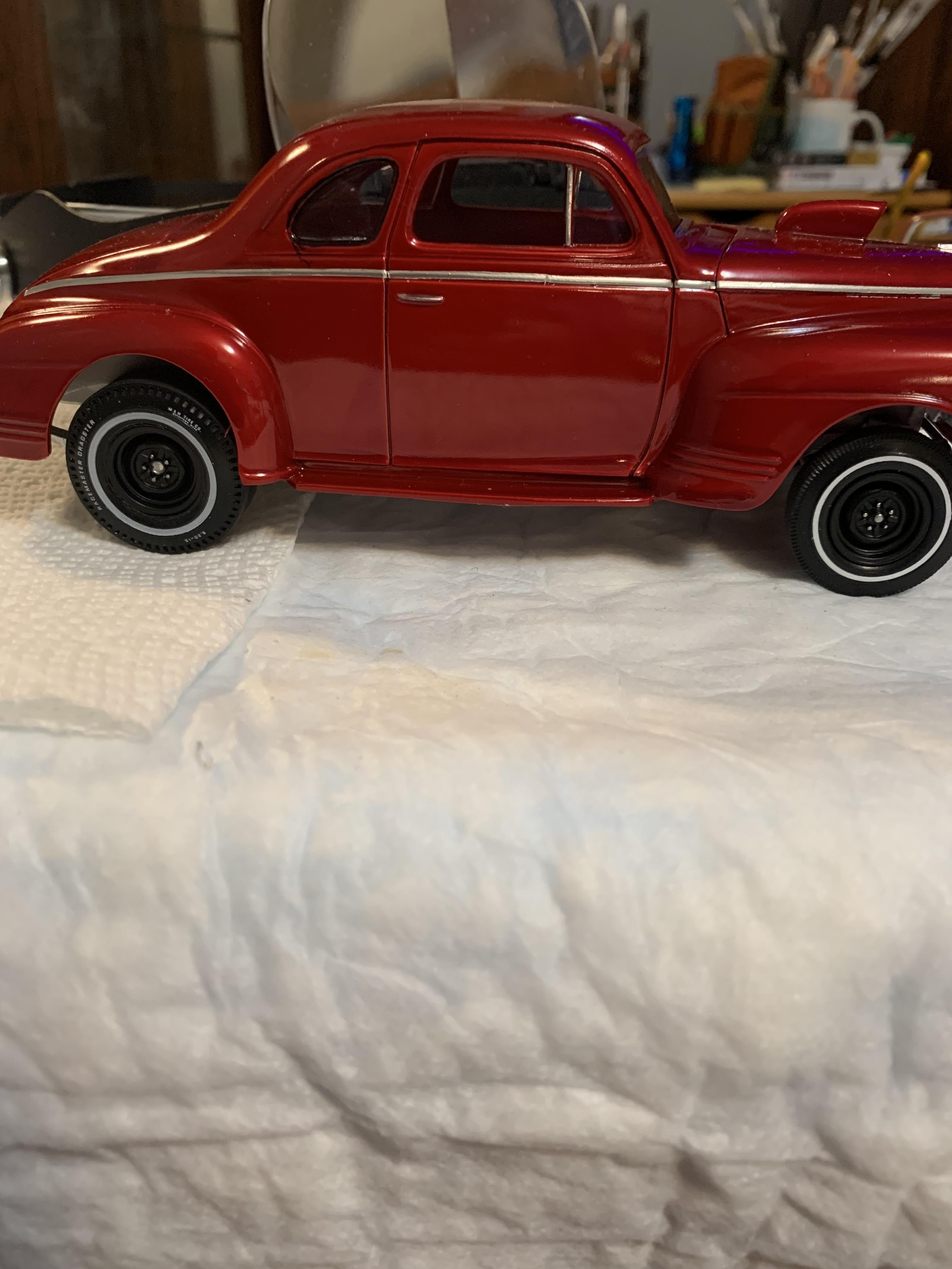

R. Thorne Posted December 5, 2023 Posted December 5, 2023 (edited) You absolutely cannot go wrong with advice from Ace. Keep in mind, though, that a lot of the early gassers were built using the stock front end. A couple of mine using the 41 Plymouth and 37 Chevy kits . One imaginary and one a replica of a real car (37 Chevy). Edited December 5, 2023 by R. Thorne 2

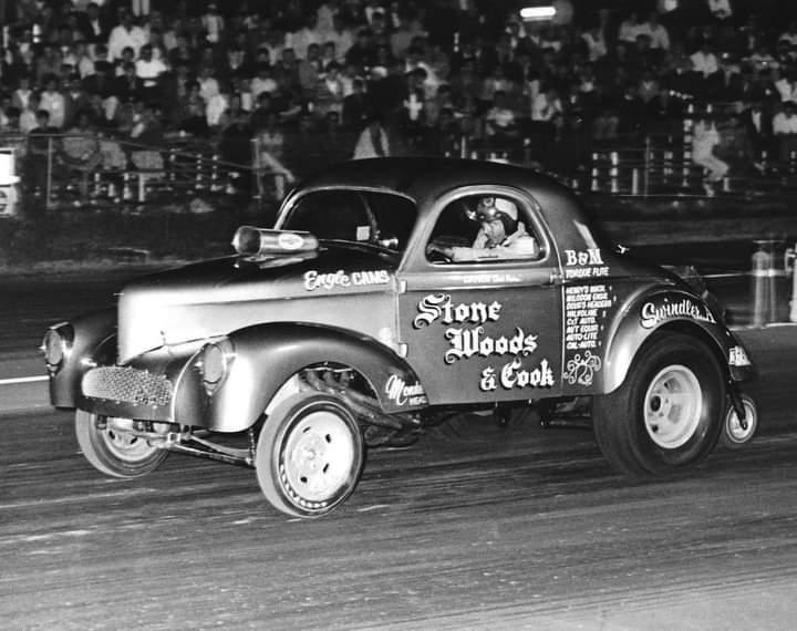

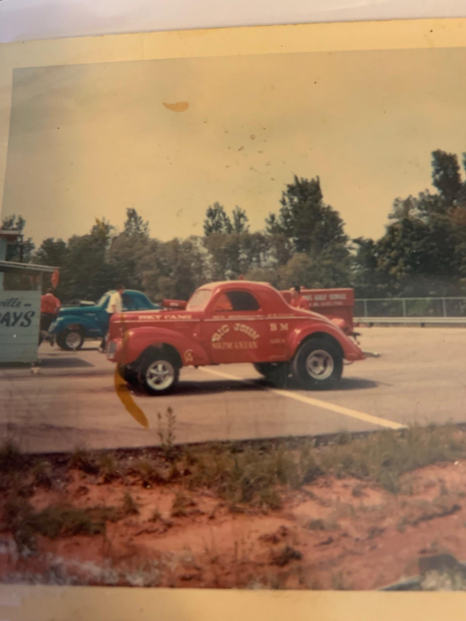

R. Thorne Posted December 6, 2023 Posted December 6, 2023 Part of the problem in assessing what these cars looked like (front end lift wise) is that most popular pictures of these cars were taken from leaving the line, not from a stationary position. This is a picture I took in the mid 60’s at a match race in Chandler, In. This was taken behind the starting line. Big John and Stone Woods & Cook were , of course, 2 of the most popular cars at that time. It seems like only yesterday that I was introduced up close and personal (about 15 ft. Away) to 2 blown hemis. 2
Ace-Garageguy Posted December 6, 2023 Posted December 6, 2023 6 minutes ago, R. Thorne said: Part of the problem in assessing what these cars looked like (front end lift wise) is that most popular pictures of these cars were taken from leaving the line, not from a stationary position. Exactly. And the front-end lift under hard acceleration leaving the line is misinterpreted to be a nose-high stance while standing still. There's been a lot of argument over it in the past, of course. Great photo, by the way. Man I miss those days. 1

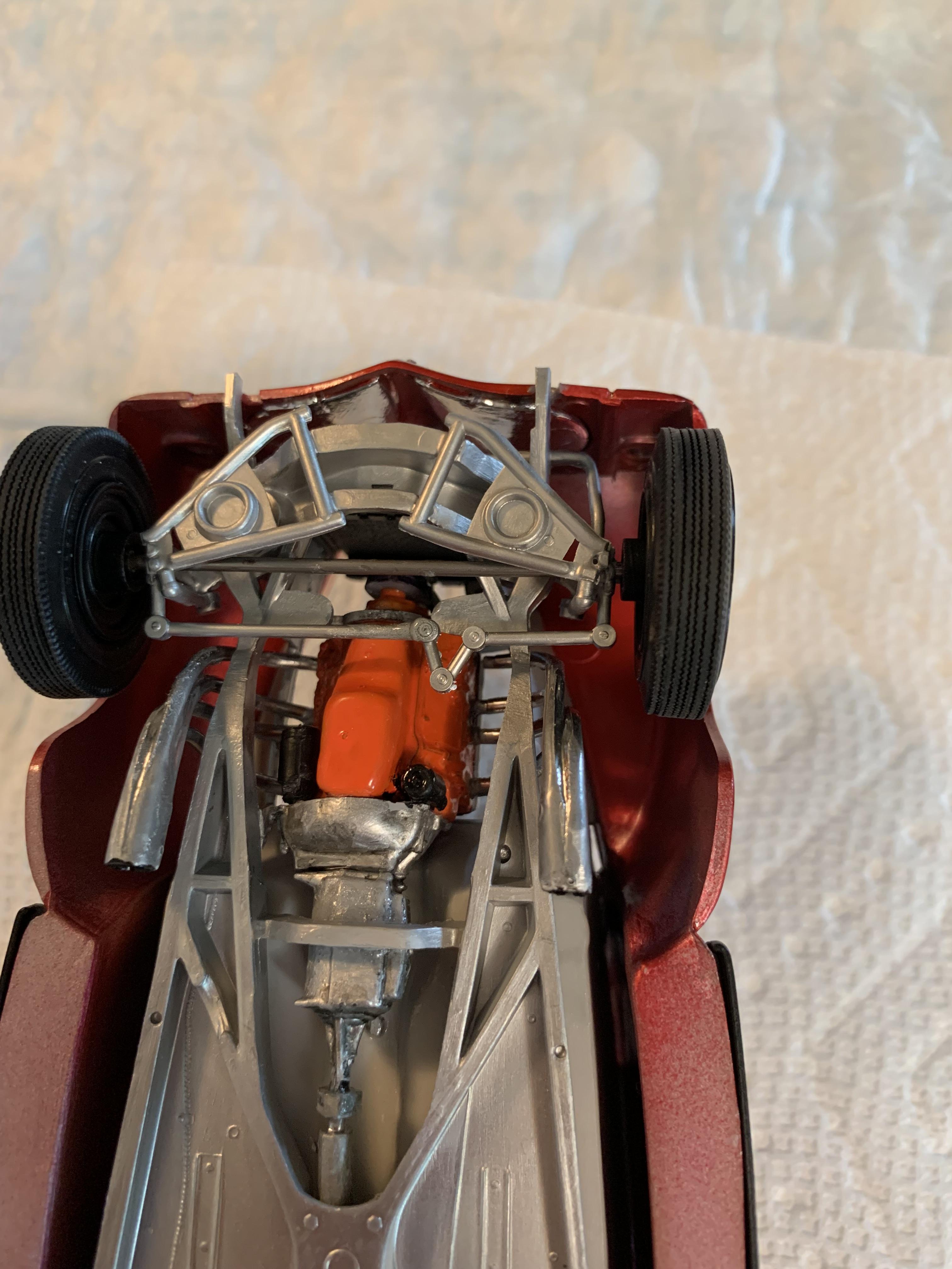

64SS350 Posted December 6, 2023 Posted December 6, 2023 I followed the pattern that Ace and maybe someone else showed us on here. And yes.....these methods are not that hard and look great! (Thanks for posting) Here's my build thread if anything on there helps, these are replicas of my friends 1:1. 2
Straightliner59 Posted December 6, 2023 Posted December 6, 2023 1 hour ago, 64SS350 said: I followed the pattern that Ace and maybe someone else showed us on here. And yes.....these methods are not that hard and look great! (Thanks for posting) Here's my build thread if anything on there helps, these are replicas of my friends 1:1. I loved following your Flintstone Flyer(s) project. Nice work on those! 1

R. Thorne Posted December 7, 2023 Posted December 7, 2023 Well, couldn’t keep from posting this picture of a focused driver and Bad car. 1 1
Ace-Garageguy Posted December 7, 2023 Posted December 7, 2023 15 minutes ago, R. Thorne said: Well, couldn’t keep from posting this picture of a focused driver and Bad car. Nice shot. And notice the thing isn't stupid-nose-high even coming out of the hole at this point in its development, thanks to those whitewall-tired wheelie bars...which I've never noticed before on any of the SWC '40 Willys cars. 1
Mark Posted December 7, 2023 Posted December 7, 2023 That's a very late, match race version of the Willys. S-W-C seem to have abandoned Gas class for match racing in 1965-66. Note also the trimmed lower body. This car is restored, as is the first one (that the old opening-doors Revell kit represents).
