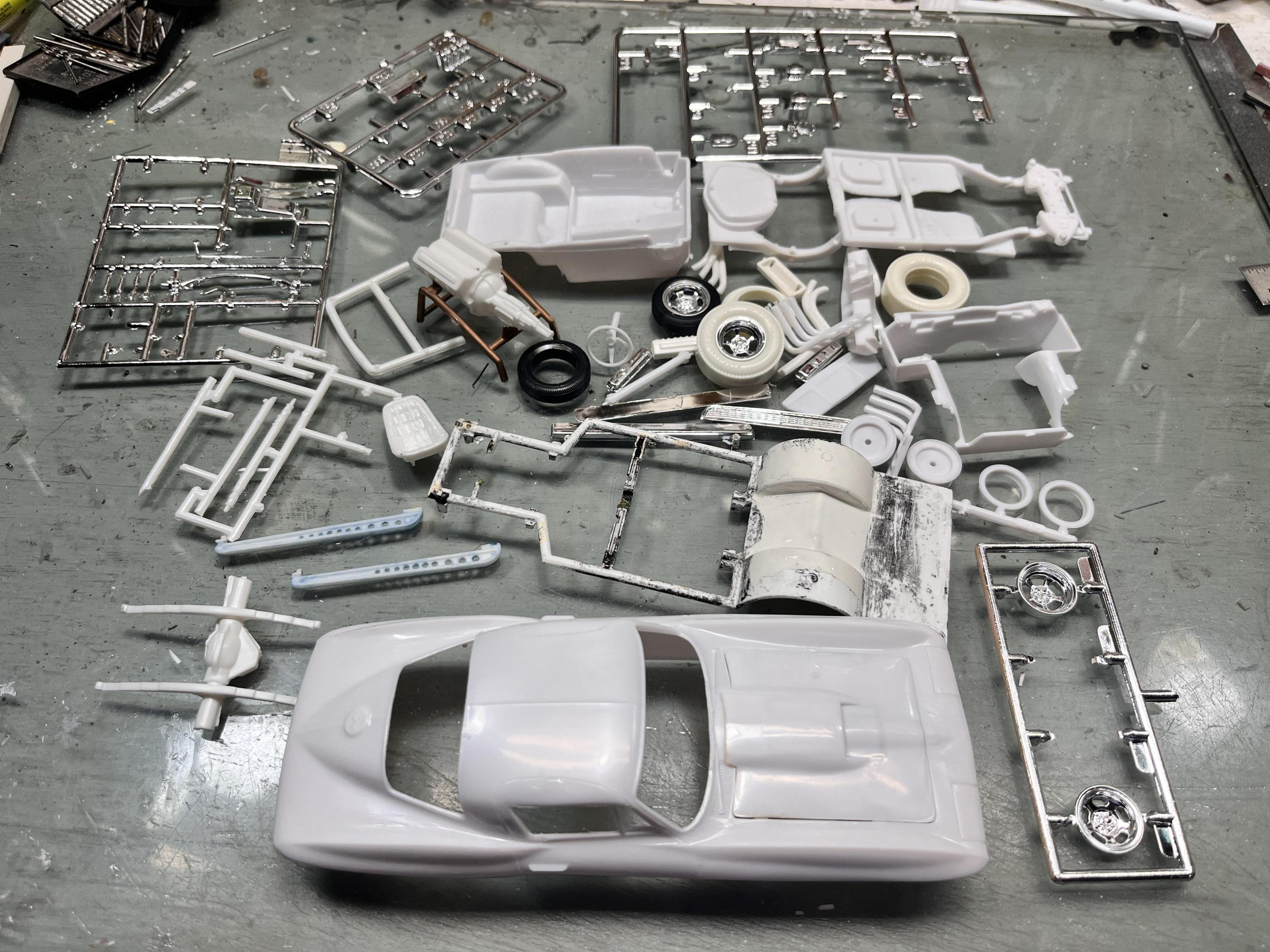

here's the kit I'm starting with....

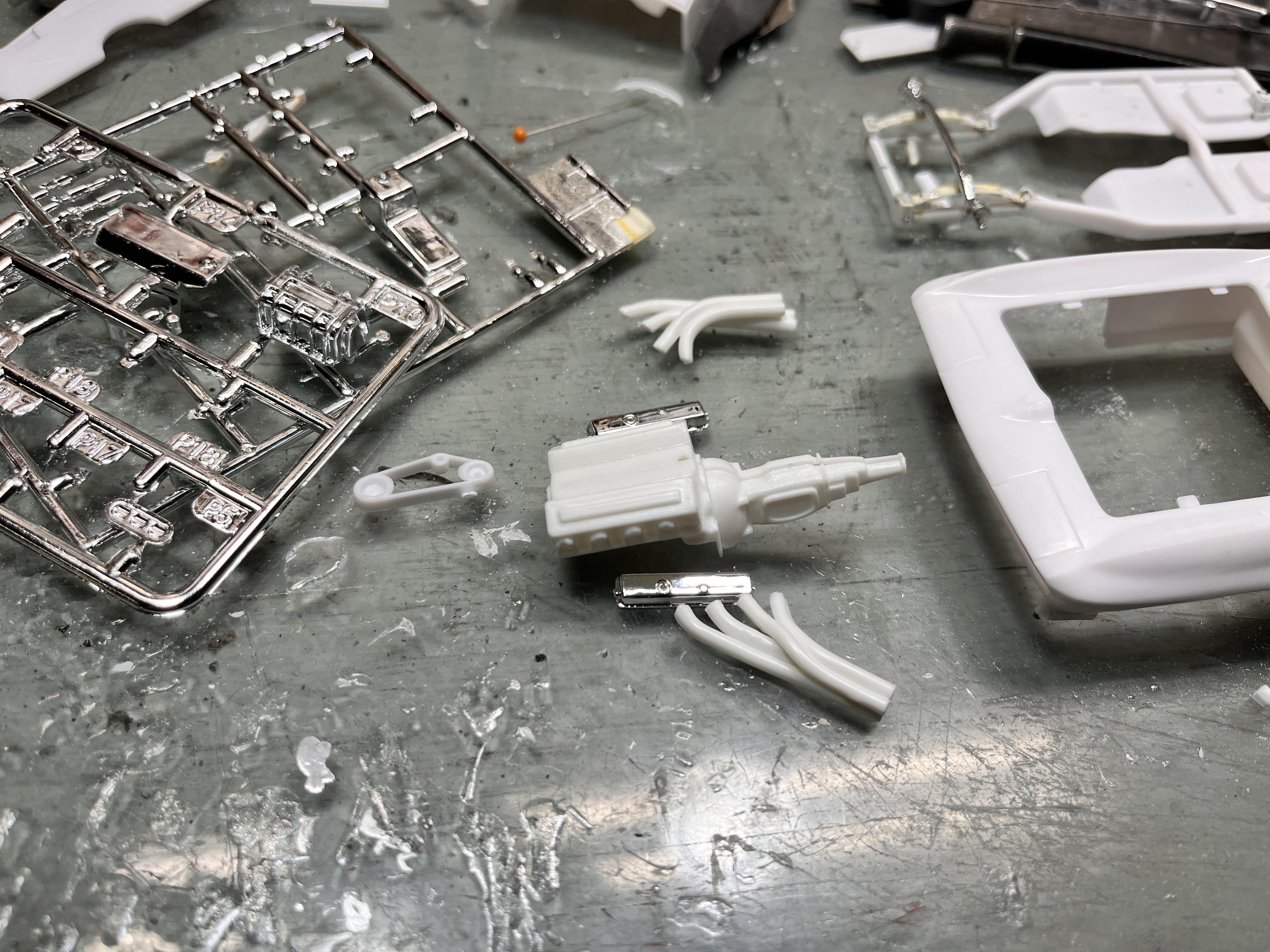

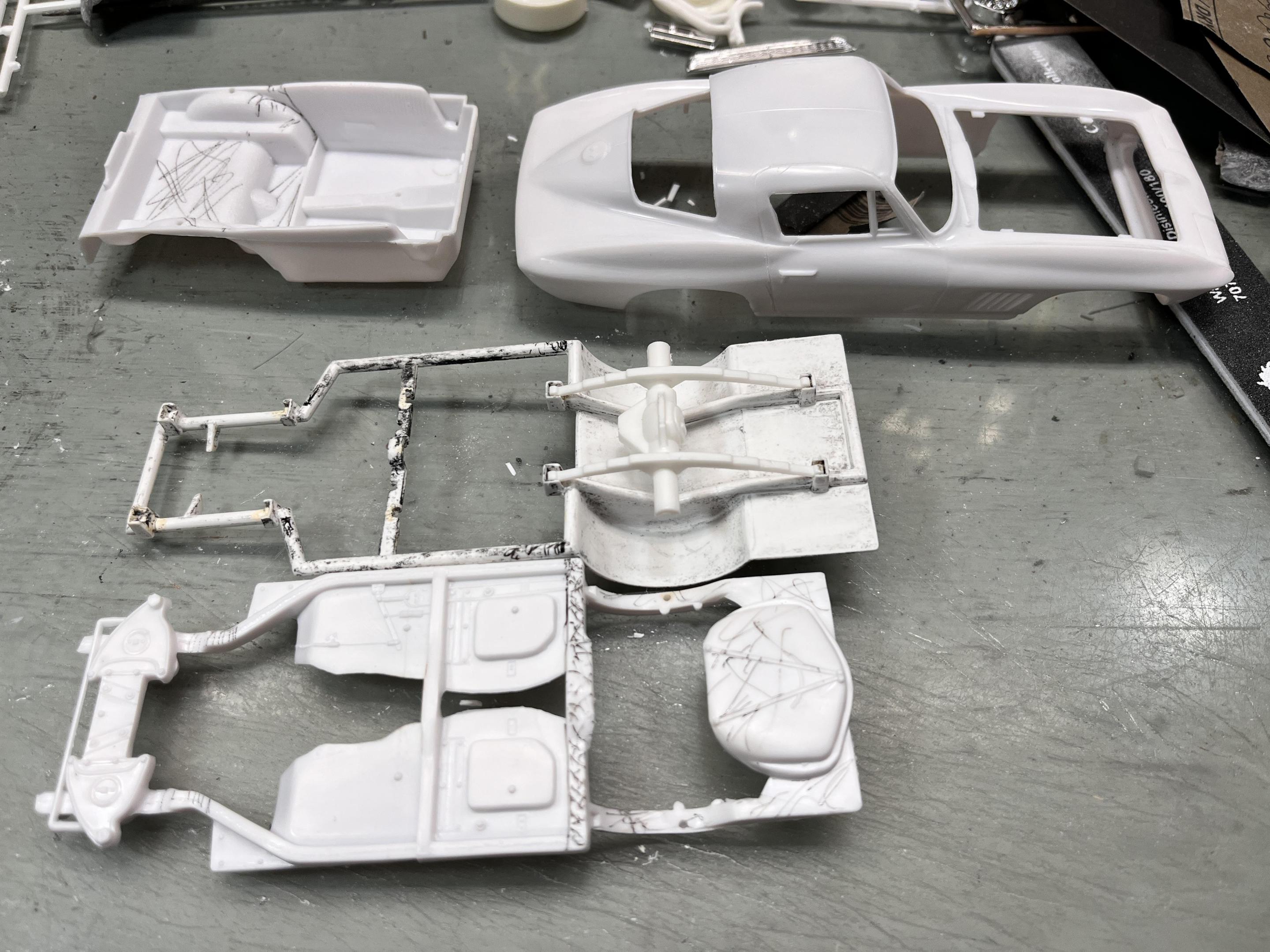

Here's the "yard sale" of parts....

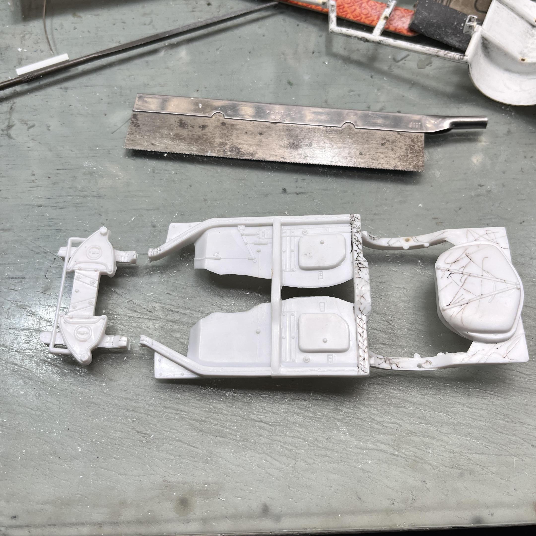

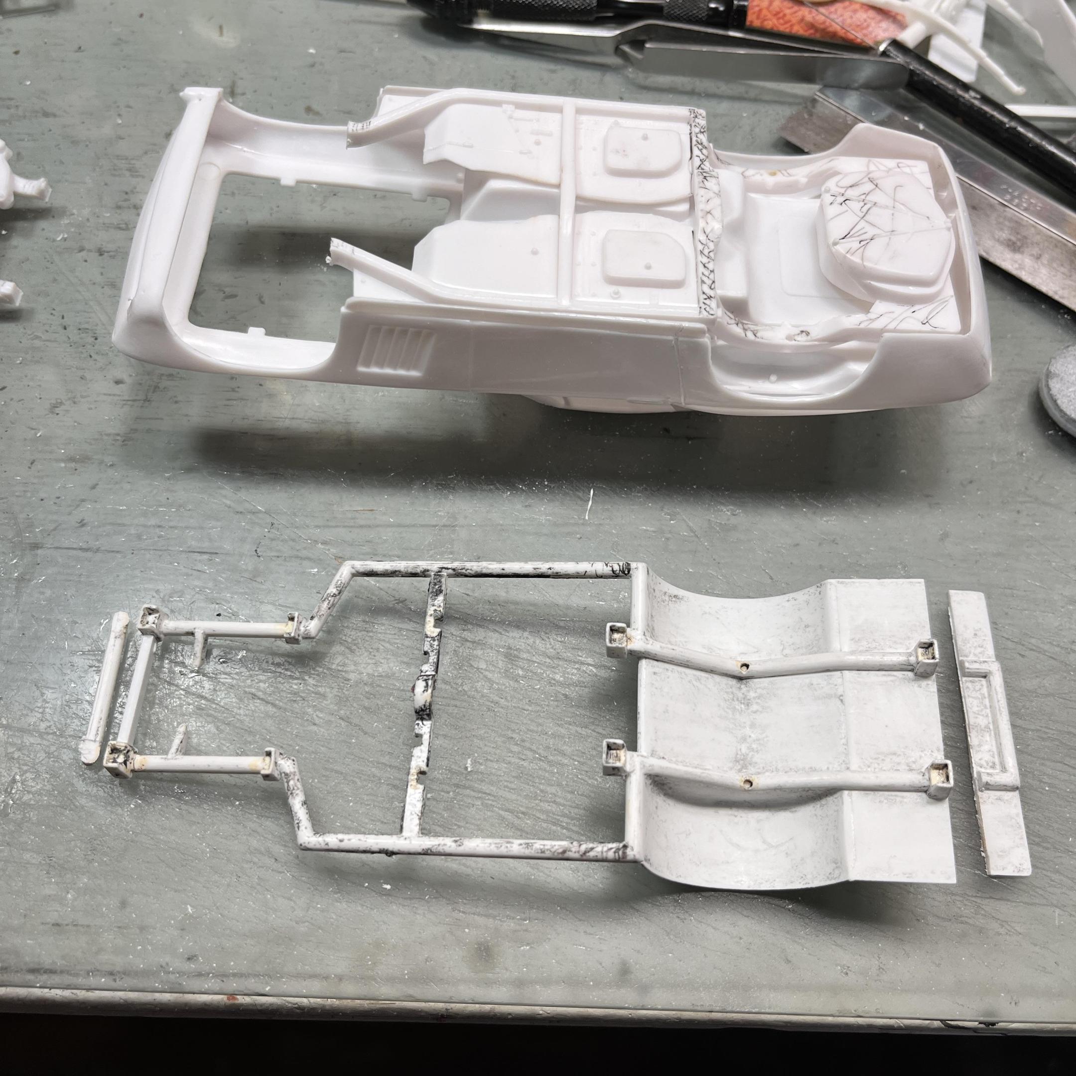

The plan is to cut of both ends of the Corvette frame and graft on the front and rear ends of the AWB frame. The AWB frame is a part I've had for decades. I stripped off the brushed on black paint. The fit is almost perfect. The back part of the Vette interior tub will be cut off in favor of a smooth package tray. More on that later.....
I cut off the front of the Vette frame....

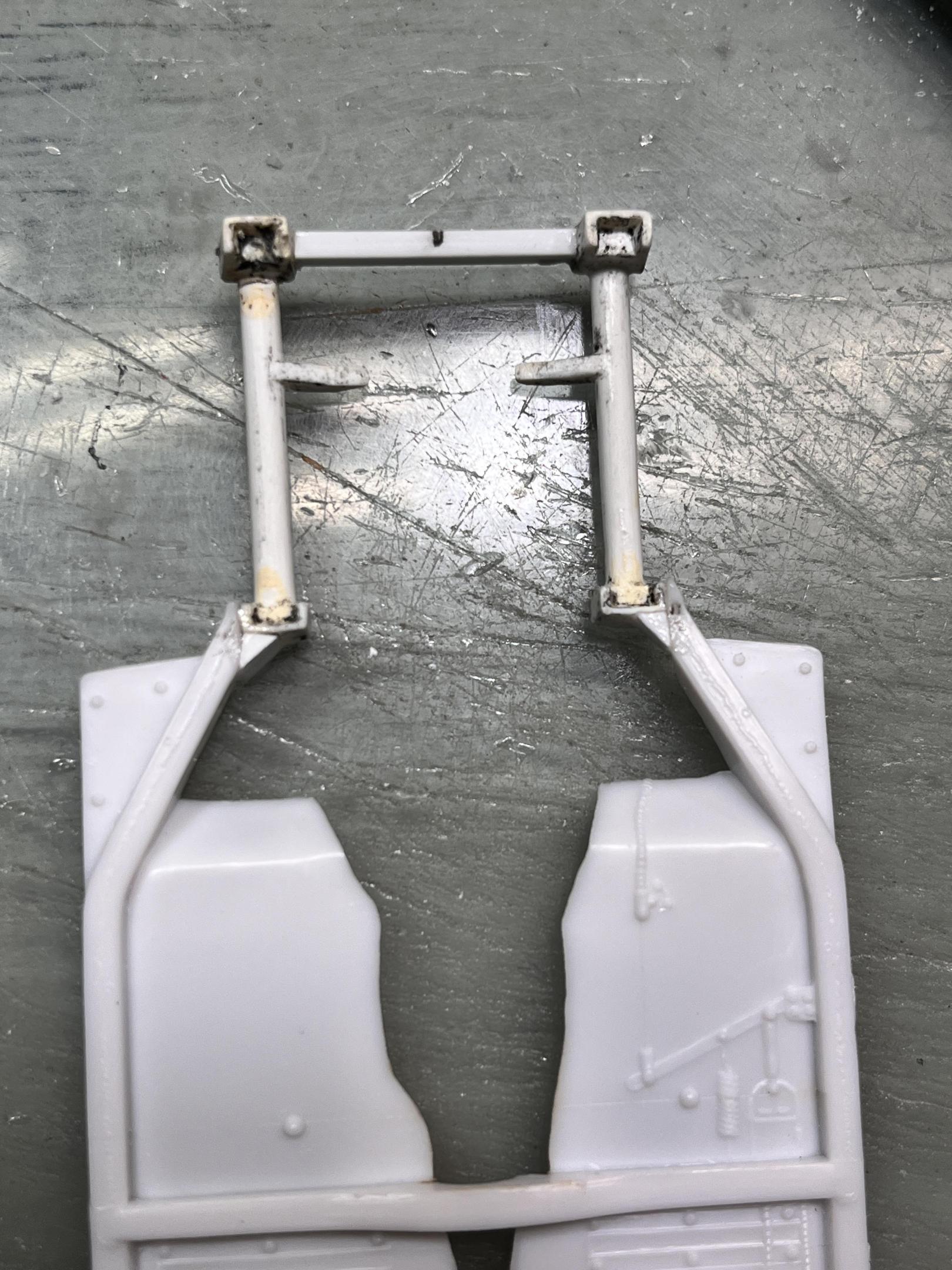

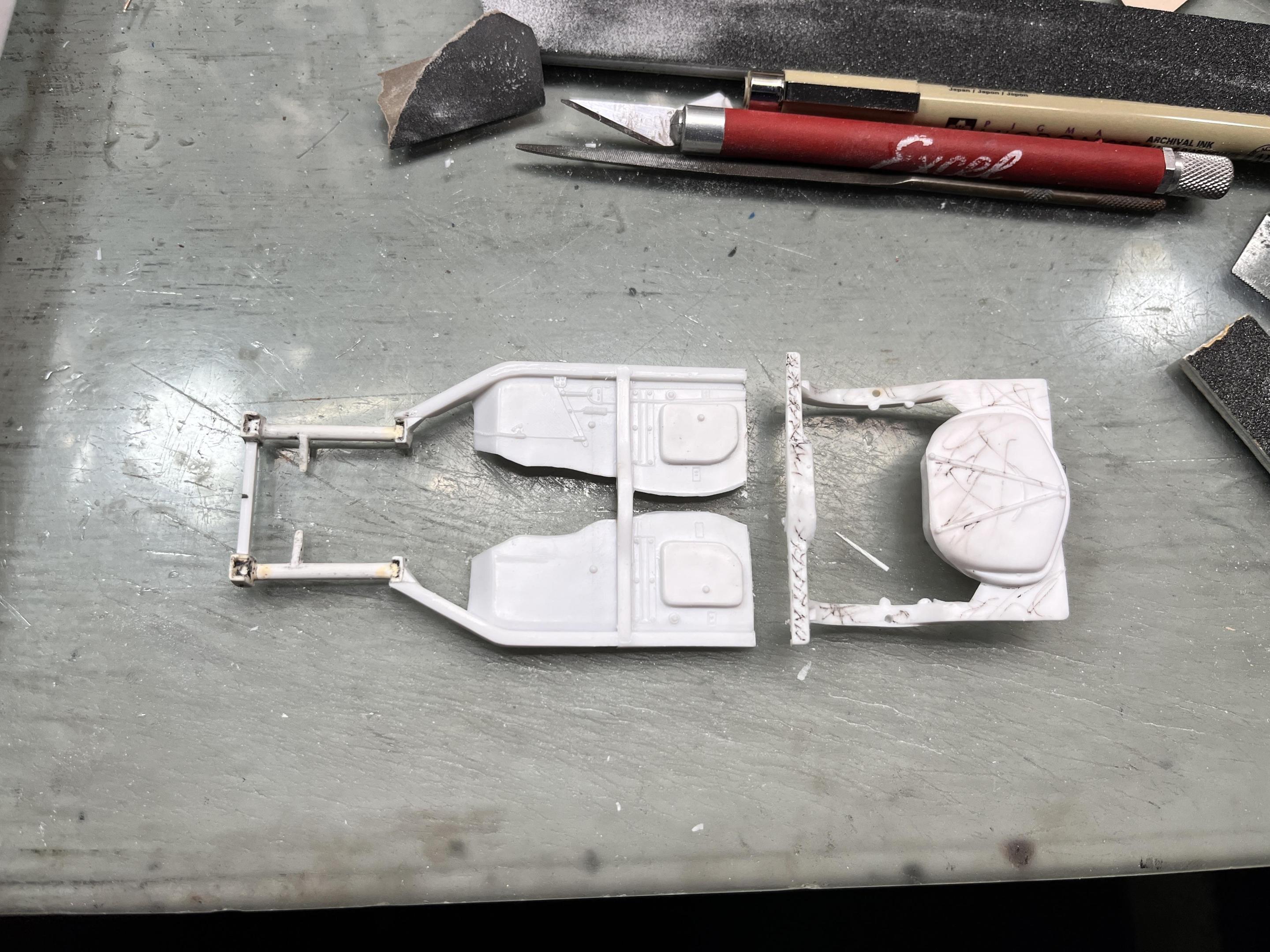

I then trimmed off both ends of the AWB frame...
The next step will be to cut off both ends of the AWB frame and graft it onto the Corvette floor pan.

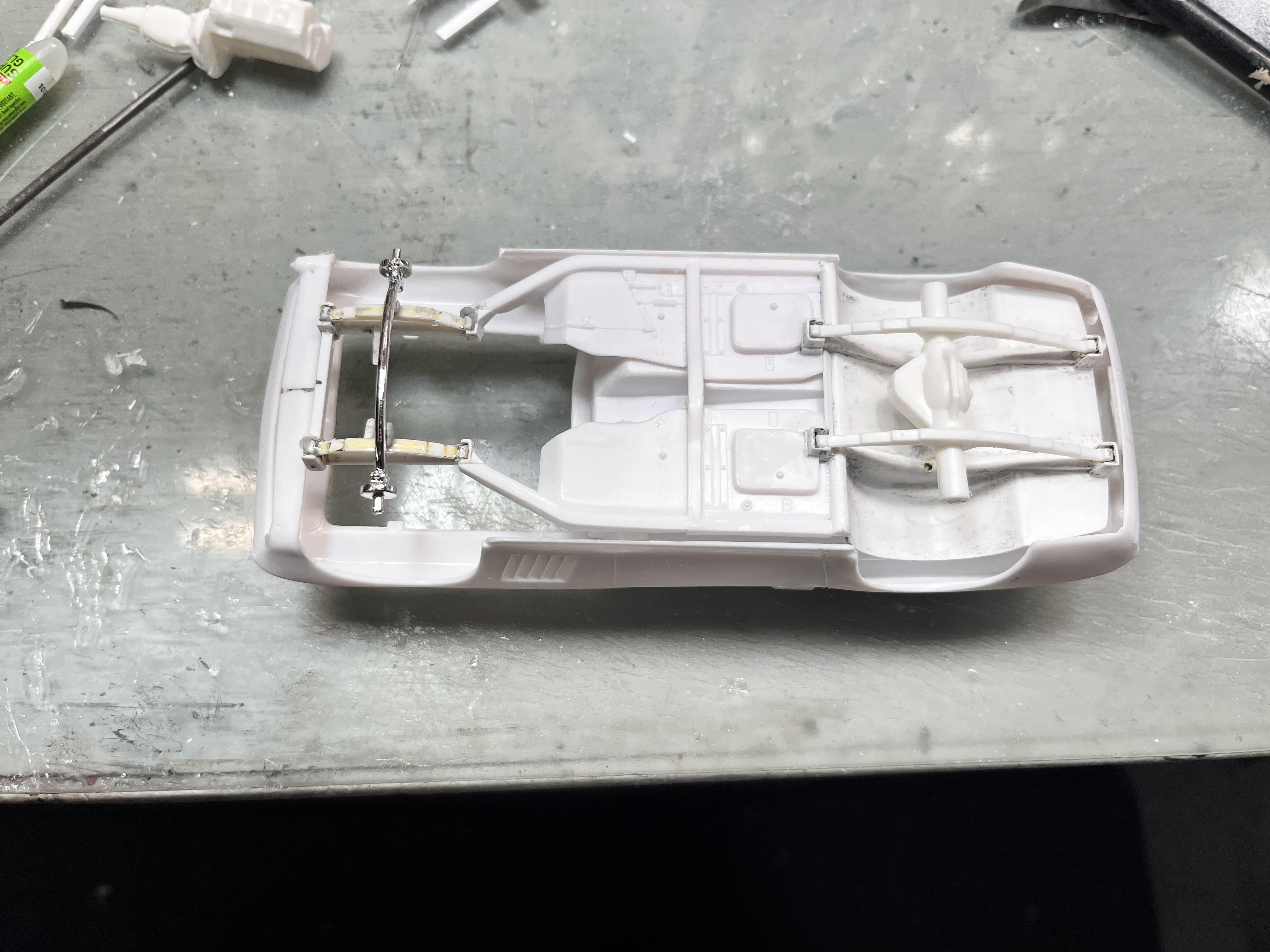

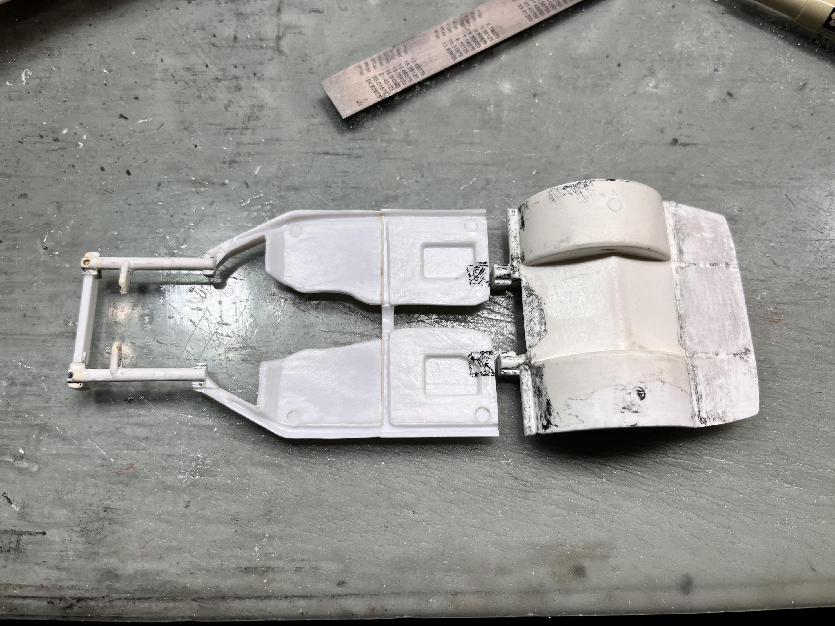

Ok, moving on to grafting on the front and rear ends of the AWB chassis to the Corvette floor pan...
fit and futz, file, sand, test fit some more, futz some more....gloo the ends together and add a little triangle support. It's not exactly square, but I'm not going to correct it now...in hindsight, I should have braced the back part of the AWB frame/spring mount piece to keep it square...too late now...
cut off the back part of the Corvette floor pan....
mark where the cuts to be made on the front mounts of the rear springs.....
like so...notice that the rear of the AWB floor pan has been shaped to fit the Corvette body......

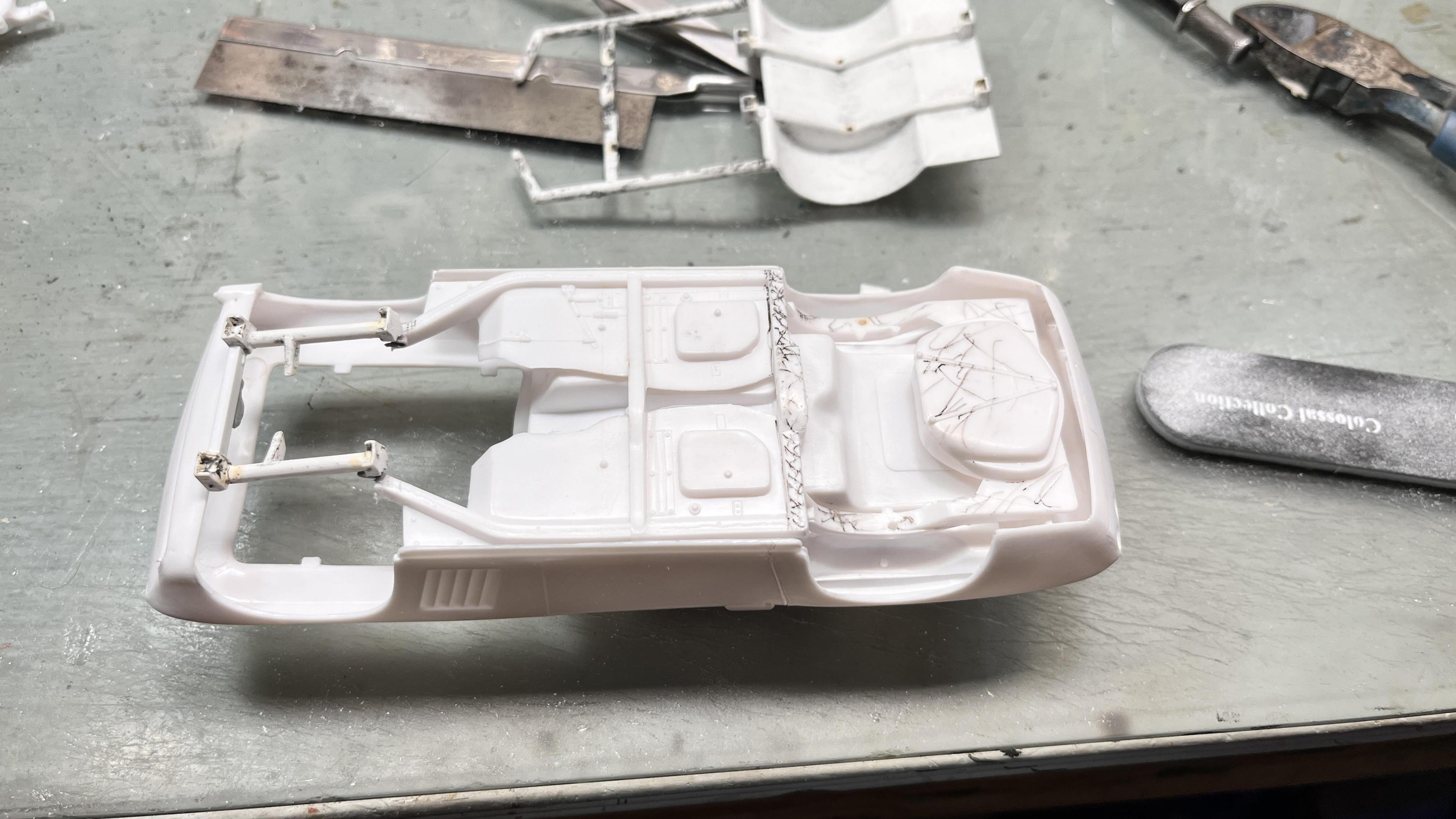

drop the chassis into the body with a blob of Blu-tack to hold the front end to the body....perfect!!!
A test fit of the front and rear axles shows it all lines up pretty well!!!

6 hours ago, TarheelRick said:
it appears both the front and rear axles are not centered in the wheelwells

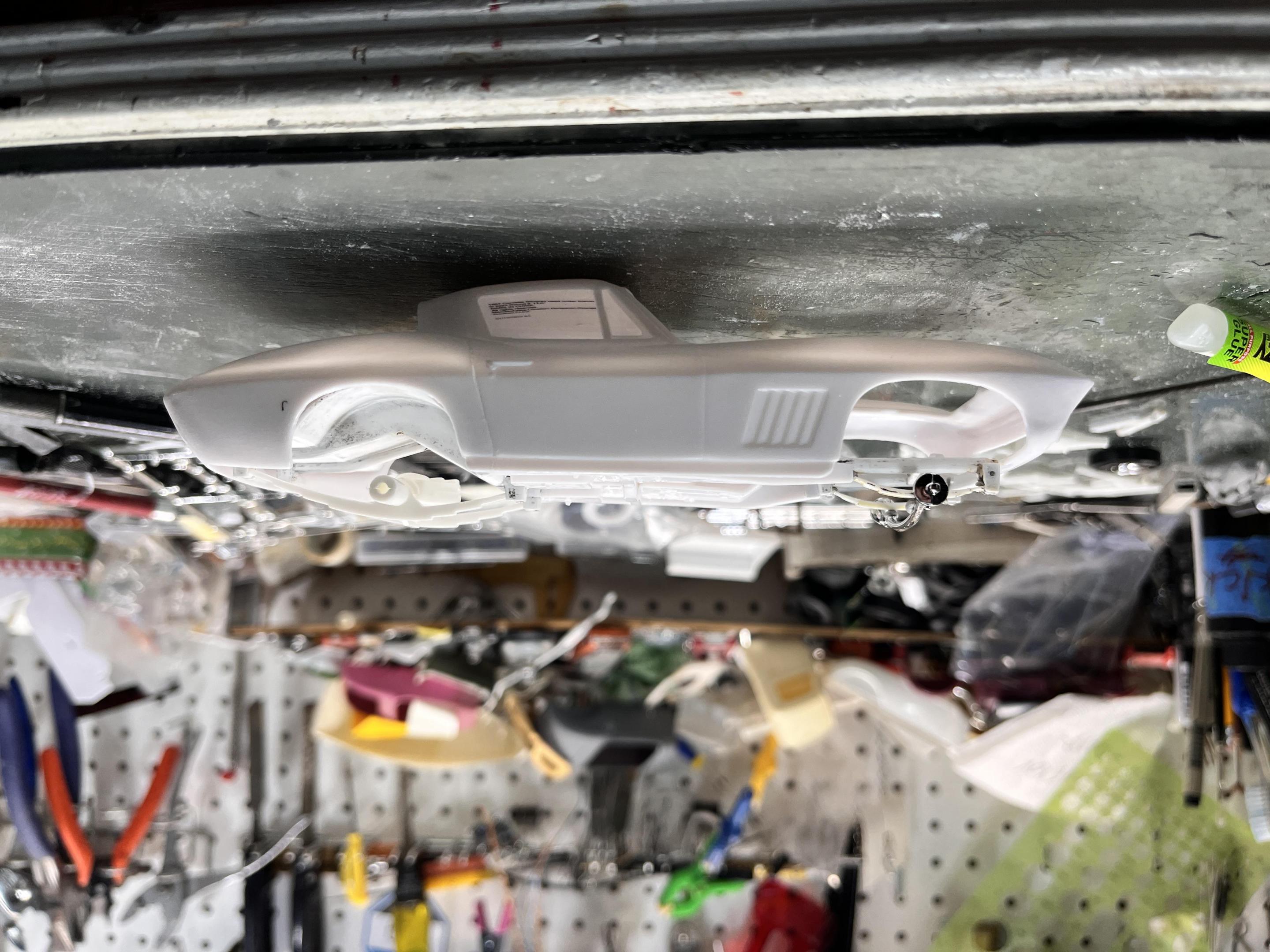

I think it is a bit of perspective, the frame will be back a tad further than shown and then a bit of careful wheel well massaging on both the front and rear, will make it all fit....
Here's a straight on shot, taken with the body upside down on the bench and the the pic flipped 180 degrees.... there is a little wiggle room front to back between the frame and the body. The Corvette floor pan literally just rests on the interior tub. This Corvette kit is really mediocre at best.... -RRR
Here's a straight on shot, taken with the body upside down on the bench and the pic flipped 180 degrees.... there is a little wiggle room front to back between the frame and the body. The Corvette floor pan literally just rests on the interior tub. This Corvette kit is really mediocre at best.... -RRR
Get Down! What R U up 2? This is all Topsy-Turvy!! -KK

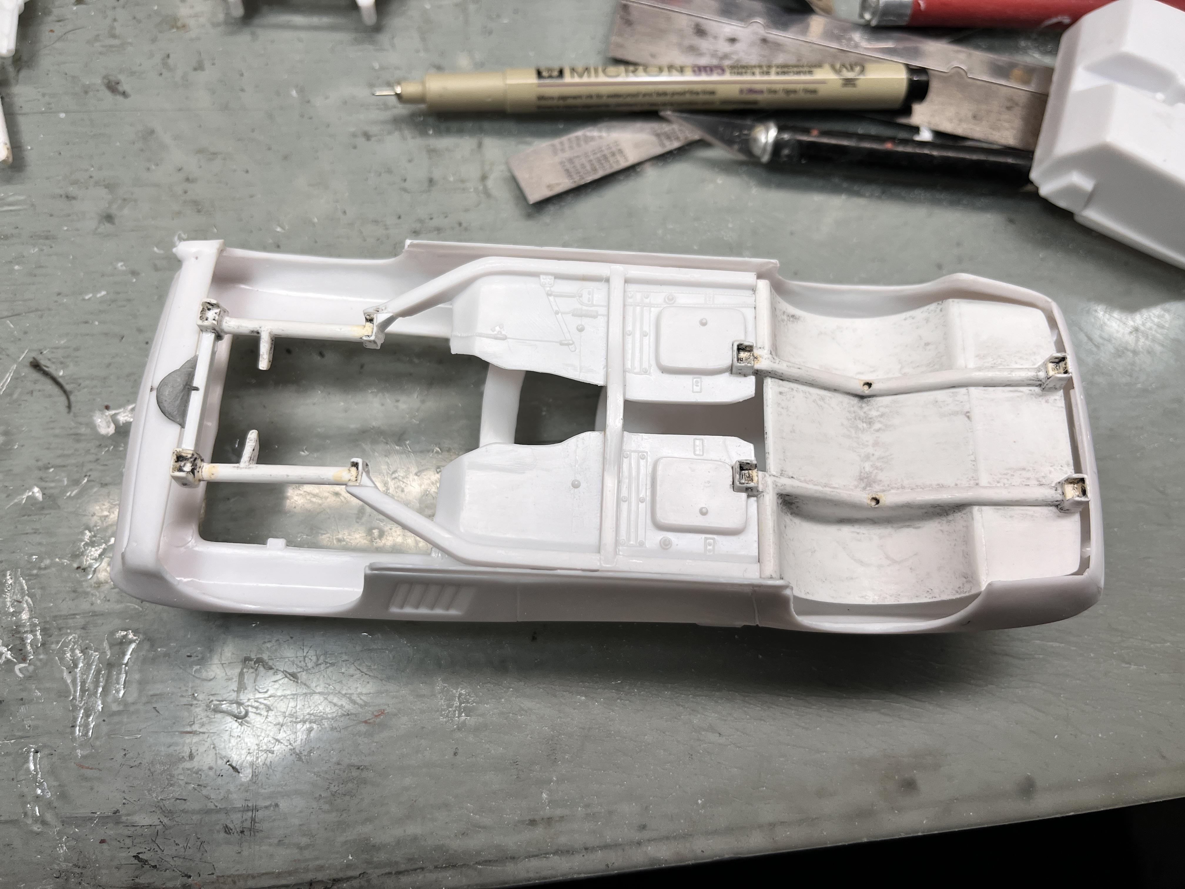

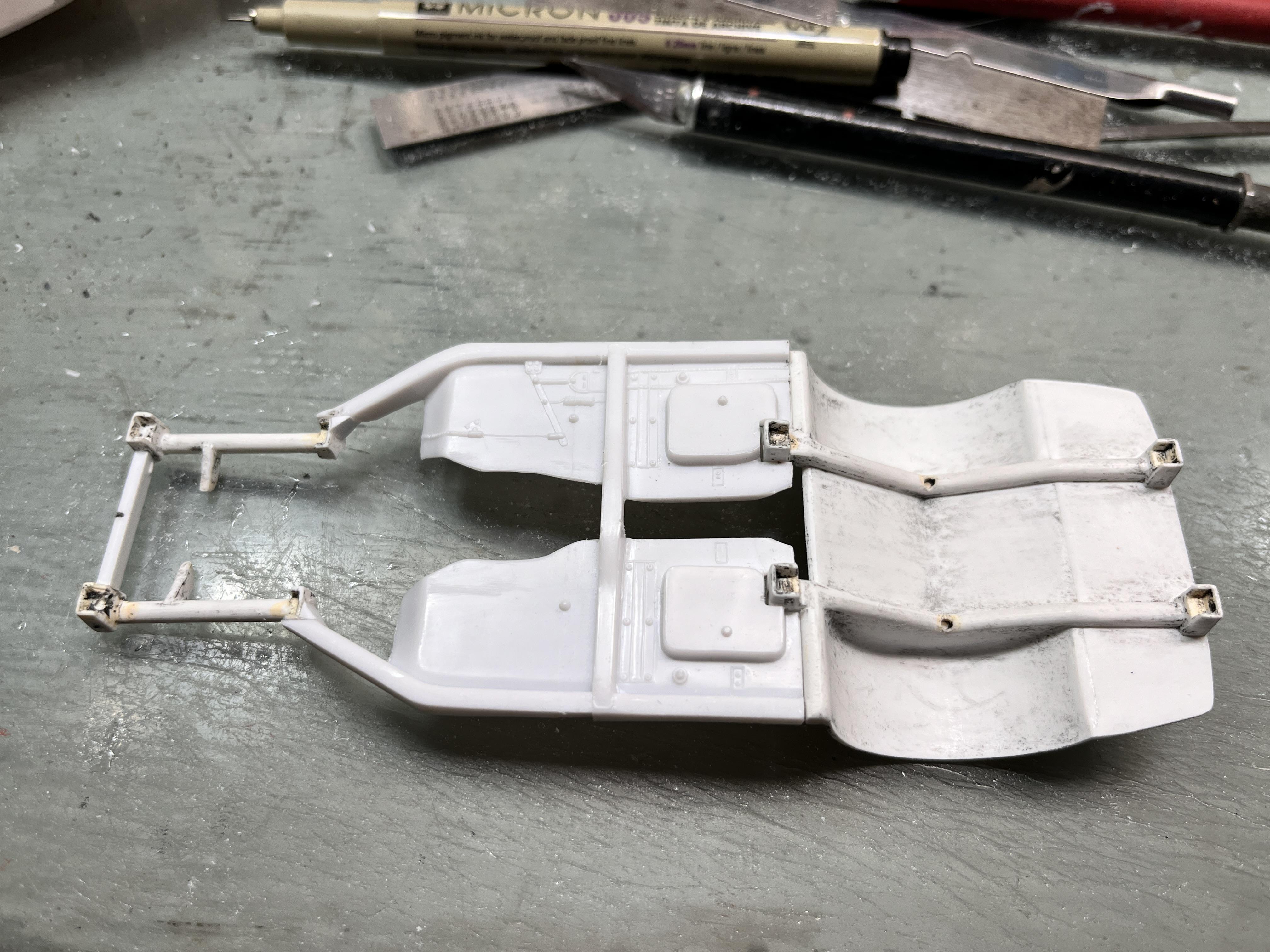

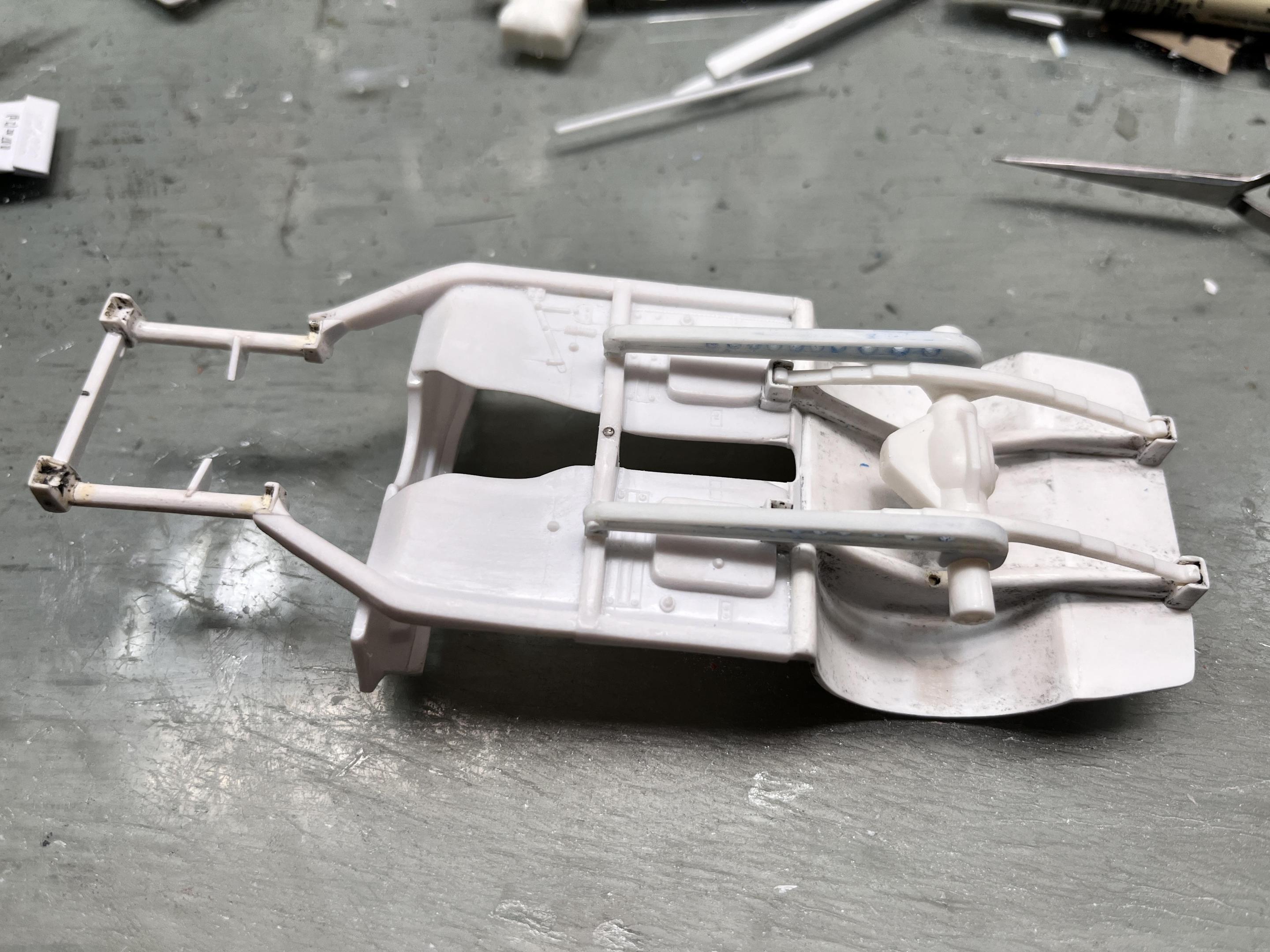

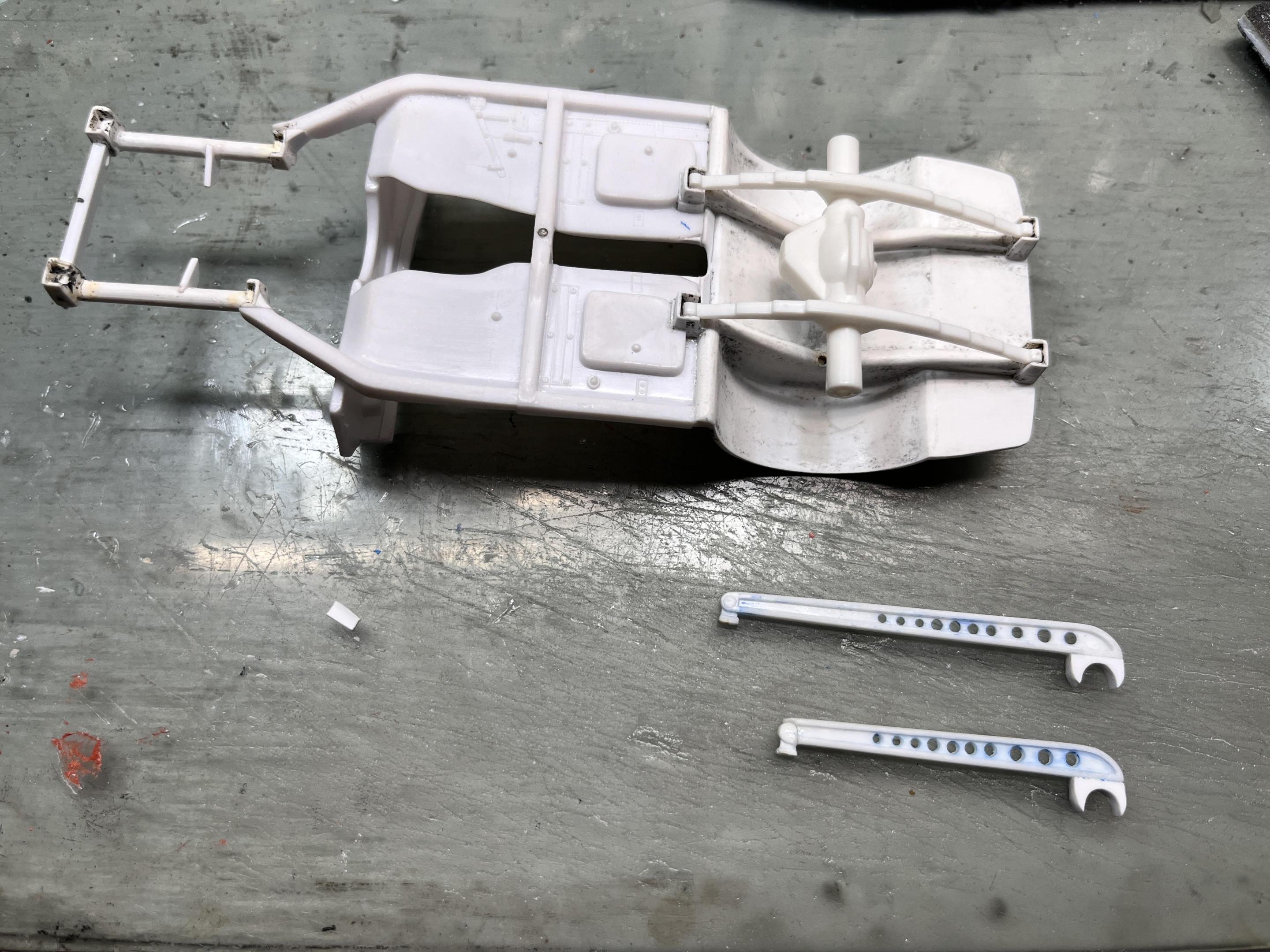

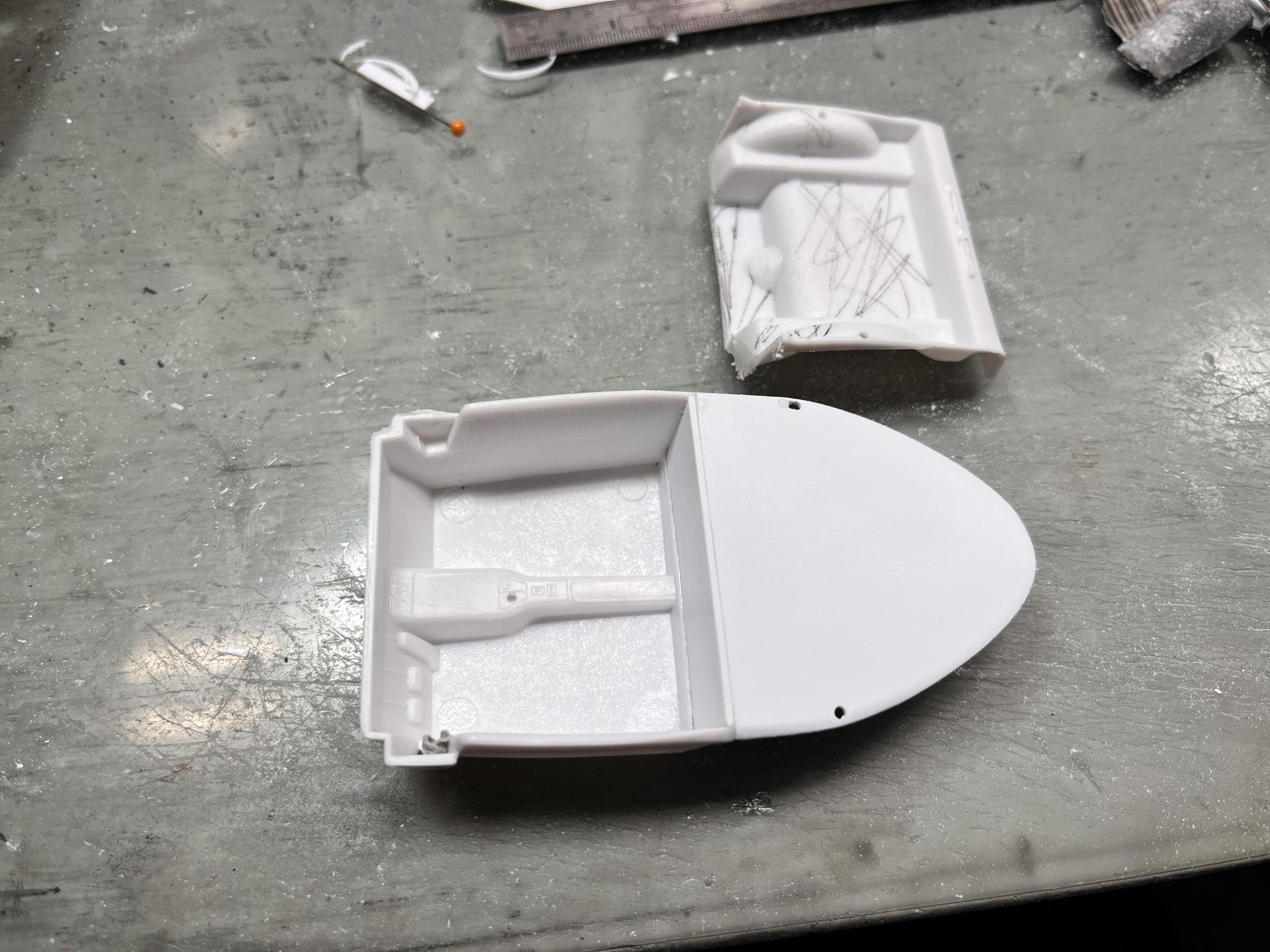

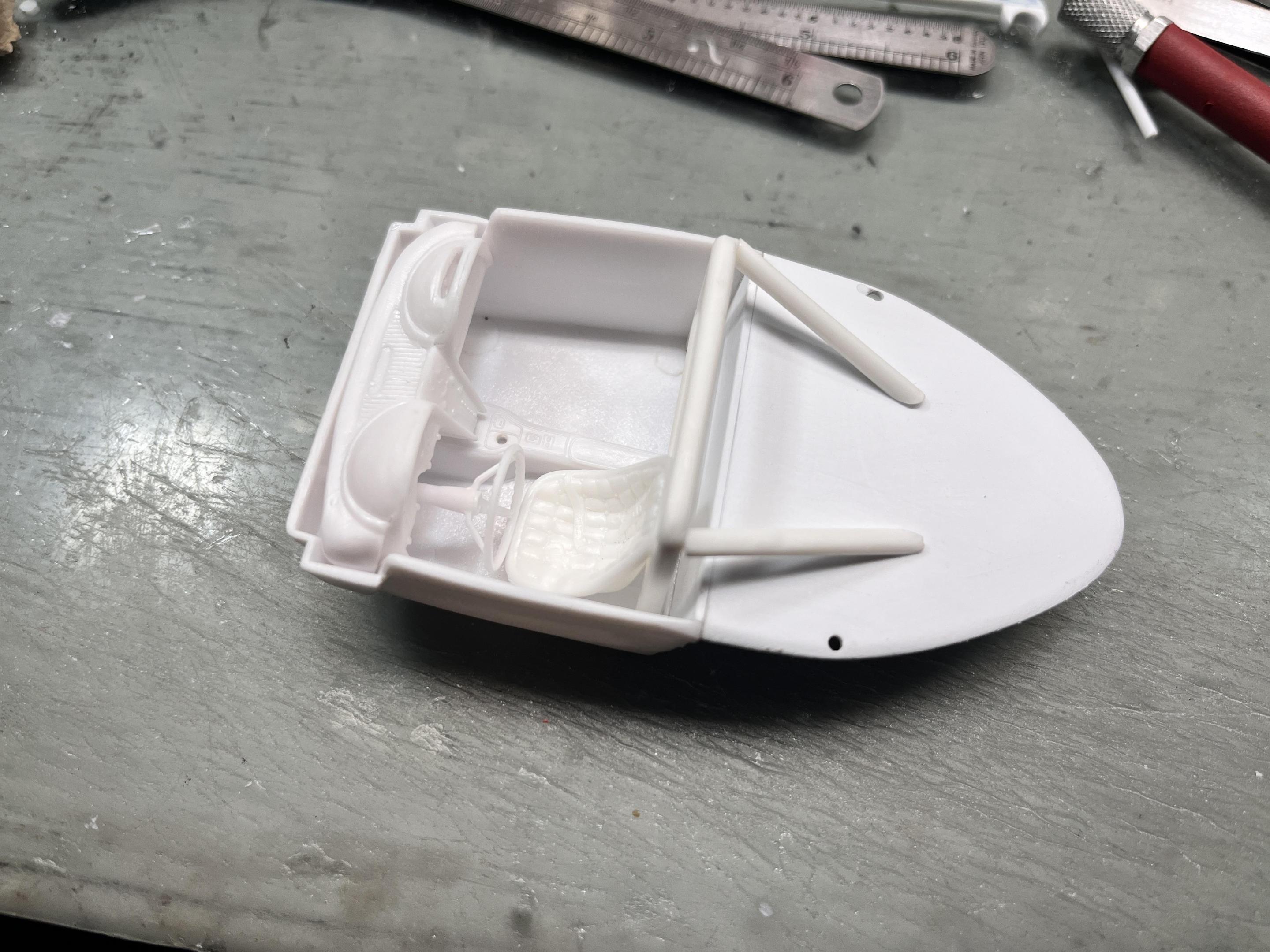

I made some quick work on the interior. Since I added the rear tubs, the back half of the tub needed to be hacked off and replaced with a smooth package tray...PhotoNov24202322728PM.thumb.jpg.3629ec53506a6af641608fc50b2ff854.jpg
There are mounting tabs on the body and I made careful measurements and drilled out the new tray to make sure I have an accurate location for the tub...
A spartan race interior with a single seat and the rollbar from the AWB kit....
More later.... -RRR

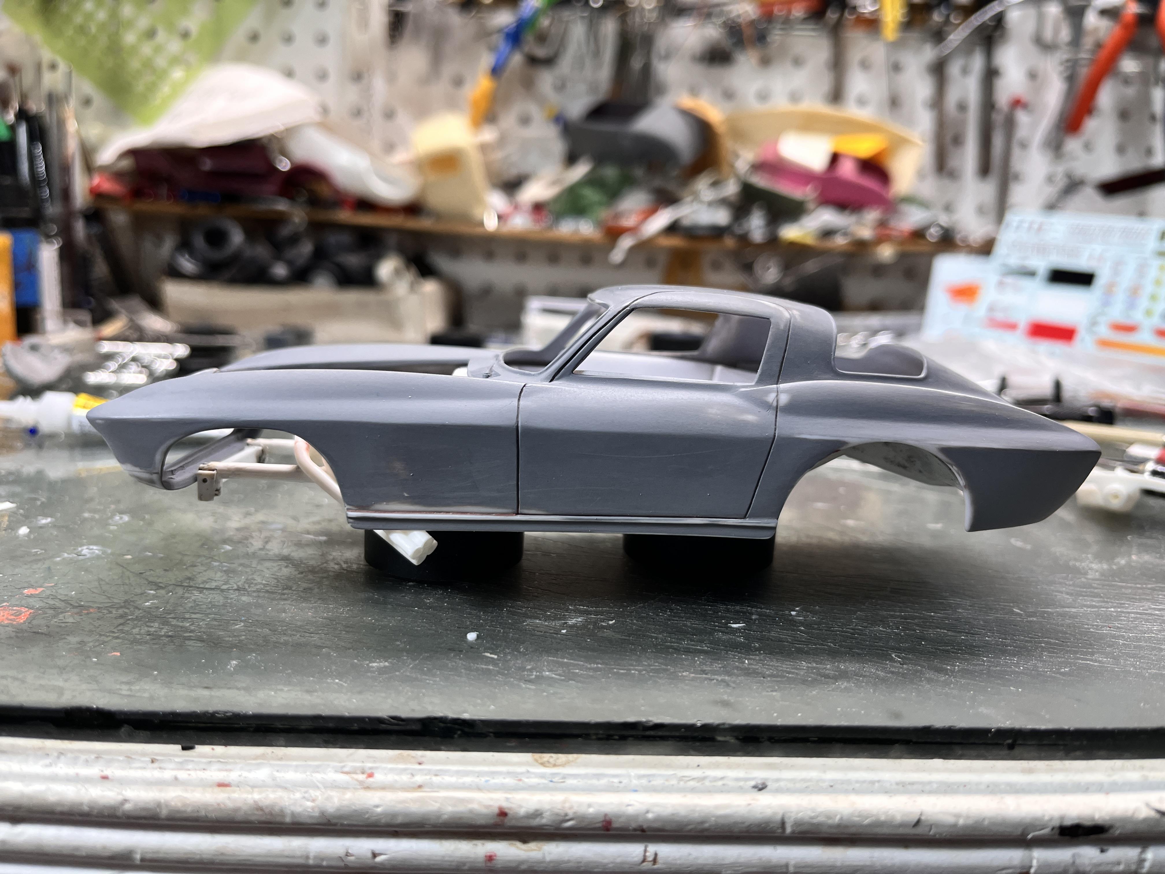

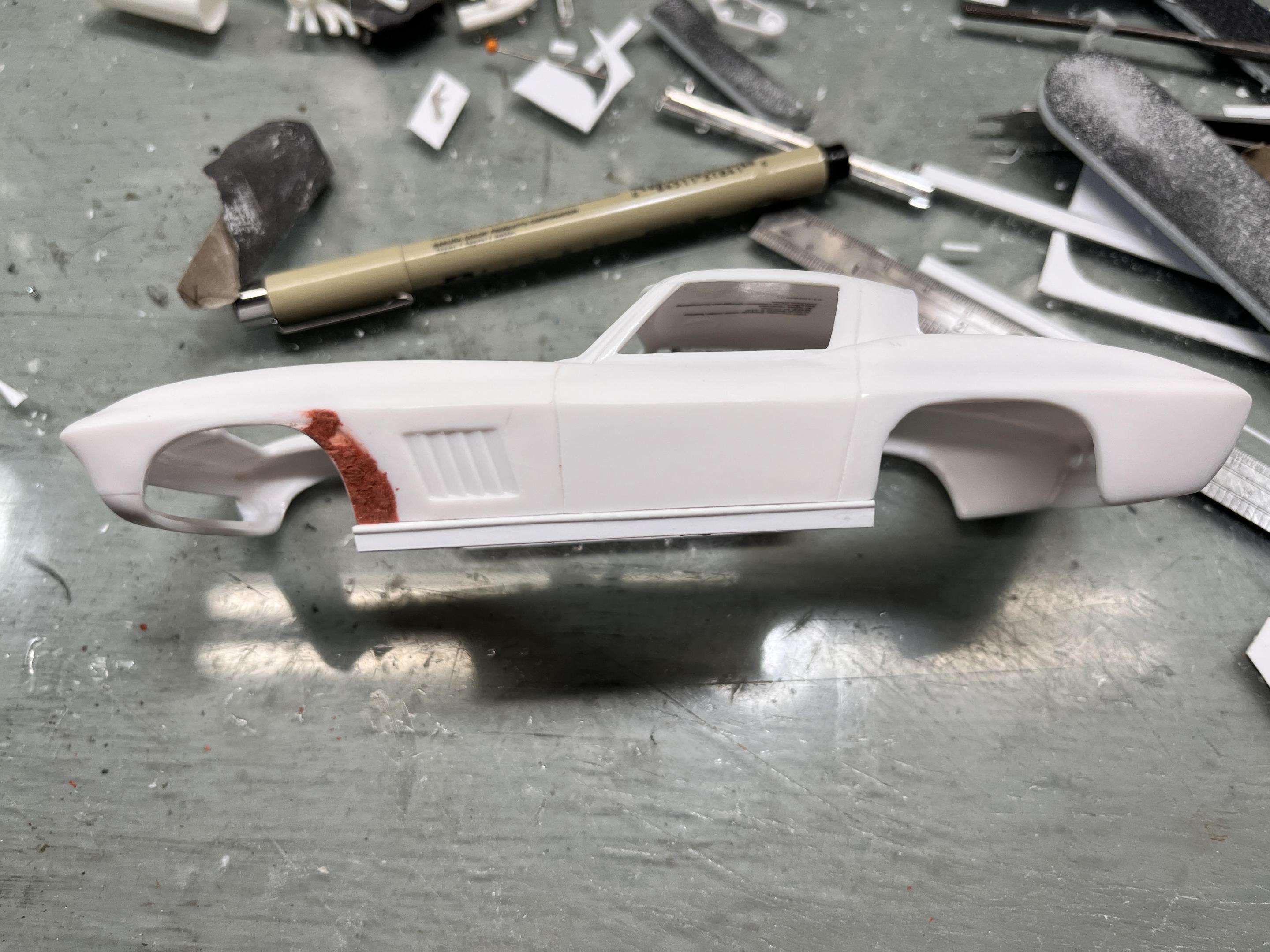

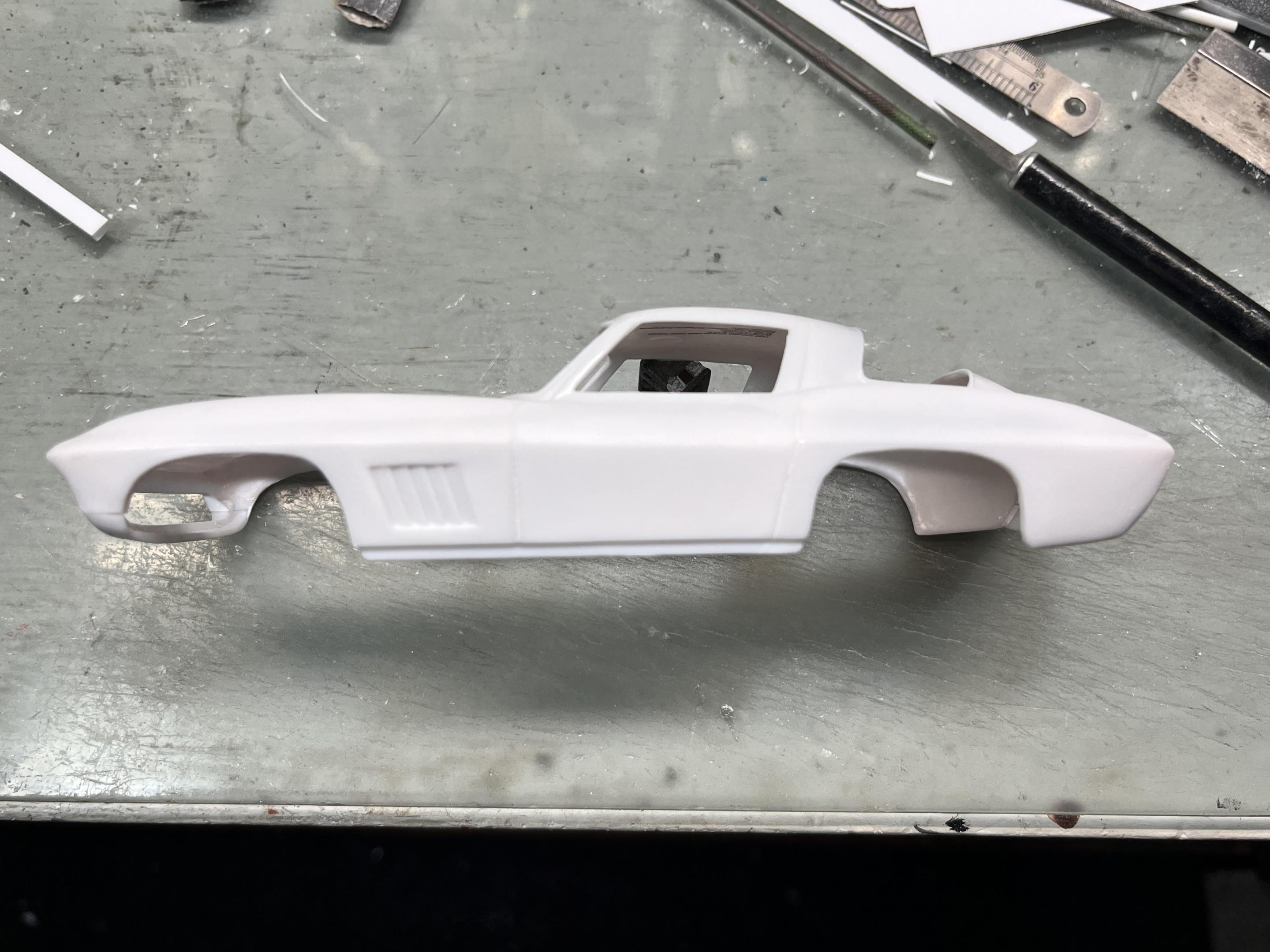

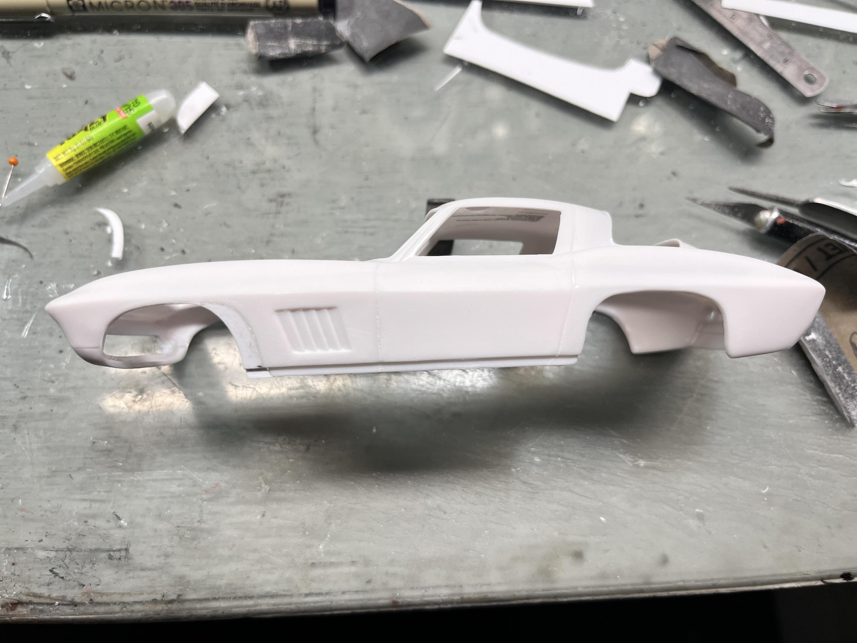

Time to turn to on the body. The first task is to remove the wing windows. Done. I glued on the front fascia and eliminated the side lights.
I'm no expert on Corvettes, but that front wheel opening looks way too long to my eyes...
Let's close it up a bit, even if it's not really accurate, it looks better to me...
a schmear of putty and some elbow grease will make that look smooth.....

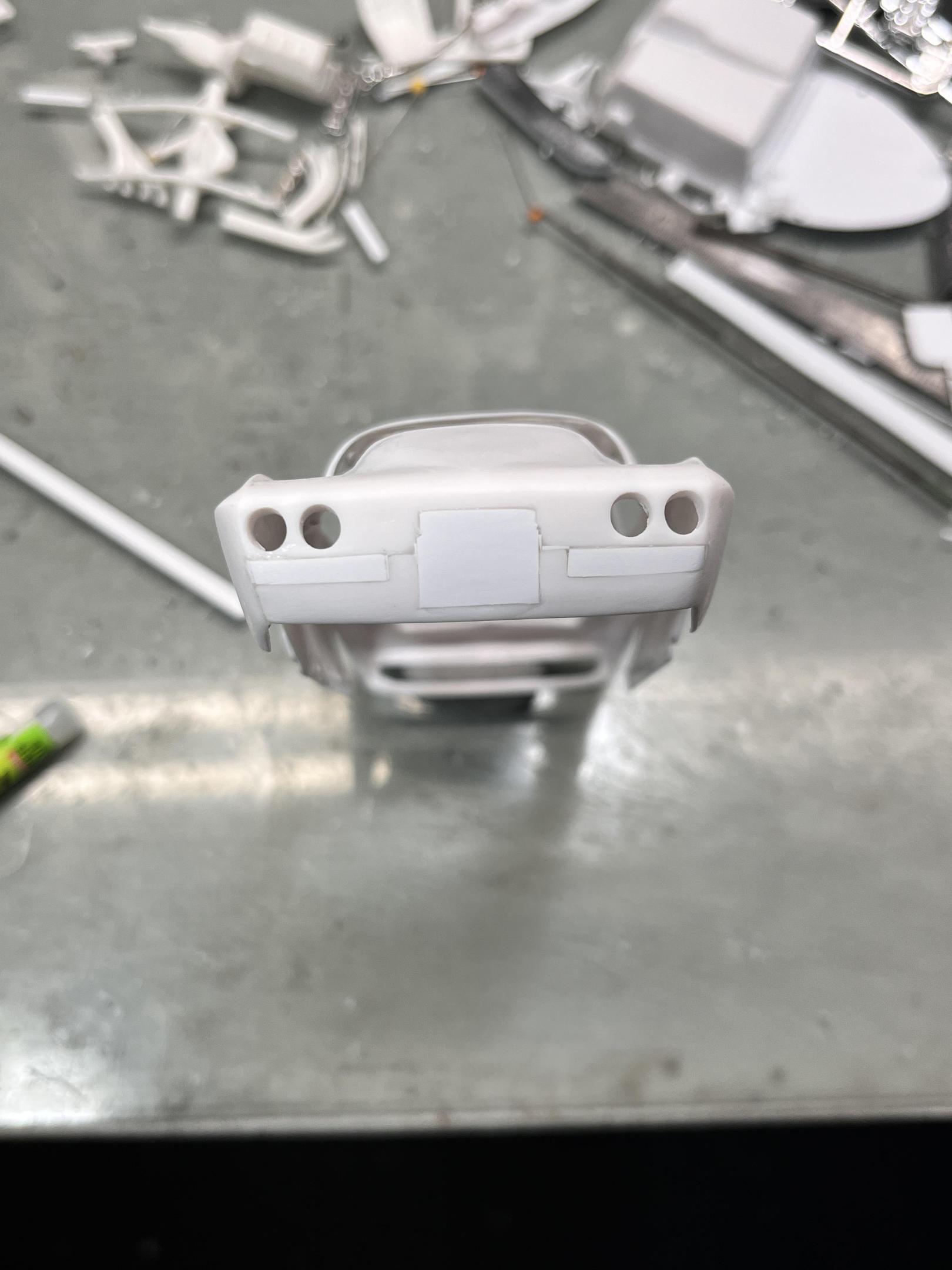

I filled in the bumper slots and the big license plate area....I'm going to leave the tail light holes in place....a drag chute added in will snug it all together.
I filled in the quarter panel louvers, radiusized the rear wheel openings and added in a trim piece along the bottom made of Evergreen strip and half-round and gave it a shot of primer. Some more work needed, but not too bad. I spent quite a bit of time scribing out the very faint door gaps.....(a sneak peek of the headers shown here, more on them later)....
As always, thanks for following along... -RRR
