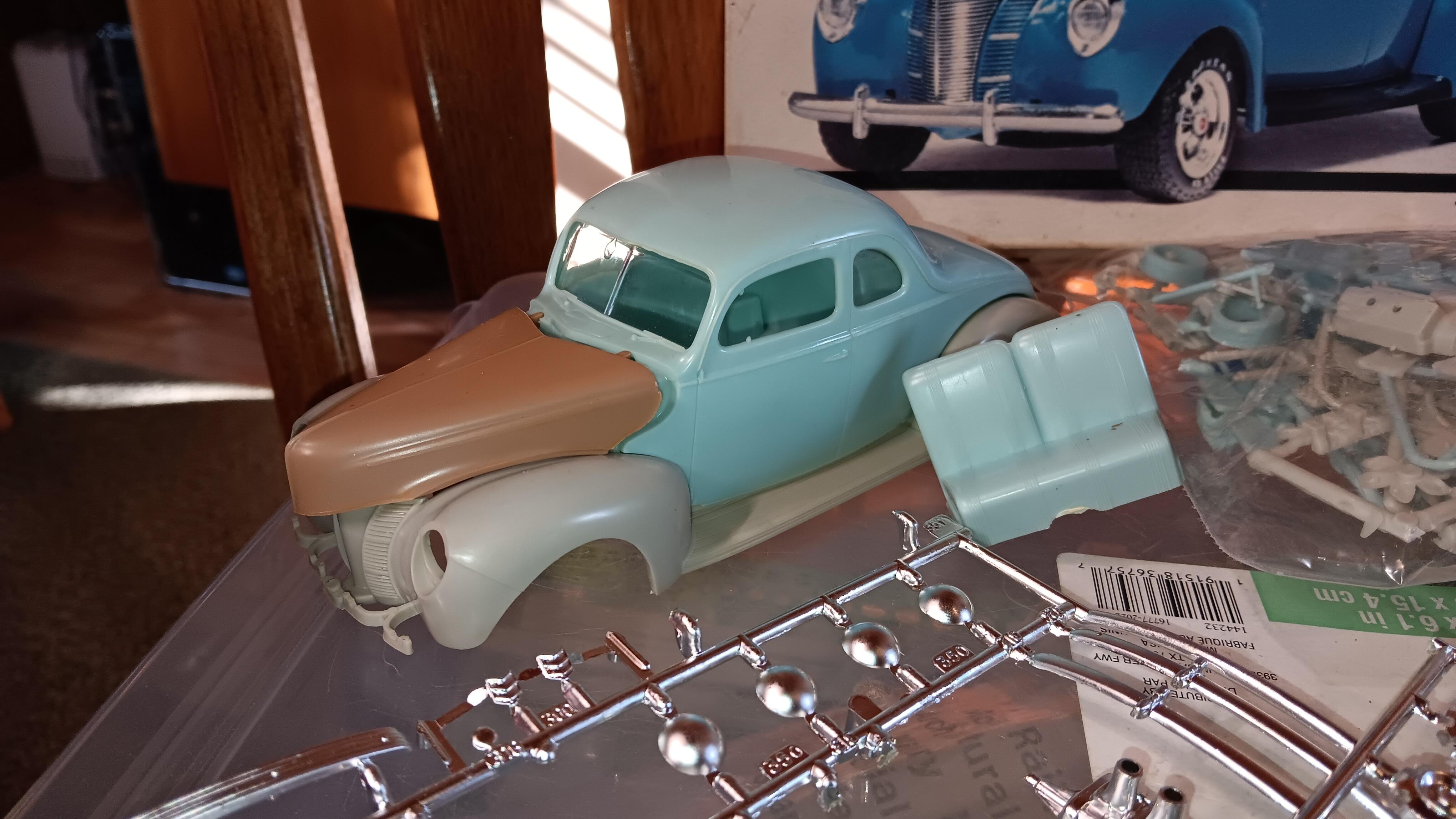

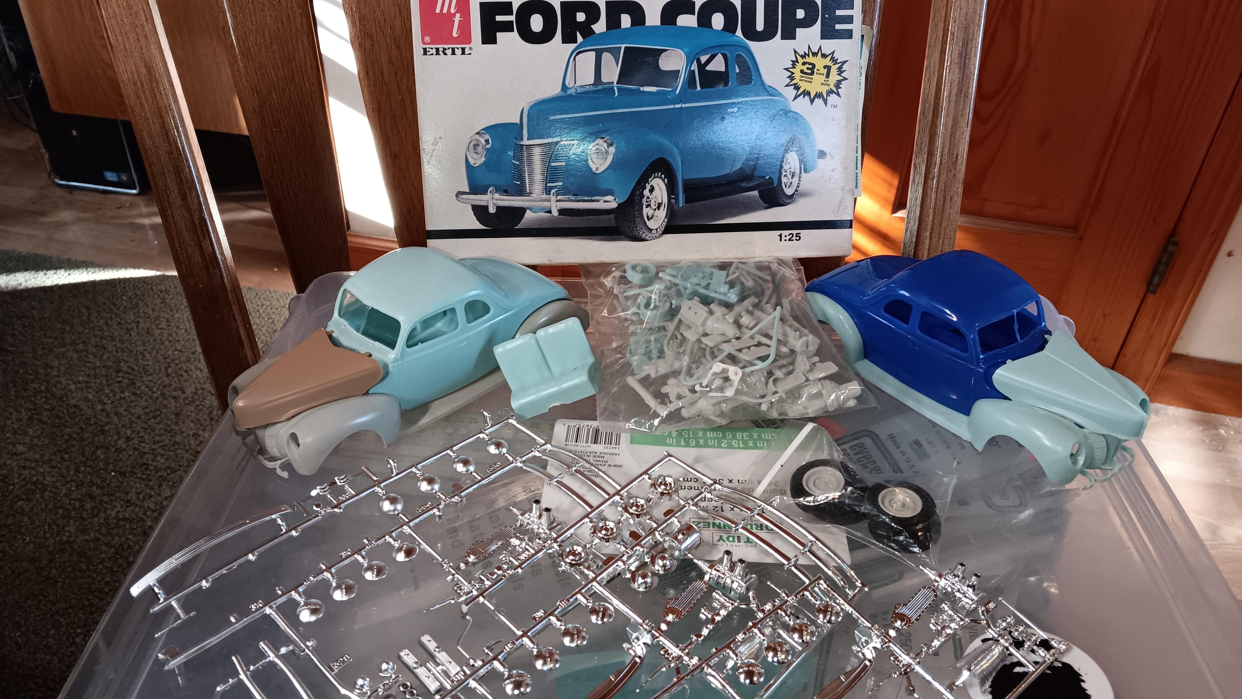

Started on another AMT '40 Ford. I built my 1st one probably in 1964.

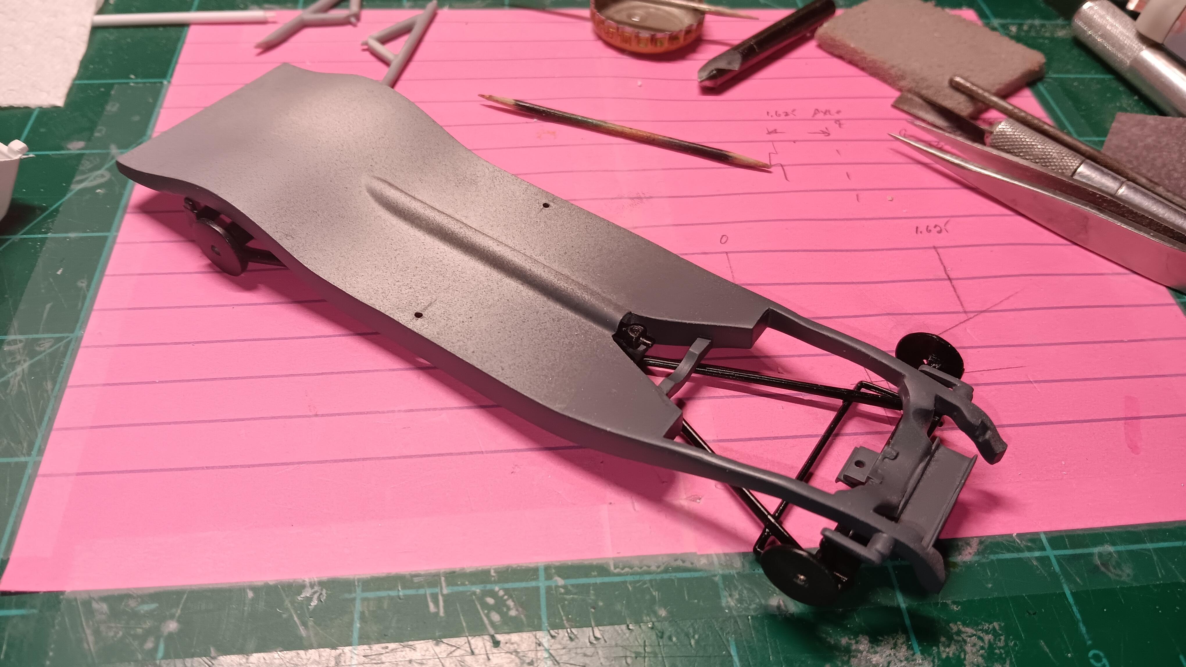

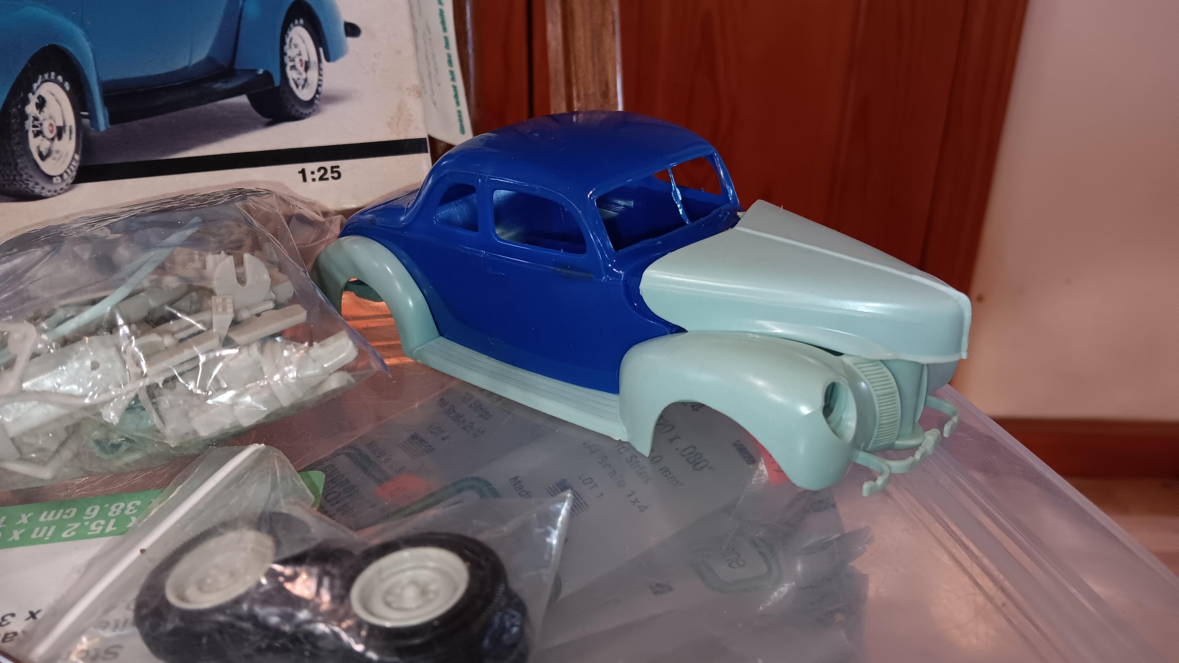

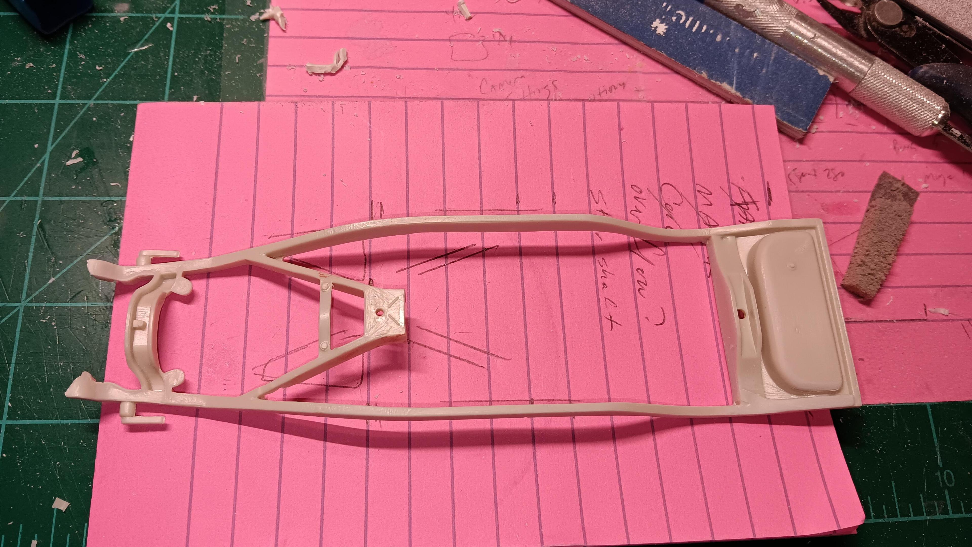

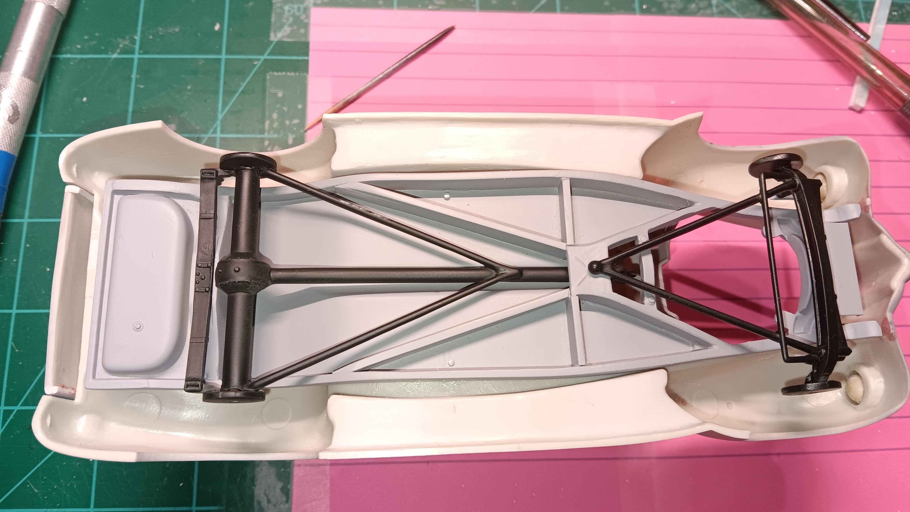

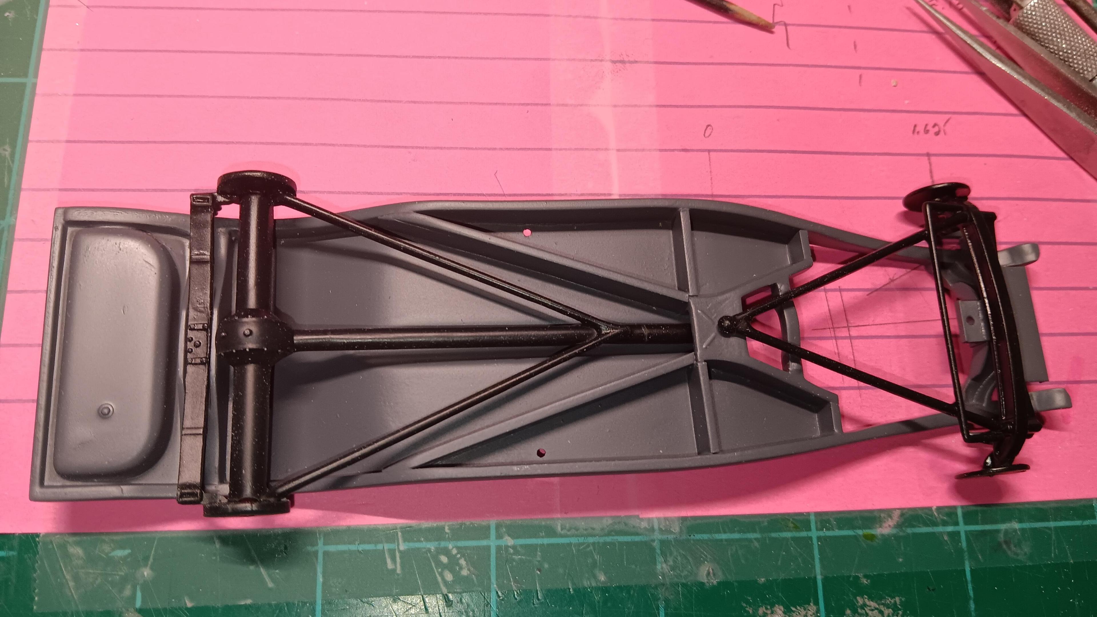

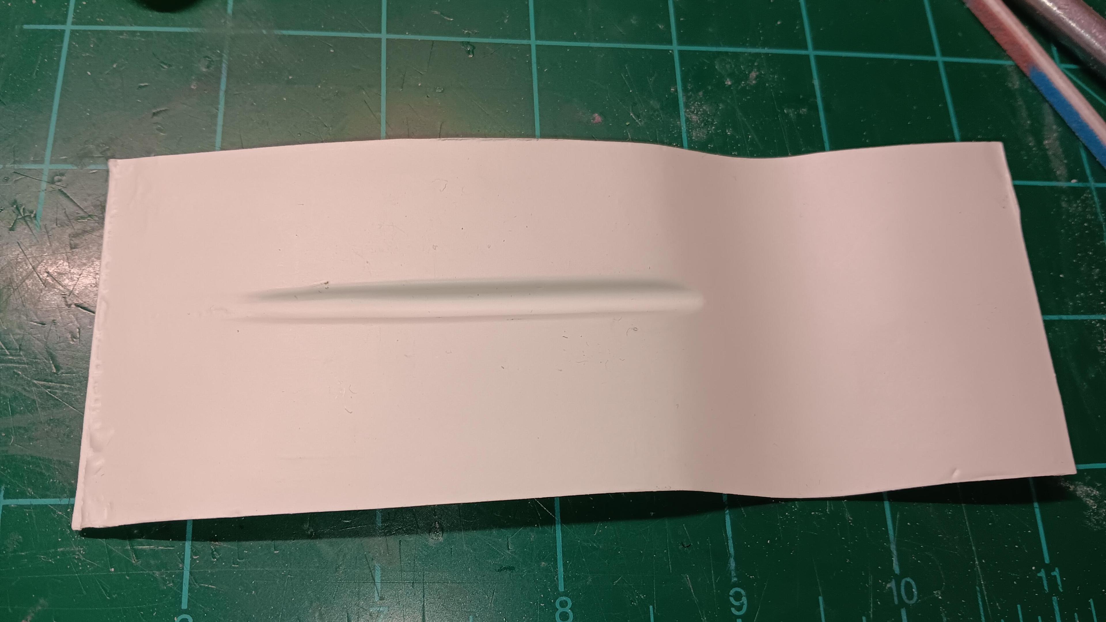

Removed the floor pan, put in a vacu-formed piece I got at a show. I made new chassis pieces, the kit ones needed too much work. Suspension is otherwise per the kit.

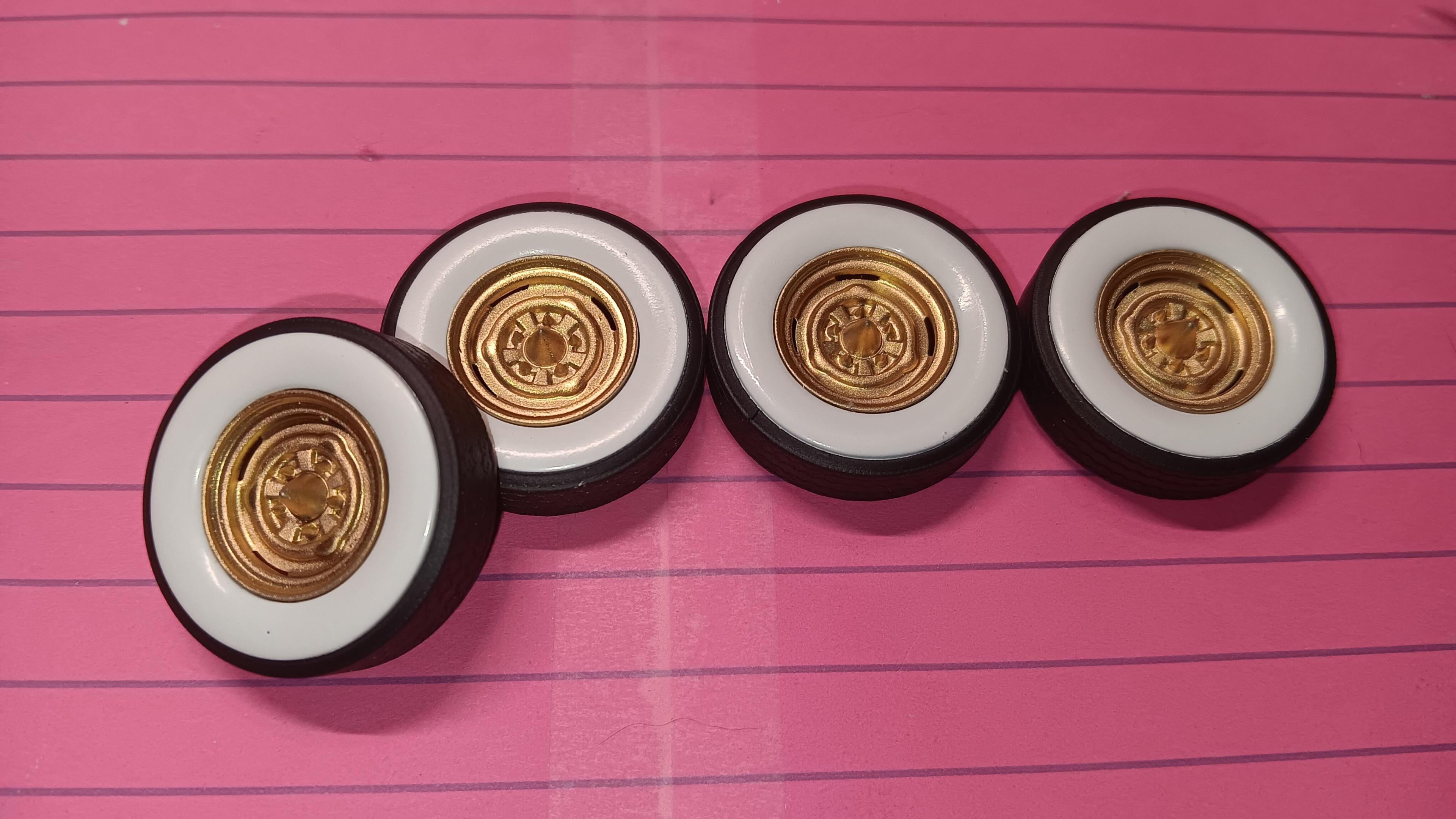

I have a set of AMT '66 Ford wheels on Modelhaus tires and a set from Jay's Resin Tires made up.

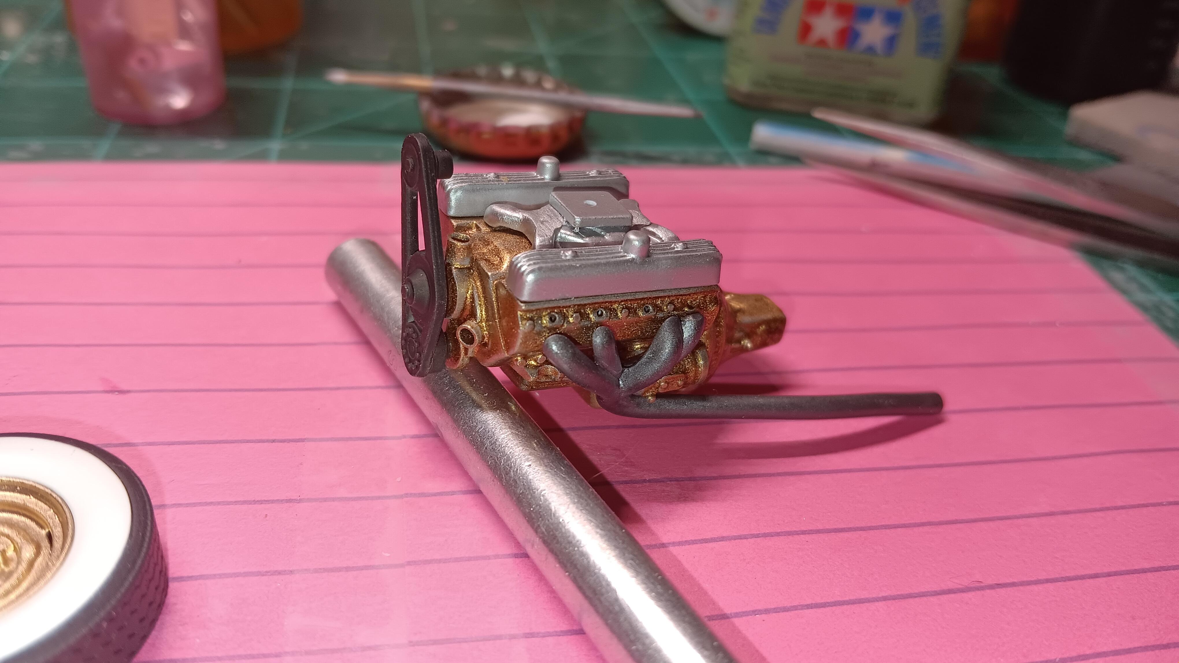

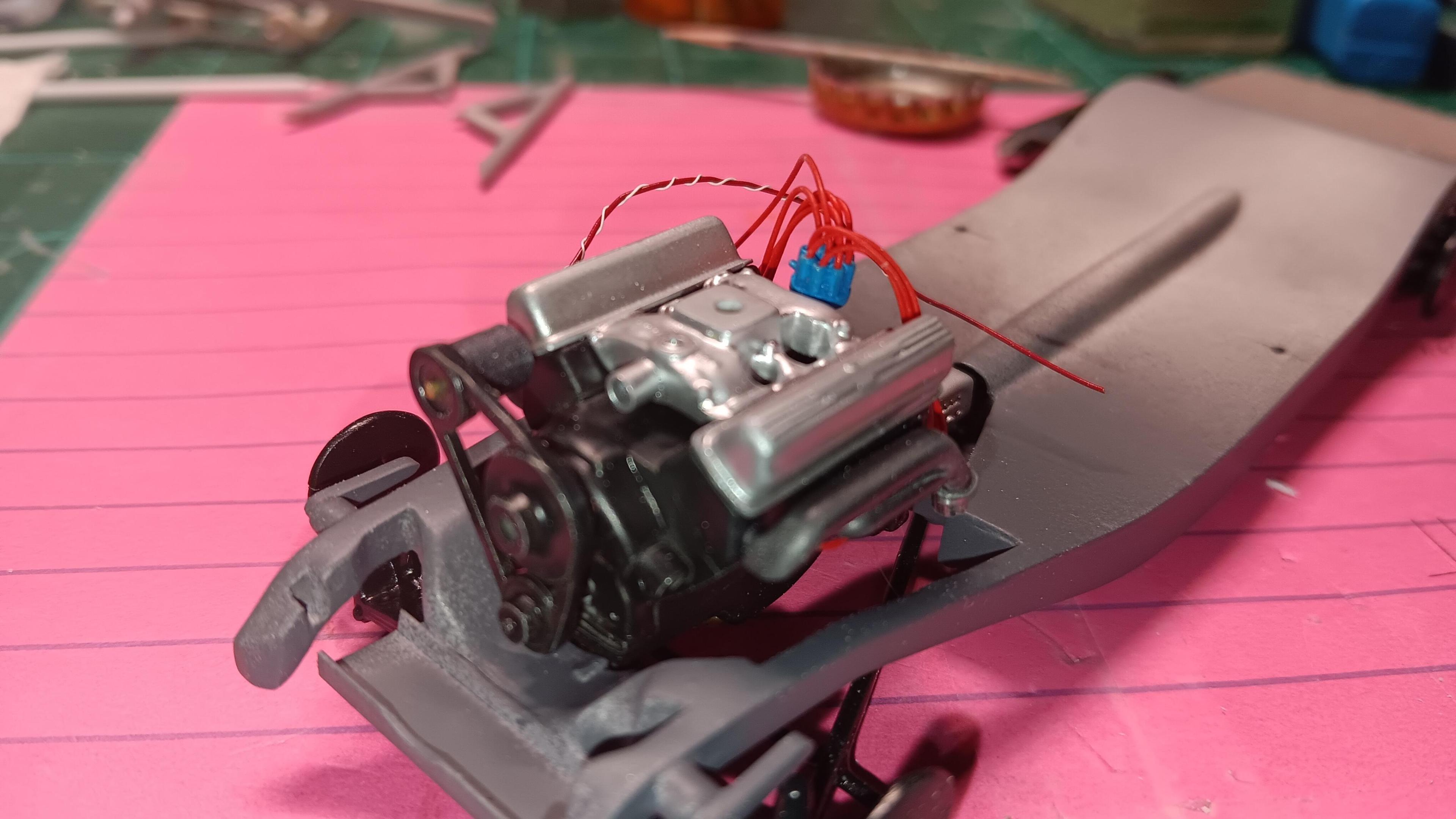

I'm going with the kit nailhead Buick so far. On other builds with engine swaps I have used the kit transmission since it has to be short to fit the chassis.

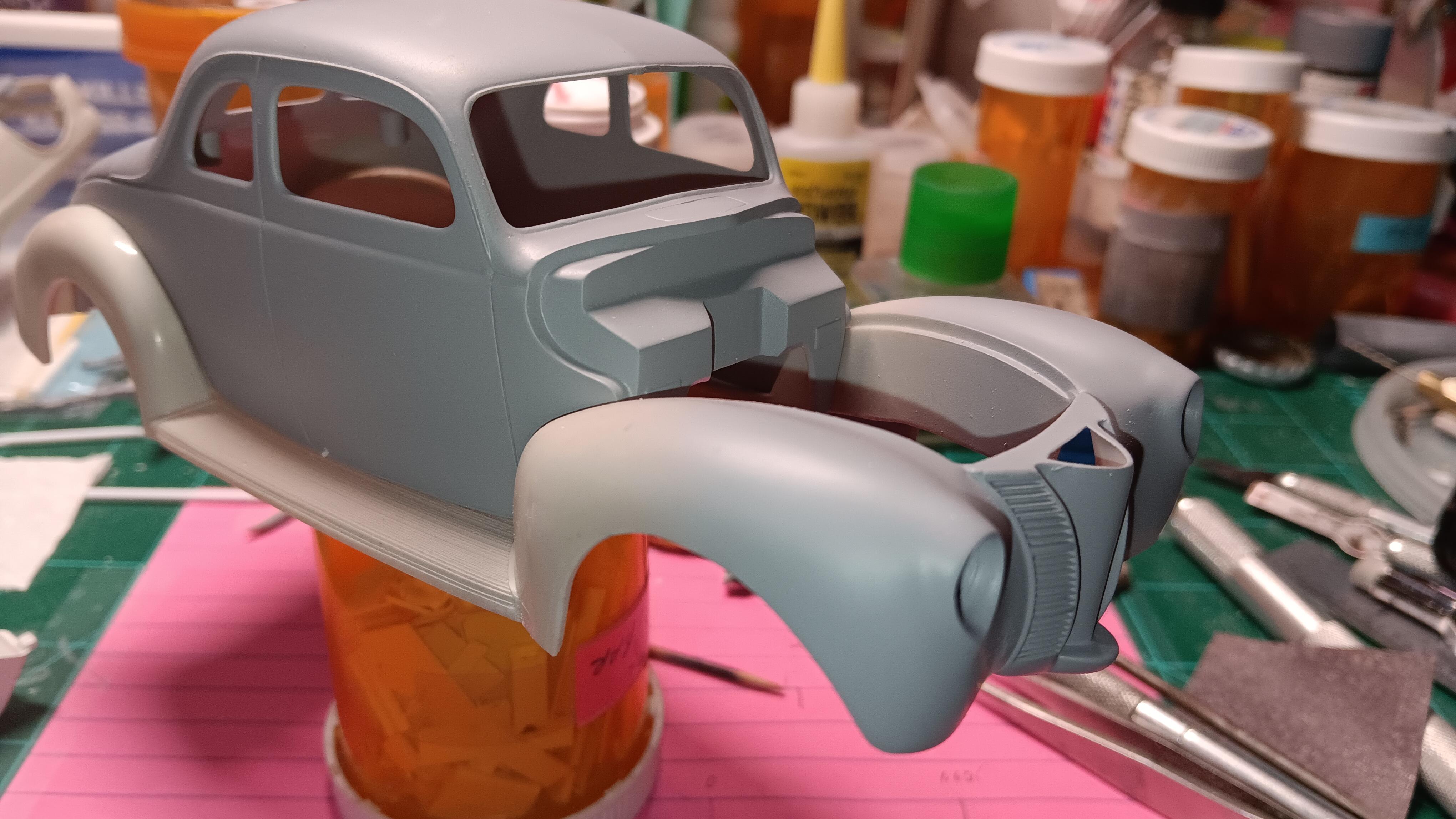

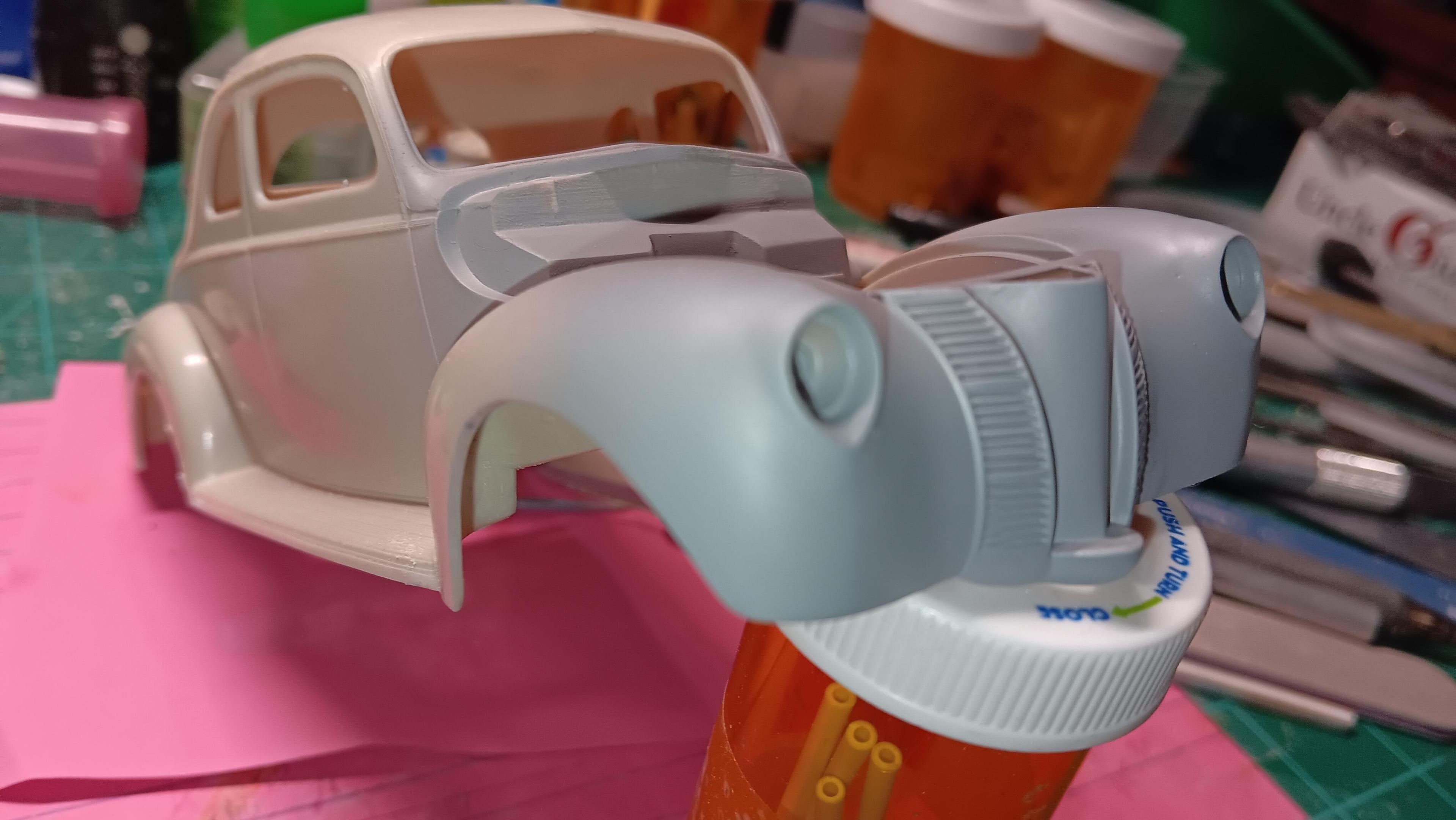

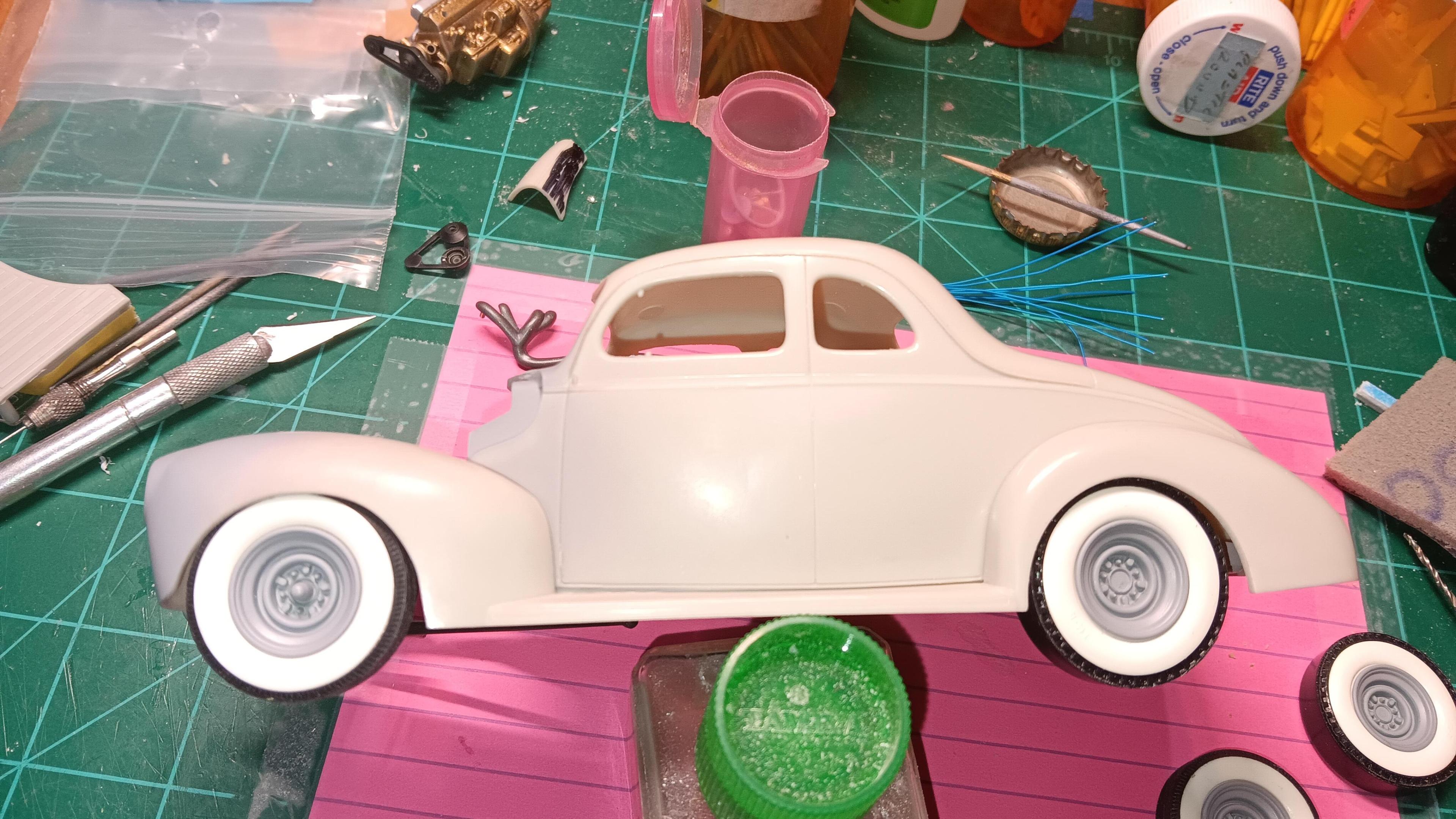

Body is about 90% there. Frenched the headlights and going bumper delete.

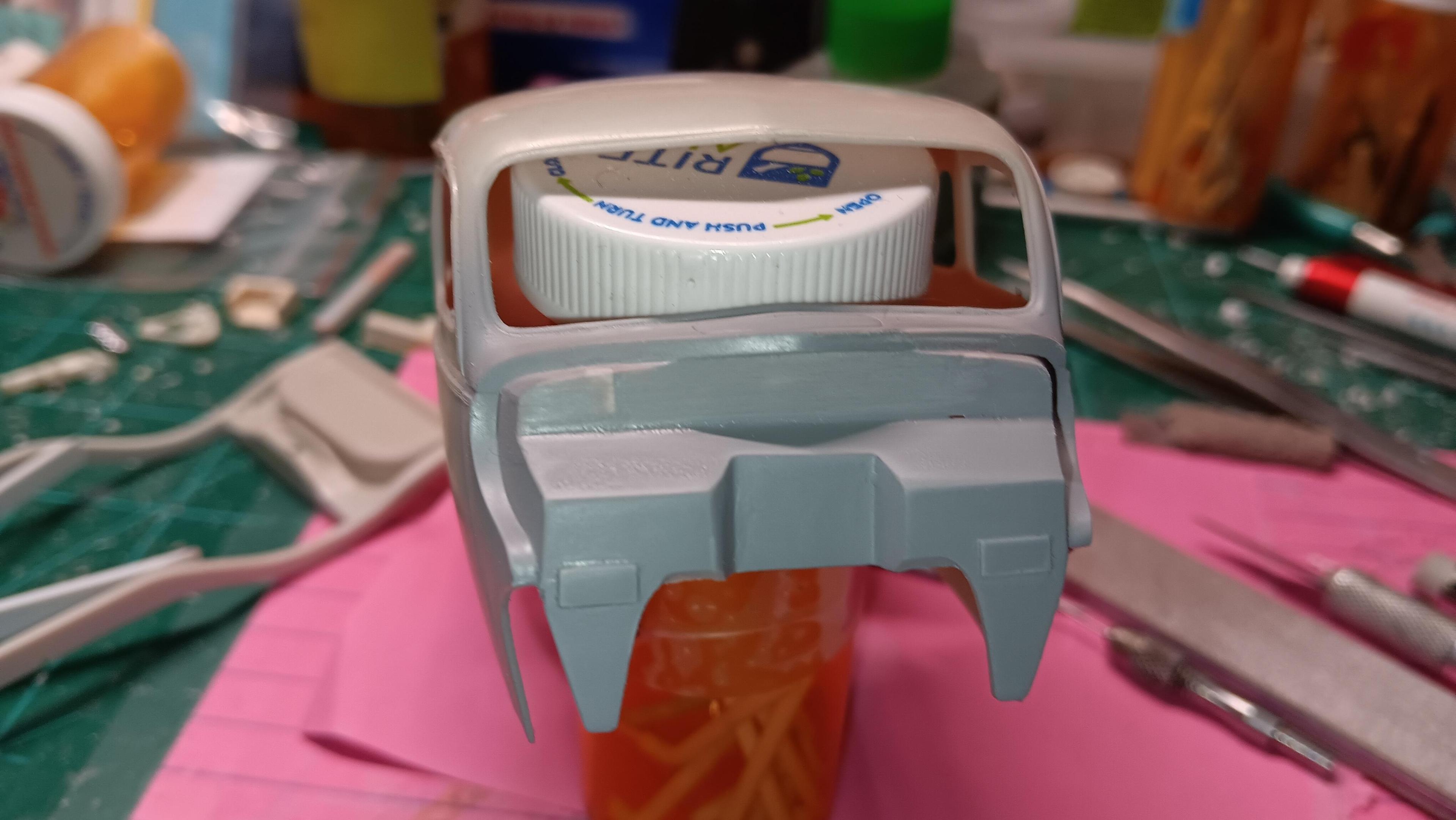

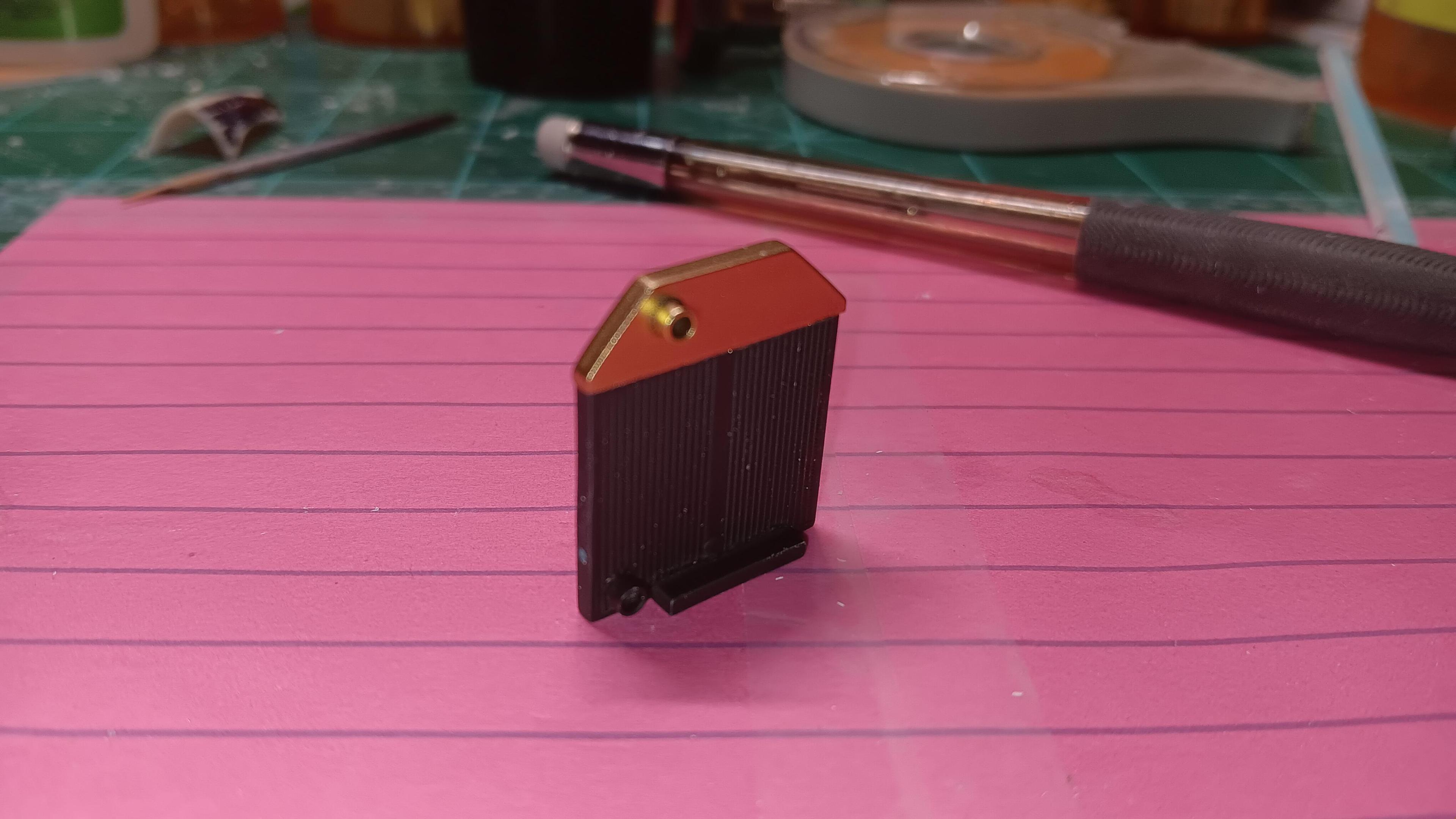

Made up a new radiator top. The kit one was pretty shabby. I also have it raised up, as is it sits too low in the chassis.

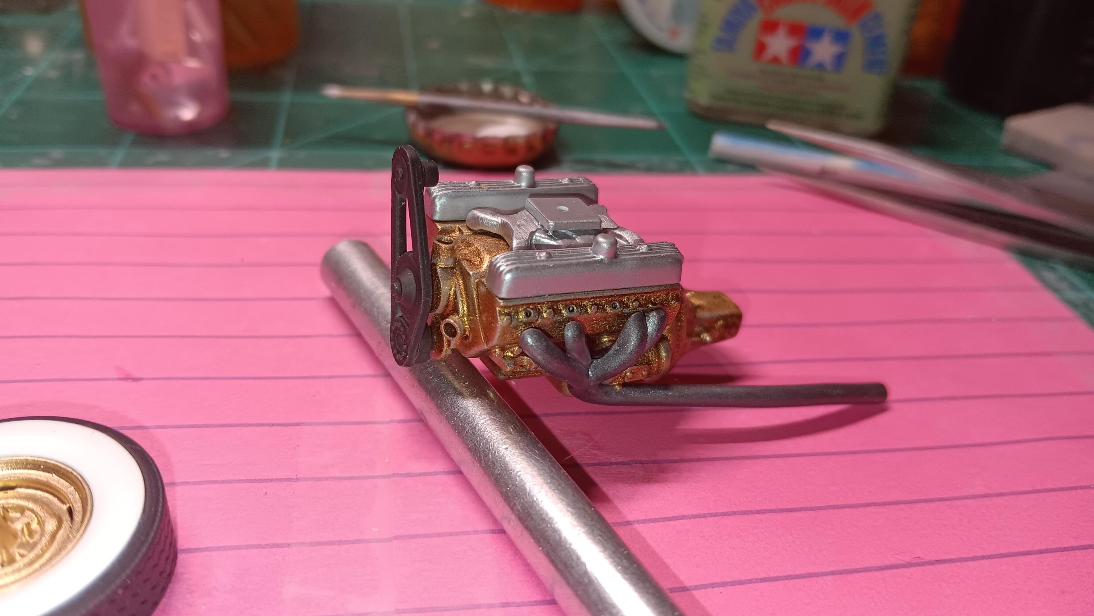

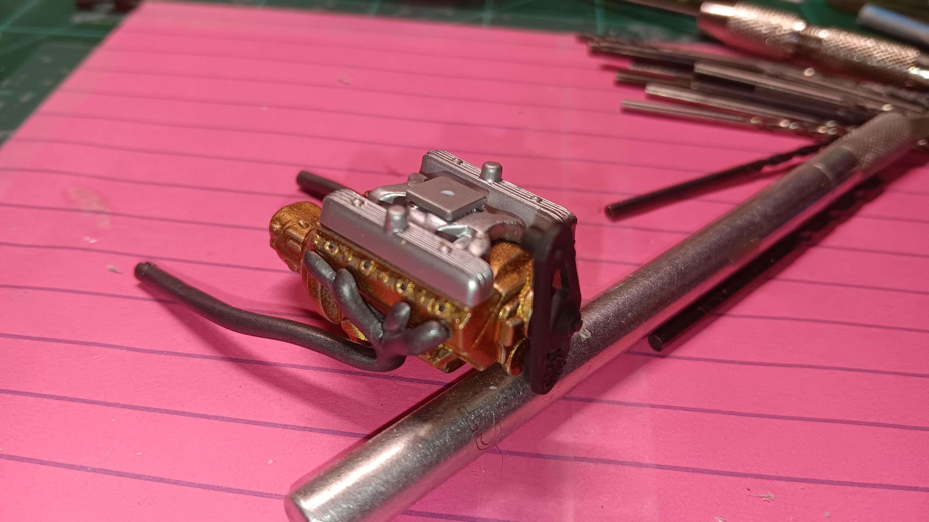

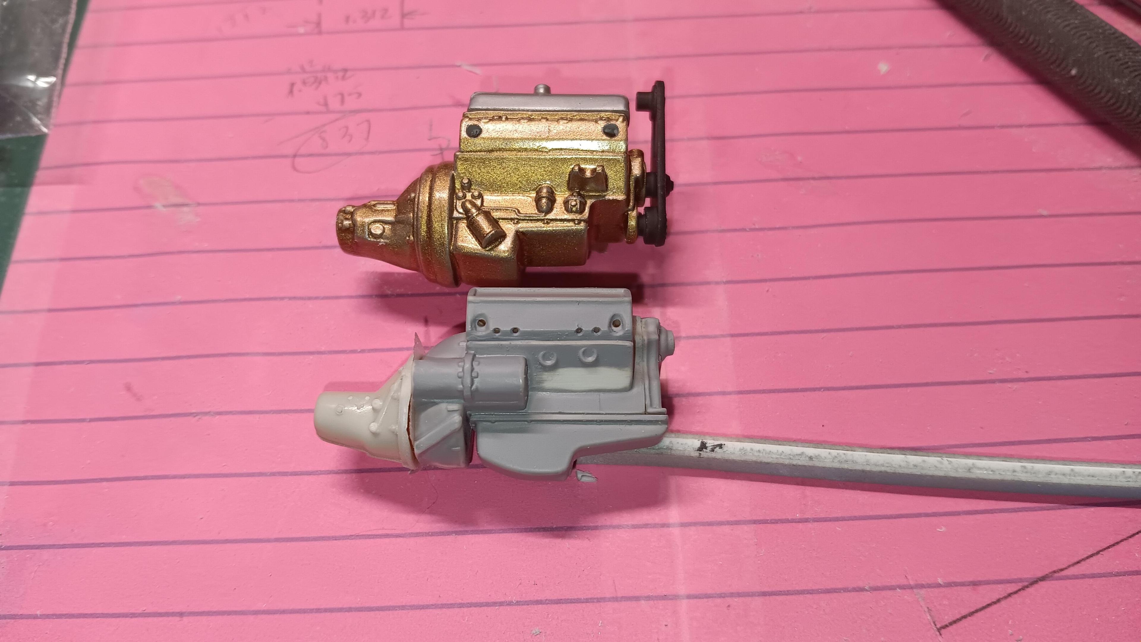

Mocked up a '56 Ford engine to the kit transmission. In the ballpark but will save it for another build since I will locate it by a hole in the oil pan up front. I'm sticking with the Buick engine.

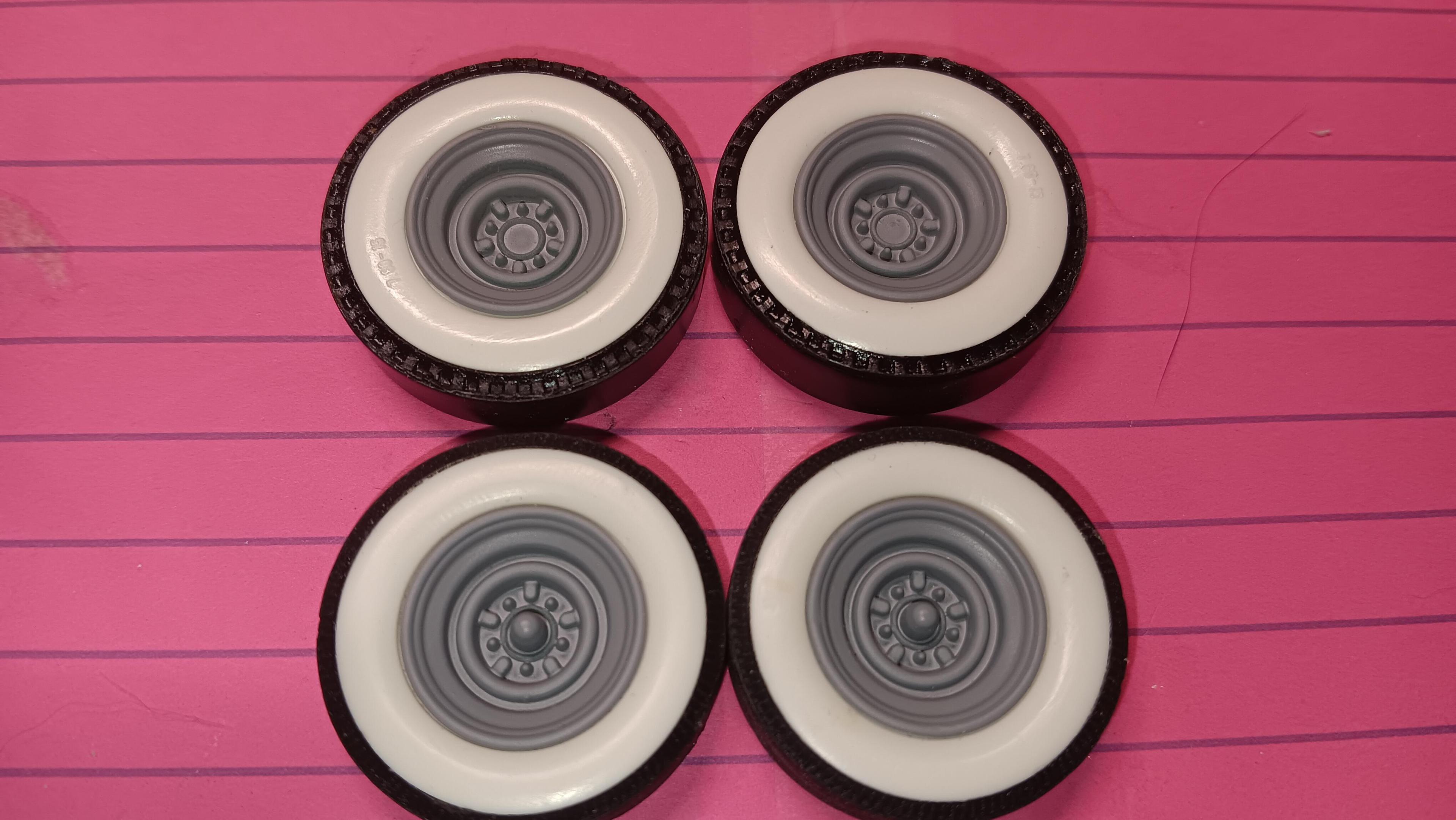

I'll be going with the Modelhaus wide whites with slicks out back.

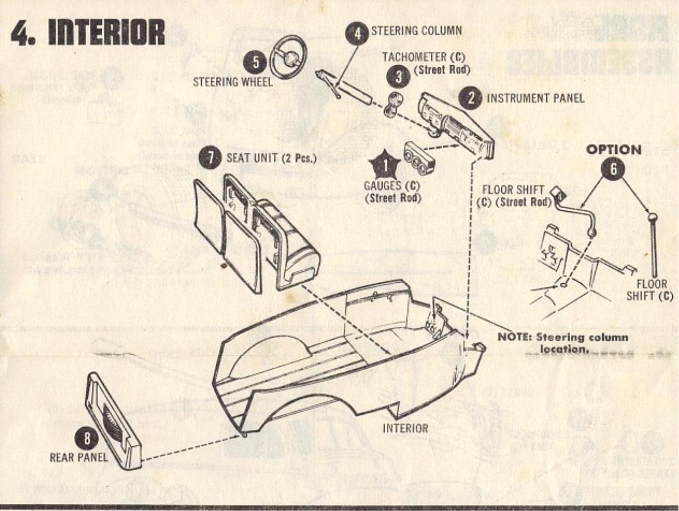

And... this odd part at the bottom shows up in various '40 kits. I can't find it on the instructions anywhere.
  • Like 1
That odd part is from the ’40 sedan delivery -kit. A rear panel with part of the spare wheel visible.

3 hours ago, TopherMcGinnis said:
Nice! I like it!
I've got a '40 panel that I built in the '80s undergoing some updating.
Those are very cool too. ?
- pic from Drastic Plastics website
Damn... knew it looked familiar.
Like the frame and floor pan upgrades. The wide white tires look good, but the diameter of the front tires seem a bit larger than what you would want on a driver.

They were sticking out too far. I took 1/16" off the hubs and .030" from each backing plate. Now it looks much better. I have some other big and little tires I may try on it.

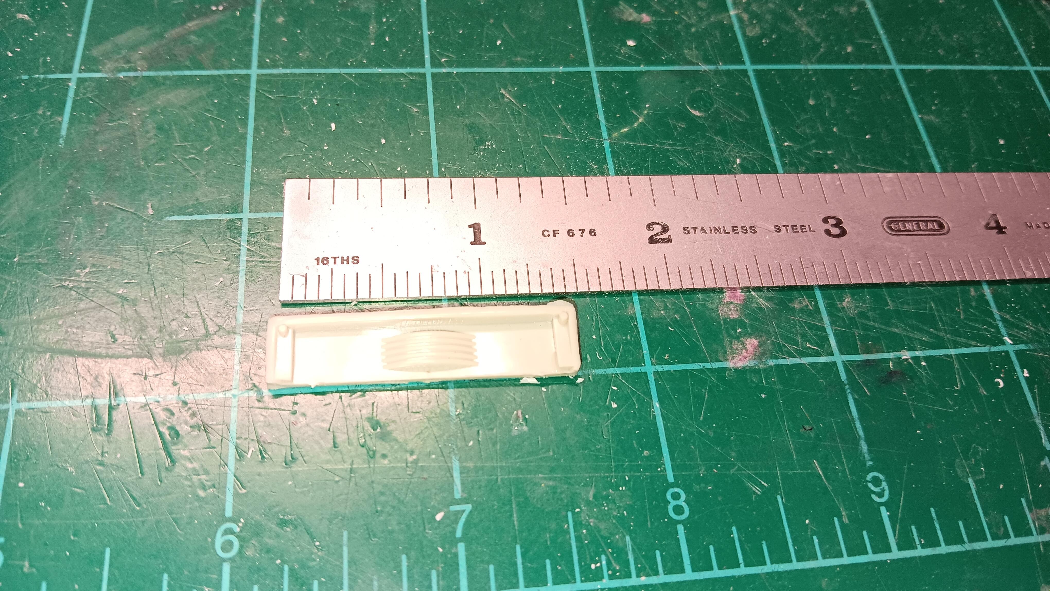

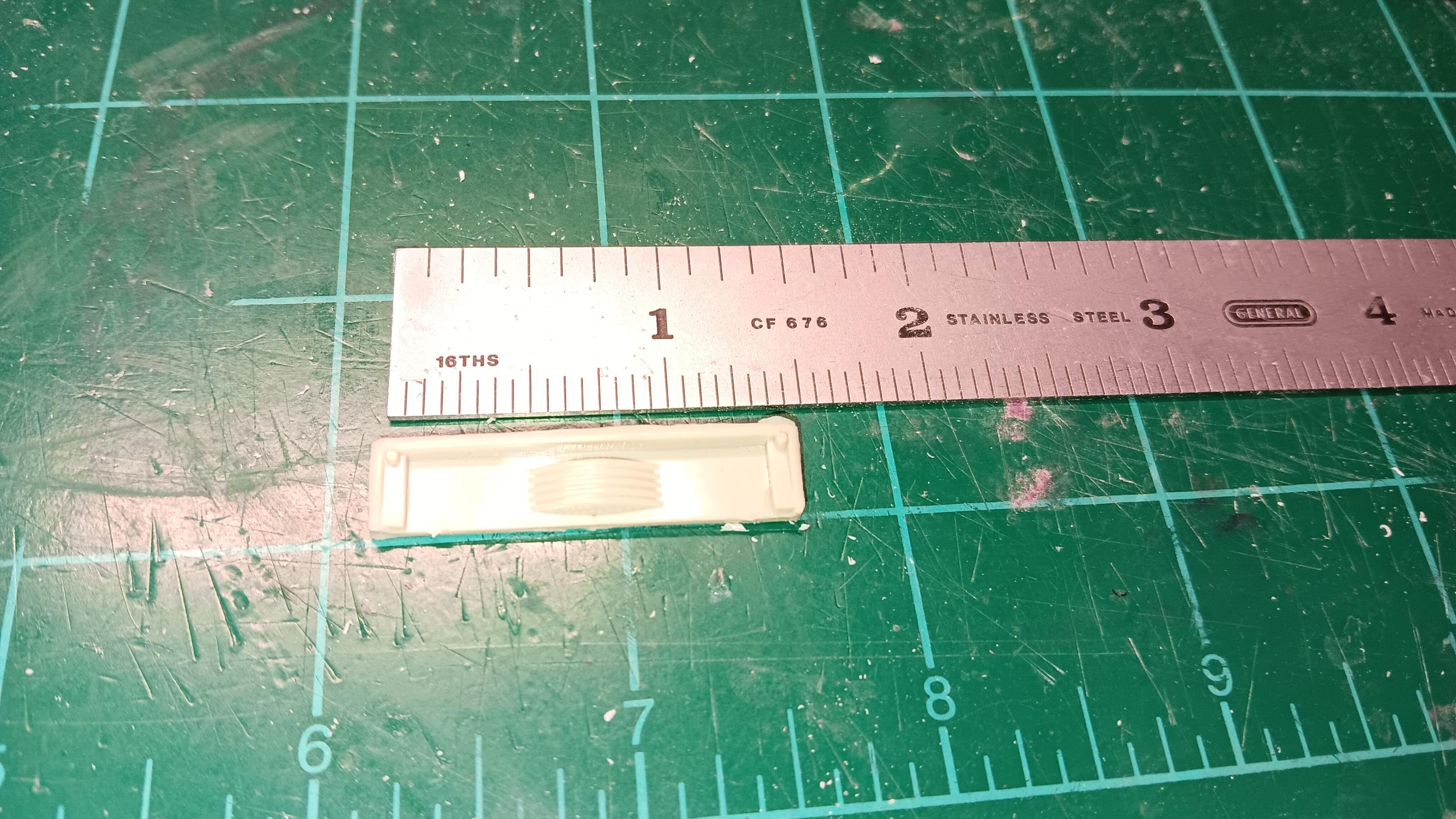

Hi Bob.  I was building the AMT '40 Ford and discovered I lost one of the taillights so my idea was to french them.  Would you post a picture of what you did?

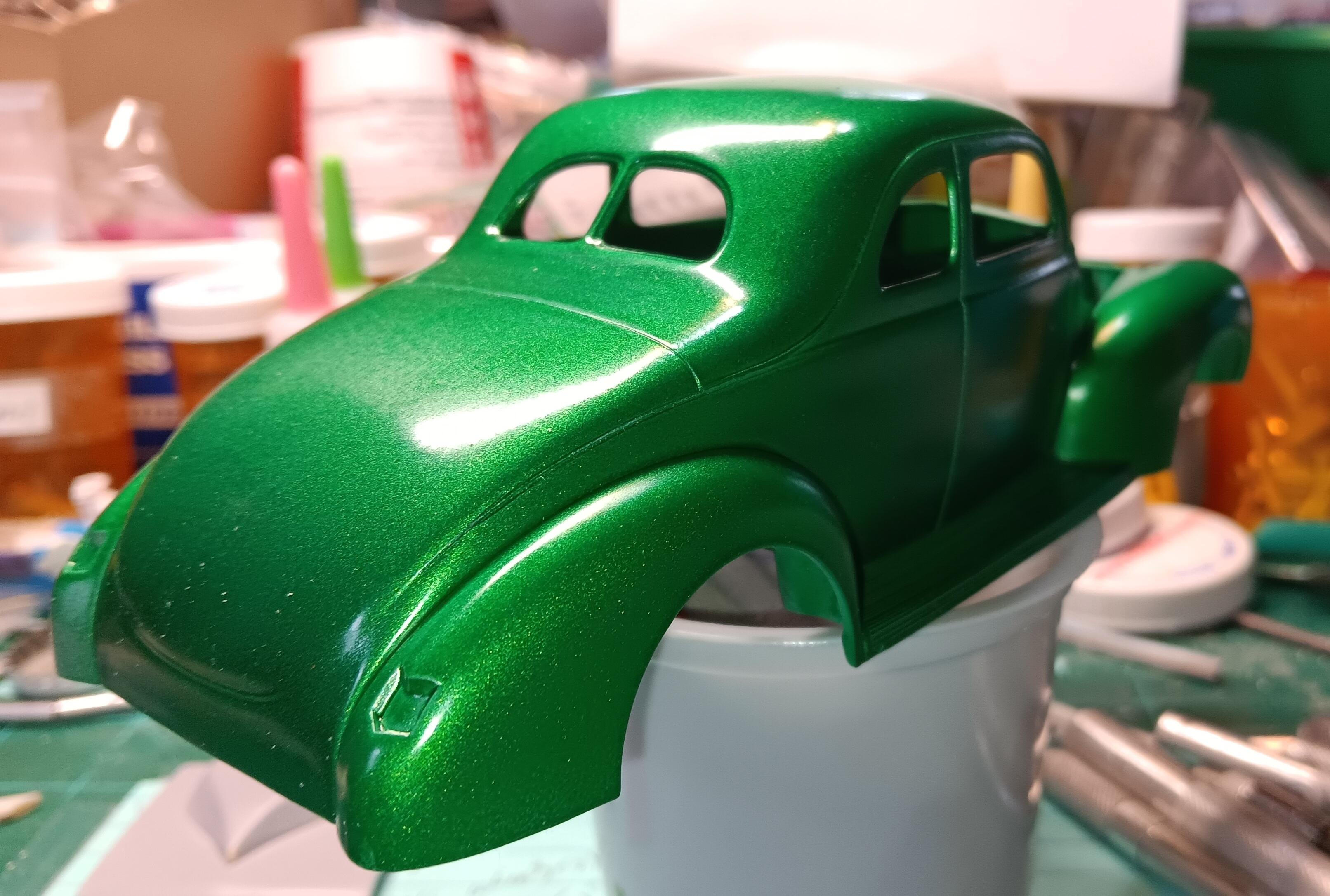

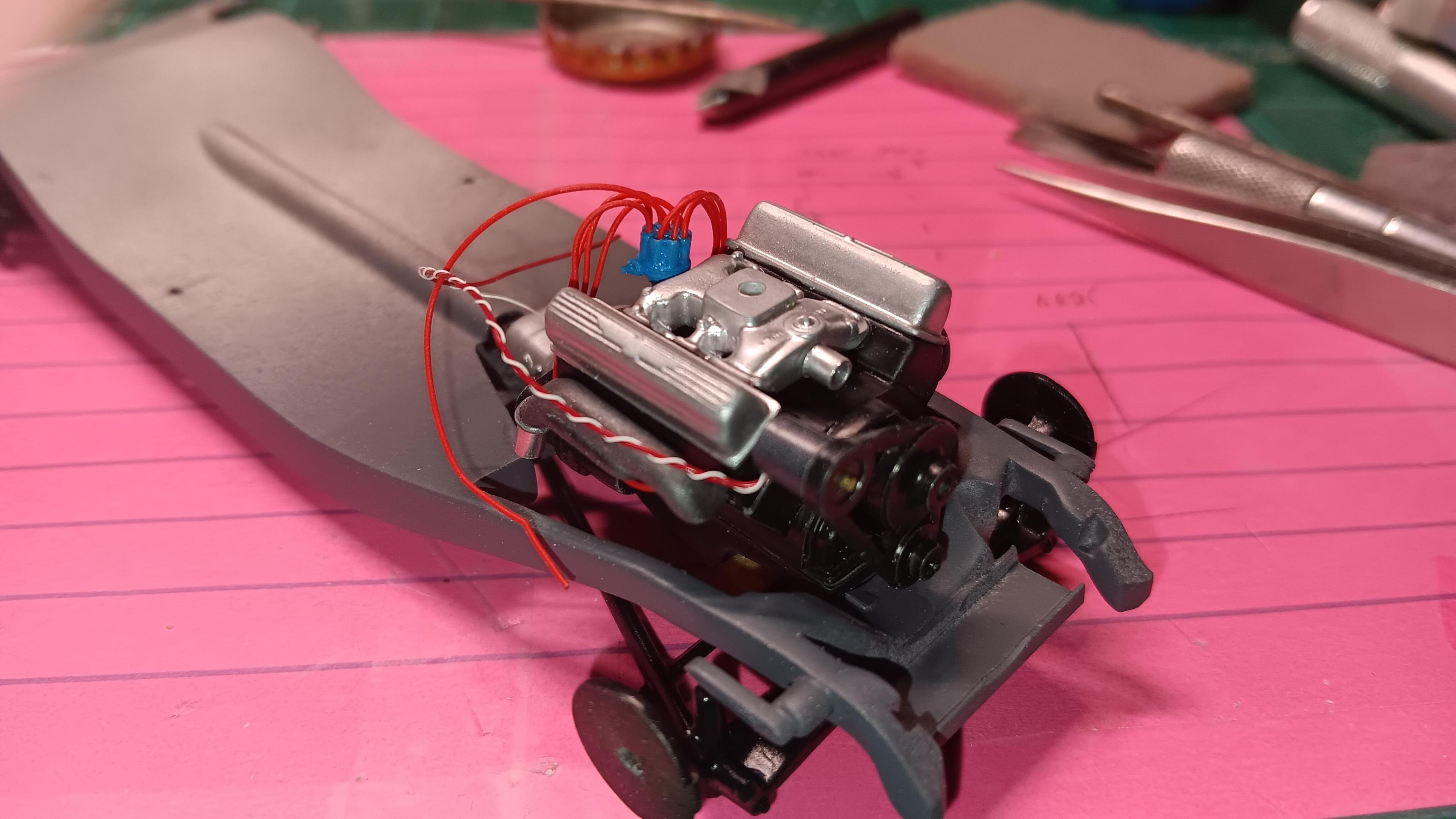

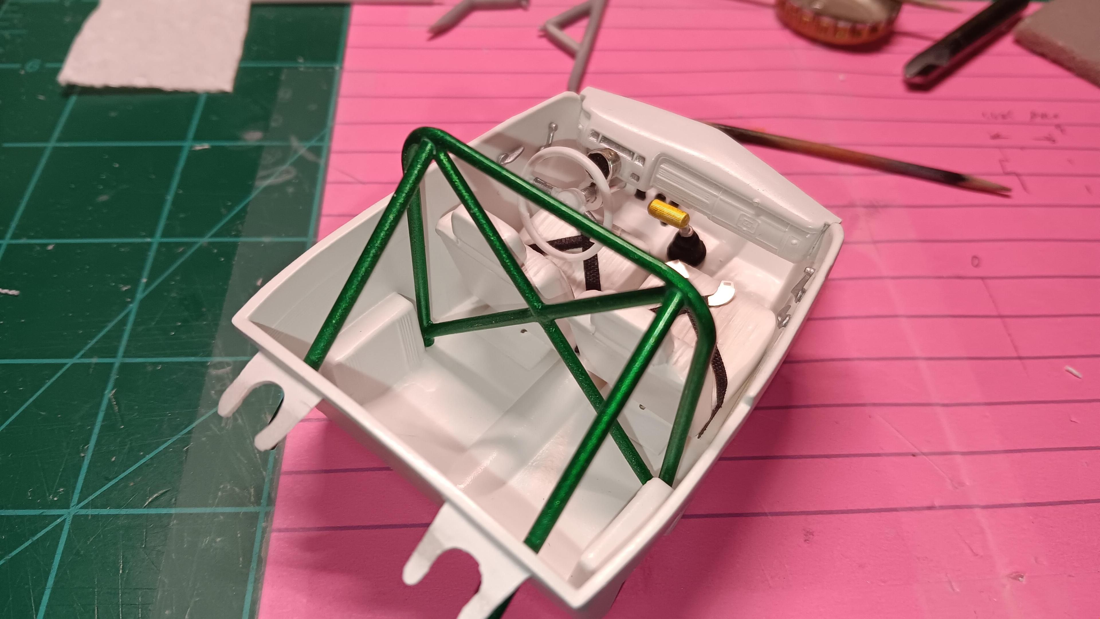

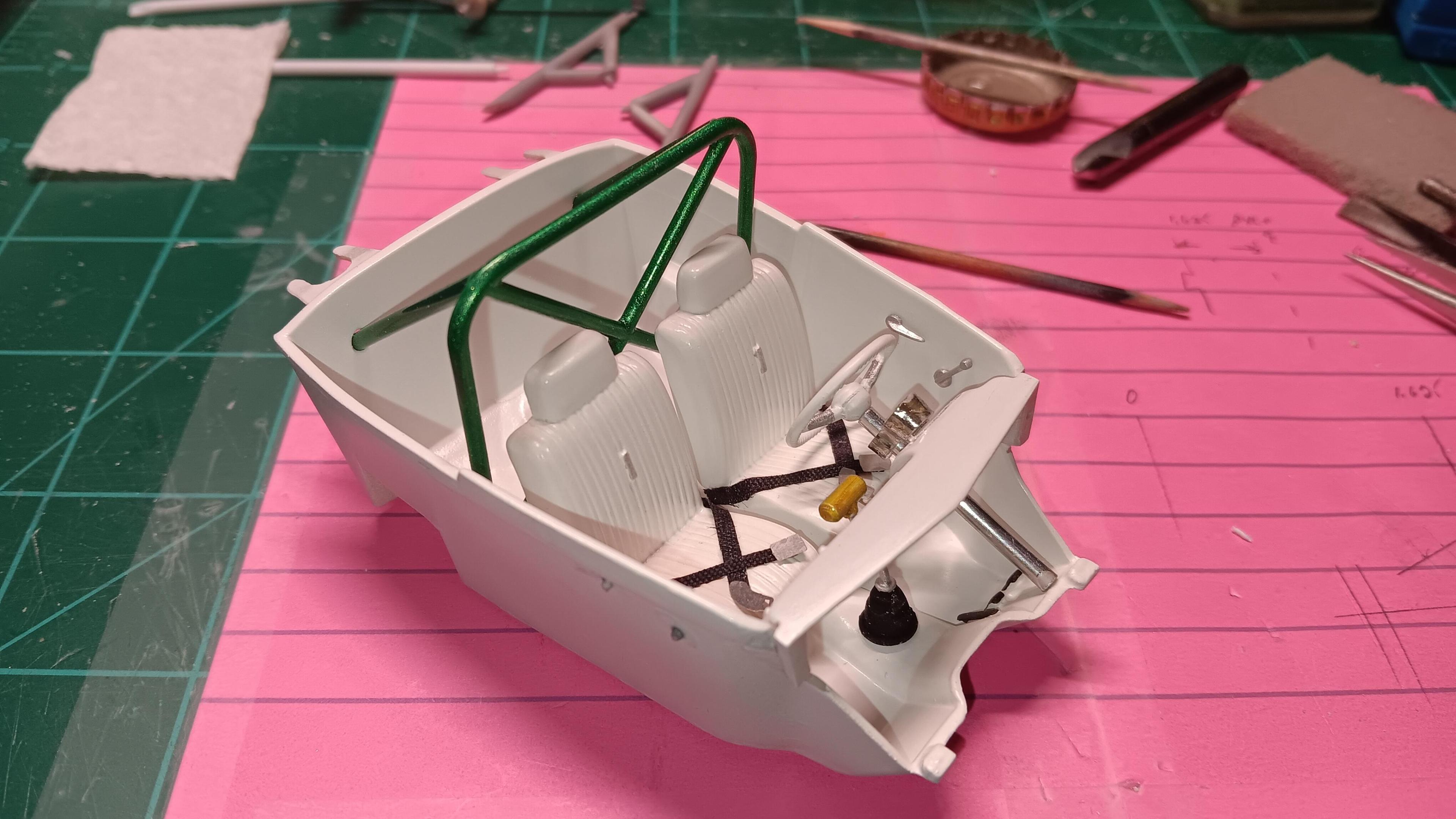

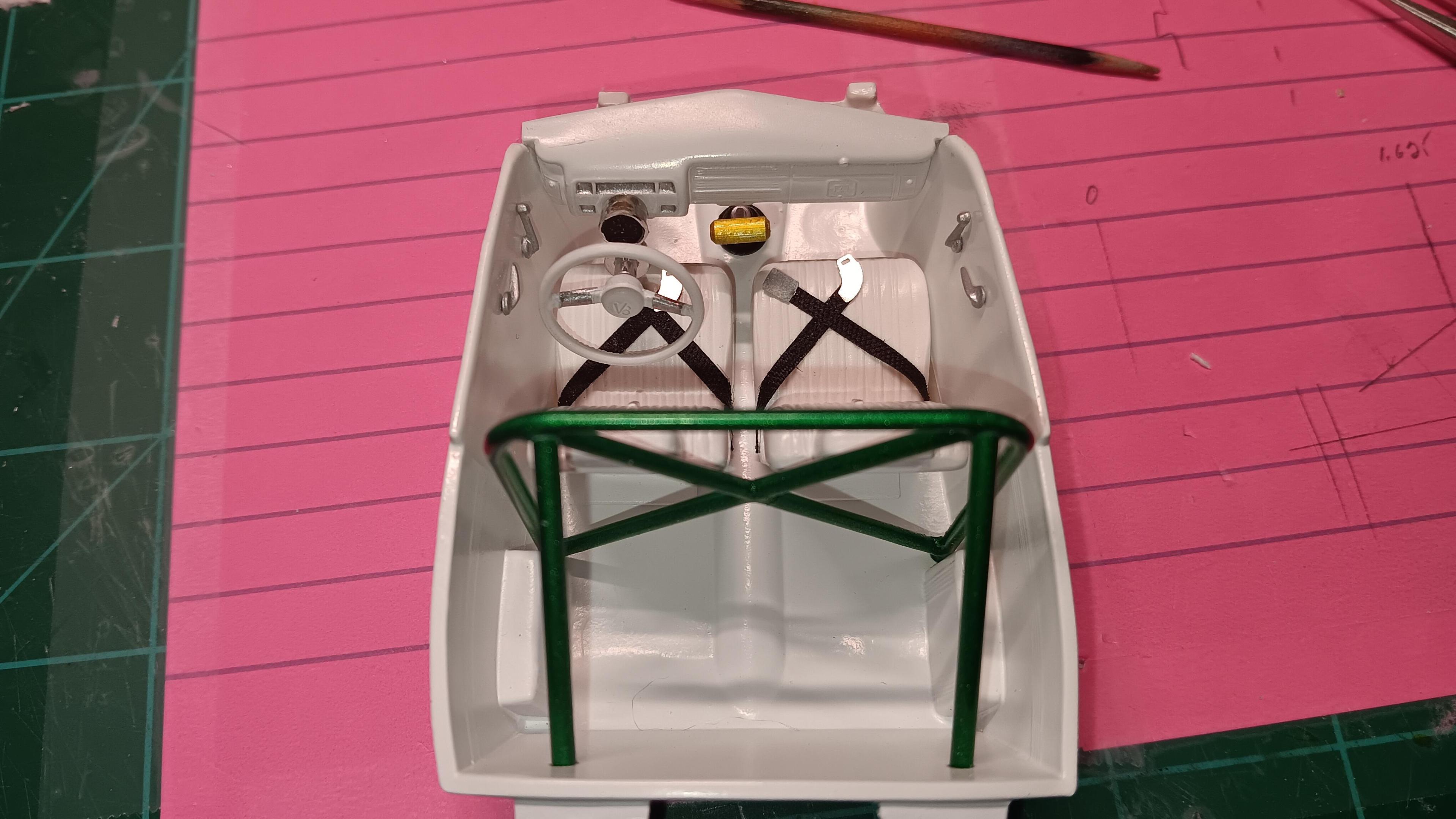

More work on the 40. Interior is done and I'm happy with it. Chassis is painted with Tamiya TS 4 German Gray.
Switched to the Ford Y block late in the game.

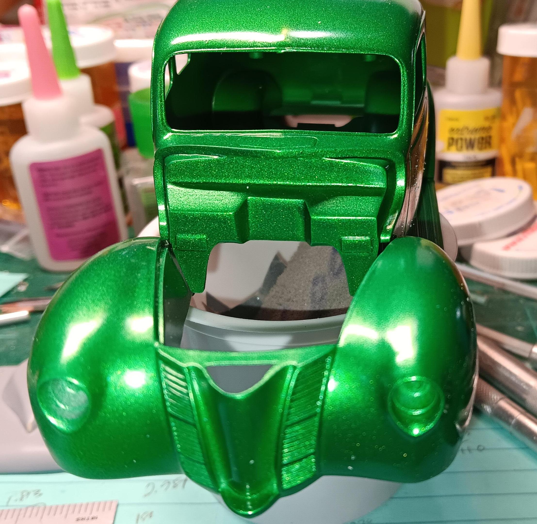

Body work is almost done, needs work above the windshield.

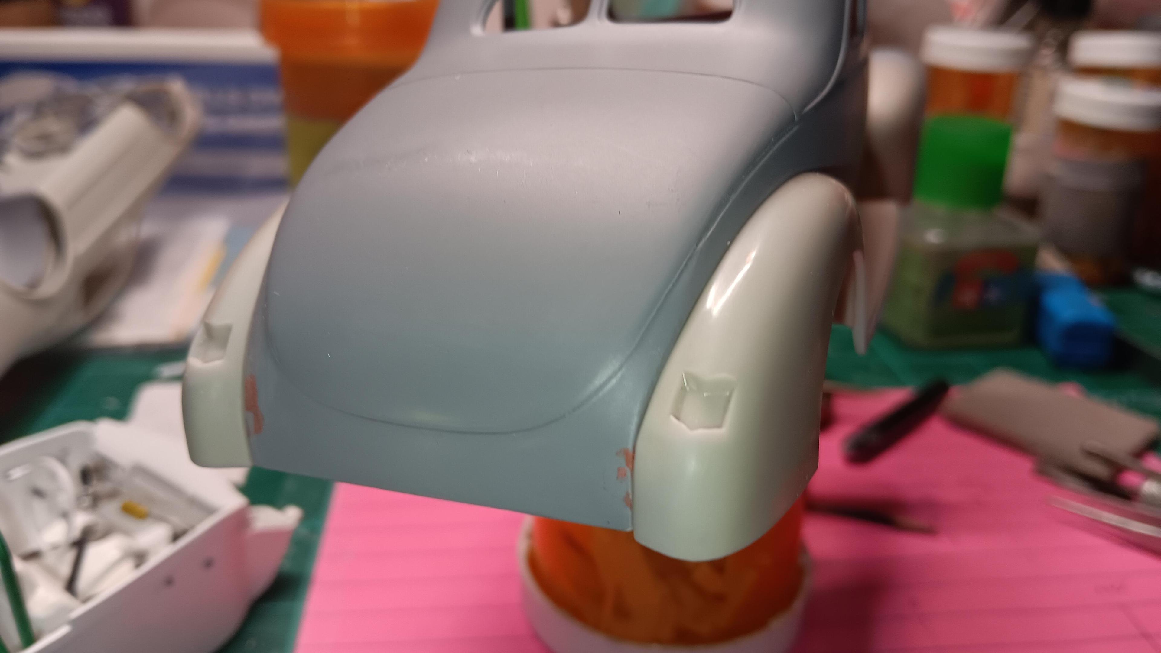

I frenched in the kit light pods. Glued them in with CA glue and waited a few days for it to dry. Then sanded them to the front fenders. Prime, putty, sand, rinse repeat.
I have fitted the lenses to the pods. Also the chevron tail lights.
  • Like 3

11 hours ago, customline said:
Looks fantastic, Bob!  Cool headlight work. Great idea! The Y-block is a neat-o choice, too.
Thanks. The 2nd coat looks even better. The 1st had a few light spots in it. I'll scuff any bumps off it with #3200 grit and go with the MM clear later today. I did a similar engine swap on another '40 using a NASCAR 351, again, the trick is to use the kit transmission.
Bob, the rocker covers are not accurate. The hold-down studs are missing. The designer was apparently a Chevy man. ?
The more I look at that Y-Block, the better I like it. I ran a '56 272 out of oil on I-95 one day back in '68. ?

10 hours ago, slusher said:
Really nice color and work Bob!,    What color is that!
Model Master Extreme Lacquer Mystic Emerald. I have one spot on a back fender I may have to deal with. The rest of the clear coat went on smoothly.
Eh, accuracy is over rated. The y-block was a remnant from my '56 Ford figure-8 car. I still have the built up Buick engine to use on another Trophy Series build, maybe a '36 Ford.
