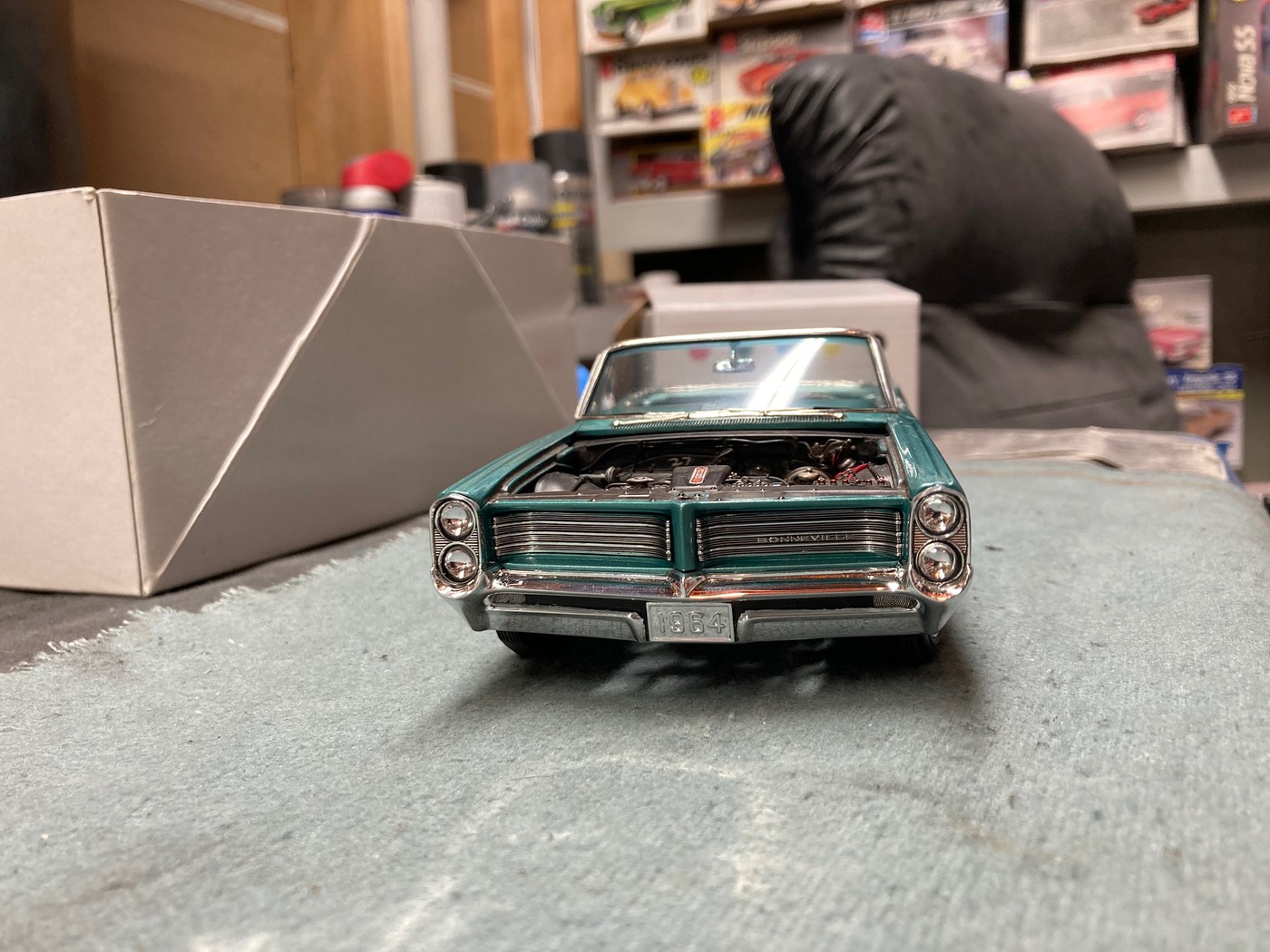

The absolute best way of course is to drill out the molded in lenses and replace them with clear lenses.
Any solution that you can come up with for the reflectors is acceptable.
Most times I'll use reflectors from a different grille and modify them to fit.
Then it's just a matter of replacing the lenses with some from the parts box.
The other option is to paint the lenses with some combination of clear mixed with very small amounts of white and silver.
It can look acceptable, but rarely looks "right".
This '64 Bonneville used buckets and lenses from the Moebius '61 Pontiac Ventura kit.
Steve
