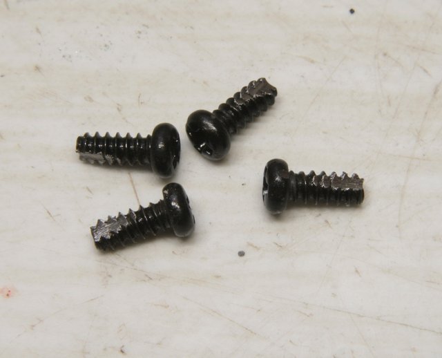

When screws are involved that need to be threaded into plastic, I cut a slot into the threads to make it easier to cut the threads without over stressing the plastic.  I use a Dremel tool with a cutting disc.

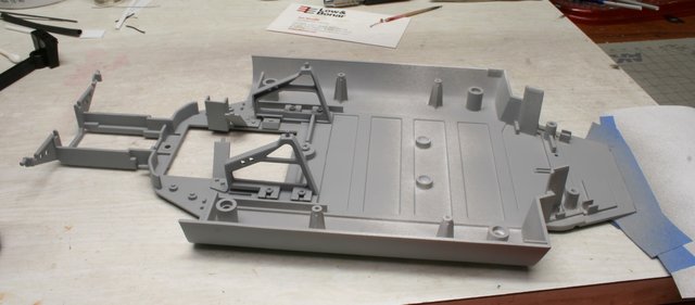

While waiting for paint to dry, I have started prepping the chassis.  I added some bolt heads and cut down some mounting posts that were needlessly tall.

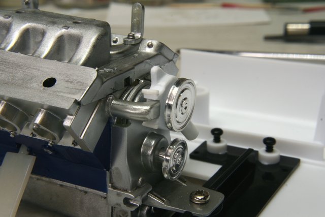

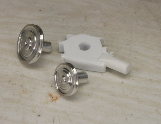

Next, I spent time working on a water pump that was omitted from the kit.  The reference pics posted by Force and Vamach1 were invaluable.
I didn't have any styrene sheet that was thick enough, so I laminated up some sheets.  Then sketched out the water pump, eyeballing the size and shape.
Then cut out and shaped the pump and turned out a couple of the pulleys.  Didn't detail them because they will never be seen.
Test fit.

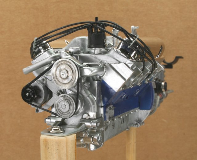

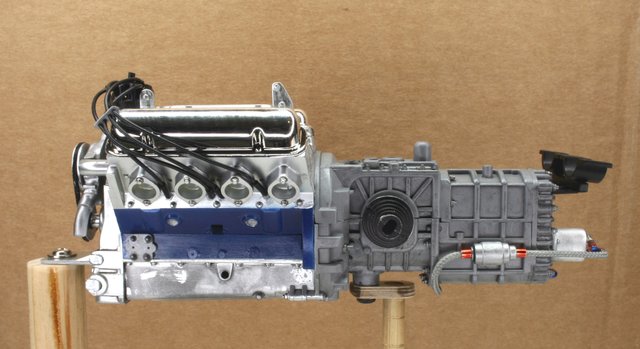

So this is where I'm at with the engine.  Still working on the water pump and planning other fittings for the plumbing.  Next will be a bracket and alternator.
Again, the reference pics have been invaluable.
I put on some washes and filters to give a more realistic appearance, so my recent military model building (aircraft) experience didn't go to waste.
Thanks for all the comments and following along.  I hope soon I will be posting real time for timely replies.

Wow, for a second there. I thought I was actually looking at a real GT. 40 engine, not joking. I love the detail you're putting into this. Great job!

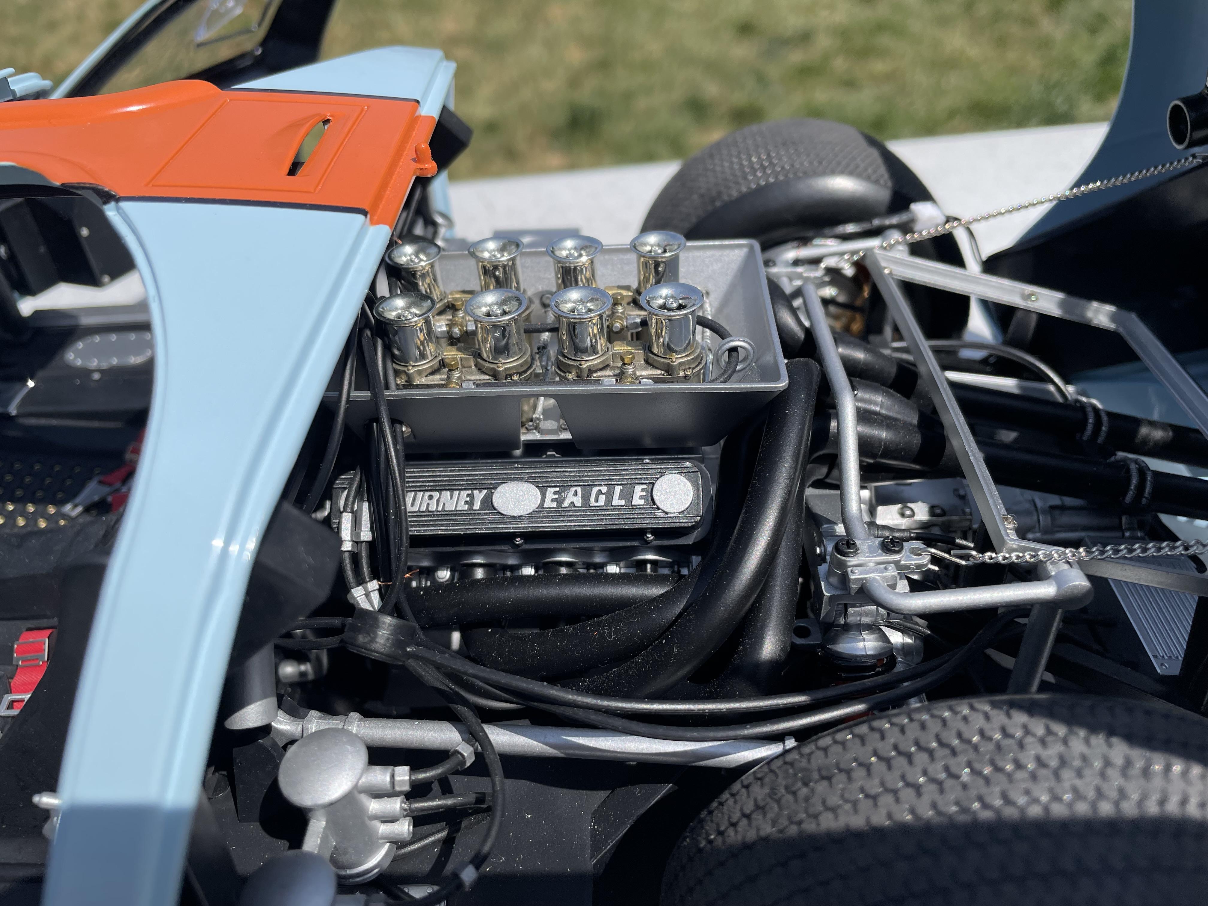

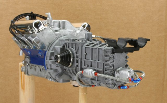

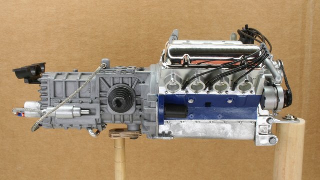

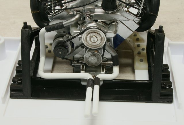

Update on the progress.  I found the kit's braided lines, made of a textile, not metal, actually work very well with their fittings.  The downside is that it comes in white.  I colored it with a metallic silver Sharpie marker, but it turned out gray.  The distributor and plug wires worked out okay.
I re-worked the entire front end of the engine, making a water pump, pulleys, and alternator.  I think it came out well, much better and more accurate than the kit offering.

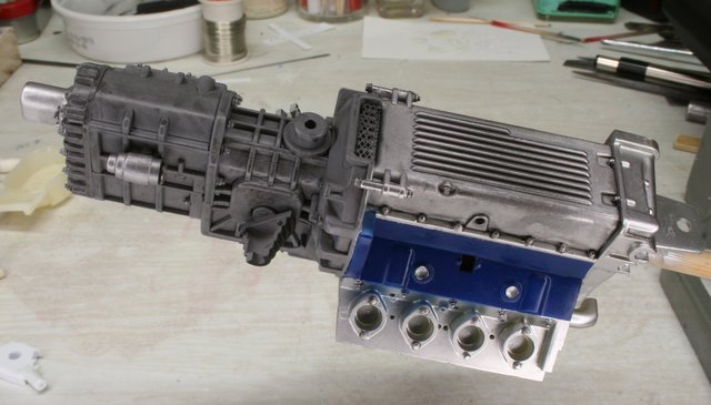

Next is the exhaust system.

Engine looks mighty good Ken. I love your upgrades on the front end and the mix of colors and textures. It adds a lot of realism to it.

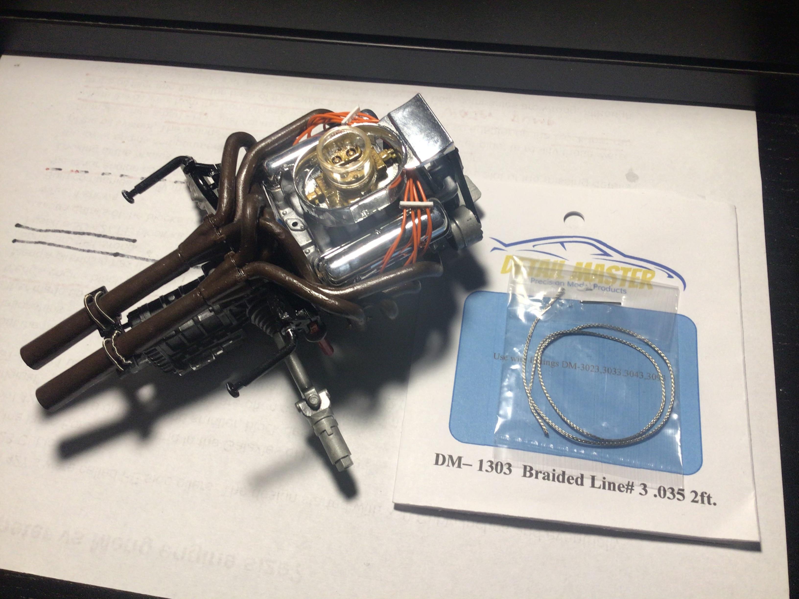

Thanks for the tip.  I bought some Old stock detail master braided lines in various sizes.  It is hard to cut, the frayed pieces will give you splinters and it is not hollow so the kit fittings do not fit inside.

It might be worth a mention about scale braided fuel lines. They look to me like electronic screened cable that has had the outer insulation stripped off it.

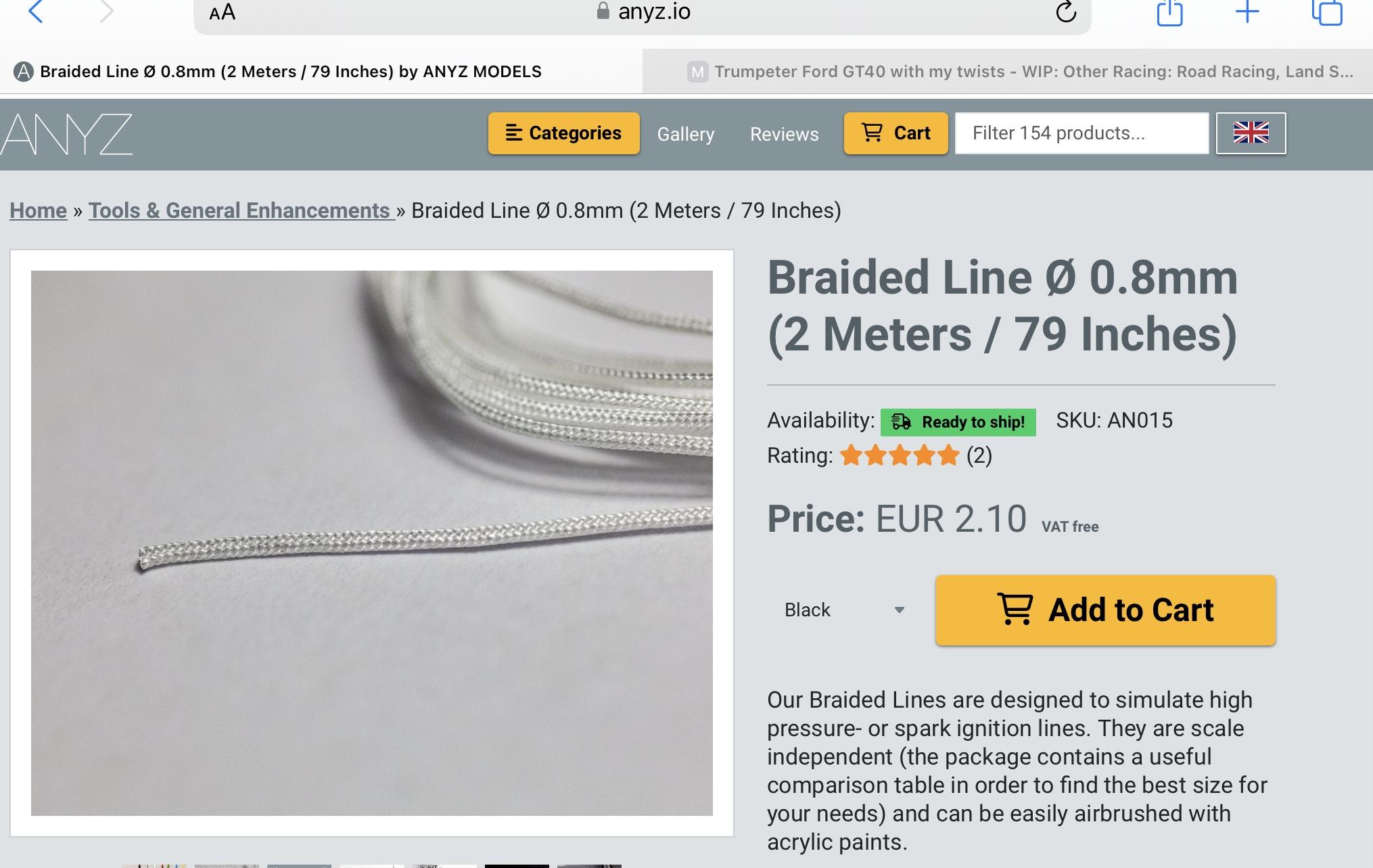

Found the s website per Andy’s comment.  I think I’ll have to order those once I determine the best size.
https://anyz.io/shop/product/AN015

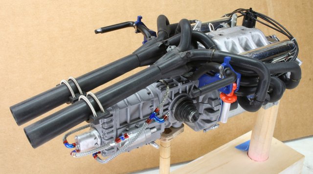

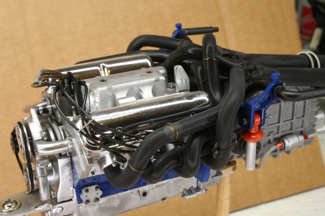

Added a few more details and charmed the snakes.
I detailed the exhaust by adding some stretched sprue to depict weld lines.  They came out a little overdone to my liking but they are not too noticeable since they are mostly black anyway.  Did touch them off with a little gold accent.
I corrected the transaxle plumbing based on what references I could find.  I think it is correct now.

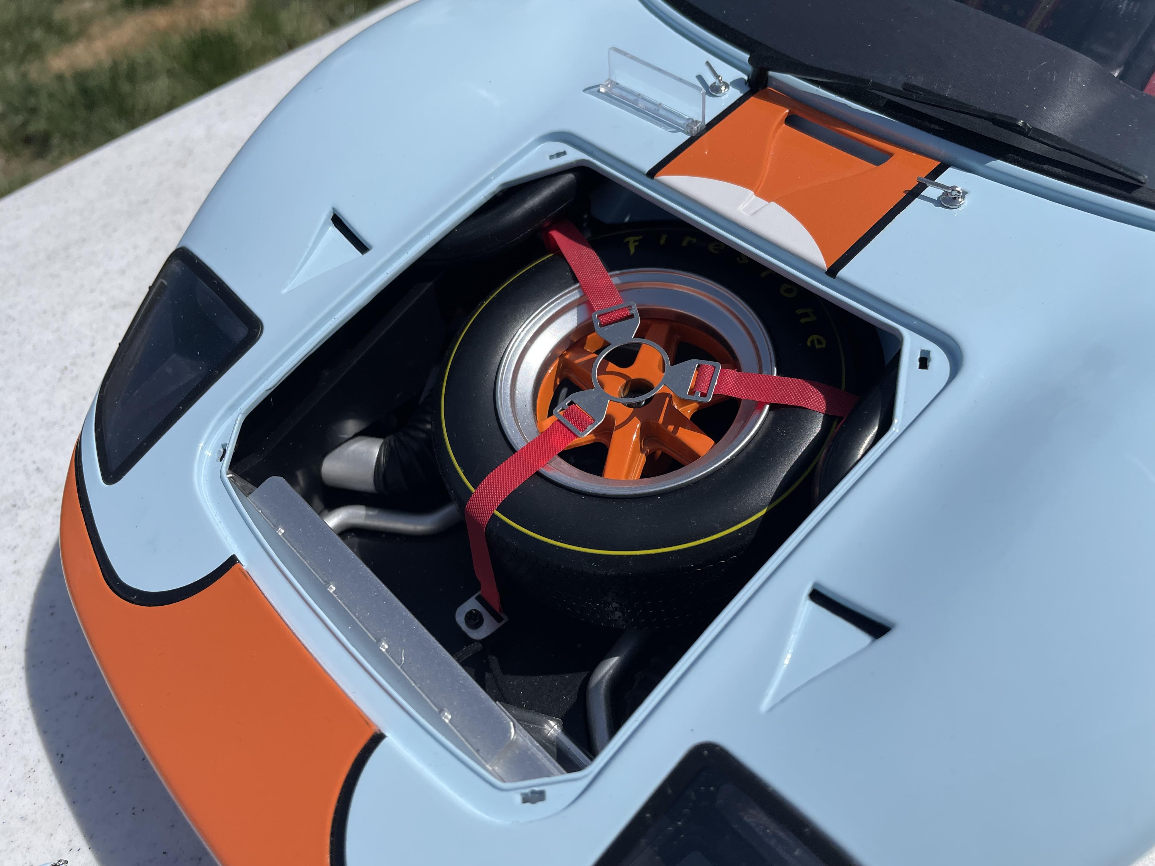

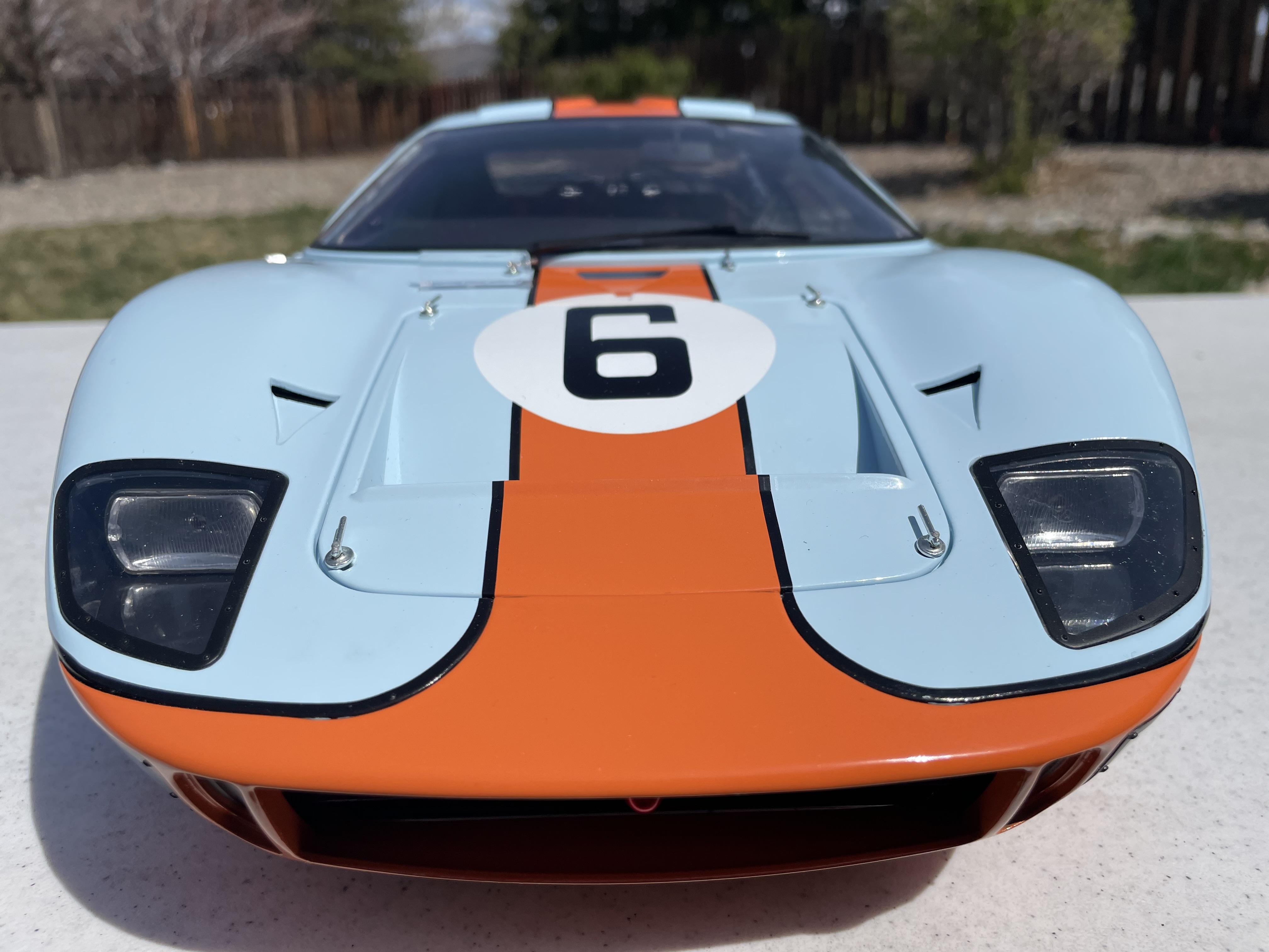

DeAgostini has the gulf car. Not a bad build. In 1/8 it needs a little detail but if you do a little detail it looks pretty good. I was happy the way it came out. Not the big block car. This car was after the fia banned the big block cars at lemans. The corrections on the trumpeter kit will be a great build.
  • Like 2
Was not aware of that DeAgostini kit Bruch. Thanks for putting up the pictures.

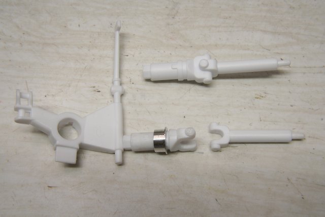

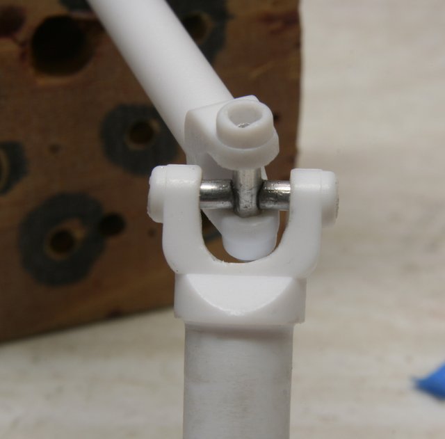

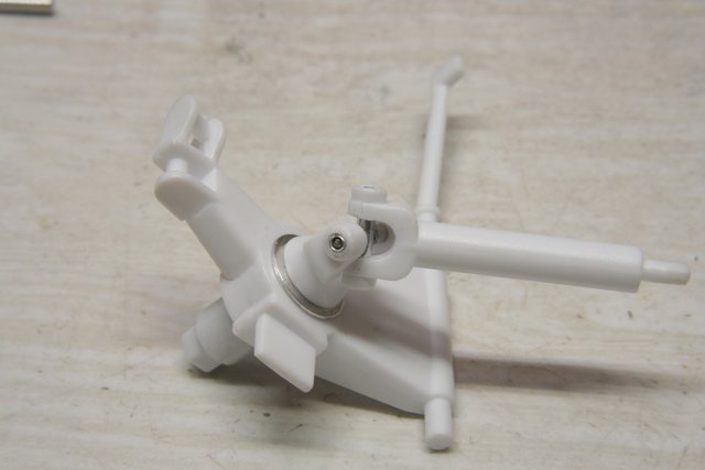

The wheels will not rotate (at least there will be a flat spot on them) and I didn't know what position the drive shafts would be in, so I made them functional.  I really didn't like the looks of the kit version of them anyway.  Some 1/16" aluminum tubing and 0.032" wire did the trick.
The fit of the axle through the hub carrier was very sloppy.  It looks like there is a piece that fits around the axle that is missing, but it is not in the kit or mentioned in the instructions, so more re-engineering with a sleeve to take up the slack.

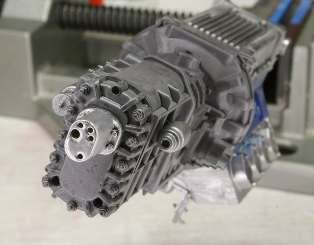

I have place 57 bolt heads so far and more are sure to come.  I'm liking that price on those Meng bolts!

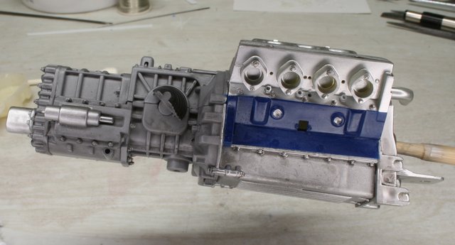

The kit left out some necessary components, like the distributor, starter motor, and crankcase breather, so I will be adding these.  Must have slipped their mind.
The beginnings of a distributor and the breather I knocked out on the lathe.

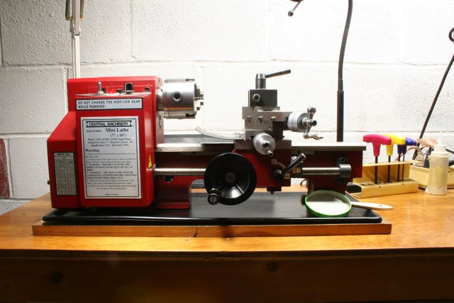

When I first got back into the hobby in the 1990s, I got a bunch of kits, more than I would ever build.  When I realized this, I had a change in focus.  I started investing in tooling and my own skills.  That way I could build anything I wanted and not depend on model companies.  These days, you should consider getting into the 3D printing stuff.  I think that is where the hobby will be going in the future.

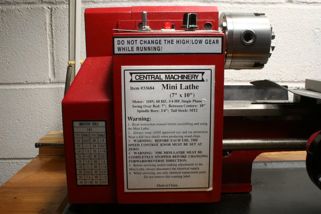

I didn't know anything about machine tools, so I started with a website named mini-lathe.com.  They have articles about how to set up the Chinese table top lathe.  These lathes are made to a single design by many Chinese companies and sold under many different retailer's names.  I bought mine from Harbor Freight.  The minilathe website tells you how to set it up and tune it up to get 0.001" accuracy, which is plenty good for modeling stuff.  They also reference LittleMachineShop store for parts and metal.  You will also spend about the same amount of money buying tooling as you do for the lathe itself.  Based on the information from the website, I set up my lathe and just started working with it.  Simple stuff at first.
If you have a lathe, you will want a mill, too.  Mini-lathe.com has some references to a mini-mill website too.  LittleMachineShop has a lot of resources for both.  I got a micromill from Harbor Freight, although I wish I had gotten a minimill, which is larger than the micromill.
This is the lathe I have.
I can show more about my workshop if there is interest.

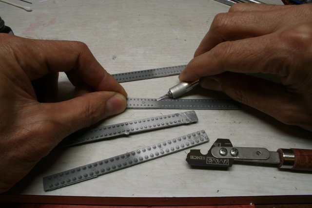

As for the Meng bolts, removing them from the backing doesn't give me any heartburn.  I have re-shaped a hobby knife blade to use for the small bolts (I make a lot of my own tools for special purposes).  Just cover the bolt with your finger when cutting it off or it will go pinging off into space.
I remove the larger bolts using a razor saw.  The blade broke, so I modified it so the blade extends far out from the holder.  This is a very handy modification.
Over the years I acquired a few machine tools for this hobby stuff, which opened up a whole new aspect of model building for me.

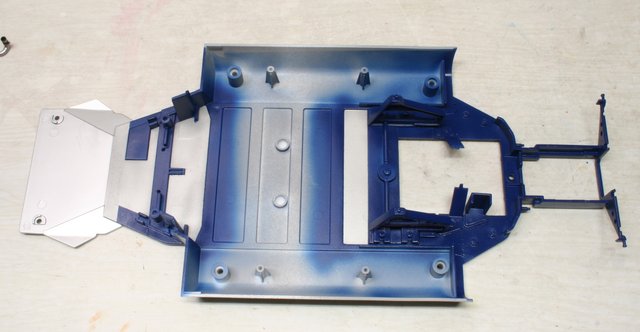

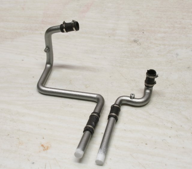

A short update here - the coolant and oil plumbing bits and , first paint on the chassis pan.
These coolant lines will run to the tunnel going through the cockpit.  PE hose clamps and heat shrink tubing.  There are take-offs for the lines running to the water reservoir tank.
These are fittings and lines for the oil circuits - to and from filter and oil cooler and the large ones to and from the oil tank in the front.
The chassis pan was primed in gray first, then painted in dark aluminum and then blue.
The side pods remain in primer for now.
