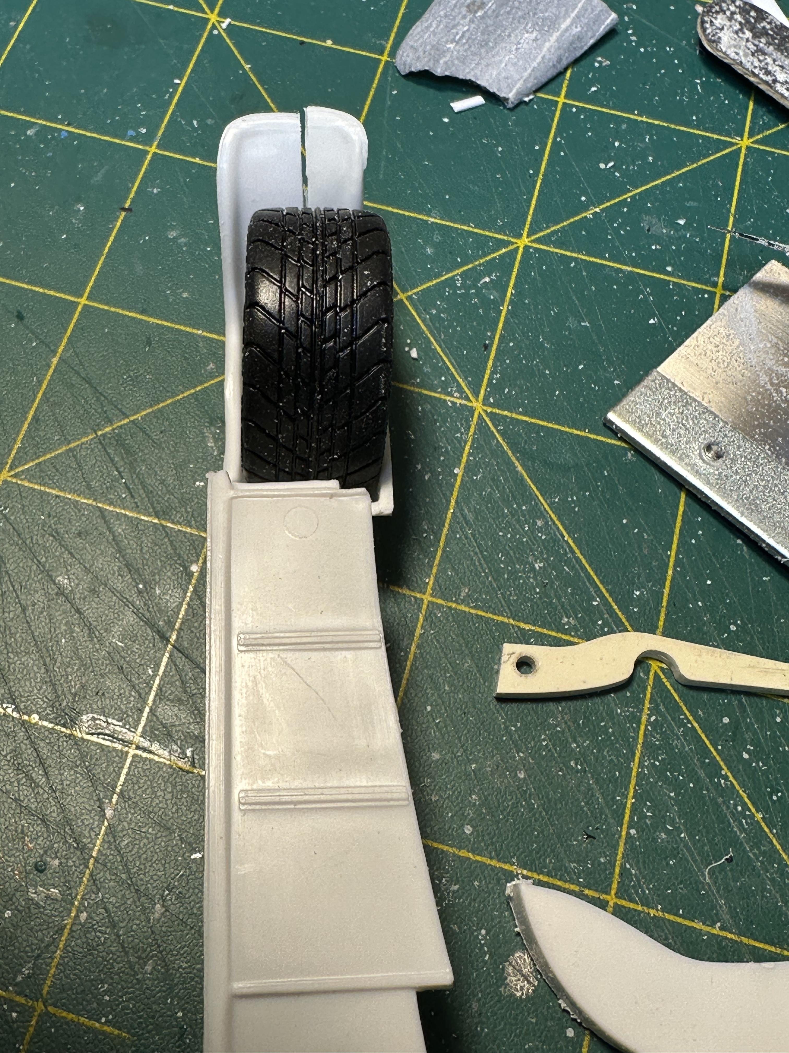

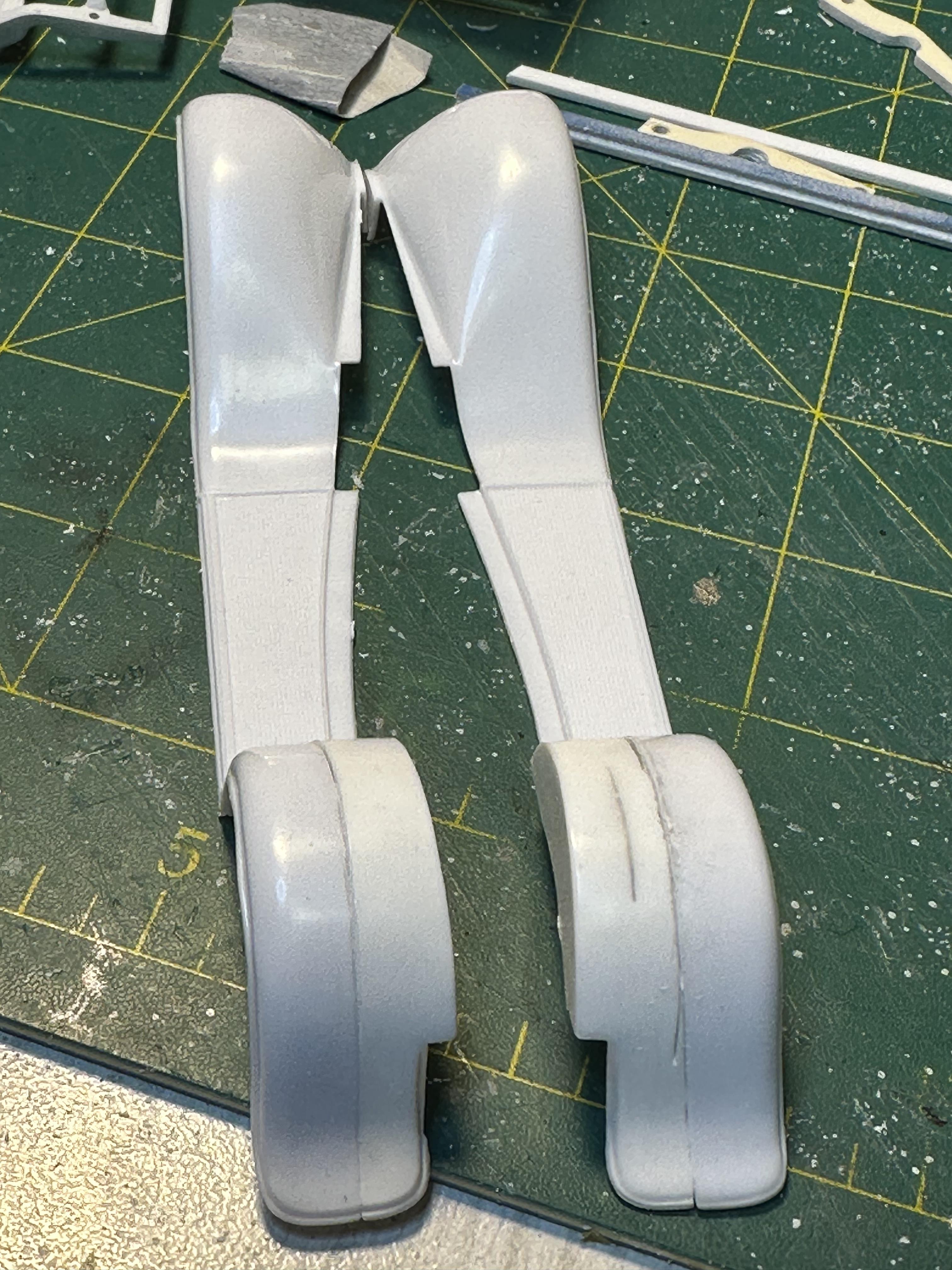

The new rear chassis rails - held together by small screws to ensure that they are the same when shaping
And the newly tubbed rear fenders. And they are now wide enough to fit the big rear meats from the Vicky. I now may be able to get the back down a bit more as a bonus

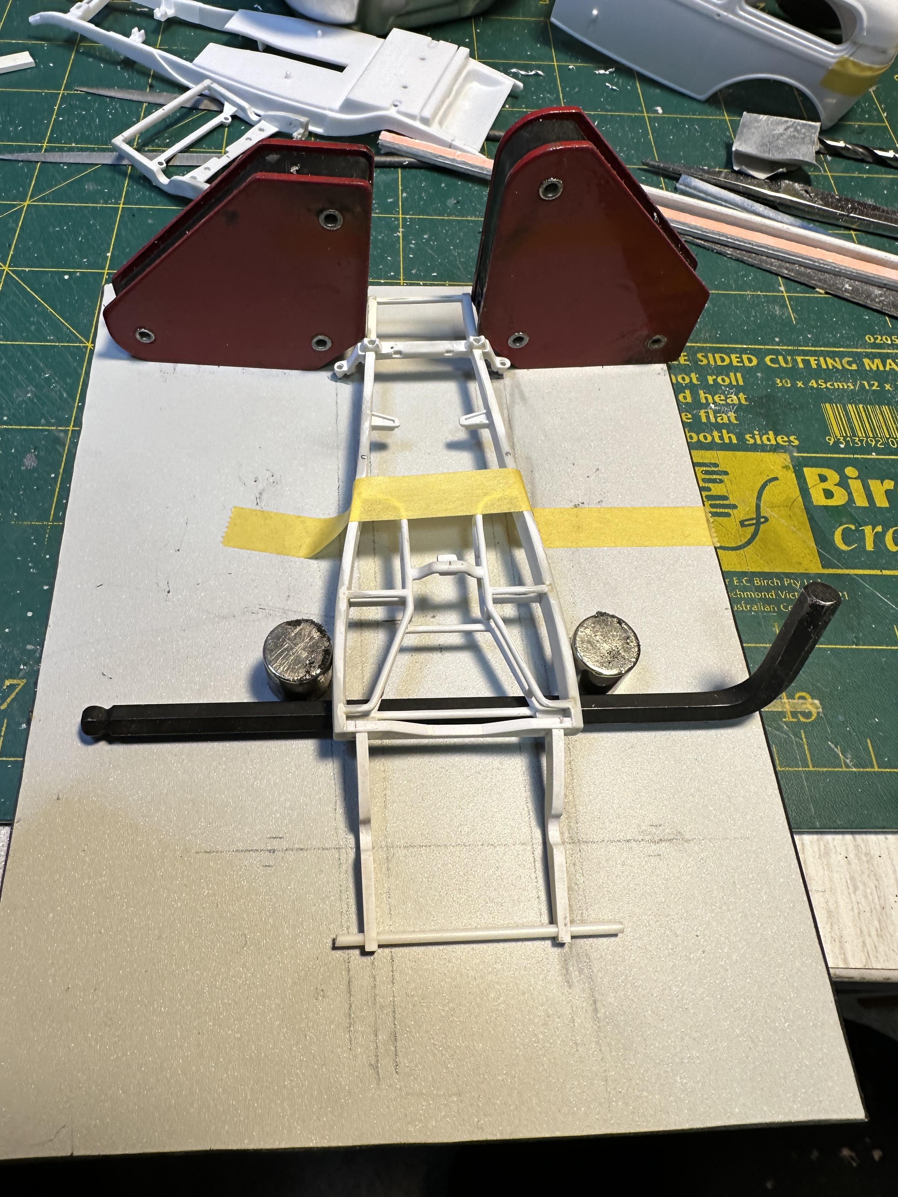

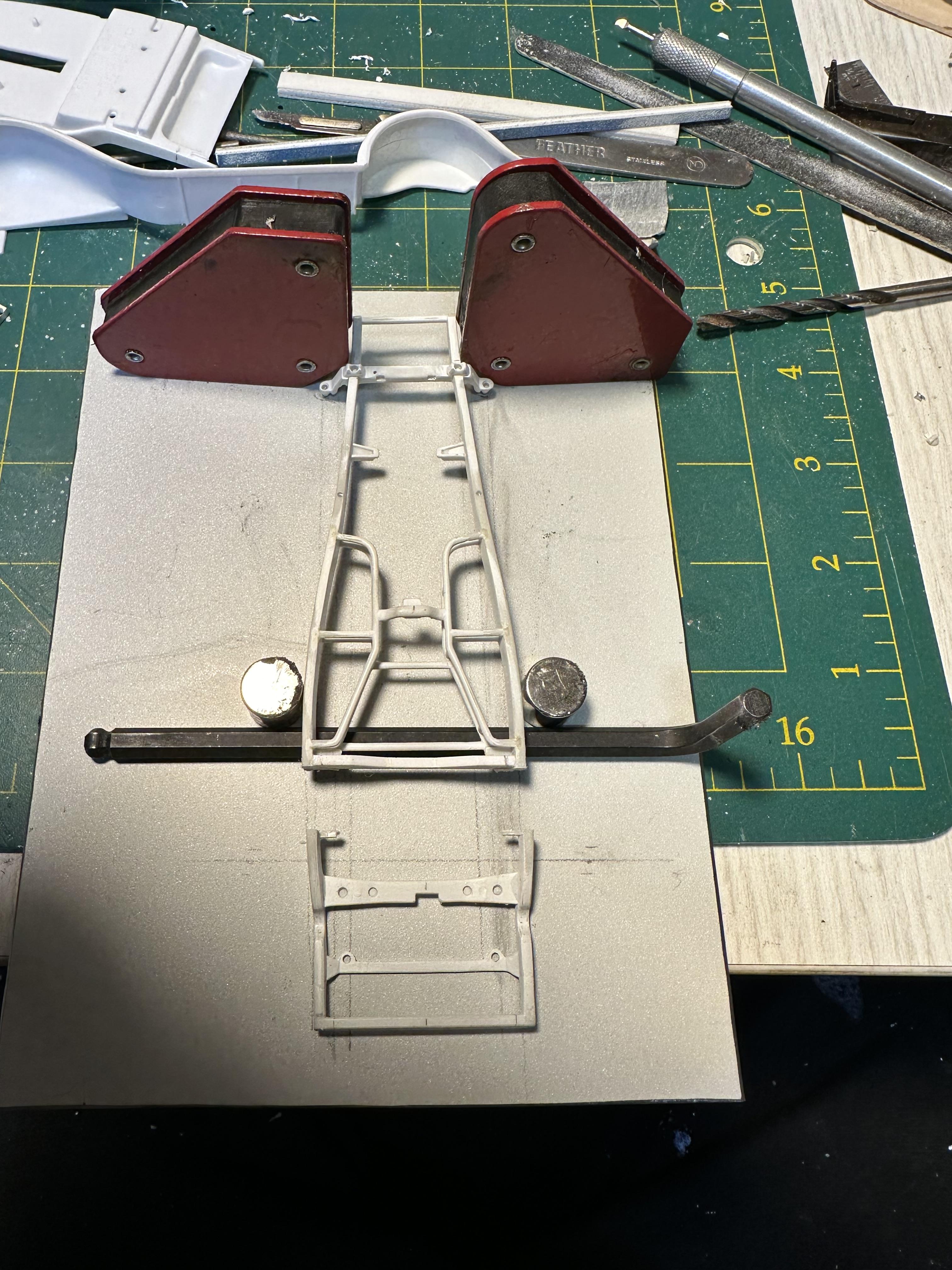

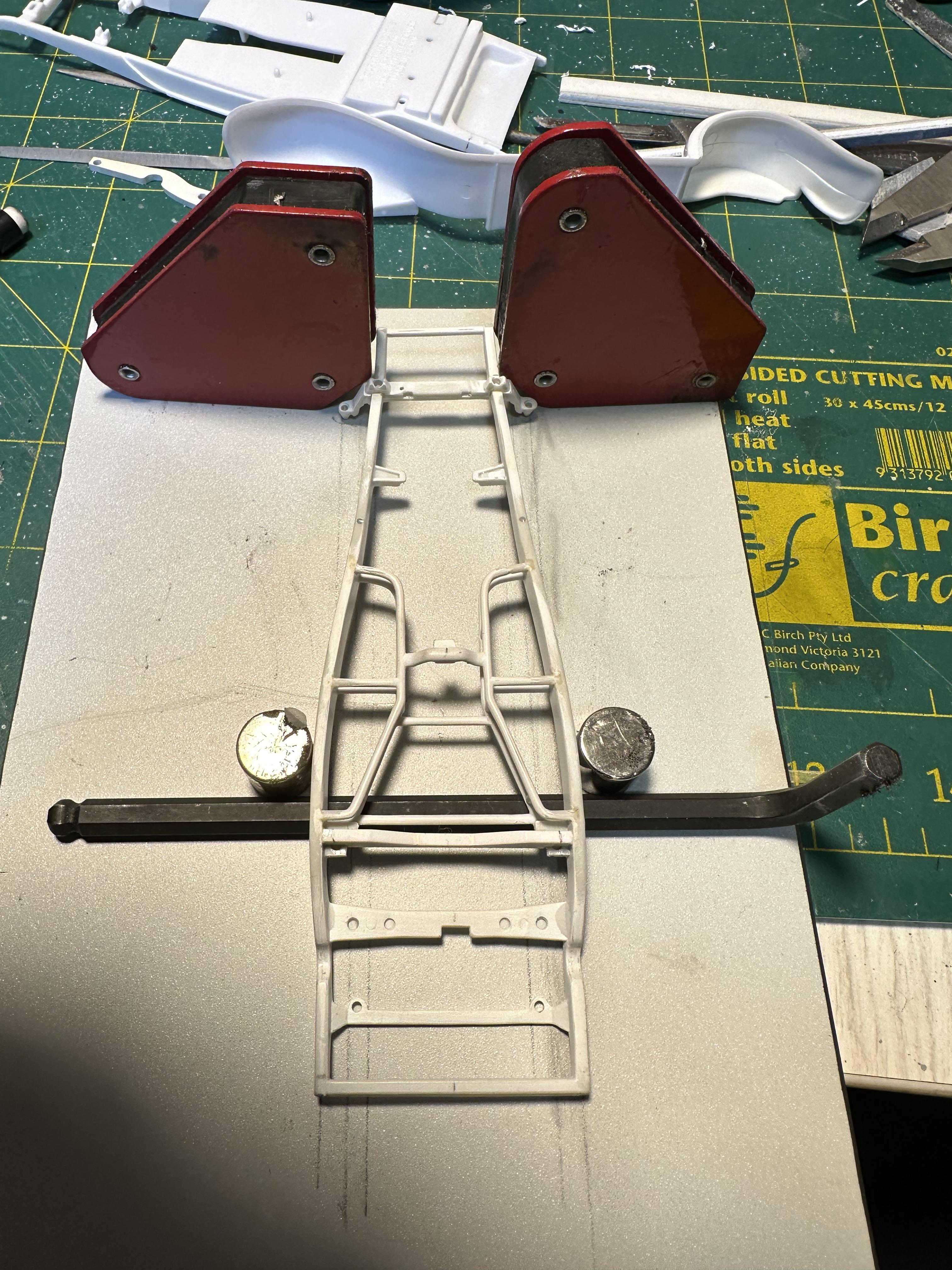

I have been working on narrowing the rear end. I made up a jig with some sheet metal and magnets. The Allen key is to provide spacing for the chassis from the jig. First pix is of chassis set up in the jig before cutting. Note that I have installed an extra cross member to provide attachment for the new chassis rails.

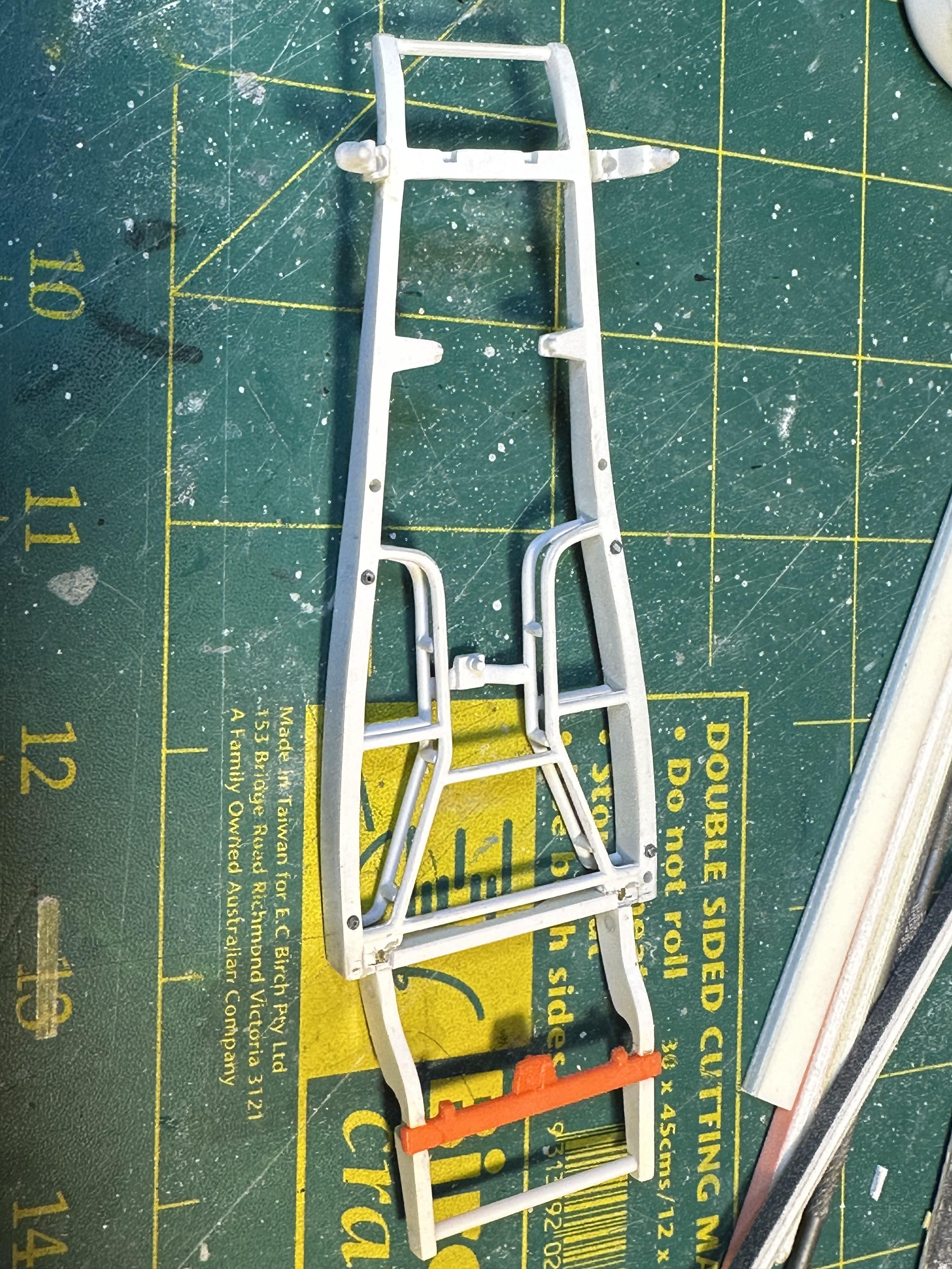

Next up is the chassis rails cut off before clean up
The new rails glued on using the jig to make sure all is straight

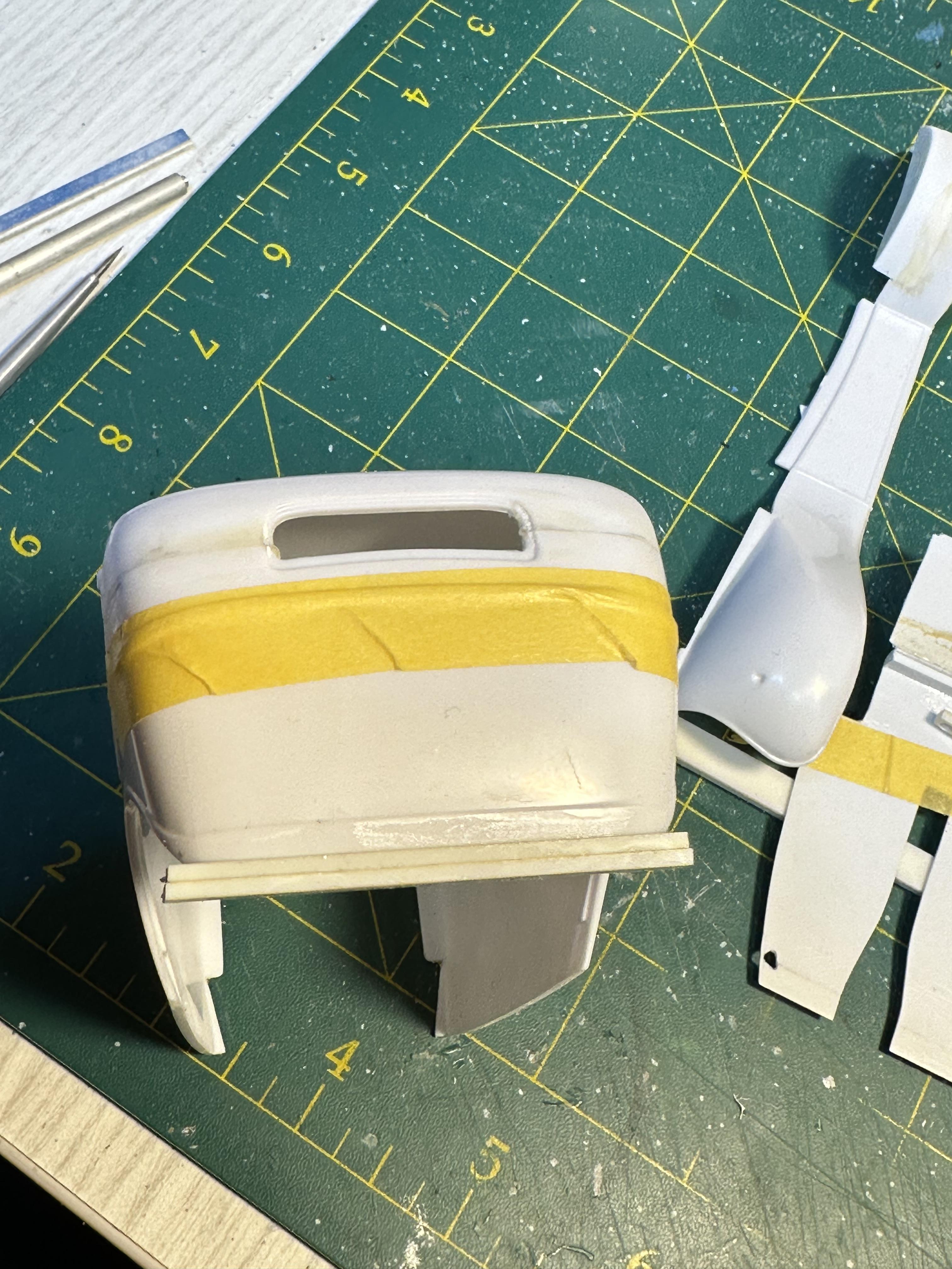

Although the rear of the chassis can still be seen when the body is mounted it is not as exposed as with the original due to the straightening of the rear section of the new rails. As I am not using the fuel tank and cover I need to cover the rails so I will make up a rolled pan. Two pieces of 1.5 x 4mm glued up and glued onto the back of the body. I will shape up when the glue has set up
I have also been working on the body filling and filing the cut lines

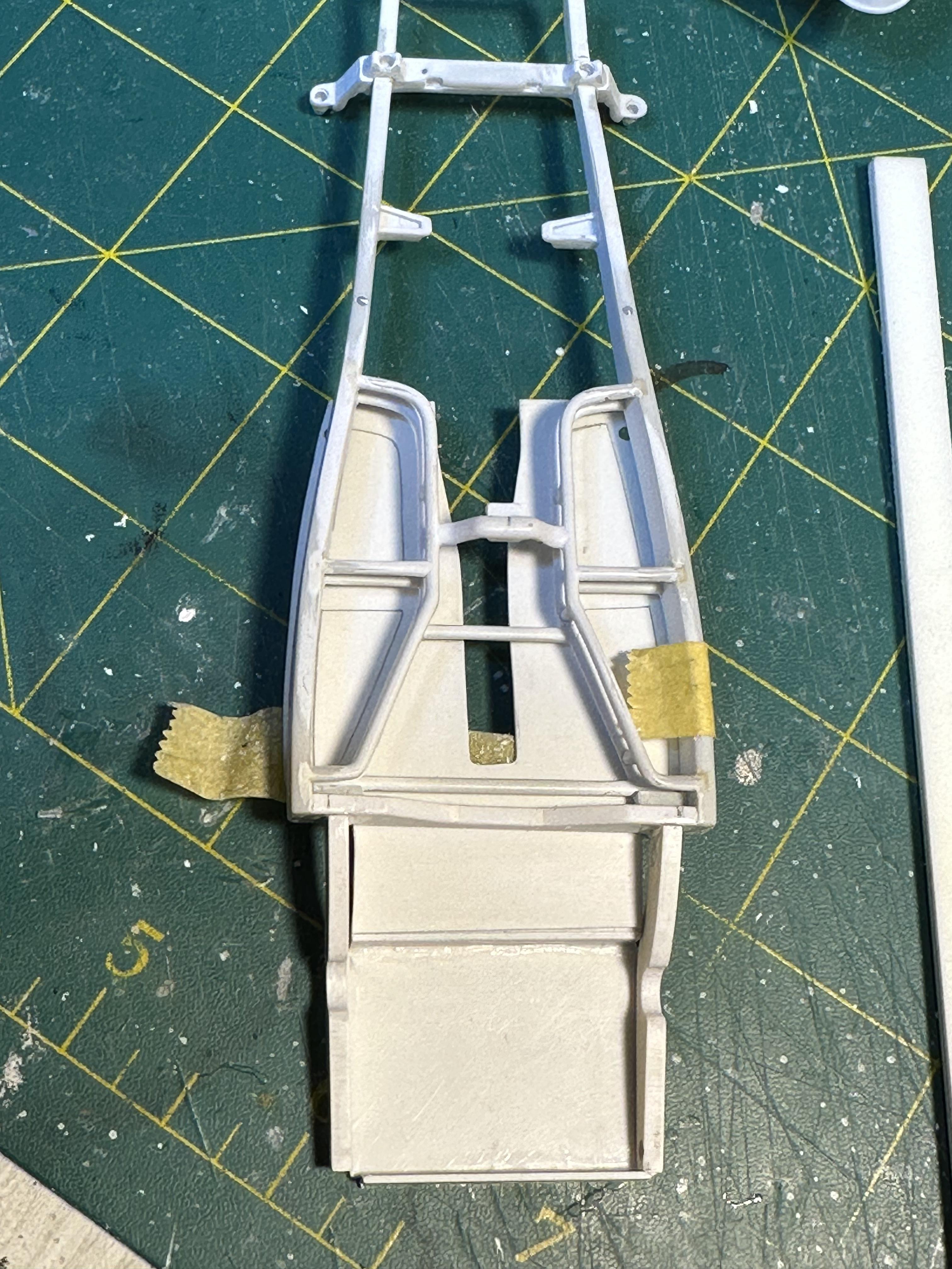

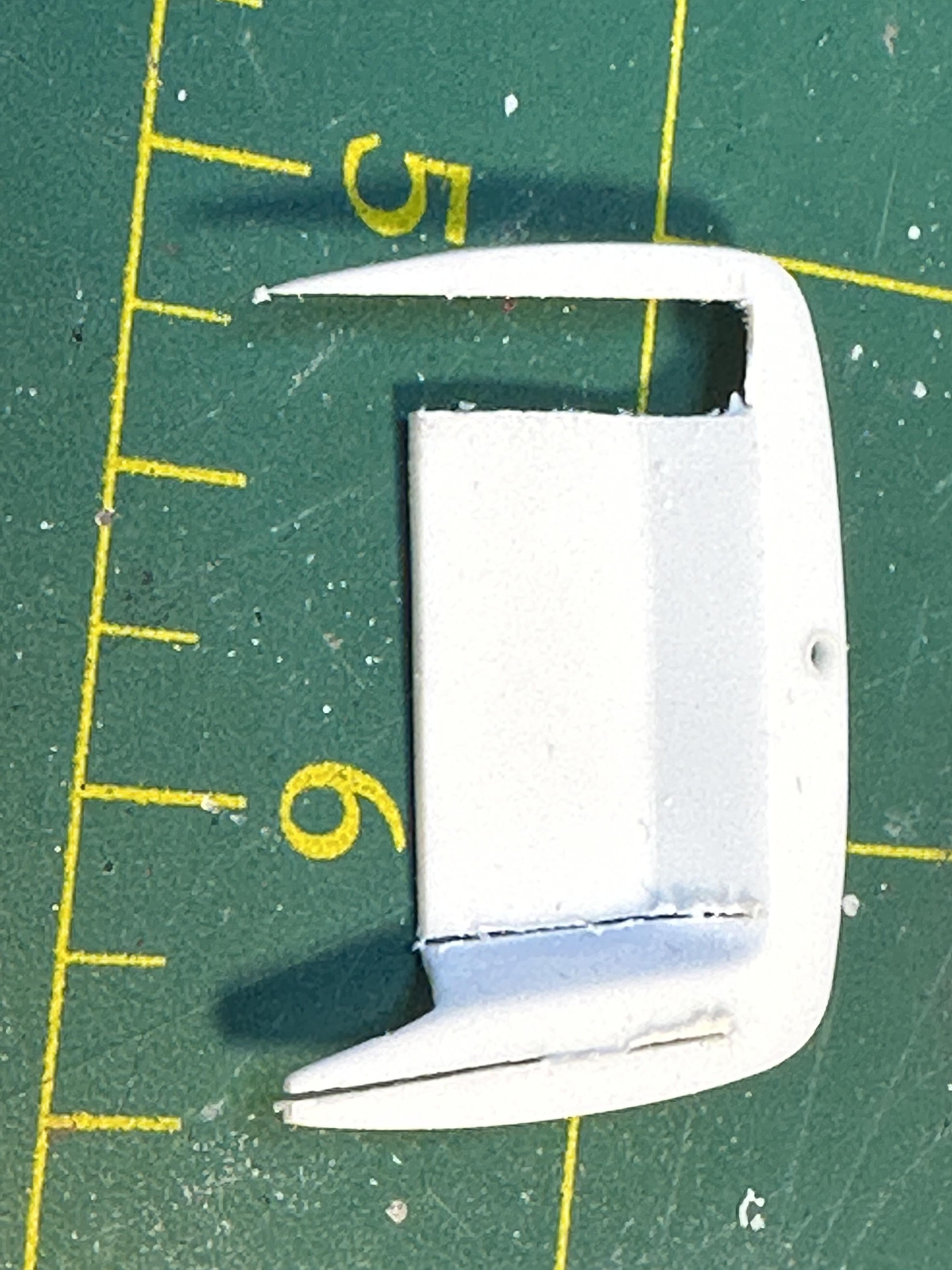

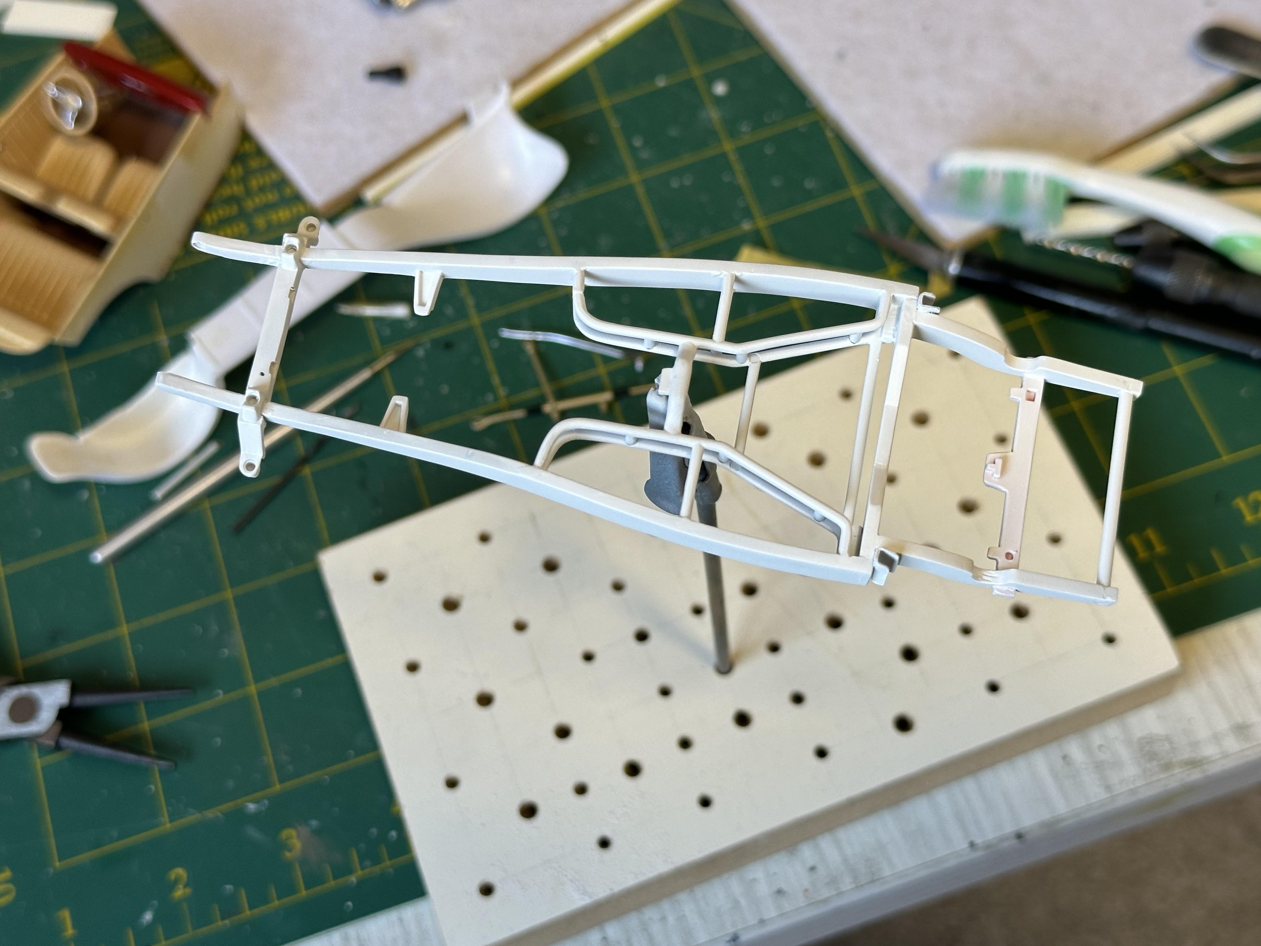

Had to make some adjustments to the floor pan to fit around the new rails and the tubed guards

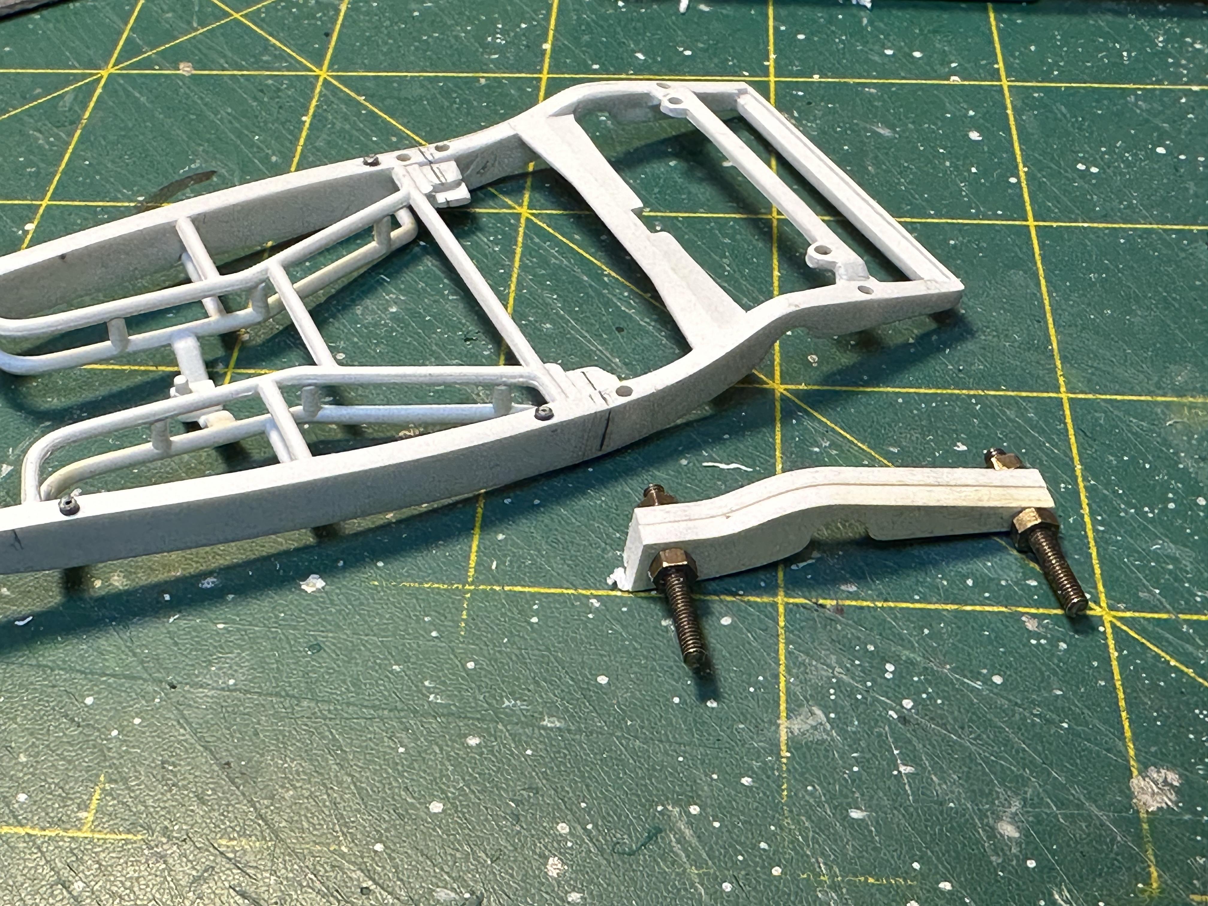

Next up was mounting the Lil John rear end. Mocked up the chassis and guards to get the required ride height. I then notched the rear rails for the cross member and glued that in
I also put some brass dowels into the chassis extensions by angle drilling from the top.

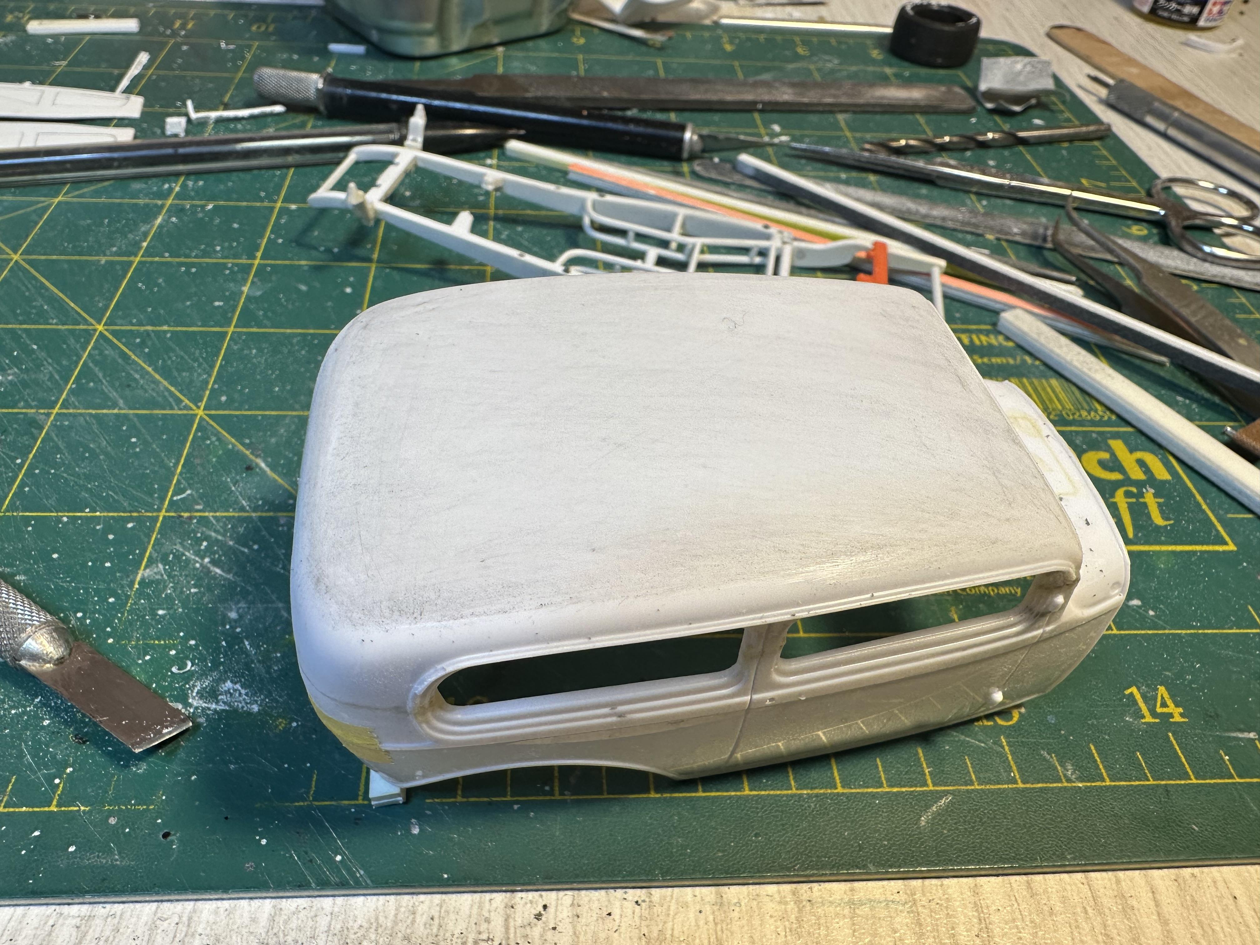

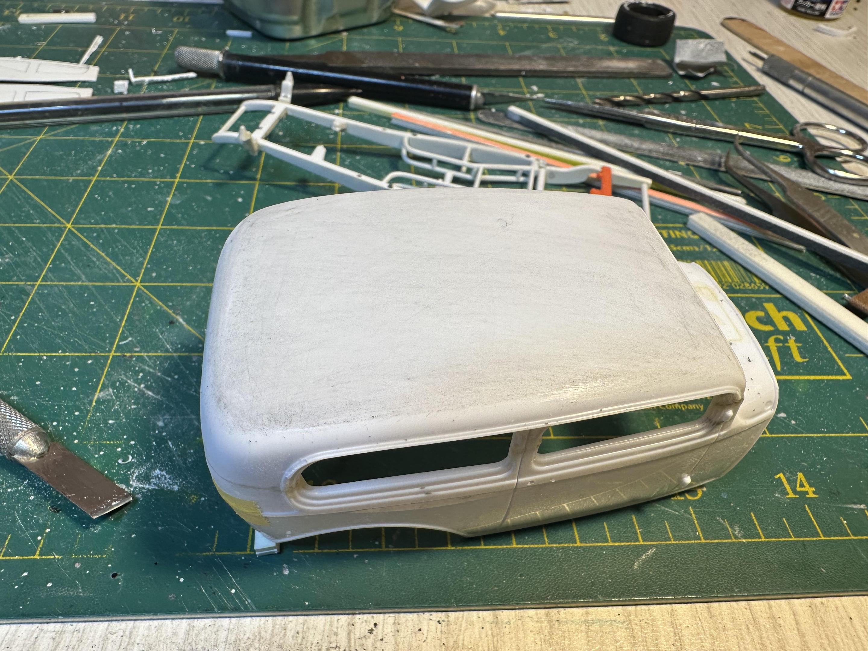

While waiting the glued crossmember to set up I attacked the top insert to remove it. First up I removed most of the moulding/bead with an Xacto chisel blade then went to work with a 230 grit sanding board to remove what was left of the bead and the textured insert. Next I will work through the grades to knock back the sanding marks

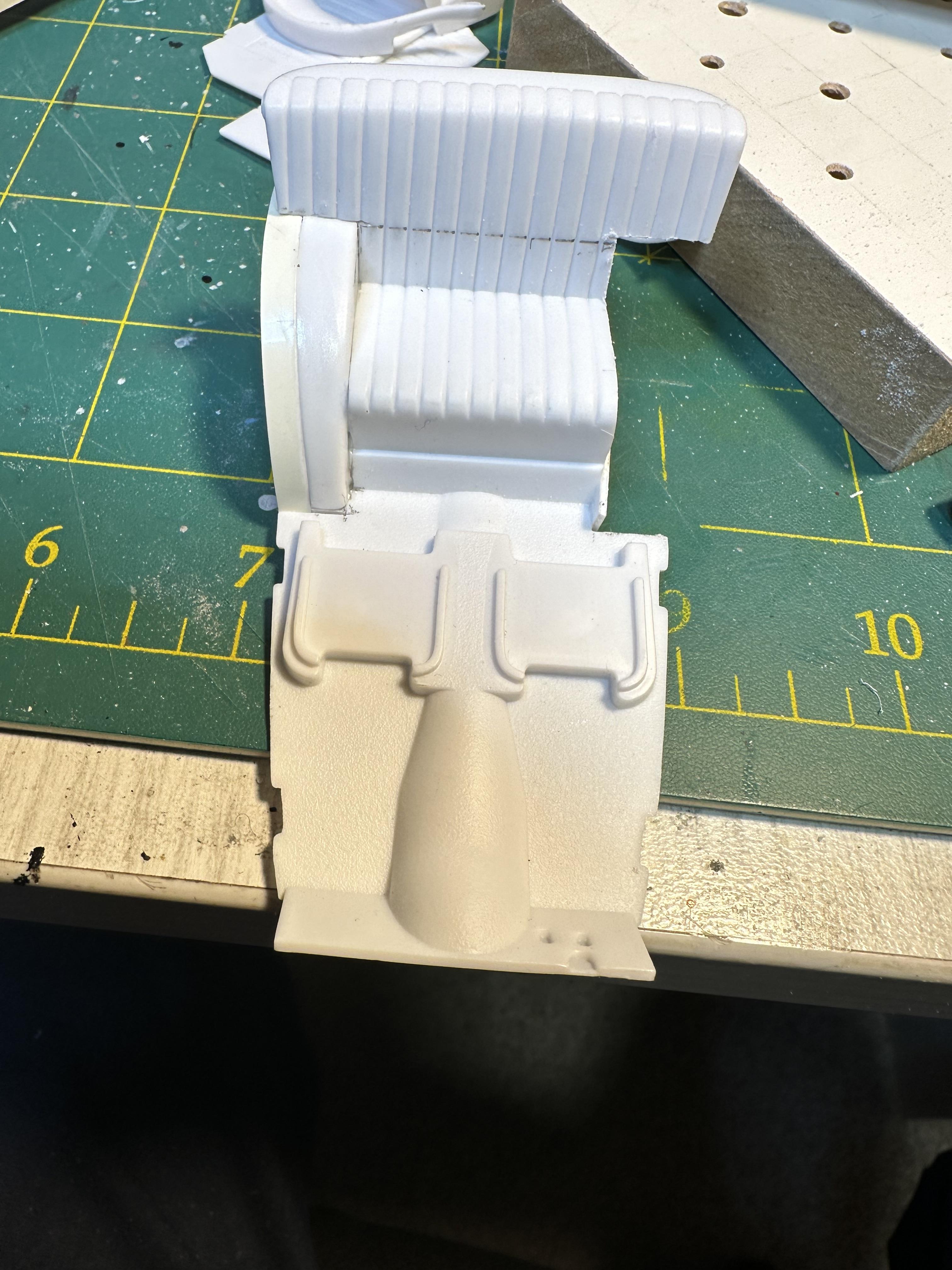

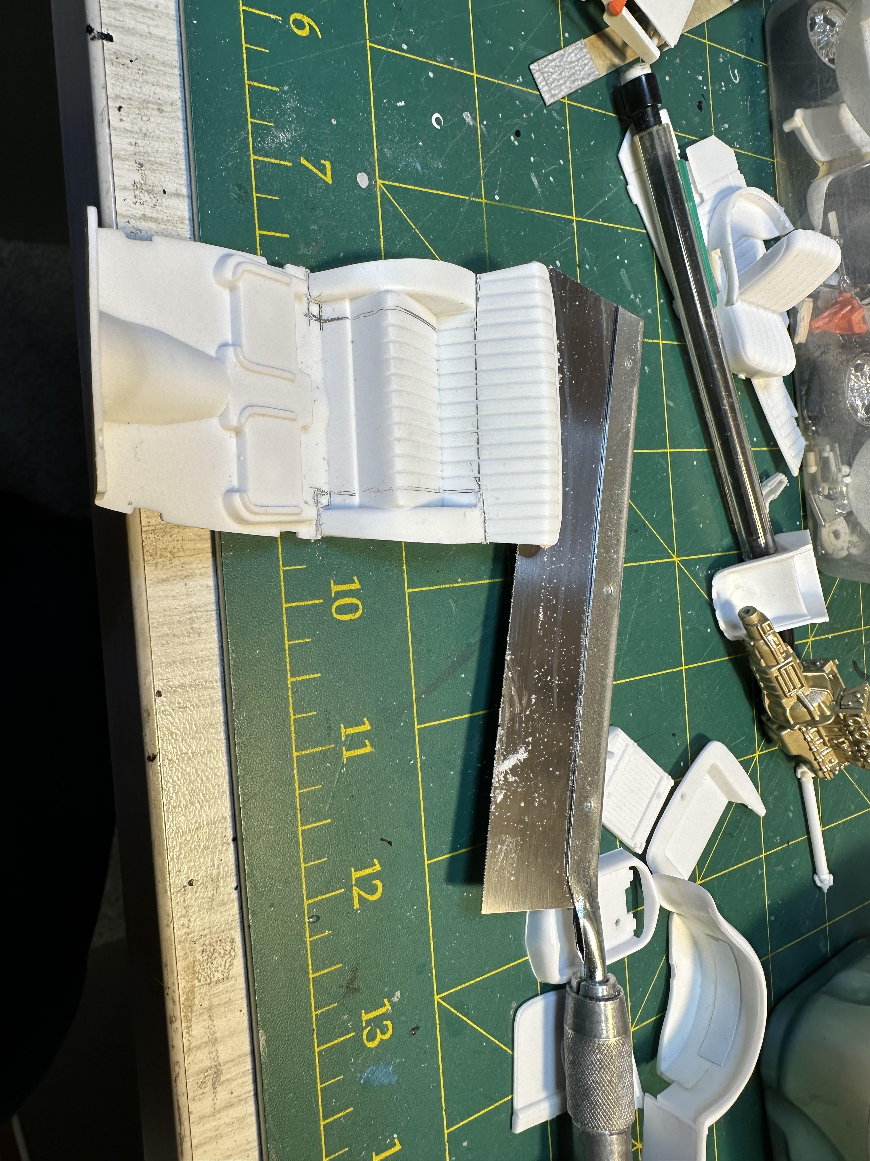

As I tubbed the rear guards I now need to look at the interior as it will not fit. Doing a bit of eyeball measuring it ooks like I can narrow the rear seat are down by one pleat on each side. Out comes the trusty razor saw. A tip here - if your saw is dragging a bit rub a candle across the blade, it makes a world of difference.
First pix is marking cut lines and horizontal cuts made
Next pix shows both sides cut with the passenger side tubbed with a strip of plastic. Drivers side has a cutting oops being filled in with a bit of plastic filler. The tub extensions are slightly wider and will be filled back to fit the door cards

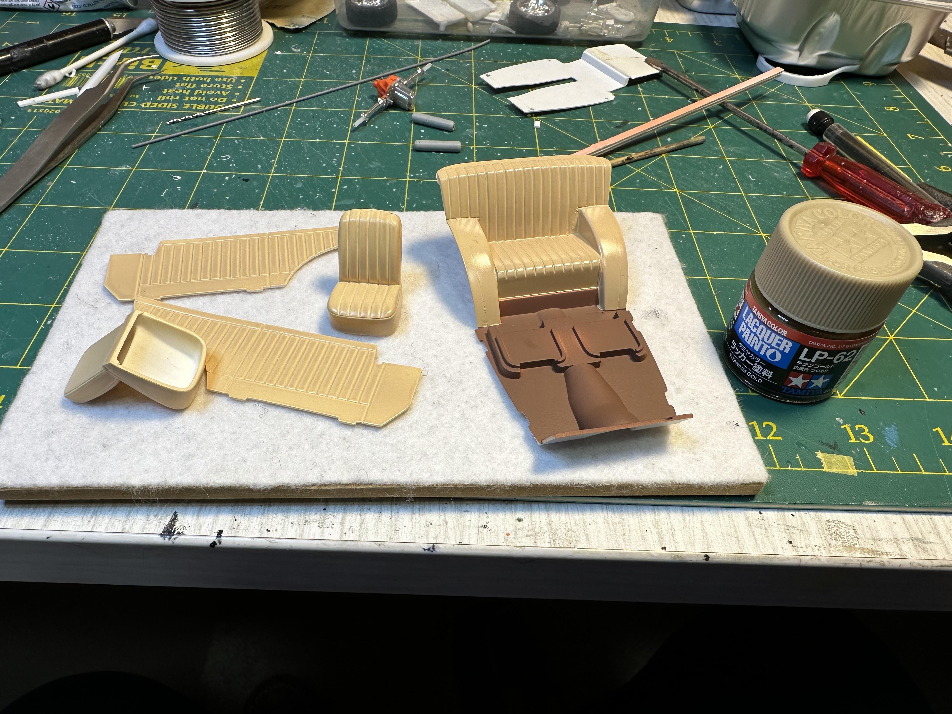

The rear seat area tubbing was completed and now has paint. As the carpet will be hard to see I will not flock it - or maybe. I have used a darker brown for the carpet which is the Tamiya LP-62 lacquer with dark brown added. I mixed the LP lacquer paint with Tamiya acrylic, and they seemed mix together. The seats and door cards were overcoated with semi-gloss clear and carpet is matt finish

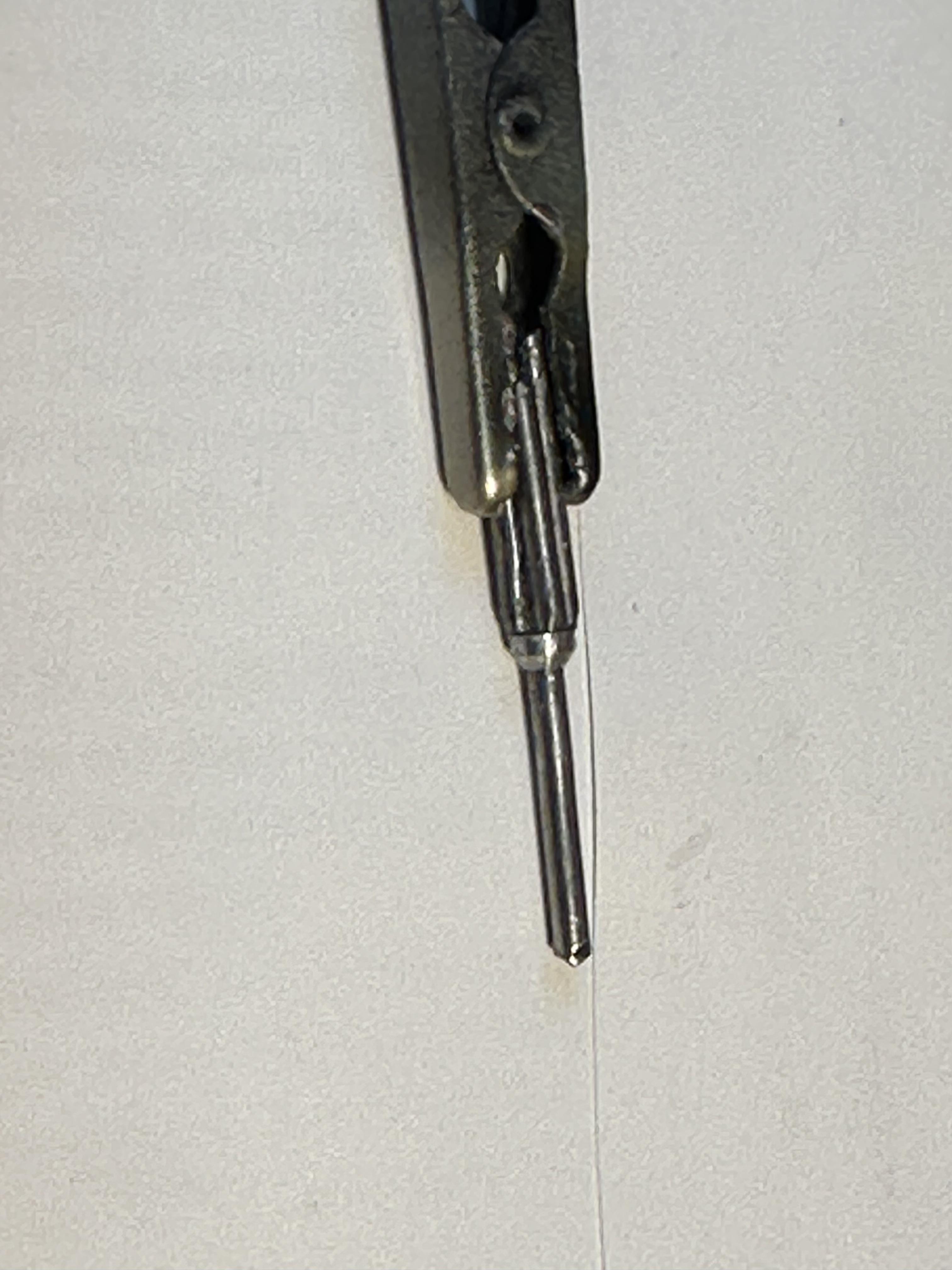

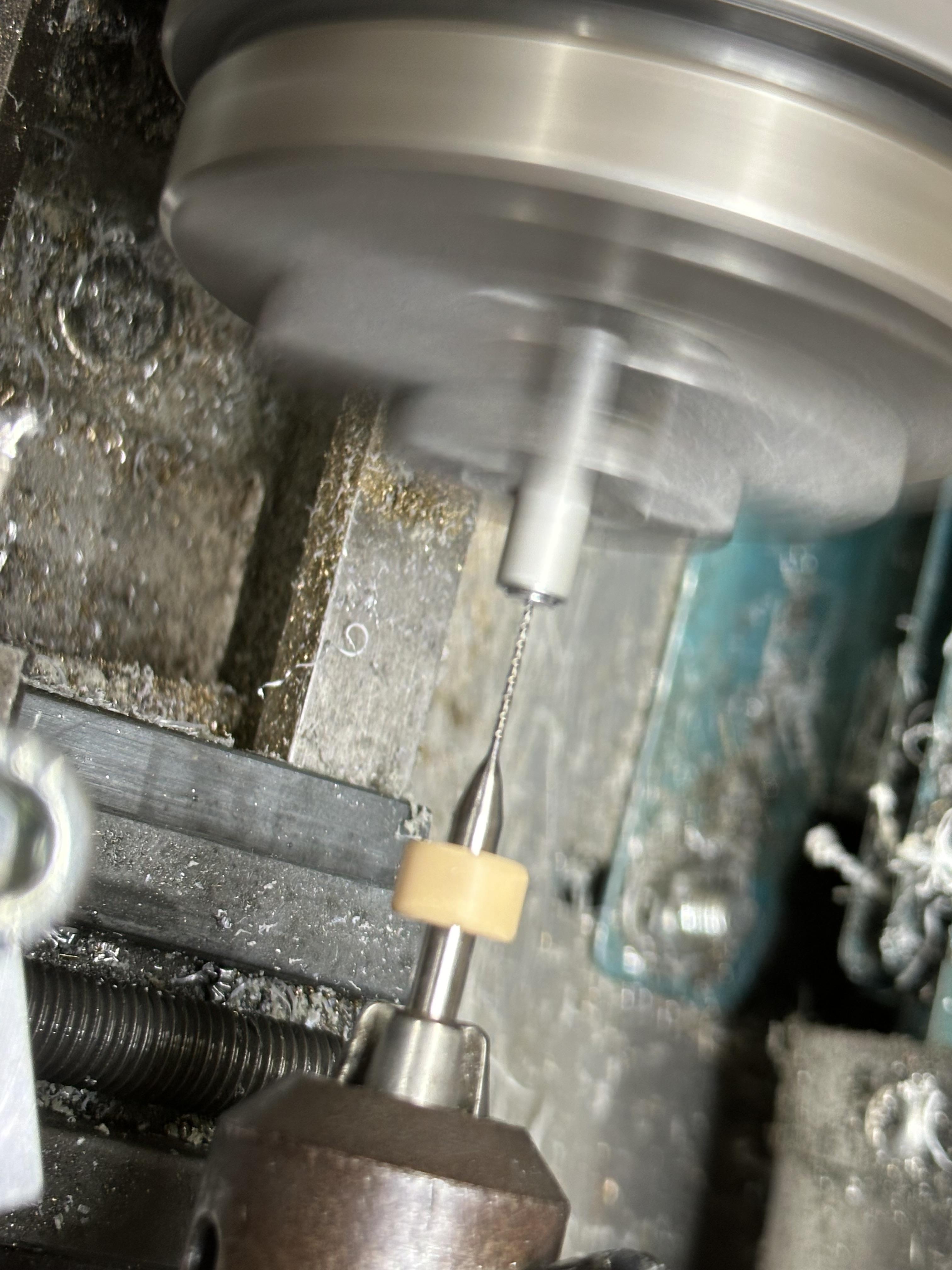

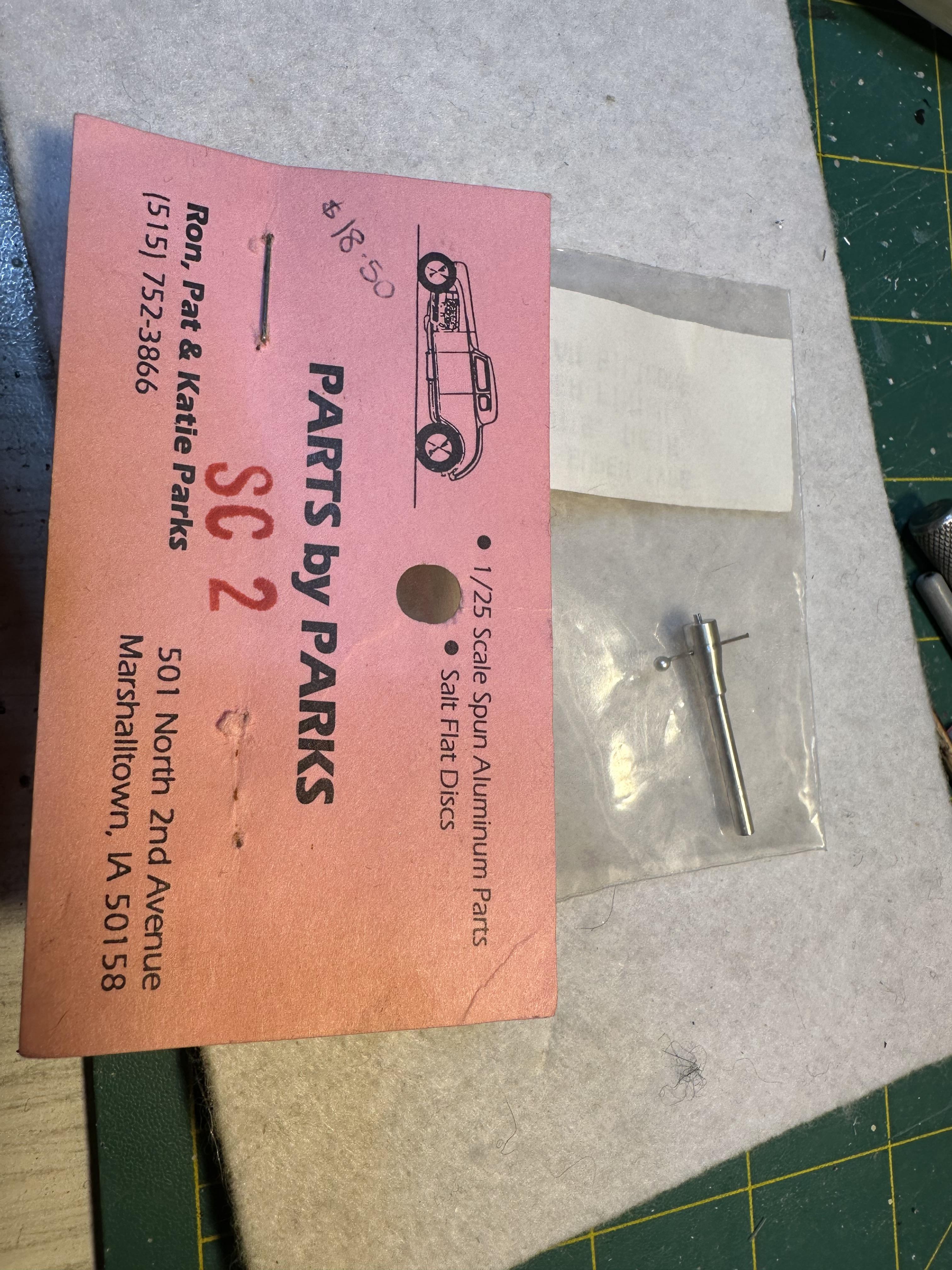

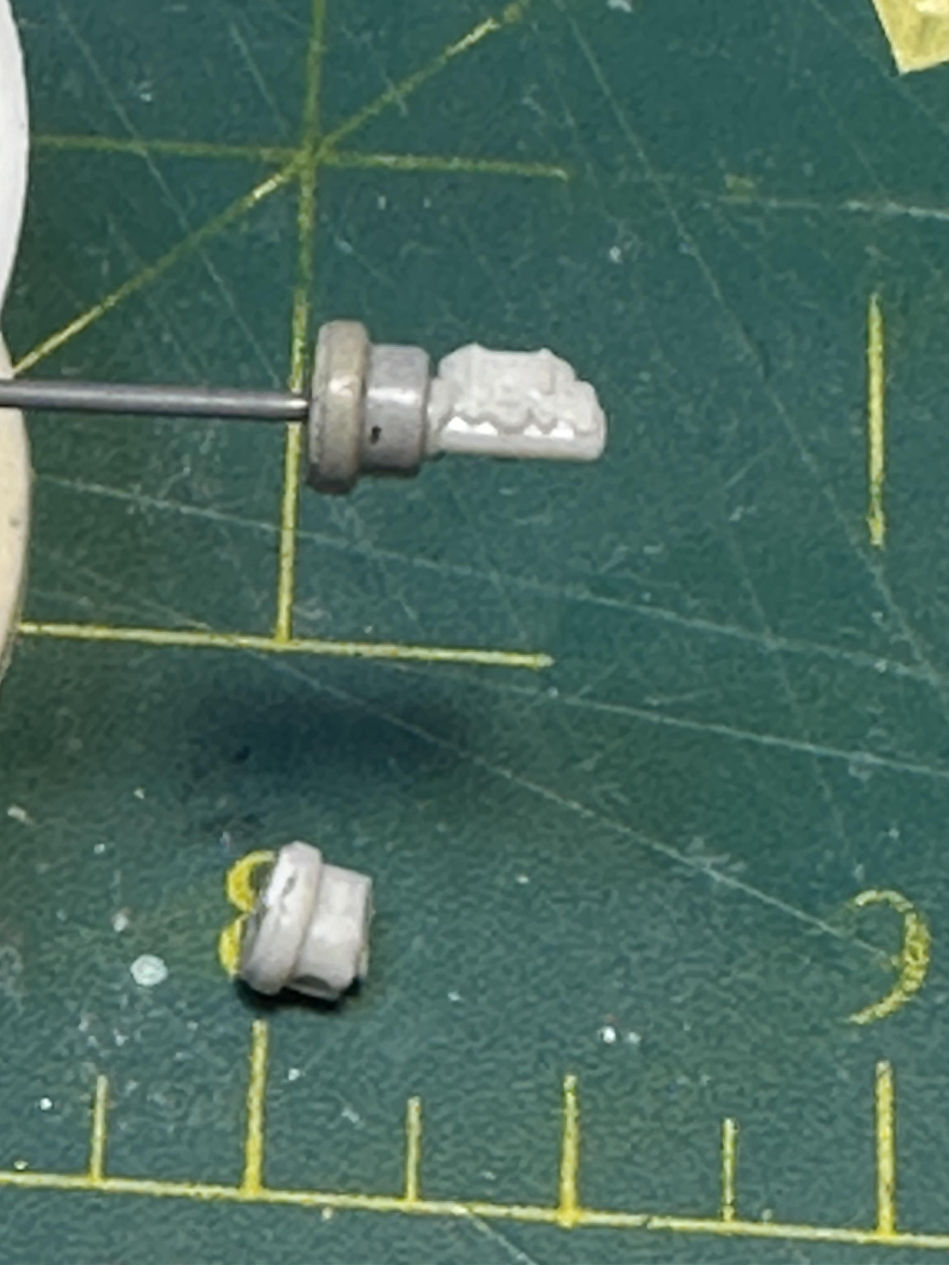

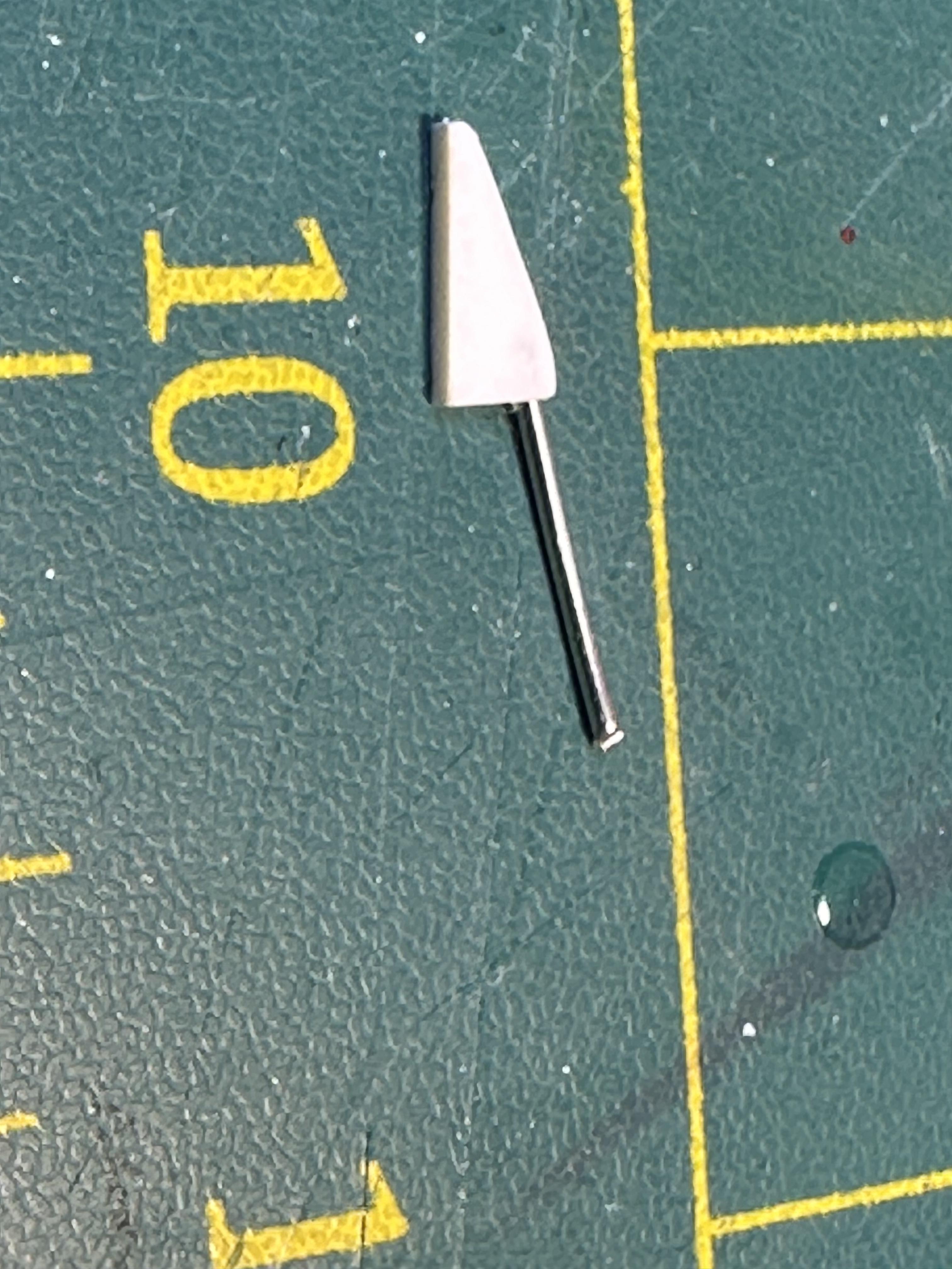

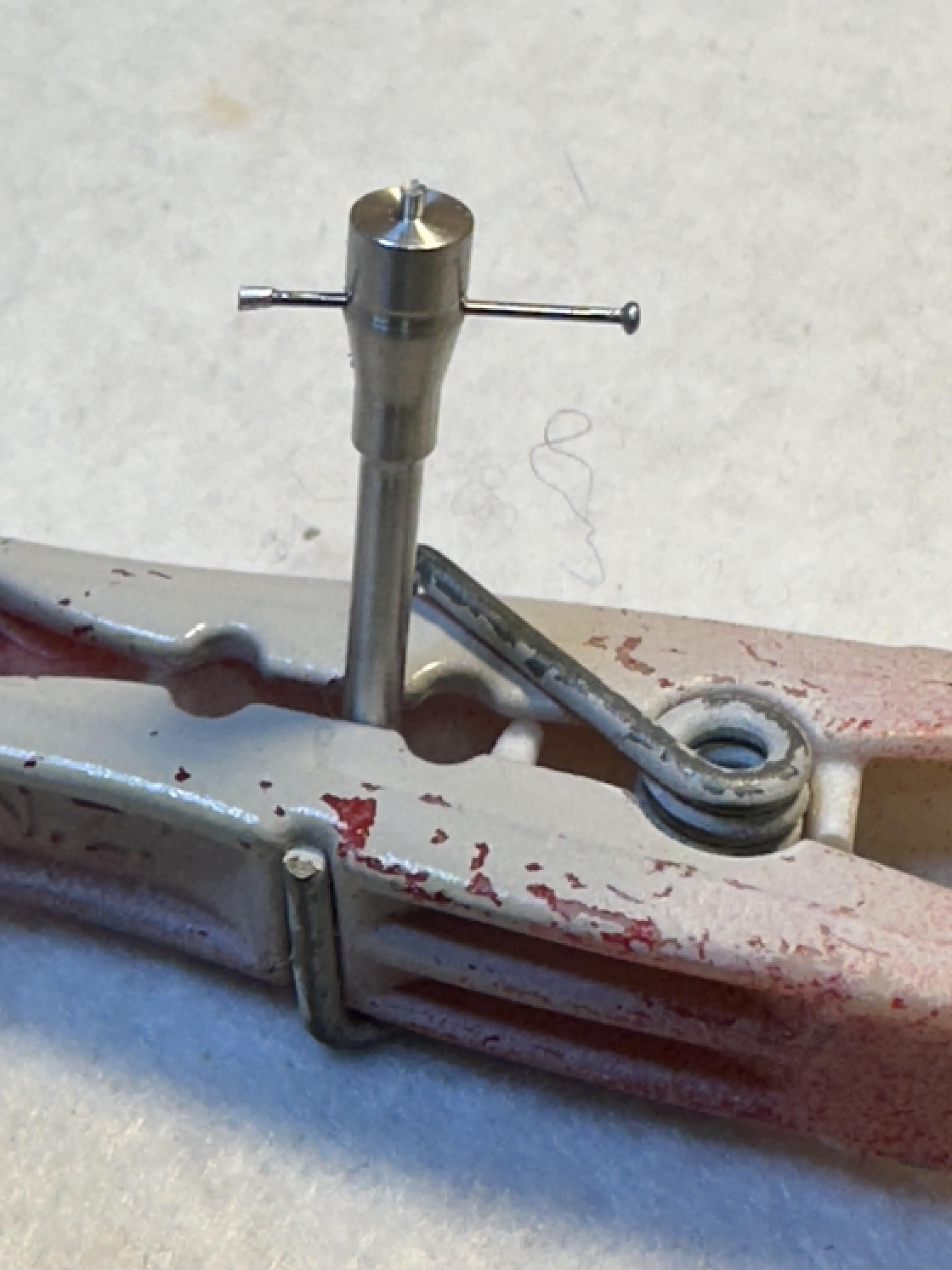

 I decided to use a Parts by Parks billet steering column that I have had squirrelled away for yonks waiting for the right build. I was not happy with the blobby gear lever so that has been replaced with a pin with a small tapered knob on the opposite side for the indicator lever. It is hard to see as it is only 0.8mm in diameter on the large dimension. I machined this on my Unimat 3 lathe
Parts by Parks column as it came
Machining the indicator knob
And the final result

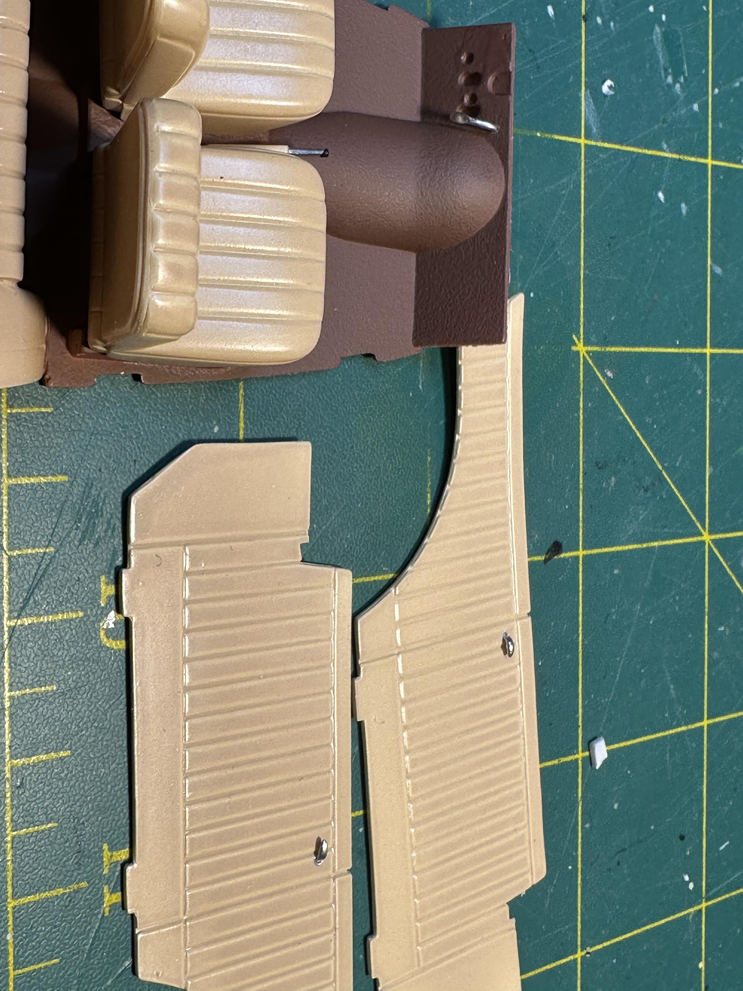

The door cards on the Revell 32 do not have any handles or winders. The window winders in this build will be replaced with electric windows so may put a couple of switches on the dash for that. For the door handles I flattened some silver coated copper wire and filed and shaped to suit. They were then painted with a new Molotow chrome pen. They will be cut to length when I fit them

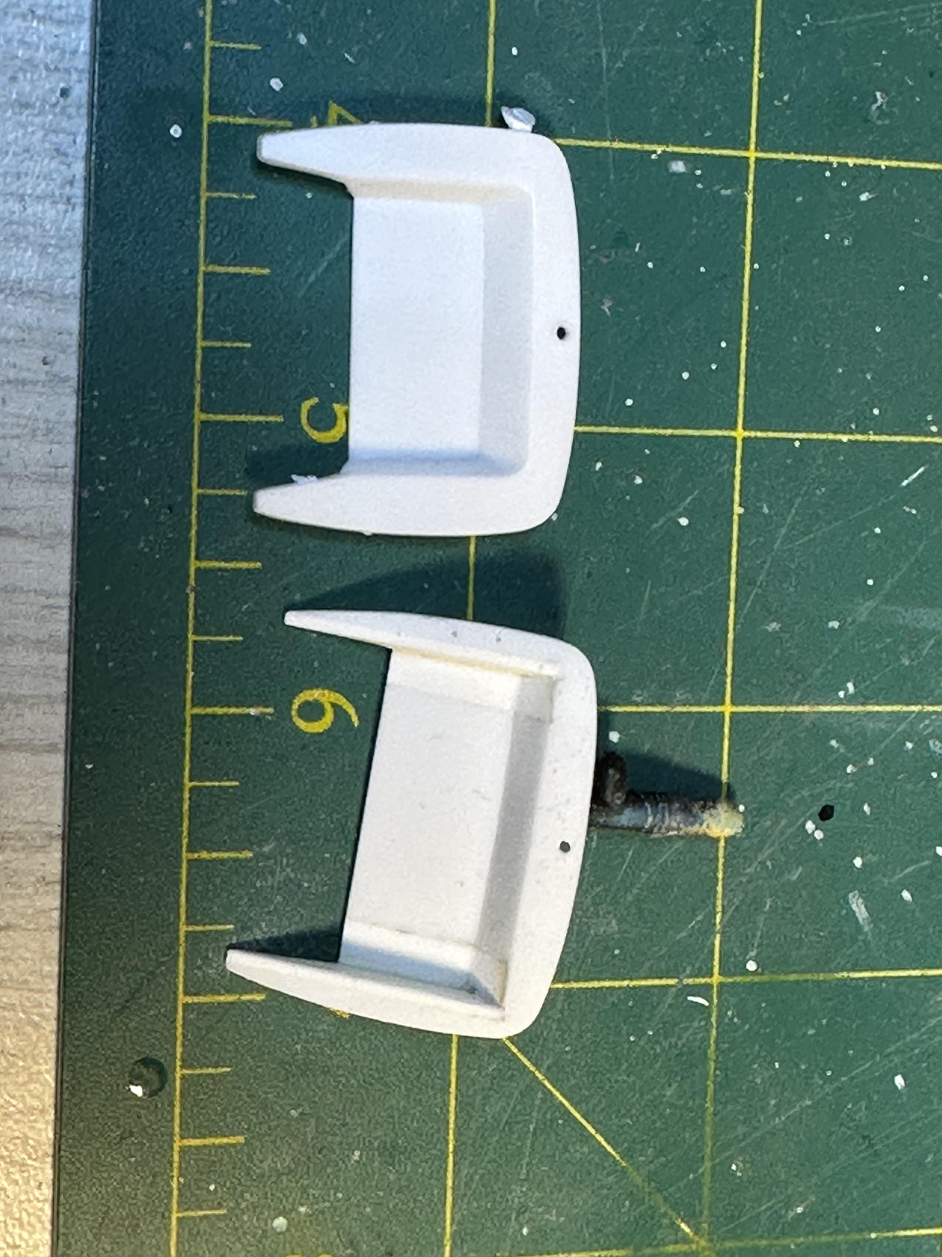

Moving on to the chassis I knew that I would need to do some work heare after the chassis mods. I tried to fit the mufflers in the chassi but they would just not fit. I have machined up some replacement cherry bombs. The Vicky kit exhausts are 1.8mm which scales out to 1.75" in real life. What serious rodder is going to use such skinny pipes, The new mufflers are drilled for 2" pipes which is better but 2.5" or 3" would have been better but I dont think I will have room for that size. I will be making new headers in 1.8mm solder when it arrives and 2mm for the exhausts from the collector onwardsimage.thumb.jpeg.0a8ddc35f32b377572084a181523a9b4.jpeg

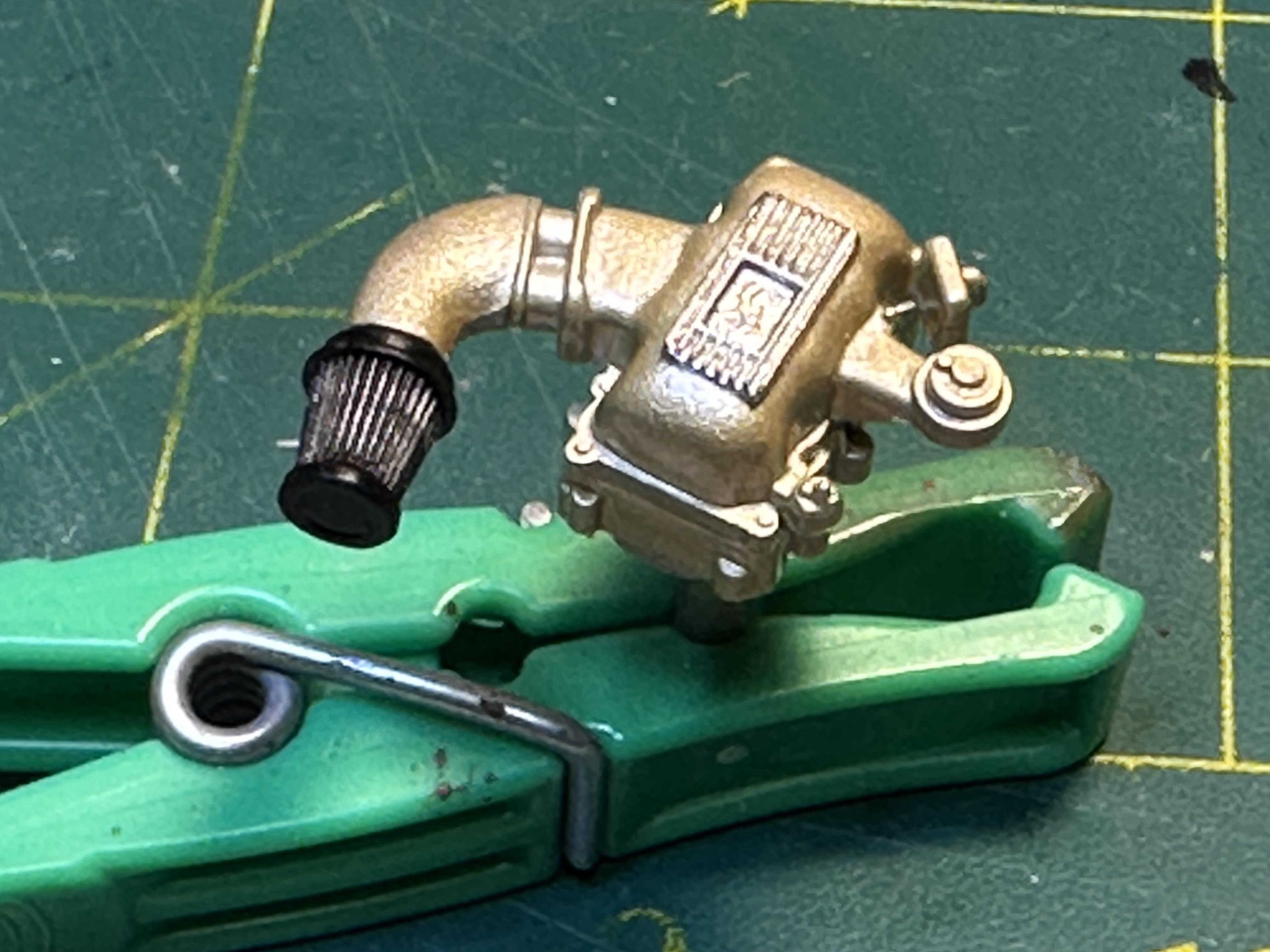

Top of motor with 3d printed air cleaner fitted. Air cleaner is way better than kit original. Painted semi-gloss black with silver dry brushed on filter ribs. I masked the inlet plenum chamber and sprayed the finned area with SMS chrome

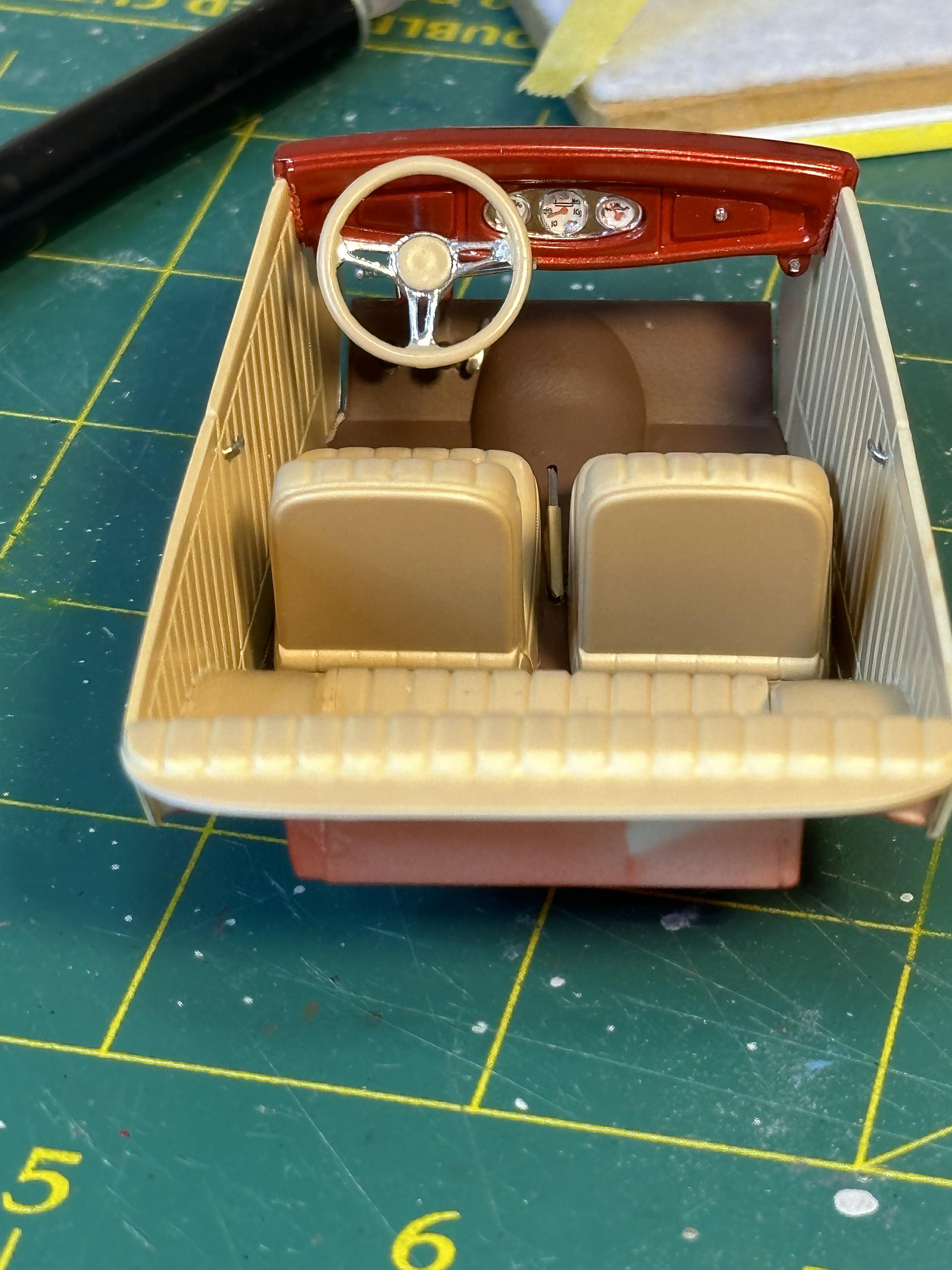

Finished the interior. Added some scratch built parts to the rather spartan interior. A spoon accelerator pedal as there was only two foot pedals and the Modular motor is a manual, a couple of toggle switches for the electric windows made from flattened silver plated copper wire and finished off with Molotow, hand brake lever as posted earlier and a billet glovebox knob I turned up on my lathe
The steering column as modified earlier was fitted and it really is for an automatic car but as the Modular motor from the AMT Vickie is a manual it will now be 5 on a tree!!!. The work I did widening the tubs on the rear seat turned out OK too.  I had a lot of trouble with the guage decals - they must be getting a bit old and fragile as this build is from an original kit

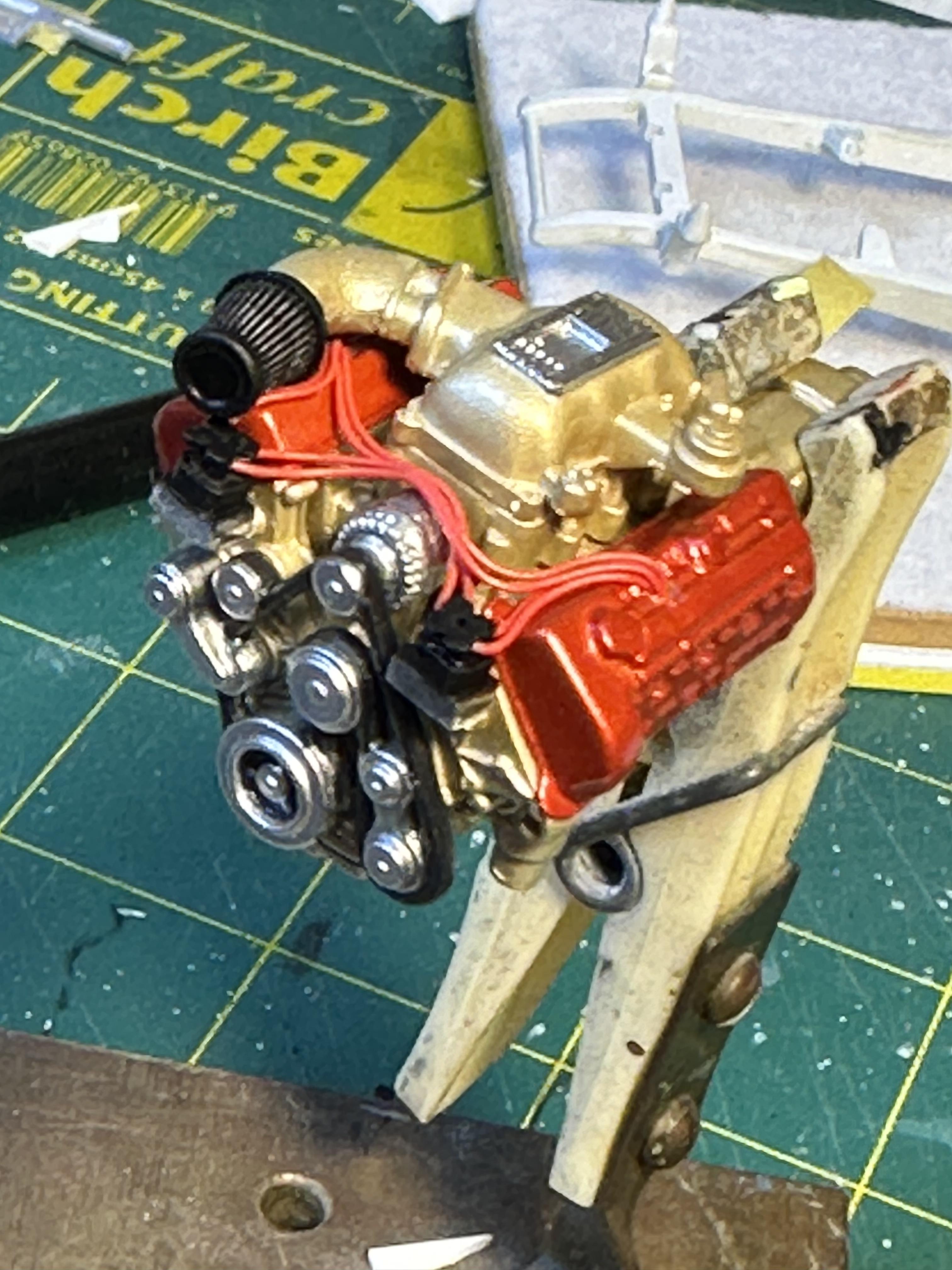

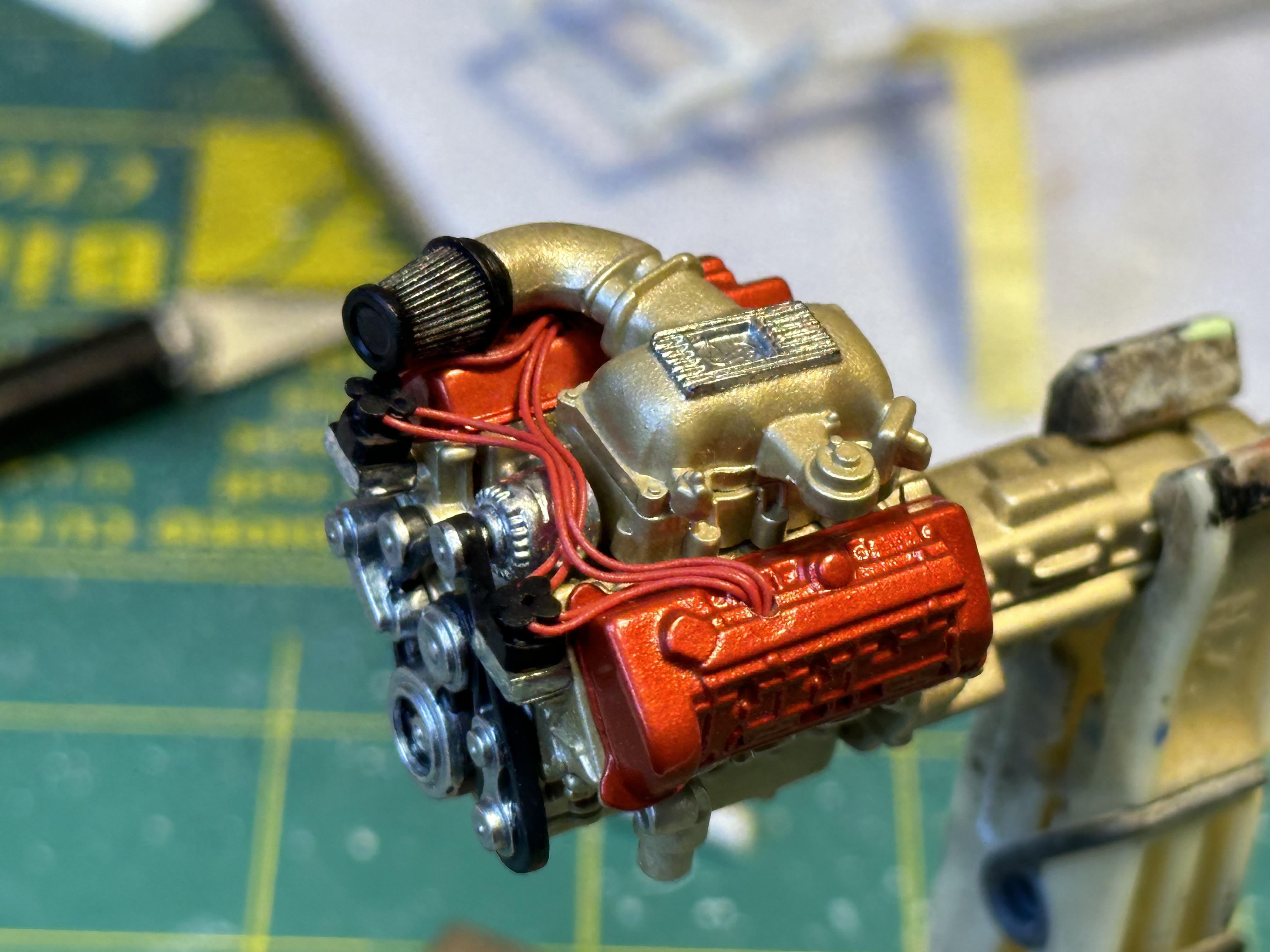

I have done some work on the motor. I was not happy with the supplied AMT Vickie coil and plug wire set as it is very chunky around the coil area. I did some research and downloaded some pix and I ended up making two coil sets
Here is my version in the raw
And finally, the motor assembled with new plug wires and paint detail
IMG_9553.thumb.JPG.5fb44a0452690dc4cac3358dd6217fe9.JPGIMG_9554.thumb.JPG.04a2f1c52950e1cb6eee4e7090383794.JPG
My they are ugly pix - I will take some better pix of the motor and post them up

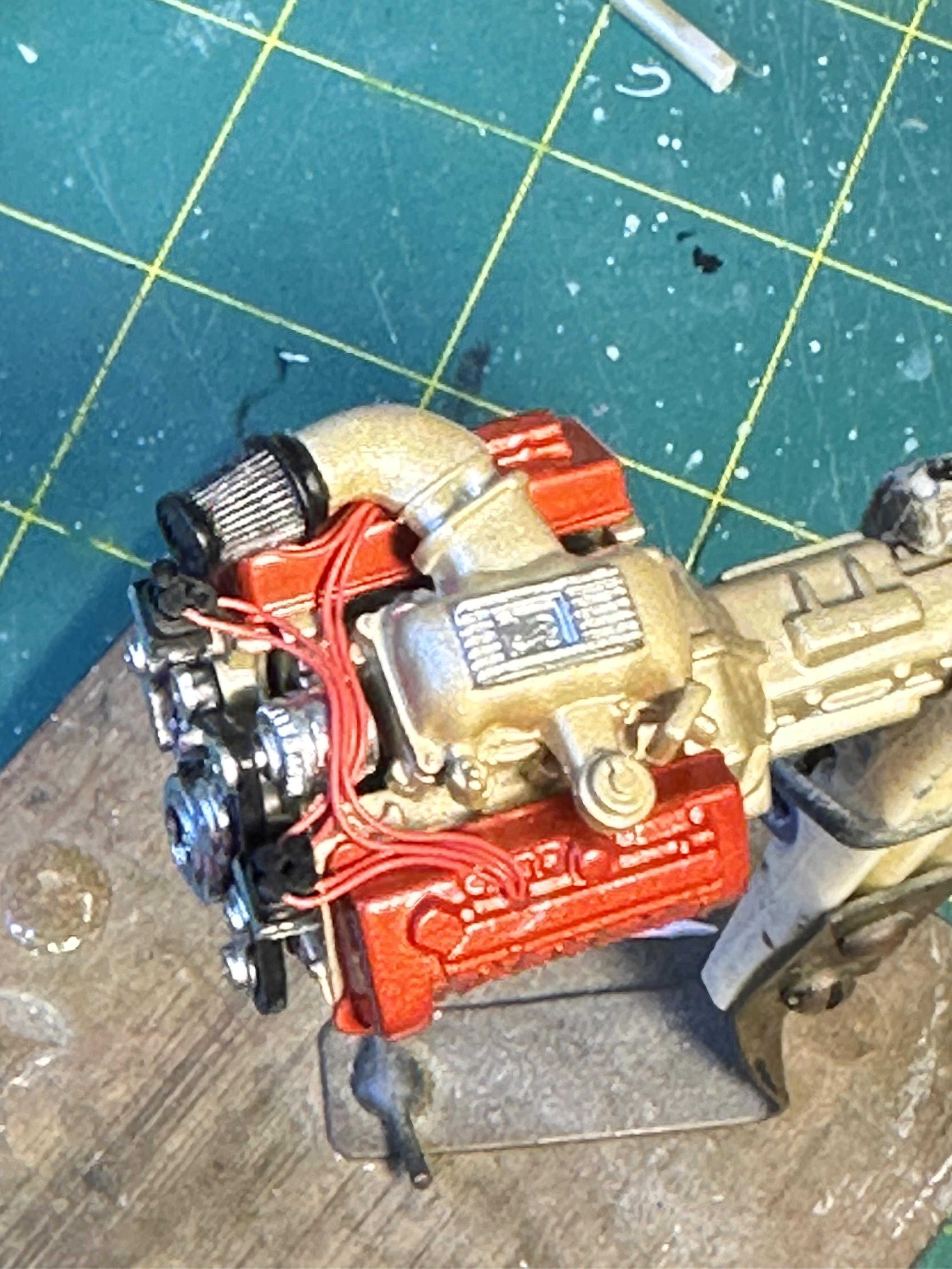

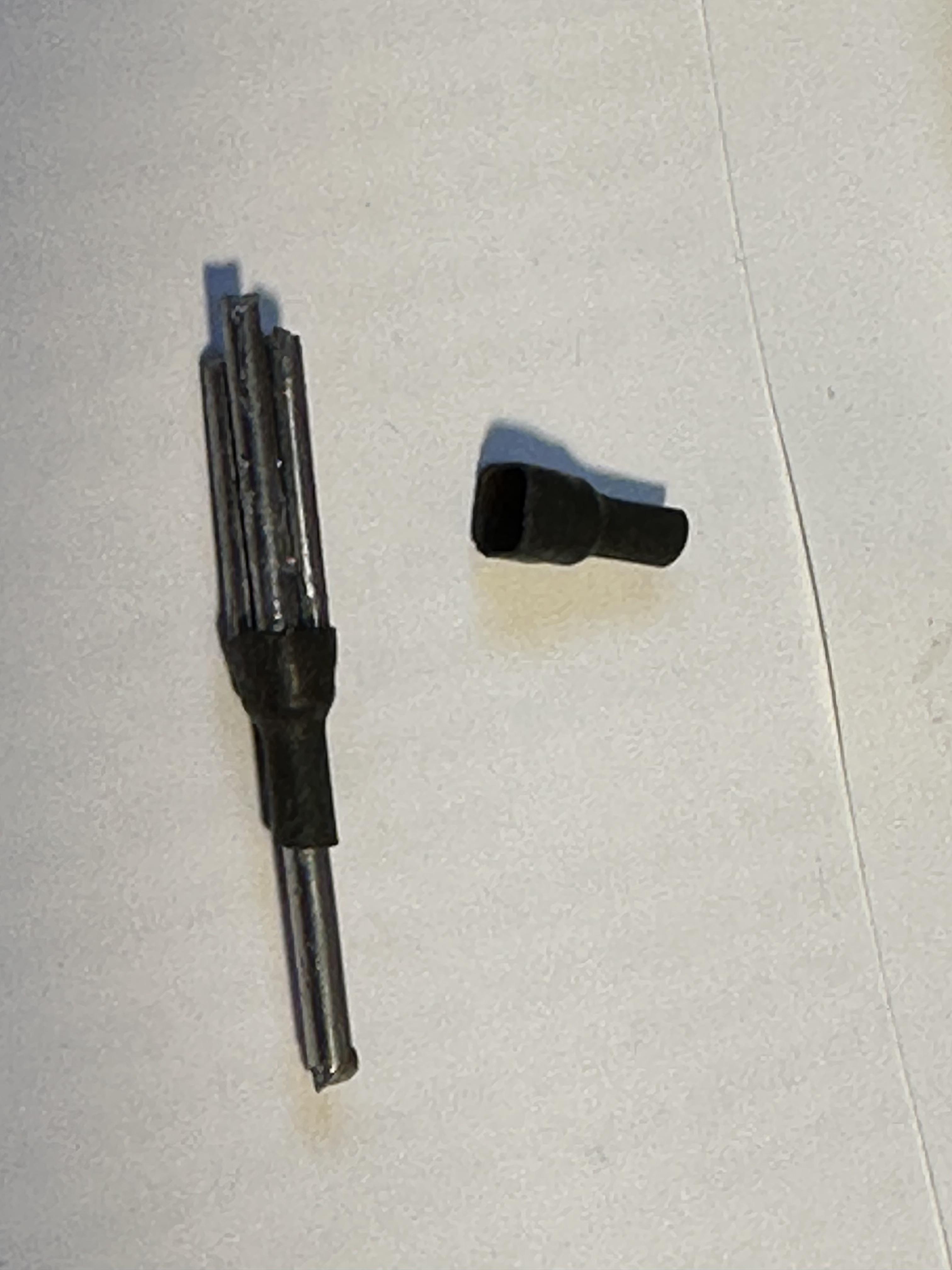

Got some work done over the weekend. Made some collectors from heatshrink. I made a former up from 4 pieces 1.7mm solder, machined a cone and a 2mm solder outlet. Some 1/8" heat shrink just fitted over the outside of the primaries with a little pre-stretching and gave it some gentle heat

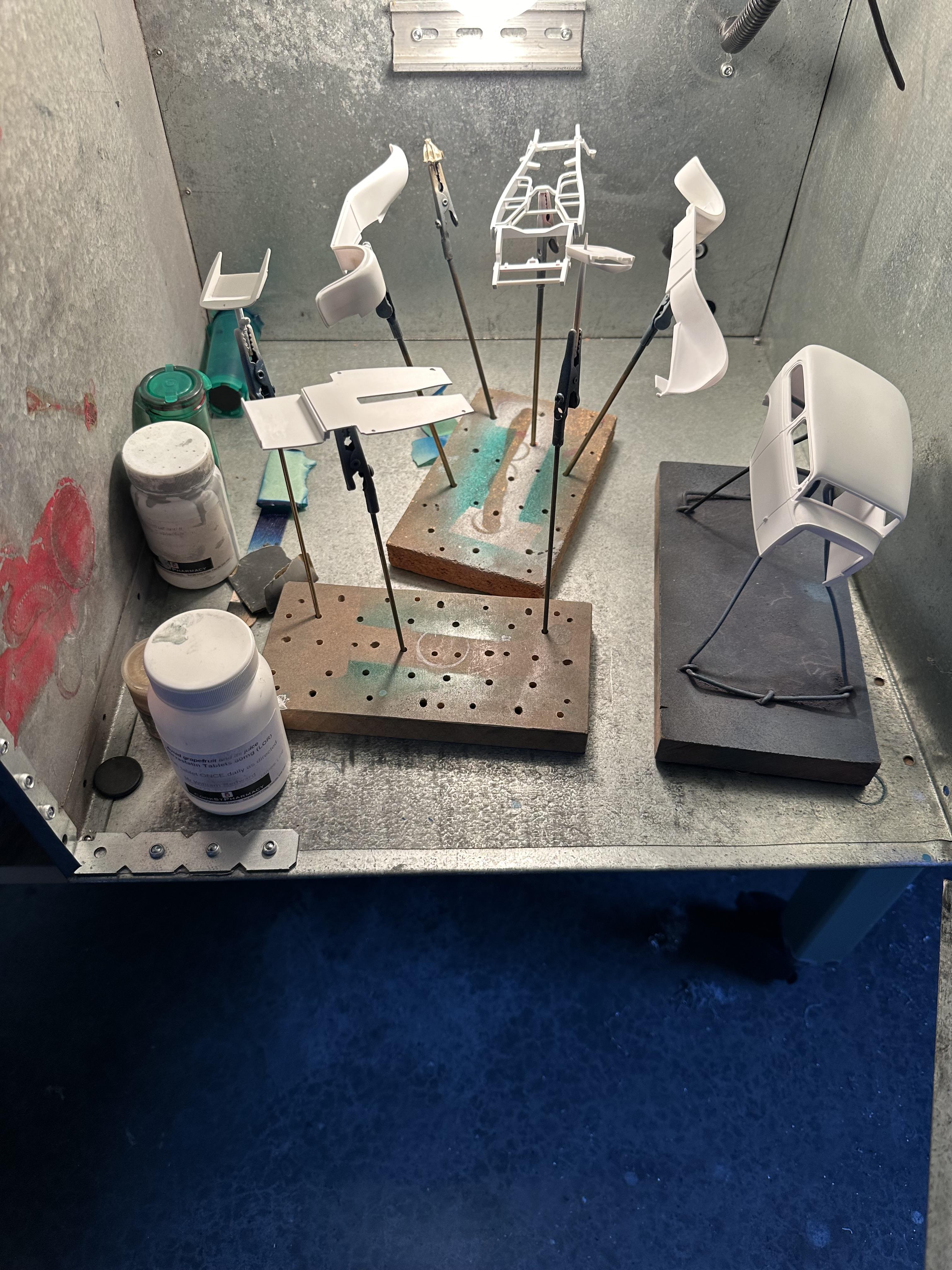

And did some cleanup on the chassis and got some primer on it. All that did was show up some areas that needed more attention. It has now been re-primed and is ready for colour.
And while I had the primer out, I shot some at the body and guards etc and now they are curing in my hot box
And clearer pix of the motor
