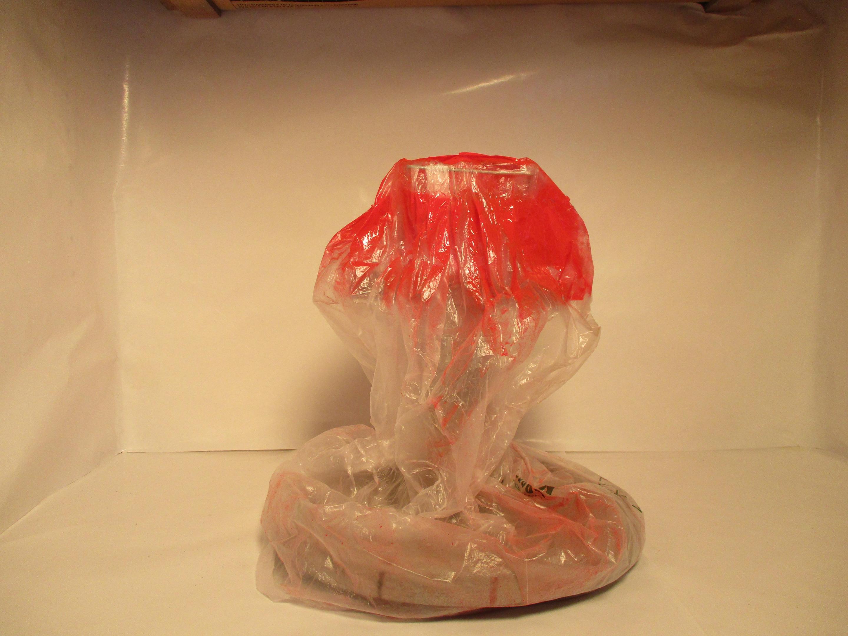

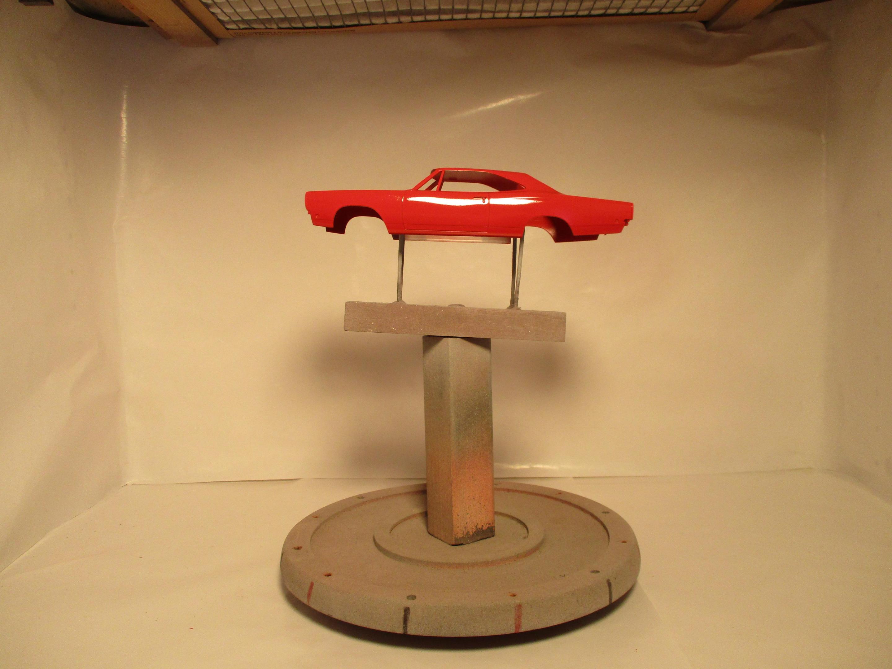

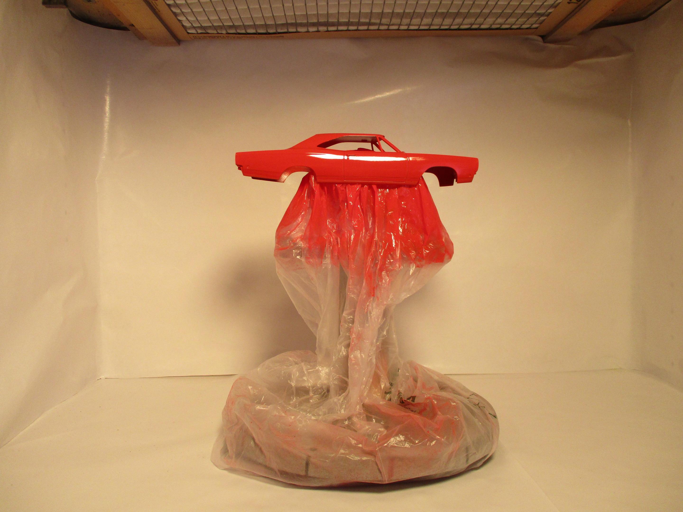

I have been using a homemade paint stand for several years now but recently I was noticing that the buildup of dried paint on the stand was rubbing off as I was handling it and then transferring to the car body as I was painting.  I first tried to clean the old paint from the stand but that was going to be too much work and I was not going to build a new one or purchase a commercial one.  So, then I decided to try a disposable produce bag wrapped over the stand.  BINGO!  Not only does the bag keep the old paint from rubbing off the stand but it also attracts the "floaties" in the air and keeps them off the car body.  I have now painted two bodies using this method and the paint has been "fuzzies" and "floaties" free.  This works with either spray can or airbrush painting.

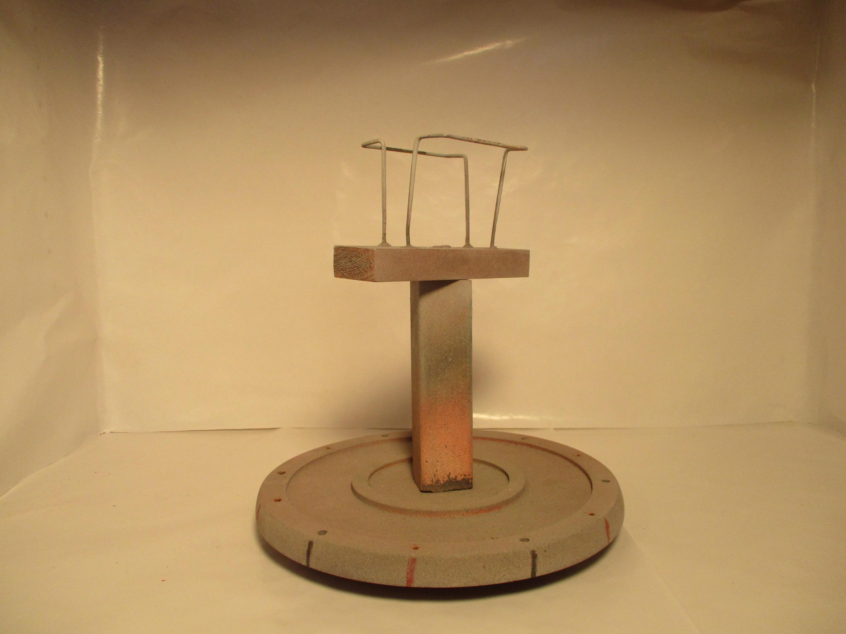

BTW, I build the paint stand using an old Goodwill wooden lazy susan and some scrap one x one wood and a couple of pieces of bent coat hanger.

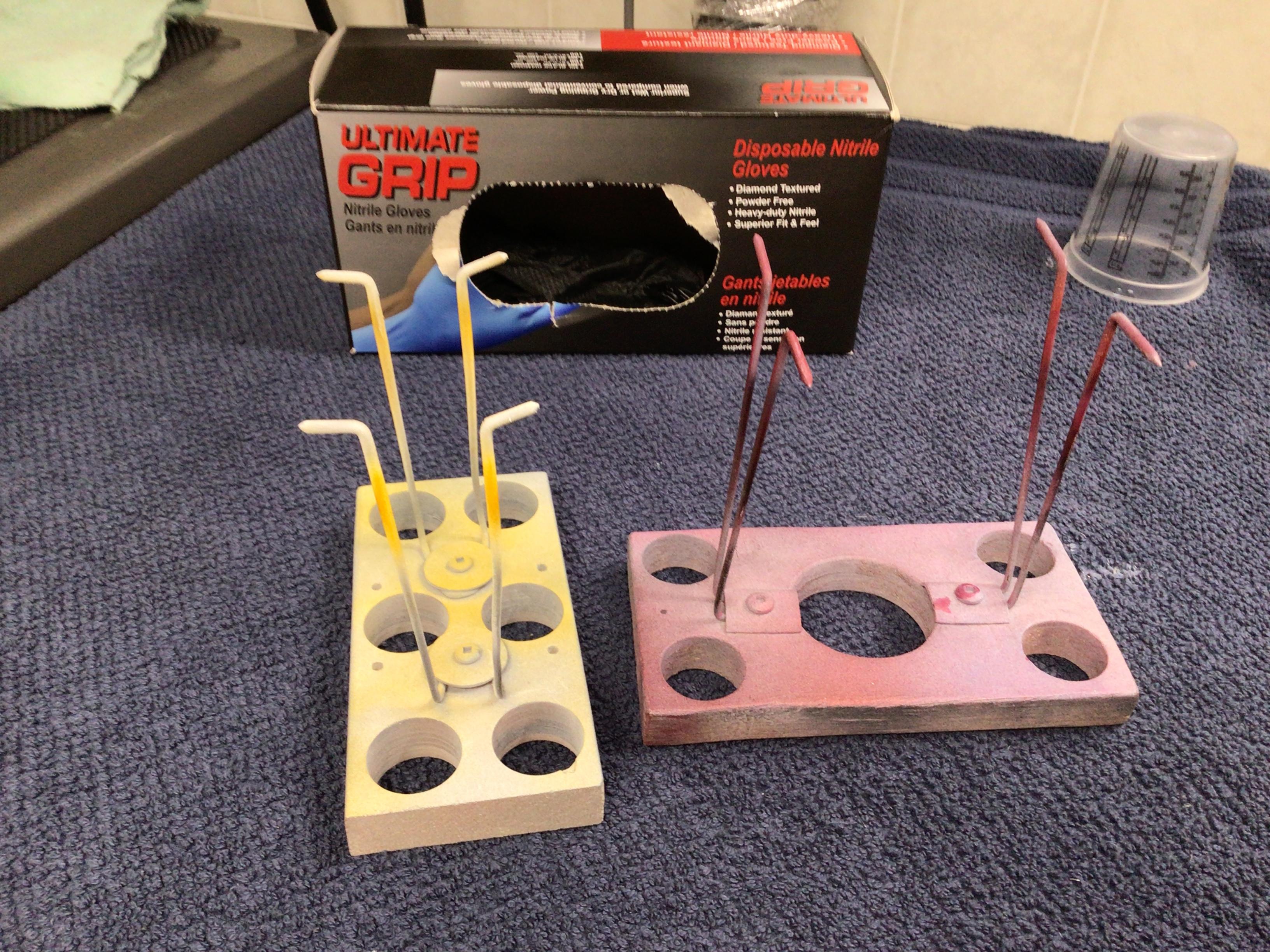

The only issue I can see with that is it can’t be moved easily after paint. I like to put mine directly into the dehydrator both to dry quicker and to protect it from dust. Your fixture is very similar to the ones I made. The prongs can be bent to suit the body as required. The holes make it easier to hang onto.
