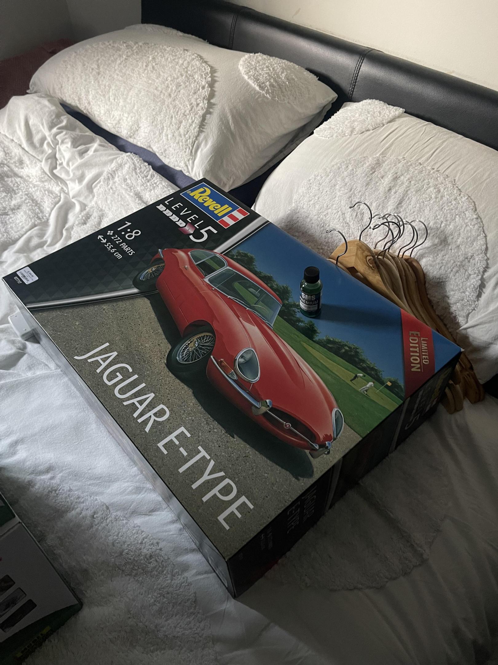

stitchdup Posted August 31, 2024 Posted August 31, 2024 since its red and revell you'll need to do a mettalic silver or gold layer between the primer and colour coats. the revell red and orange leeches a lot of colour through the paint and the silver stops it
Dave G. Posted August 31, 2024 Posted August 31, 2024 You will very likely need a sealer of some sort to keep the red from leaching through to your color coat ( as mentioned above). The silver pre paint is one method. Some folks like a shellac based sealer like Binns, first. It's white. If you were shooting acrylic or enamel, I'd suggest Stynylrez primer, which is a sandable poly acrylic primer/sealer. But some lacquers if hot enough can get sand scratch swelling with this. I don't know how hot SMS is.. Anyway, you want to seal that red.
Ace-Garageguy Posted August 31, 2024 Posted August 31, 2024 (edited) RED PLASTIC LEACHING COLOR INTO PAINT: This topic has been debated endlessly for years, with some insisting it's a problem, and some insisting it's not. The REASON people disagree is that SOME red plastics leach color and SOME don't...and not every red plastic from the same manufacturer does it. I know this to be true from extensive experimentation. SO...as in all things related to getting primo paint results on models these days: TEST ON THE PARTICULAR PLASTIC FROM THE MODEL YOU'RE WORKING WITH BEFORE DECIDING HOW TO HANDLE IT. Edited August 31, 2024 by Ace-Garageguy

Matt Bacon Posted August 31, 2024 Posted August 31, 2024 (edited) BRG is not one colour, anyway (even Tamiya's rattle cans have two... TS-9 and TS-43). 1930s Bentleys were Brunswick Green with matt-finish olive green fabric bodywork. Racing Jaguars in the 1950s and early 60s were very dark; Lotus race cars in the green with yellow stripes schemes were much brighter. Vanwalls are somewhere in between. Jaguar's E-Type racing green is dark and slightly bluish.... unless it's "Opalescent Racing Green", which is beautiful, but different again. Broadly, I'd go for neutral grey primer. But it's important to make sure that the red pigment of the plastic won't come through and make it brown, so test as @Ace-Garageguy says. In my experience, Tamiya Fine Surface Grey Primer with multiple _light_ coats of colour on top will not leach the plastic pigment. The problem arises if the solvent in the coloured paint layer can penetrate the primer and pull the plastic pigment through. So don't have wet coats, and remember the same thing can happen with the clear coat as well. In fact, the couple of times I've had this problem, it's been with Zero Paints 2K clear (which is intended to be applied wet) pulling pigment through the matt finish porous base coat (which is designed to give a really good "key" for the gloss coat on top), best, M. Edited August 31, 2024 by Matt Bacon 1
