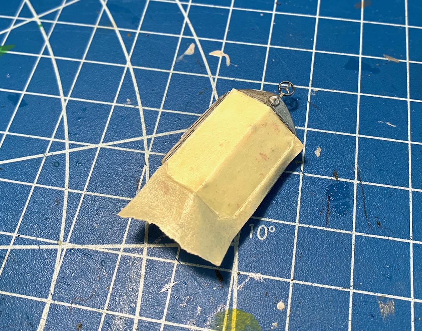

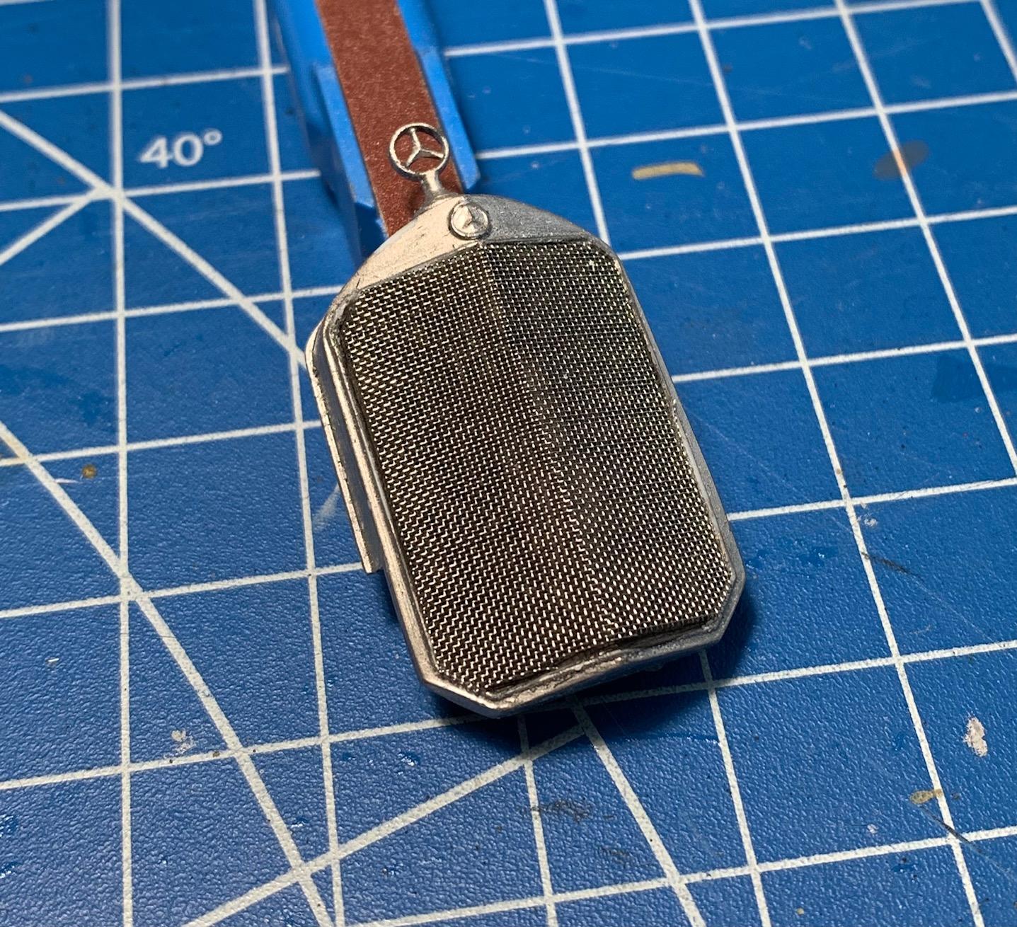

Pierre Rivard Posted February 3 Author Posted February 3 (edited) I need a solution for the radiator grille which is so prominent on this car. The kit rad grille does not have the right mesh pattern plus an extra part for a stone guard with a pattern that appears a bit heavy to my eye. I'll definitely dump that part and and would prefer to apply steel meshing right over the radiator/grille unit. I have 40 mesh and 80 mesh in my tool box so I will test with both before making a more precise unit after choosing which of the two is the better candidate. Again here I aim more for realism than accuracy. Don't hesitate to offer ideas or opinions. This is work in progress. Edited February 3 by Pierre Rivard
MarkJ Posted February 3 Posted February 3 Either one looks better than the one in the kit. Awesome way to get the mesh to fit using the masking tape. I personally like the finer mesh but whatever an actual race version looked like would be the way to go. Do you have a ref picture close up of the race version grille?
Pierre Rivard Posted February 4 Author Posted February 4 Here are period pictures of the car, preferable IMO to what we may see on big bucks restored cars. Top left corner is the actual grille without the stone guard and the other 3 have rather simple stone protection screens. I think the finer screen is a better fit.
AmericanMuscleFan Posted February 4 Posted February 4 I go with the family, I also prefer smaller meshes. Even in the first photo, what makes up the cooling cells seems flush with the tanks, is there also a decorative grille on top? Sorry for the potentially stupid question, I'm not an expert on cars from this era!
Pierre Rivard Posted February 4 Author Posted February 4 46 minutes ago, AmericanMuscleFan said: I go with the family, I also prefer smaller meshes. Even in the first photo, what makes up the cooling cells seems flush with the tanks, is there also a decorative grille on top? Sorry for the potentially stupid question, I'm not an expert on cars from this era! It's a V shape radiator with the cooling cells flush to the front, perhaps what we see is a decorative grille but regardless the kit part did not reproduce that pattern and it is too fine to reproduce at 1/24 scale. Going with a stone guard as was commonly used for racing makes sense and is easy to reproduce. The 80 mesh screen it is! 1

Pierre Rivard Posted February 5 Author Posted February 5 Spent time refining the grille fabrication and then installed the radiator which I should have done before the engine install... or not move the headlamp assembly back. Anyhow, found a way to squeeze it in. 3
MarkJ Posted February 5 Posted February 5 Pierre, Wow. That grille is spectacular. The whole front of the model is as well. Really looks like the real thing shrunk down to scale. I guess that's what we all want from our builds. Superior work going on here. 1 1

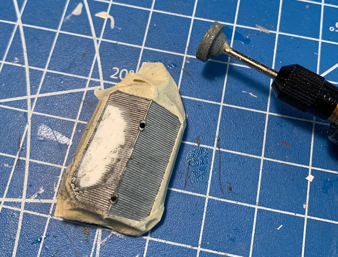

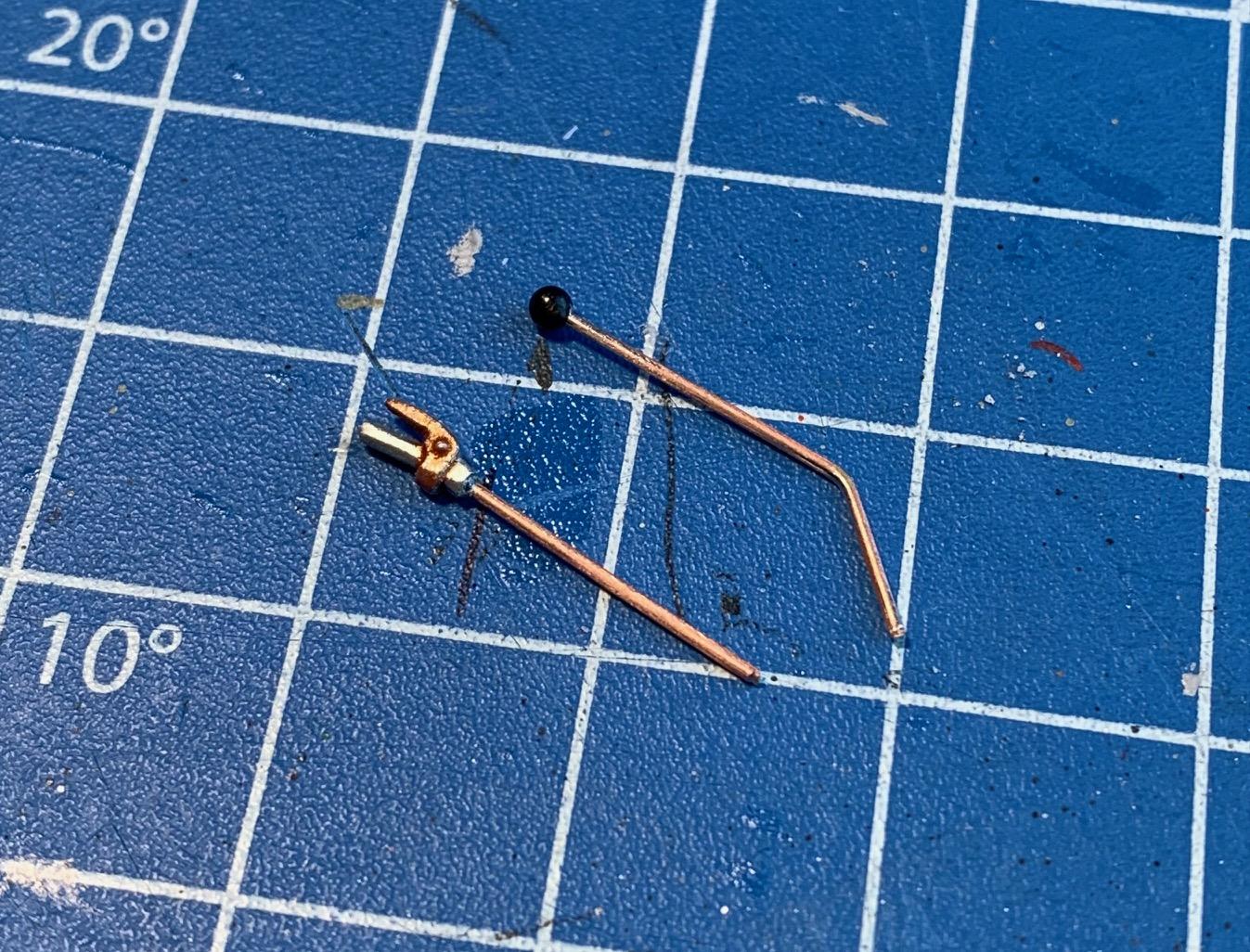

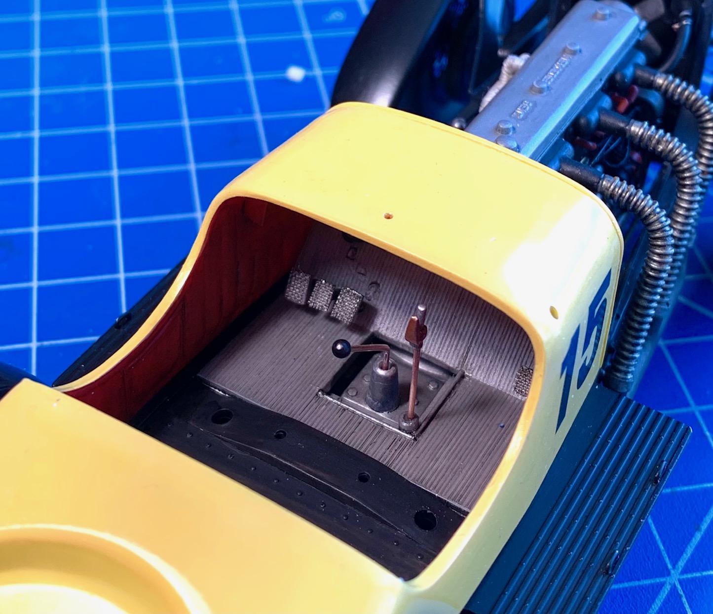

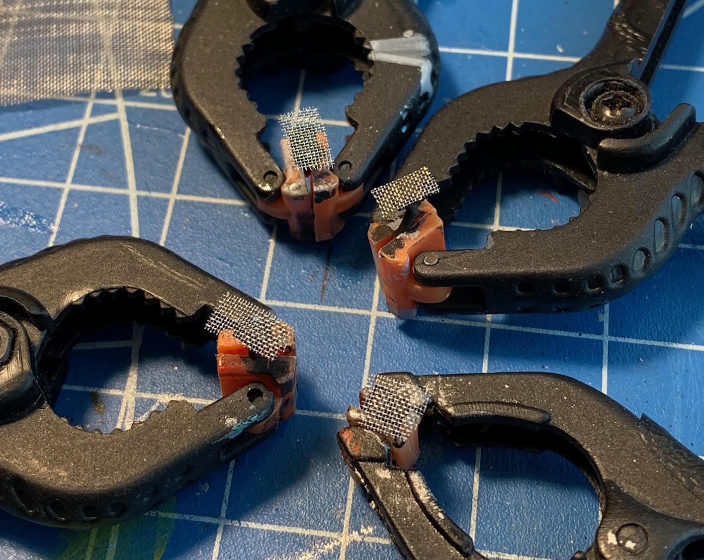

Pierre Rivard Posted February 8 Author Posted February 8 Moving on to the interior. First job is carving up an opening in the floor to expose the top of the transmission, like the real car is. I then did a mock up to get the dash, steering wheel and shifters locations marked up. It's a tight cockpit so better make sure. The steering wheel is not original... and the rest (apart from the seat) will also require some fabrication to look more like the real car. I made the 4 pedals with little blocks of styrene, then glued meshing, which will be trimmed to size. Next were the shifter and hand brake. Going with a pin from Michael's jewelry section for shifter and trimming down the BIG hand brake 5
1959scudetto Posted February 8 Posted February 8 Pierre, your controls are far superior to the original parts - be it handbrake, shifter or pedals ! Your speciality is turning a crude kit into a faithful replica, bravo ! Can't wait to see the next steps you are taking....
