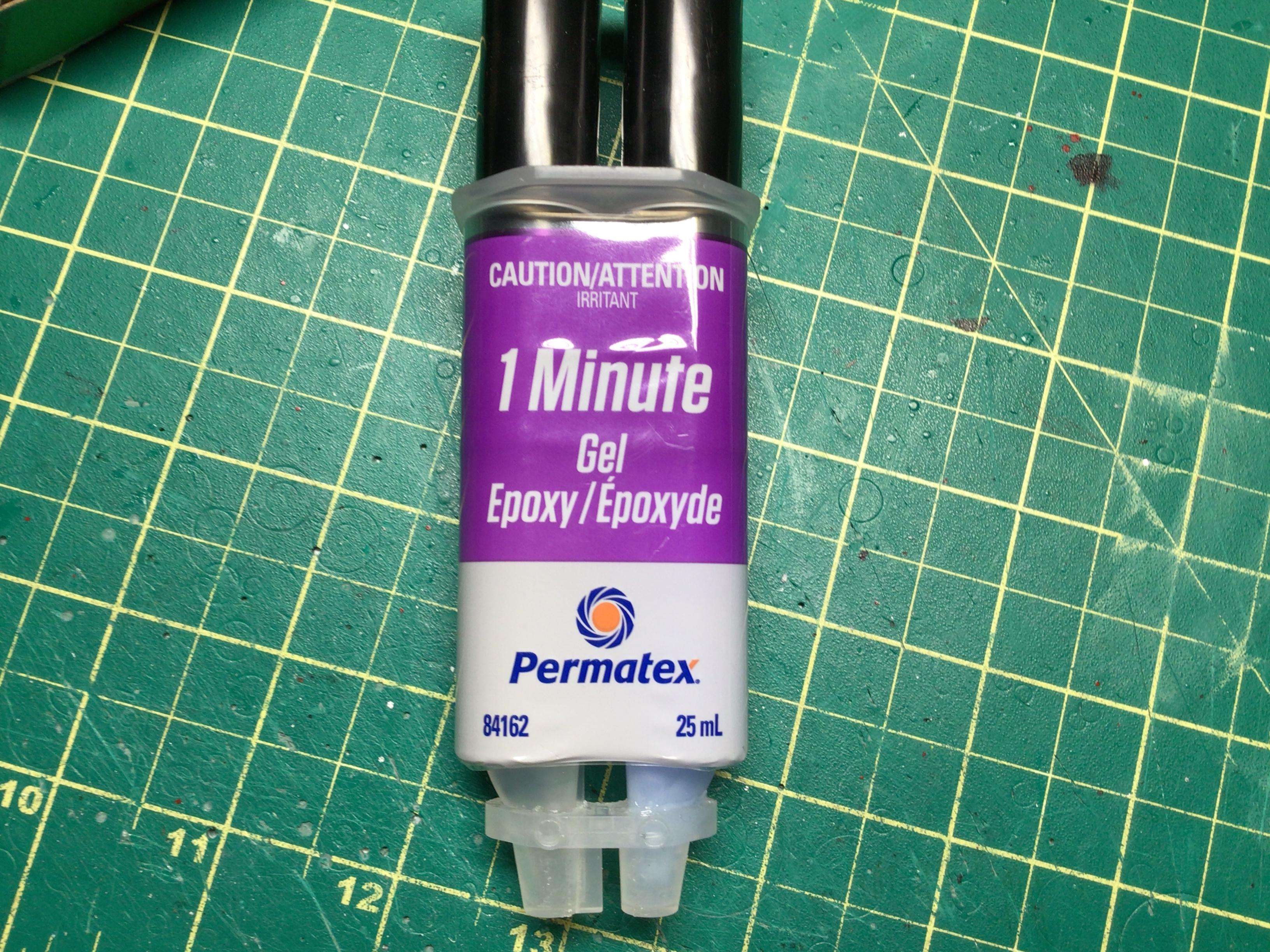

StevenGuthmiller Posted January 28 Posted January 28 On 1/28/2025 at 6:27 PM, Chariots of Fire said: I've tried the stuff that comes in a combined tube for A and B. Never worked out that well because it was difficult to push out equal amounts. I ended up cutting them apart. I note some of you don't like CA and tend to use other adhesives exclusively. Each of us has found through experience what seems to work best. As for me I work almost entirely with CA, using epoxy in those cases where I want some time to adjust or place parts. Clear Gorilla glue works well with headlights, if used sparingly, but it takes a while for it to set up. Lastly, about all small parts get pinned as well as glued in place. It's almost a necessity especially if parts are to be added after painting. Gluing exclusively to painted surfaces almost guarantees that at some point the part will come off. Expand I pin small parts as well, but not in every circumstance. Only where I feel that extra strength will be needed for whatever reason, such as door handles, mirrors, antennas, and occasionally some engine parts that may have to endure some stress, (ie, pulleys, etc, where a belt may put extra stress on the parts) Otherwise, I’ve found the epoxy that I use to be far superior in bond to nearly any other glue I’ve used over the years, at least initially. As a matter of fact, I’ve had the occasion arise where I’ve had to take something apart that was assembled with epoxy, and let me tell you, it’s been a real bugger to get them apart in every case! Steve 1
