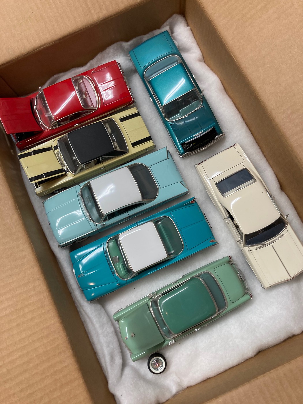

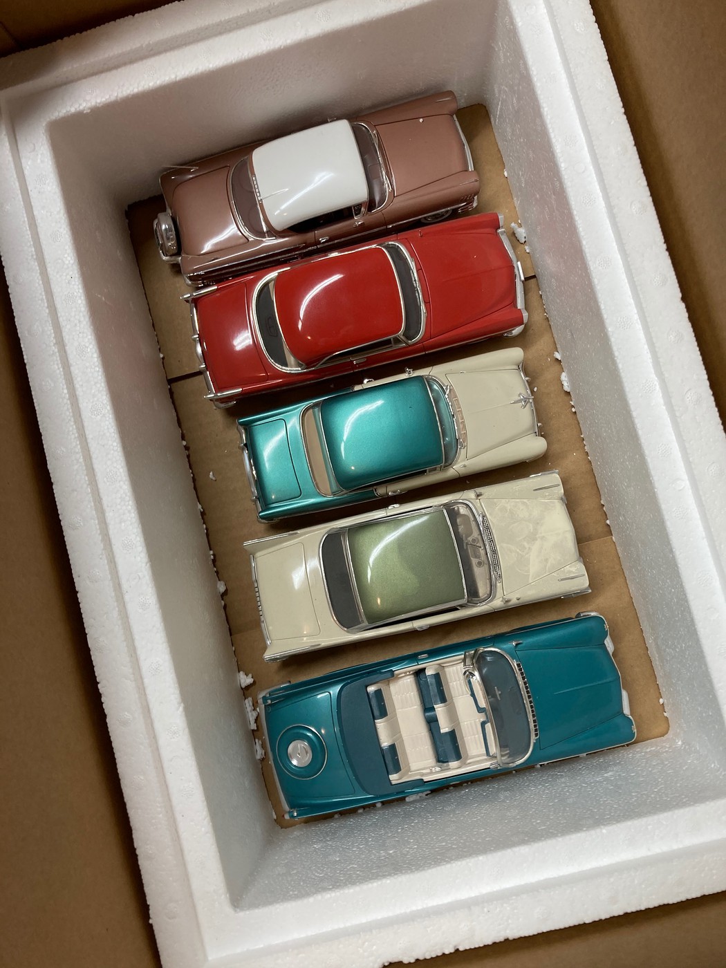

StevenGuthmiller Posted March 30 Posted March 30 (edited) I haven't scraped a painted or chromed glue joint since I was a kid. Call me lazy I guess, but I've never really found much of an advantage to it. I suppose if your models are going to get a lot of really rough handling, or get knocked around a lot, I suppose I could see it. But even with plenty of bouncing around and routine handling, I haven't had much problem with parts coming off. Have I had the occasional mirror or antenna flicked off?.....sure I have, but that's going to be pretty hard to avoid in any circumstance. I've been using 2-part epoxy now for pretty much everything for more than 10 years. I don't scrape a single glue joint anywhere, and my models get more than their share of abuse and frequent handling, and I don't think I can remember the last part I lost. Just for an example, the last model I built, (1964 Pontiac Bonneville) contains a TON of tiny parts. It's made at least four trips to shows this past year of around 500 miles each trip, bouncing around in the trunk of a stiff riding Honda S-2000, unpacked and repacked 16 times during the course of those shows, not to mention the handling it receives at home for whatever reason on occasion. So it's no shelf queen by any stretch, but as fragile as some of the intricate assemblies on this model are, I have not had to re-glue a single part throughout all of the abuse. The same can be said for virtually every model in my collection. Just out of curiosity, I decided to dig out a box of old stuff that has been sitting for about the past decade. These models were packed up when we moved about 9 years ago, were thrown into the back of a U-Haul and driven 300 miles, stored in a hot storage shed for over a month, and then tossed into a pickup truck and hauled to our current home, where they were unloaded and placed in the room that is now my shop. I think this is the first time I've looked at them since they were packed up. The only lost parts that I see on any of them is a knocked off mirror on a '61 Impala, and a front wheel from the '53 Ford. (the wheel is not a failed glue joint, but a broken axle instead) In any case, I imagine that you're catching my drift. A lot of my models have not had easy, pampered lives, and yet I don't scrape joints, and I don't loose parts. Steve Edited March 30 by StevenGuthmiller 2
