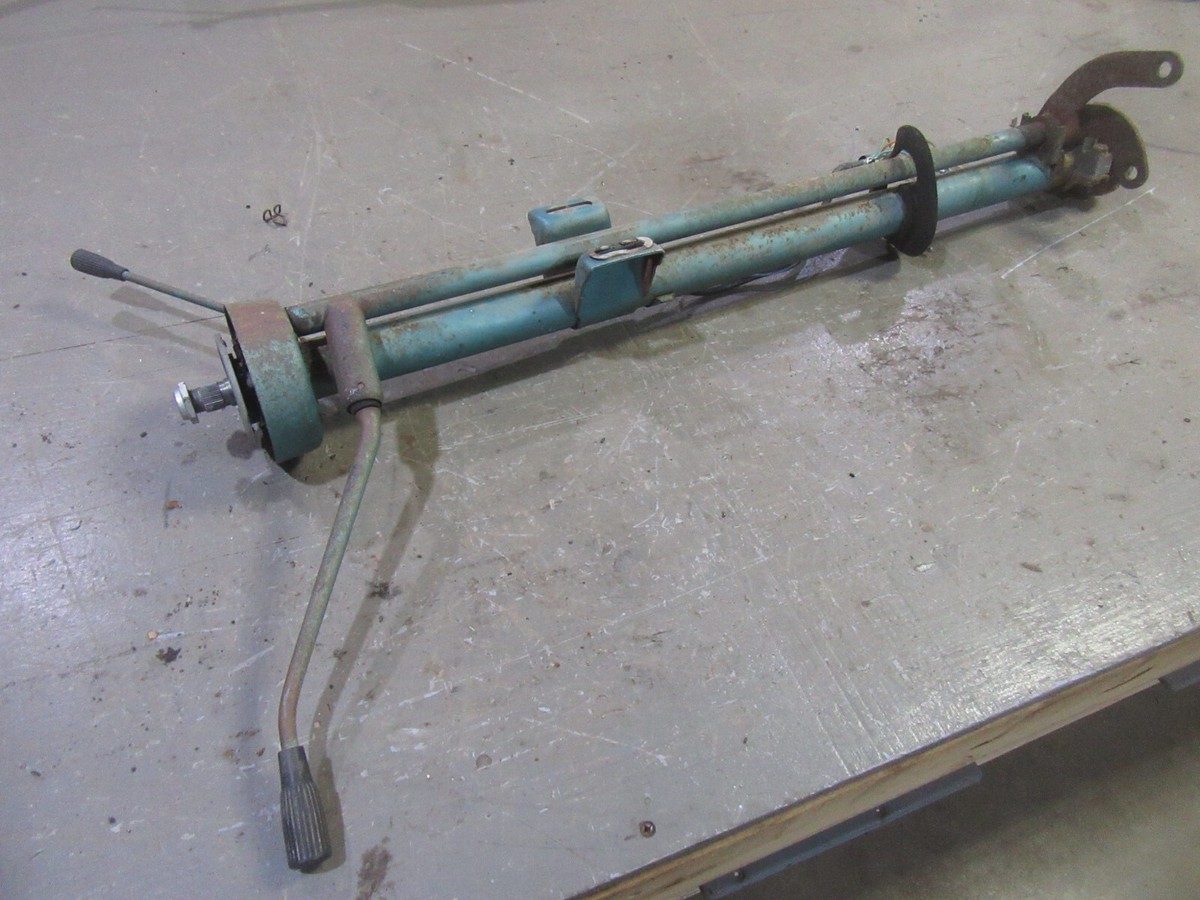

sidcharles Posted July 29 Posted July 29 speaking of transmissions .... the floor shift was omnipresent until when; around 1941 or so? but what happens if a rodder has a three speed transmission, and not the means or desire to put the lever on the floor? for him, the journey may be the destination with no hurried anticipation of getting there. or maybe his gal likes doing the "slide-over" and sitting next to him on those long drives. kinda hard to feel romantic with a steel shaft between your knees. i've yet to find the interconnection between the transmission linkage and the two perpendicular stalks which emerge from the steering column mounted shaft connected to the shift lever. any link to a diagram or help piecing this puzzle together will be greatly appreciated. thanks, sid
johnyrotten Posted July 29 Posted July 29 Here's a couple from GM. 67-71 c10 truck and the older 50's versions. The H.A.M.B is a great resource for this kind of information. Tons of knowledge and information there. 3 2
Bainford Posted July 29 Posted July 29 The vast majority of 3-speeds that I have encountered were on the floor. Three on the tree seems to have existed in cars throughout the 50s and early 60s, though common in pickups into the early 80s. In addition to the excellent illustrations posted by John, here are a couple photos of a '61 Merc steering column. I'm sure your imagination can fill in the bits between the column levers and the transmission. The best thing about owning a vehicle with three-on-the-tree today, is no one will be asking you to borrow it. 1 2
espo Posted July 29 Posted July 29 7 hours ago, sidcharles said: speaking of transmissions .... the floor shift was omnipresent until when; around 1941 or so? but what happens if a rodder has a three speed transmission, and not the means or desire to put the lever on the floor? for him, the journey may be the destination with no hurried anticipation of getting there. or maybe his gal likes doing the "slide-over" and sitting next to him on those long drives. kinda hard to feel romantic with a steel shaft between your knees. i've yet to find the interconnection between the transmission linkage and the two perpendicular stalks which emerge from the steering column mounted shaft connected to the shift lever. any link to a diagram or help piecing this puzzle together will be greatly appreciated. thanks, sid In addition to the pictures of actual mechanicals check out the clutch and shifting in one of the Mobius '42 - '48 Chevrolet models. 1
sidcharles Posted July 29 Author Posted July 29 holy-smoley guys. you don't know how many responses the Ford Barn & HAMB have sent me today and most of them have left me scratching my head. both diagram & pictures [above] have all but eliminated and doubts in my mind how the seemingly contradictory motions of lever & crank thingie interact to make it work. much appreciate the helps, sid
sidcharles Posted July 29 Author Posted July 29 12 minutes ago, espo said: In addition to the pictures of actual mechanicals check out the clutch and shifting in one of the Mobius '42 - '48 Chevrolet models. those rascals @ scalemates pulled a good one on me. it's listed under Fleetmaster (if that's the one you meant) '47 Chevy Fleetmaster , Moebius Models 2302 (2025) the instruction sheet (from another version) has a good picture of the steering column & shift shaft (?) to help with proportion. thanks sid

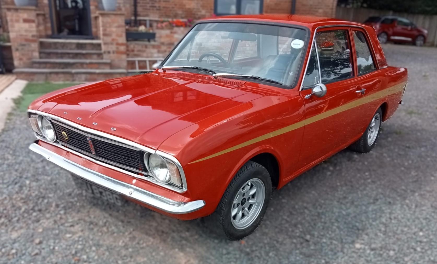

DanL Posted August 7 Posted August 7 Once owned a 1969 Cortina MK2 with 4 on the tree...nice little car and a lot of fun 1
