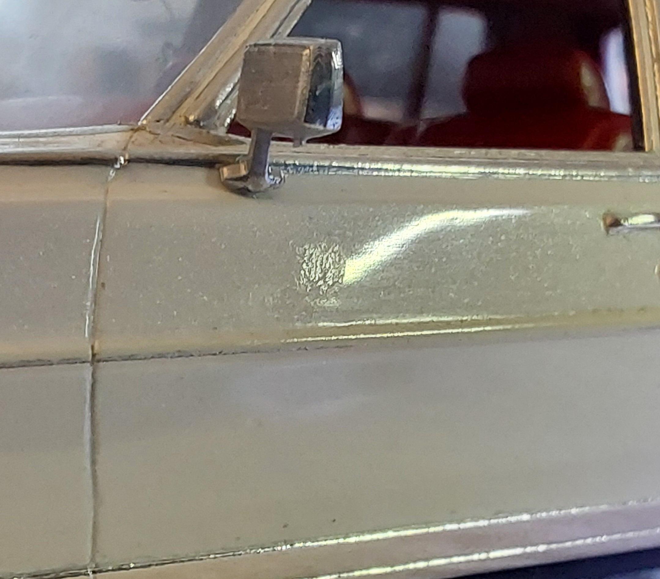

Perspect Scale Modelworks Posted August 21 Posted August 21 I guess while gluing on the mirror I managed to get a smudge of CA glue on the painted body. It's Tamiya TS-13 clear over TS-45 pearl white. Is there an easy way to remove the glue without damaging the paint? π€

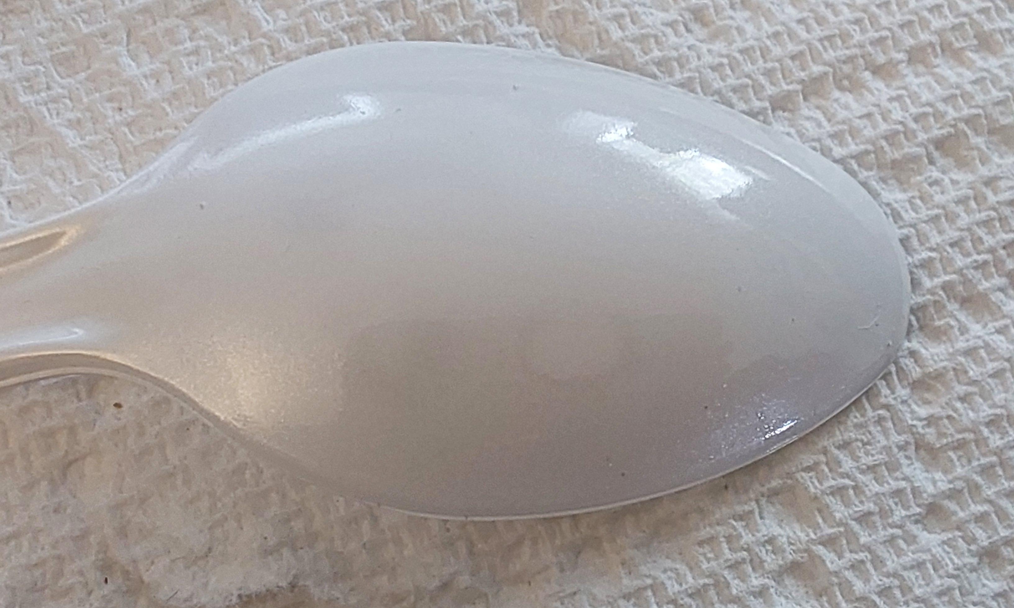

Perspect Scale Modelworks Posted August 22 Author Posted August 22 This is the damaged area. Really just a smudge. Below the mirror. Β I tried a dab of this on the paint test spoon. Β It left a watermark like ring in the paint that didn't polish out. Β

peteski Posted August 22 Posted August 22 Yes, as mentioned, anything substance that dissolves CA will also damage the paint.
Mike 1017 Posted August 22 Posted August 22 43 minutes ago, Perspect Scale Modelworks said: This is the damaged area. Really just a smudge. Below the mirror. Β I tried a dab of this on the paint test spoon. Β It left a watermark like ring in the paint that didn't polish out. Β This stuff also softens the plastic and makes a mess of things. I used it one time and into garbage it went 1 1

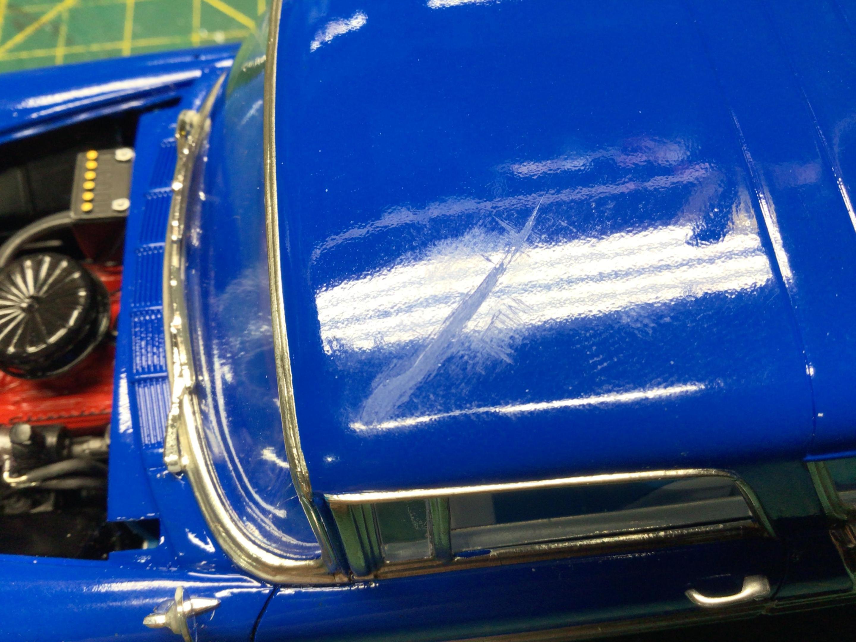

Perspect Scale Modelworks Posted August 24 Author Posted August 24 So plan A was like Steve's suggestion, and just used rubbing compound. Neither Tamiya or Novus removed the glue stain, but they did smooth it down a bit. Plan B, wetsanding. I used a hole punch on 2500 and 3000 grit paper, and glued them to pencil erasers.Β Β I was able to keep the sanding area small. This worked ok. The spot now looks more like a paint error and less like a glue goof.Β It's detectable when you get really close. I should have probably started with 2000 grit, but this is ok for me. The thought of getting deeper into this repair gives me agida. There are a few other flaws on this one so I'll let it go as is and move on to the next one. I'll have pictures posted in Under Glass soon. In the mean time, you can check out the video on IG,Β https://www.instagram.com/reel/DNa8hZasp6R/?igsh=MThyaHFvcnBraTduaQ== Thanks for all the input! 1

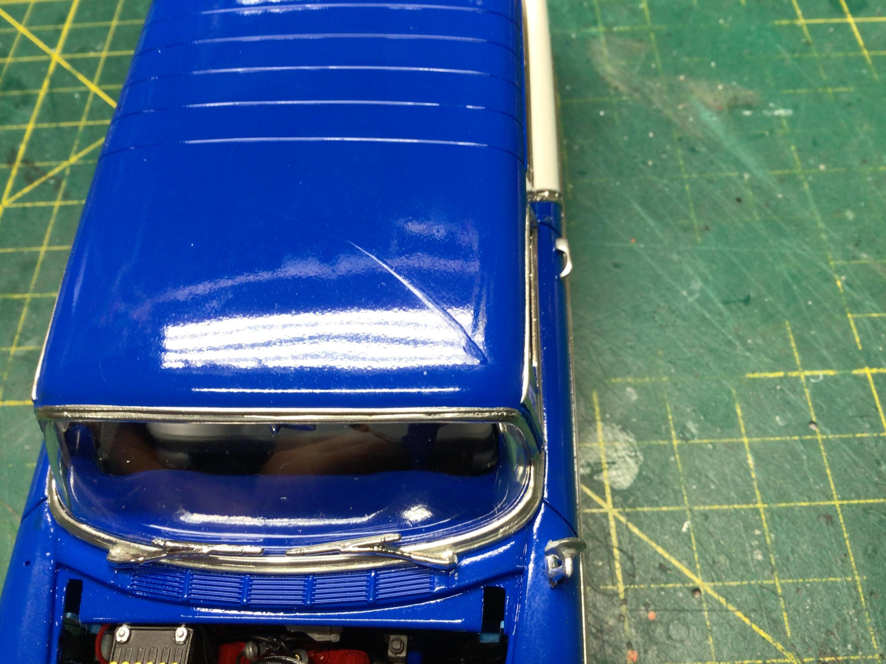

gtx6970 Posted August 30 Posted August 30 I got a tiny glue smudge on the roof of my Doc Burgess car.Β Im thinking lighting sanding the area and polish it . Β Then again...I may just leave itΒ Β Β
