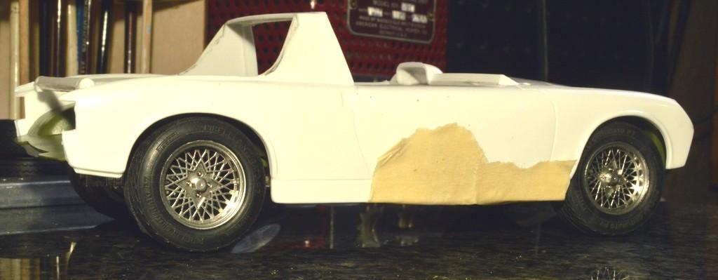

Big Messer Posted August 30 Author Posted August 30 28 minutes ago, Straightliner59 said: F'r instance... Nice wheels. Where they came from? 1

Straightliner59 Posted August 30 Posted August 30 5 hours ago, Big Messer said: Nice wheels. Where they came from? The best answer I have, is from my parts box! I didn't even remember having them.

Straightliner59 Posted August 30 Posted August 30 6 hours ago, Big Messer said: Nice wheels. Where they came from? Looking more closely at them, I am going to guess that they are from a Fujimi tire and wheels set from the late '80s to early '90s. The tires are Centuratos. 1
